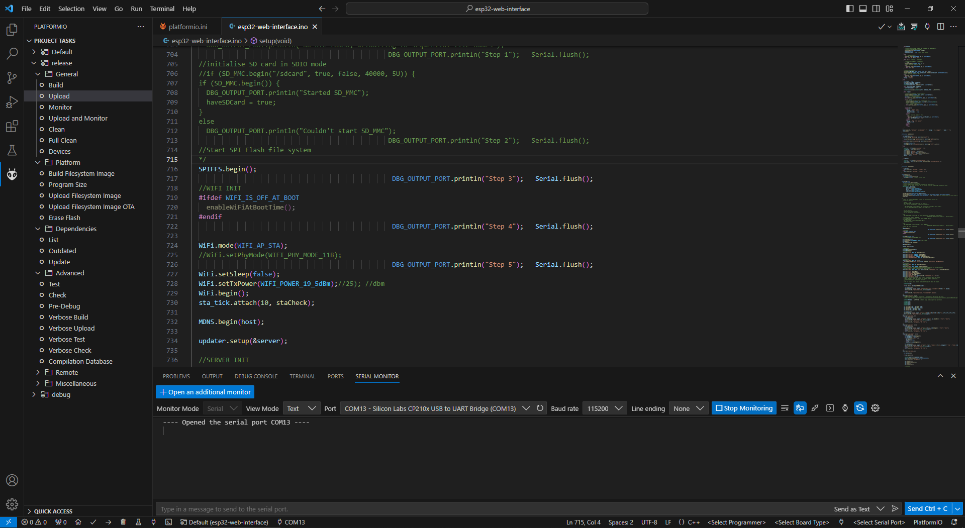

what am I doing wrong ??? ESP32 flashing
- uhi22
- Posts: 1244
- Has thanked: 245 times
- Been thanked: 684 times
Re: what am I doing wrong ??? ESP32 flashing

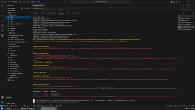

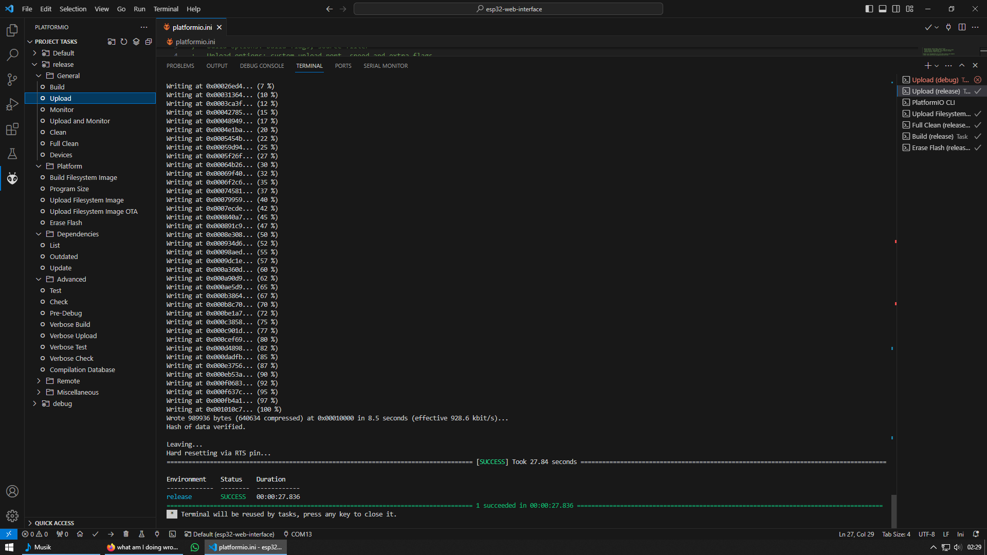

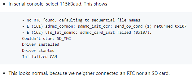

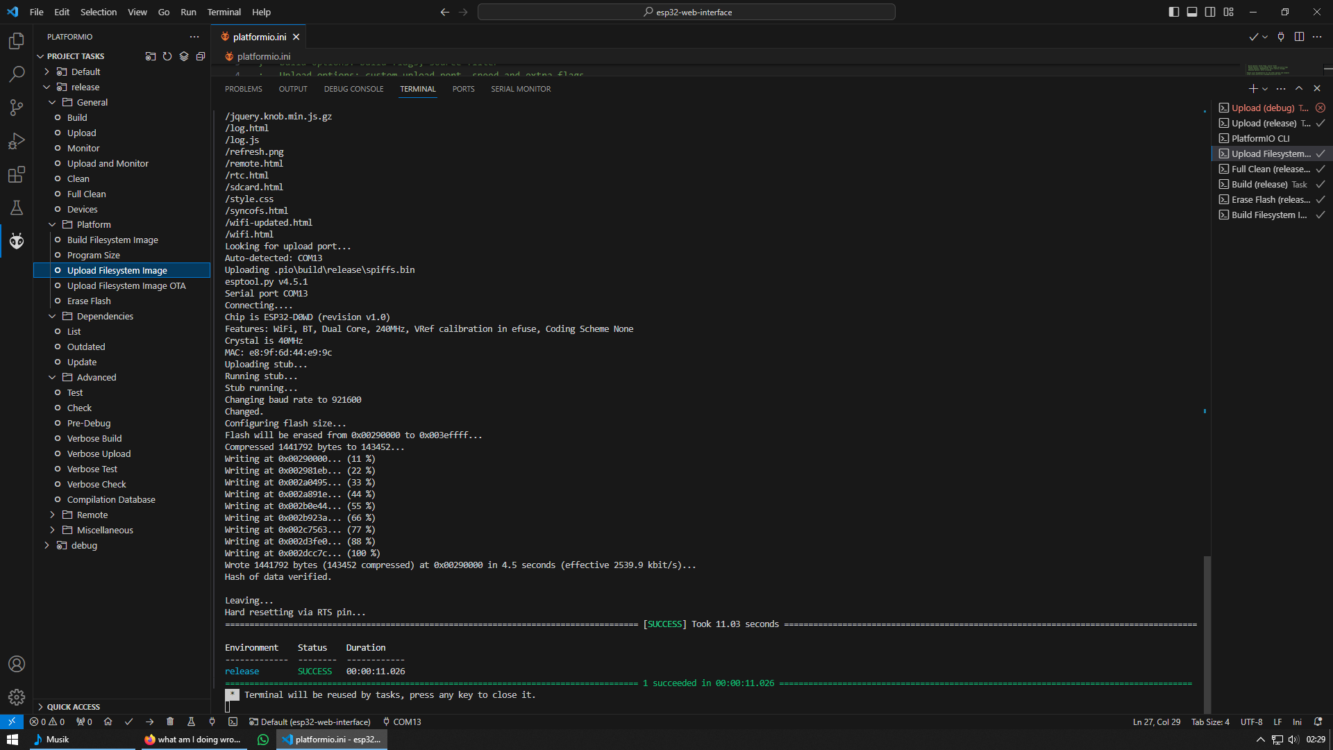

This is the part of the console output which shows the download of the software. This looks good, but more interesting would be to see what comes afterwards. In https://github.com/jsphuebner/esp32-web ... n_notes.md I noted

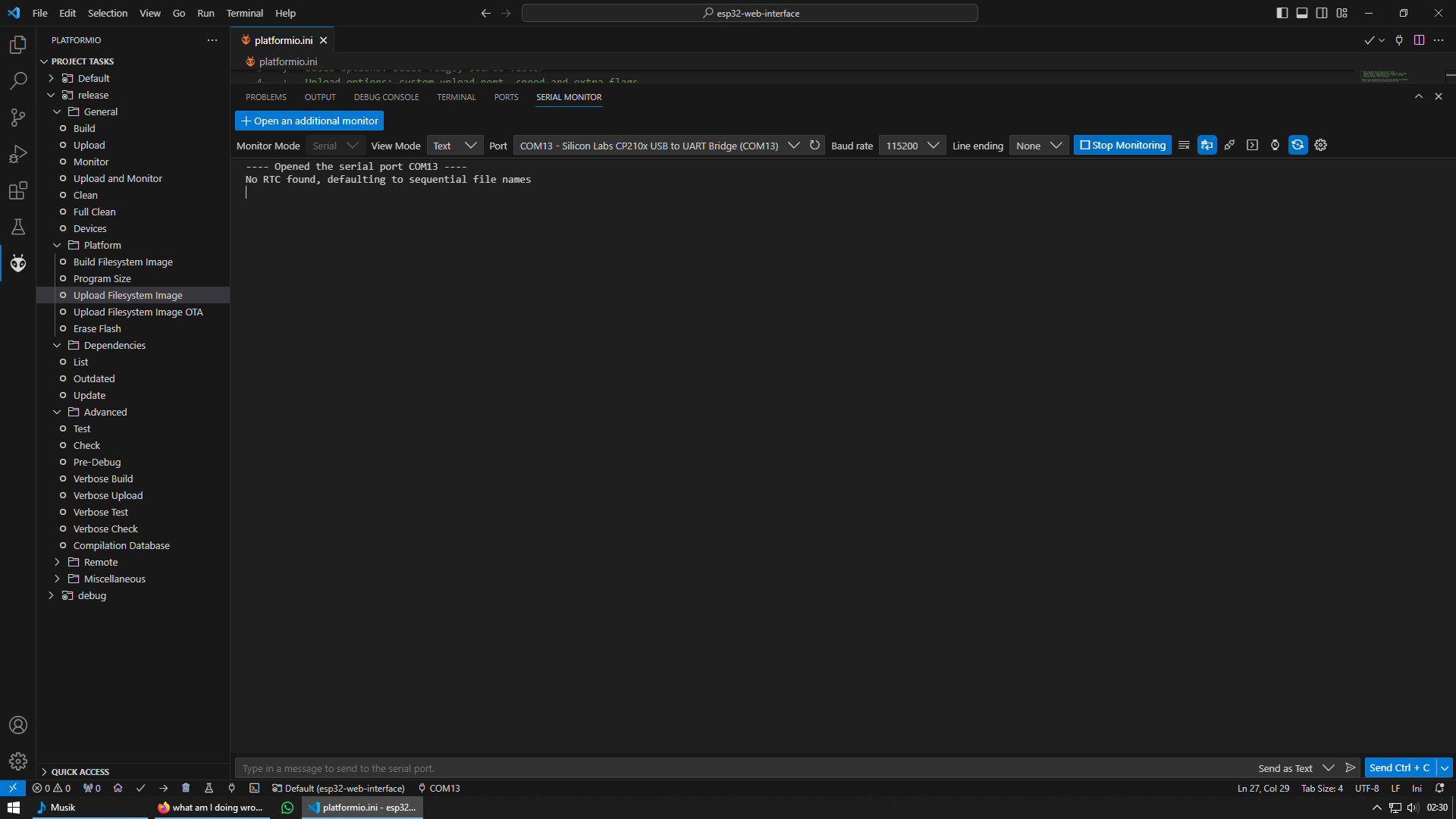

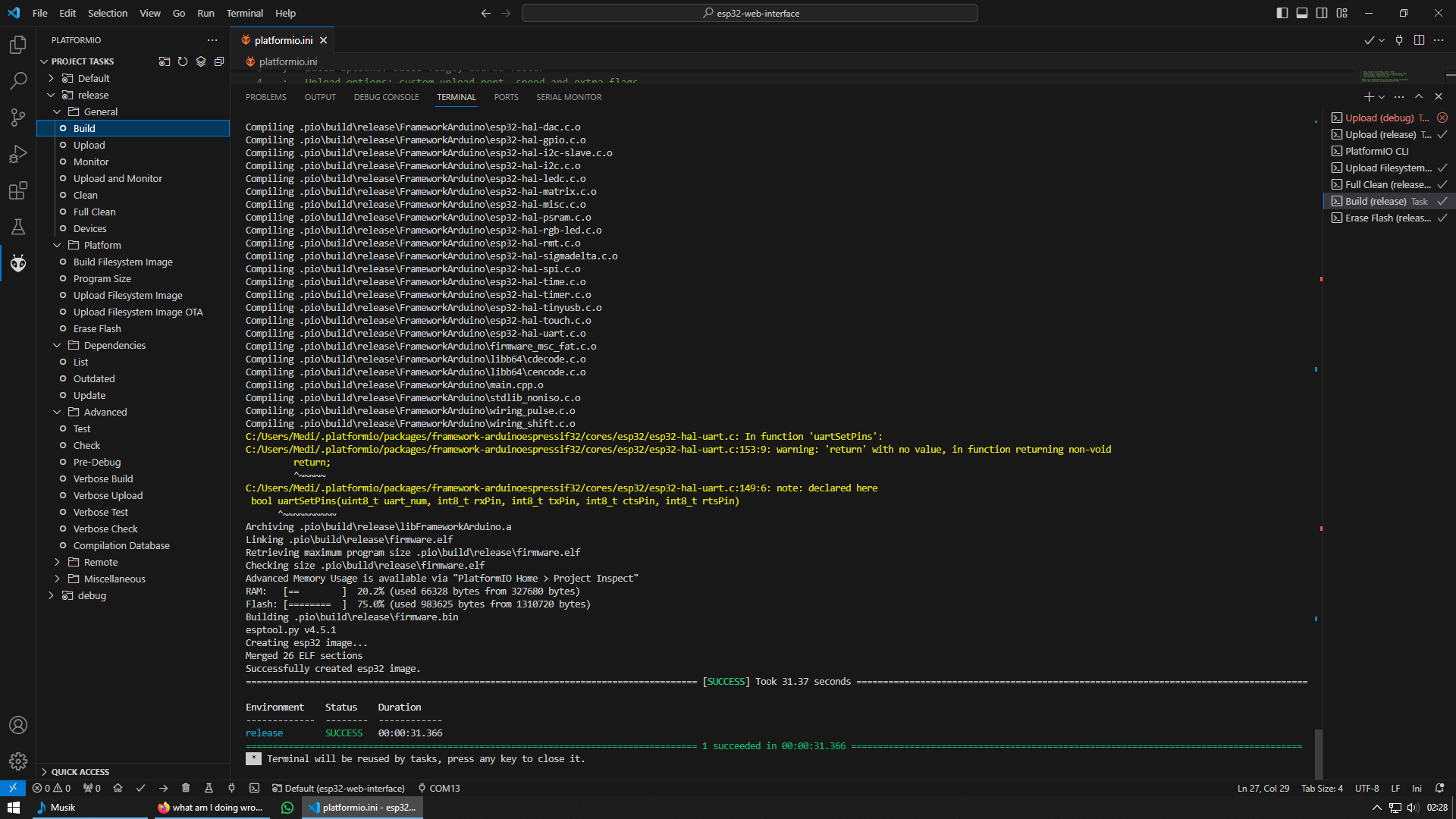

if i make e full clean and erase flash, and then i make a build, then it looks like this
If I build again, it will look like this
then the upload works

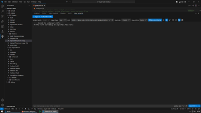

then upload the filesystem on the Serialmonitor looks like this but still no wifi

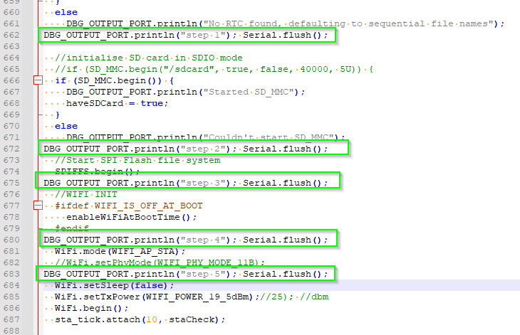

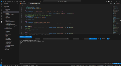

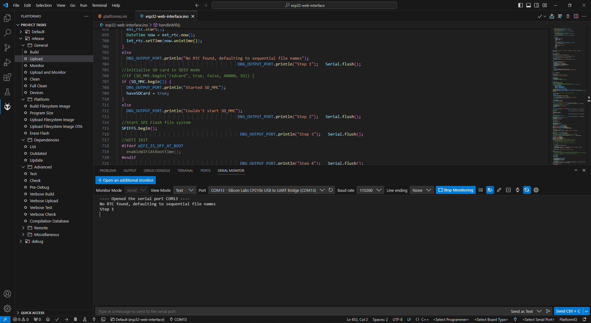

Strange. You could add some further instrumentation in the code, to find out where it stops. Go to the setup() function, and find the DBG_OUTPUT_PORT.println("No RTC found, defaulting to sequential file names");
This still works, we see the output in the console.
Add below this further lines like
DBG_OUTPUT_PORT.println("step 1"); Serial.flush();
The Serial.flush makes sure that the serial data is really transmitted, before the next step is done. Example:

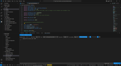

It looks like sd_mmc is causing problems
I've now commented out that part, but it just doesn't continue
Nobody needs this, just delete the SD card things completely
Maybe the SD card driver is not happy with something. Just remove everything related to SD card from the code and try again.
I have removed everything related to SD card, now i have wifi and can open the web interface,
but now I don't have any values, probably deleted too much in the code, unfortunately I'm not familiar with it

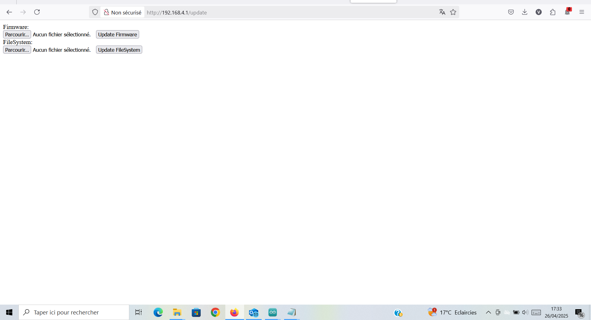

Sorry people. I gave up on my ESP8266 and went to a ESP32S3 pico. I have managed to upload the code from https://github.com/jsphuebner/esp32-web-interface.git
Using Arduino IDE, I uploaded it (with and without removing all SD card functions).
I can connect to the ESP board, but no parameters come up.
I have tried connecting it to my Prius Gen2 Boards, but it's identicle.
I have searched all over the place, but cannot get any further.
Thanks in advance for pointers.

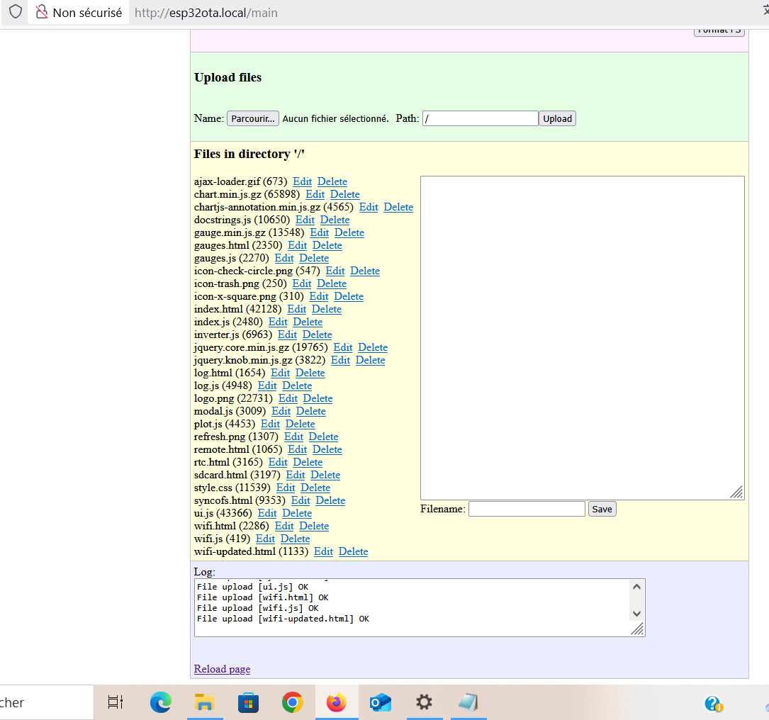

Flash file system!

Thanks Johu.
1. went to https://github.com/jsphuebner/esp32-web ... n_notes.md
2. I went to https://github.com/palmerr23/ESP32-OTA-and-File-Manager
3. I downloaded the Code in Zip format
4. Unzip and created new folder ESP32_OTA_FILESYS
5. I openned the ESP32_OTA_FILESYS.ino in Arduino
6. Following your instructions, I made sure I had exactly the same settings as you noted.
7. Verify in Arduino that the sketch is OK
8. Put wifi credentials in the code where I have put ****
//#define MYWIFI // allow credentials to be stored in a file
#ifdef MYWIFI
#include "mywifi.h"
#else
const char* ssid = "******";
const char* password = "******";
#endif
IS THIS CORRECT??????

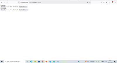

9. On esp32S3 - Press and hold the BOOT button down. Press ONCE the RESET button. Release BOOT button
10. Upload Sketch in Arduino
11. Diconnect ESP32 and reconnect (to enter Normal mode)
12. I now see the ESP and can connect to it, but the ESP doesn't connect to my wifi (which is 2.4 Ghz)
13. I then went to http://esp32ota.local/ and followed instructions to format FS - That worked as per instructions.
I4. Went back to .\esp32-webinterface\esp32-web-interface\data and downloaded ALL 30 files via the OTA
15. Went Back to Arduino & Uploaded the ESP32-without-SD_card-functions.txt ( which is esp32-web-interface-uart-backend MODIFIED)
16.I found the ESP again over WiFi and connected to it - The User Interface comes up, but no Spot Values ( that's OK because I haven't connected to my Adapter Board yet)
17. I try to put in my WiFi credentials ( it knows the SSID), but the Password is Blank. I put in my Password and ENTER
I go back to Main Page - Still no Spot Values
18. I notice NO Firmware is uploaded at the Bottom of Main Page, so I followed instructions "A shorter way to change files is, to use in http://inverter.local/ the "Files" tab in the left menu".
I see the ESP32_sine file in the FILES section of the Interface, but on Main Page it still doesn't show firmware version....
19. I attempt to Update the Firmware from the Main Page Menu - It says the Upload is Complete - with the Orange Bar, but it never changes status.
I tried by carrying out the "ESP32 BOOT & RESET" and then not- no difference.
20. I connected the ESP32 to my Adapter board , swapping the TX/RX each time, but no difference.
NOTE: There is a permanent message "Communication problem between ESP & STM"
I feel like Iam missing a fundamental element....and hope to use this post in the future to document the process in the Wiki...so any pointers are appreciated.
