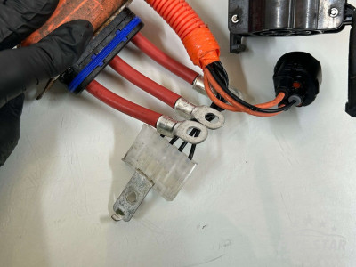

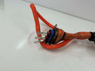

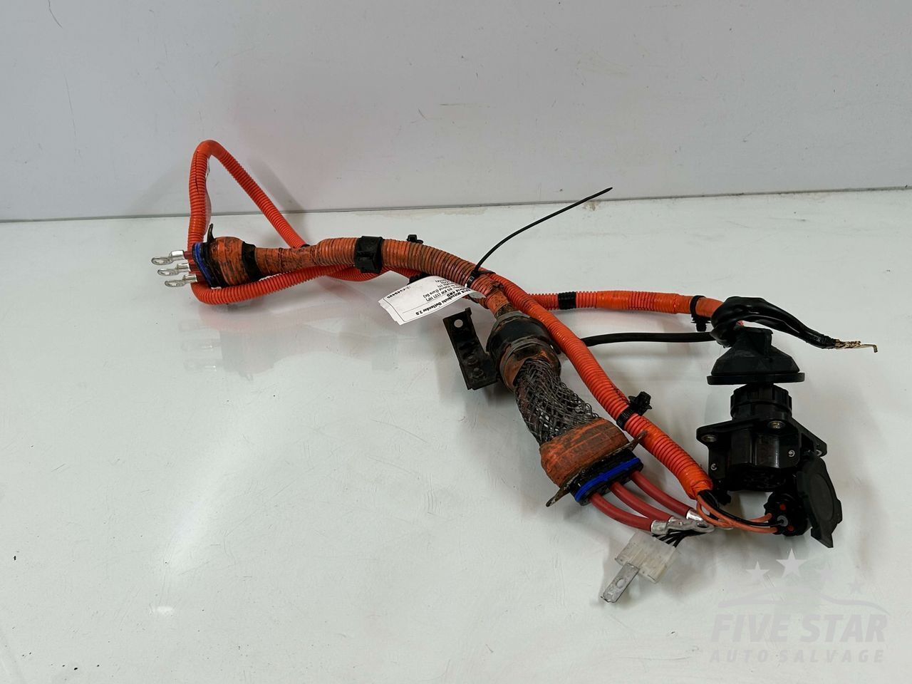

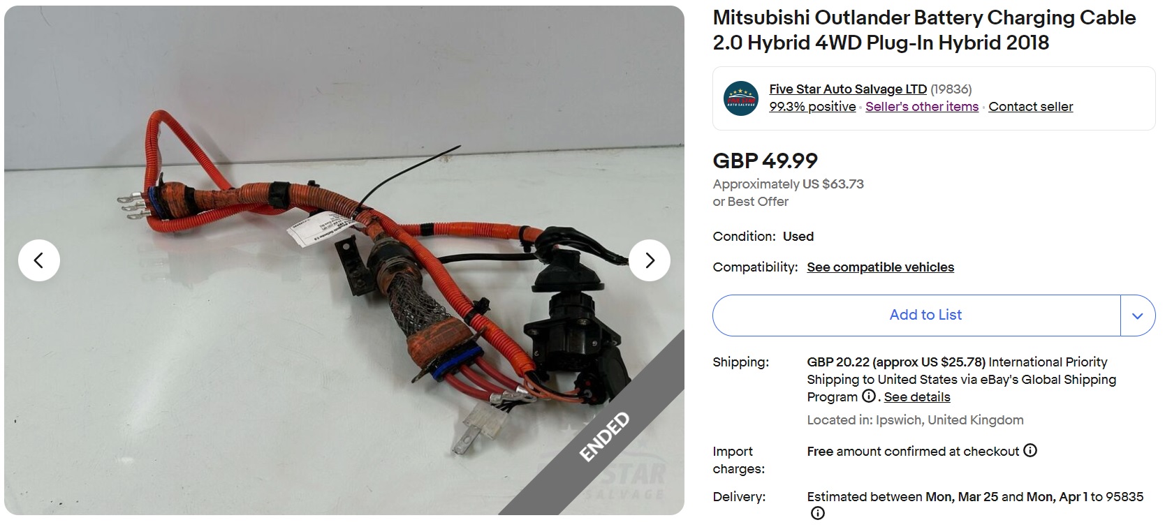

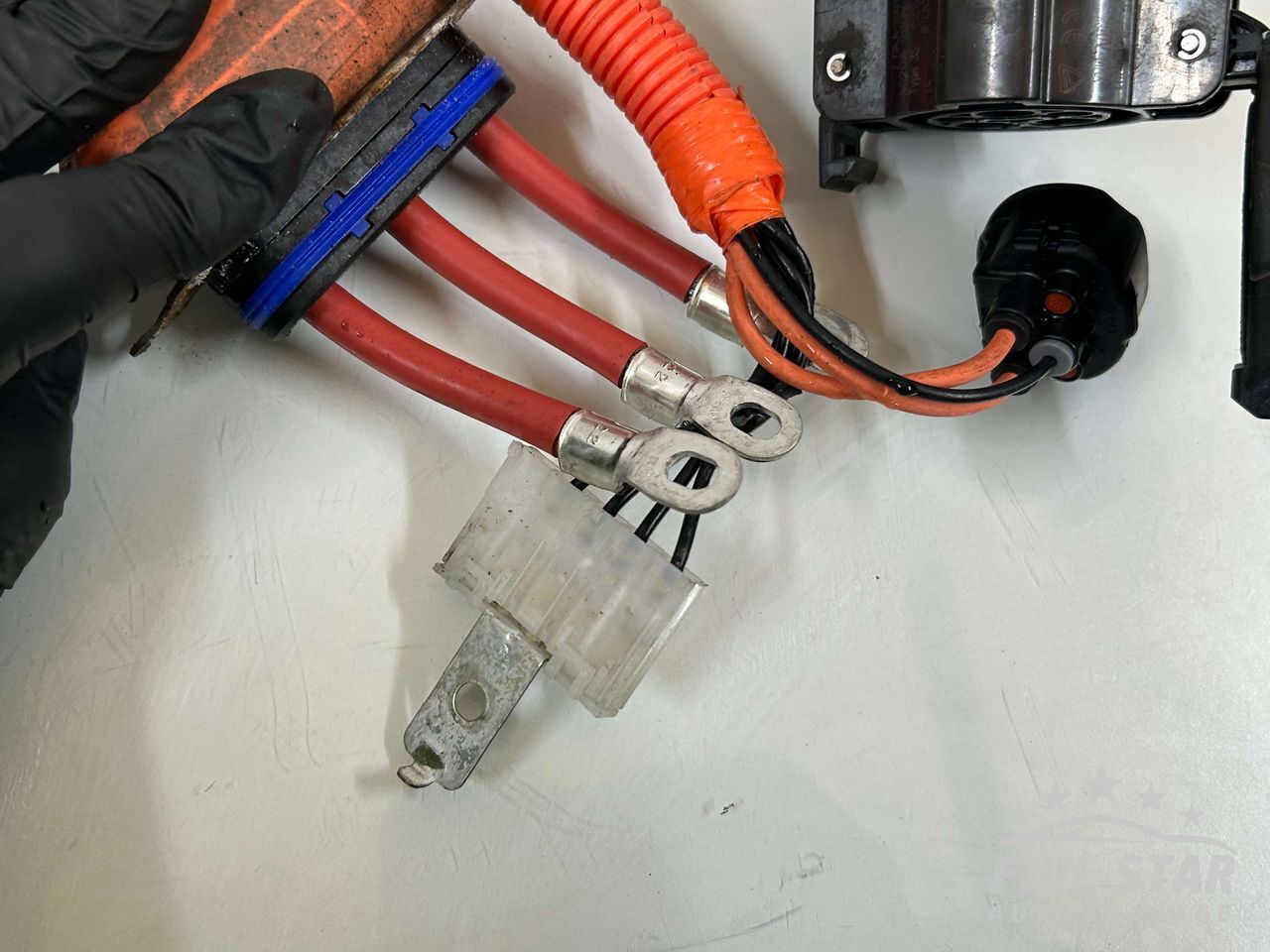

I also bought the Mitsubishi Outlander Battery Charging Cable part number 9482 A150
and no that's not what I paid for it, and yes, eBay is loosing it's mind and getting worse every upgrade

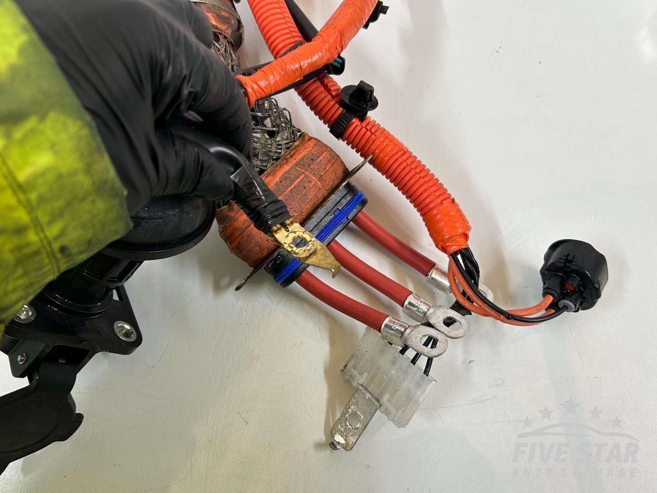

Gentlemen I could really appreciate your help in identifying the mystery 3 prong "extra" cable in this Medusa like listing

That's the rear inverter to motor cable.
That price is very cheap for both cables. Was this listing for just one of the cables and did you get the right one?

Now you are truly on the path to put in Outlander motor and inverter :).

arber333 wrote: Fri Mar 15, 2024 7:43 pm Now you are truly on the path to put in Outlander motor and inverter :).
shhhh don't tell anyone but I am leaning that way for Conversion #3

royhen99 wrote: Fri Mar 15, 2024 4:42 pm That's the rear inverter to motor cable.
I should get it today, it appears after it left UK it decided to tour California. I seem to live between a major receiving center and the post office distribution center on the other side of town, so they literally drive within 1 mile of my house from one place to the other in the morning, only to turn around and deliver it to my house later that evening

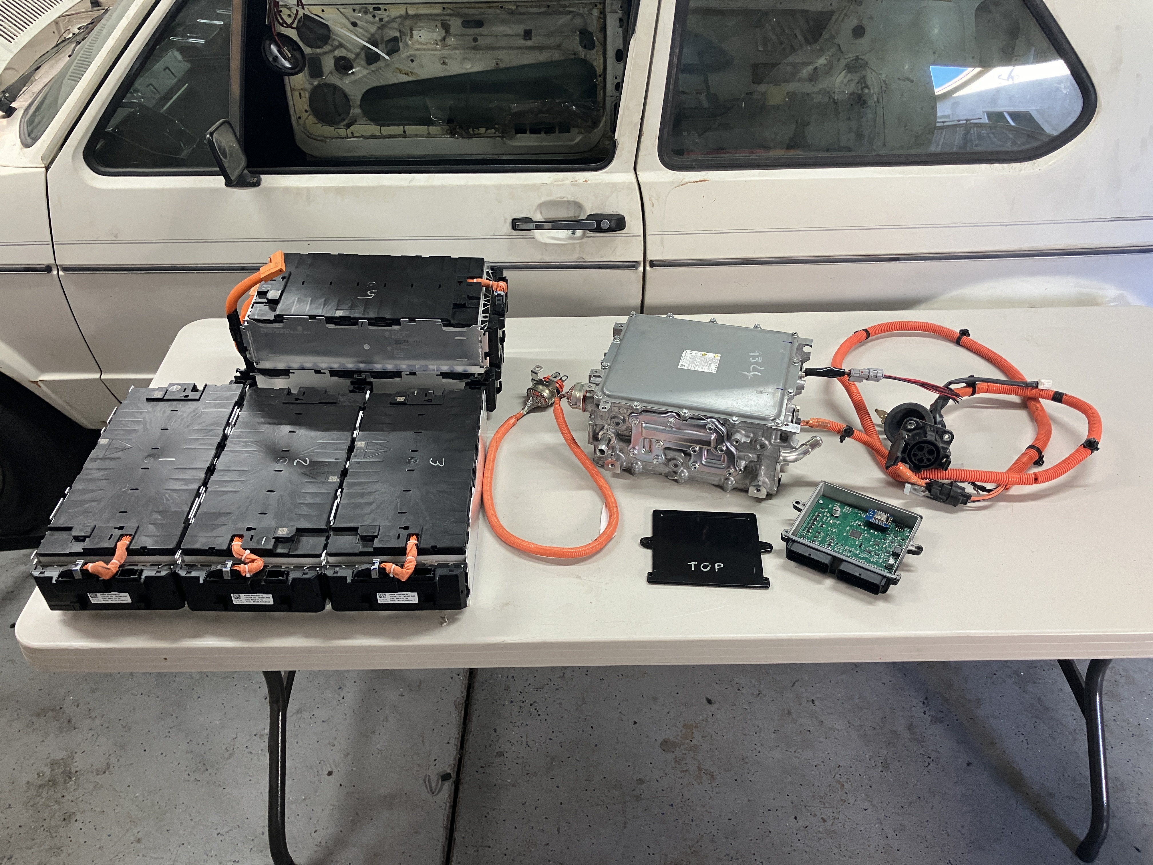

Mitsubishi Outlander Charger Cables

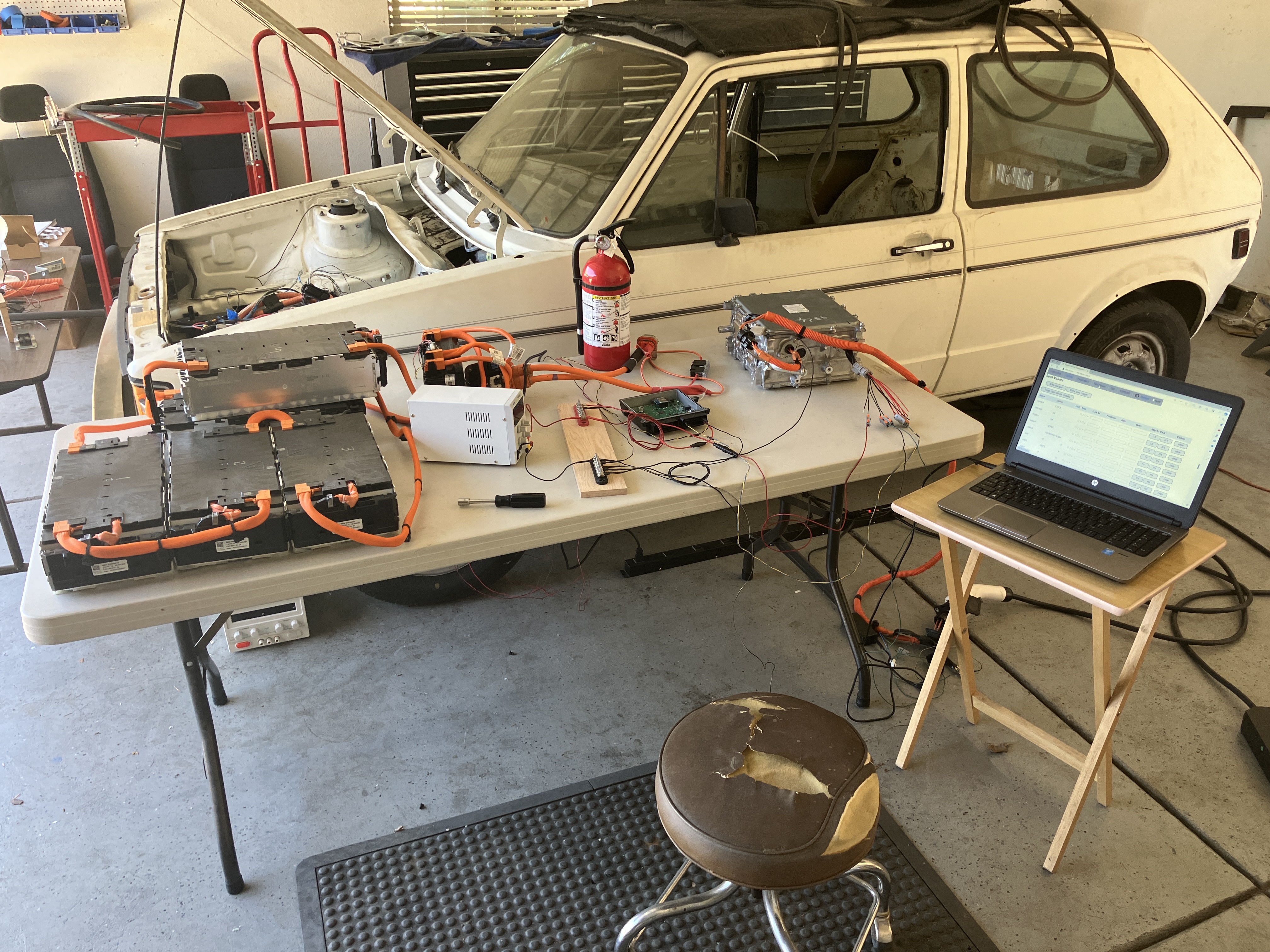

Time to see if I can get charging working on the work bench

all set up for charging, fingers crossed
Mitsubishi Outlander Charger ZombieVerter VCU Working

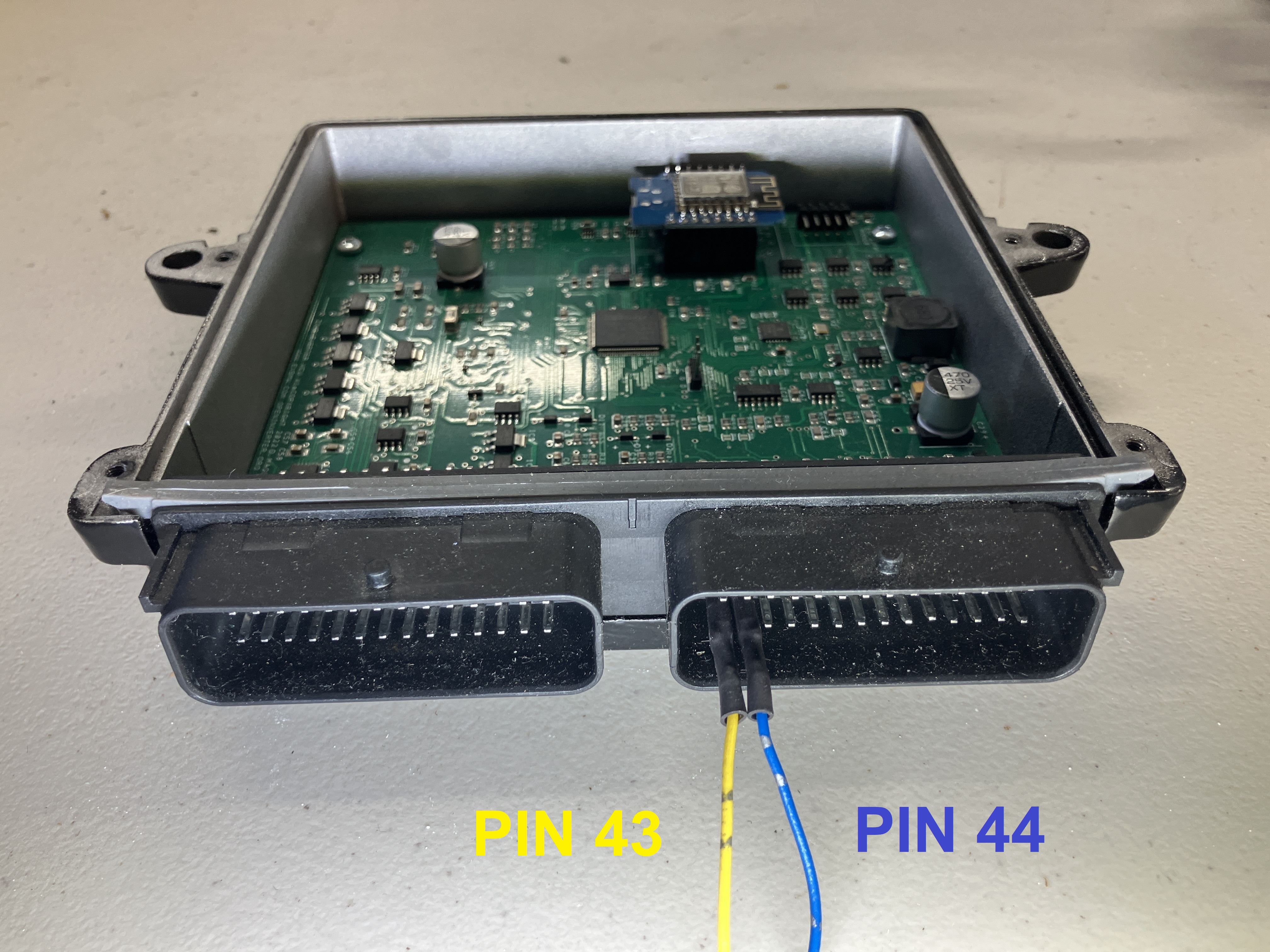

looking good, so does the Zombie control the charge control then ?

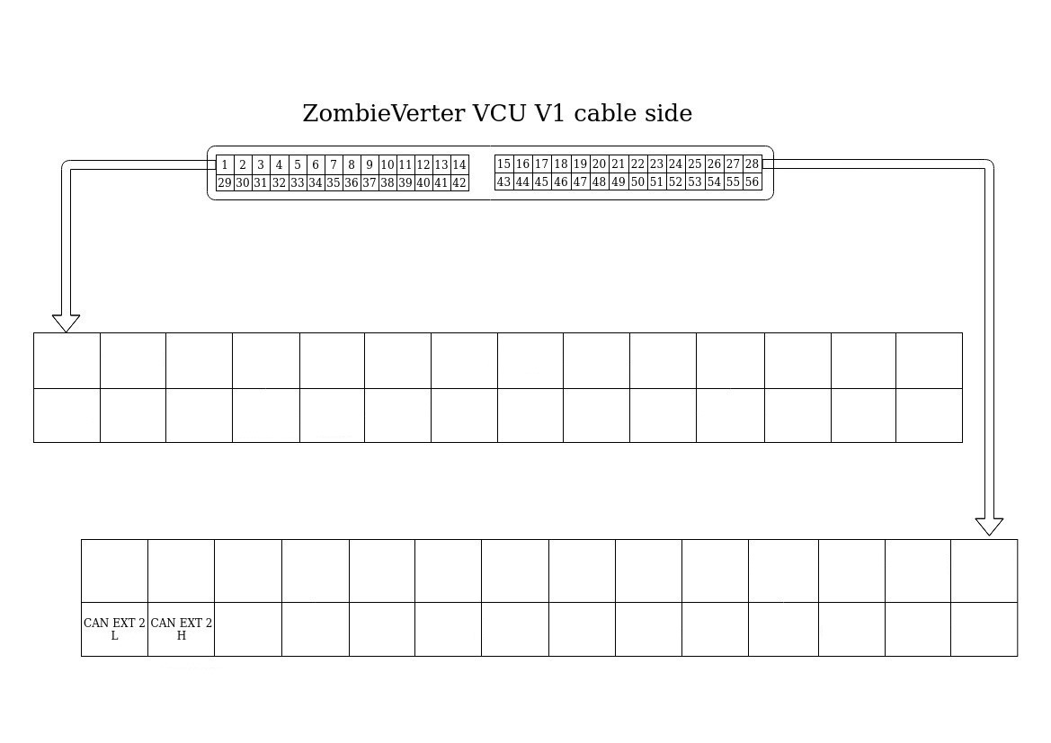

the ZombieVerter VCU controls (talks to) the Mitsubishi Outlander on CAN Bus 2 so it uses these two pins on the connector

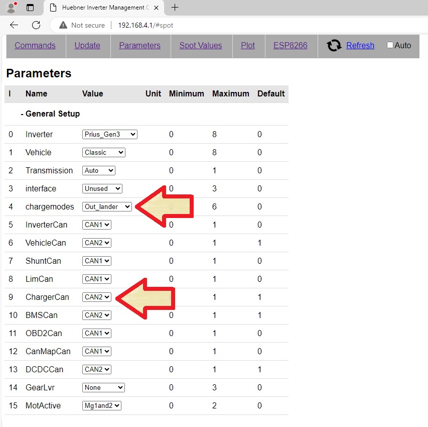

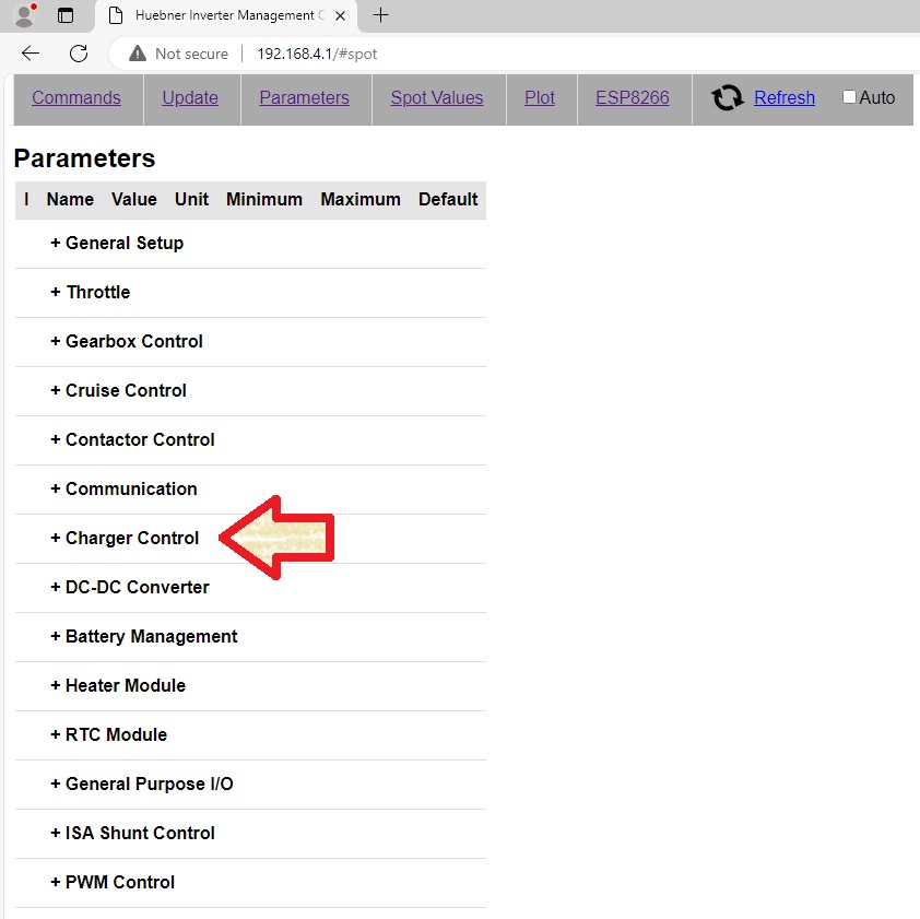

let's take a look at the ZombieVerter VCU software, and the settings we need to configure for the Outlander Charger
we start under Parameters (pronounced: "Settings") under the General Setup section
first we need to select Out_lander using the pulldown menu next to the chargemodes parameter
chargemodes: Out_lander
next we just need to verify (no need changing anything) that the ChargerCan pulldown menu is on it's default setting of CAN2
ChargerCan: CAN2

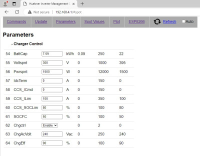

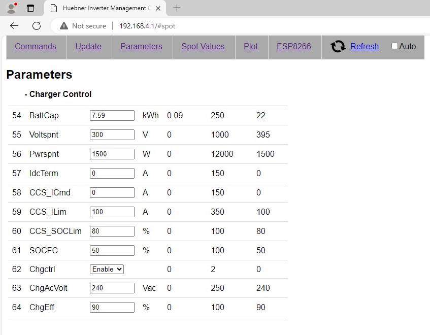

then we move on to the Charger Control section
so let's go over these one by one
