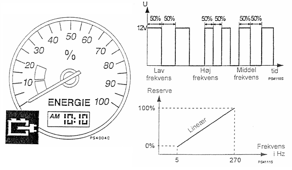

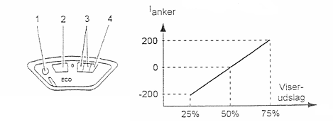

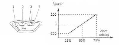

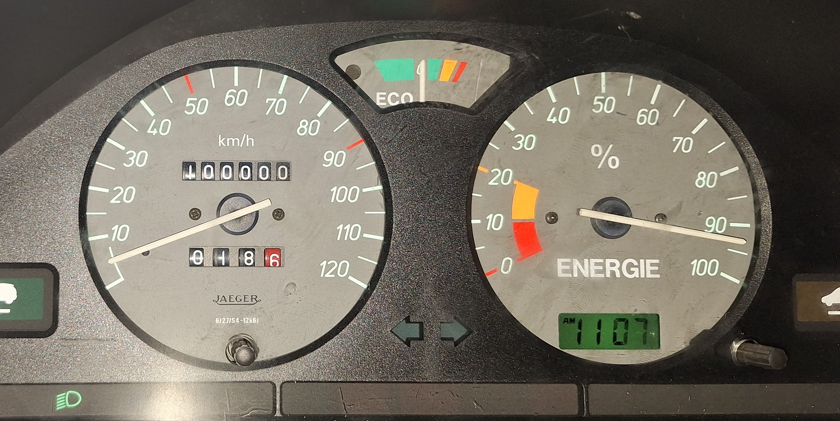

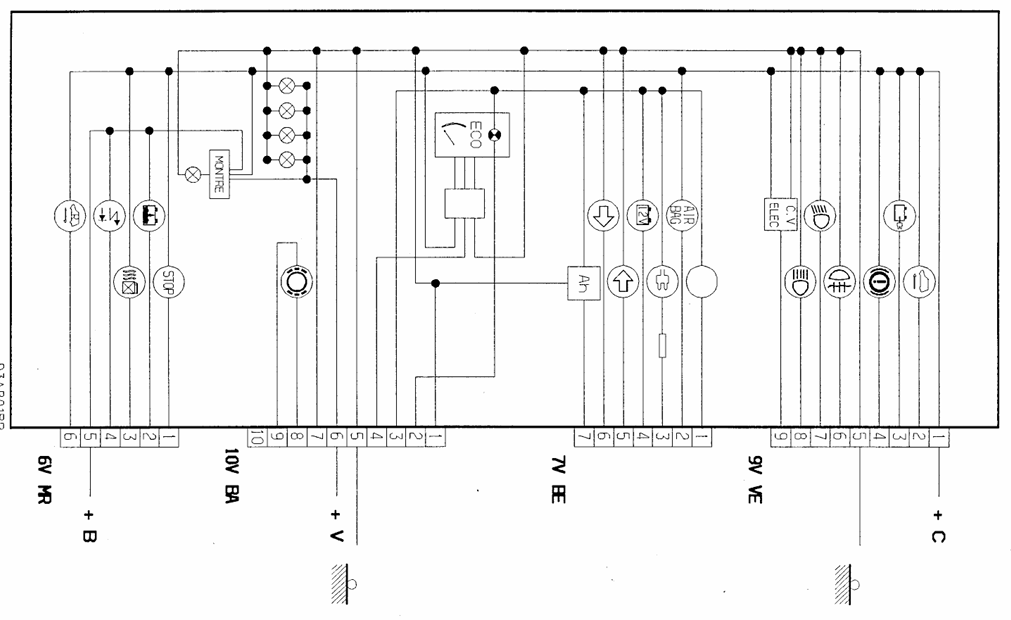

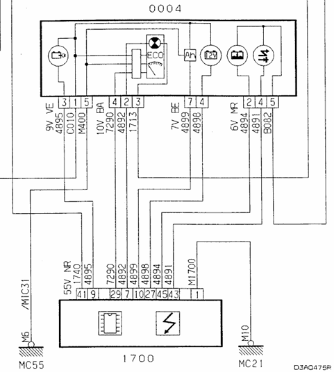

Zombie is running the speedometer, but the cluster also has a Energiemeter (SOC) and a Econometer(power).
The board that I made to be the BMS controller. That whas back in october 2023 :o
It has 3 outputs for contractors that I am not using. So I will use them to control the cluster.
the Econo meter is simply a PWM signal @122hz this matches well with the arduino. (16Mhz / 256 div / 256 pwm bits = 244 hz)
244 is double the frequency, When using centeralinged PWM the frequency halves.

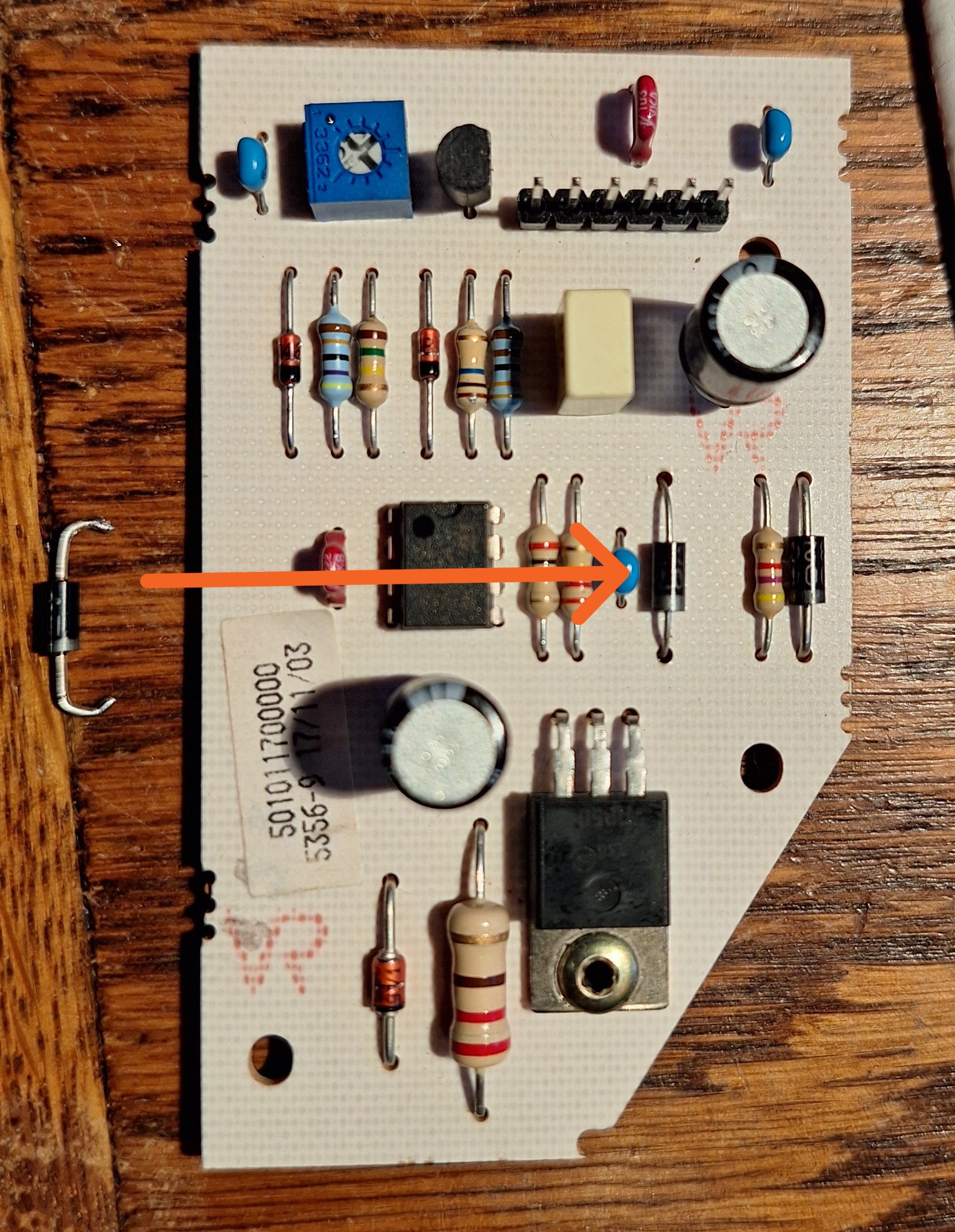

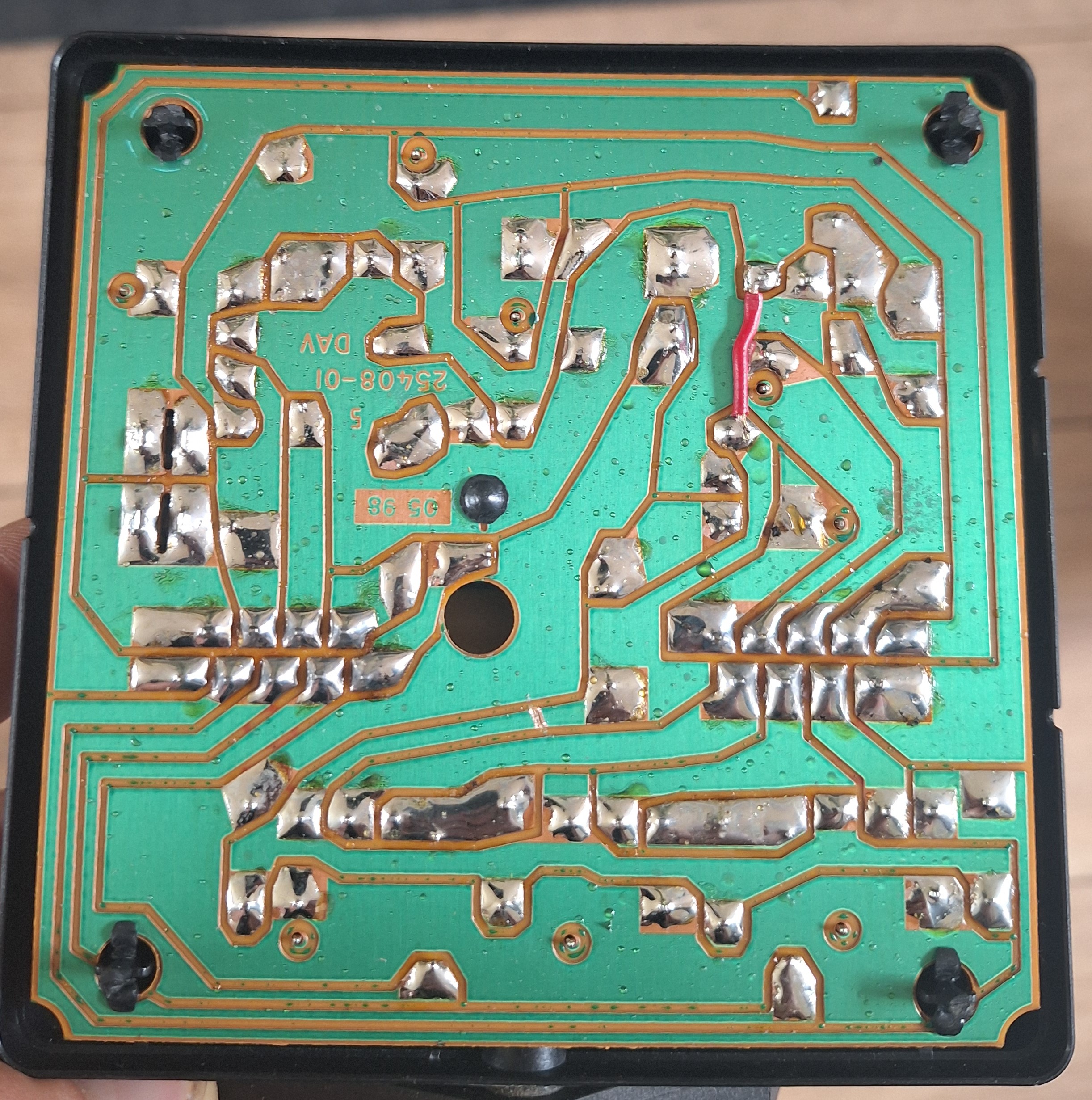

During the testing and calibrating of the gauge it stopped working completely. Checked the BMS PCB, checked the wiring all seems fine.
As a last option took the dashboard appard to get the cluster out. And disassemble it to get the PCB out that controls the Econometer.
The reverse polarity diode dropped 12V instead of 0,6V. So replaced it, put the hole lot back together it worked again. This stupid diode caused at least 4 hour of troubleshooting. You just assume that it is the stuff you are adding that is broken somehow.

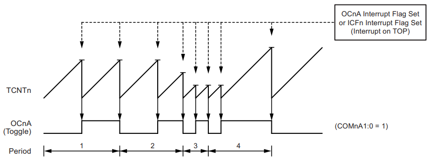

The Energie meter is a bit more annoying. Because it is a rev counter in disguise that why it needs a variable frequency signal. Using the 16bit timer on the Arduino this is not that bad. Using the CTC mode (Clear Timer on Compare Match) and the pin to toggle on compare match. it's easy to generate the necessary frequencies.
There was a little bug in the code that caused the meter to fall and then jump back to the right value. Reading through the datasheet I found the problem.
changing the TOP to a value close to BOTTOM when the counter is running with none
or a low prescaler value must be done with care since the CTC mode does not have the double buffering feature. If the new
value written to OCR1A or ICR1 is lower than the current value of TCNT1, the counter will miss the compare match. The
counter will then have to count to its maximum value (0xFFFF) and wrap around starting at 0x0000 before the compare
match can occur
Added a if to check if the TCNT1 is greater than OCR1A, and if so set TCNT1 to 0x0000. This fixed the problem.

After getting through the safety inspection. With one advisory, one of the rear wheels is almost at the minimum tread depth.
A have already driven 200 km. I love that my lite electric car is back on the road. I really missed it.
Had some issues with the code that I modified on the BMS.
The SOC meter was stuck at 41%.
I forgot to apply a scale factor to convert the 0 - 100% to the 5 - 270Hz.
after fixing tis the meter whas stuck at 100% better but not great.
made a mistake with the code that resets the SOC to 100% this was triggered constantly.

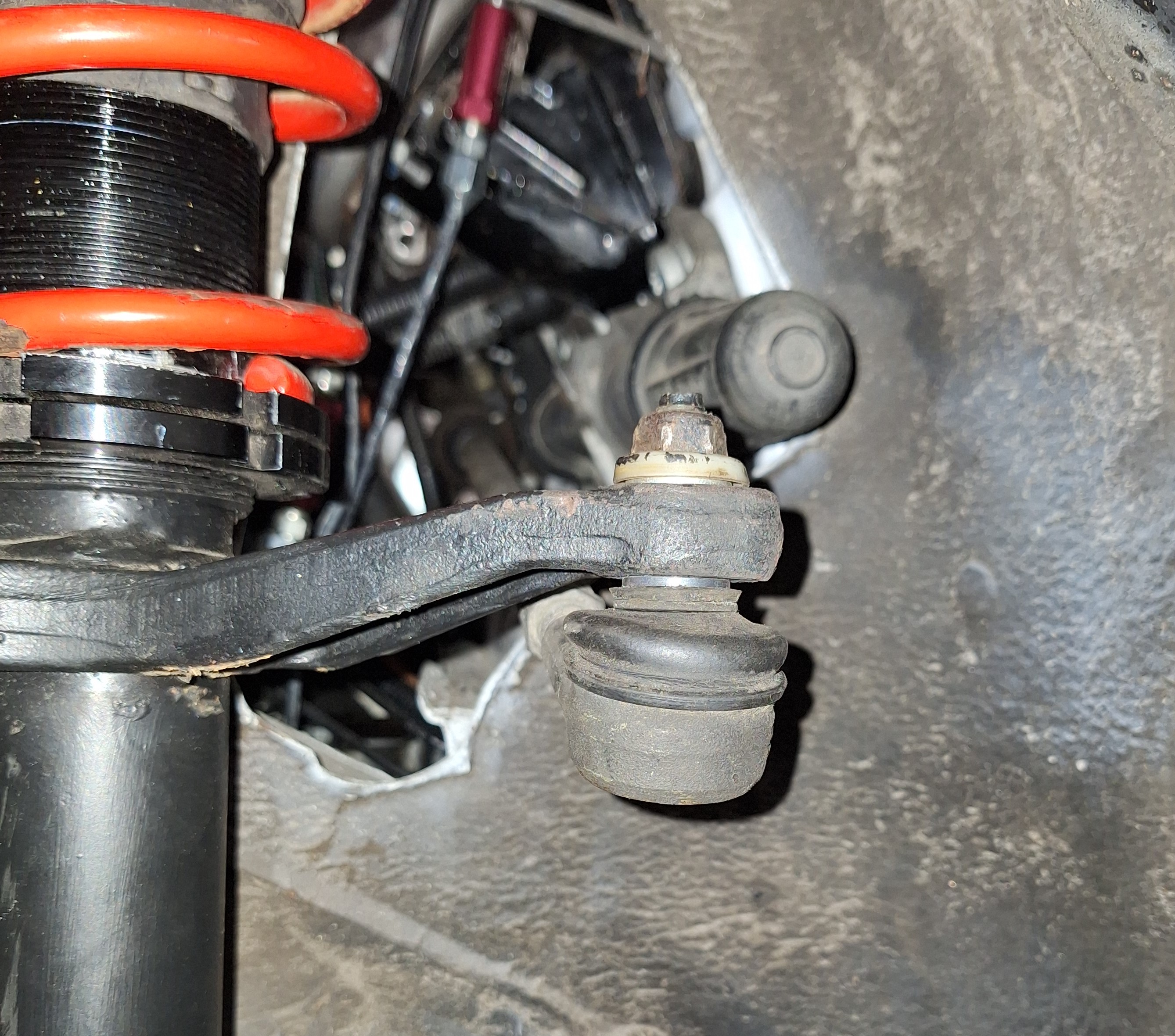

  • the steering arm is hitting the mount for the ibooster

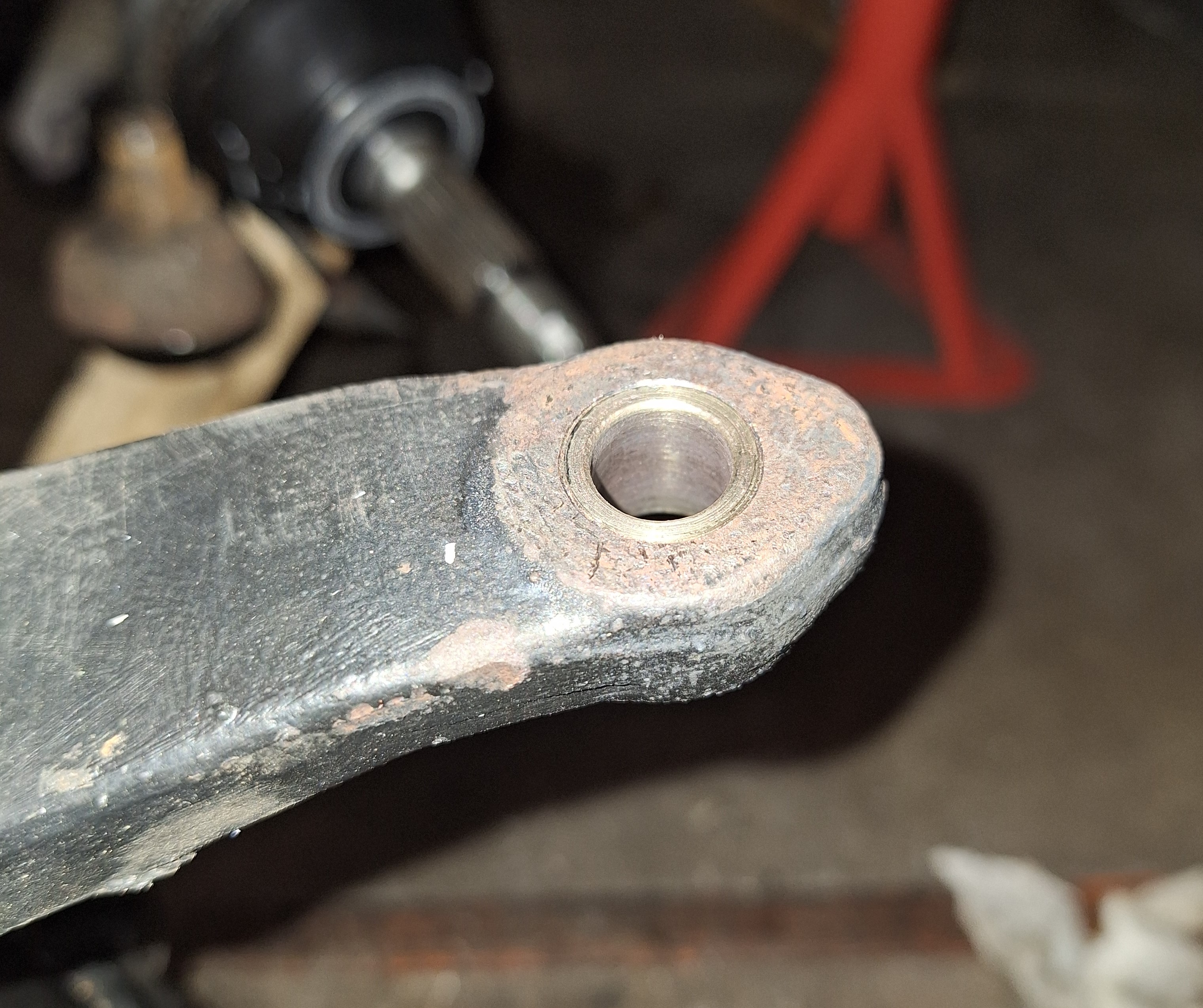

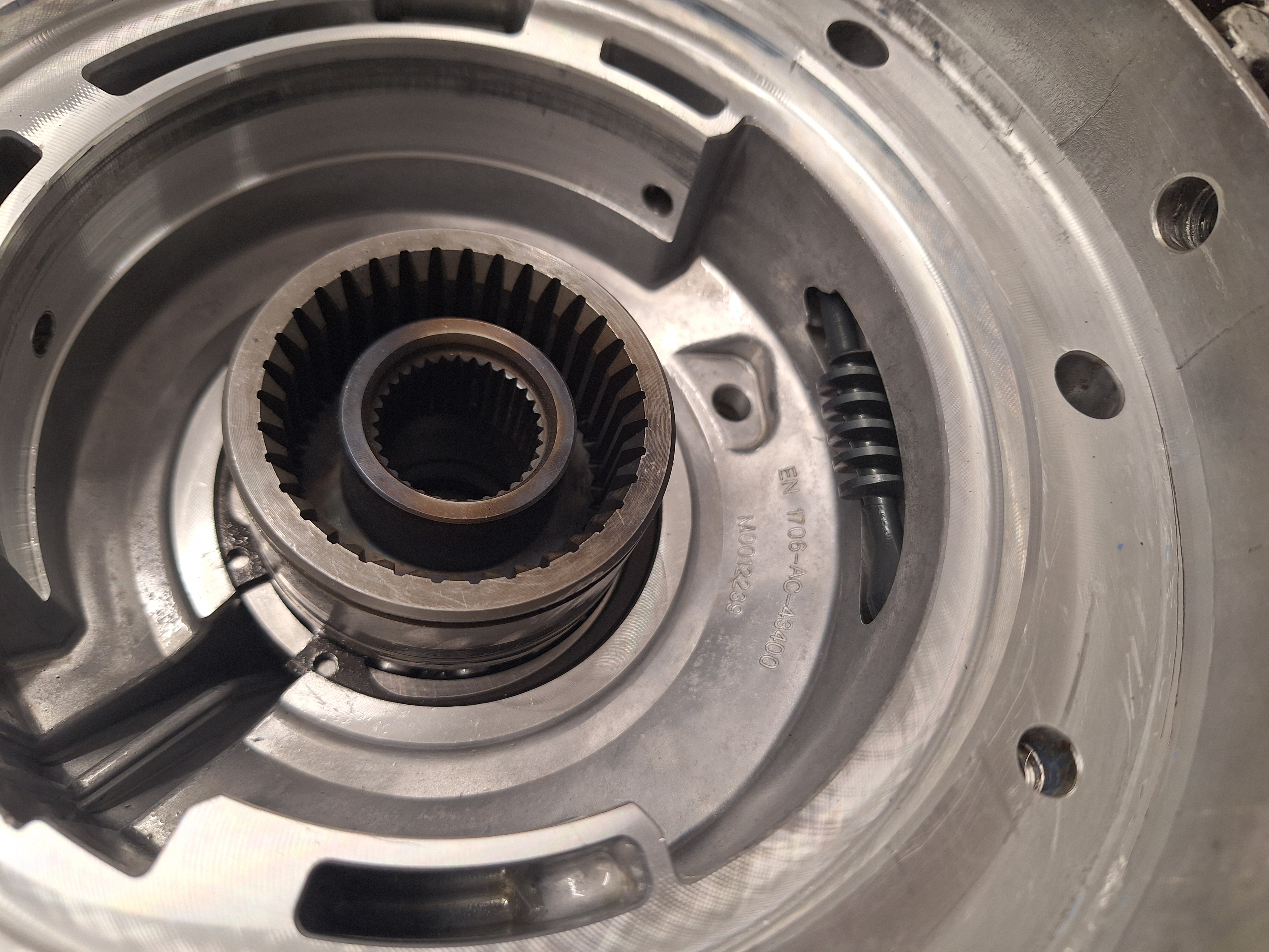

Fixed the steering arm hitting the mount for the ibooster. Made a bushing on the lathe with the taper on the inside for the tie rod and a flange on the outside. Drilled out the steering arm on the strut and pressed in the bushing to mount the tie rod end upside down.

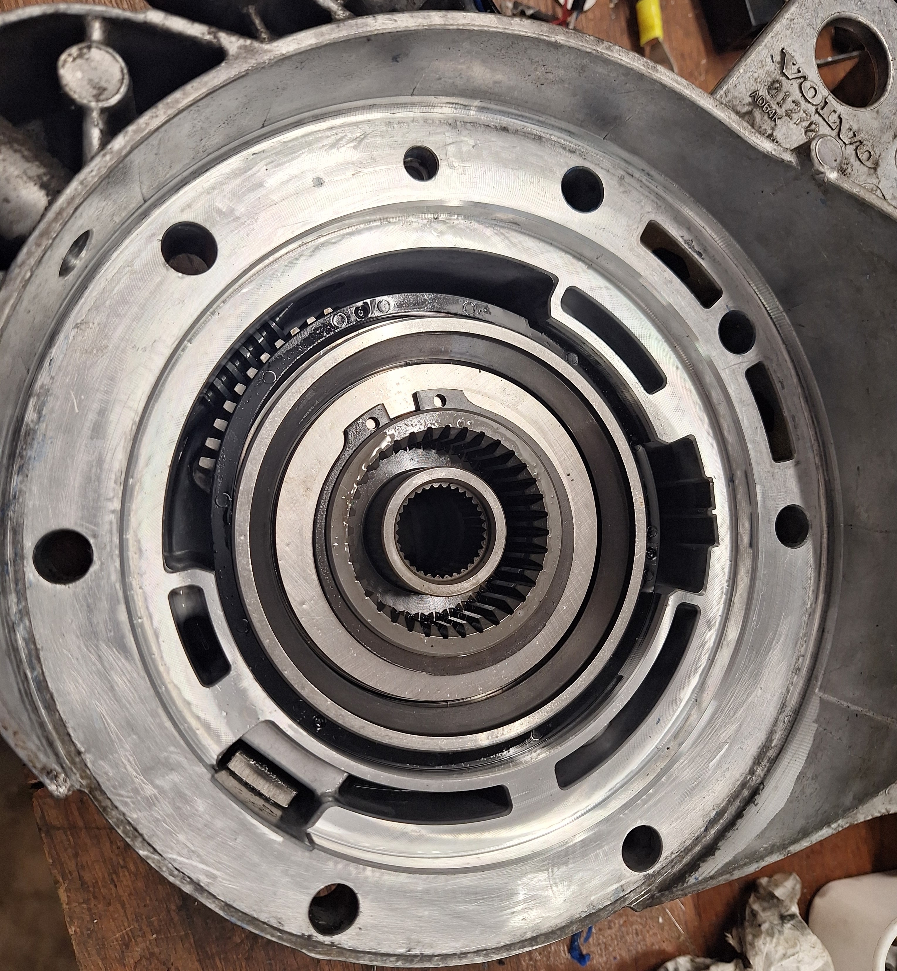

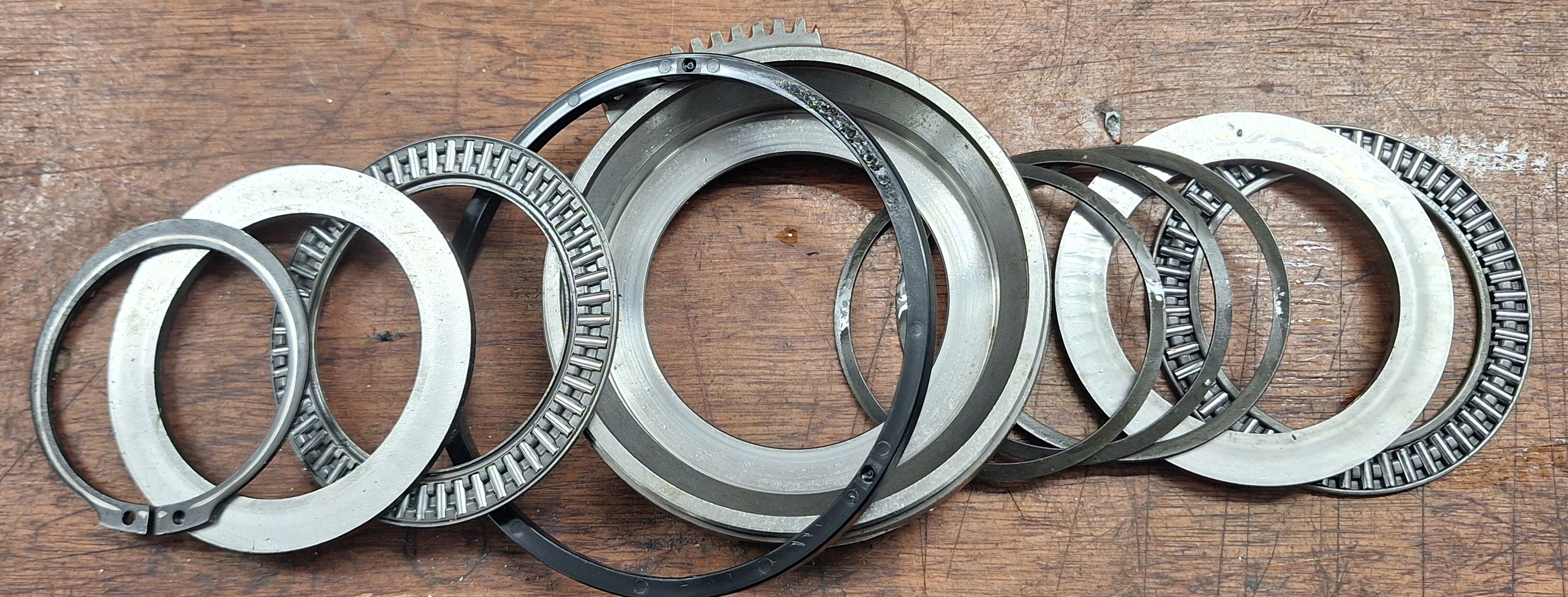

Took the motor apart to find the clonking sound. First looked at the clutch side. Had a hard time taken it apart, because I looked with my eyes closed 8-) You can just rotate it with the control screw to the end and take it out.
here are the parts in the clutch.
Because I destroyed the clutch mechanism when taken is apart wrong. I welded the clutch to eliminate the clutch system.
This did not fix the sound. Maybe there is a problem with the differential because is whas locked when I got the motor, because the driveshaft was pushed in to the motor and this pushed the bearing in to the differential locking it up.

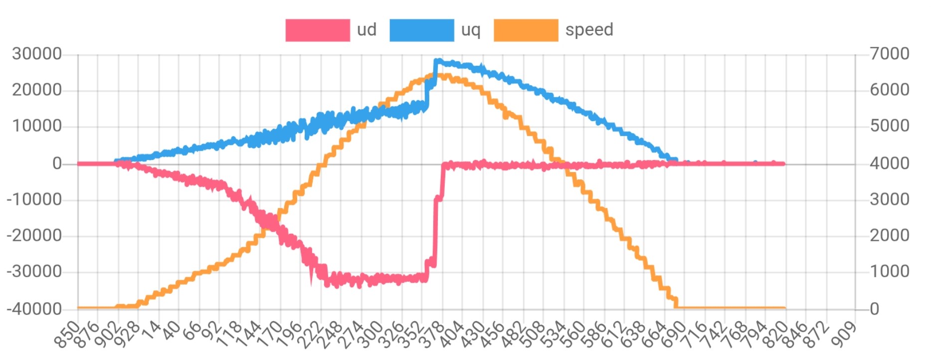

The top speed of the saxo is about 100 km/h at the moment. With field weakening disabled. I am hesitant to enable it.

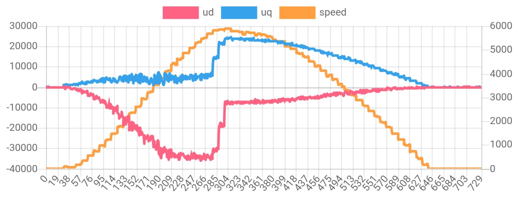

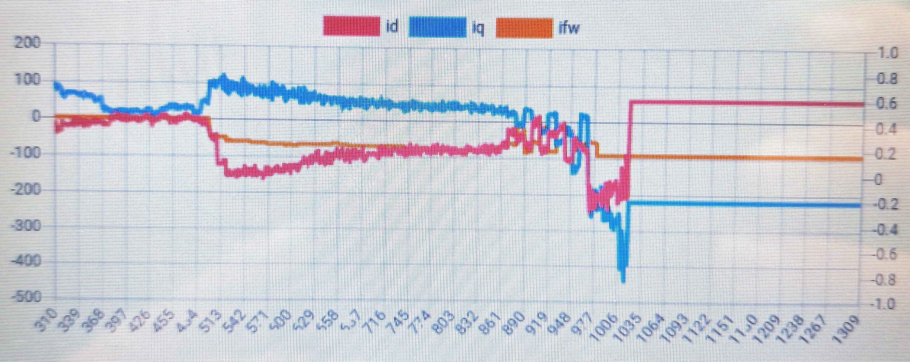

So I did a lot of testing and tuning the controller. Also got the Pete9008's IPMmotorcalc software up and running to check the motor params.
Not the same but close enough.
After reading through the "IPM Motor Simulation and FOC Software" thead I went out to check the syncadv
with syncadv at the default 10 this is the plot
After a couple of runs I got ud to zero at syncadv 17 (Seems high compared to what I have seen on the forum)
I am not sure if this is correct. Put syncadv to 12 and drove with that for a week. Seems better.
Got the car up to 100km/h seemed fine. On the return trip I added -100A field weakening. The acceleration to 100km/h seems better. But when going above 100km/h a bit and letting off the throttle the motor controller lost it's shit. First oscillations between acceleration and regen. After that hard regen until overcurrent error cut the pwm. This was scary.
(Sorry for the bad quality but this whas on the android head unit. I am not doing this again jus for a better picture.
I would like to get the car up to 130km/h if possible. Think this motor is a bit odd. Its a 5 pole with a 9.17 reduction so to go 130km/h it needs to spin at 12000rpm that 1000hz. Motor is spec'd to go 13000rpm.
I'd love some advise on how to proceed. Do i run with syncadv set at 17? Are there other thing to check/try

Been thanked: 1918 times
Re: [DRIVING] Citroen Saxo Electrique
You will want to install the latest git version for more stable fw.
On the other hand Pete predicted that the controller will loose it at very high frequencies. 1000 Hz hasn't been tried before :?
viewtopic.php?p=81555&hilit=Syncadv#p81555

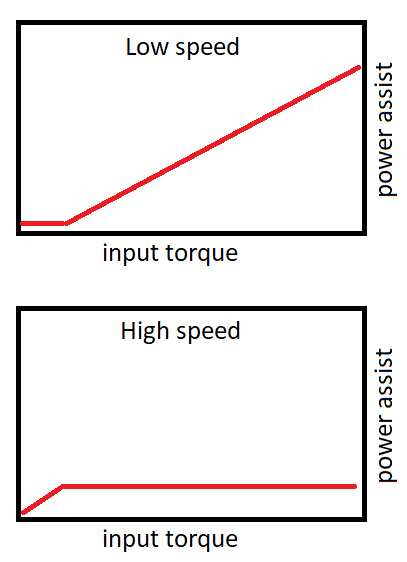

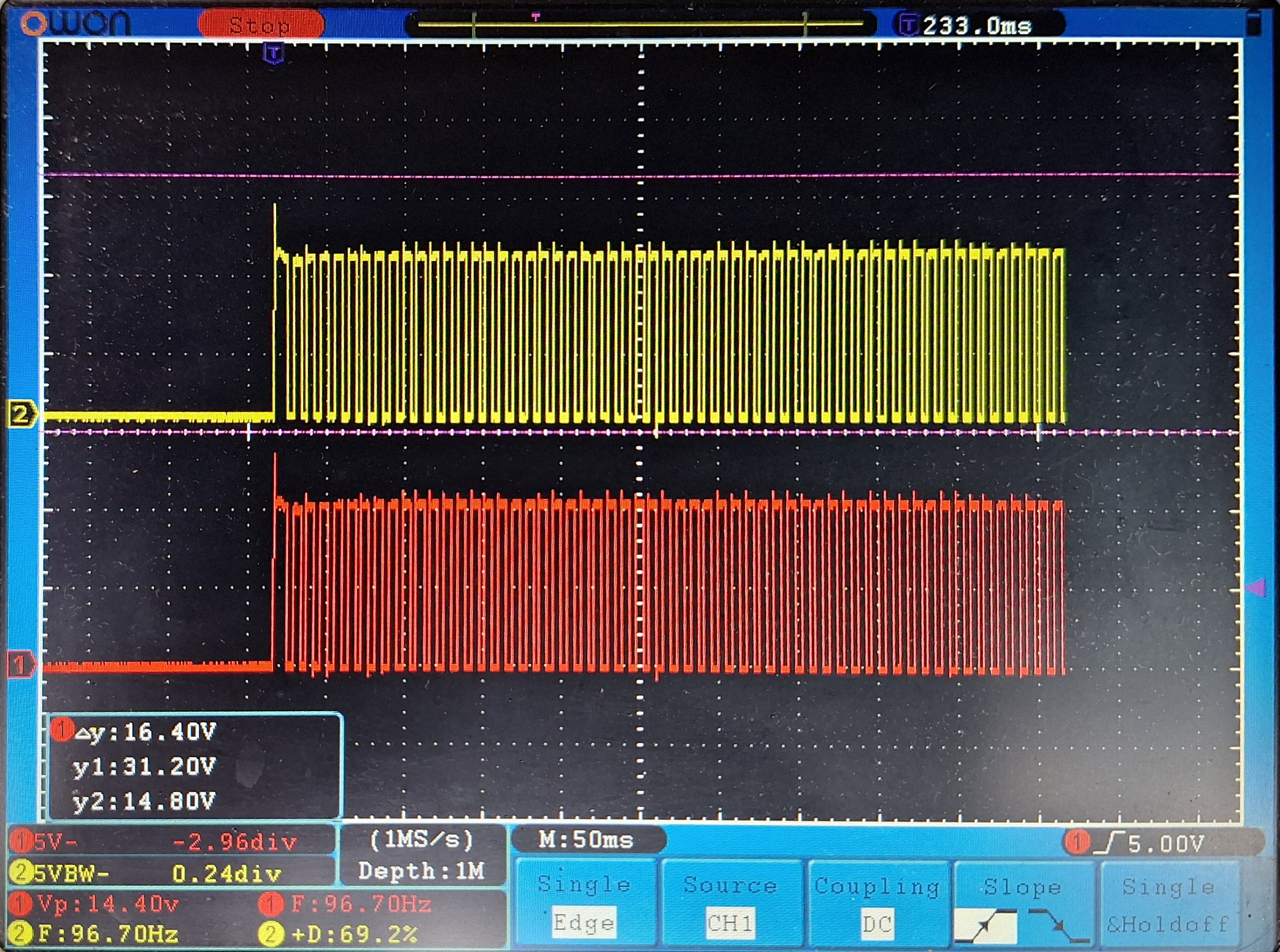

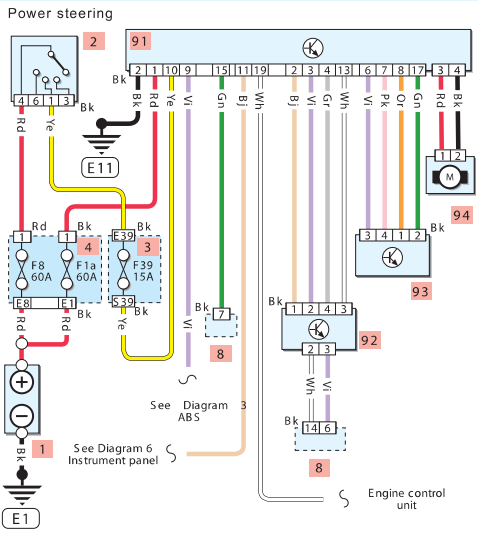

I have a electric power steering unit from a Renault Clio II in my Saxo. And using a control box from servtronic.
https://www.servtronic.com/products/ren ... epas-rally
It has a knob to set the amount of assist. It works well, nice light steering but at higher speed it hard to make small corrections.
First I assumed I did something wrong causing the stick slip effect feel.
For a test drive I turned the assist down, at low speed hard to turn, but at higher speed it was better.
It feels like this (Low and high speed setting on the control box):
Took the scope to the car to see the signals between the "magic box" and the EPS controller. There are 3 wires between them red, blue and black.
EPS connector.PNG (70.04 KiB) Viewed 3264 times

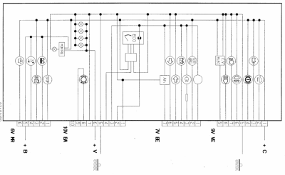

Wiring diagram that I found online:
Pin
9: Red (from ABS so probably speed)
10: Black (12V switched)
19: Blue (from ECU so probably RPM)
I think the "magic box" is just a 555 timer in a box. The knob varies the frequency between 22 Hz and 609 Hz. The frequentie was 206 Hz with the test drive.
So maybe I can connect the signal from Zombie that drives the speedometer to also drive the speed signal on the EPS controller and use the "magic box" to supply the engine RPM signal.
And YES speedo signal works fine. Light steering at low speed and easy fine control at high speed :D
Only thing needed was a short piece of wire and two solder connections.
really happy with this, feels much better.

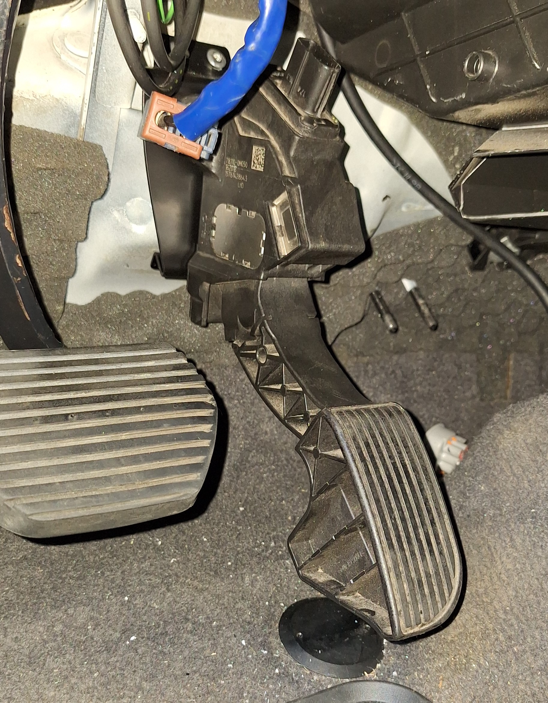

Had so weird pulsing feeling at low power and constant speed. A part of the problem has this viewtopic.php?t=6568
After some more troubleshooting I suspect the cheap TPS pot I used was faulty. I wanted to go to a Hall-effect throttle pedal anyway.

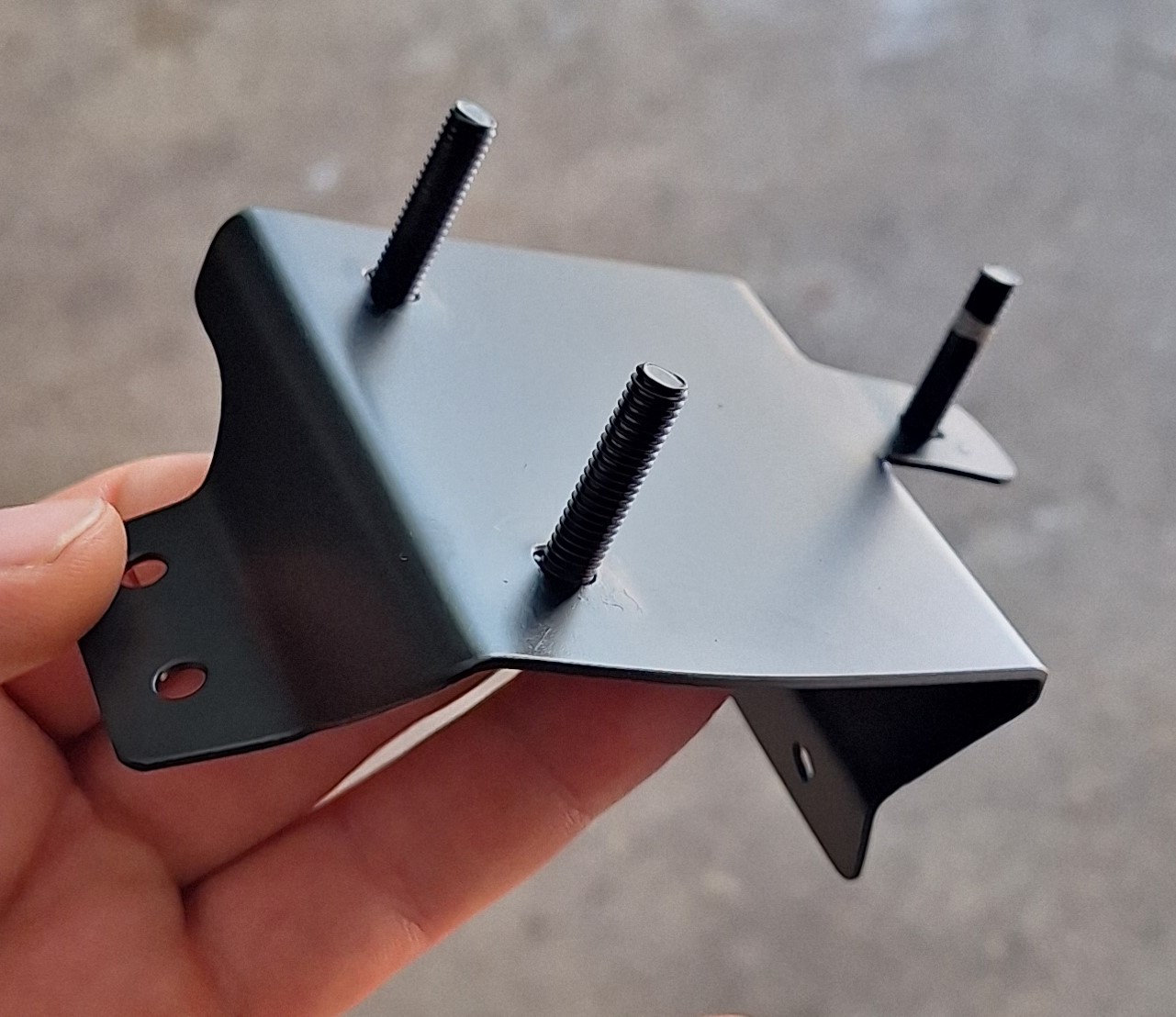

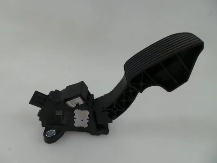

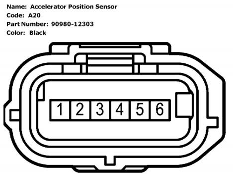

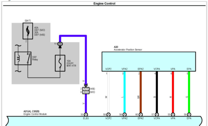

So it was time to replace the throttle, during the main part of the build I was looking at some different pedals.
The throttle pedal from a Citroen C1 seemed to be a good candidate (781100H050). It's a toyota part.
After some time googling I found a picture with the connector on so I could check the wire colors.
It the same as in this wiring diagram.
And the pin numbers of the connector.
  1. VCP2 (5V)
  2. EPA2 (GND)
  3. VPA2 (SIG2)
  4. VCP (5V)
  5. EPA (GND)
  6. VPA (SIG)
VPA goes from 0.799 to 3.739V
VPA2 goes from 1.594 to 4.545V
And of course it needs a bracket to mount it.
Mounted.
After this a quick update to the parameters on zombie and the OI inverter. And it works and fixed the problem.
After driving a couple of days I might remake the bracket to put the throttle a bit higher. For my big feet :)

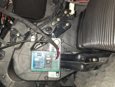

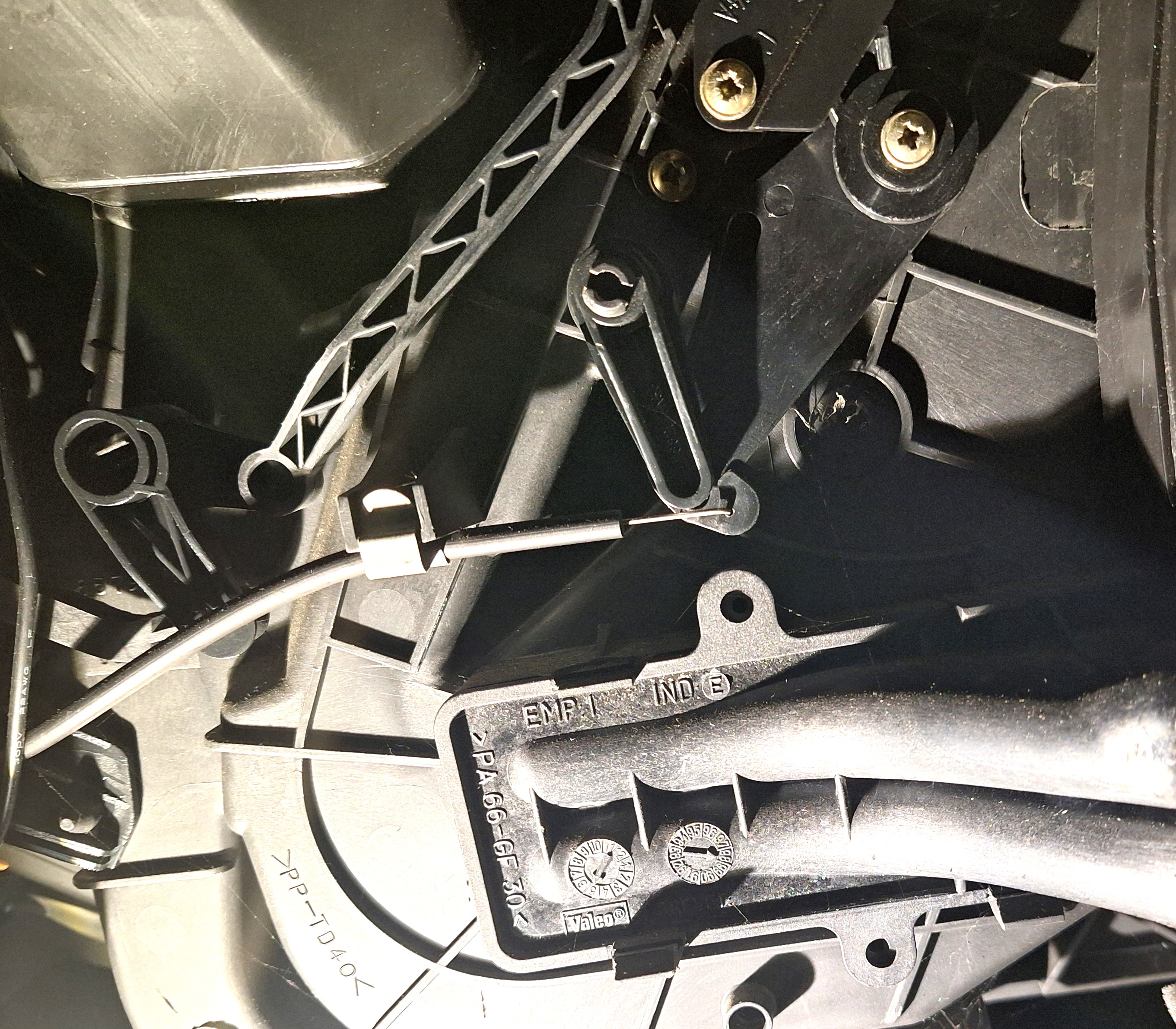

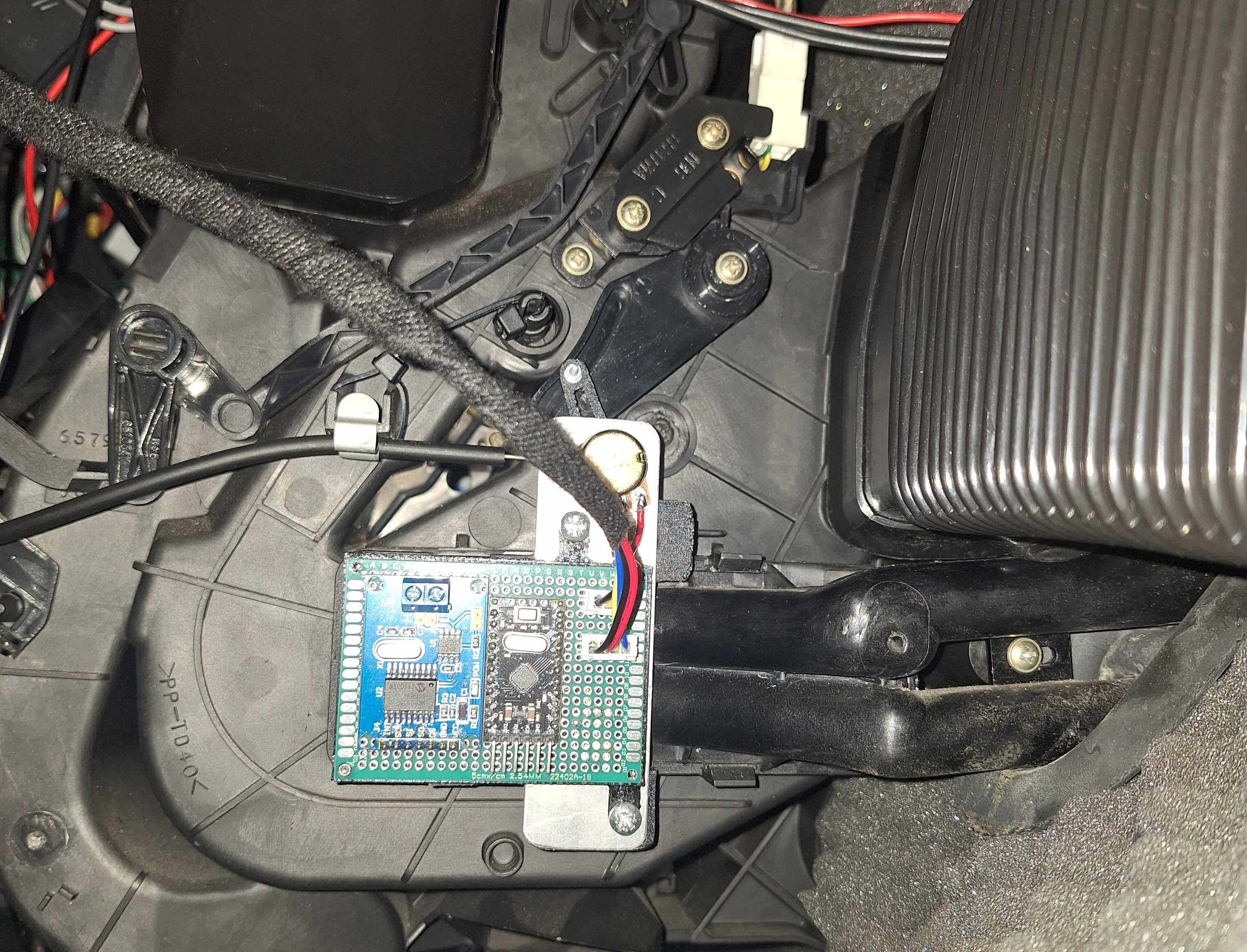

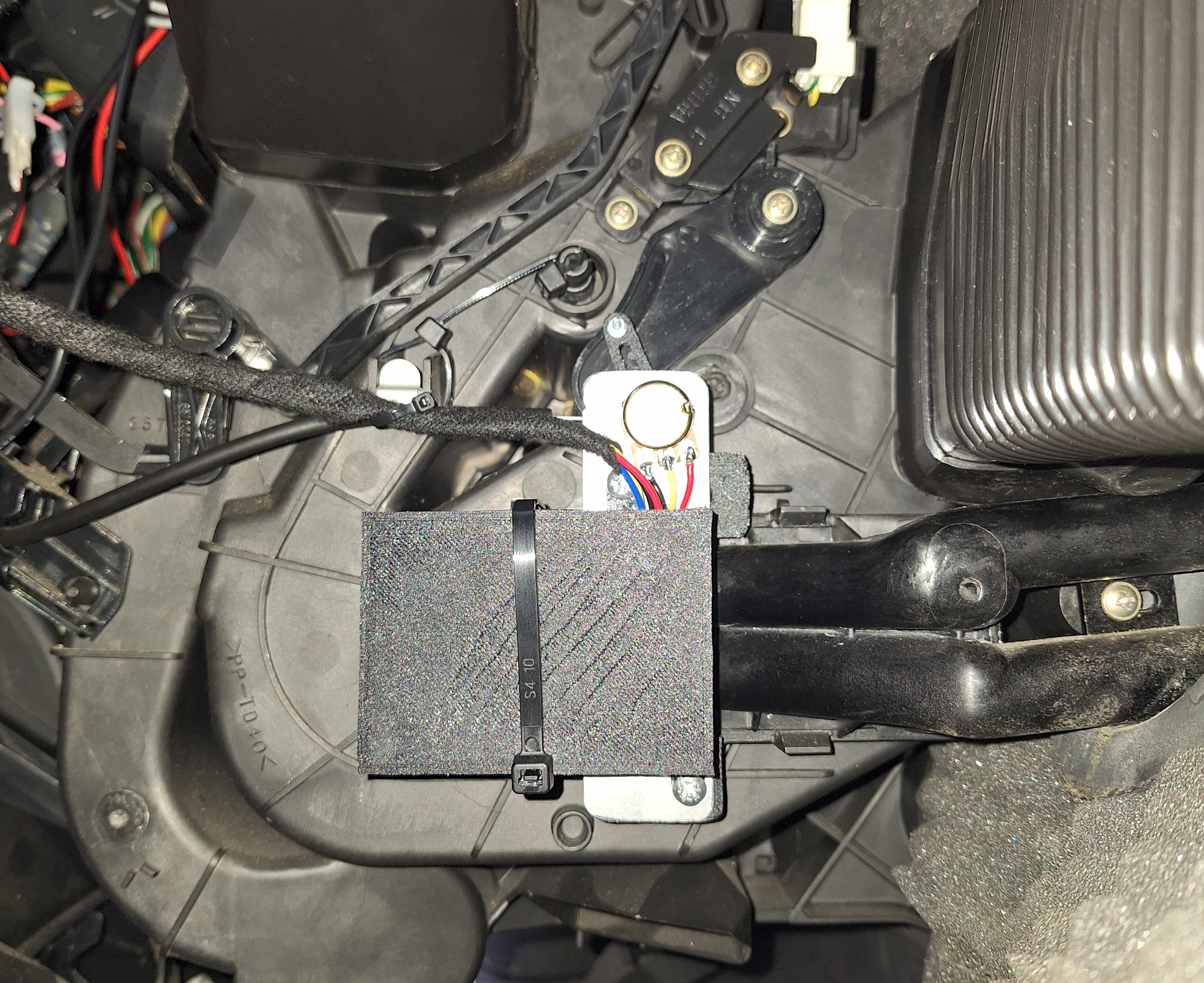

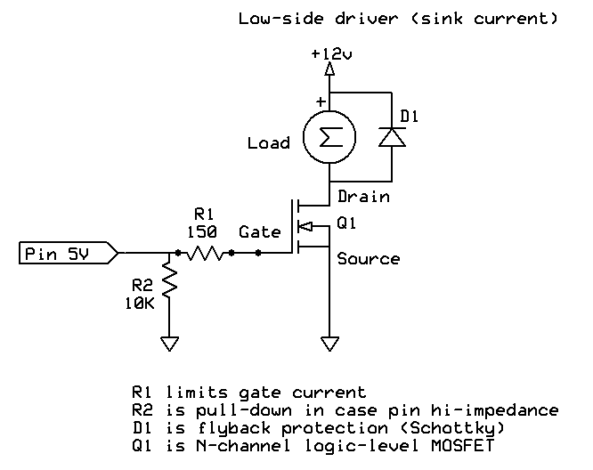

Since winter has begun, I wanted a bit more heat in the Saxo.
Until now I had the heater set to 50% via the web interface. And the only control I had was on/off.
The Saxo has a slider to adjust the heat in the car. This mixes heated and cold air. I could use this but the wastes power.
So I modified the control mechanism by locking the mix valve to full hot using a Tyrap.
Added a potentiometer to sense the heater slider position. An arduino reads the value converts it to 0 to 100% and sends it via CAN to the Zombie. Luckily there are some mounting screws for the heater matrix. With a couple of 3D printed parts it was easy to mount the electronics.
In the Zombie I added a CAN mapping to read the value and put it in to the HeatPercnt. Found out that the VW heater did not like a 100%
Changed the arduino code to limit it 97% after that it worked fine.

cajamatt wrote: Wed Nov 12, 2025 1:37 pm Added a potentiometer to sense the heater slider position
This has recently been added to Zombie in a few variants. Slider to ON/OFF, Slider to ON/OFF + Set believe even now a Button ON/OFF + Silder to Set
So this is an arduino you can remove.
marucha79
Posts: 36
Joined: Wed Jul 20, 2022 6:28 am
Location: Poland
Been thanked: 9 times
Post by marucha79 »
It's great that you shared info about energiemeter and econometer, I couldn't find anything about control signal of them. I tried send test signal to energiemeter via pin 14 of round connector ICE0A, but without success. Maybe I made something wrong in electrical circuit (GND--ULN2803--output to dashboard--5,1k resistor-- 12V supply) or there is any wiring problem. Could you share your circuit? It would help me solve this problem.
BTW your project is very impressive, every detail is refined to perfection. I don't have so many patience. Maybe some time I try follow your idea of power steering, sound of original pump is really annoying.

marucha79
Posts: 36
Location: Poland
Post by marucha79 »
Saxo/106/Partner/Berlingo Electric OEM energiemeter and econometer need more complicated signal, as @manny described in first post on this site. Before I read this, I tried other ways, this described by you too, but it didn't work.
manny
Posts: 197
Location: Netherlands
Has thanked: 59 times
Been thanked: 159 times
Post by manny »
I am on a road trip to sweden at the moment. Will give a more detailed answer later if needed.
From memory I only have a mosfet to ground from the eco meter.
It's PWM controlled make sure that it frequency matches other wise it will not work.
Is the dash in the car or on the bench? Because the eco meter is controlled by electronic it needs power en grounds.

marucha79
Posts: 36
Location: Poland
Post by marucha79 »
Dash is mounted, speedometer works well. Econometer was not tested yet, energiemeter is my priority now.
manny
Posts: 197
Post by manny »
The energiemeter is controlled with a 50% duty cycle variable frequency square wave. With the frequency varying between 5 and 270 Hz.
Here is the pinout of the dash.
And the wire should been labeled 4899. Your connection to pin 14 of round connector ICE0A should be good
I used something like this to connect the arduino to the energiemeter. The diode D1 is not used. And the energiemeter is the load the 12V is connected in the original dashboard. key needs to be in the on position.

marucha79
Posts: 36
Location: Poland
Post by marucha79 »
Thank you. I'll try this solution soon. Now my way to know battery level is connection phone to serial interface - not very practical...
marucha79
Posts: 36
Location: Poland
Post by marucha79 »
My problem solved. Reason was prosaic - lack of 12v supply on pin 9 of ICE0A. I hadn't got motor relay box and OEM wiring, when connecting stuff didn't realize that this pin should be supplied. Now energiemeter lives when driven directly by ULN2803.
