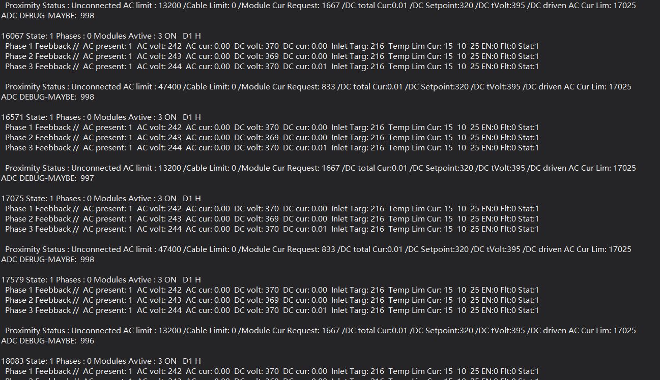

Started messing with the actual charger. WIth the code I posted above, I can get the connection state to change on the bluepill test with varying the input voltage. When running the above code on the logic board. It seems stuck at unconnected reading back a value of 996-998 regardless of connection. I need to dig in a little further.

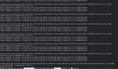

Progress made. It turns out my prox input put wasnt fully seated in the molex connector. Once my oversight was fixed, we now have the J1772 connection state properly working.
Ive now run into another issue. My evse will click the AC voltage on as shown in the debug screen, but it will not command any current. There is also a toggling going on with the AC cur limit values. Need to look into that further. Any ideas there?

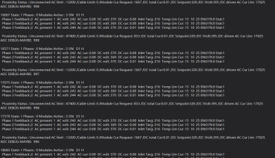

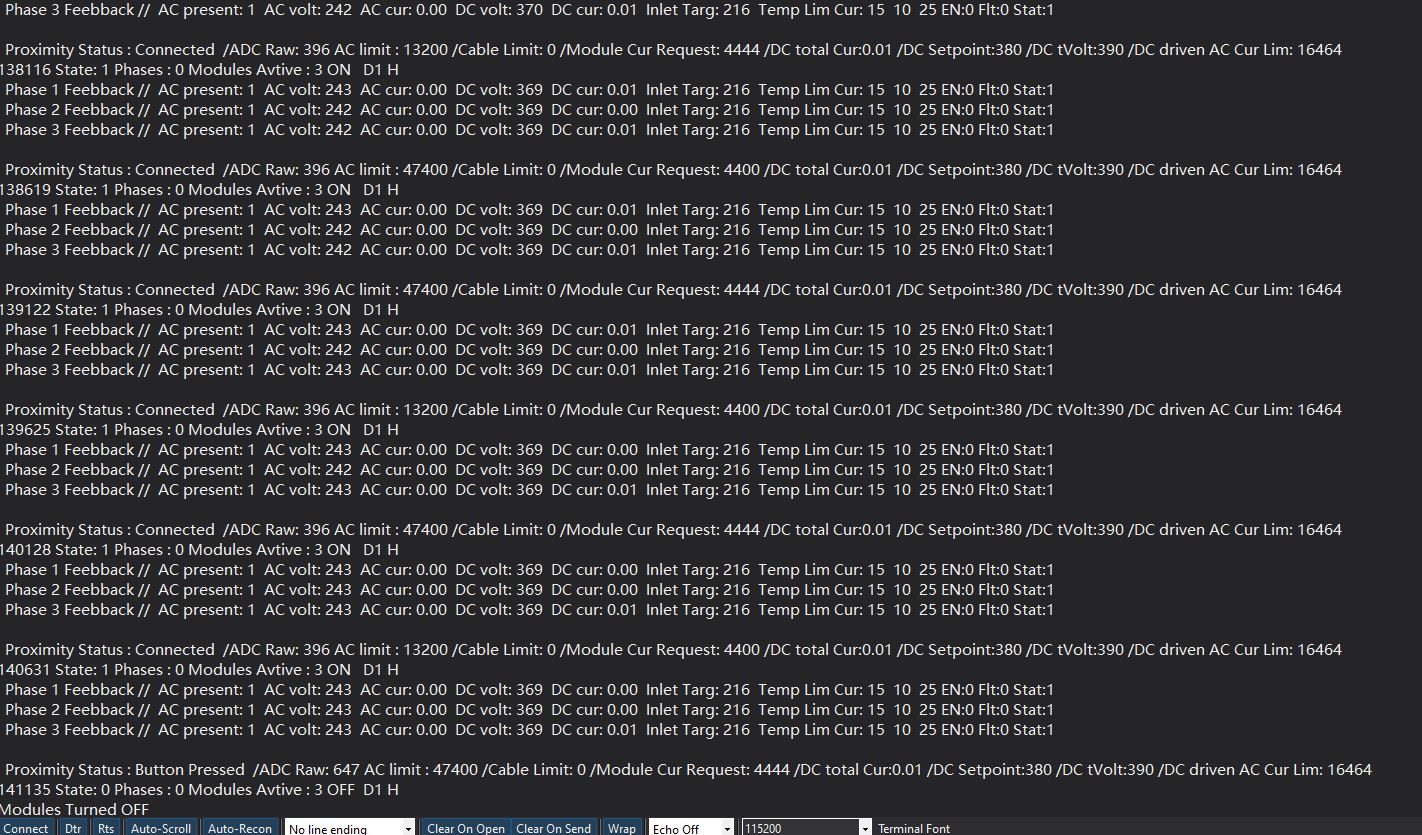

Screen grab of the latest plug in.
Posts: 4007
Been thanked: 1137 times
Re: Gen 2 Charger V5 Software Development Thread
You the man Jon:) I had not gotten any further then the prox detect problem but I see there your cable limit is 0 that is why its not drawing any current. It's not setup to calc the cable limit from the new values from the adc I would guess.

jon volk wrote: Sat Apr 25, 2020 2:00 pm Screen grab of the latest plug in.
That looks good to me the current request is what is shown in the debug. so it should be asking for 4444mA ac current into the phases.
What is your configuration?

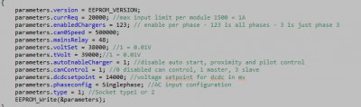

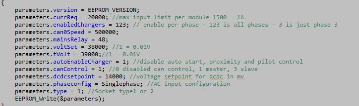

Post by jon volk »
Heres the settings I have in there. It appears the AC is being requested, but the EVSE is not supplying the requested voltage. If i look at the EVSE app, it shows as connected, but not supplying any current.

jon volk wrote: Sat Apr 25, 2020 2:23 pm Heres the settings I have in there.

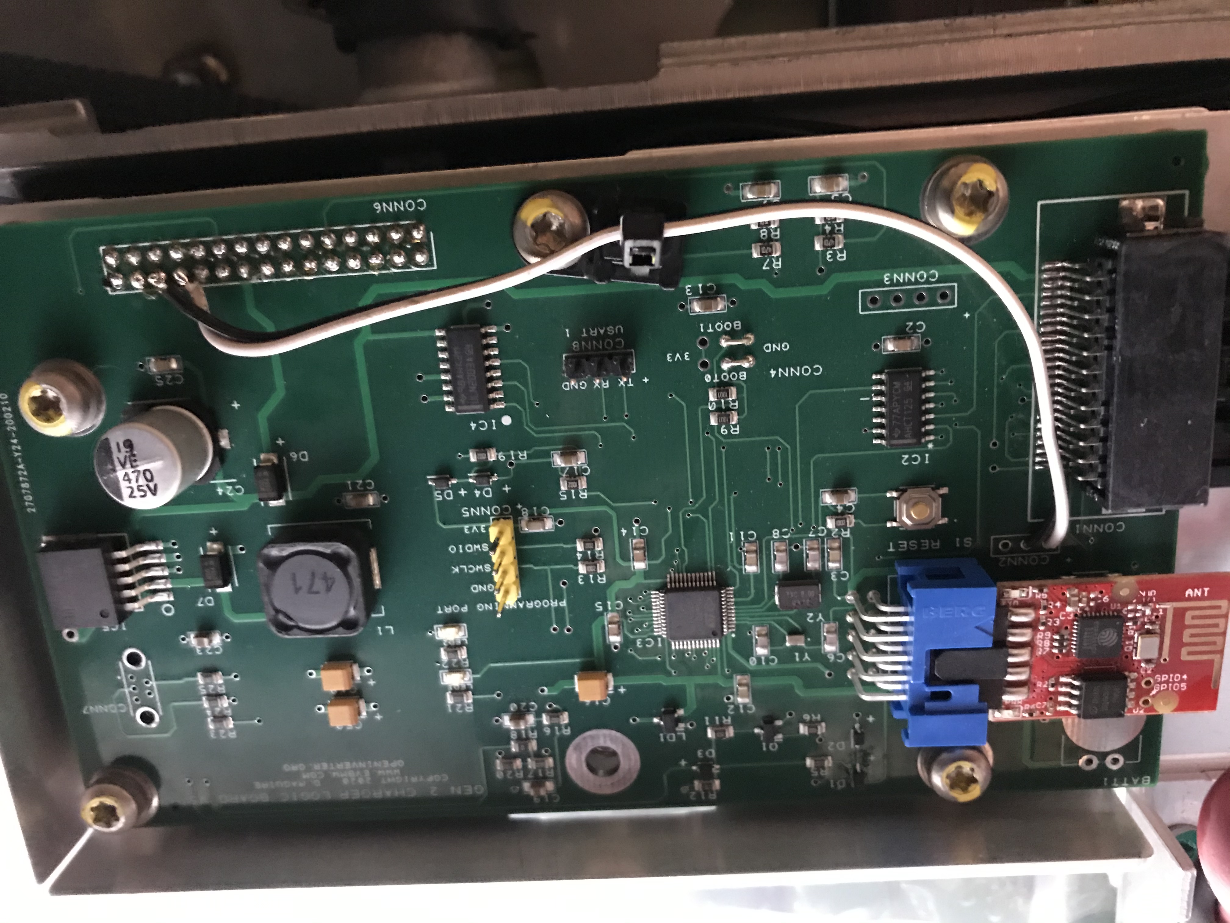

jon volk
Posts: 574
Location: Connecticut
Post by jon volk »
Added jumper wires to get an external CAN connection. Here is a snip while plugged in.
