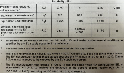

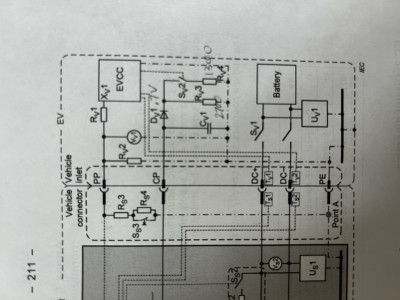

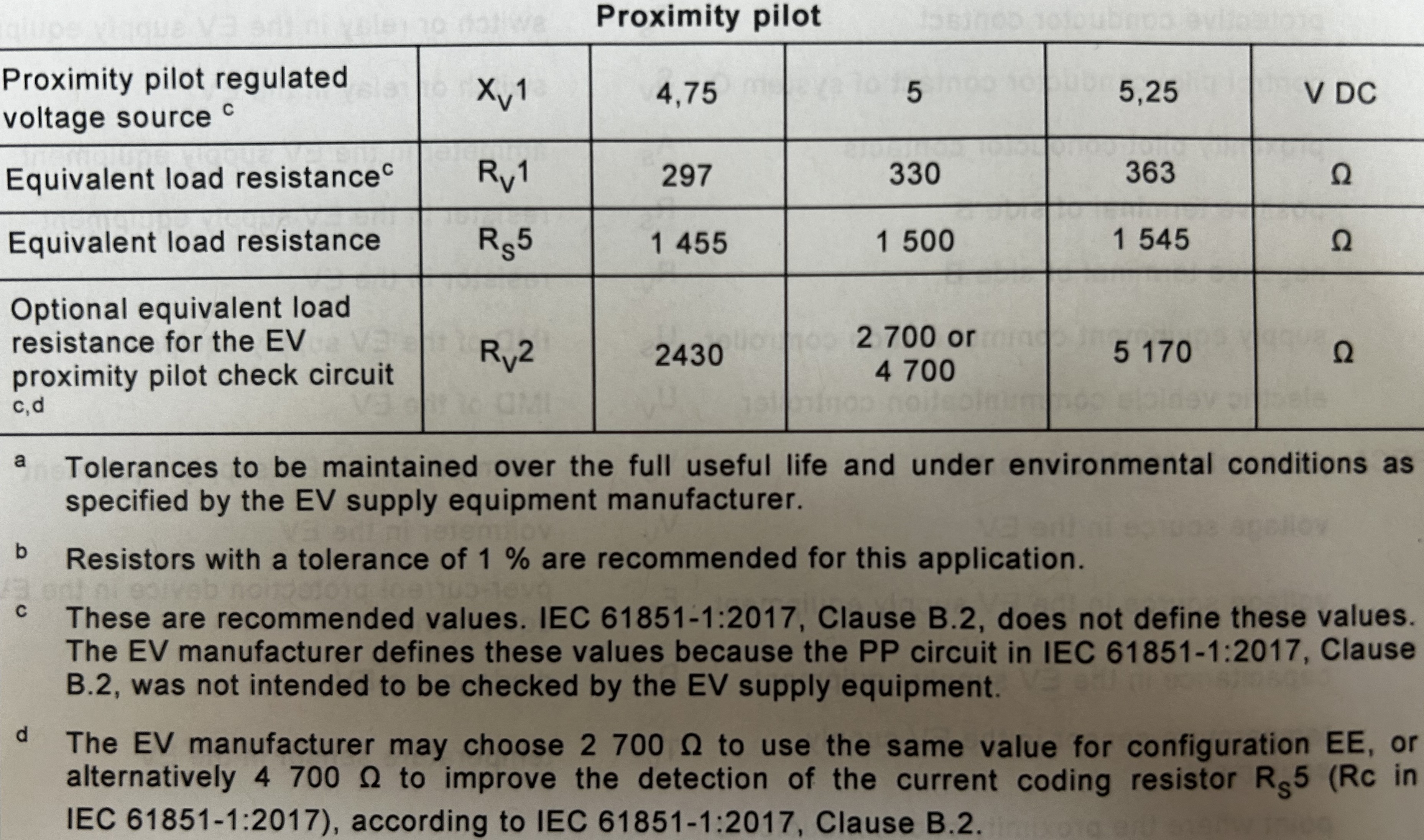

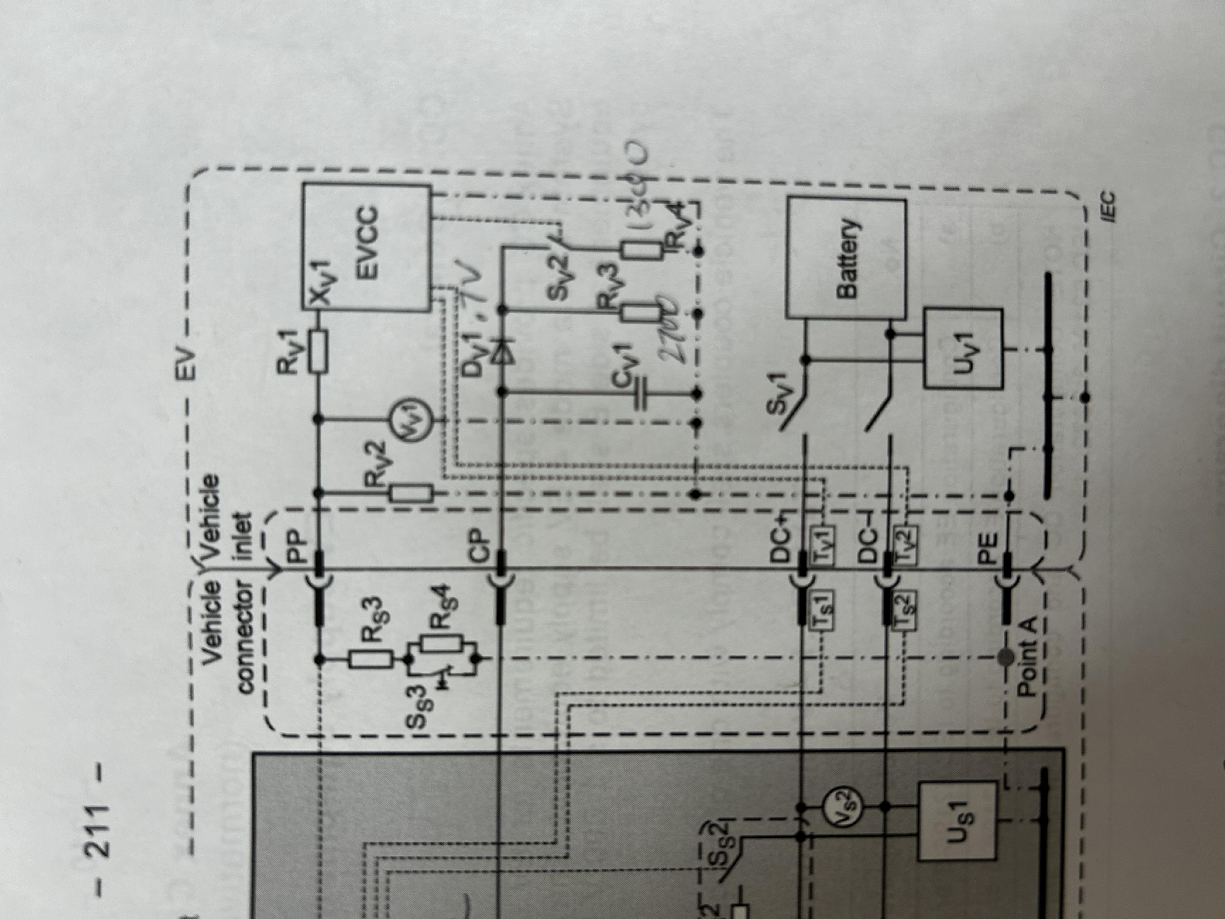

Bigpie wrote: Sat Apr 13, 2024 8:47 am CCS1_vs_CCS2_signaling_circuit_2.png
Shows the differences
Also wondering if this is a change I may have to make. I found these bits of doc in the CCS1 protocol documentation and it seems that in a certain setup, 4.7k is optional? Again, I'm not very knowledgeable in this space so I figured I'd throw these up anyways just to get y'alls thoughts.

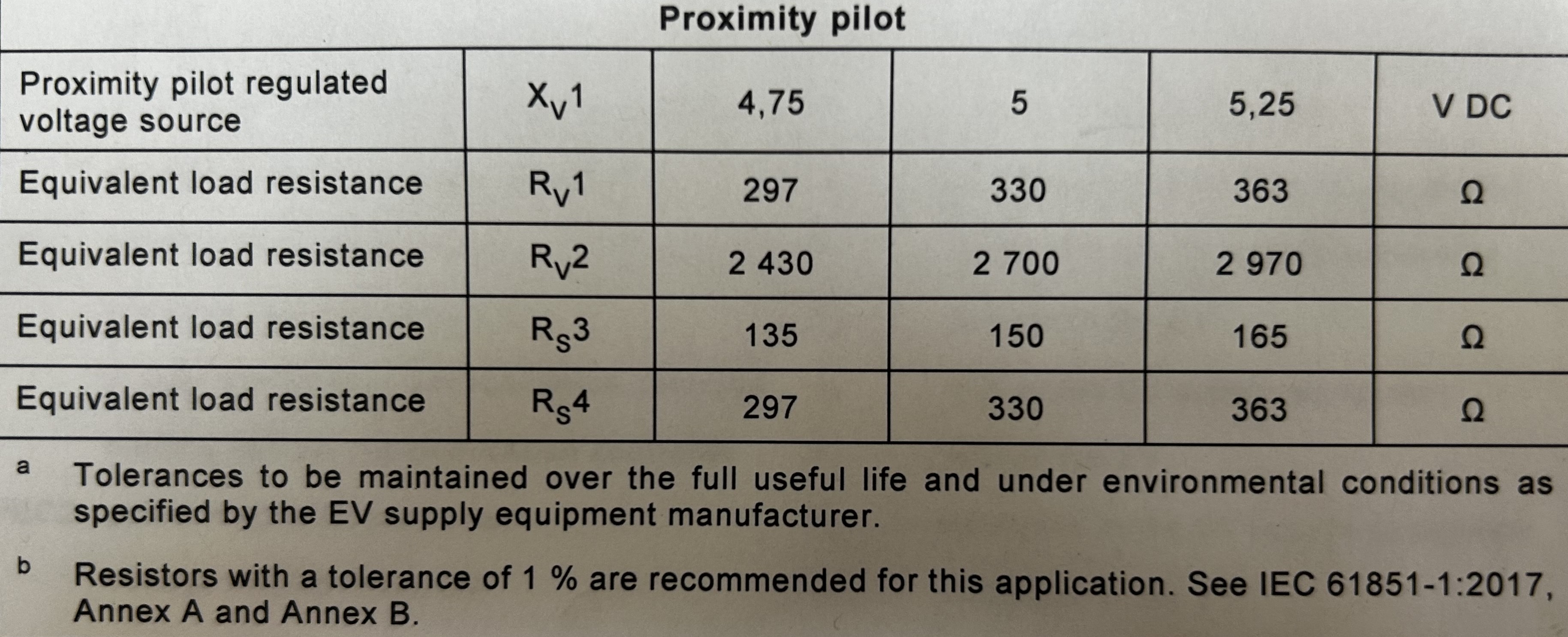

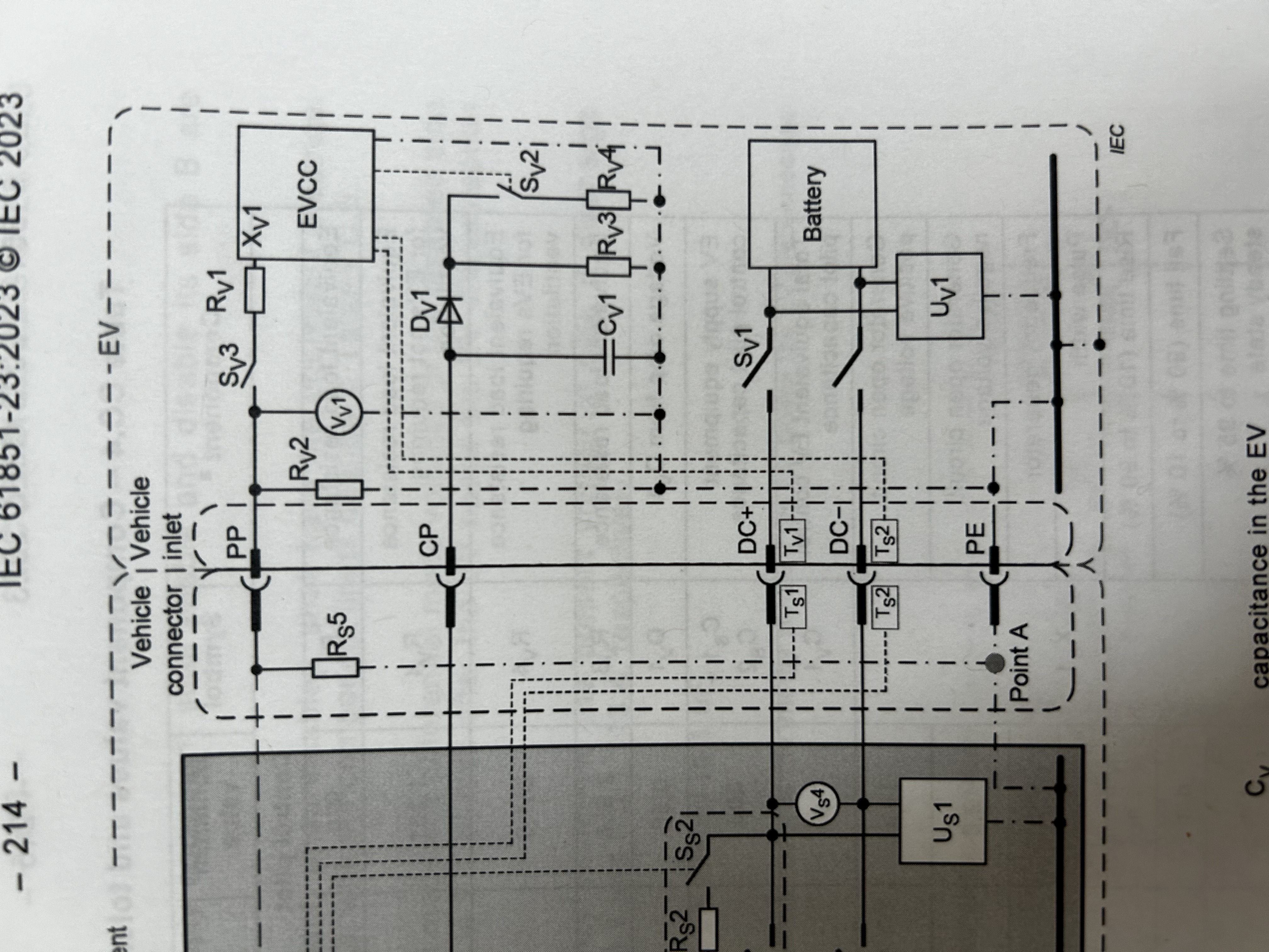

serh270 wrote: Fri May 03, 2024 5:35 pm Also wondering if this is a change I may have to make. I found these bits of doc in the CCS1 protocol documentation and it seems that in a certain setup, 4.7k is optional?
There are two different use cases: CCS type 1 and CCS type 2.
The upper picture, with Rs3 and Rs4 and button in the connector, is CCS type 1. For this, the PP pulldown 2.7k inside the vehicle is mandatory.
The lower picture, without the switch in the connector, is CCS type 2. For this, the PP pulldown is optional and can be 2k7 or 4k7 (or not present at all). Thanks for the official data, this confirms the understanding with the 330 ohms to 5V.
You could cross-check, whether you have the 330ohms to 5V, and the 2k7 (or 3k) pull-down on the PP. If you put a multimeter in current mode between the PP and ground, you should see something like 5V/330ohm=15mA.
serh270
Posts: 42
Joined: Sat Mar 16, 2024 9:05 pm
Re: First-Time Config of FOCCI And CCS1 vehicle charging
Post by serh270 »
uhi22 wrote: Fri May 03, 2024 6:57 pm The lower picture, without the switch in the connector, is CCS type 2. For this, the PP pulldown is optional and can be 2k7 or 4k7 (or not present at all). Thanks for the official data, this confirms the understanding with the 330 ohms to 5V.
So in this case, if the charger is a CCS2 charger (which it is), then the resistance option on the board does not matter i.e. it should be backwards compatible? Idk I suspect that the issue lies somewhere with the PP because it is not detecting connecting but I am unable to test right now. I will update with results when I can.

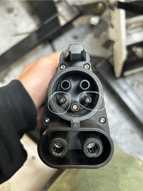

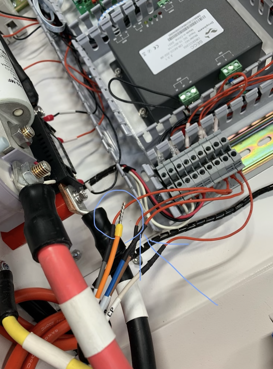

Opened the charger. Looks like the PP line was disconnected completely from the factory (on both chargers). Supplier seems to have confirmed that this is not intended. Will test again tomorrow and hopefully this fixes the issue
uhi22
Posts: 1244
Location: Ingolstadt/Germany
Has thanked: 245 times
Been thanked: 684 times
Post by uhi22 »
Could also be normal. The PP resistor should be in the plug and nothing else is mandatory on the PP. Is it possible to take a multimeter and measure the PP resistance while everything is off and disconnected?

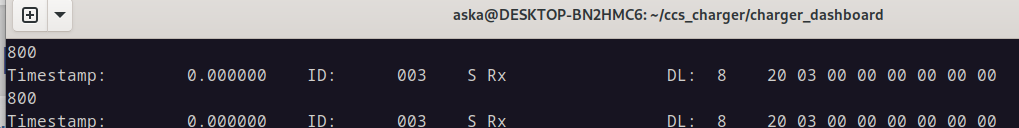

Screenshot from 2024-05-10 10-41-59.png (7.67 KiB) Viewed 10754 times
Found the problem with the incorrect target value. Silly-mistake: Can-mapping was incorrect. Above was the incorrect mapping in which only the first byte was taken in. Below is the message:
Corrected it to this ^. I don't have access to the vehicle to test charging, but will test when I get a chance. Is there any danger of testing without the cell load on the EV side? Want to test charging hardware but unsure if doing so will cause a problem other than triggering a fault when the contactors close
If I try to test above that 500v limit, it just simply won't charge?
