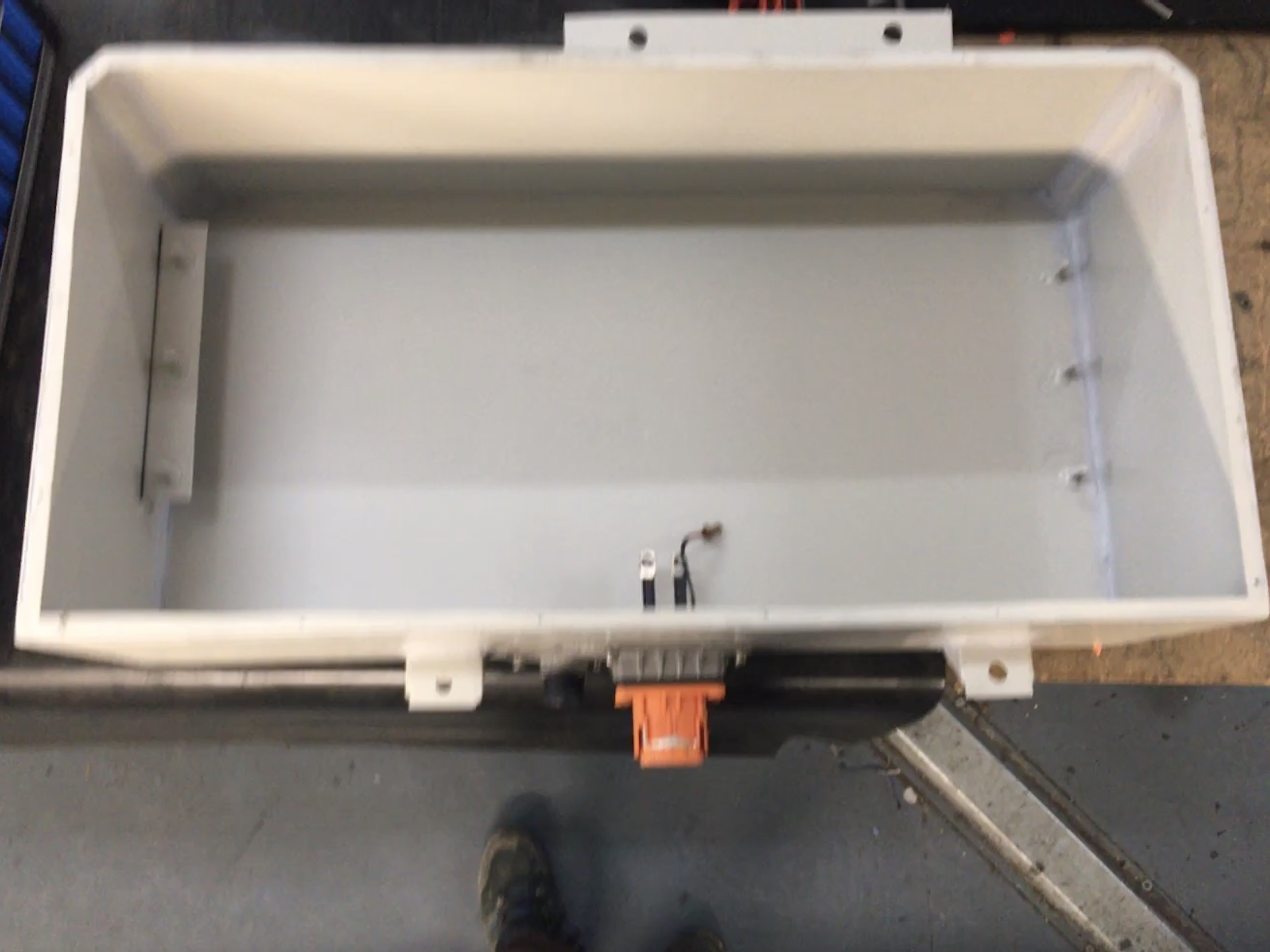

Hi all, sorry it has been a long while since the last update. We’ve been making steady progress and the rear battery box is almost finished. Once it is installed we just need to finalise designs for the front battery box. Will post some pictures soon. The main issue has been the lack of available space at the front, the Gen 1 Leaf inverter is quite bulky so we are exploring other options...

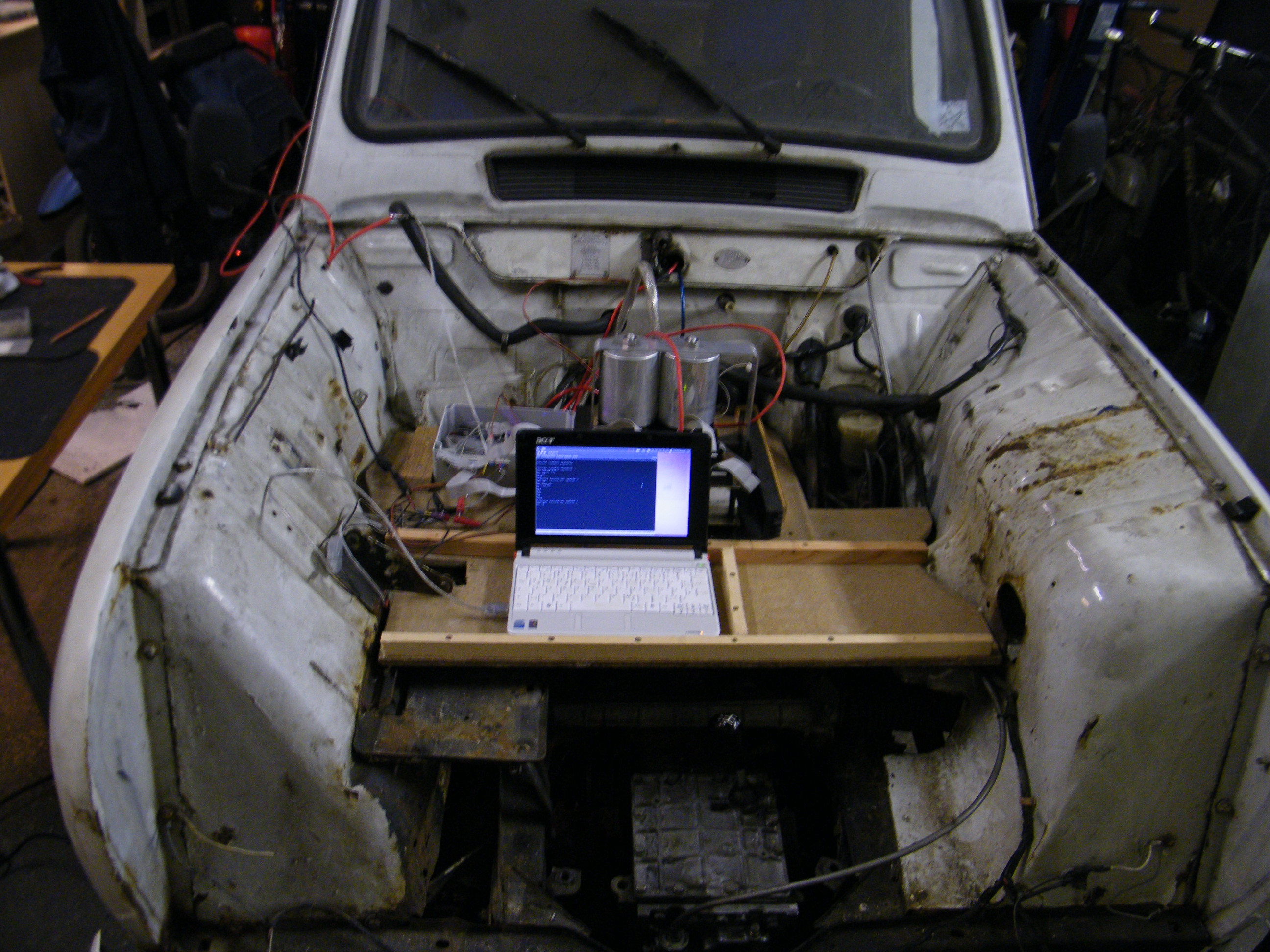

This is even more outrageous then my first test run (notice the fancy user interface)

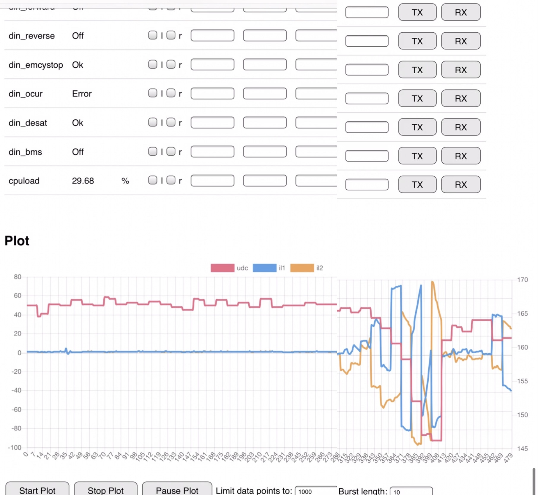

Here is an expertly spliced photo of the spot values for IL1, IL2 and UDC in the test video above. Nothing too exciting but as you can see the car accelerates gently with about 80 motor amps. Those cells do sag quite a bit under load

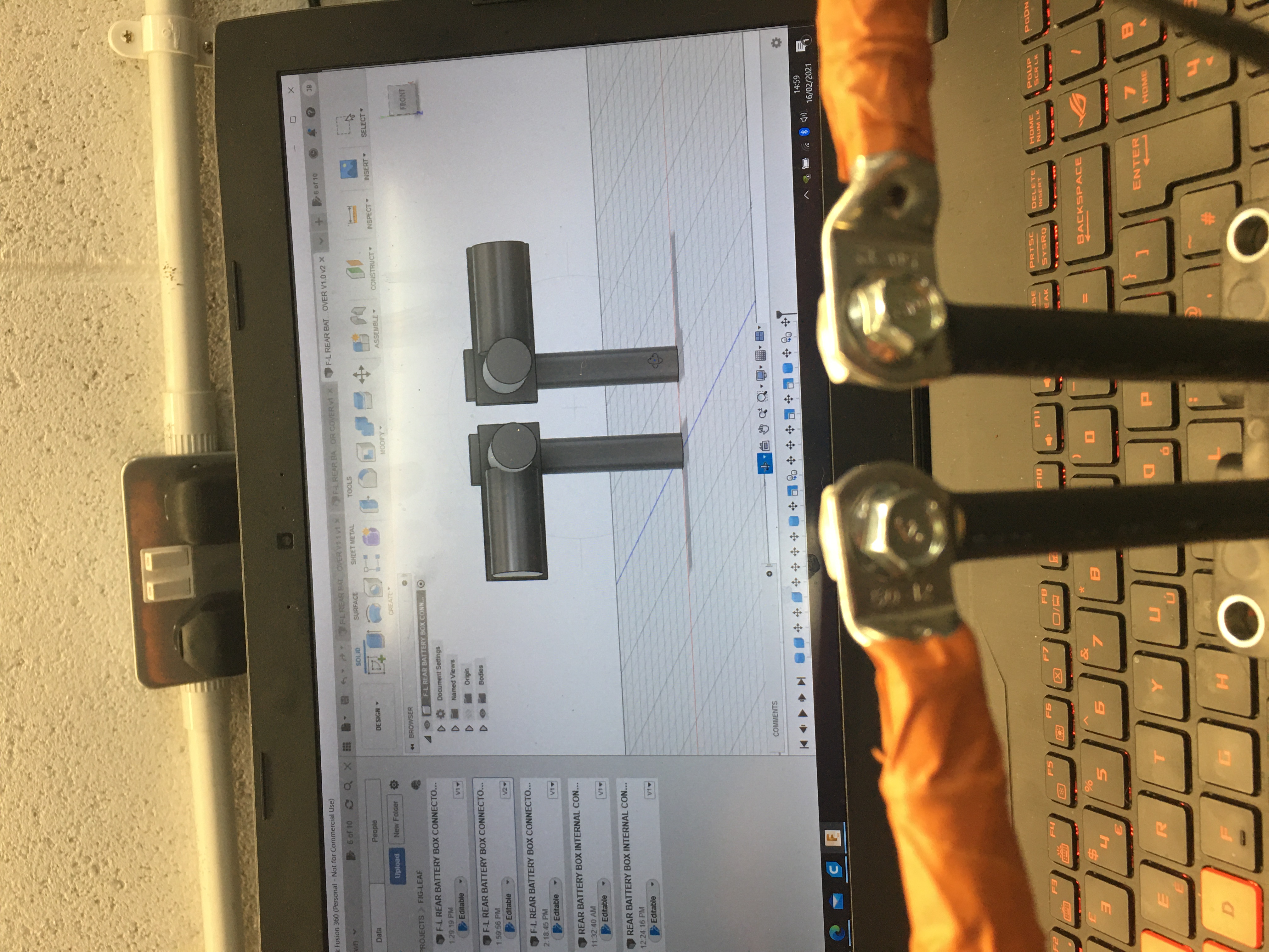

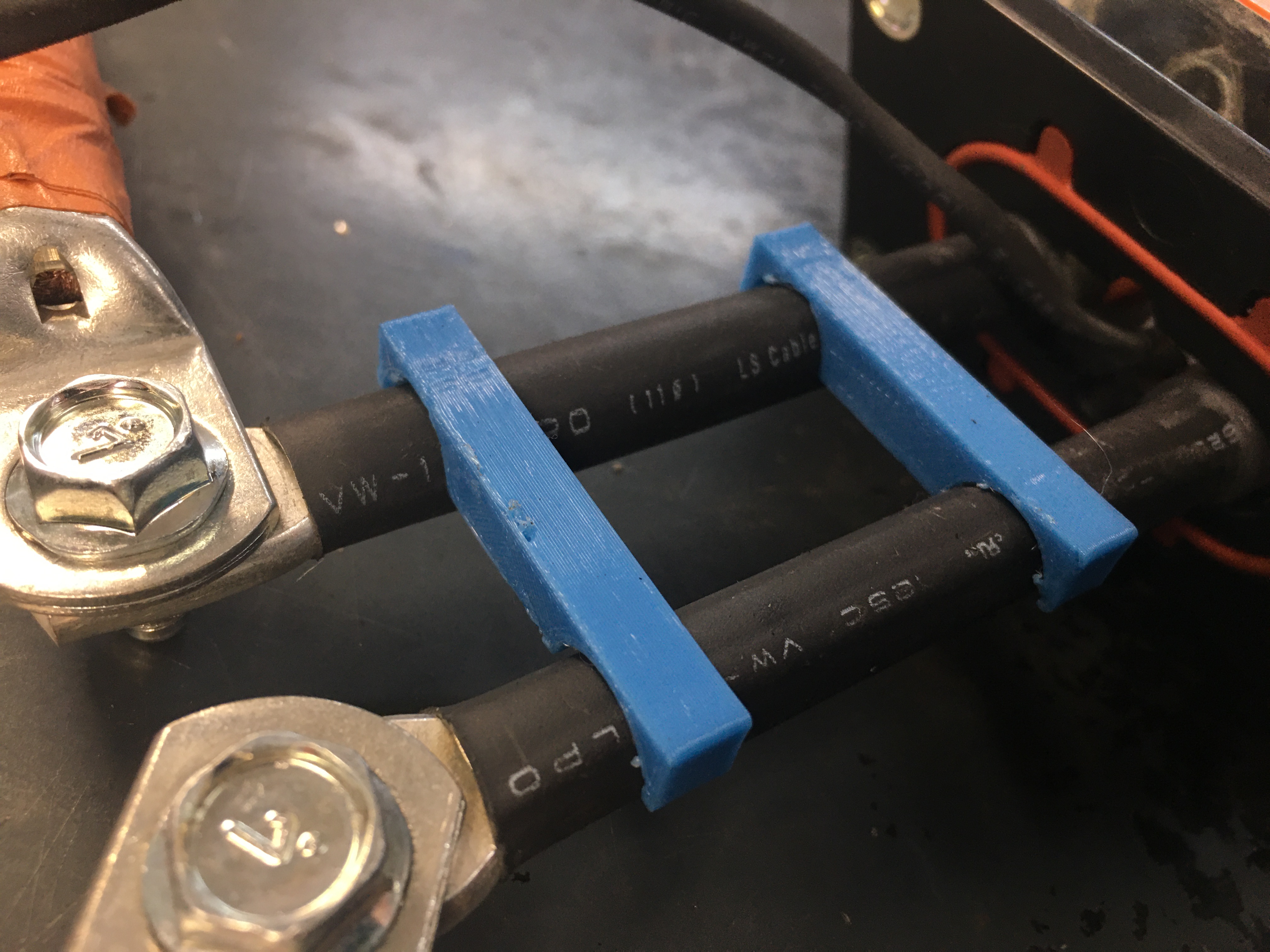

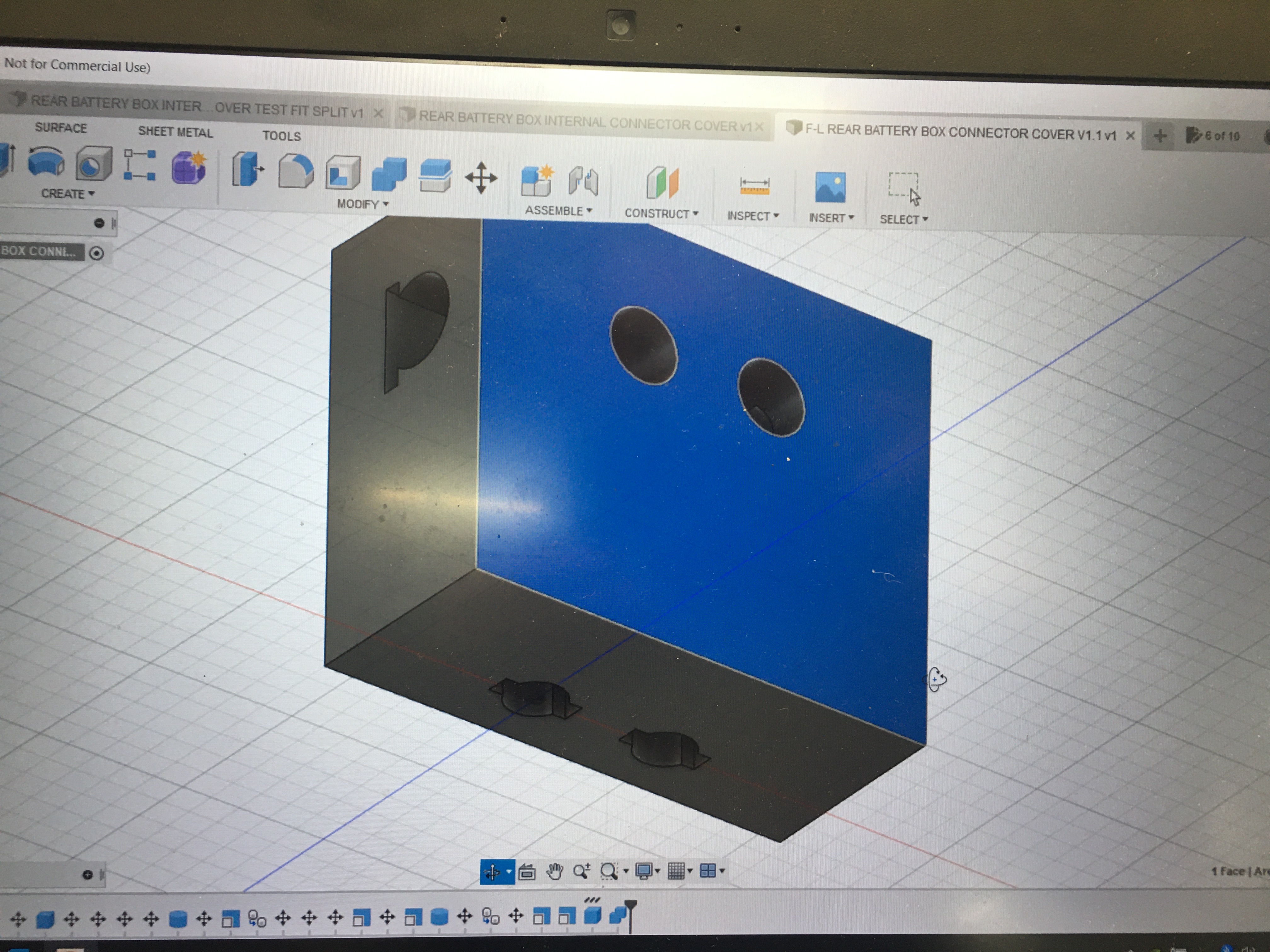

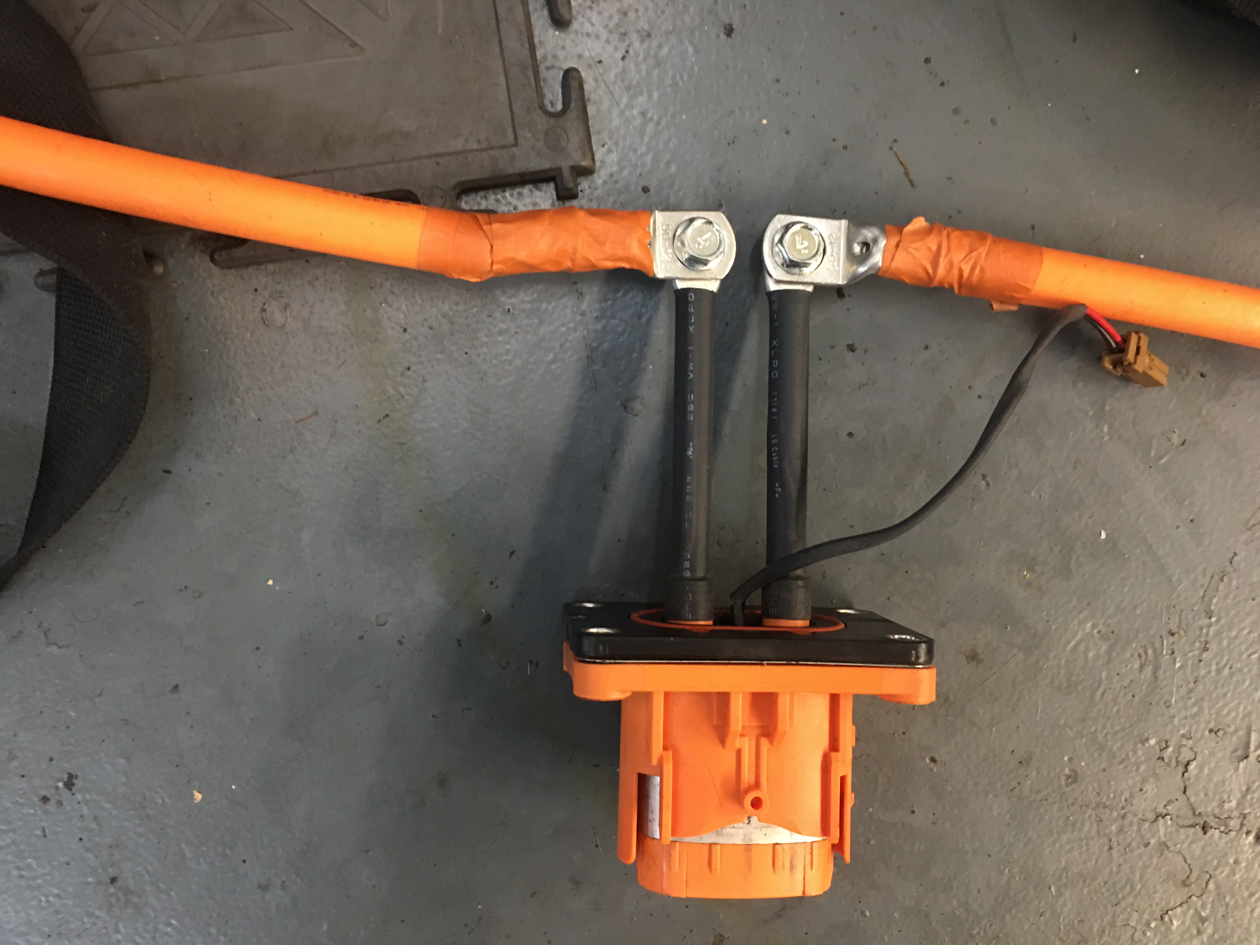

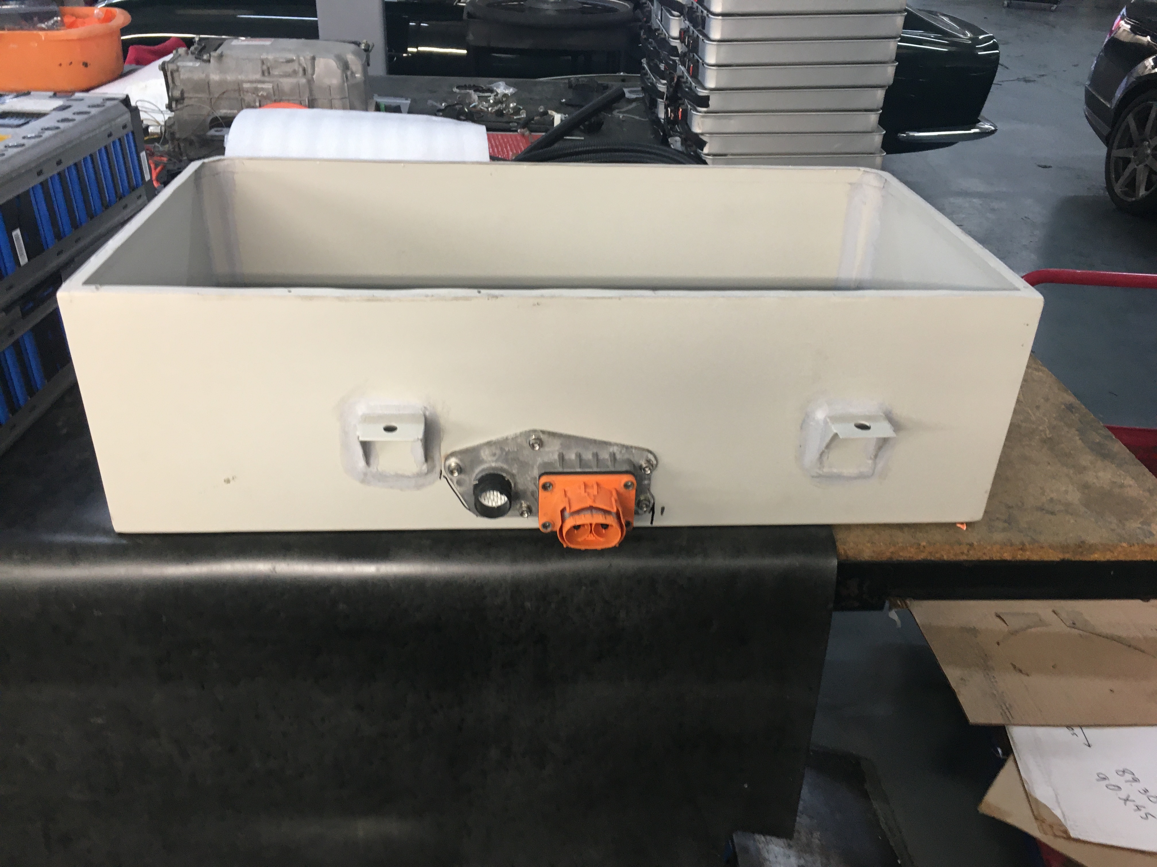

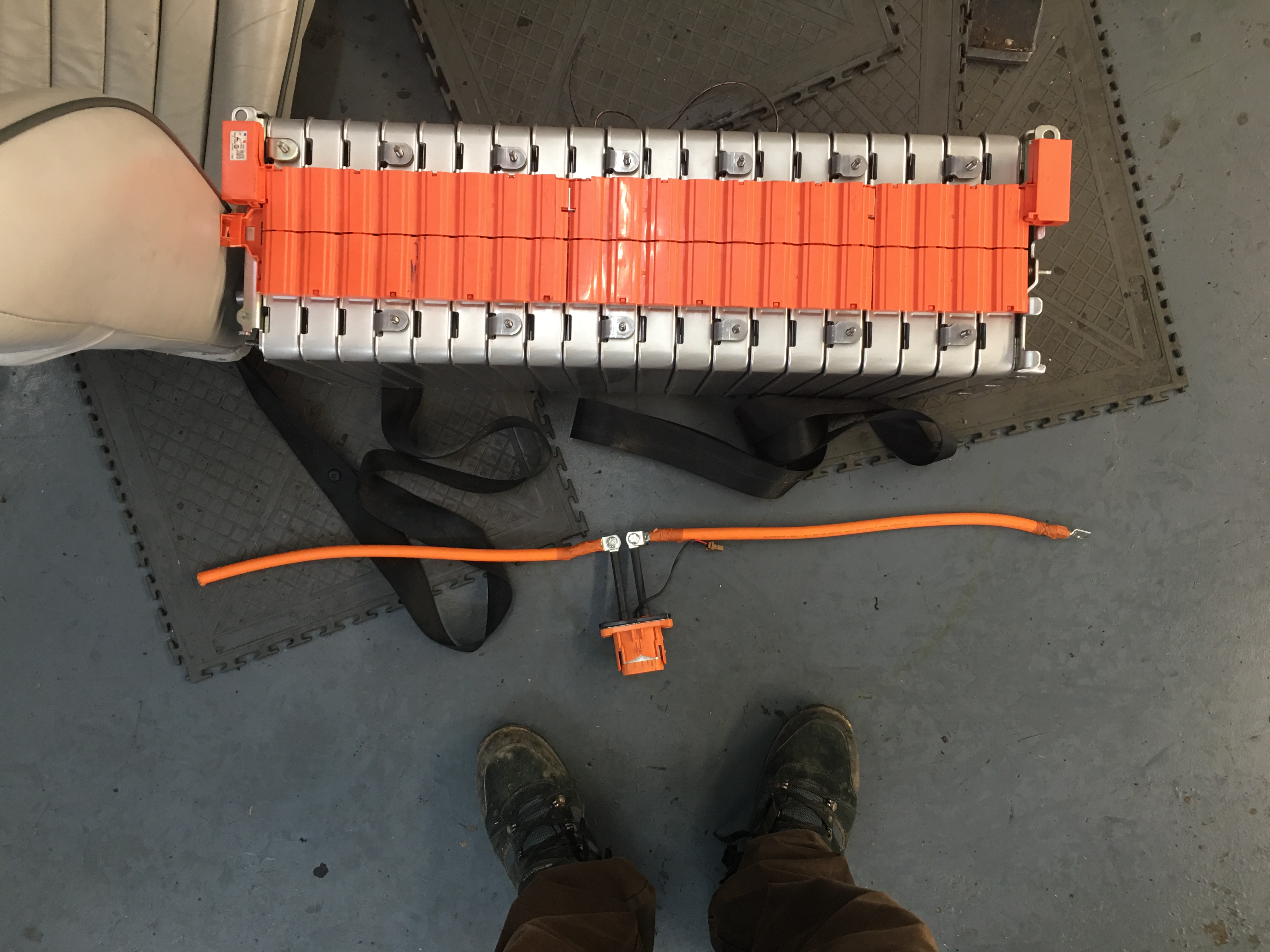

Just wanted to share some pictures of the almost finished rear battery box which will house 20 of the gen 1 Leaf cell modules.
I wanted to use as many of the original leaf connectors as possible, but as you can see the battery box connector plugs straight into the HVJB so it didn’t leave much room for insulation. I quickly designed a terminal housing to go round it.
