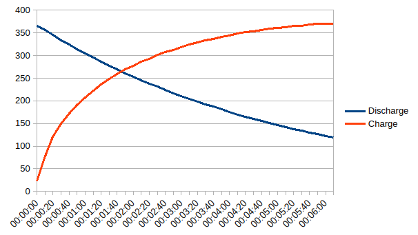

Measured some times (bus charged to 370V, well above threshold of 160V):
0:00 Send start command
2:15 Standby to Startup
2:25 Click
2:45 Start Boost
2:50 Error
Then the HV supply, cranked up to the max setting: It takes 6 minutes to reach 370V and doesn't go any higher. As expected voltage drops very quickly when turning it off and steps right back up to bus voltage when re-enabled.
So now we have to time the CCS state machine to connect the battery at around 2:30 minutes. The big question is, how will cars react if they see voltage before CableCheck? I think this should be avoided, making it even more challenging.
So we precharge the inverter to 370V and as soon as we enter state CableCheck we need to turn off the HV supply
Then:
For cars that don't time out we can proceed to CurrentDemand as quickly as possible and the car will just sit there until the inverter has started up. This makes stuff much simpler:

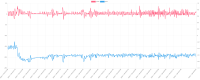

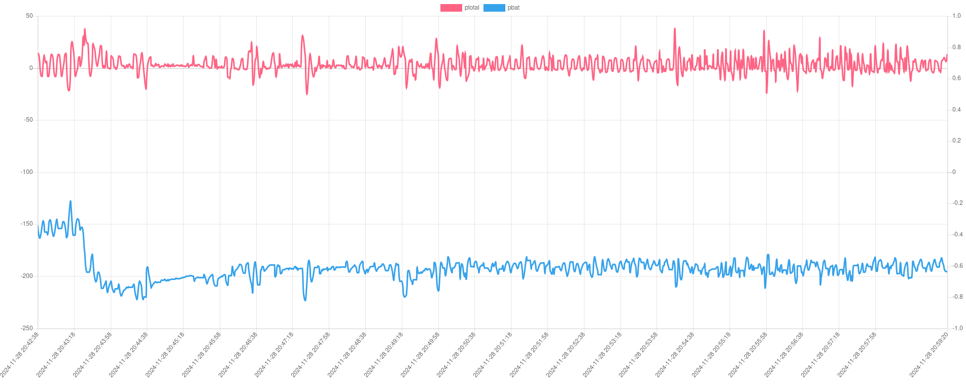

Tested the above with Touran (well it had to work as it doesn't care about port voltage). What was more interesting was the timing.
Started with 370V on the DC bus. From plugging in to Current demand took 25s and bus voltage had sagged to 348V (Battery voltage 366V). CableCheck and Precharge went through so quickly that the voltage change didn't even show.
Currently electricity is expensive so I'm sucking energy from the car: Not super precise but should be good enough. Target values are maybe written every 5s, not quite sure how modbus4mqtt works in that regard

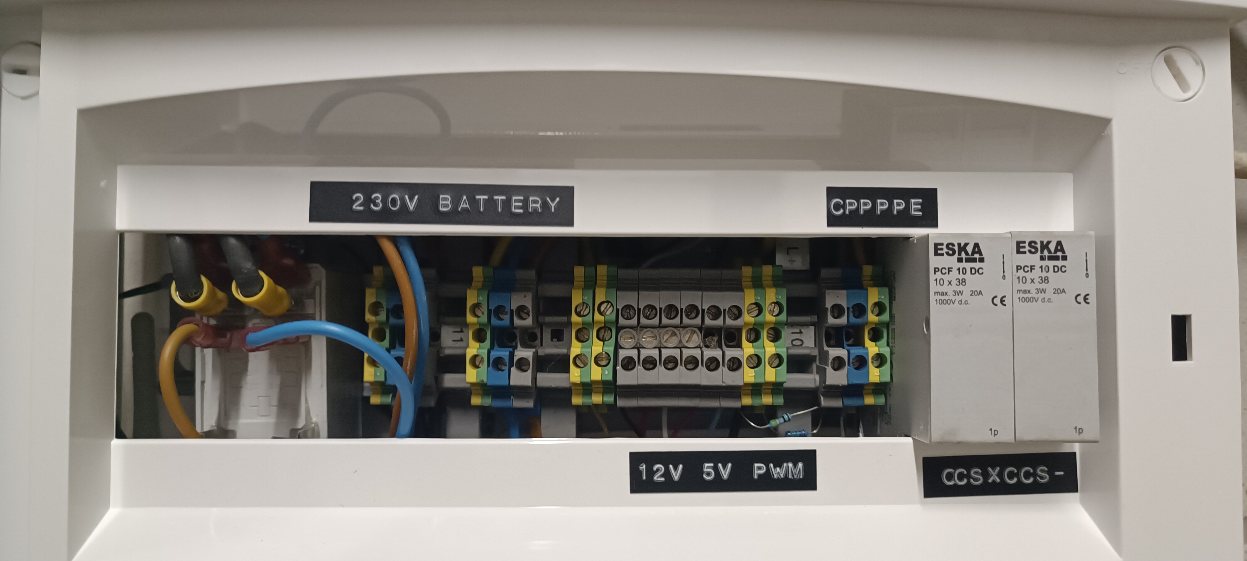

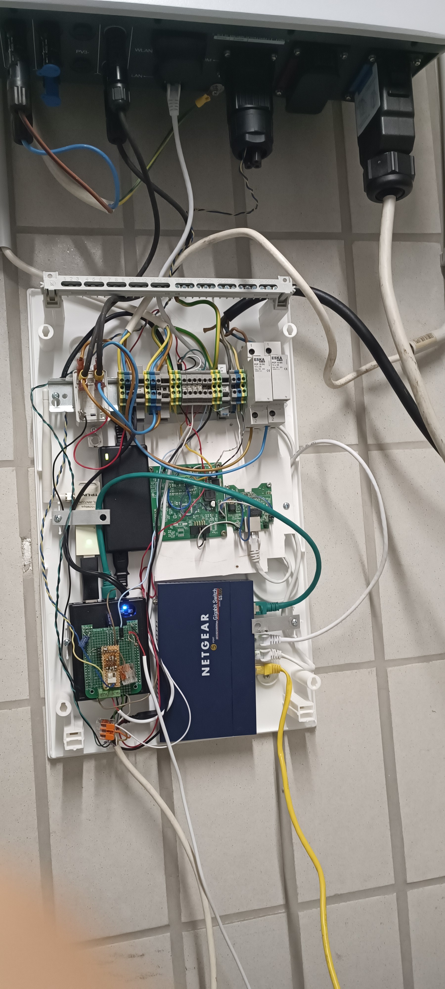

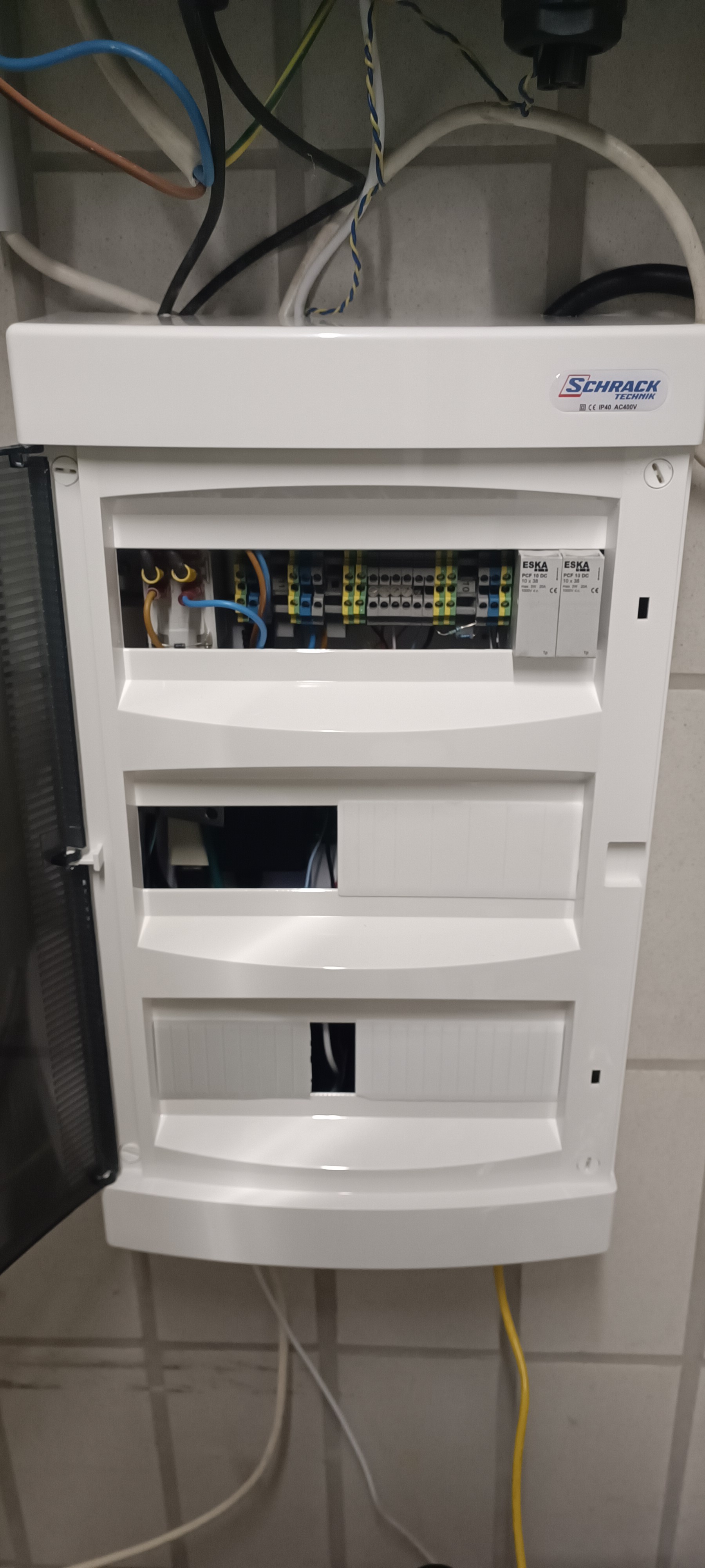

Re: Bidirectional charger with PV Hybrid inverter and pyPLC
(Sorry for posting charger related stuff in the other thread: viewtopic.php?p=79001#p79001 )
For completness, also mentioning it here: To apply a HV voltage to the DC lines, I use this modded step-up converter: https://github.com/dalathegreat/Battery ... age-source In pyPLC I then just try a few PWM frequencies, until the car is happy: https://github.com/lewurm/pyPLC/blob/cd ... #L303-L339
However that doesn't work well if the inverter is on the same line, as the capacitor in the inverter would take aaaaages (I tried, and stopped after 30min). For my inverter, Kostal Plenticore Plus G1, that wouldn't work anyway: The protocol essentially requires to apply HV voltage to the battery input at a given time when the inverter asks for it. So matching that timing with the PreCharge of the car is kind of impossible.
Instead I'm using three contactors (one with a precharge resistor, although I think that one wouldn't be strictly necessary in my case). I only start communication with the inverter once the car is in CurrentDemand and thus only once in this state the inverter can request closing the contactors.
I'm using this: https://www.te.com/de/product-2071584-4.html
With this setup the car (Tesla Model 3) is in CurrentDemand within less than 10s after plugging in. Until the inverter then finally (dis)charges, it can take up to two minutes. Not great, not terrible
No physical interaction with the inverter is needed in my setup, which was particularly important because the inverter is located in the basement.
I should mention that someone wrote a tool to interact with the web API of the inverter, and that allows me to toggle battery support of the inverter programmatically, which makes it overall more predictable: https://github.com/lewurm/pyPLC/blob/cd ... 1105-L1117

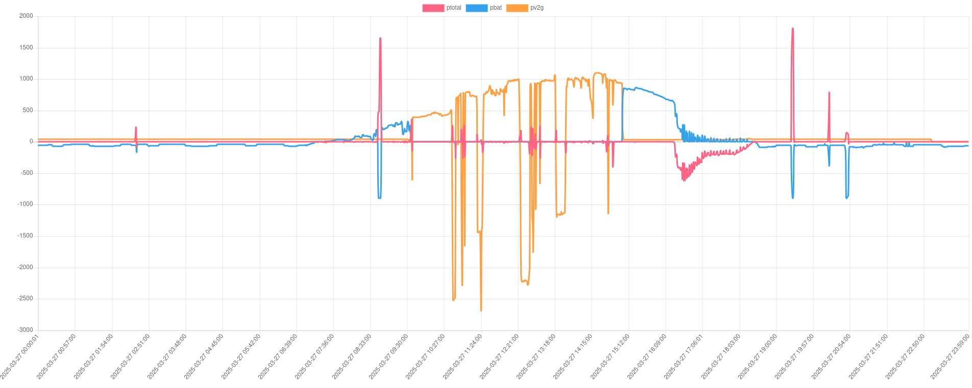

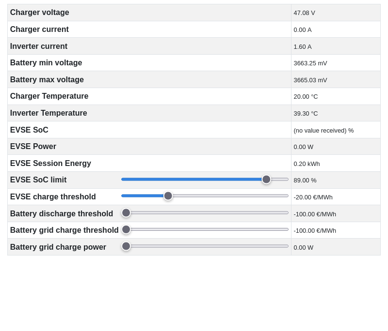

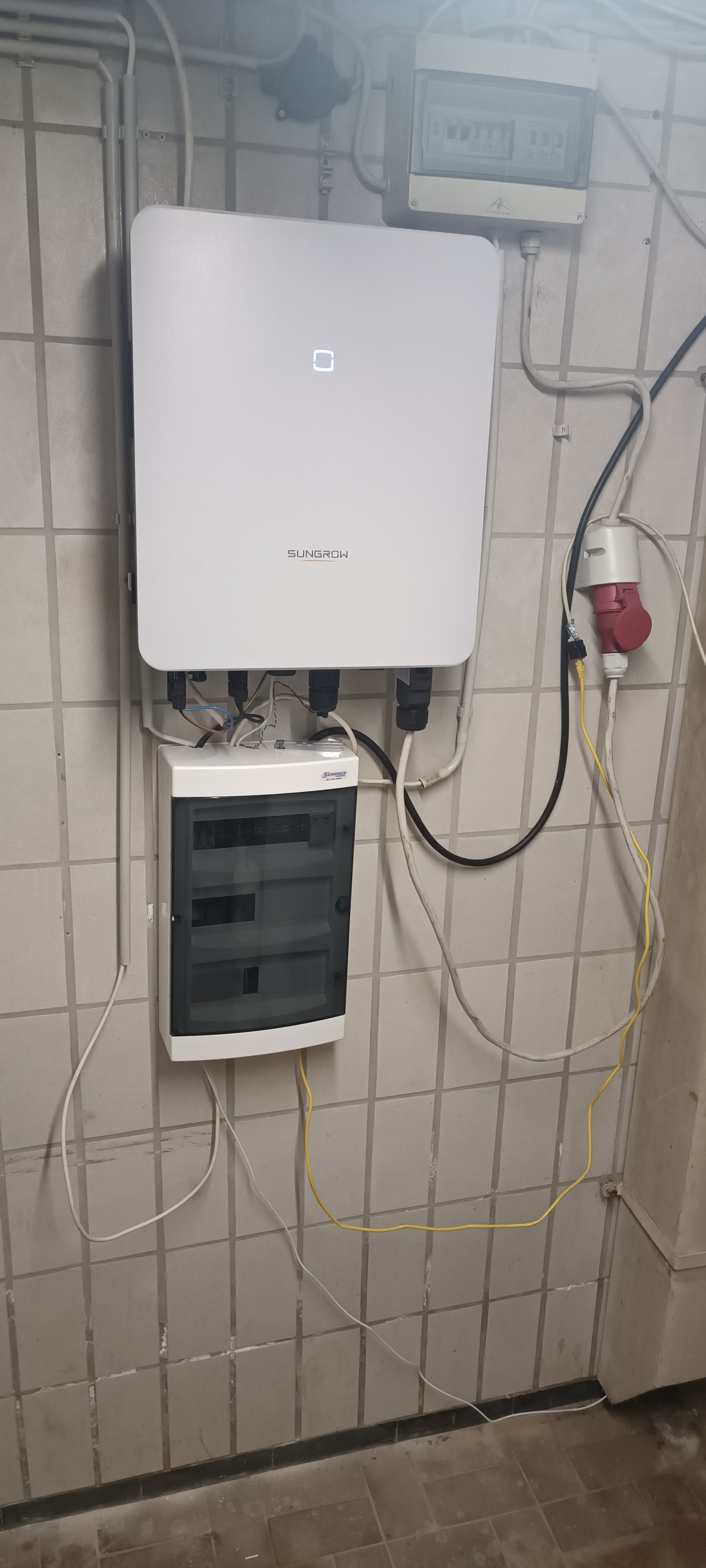

Small update on this. I have tweaked the scripts to automate things more. Now as soon as CCS is plugged in and the inverter ready the control script changes over to using the cars battery instead of the small stationary one. I installed an IP67 switch with LED next to the car to stop the CCS session. The LED blinks when the system is ready and is solid once pyPLC is in state CurrentDemand.
Here is a pretty nice day that has everything
- Charging the car from solar PV (yellow)
- Running dishwasher and laundry machine from car (and PV)
- Changing over to the stationary battery (blue) as the car is disconnected
- Supplying smaller loads in the evening
You can see there is very little draw from the grid that day (red). PV supplied enough energy for cooking, dish washer, 3 laundries and even added 2% (1 kWh) to the car.
PV power isn't measured as it comes from 4 micro inverters.
I've also added more controls to the web page: So now I can program max SoC, maximum price for EV/stationary charging from grid and minimum price for discharging either of the batteries (I'm on a dynamic spot market plan). So already some degree of automation.
Would like to automatically determine the thresholds with forecast data. There's a project that apparently does this but I haven't understood how to use it
https://github.com/Akkudoktor-EOS/EOS
