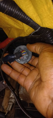

maiks wrote: Fri Dec 27, 2024 7:23 pm Yes my f18 connector was damaged.
How was it damaged? How was your mating connector okay? Pictures would really help everyone.

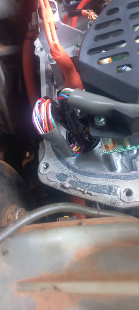

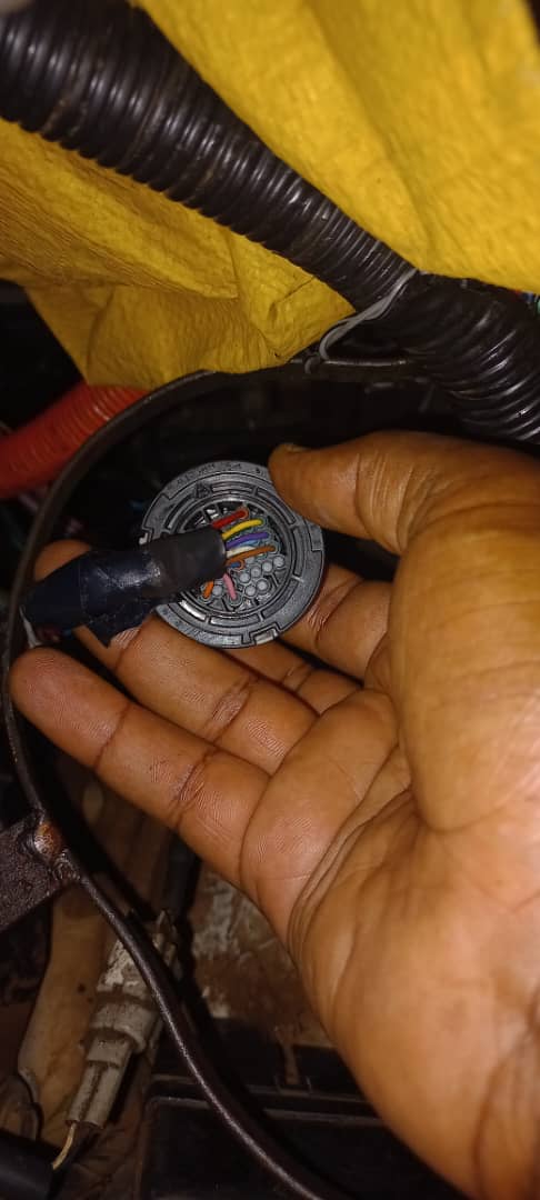

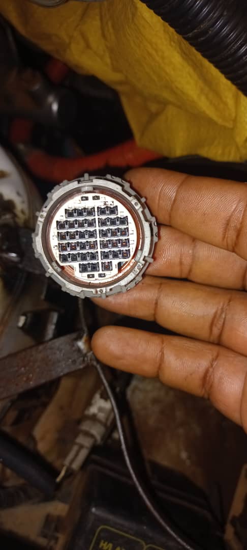

The pinout is correct and l followed it to trace wires inside the pdm, cut them and made a bypass .
Apologies for the delayed response; I’ve been on holiday.
After performing CAN logging, I discovered that the PDM wasn’t communicating. I opened the PDM and found that the voltage wasn't reaching it. I traced the wiring and created a bypass, as mentioned earlier. The bypass was connected to the female connector, as shown in the attached "open_pdm.jpg."
I apologize for not taking more clear images that would better show the bypass setup.
