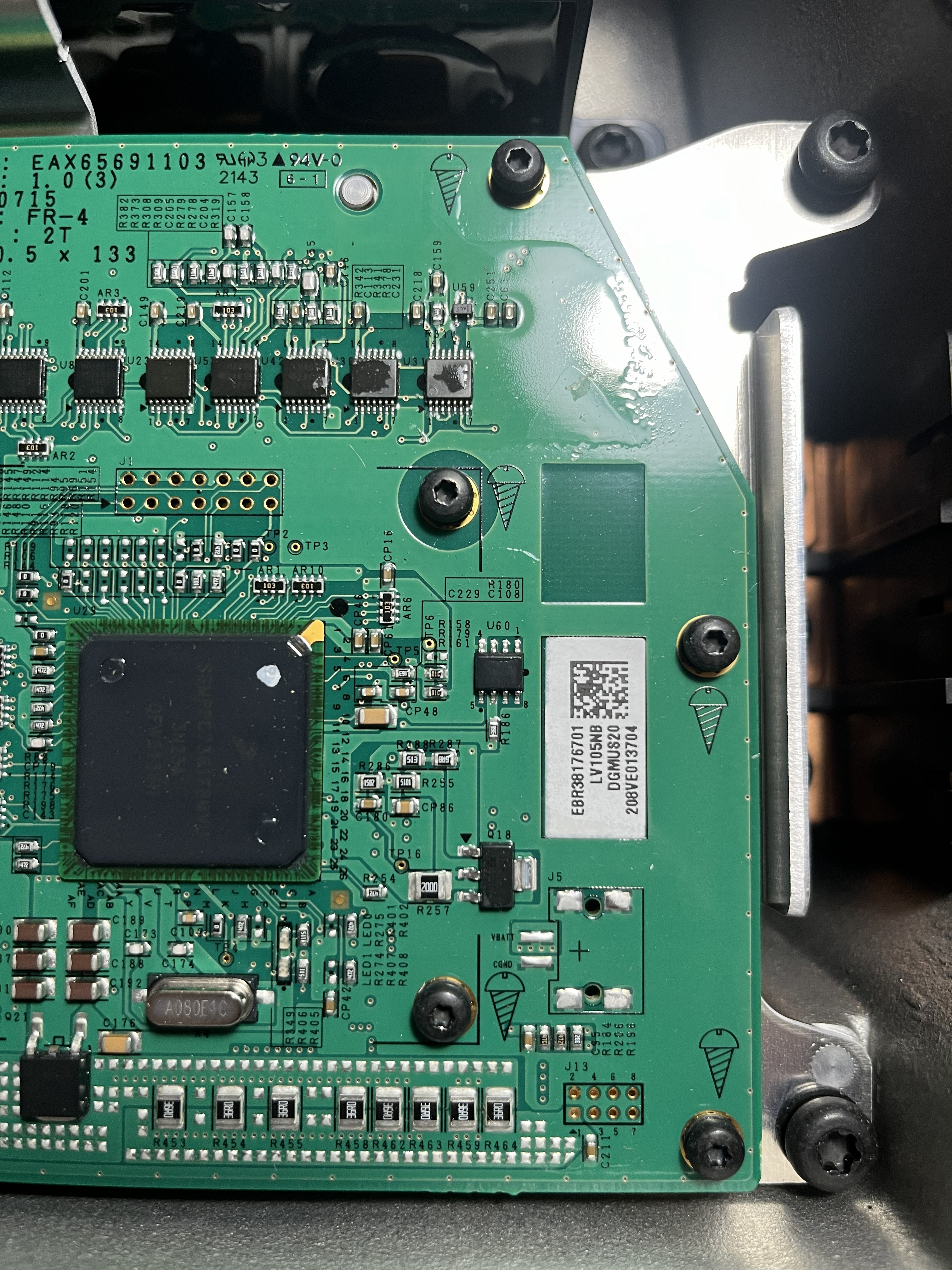

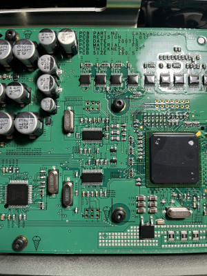

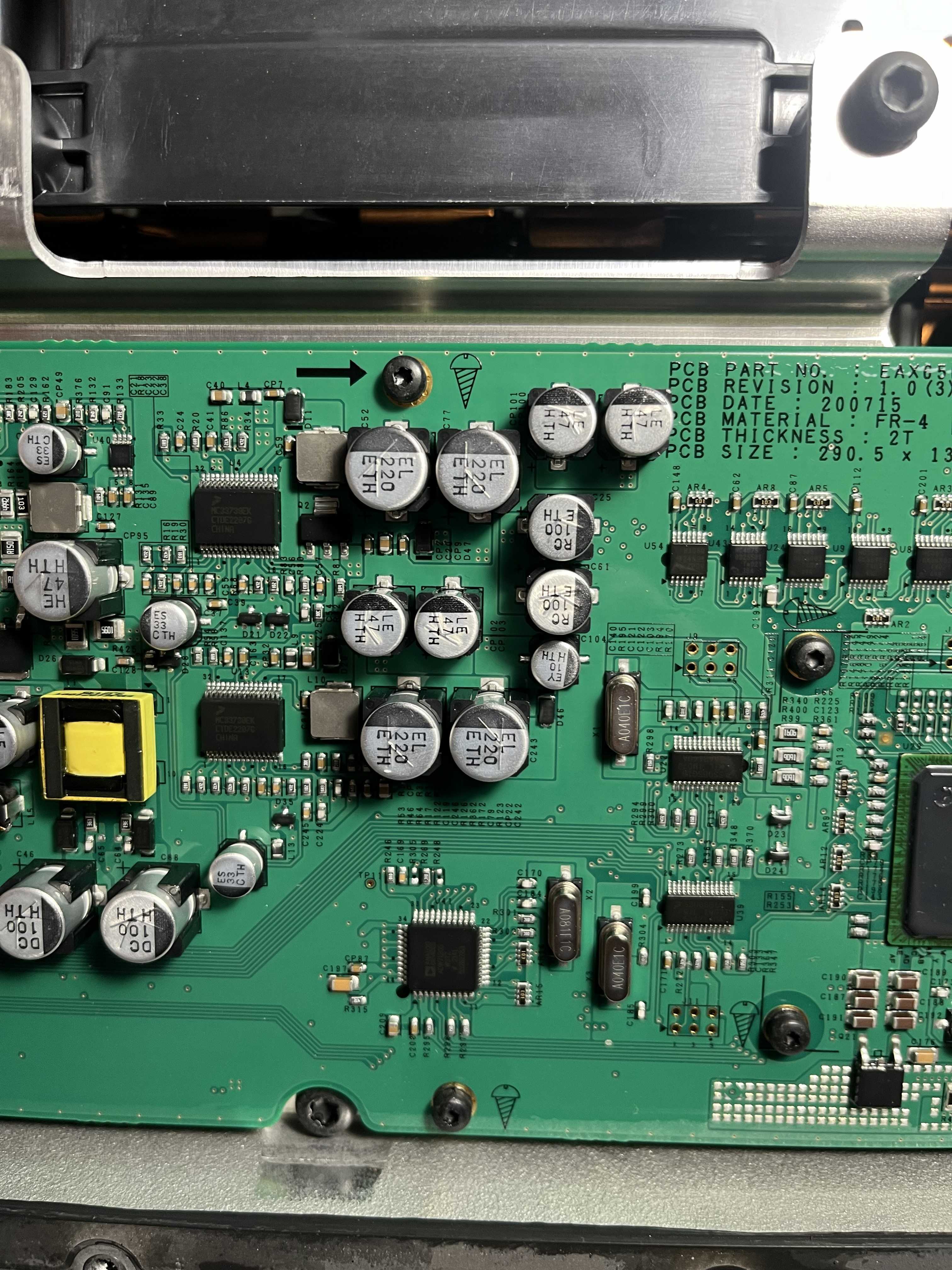

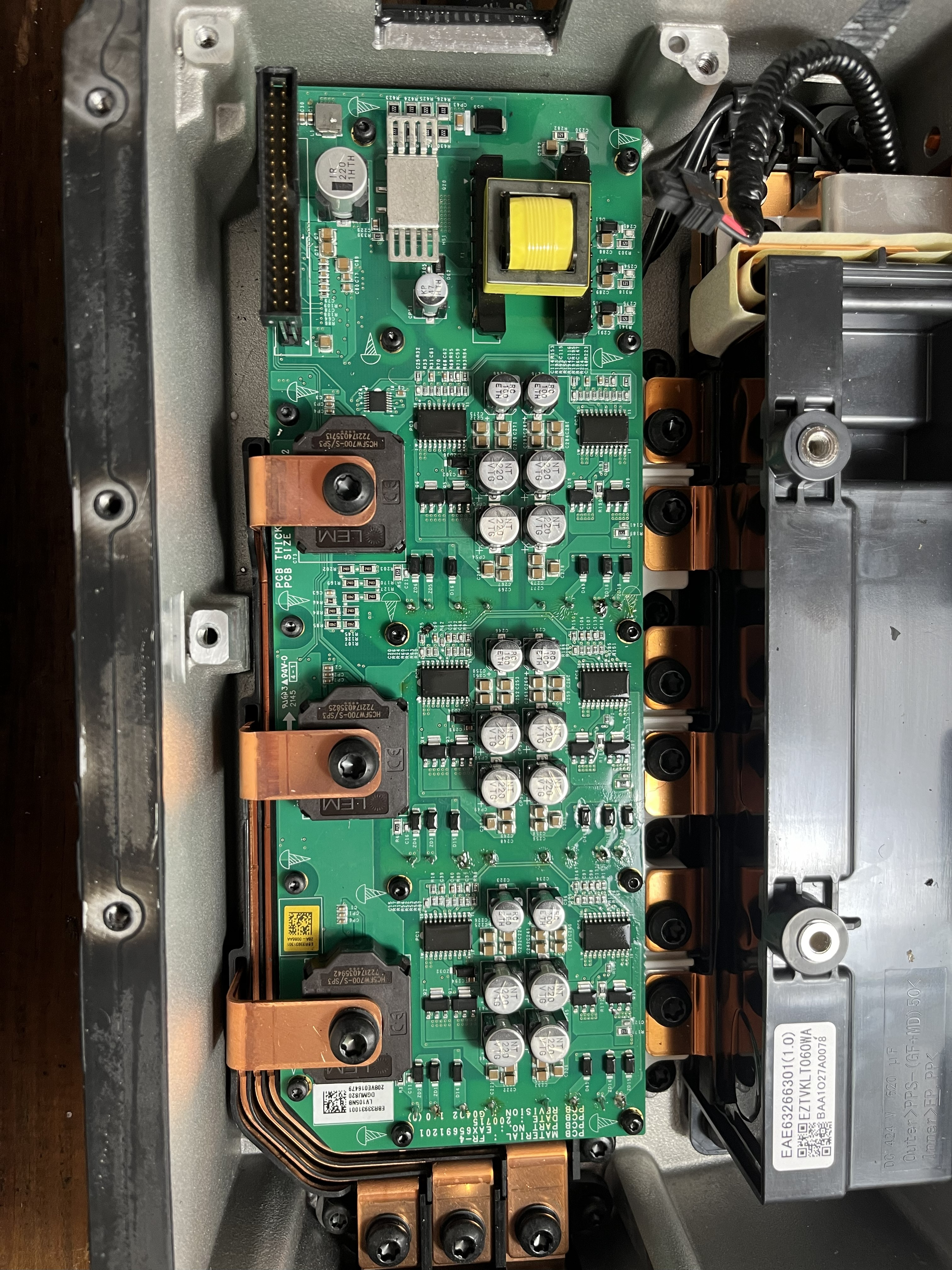

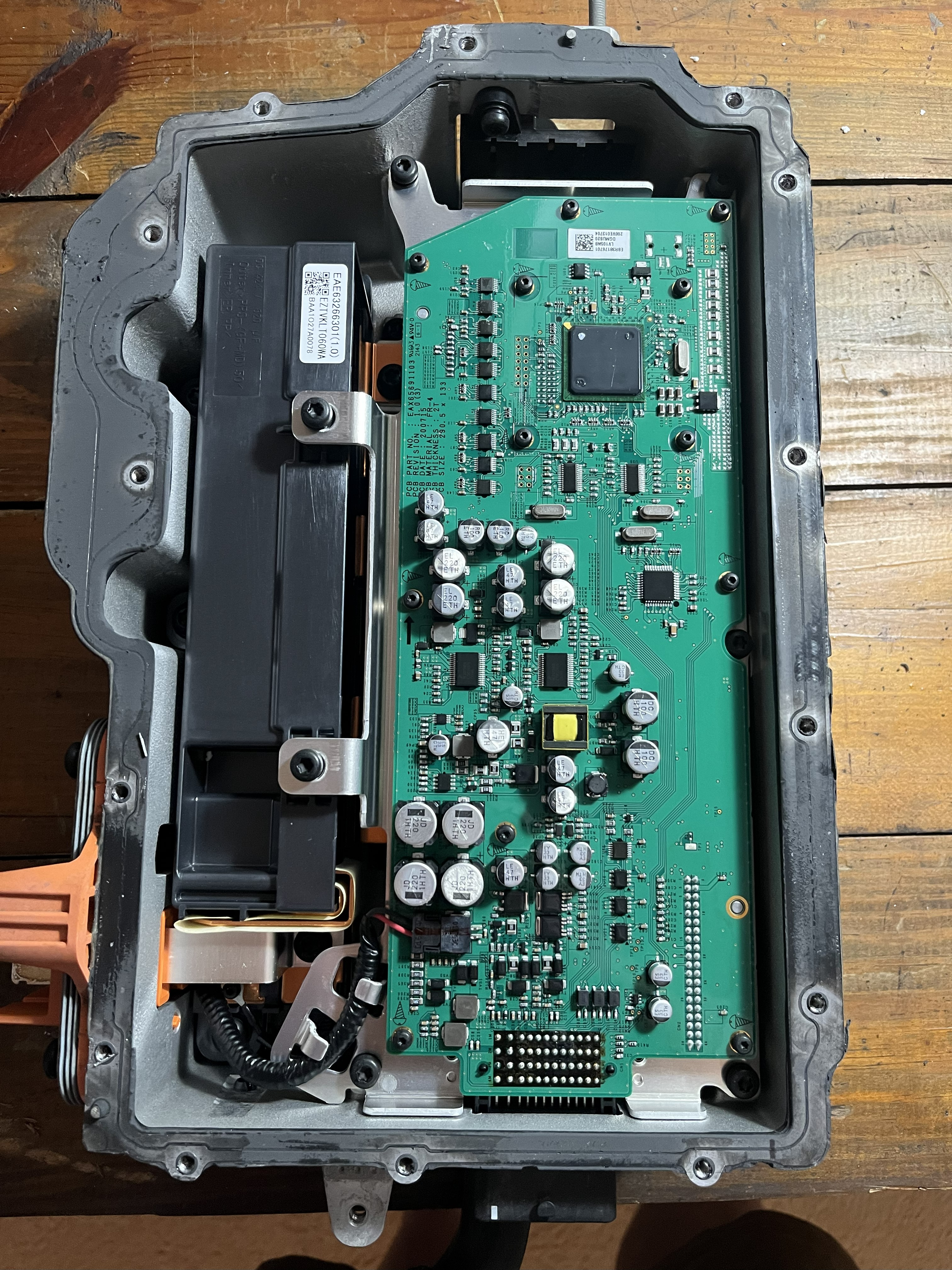

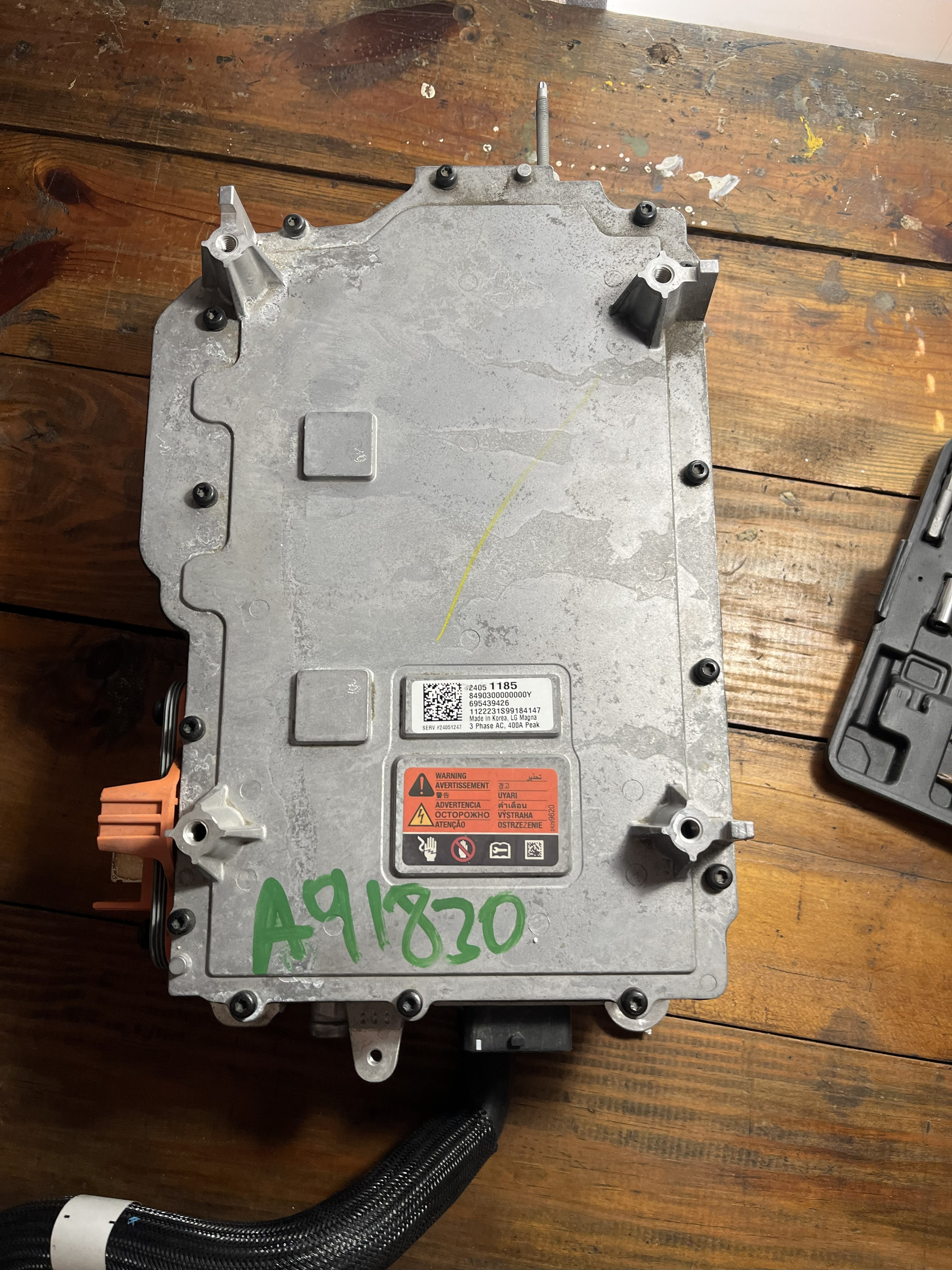

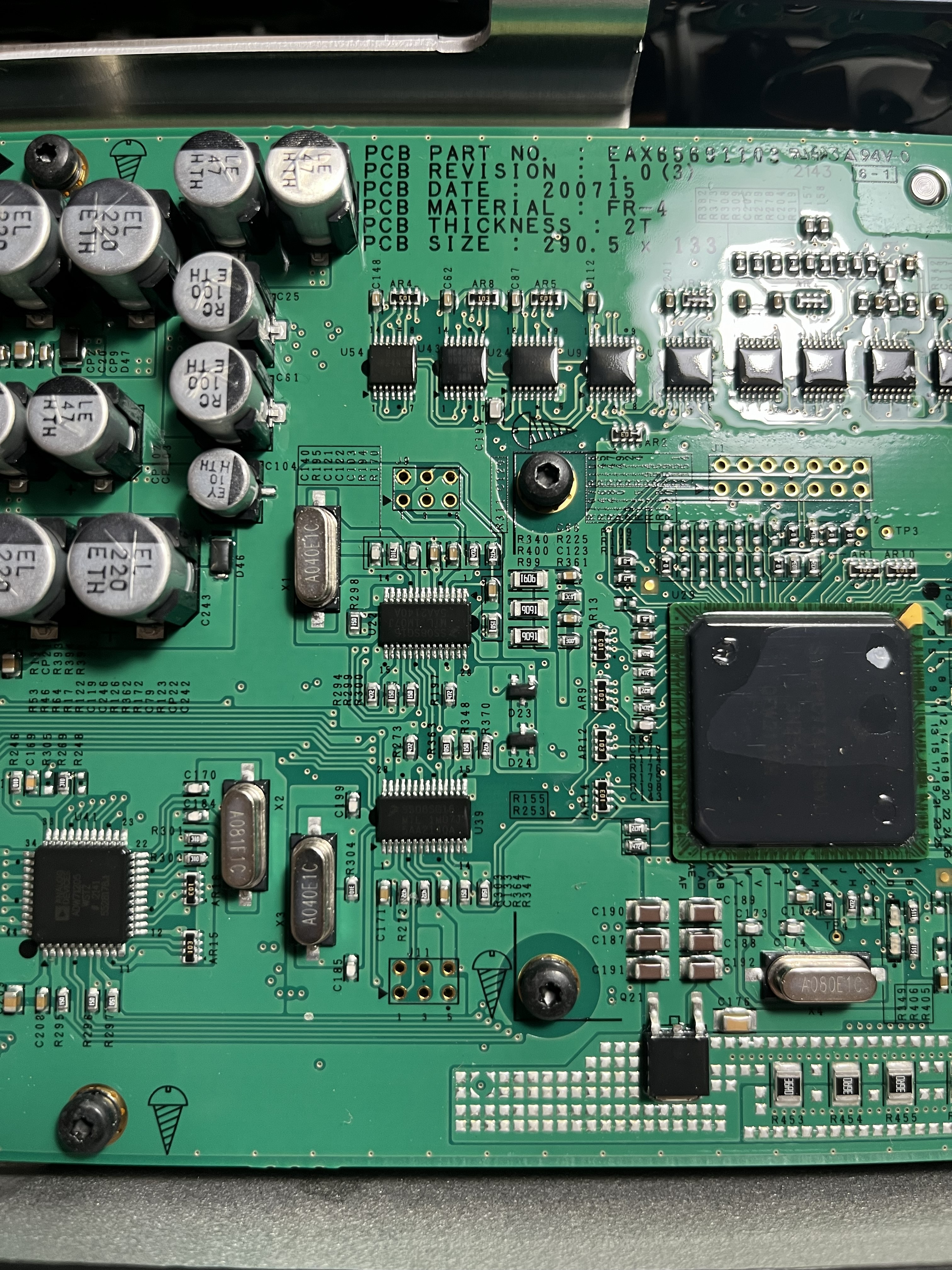

Alright so I got my inverter torn just about as far apart as I want to go right now. I've basically taken the approach of "let's see what we can see, and take lots of photos." Here's what I've found:
First, here is the exterior, with the part numbers that I'm looking at. Who knows which numbers are actually the part number, thanks GM:

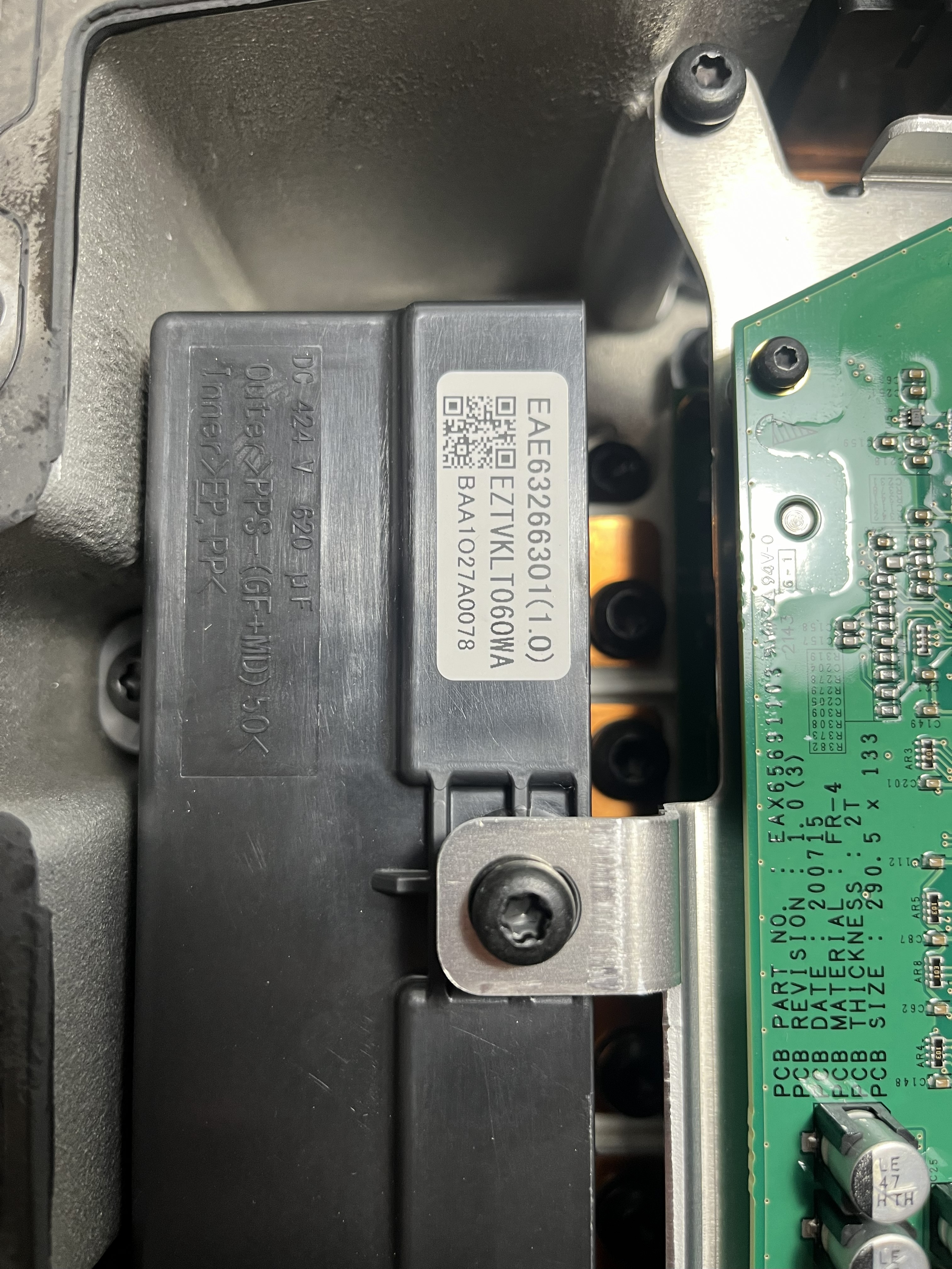

Once you pry off the lid (which has a very strong adhesive) it looks like this should be fairly simple to disassemble, but you'd be only partially correct. Yes, most of it is bolted in place, but the main 12V connection (bottom side of the image, black square) is soldered in after the board is installed, and must be unsoldered to remove the top board. The connections to the lower board are thankfully via a header, and no de-soldering is required there. Side note, fighting to remove this solder likely damaged some of the traces on this board, so unlikely I can play with the CAN logs on this unit.

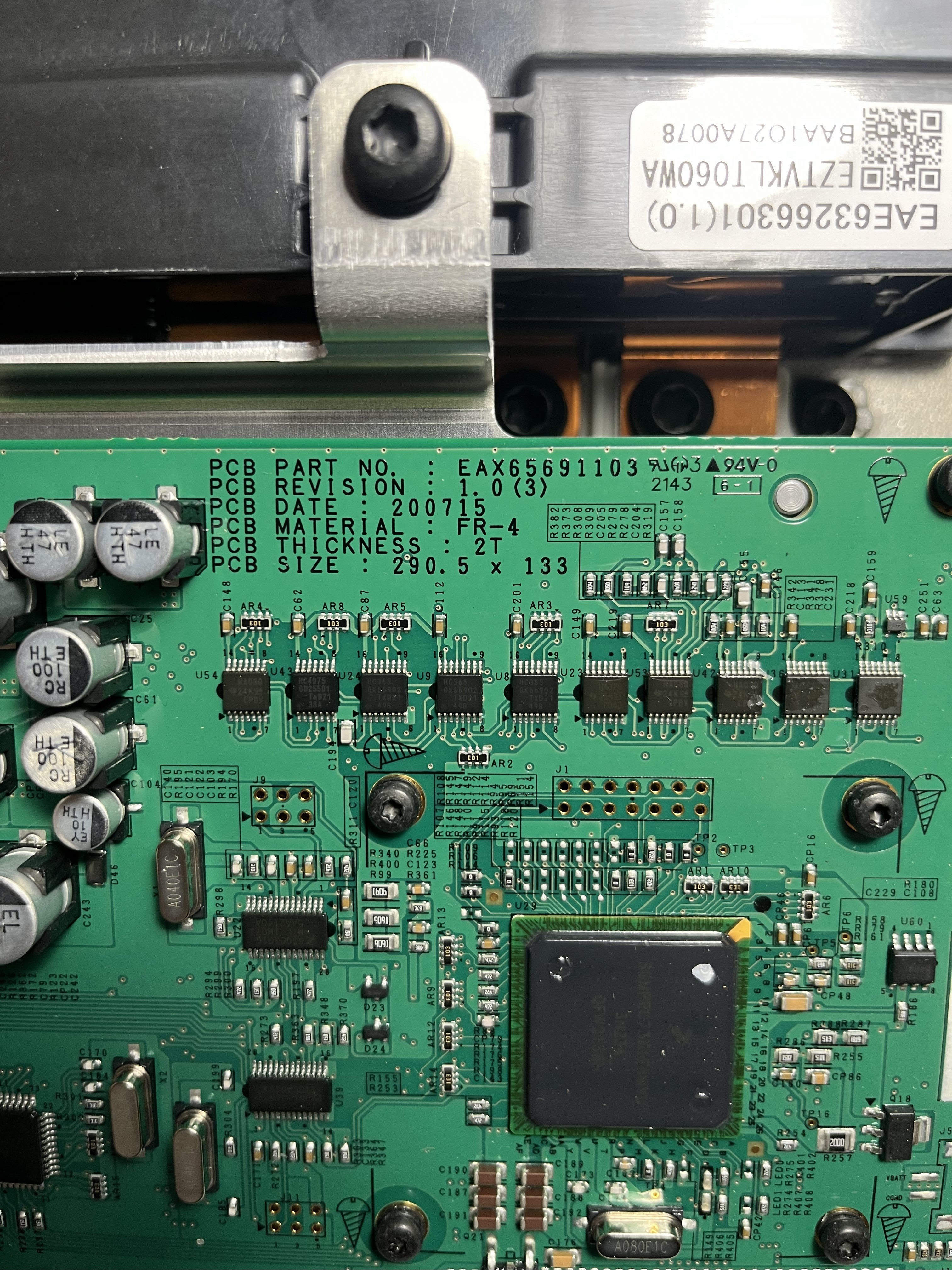

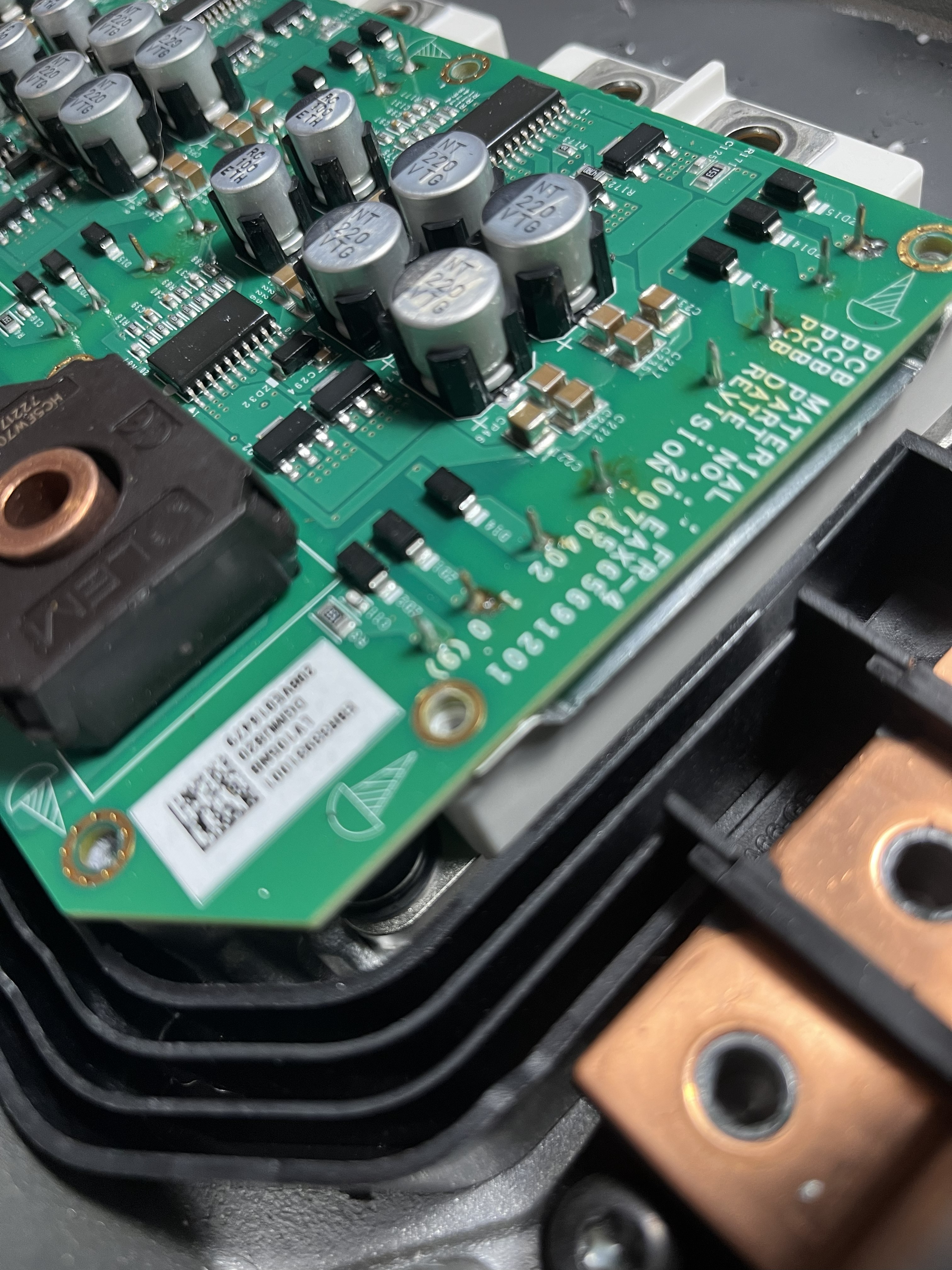

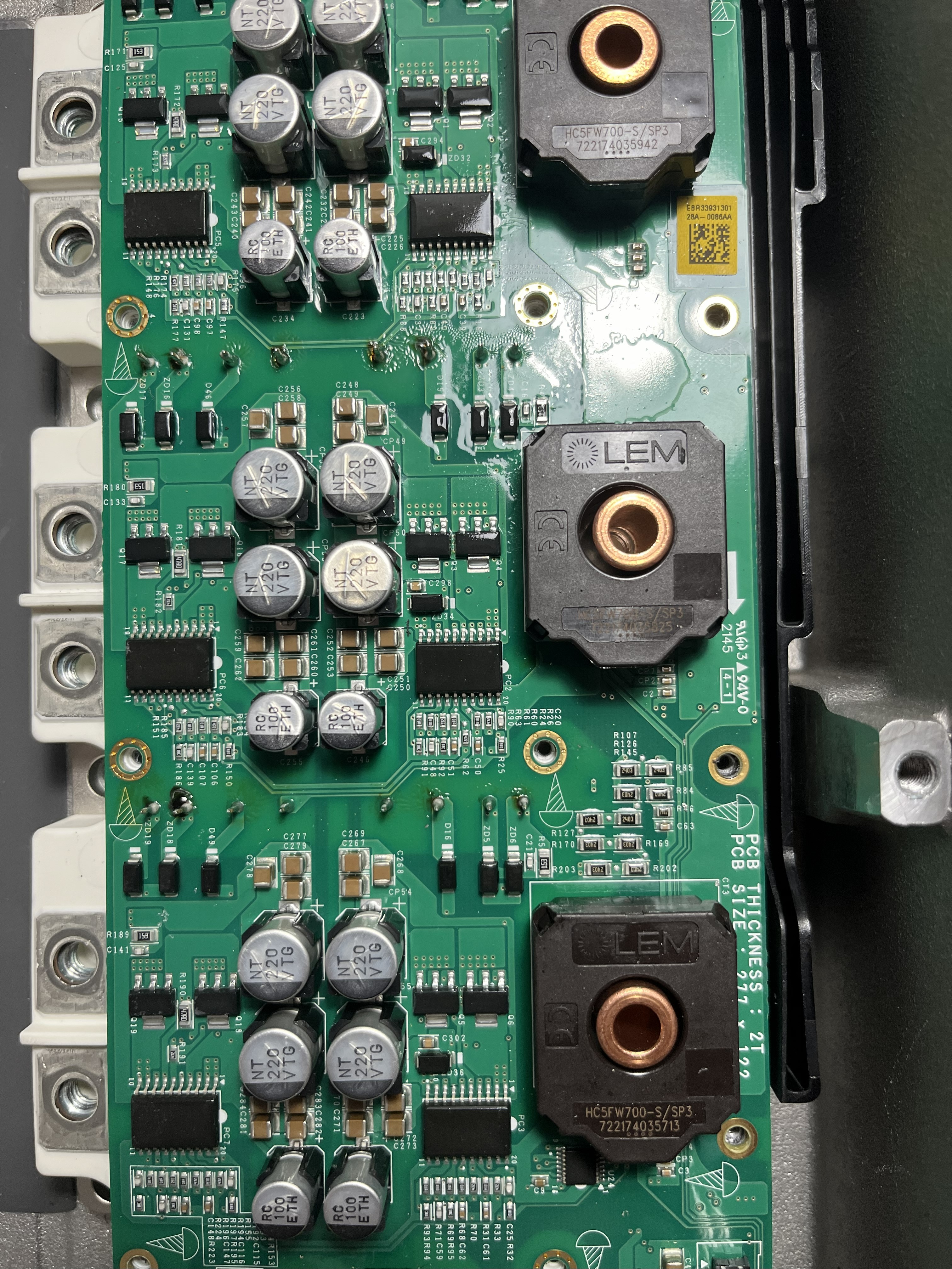

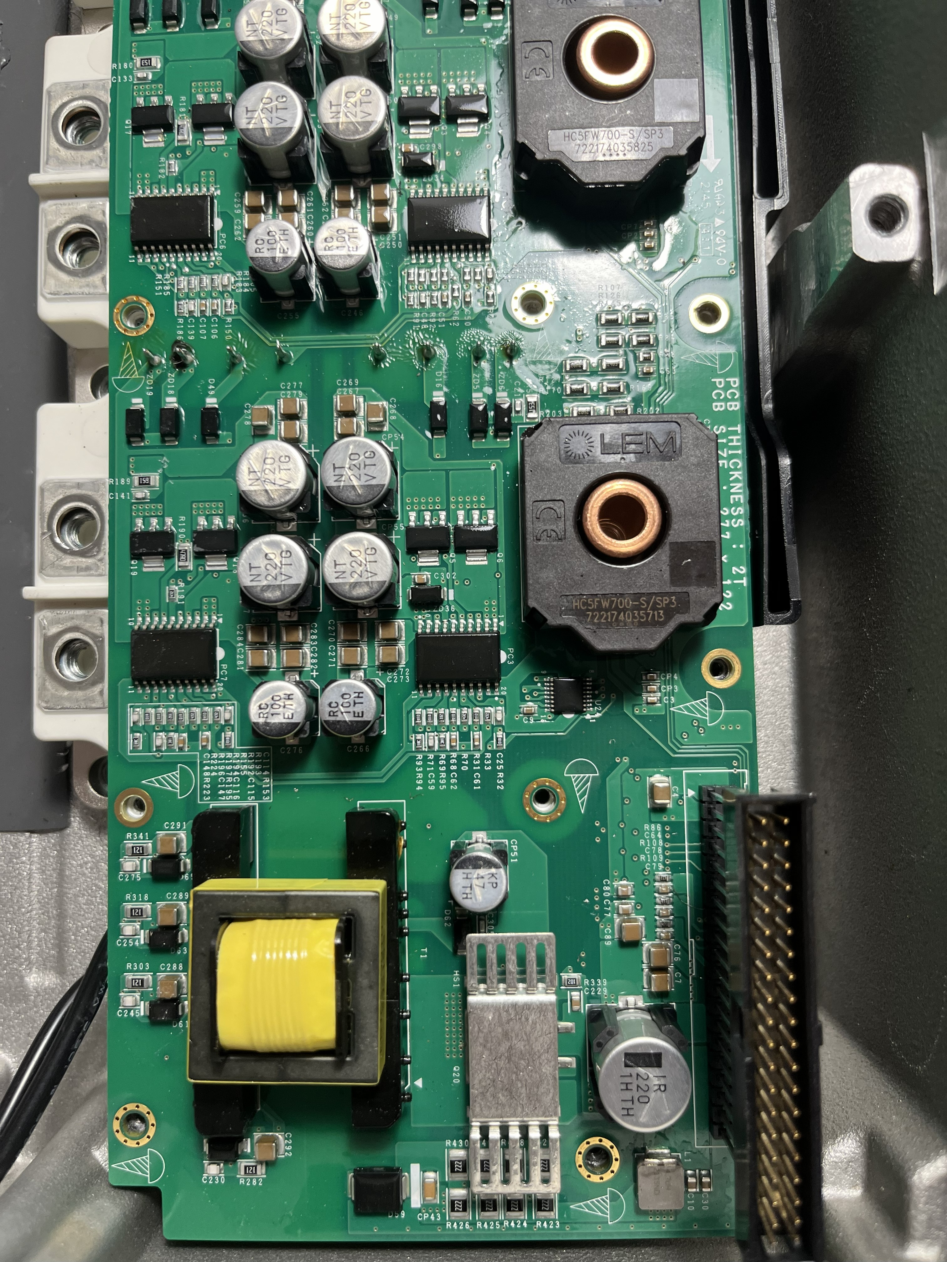

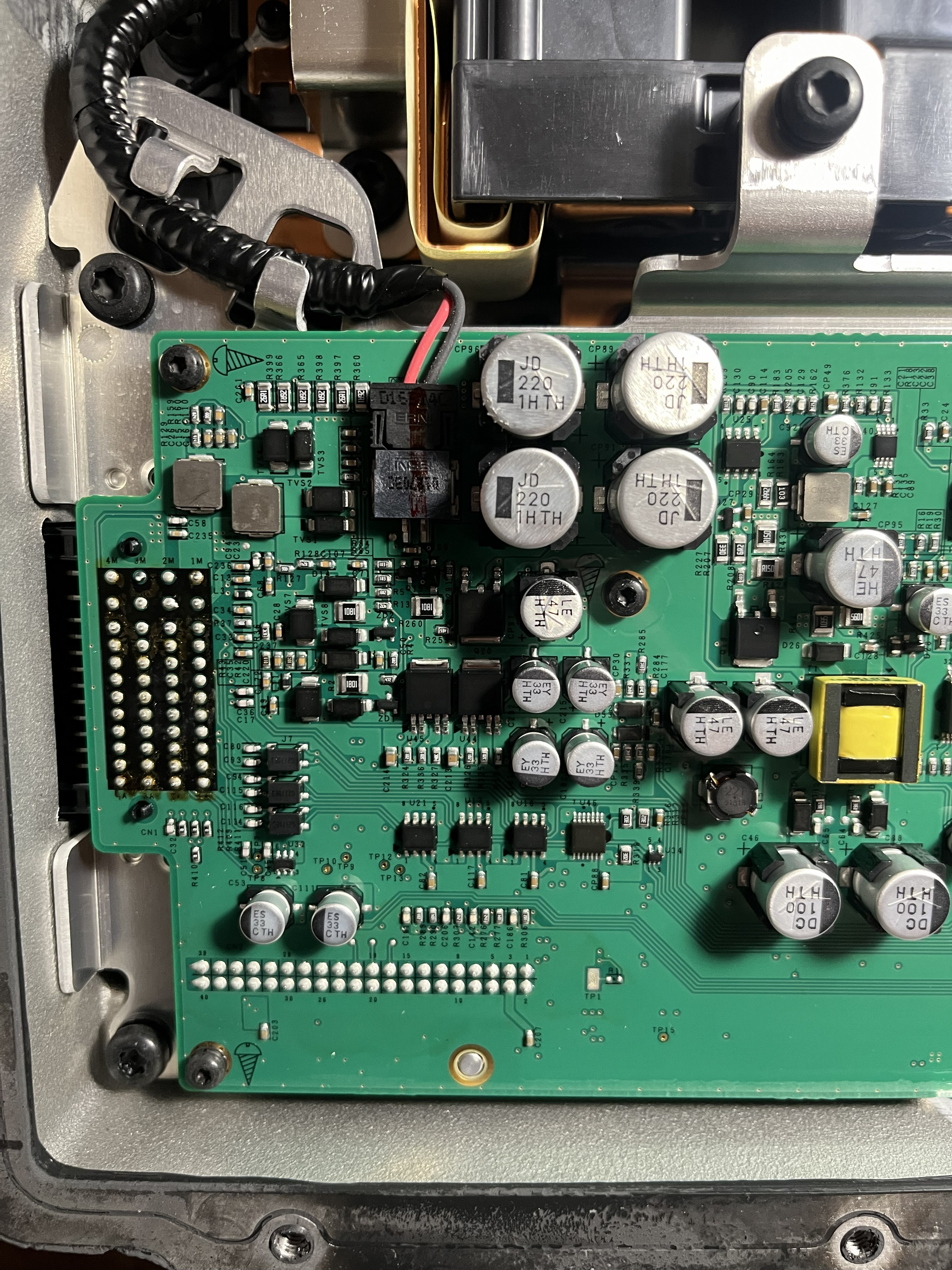

Here are detailed photos of the upper board. Helpfully, they've even printed information on the board's fabrication on it.

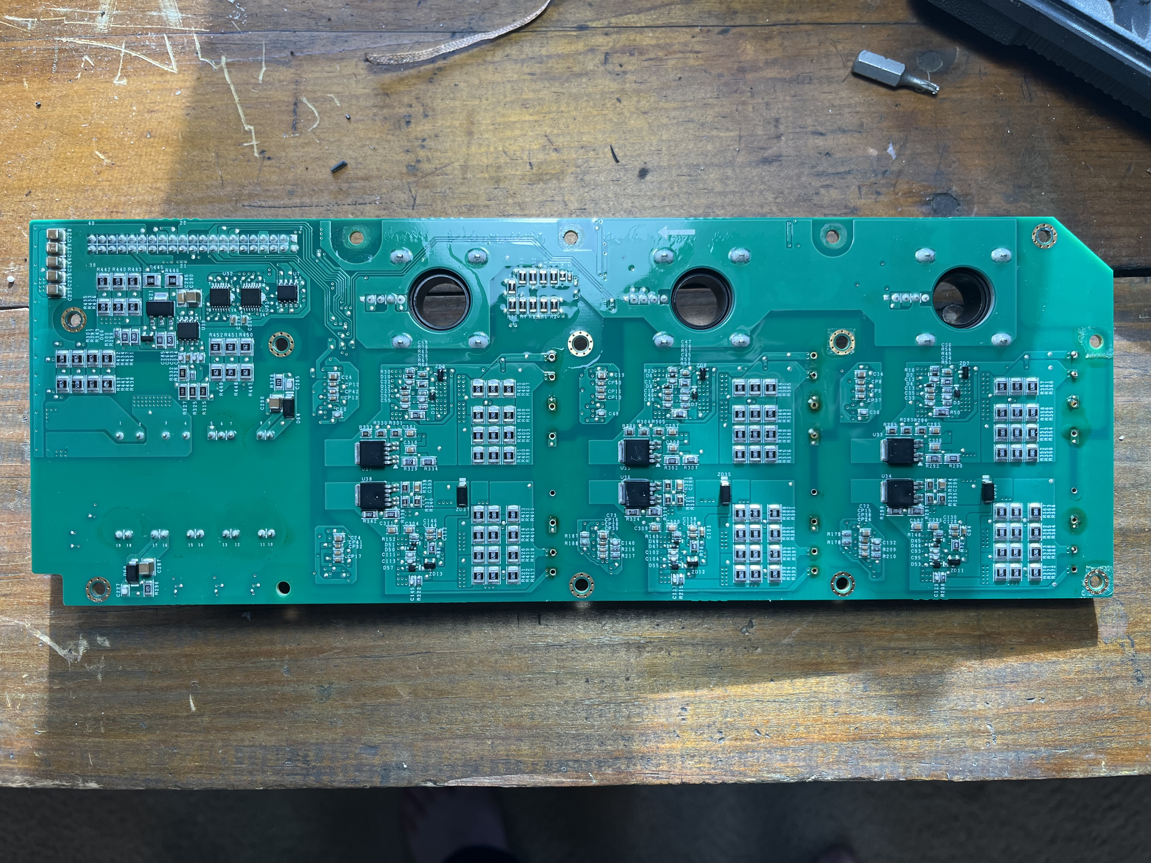

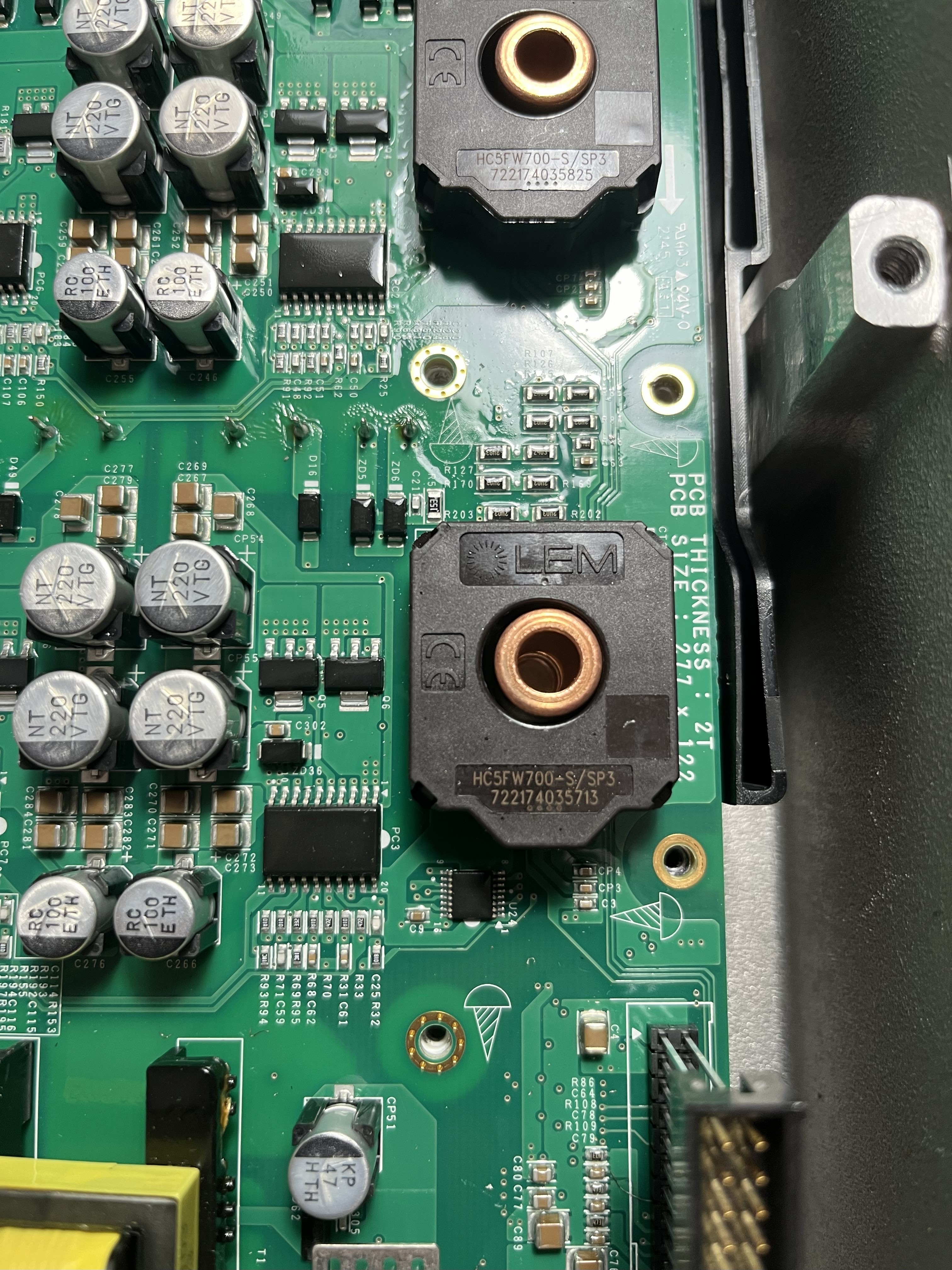

Then there's the lower board. It looks like this can be unbolted, but once again, thwarted by soldering to the switching electronics below. But wait, can we unbolt those from the case, like we can the capacitor and bus bars? No, we cannot, as some of their bolts are covered by the lower PCB itself.
Here are detailed photos of the lower board.
In my uneducated opinion, it looks like we have a separate brain board and gate driver board, so maybe we can simply modify an existing Damien design to drop in place of the upper PCB. Anyone who knows what they're looking at, please chime in here, otherwise I'm going to have to actually go over the local community college and get another engineering degree to figure some of this out (only half joking here). If it would help to see the switching electronics, I can de-solder the lower PCB and pull it off. Also, if there's anything you see that I should probe/measure, let me know. I've recently gotten an oscilloscope, and I'm hoping to pick up a bench power supply soon. The joy of living alone is I can turn my entire guest room into an electronics lab for this silly hobby. I'm going to see what I can figure out from some googling and poking around, but I definitely am going to need some help with this.

Yes, the two boards are exactly as you described. One board does the master control and interfaces with the rest of the car. The other is a driver board that fires the transistors and reads current on the three phases. Those LEMs are high speed current sensors used for fine control of the motor.
And, yes, it is almost certain one could replace the upper board and leave the bottom driver board alone. This would require reverse engineering the pinout of the 20x2 connector on the lower right. There are six IGBTs to fire and each would have its own ground so that's 12 pins right there. Then probably desat for each of the 6 and some means of sending the three phase currents. 12 + 6 + (3 * 2) = 24 pins needed so far in my guess. Then you would also have power to drive things not isolated so probably two more pins for that. All in all, probably at least half of the pins do something.
Make no mistake, any path forward is a lot of work. To replace a board you still need to know what it did and how it worked. I have actually done this before though. I once reverse engineered an Azure Dynamics DMOC645 power section and used it to drive a custom permanent magnet motor by using my own control board. So, it's possible, it just takes some time. Basically you'd want to trace down the function of each and every pin in that 40 pin connector to see where it goes. It's fairly safe to probe around with a multimeter in continuity mode.
Another thing you'll want to do is try to determine the part # of every chip you can. It helps to take pictures from different angles to find one where the text is legible. Then try to get the pinout for the chips and see what makes sense for each pin. It's a long process but kind of interesting.

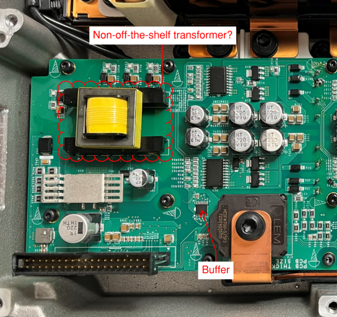

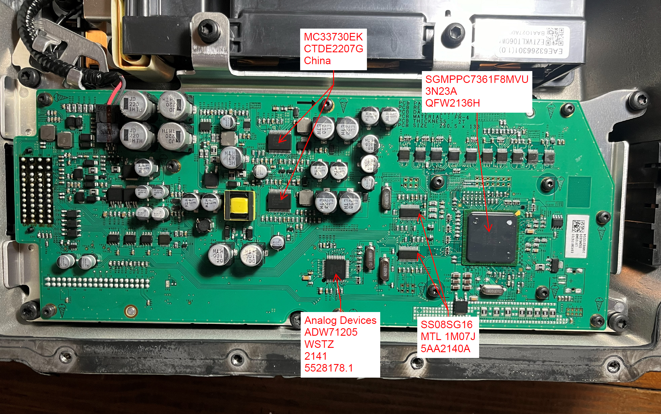

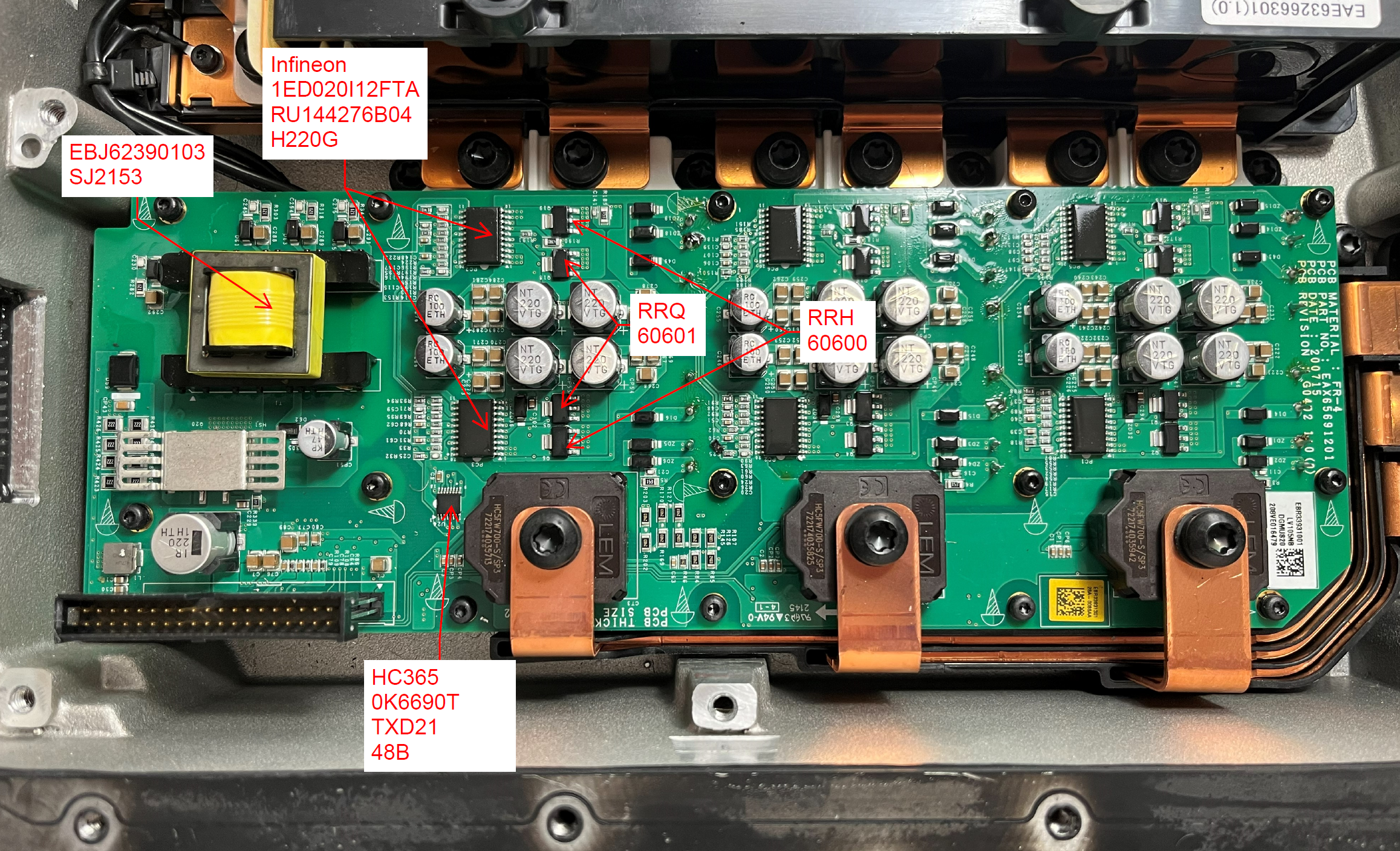

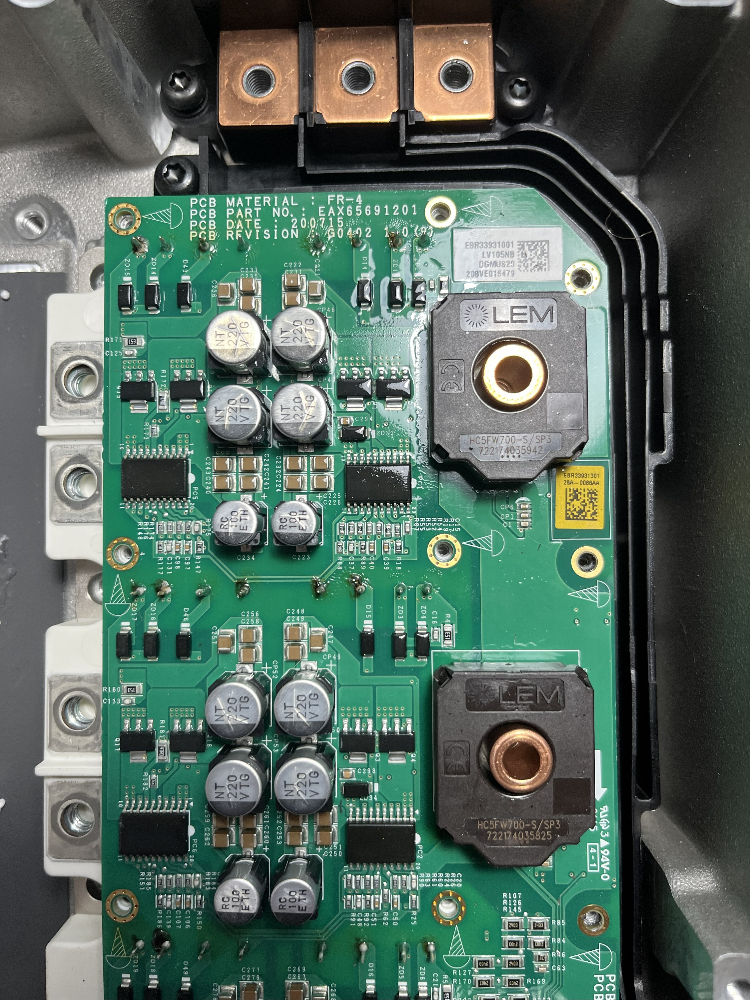

Alright, some real progress (I think)
I scratched off the lacquer on a bunch of components, and got part numbers for them. They're in the photos below.
I also fed them into ChatGPT, to see if that would help track down information/teach me a bit about this stuff. Here's what it had to say:
FULL COMPONENT IDENTIFICATION (Using your PDF Markup)
1. MCU / Logic Interface: Freescale (NXP) — MPC5777C
Marking:
SGMPPC7361F8MVU 3N23A QFW2136H
This is an NXP MPC5777C, a 32-bit Power Architecture automotive MCU.
Specifically designed for traction inverters
Features dual lockstep cores, motor-control peripherals, safety functions
Loads of ADC channels
Built-in PWM modules for 3-phase gating
Often used in GM powertrain applications
👉 This confirms GM did not use an external DSP — the MCU directly generates all PWM timing and reads the gate-driver faults and current sensors.
This will guide your replacement controller design.
2. Gate Drivers: Infineon 1ED020I12-F
Marking on PDF:
Infineon 1ED020I12FTA
These are Infineon EiceDRIVER™ 1ED020I12-F devices.
Key points:
26 A / 52 A peak gate drive capability (very strong)
Single-channel isolated gate driver
Designed for IGBT/SiC high-voltage modules
Has DESAT protection, Miller clamp, and soft turn-off
Reinforced isolation
~1200 V isolation rating
On this board, each phase has two of these —
one for the high-side switch, one for the low-side switch.

3. Current Sensors: LEM HC5F / HASS-HT Family
Marking:
HC5F700-S SP3
This is a LEM Hall-effect current transducer, likely >700 A nominal.
Fully isolated
Analog output
Integrated magnetic core
Provides the current feedback for each phase
These feed into the MCU ADC channels via analog conditioning.
4. Isolation / Gate Driver Power DC-DC Module: EBJ62390103
Marking:
EBJ62390103 SJ2153
This is a custom LG/GM-specific transformer module.
The part is not sold retail but is clearly:
Multi-output
High-frequency
Providing isolated rails
≥3 separate secondaries (one for each gate-driver pair)
Based on the Infineon 1ED020I12-F requirements, each driver needs +15V and possibly –5V rails.
👉 This transformer supplies the isolated power for all 6 gate drivers.
5. SMPS Primary Controller / MOSFET driver: MC33730EK
Marking:
MC33730EK
This is a NXP MC33730, a multi-channel gate-driver power supply controller.
Designed for powering isolated gate drivers
High-frequency switching
Automotive-qualified
Often used with multiple isolated secondaries
Matches SMPS topology visible on your board
👉 This is the master controller that drives the large transformer.
6. Secondary-side rectifiers/regulators: ADW71205
Marking:
Analog Devices ADW71205
This is a secondary-side synchronous rectifier controller or isolated regulator (Analog Devices makes several ADWxxxx families for DC-DC regulation).
Given placement:
It sits on the secondary side near the gate-driver capacitors
Regulates the isolated gate-drive rails
Ensures stable voltage under fast gate-charge spikes

I'm hoping to use this, plus some more digging on these part numbers and tests with a multimeter to begin work on the pinout for the connector between the gate driver board and the control board.

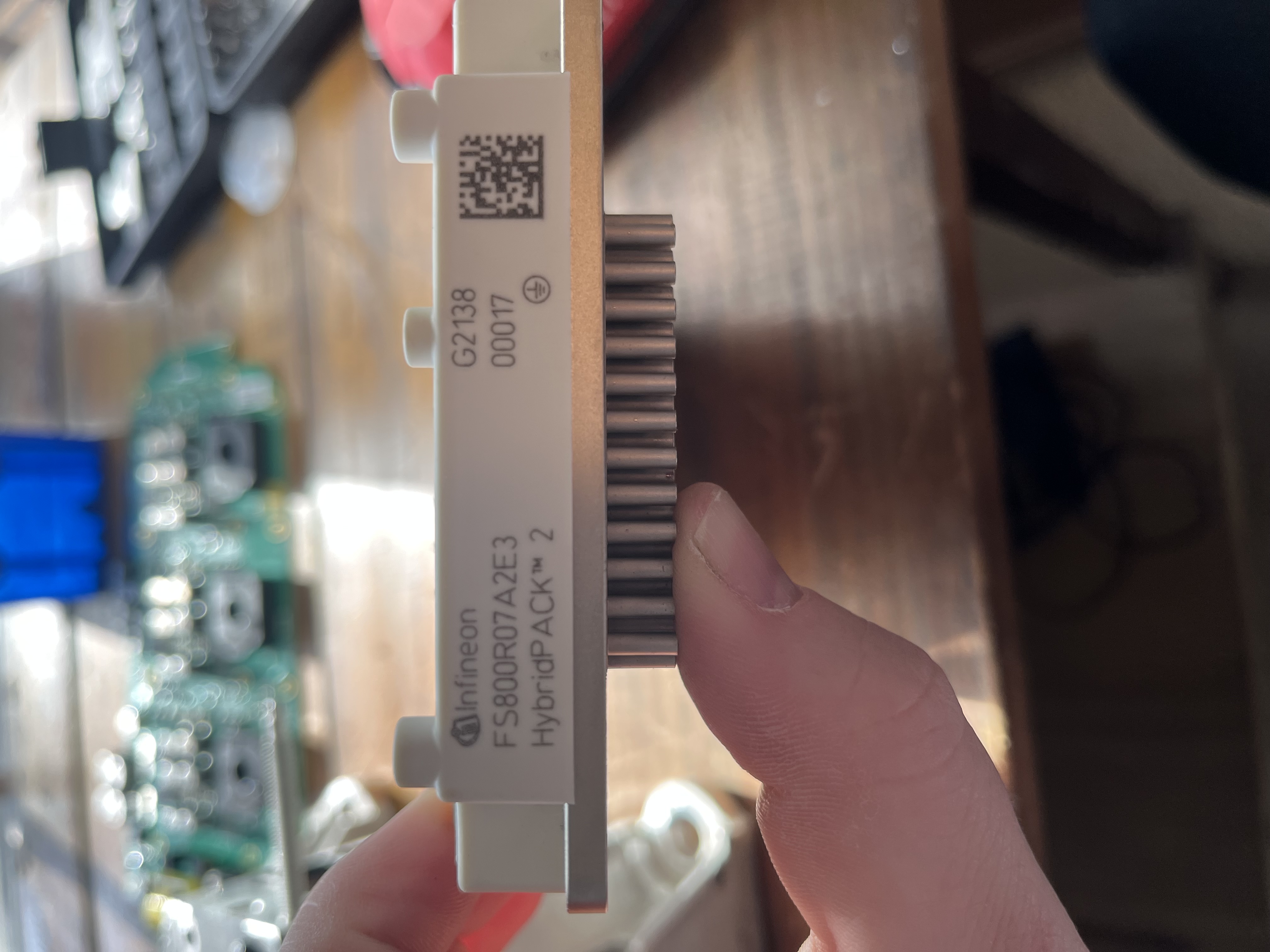

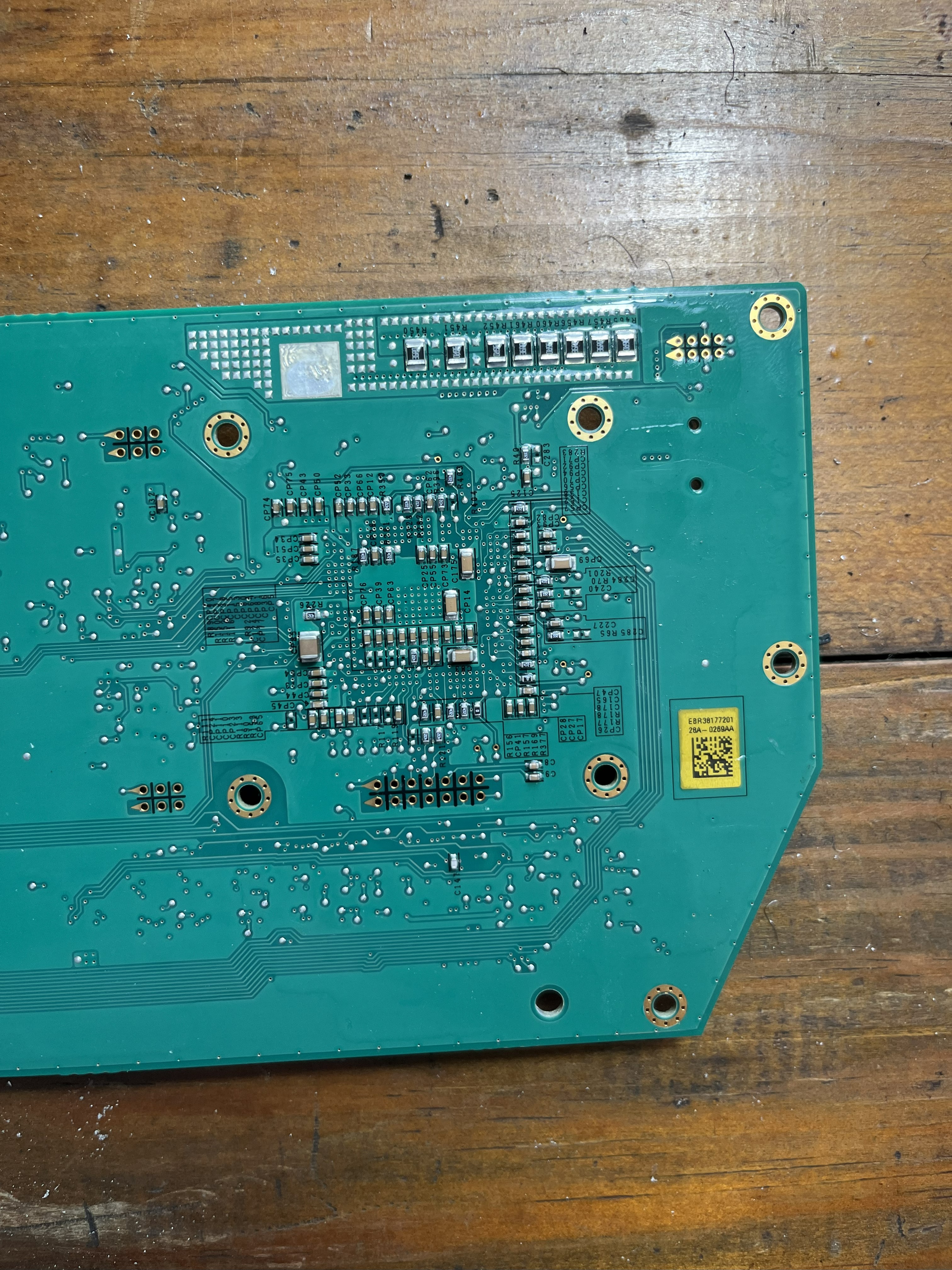

Happy New Year everyone!

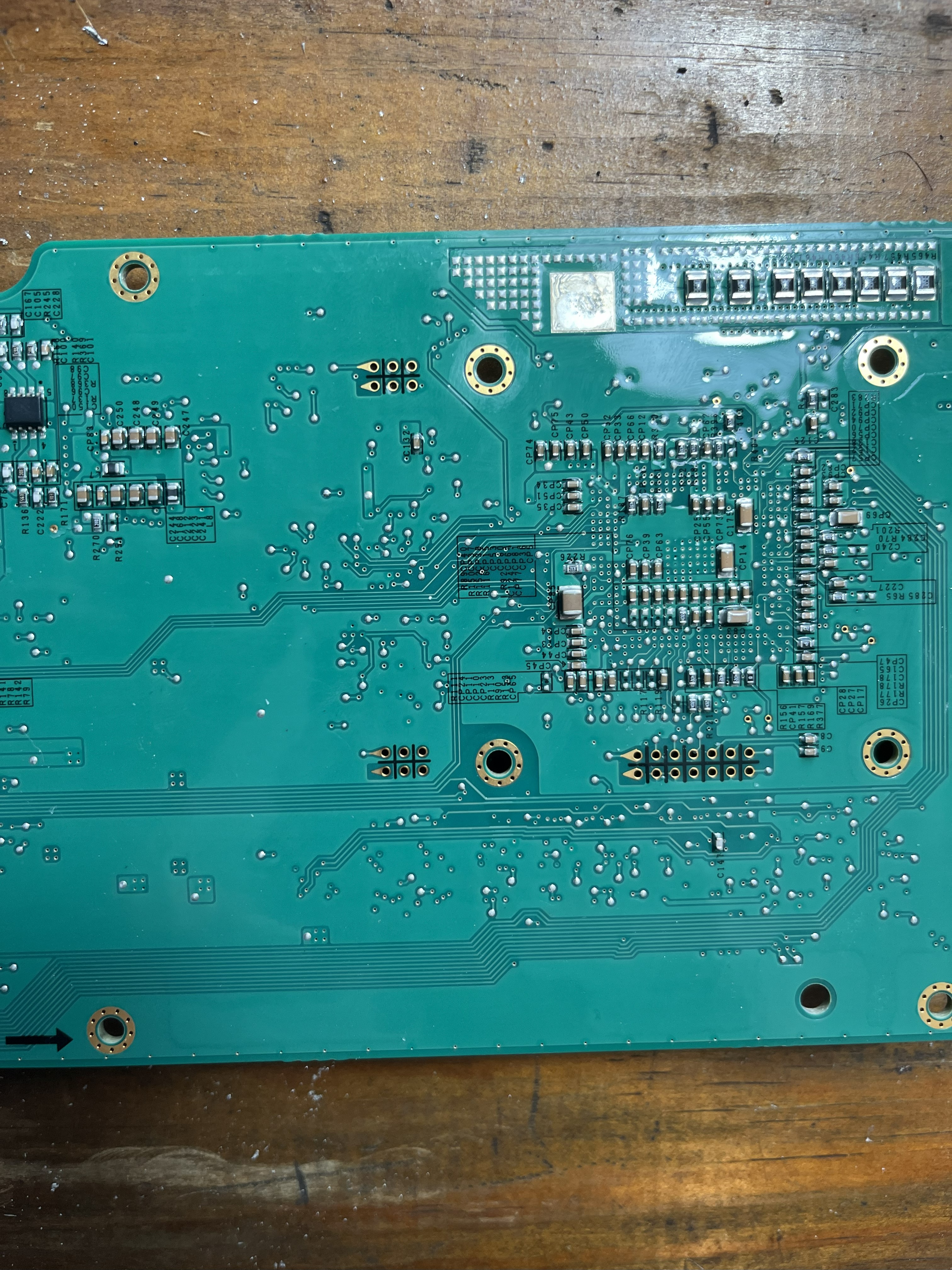

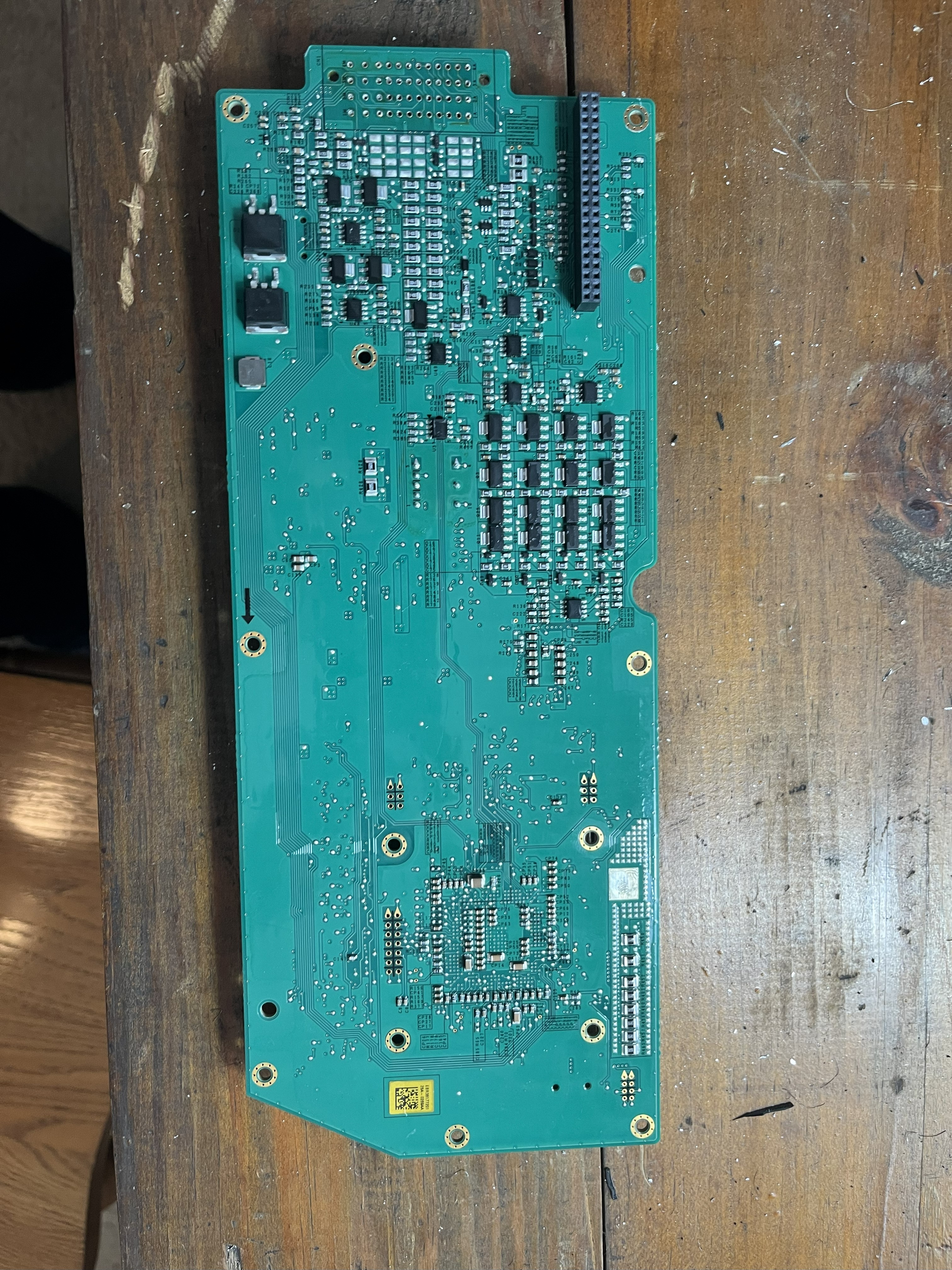

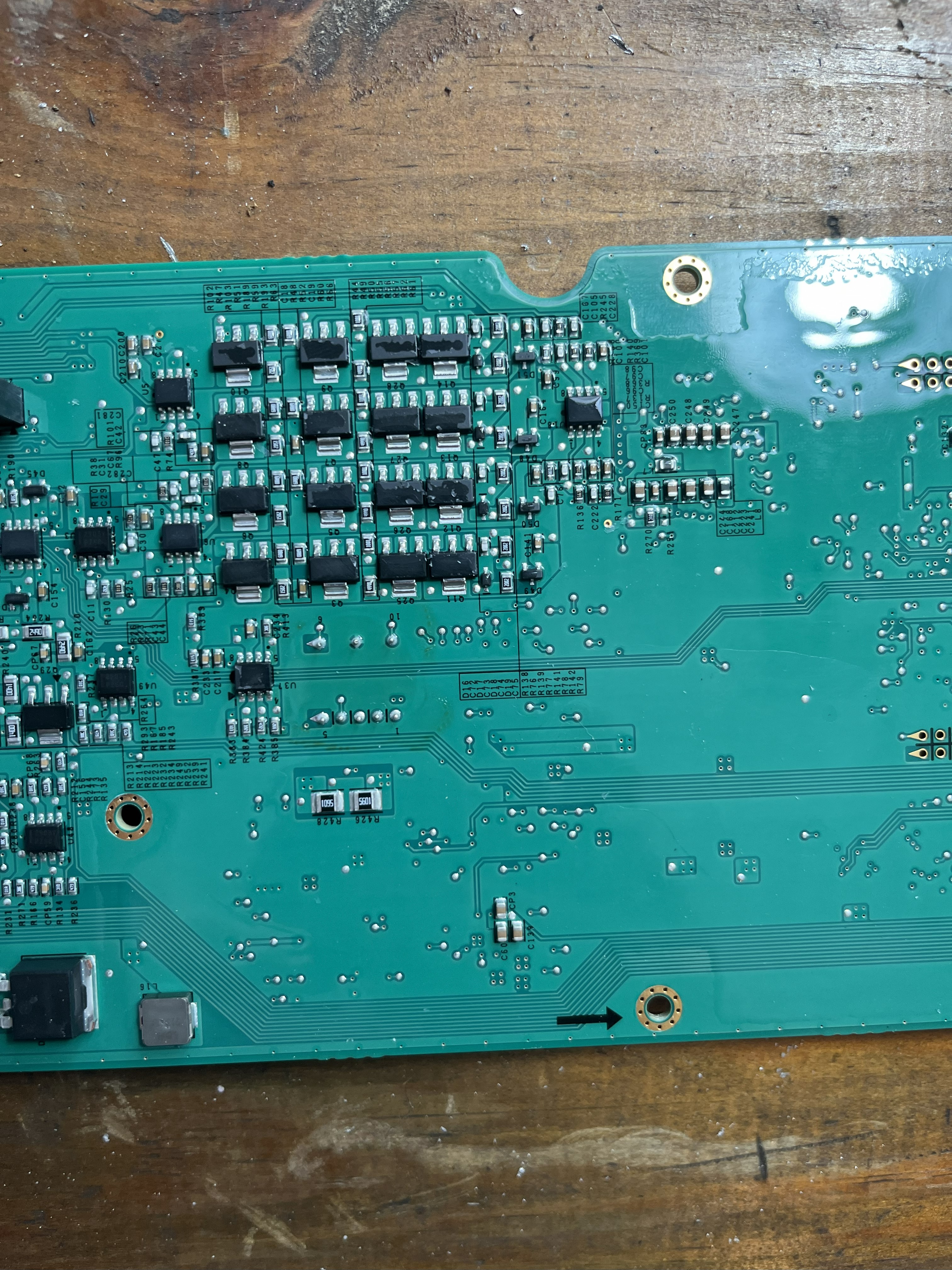

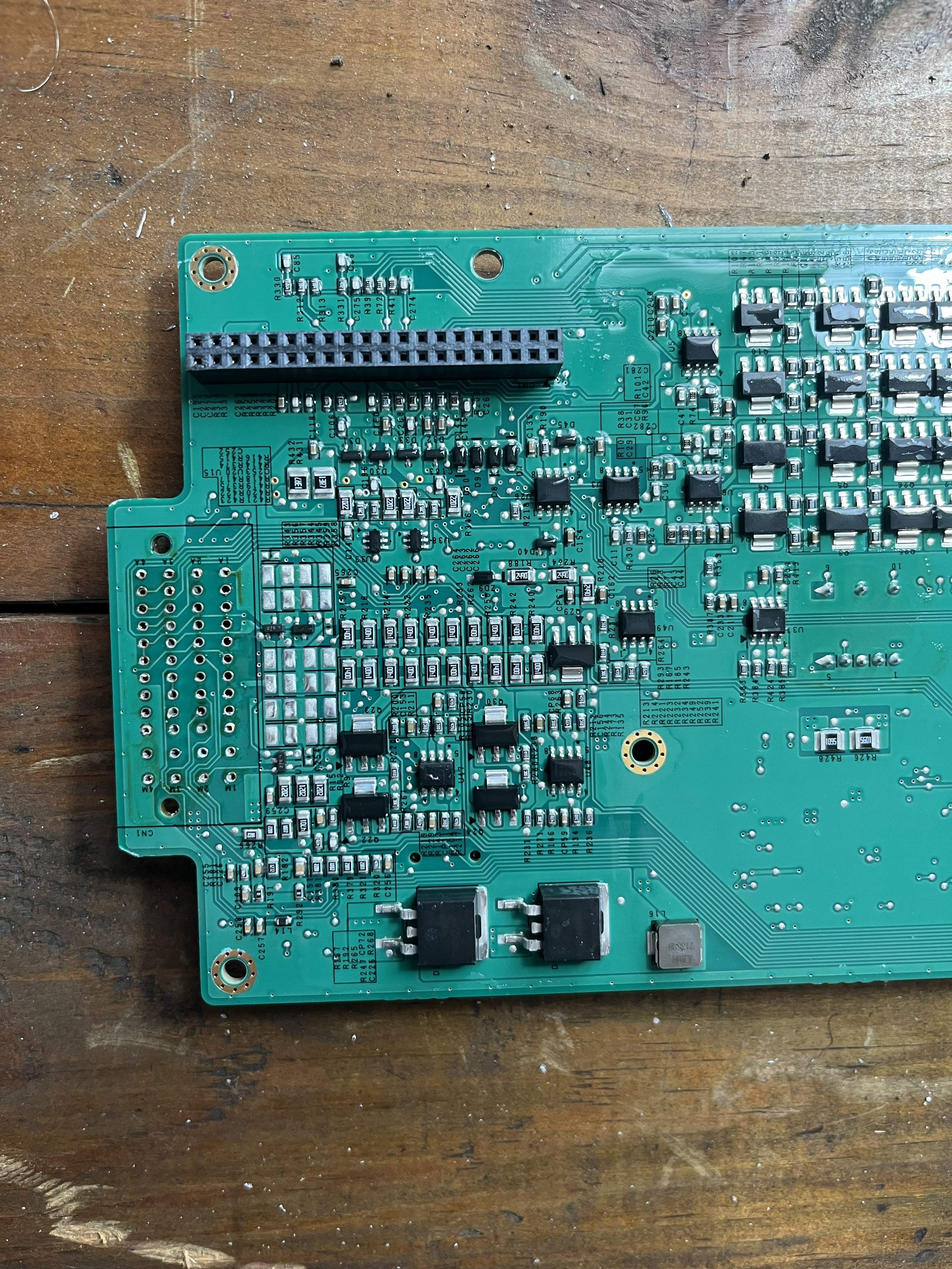

I got some more work done today, thanks to a new desoldering iron I got for Christmas. I pulled the gate drive board off so that I could get a look at the bottom and the IGBT module itself. Starting with the IGBT module, it's an Infineon FS800R07A2E3. Data sheet attached.
And here's the bottom of the board. I didn't do any digging into the newly revealed part numbers yet.
I did do some digging on pinouts for the previously identified components (attached excel file) and I'm hoping to do some tracing this weekend in order to make headway on the pinout between the two boards.
inverter component pinout.xlsx
(1.22 MiB) Downloaded 8 times
Infineon-FS800R07A2E3-DS-v03_02-EN-1226878.pdf
(783.83 KiB) Downloaded 10 times

Alright so connector pin progress!
This is the 40 pin connector between the main control board and the gate driver board. It took me a bit to realize there was a buffer chip in between the connector and the gate driver chips themselves (data sheet attached, its a TI HC365). Once I figured that out, I made more progress. Here's what I have for now, hoping to do some more throughout the week, including identifying each specific gate driven by the inputs listed below.
1 ground
2 ground
3 Vcc power pin on buffer - note: need to do more investigation on where else this is connected
4 Vcc power pin on buffer - note: need to do more investigation on where else this is connected
5 ground
6 ground
7
8
9
10
11 1A input to buffer
12 2A Input to buffer
13 3A Input to buffer
14 4A Input to buffer
15 5A Input to buffer
16 6A Input to buffer
17
18
19
20
21
22
23
24 Current sensor output, furthest phase from connector (will check specific letter)
25 ground
26 Current sensor output, closest phase from connector (will check specific letter)
27 Current sensor output, middle phase (will check specific letter)
28 5V supply to current sensors
29
30 ground
31
32 ground
33
34 ground
35
36
37
38
39 ground
40 ground
These were identified by finding continuity with a multimeter. There may be some nuances or intermediary components I still need to identify.

collin80 wrote: Tue Jan 06, 2026 12:06 am You might find that there are transformers or special capacitors need the high side drivers. They may live on the other side of an isolation barrier of some sort. You mention buffers so I'm thinking this is what you're finding. There are buffers and isolation barriers at appropriate places.
Yeah, there is what looks to be a transformer, but the part number is clearly not an off the shelf part, as Googling it brings up nothing relevant.
The image below shows the buffer chip and the transformer. I think the whole section directly above the connector is related to the power supply. I need to learn a bit more about this and do a bit more probing.
There's also a smaller yellow transformer up on the main control board, so I may start by tracing the 12V on that board, and from there figure out what's headed to the connector.

Alright, I need some help with this transformer. The transformer on the gate driver board is a 19 pin, likely LG-made transformer. I was able to trace a few pins to the connector going up to the main board. Transformer pins 1,2,3,4 all have continuity to pins 31, 33, and 35 of the board connector. Transformer pins 5,6,7 are connected to ground.
The transformer is marked "EBJ62390103 SJ2153" but I can't find any information on this or a similar transformer. I'd like to figure out what it's expecting on pins 1,2,3,4. Does anyone have a source for this information?
In the meanwhile, I'm working on tracing the power supply on the main control board, but haven't gotten far.

The transformer needs to work with the voltage regulator. The MC33730EK looks to be obsolete, it may be best to rethinking the voltage regulator section and it's isolation transformer. Ti has some decent tools for designing them but there may be a design reference from one of the other oi boards you could use.
collin80
Posts: 118
Been thanked: 15 times
Re: Chevy Bolt Motor Control Adventures
Post by collin80 »
P.S.Mangelsdorf wrote: Thu Jan 22, 2026 12:46 pm The transformer is marked "EBJ62390103 SJ2153" but I can't find any information on this or a similar transformer. I'd like to figure out what it's expecting on pins 1,2,3,4. Does anyone have a source for this information?
The unfortunate truth is that transformers are often custom made for the application. Those numbers may only be meaningful to the original manufacturer.
It would be best to see if you can trace out the way the transformer works by figuring out which pins have continuity to other pins (on the transformer). The idea is to determine how many wires there really are in there. If there are 19 pins, are there 9 separate spools of wire in there or what? Are some pins just duplicates of other pins? If you have the means, trying to figure out the resistance and inductance of all the separate spools would be interesting. The transformer looks to probably only have one or two cores. So, likely most all of the spools are more or less on the same core and thus magnetically coupled. But, they do this because they aren't galvanically coupled. That is, there is no short circuit path between the various windings. They can have magnetic coupling which allows signals to flow back and forth but only through magnetism, not via a direct connection. That can be useful in a variety of circumstances. For one, you could have one or more input windings that then power the others, probably with voltage step up or down. Or, you could send signals from one place to the other but isolated from each other. That does not look like a signal transformer, it's way too big for that. I'd guess it's more for something like generating isolated gate drive voltages.

collin80 wrote: Fri Jan 23, 2026 12:14 am It would be best to see if you can trace out the way the transformer works by figuring out which pins have continuity to other pins (on the transformer).
I'll take a look at this over the weekend. I'm also planning to try to power up the main board and see if it will output voltage on the pins that go to that transformer.
collin80 wrote: Fri Jan 23, 2026 12:14 am That does not look like a signal transformer, it's way too big for that. I'd guess it's more for something like generating isolated gate drive voltages.
I think that's correct.
jrbe wrote: Thu Jan 22, 2026 10:44 pm The transformer needs to work with the voltage regulator. The MC33730EK looks to be obsolete, it may be best to rethinking the voltage regulator section and it's isolation transformer. Ti has some decent tools for designing them but there may be a design reference from one of the other oi boards you could use.
I'm hoping that we won't need to redesign this board. From what I've seen so far, I think we just need to figure out what the control board is providing it, and then design a control board. I'm hoping that it could be a (relatively) simple port over of the Tesla LDU board, with adjustments for the specific sensors in use, etc.

P.S.Mangelsdorf wrote: Fri Jan 23, 2026 1:00 pm I'm hoping that we won't need to redesign this board. From what I've seen so far, I think we just need to figure out what the control board is providing it, and then design a control board. I'm hoping that it could be a (relatively) simple port over of the Tesla LDU board, with adjustments for the specific sensors in use, etc.
Agreed, should be able to reuse the driver board, I missed what you were trying to do. And also agreed, I think you could skip the transformer specs and look at how the driver is connected / what signals it requires / gets and avoid that whole headache.
Does that 2x20 connector have a common pitch? You may be able to get an extension cable (ide cable?) with a tap that you can carefully setup and use to tap signals / readings from carefully while powered up.

jrbe wrote: Sat Jan 24, 2026 3:04 am Does that 2x20 connector have a common pitch? You may be able to get an extension cable (ide cable?) with a tap that you can carefully setup and use to tap signals / readings from carefully while powered up.
Need to measure that, that's a good idea!
