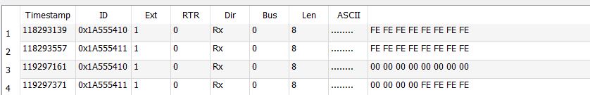

I have a hunch based on how the messages are built and the fact there are 12 cells per slave.
Having reviewed the logs to figure out which IDs are most likely from the pack master.
These are the first two ids that contain the same values for another 7 sets of ids.
Since there are 8 module with 12 cells each this sort of makes sense.
Then you see the behaviour, 16x 0xFE followed bij 12x 0x00 and 4xFE. So could this be an initialisation state and then 12 values (relating to 12 cells?) get set to zero, and remaining 4 are still in the init state due to not being used.
I would say try and spoof this behaviour onto the bus and then set the values to something else then 0x00 after the initialisation.

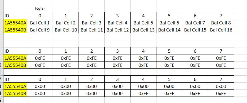

My hunch is that the message ids: 0x1A55540A to 0x1A55541F
contain a balancing command, as the table below. As a vw gte pack with a SimpBMS does not use these messages getting them onto the bus should be straight forward and can be altered for testing.
I could also just code this experimentally into the SimpBMS code, I will have a look around localy and see if I can obtain one GTE module for testing.

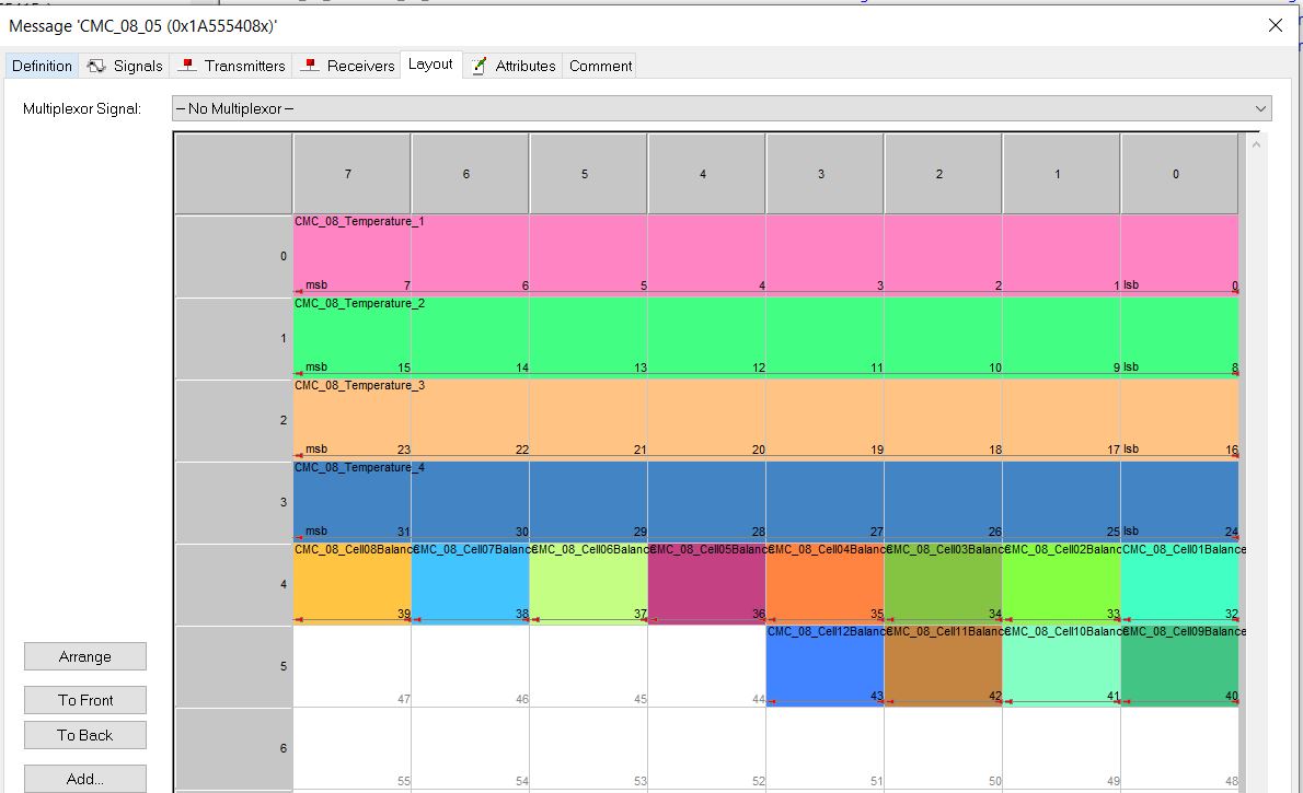

Created a DBC file to decode the Golf/Passat GTE packs.
https://github.com/Tom-evnut/VW-bms/tre ... Golf%20Can
If anyone has anything to add please push to this file so we can get more info into the DBC

So my hunch looks correct. Turns out that the message that contains the temperatures also contains feedback.
I am still working on trying to verify it actually works, my module however is at 3.69 cell volts so causing a voltage delta utilizing balancing bleeders is hard.
The findings are updated in my github, also put a crude function to force balancing on module 7 and 8 in code and this is only meant for testing. If anyone has a test setup and wants to try something please let me know and I can tweak the code to match.
