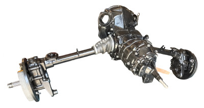

ianlighting wrote: Sun Jun 29, 2025 7:06 am You might want to take a look at your gearbox before you start getting too far into the build. .
Hi Ian,
I have a newly rebuilt freeway flyer transmission and a new set of higher geared transaxles. So what you see in the picture will be replaced.

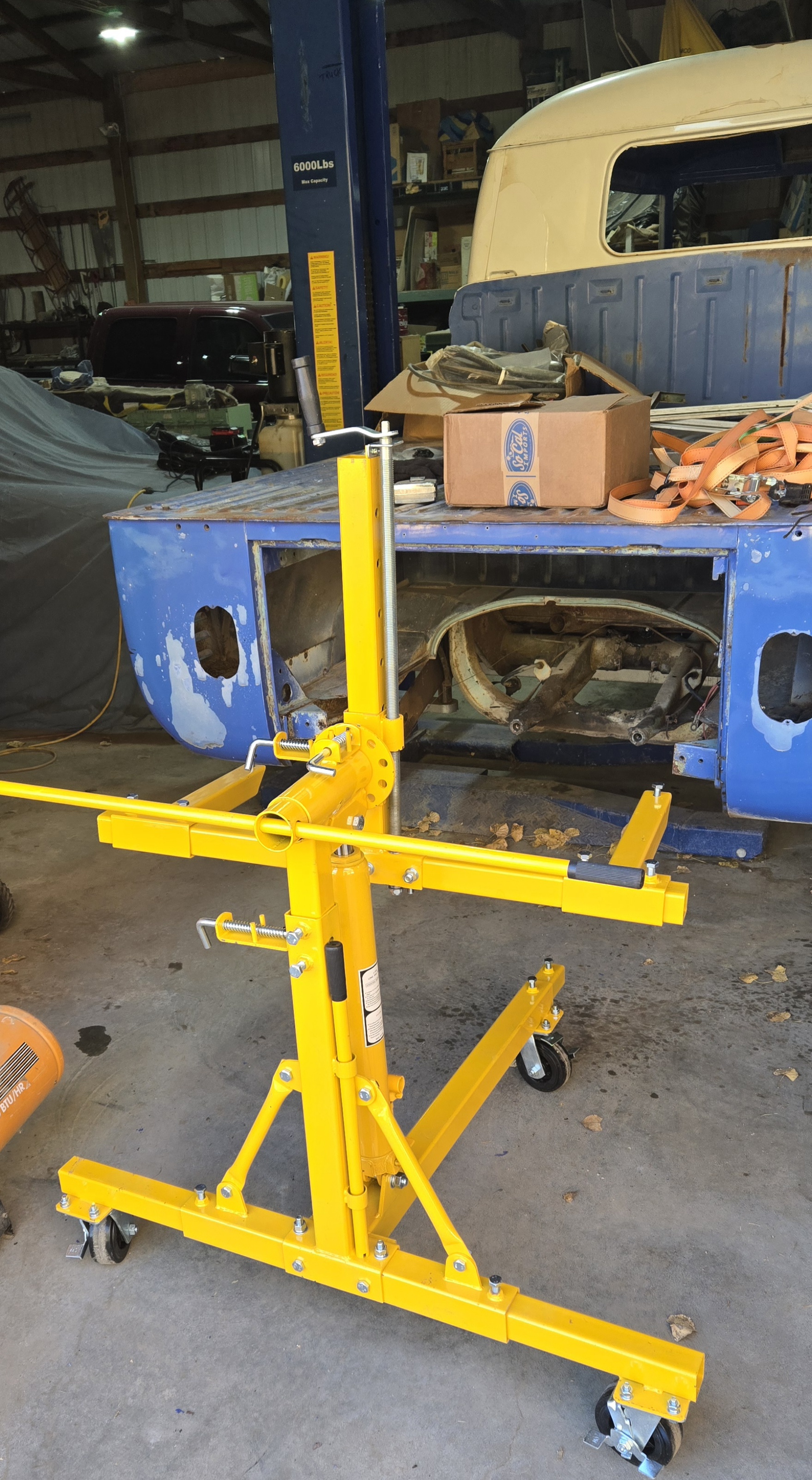

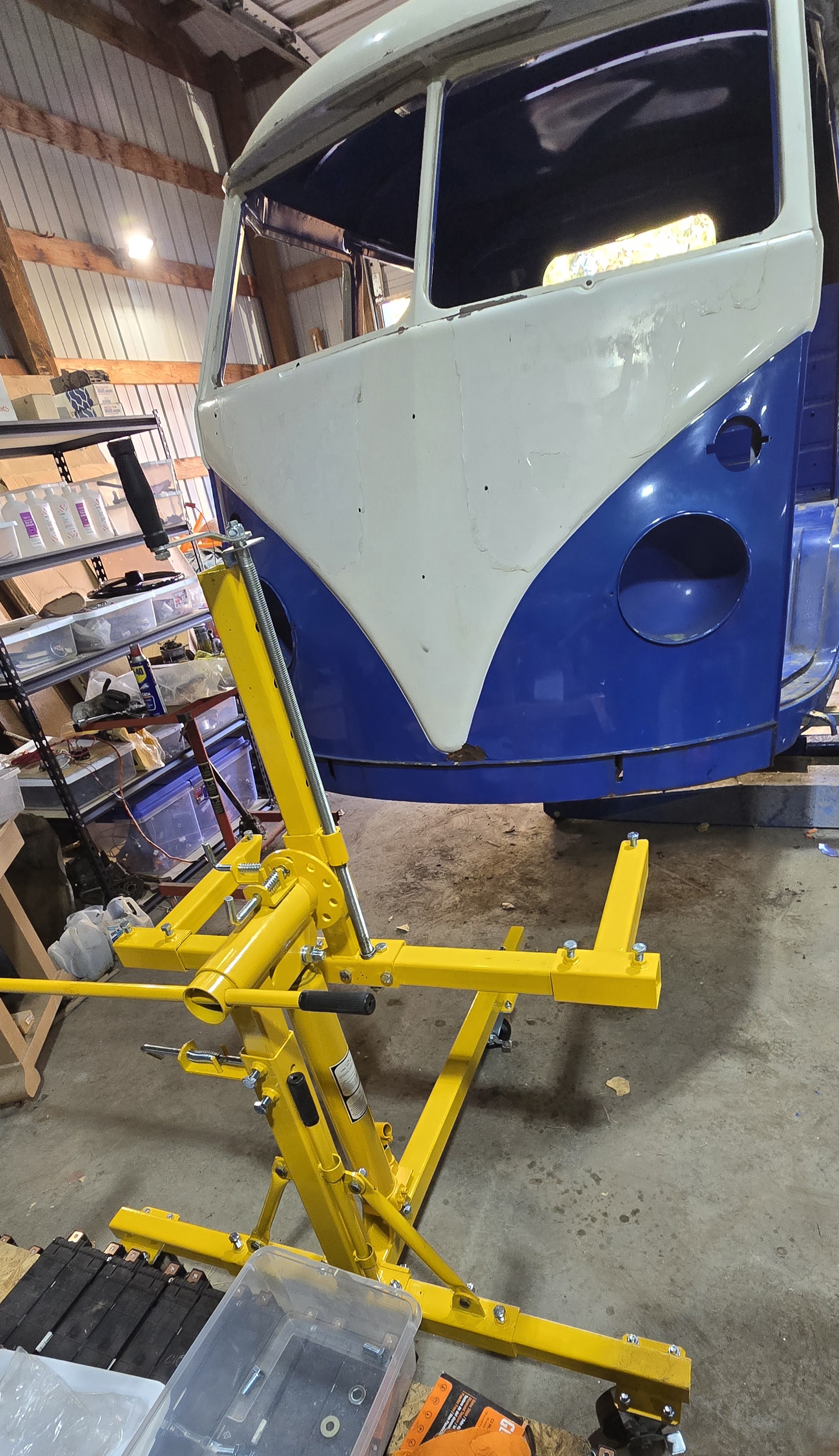

ianlighting wrote: Sun Jun 29, 2025 12:26 pm Sounds good. Happy to answer anything. I should add, I’m not going to be the right person to help on Zombie VCU stuff, and I do consider myself to still be very much a learner on the whole world of EV conversion, but if there’s any insight I can share I’ll be happy to.
There is significant difference between your transmission and mine. And also how they are mounted to the frame I see. I've been examining them from yours and my pictures. I also included a pic of the gear reduction axle transmission.
Not insurmountable "problems" yet to be solved. Ha!

I’m not surprised there are differences given the 70’s bay window was the next generation on from your split screen type.
In case you’re not familiar, The Samba is a great place to get all the expert VW knowledge if you need it.

jerrykco wrote: Sun Jun 29, 2025 1:19 pm There is significant difference between your transmission and mine. And also how they are mounted to the frame I see. I've been examining them from yours and my pictures. I also included a pic of the gear reduction axle transmission.
It is so cool, that you actually have portal axle gearing on that! 8-)
I suppose the gear reduction axle transmission you refer to is the gearbox on the wheel hub?
A benefit is increase in ground clearance under the axle, but downside additional possible failure point and transmission losses.
You may want to open those boxes and see how beefy gears they have in before giving full chooch of the Leaf motor :D
