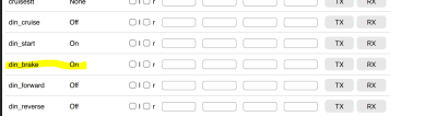

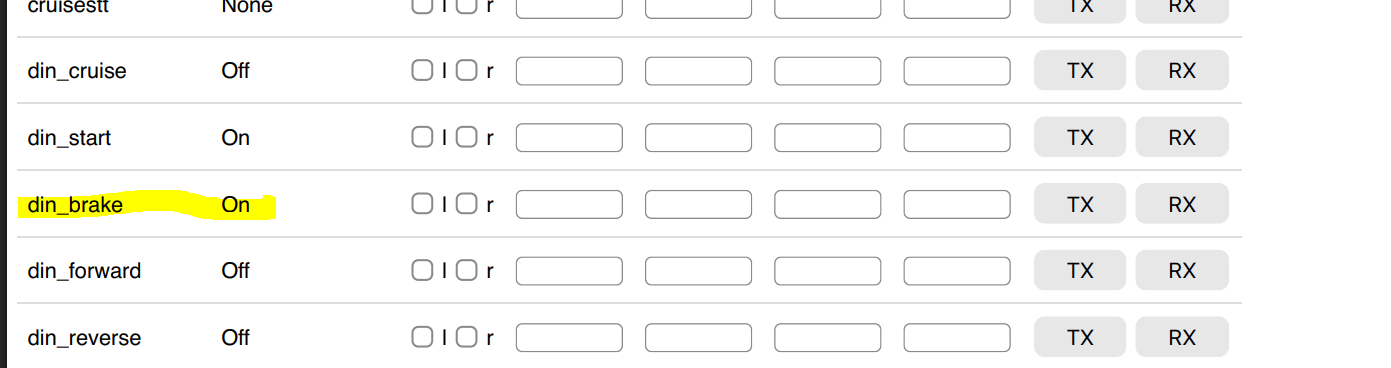

Really? I did not check as I believe you would have checked, as there is zero mention of you having wired up a brake input.
Why is the brake signal ON?!?

Thaaanks Tom! I got further with that.
I am getting PotNom in Drive (now where there break input is disconnected...I guess I need a different break switch.
reconnecting the Inverter will definitly send signals to the motor but it just beeps when PotNom is above 10% what is needed to convince it to rotate?
All setting are exactly as yours.

No idea what it would take.
You can plot torque and udc and idc to see if anything happens.
Possibly your power supply aint got enough power.
