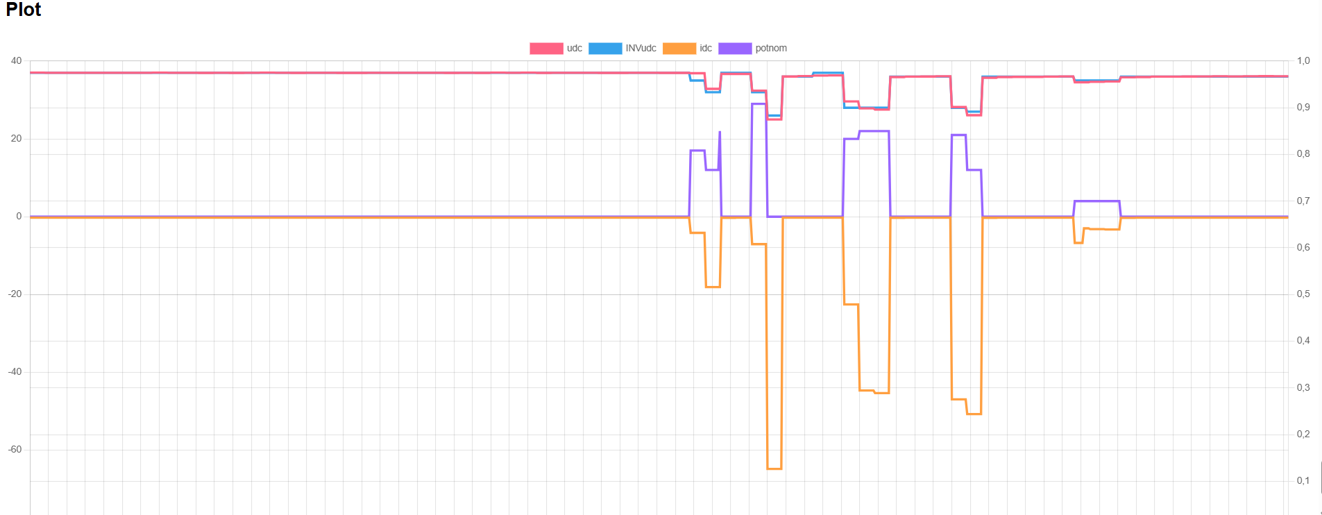

took three 12 V lead-acid batteries and connected them in series (36 V) as HV power source.
Basically same behaviour, the output shaft just rattles / shudders but does not spin.
I just realized that "idc" shows a negative value, is this correct or did I switch polarities?
here is a plot with idc:
