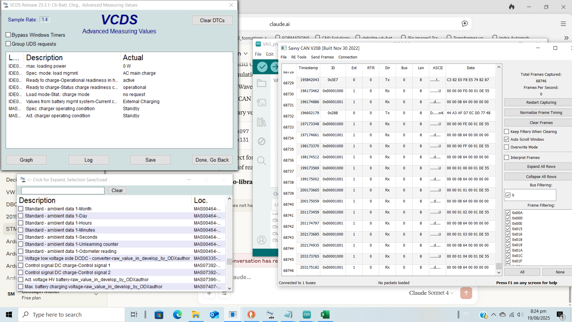

Another weekend staring at vcds & savvyCan. There must be something in the charge requests, because sometimes I get a quick charge, and other times nothing. Still the usual faults, but I'm trying not to focus too much on them, because they don't go away.
I am finding more data along the way, but I'm not able to confidently start a charge.

Another weekend sniffing.....Got some more data, but not any further with charge process.
Firstly, have a doubt about the mqb_dbc file, as the ID's don't match with the logs and the original VAG_phev_1.ino I am running.
I have found that 0x3AF & 0x187 throw my various faults, and I cannot find a way to spoof them at the minute.
0x3AF = Hybrid Powertrain stores U1121 & U1122 // DC_HYB_01, BMS_HYB_02, MSG_HYB_01 (all Time Out faults), & DC_HYB_02_CHK
0x187 = Engine Powertrain stores Motor_14, Diag_01, Motor_12, BEM_05, Motor_31, OBD_01 (Time out faults), & Error_Value_Motor_EV_01_CHK
0x365 & 5E7 = same faults as 0x187 + Motor_EV_01 (Timeout)
0x0A8 = Error_value Motor_12_CHK
Hope this info helps to hone in on the reason the charge process stops after 2 seconds....

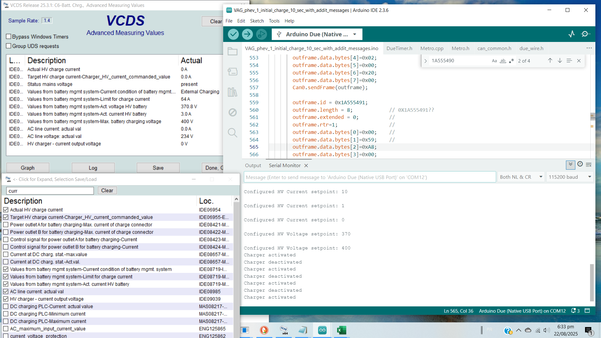

Re: VW GTE 3.6Kw charger 5QE 915 682 AF reverse engineer
Another day, another hole on the wall..Some more spoofing, this time adding ID data from the 6A_charge_log.
Still have the LED light staying RED & no charge activation.
Feel free to dissect and comment on the new .ino file

I've now split the messages into 2 can busses and will try it out tomorrow.
I also have 2 heating elements in series as my load for the moment.
Don't know about AliExpress vcds, I got a registered one.
I have the full charger cabling with port.
I also have savvycan along for seeing what's going on, for sending different messages.

Have you used it for reading values whilst attempting to charge? If so, , anything stand out as not being coherent. I spent another day banging my head against the charger!!!! Cannot initiate a charge any longer.Jacobsmess wrote: ↑Fri Aug 29, 2025 10:20 am Ive got an aliexpress vcds. Not the most up to date but works fine. Make sure you use it on an air gapped laptop though

I've now prepared everything for when my fake Mongoose JLR arrives. I've wired power to my OBC, as well as an ECU connector with both CAN buses, temperature, power supply, the RGB LED, CC and CP and nothing else, according to the Wiki. When I apply 12V without any CAN communication, the LED doesn't light up. Is this expected behaviour? Or did I make some mistake in wiring the connector up?
More importantly, on which CAN bus should I connect the Mongoose? PT-CAN or Hybrid CAN? Does it matter? What would happen if I connected both buses together?

I have both buses together. I only get the red led to light up when attempting a charge process.

My mongoose arrived now and I have a laptop with ODIS, though I am still struggling. J2534 seems to work fine, my main problem is that I don't know what project to select for my 5QE 915 682 BG. Could you give me a hint on that? Do I need to import some external MCD project?
Edit:
Now, a few hours later, I see that I failed to mention the actual problem. ODIS complains that it is unable to see the car and won't let me select between control modules. While using my newly acquired Mongoose and ODIS to code in the AUX port on my mothers RCD 210 in an older VW Caddy, I tried to select VW37X as a project (which shouldn't be compatible with the Caddy) and I would have been able to connect to the OBC! Looking into the index.html of the VW37X project directory, I see that there are multiple EV_OBCSinglPhaseKLOMQB1 odx files.
In the MEB chargers thread, Mitchy seems to have been able to create an MCD project that doesn't require a full car. That project archive sadly isn't accessible anymore and I'm definitly lacking the skills to create such a project directory myself.
Seeing that a much older car was able to bypass the check in ODIS, maybe the easiest path forward would be to acquire a CAN gateway from any random VW car? At least that's what people on YouTube seem to use to bench flash their ECUs with ODIS. I might have to go back to the scrapyard.
Alternatively, maybe VCDS would actually be better? When trying to code the aux port into the radio, I didn't see the nice descriptions for the bit fields you get in VCDS, but that may just be my inability to use ODIS properly. I'm reluctant to get another clone dongle and struggle with another weird cracked software.
Edit 2: Still trying to get a gateway. I already held one in my hands, but the conveniently located scrapyard wanted 50€ for it! Gotta try the other scrapyard.
Edit 3: Fascinating! I was trying to sniff the behaviour of the CAN-bus between the Caddy and the Mongoose and somehow it's able to tell that there is a DB-9 adapter in between! If it isn't directly connected to the car, it will send three messages to 0x700 and then complain, otherwise it will send only one. Adding 12V on the appropriate pin didn't seem to help. I'm going to try and sniff the J2534 data, maybe this can tell me what's going on
Edit 4: Alright, I think I got it now. I messed up by connecting 12V between chassis ground and 12V, the Mongoose measures in reference to signal ground. I can now get a list of Control units. So, for reference, ODIS error ODS8001E can mean that no battery voltage was detected. I found out about it by comparing the output of this j2534-shim/logger between a working connection with the Caddy and a non-working connection.
Edit 5: ODIS can connect to the OBC now and is incredibly helpful. Some noteworthy things:
Edit 7: I'm stuck again. Coding out the charge lock didn't seem to have any effect. I've been trying all day to get the charge lock working first with a simple 74X-based circuit, now with an Arduino. It does seem to register the resistors and the relay I use to short the 10k resistor that's in series with a 1k resistor, because the initial values after powering the OBC down and up again (locked and unlocked) differ. Weirdly, it seems that only the locking pin ever gets pulled high. The unlocking pin (Pin 17) never sees any voltage. Can anyone confirm that this is expected behaviour? Or did I maybe fry pin 17 in my experiments?
- VW37X does indeed seem to be the right project
- Coding out charge lock and flap seems to have worked
- 1068 Ohms on the thermistor wires didn't give values in range. I found 943 Ohms (measured out of circuit) to result in around 35°C. 22 Ohms less would be around -14°C.
- I will have to confirm the pinout of the connector tomorrow. ODIS reports electrical DTCs on the Charge lock, the charge socket itself and the third LED.
