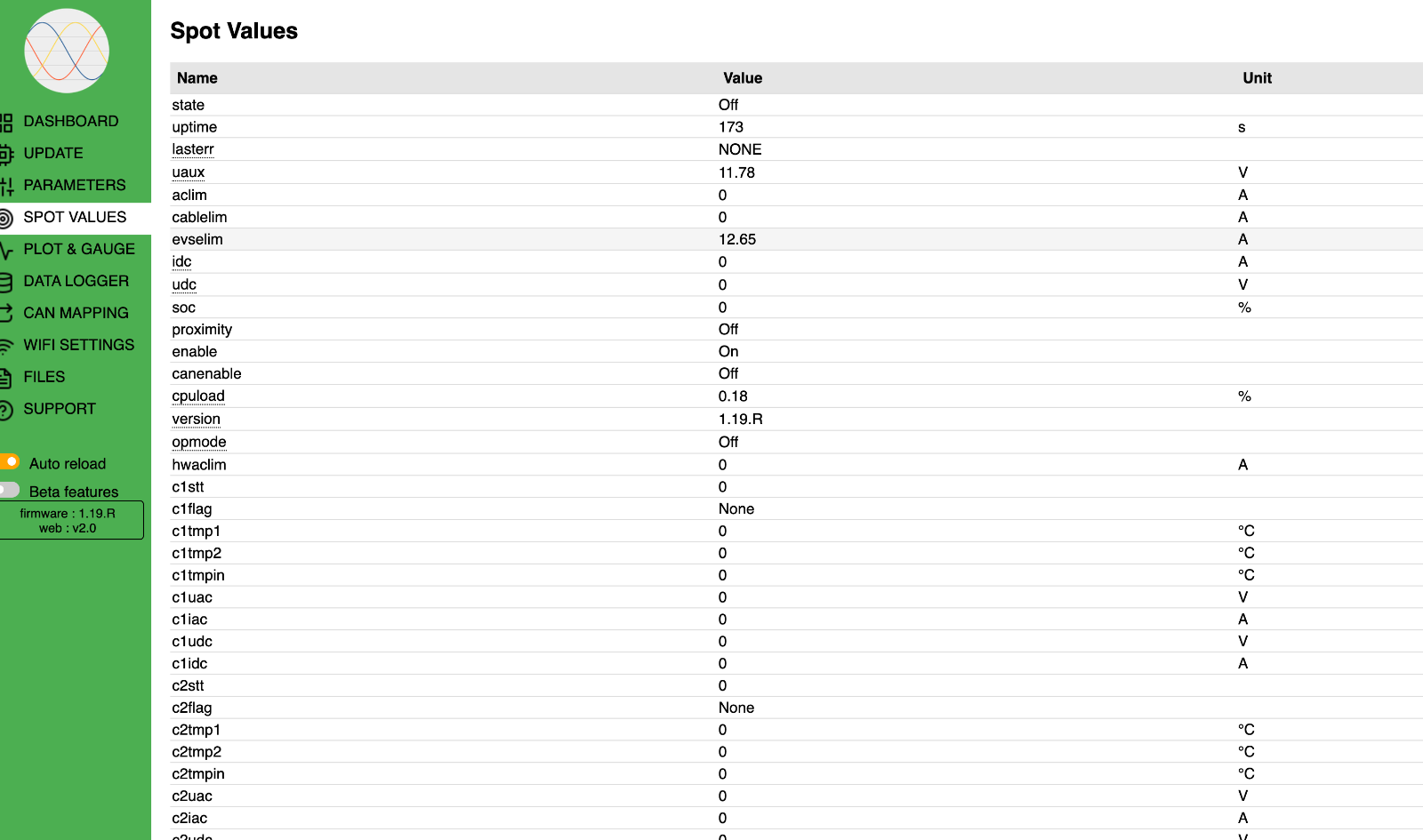

Re: Tesla Gen 2 Charger configuration help
Hi Tom et al,
I've been away on vacation so I haven't had the time to dig further into this.
Last night I was trying a few things out and verified all the wiring and connections and still was stuck on getting the Tesla EVSE to start charging (ie. providing the AC input into the OBC).
So I finally put the wiring back to incorporate the SimpCharge. Even though you mentioned you can't splice the PP and CP signals, I did and when I plugged everything in, the EVSE started applying AC power to the OBC. I validated this at the AC input connector.
But the red lights for each power module in the OBC were not lit, no current was coming out of the HV DC connector.
Here are the Spot values showing the EVSE on:
I don't think I ever got an answer, but what is the right way to wiring in the SimpCharge to the OBC using the Openinverter control board? I'm not using CAN. Is there a way I can confirm the OBC is actually functional? It feels like this wiring config is still not correct so I want to rule this out or even at least run the charger in manual mode to see if it turns on but somehow in that config it doesn't let the EVSE turn on.
Thanks again in advance!

- Posts: 2962
- Has thanked: 328 times
- Been thanked: 847 times
None.
The charger needs to be setup and wired to properly turn on the EVSE.
Note the opmode showing off for each of the previous screenshots.
The spotvalue "evselim" will populate once a correct Control Pilot signal is detected.
So the charger does the following:
State: Off = Enable is high + Proximity is detected + Proximity cable limit verified => State:WaitStart = timedly has passed
Try changing timedelay to 0, AS PER WIKI https://openinverter.org/wiki/Tesla_Mod ... 5_Software
Stop messing around with the wiring and do as instructed.timedly
The default value is -1 but this results in the charging waiting forever. You need to set this to 0 (or more) for the OBC to work.
Understood and acknowledged. I don't take this lightly and very much appreciate yours and everyone's time and willingness to contribute. I just couldn't figure out why my EVSE wasn't turning on so I needed to revert to ensure I could verify the EVSE works and does produce current and it does!
Yes, mine was already set to 10000 as the instructions said "0 or more", but thank you. I will set to 0 to confirm.tom91 wrote: ↑Fri Aug 01, 2025 2:35 pm Try changing timedelay to 0, AS PER WIKI https://openinverter.org/wiki/Tesla_Mod ... 5_Software
So just to confirm, (and hopefully for the benefit of others reading this), the purpose of the SimpCharge was to control the EVSE. If I remove this, then this will be how the wiring will be configured:
1. CP and PP lines go directly from charging plug to the OBC (pins B5 and B11 respectively)
2. PE goes from charging plug to chassis and GND from OBC (pin B7, and OBC case also grounded here as well as A6)
3. Line and Neutral from charging plug go to AC input on OBC
4. 12V constant goes to OBC B1.
5. 12V signal to turn on from SIMPBMS goes to A3. For testing purposes, I already tried permanently connecting both B1 and A3 to 12V.

Sorry, I meant Pin A1 from the OBC is the AC present output.
I've tried the above without connecting A1 from the OBC as I'm right now just trying to get the charger to turn on without connecting it to the BMS. So I think I'm back to the same problem I had before:
12V connected to A3 and B1,
CP and PP connected to B5 and B11,
A6 and B7 connected to ground (along with chassis and PE from J1772 socket).
A1 not connected to anything.
EVSE recognizes it's plugged in, but doesn't start providing AC power.
No charger module red lights come on.
I'm still at a loss trying to understand why the EVSE provides AC power when the CP and PP signals are going through the SimpCharge (spliced) but doesn't provide power when the CP and PP signals are connected directly to the OBC.
If anyone has any thoughts or ideas that I should test or check wiring, I'm all ears.
Thanks in advance!
