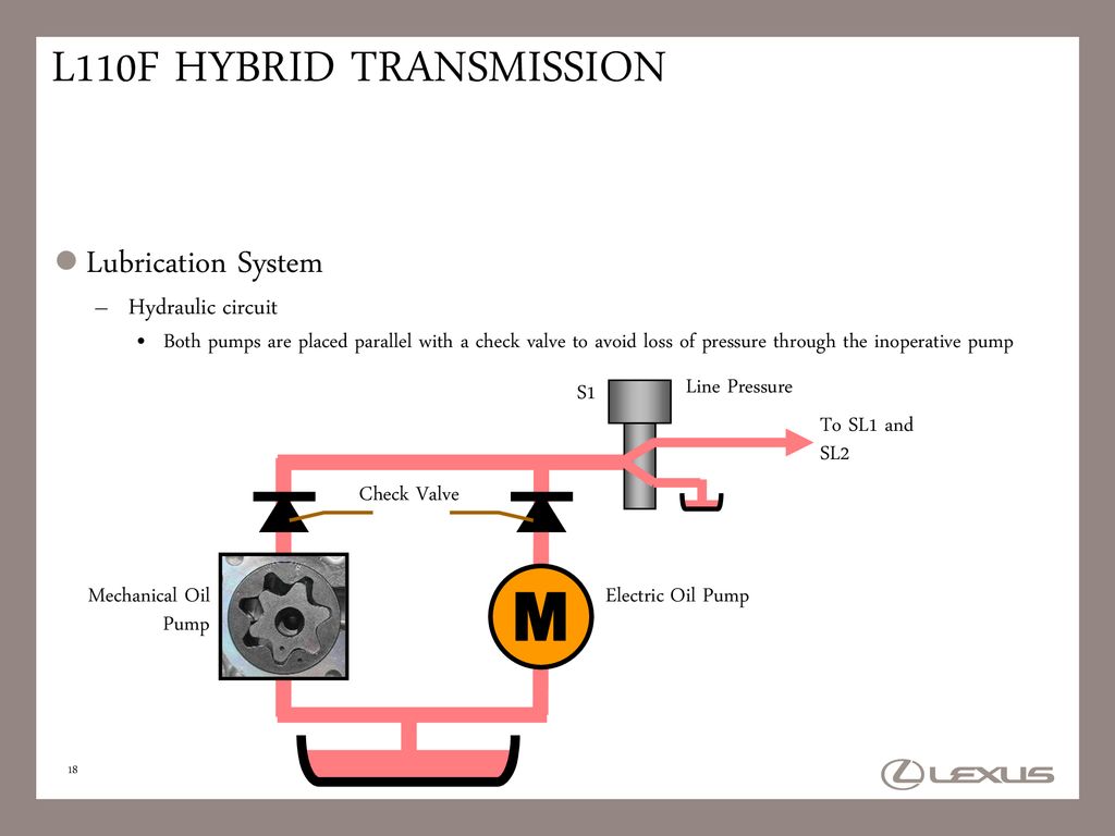

No, TransSP controls overall oil pressure in the trans. The trans has 2 pumps, the electric one is somewhat slow to respond, and we can't control the speed of the mechanical pump. The 2 pumps converge (through check valves). Then the TransSP solenoid determines the pressure of the system overall. We can probably manage the pressure with the pwm of the electric pump for those not turning the input shaft, but mine will have a 3rd motor on the input shaft. Most times, the goal is to produce ample pressure with the pump, then regulate pressure with a pressure regulator after the pump. See attached picture as well.

Don't forget that you can disengage and electric pump simply by turning it off!
The SP solenoid is just a bleed/bypass solenoid. These are common in automatic transmissions to control line pressure. Sometimes manual (as in older units such as the A340 series), sometimes electronic.

FYI with the oil pump set to 100 (~40%) PWM the TransSP solenoid can make the pressure switch open with as little as 2.5% pwm. I need to find an adapter and put a pressure gauge on it.

One thing that would be good to know, is how much the oil pump contributes to lubrication and cooling. Whether it needs to run at a high rate all the time or not, if it should be temperature controlled and if that would make a difference, or maybe it's fine to just run at a low speed, and increase the speed for gear shifts.

I'm not sure that answered my question at all. What is the reasoning behind basing it on torque input? As additional cooling?

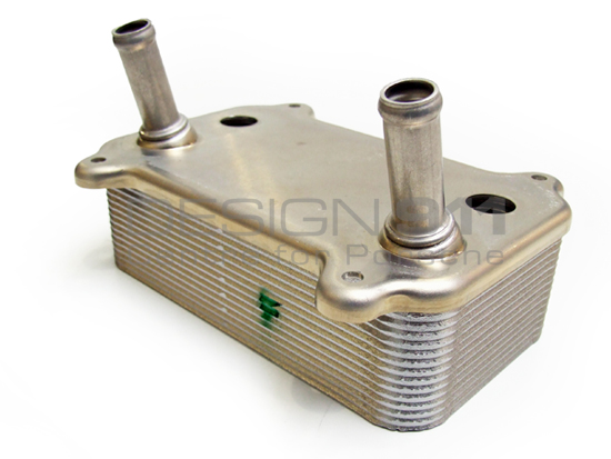

You mention a heat exchanger, does this mean that water does not circulate in a jacket around the motors? Is motor cooling done only by oil?

There is an integrated AFT to coolant heat exchanger for the gearbox. The motors sit in a pool of ATF fluid though it might be different formula for this application rather than common ATF. The heat exchanger transfers heat from the gearbox to a coolant circuit. I don't know it this is separate or shared with the ICE coolant and cabin heater circuit.

The reason you base it on torque input, as the clutch packs are applied with hydraulic pressure (for MG2). Without pressure, they will slip and burn. You need enough pressure to hold them applied without slipping.xp677 wrote: ↑Sun Apr 05, 2020 11:32 am I'm not sure that answered my question at all. What is the reasoning behind basing it on torque input? As additional cooling?

Correct. The motors are cooler with ATF flowing throughout the trans.
No, there is no lubrication without oil flow. All the bushings and bearings would fail without the pump running (in addition to clutches slipping).

Strange that the car has a heat exchanger within the transmission, and also external oil cooling up front. I'd have thought that especially with the increased load in our projects, an external oil cooler would be required, with a pump speed set relative to oil temperature (assuming constant coolant flow).

The heat exchanger is likely to me housed externally to the main casing. There will be an oil entry and exit port which are probably hidden under the mating surface. There will also be an external coolant entry and exit, a couple of hoses leading forward to the radiator most likely.xp677 wrote: ↑Sun Apr 05, 2020 9:15 pm Strange that the car has a heat exchanger within the transmission, and also external oil cooling up front. I'd have thought that especially with the increased load in our projects, an external oil cooler would be required, with a pump speed set relative to oil temperature (assuming constant coolant flow).
Something like this?

It's mounted on the right hand side, one of the hoses is mounted to it's cover plate. The other must pass through the transmission since the hose entry is on the other side.sfk wrote: ↑Sun Apr 05, 2020 10:06 pm The heat exchanger is likely to me housed externally to the main casing. There will be an oil entry and exit port which are probably hidden under the mating surface. There will also be an external coolant entry and exit, a couple of hoses leading forward to the radiator most likely.
