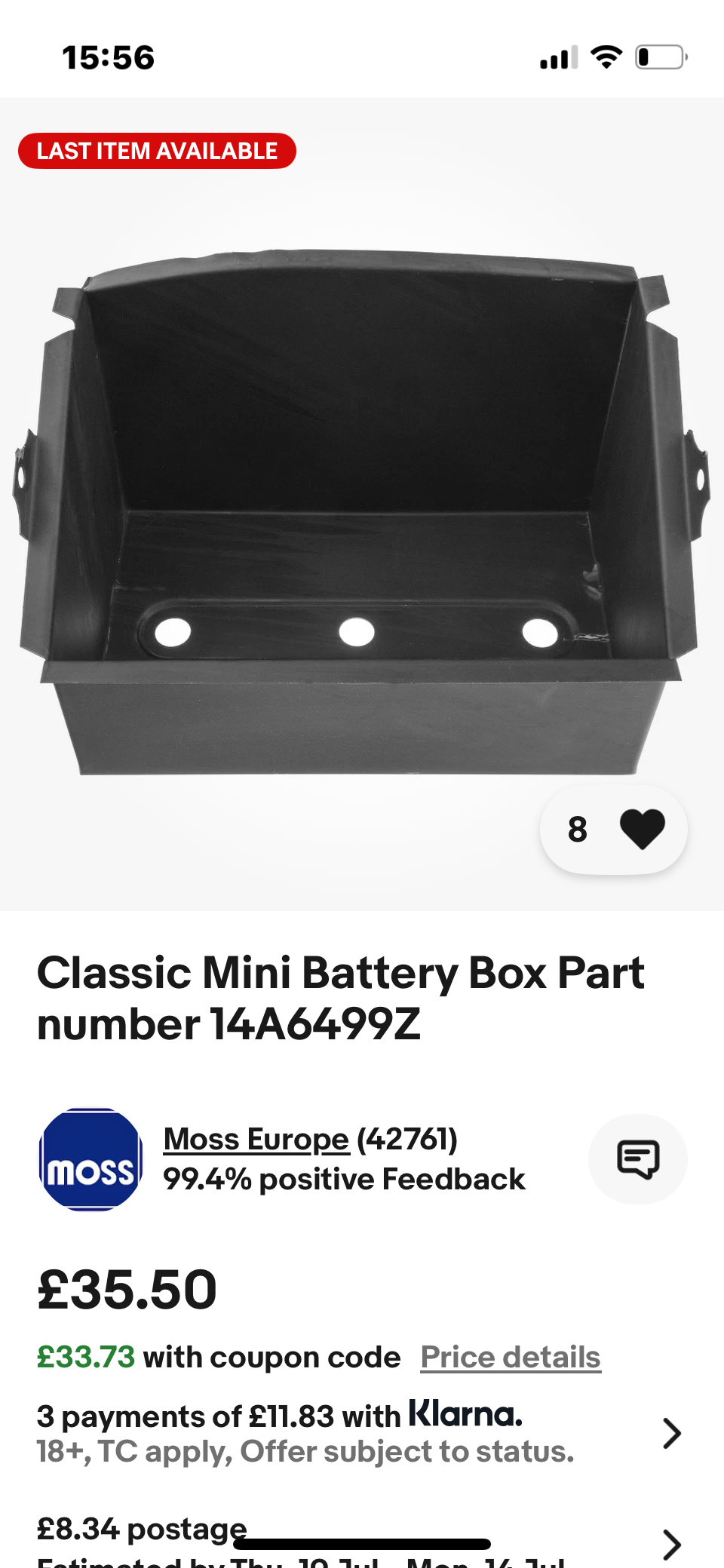

tom91 wrote: Mon Jul 14, 2025 1:14 pm Dont forget you need to house the batteries in watertight enclosures, they will take up space.
also keep in mind you need to achieve at least 72S(300V fully charged) for the outlander voltage range to be happy with the batteries a maximum of 96s (400V charged) is possible.
That would mean 21 units, there’s potential for for 10/12 in the floor, 6/8 in the front and to keep the weight about right i would need 8 in the boot. This would raise the net weight of the mini by around 120 kg
