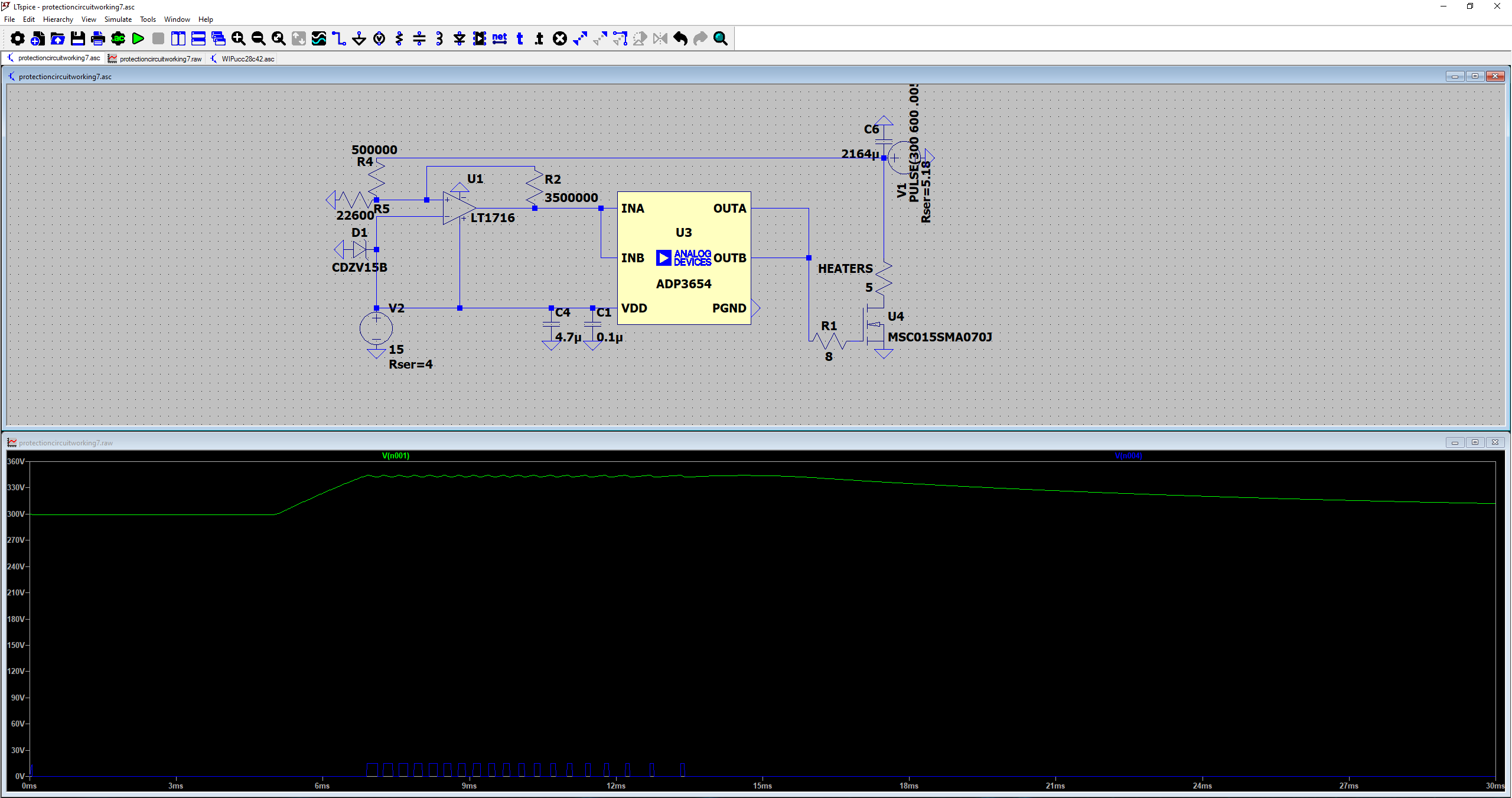

Re: Using a PMSM and inverter to generate and regulate a DC voltage
The current idea for a zenode diode circuit is to use the diode(s) to divert current to a resistor bank when voltage exceeds 400V. Thinking of using 240V water heater elements wired in series to accomplish that, at least for testing purposes.

Another note about the zener diode circuit: it looks like a TVS diode would likely be better suited for this application. Someone correct me if that's wrong. Right now looking at targeting a conservative break down voltage of 400V with the intention of actually running the DC at 240-300v.

If you have a data sheet of the TVS or Zener please share this before producing too much smoke. Difficult to imagine how to convert 40kW into heat.

That Zener idea sounds sketchy to me as well, like uhi says if at all it won't dissipate that much power for long. They're meant to low energy, short (µs) duration spikes. There is something called a "crowbar circuit" but I have no idea how these are built

Haven't decided on the exact part yet. Maybe something like this: https://www.digikey.com/en/products/det ... TH/9681407
It seems like the TVS diodes never provide a continuous current rating, so that is an unknown at this point. Finding high current capacity zener diodes is also difficult but they're very cheap so I could just run a whole load of them in parallel.
The intention wasn't to dissapate 40kW into the diodes themselves, I wanted to use them to direct current to resistive heating elements. Unless I'm fundamentally misunderstanding how these components work? Once again, I'm no EE.
The shuts down PWM part was my mistake, I edited my post shortly after posting to include a note about that.johu wrote: ↑Wed Feb 04, 2026 9:20 pm Can you point us to where in the wiki it says "shuts down PWM?". It only tapers regen whereas "udclim" actually shuts down PWM. But with the same speed limitations.
I'll look into the crowbar circuit.

here's the voltage limiting circuit, for anyone who might be interested to check it. It's not exactly what we've made because I couldn't find SPICE models for everything, but this is the idea.
