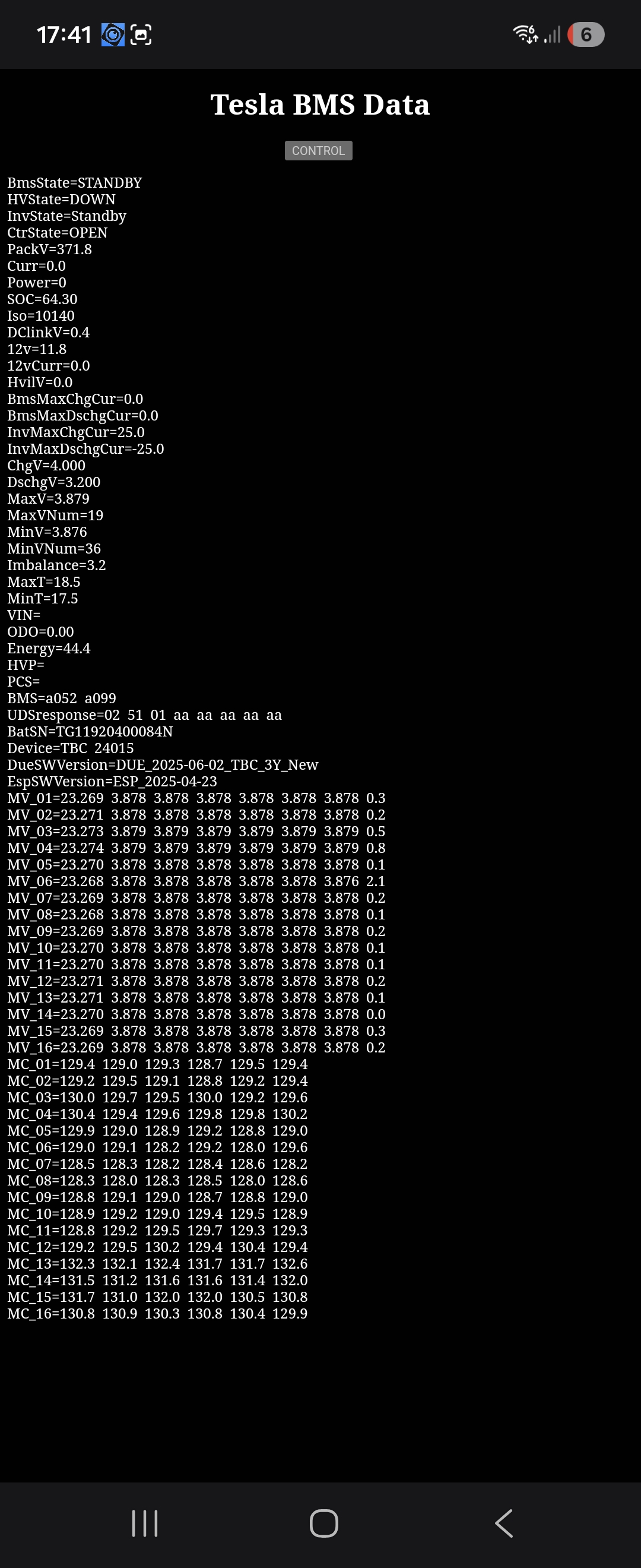

2nd balance board...

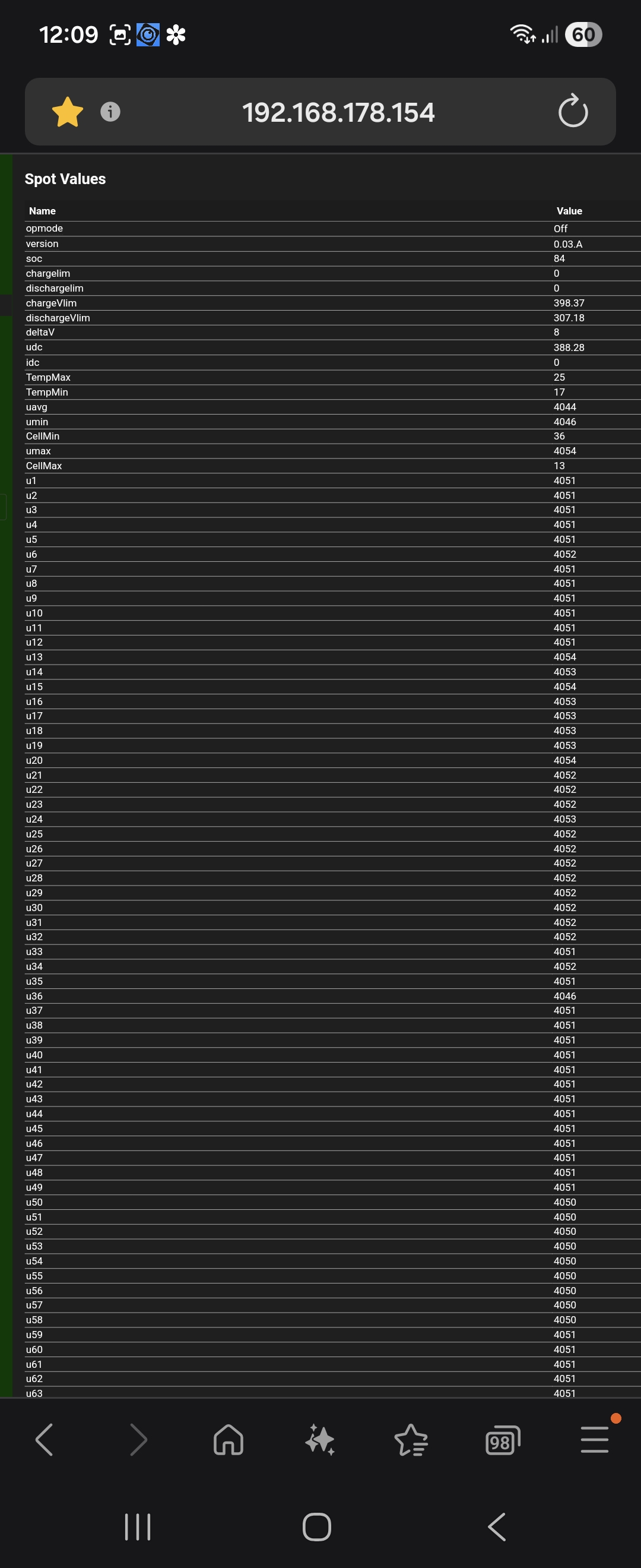

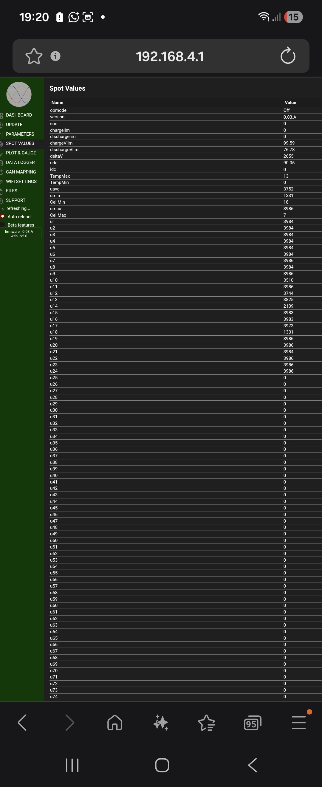

I have reviewed the SPI comms, there seems to be no data coming back from the BMB. The batman on the BMS board seems to be sending some info, or atleast responding to SPI commands. Yet when looking to read data from a BMB nothing is passed on.
Posts: 4000
Been thanked: 1117 times
Re: Tesla model 3 BMB control boards
Can you please remove IC4 from the board. MAX17841. That should solve the problem.

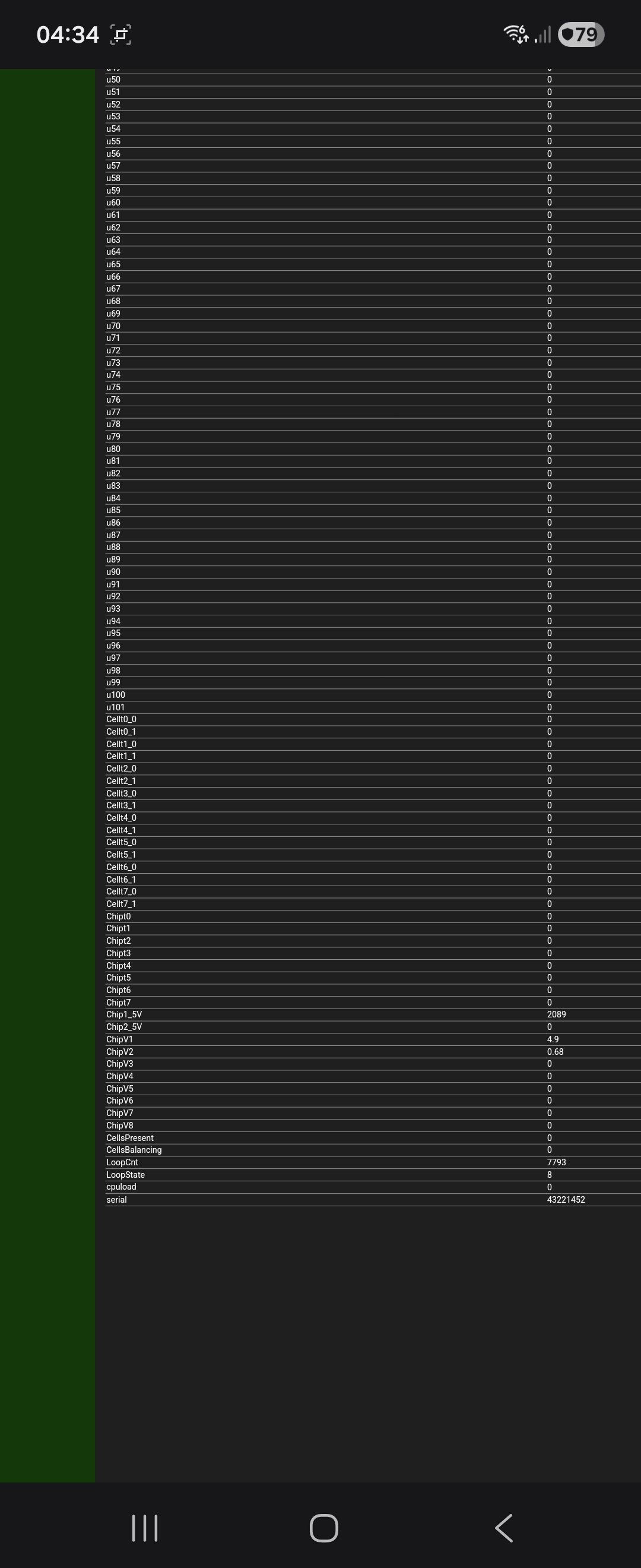

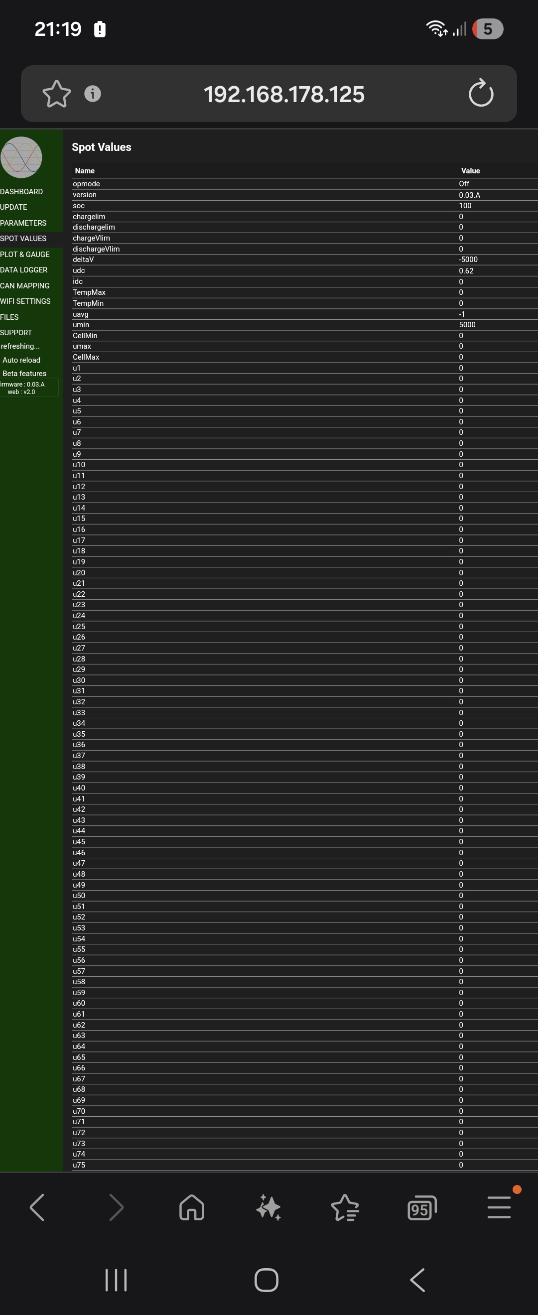

Posts: 4000
Excellent!

hanskraayeveld wrote: Fri Oct 10, 2025 5:20 pm
So removing the MAX chip that is also on the SPI bus solved it. Good to note this for this hardware version.
I only even worked on M3 on older version and now ONLY the MAX on the new version.

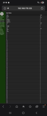

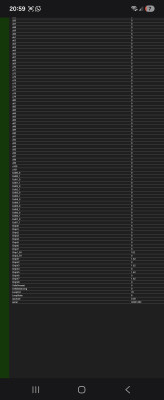

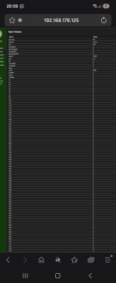

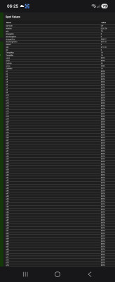

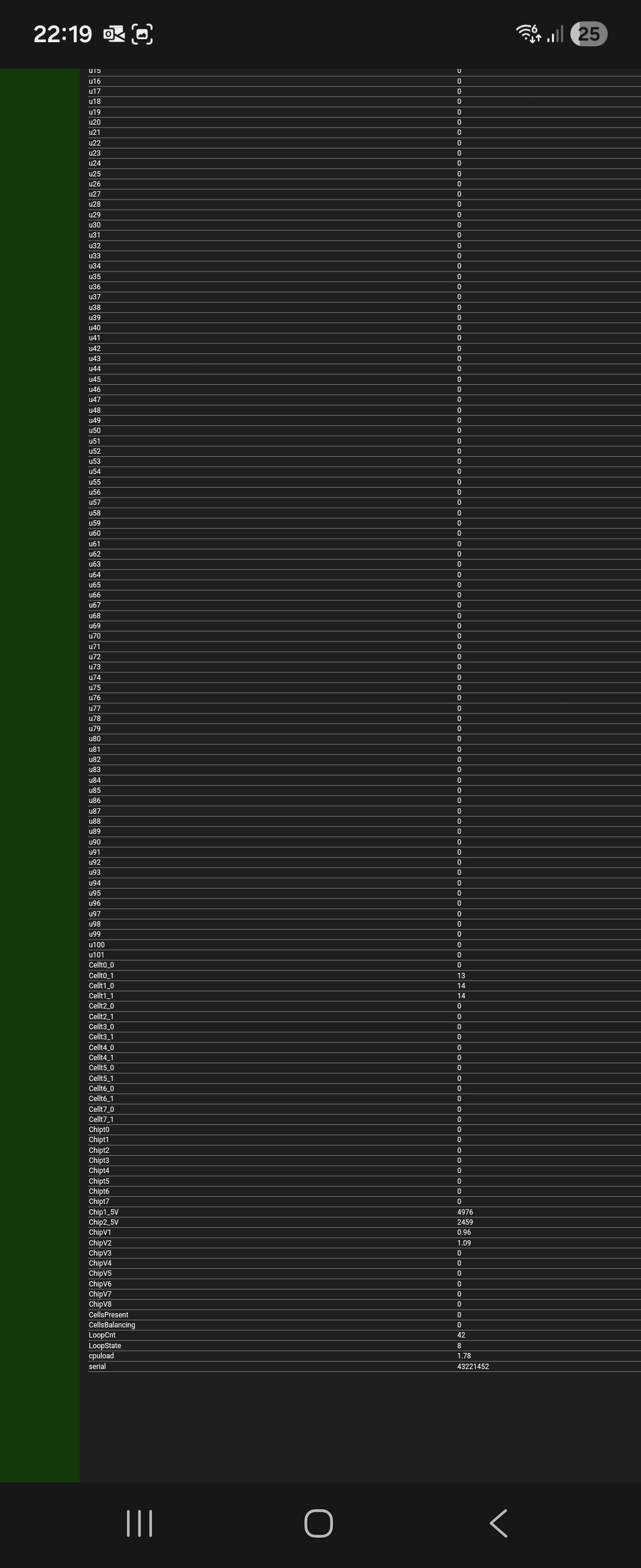

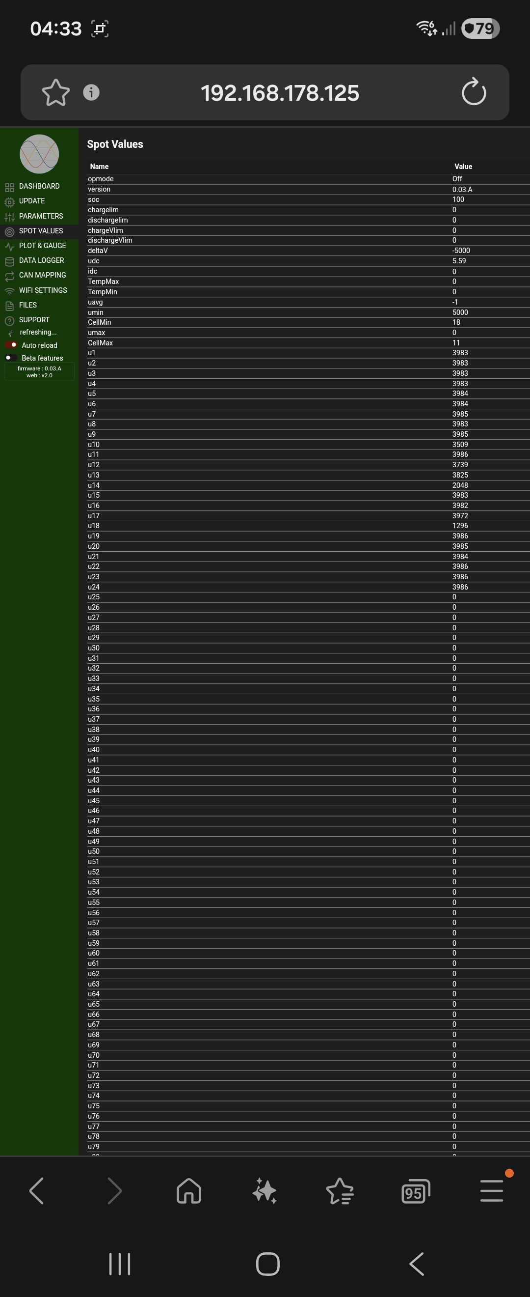

I also connect 4 modules, changed parameters to 4 modules, plugged two wires in one connector on hvc, other connected to hvc, but little data?
After it, I plugged out other connector from bmb4 to hvc, but same data.
After it connect to one module again, same... little data.
Is it unstable?

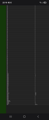

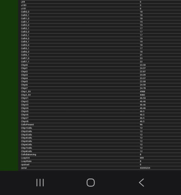

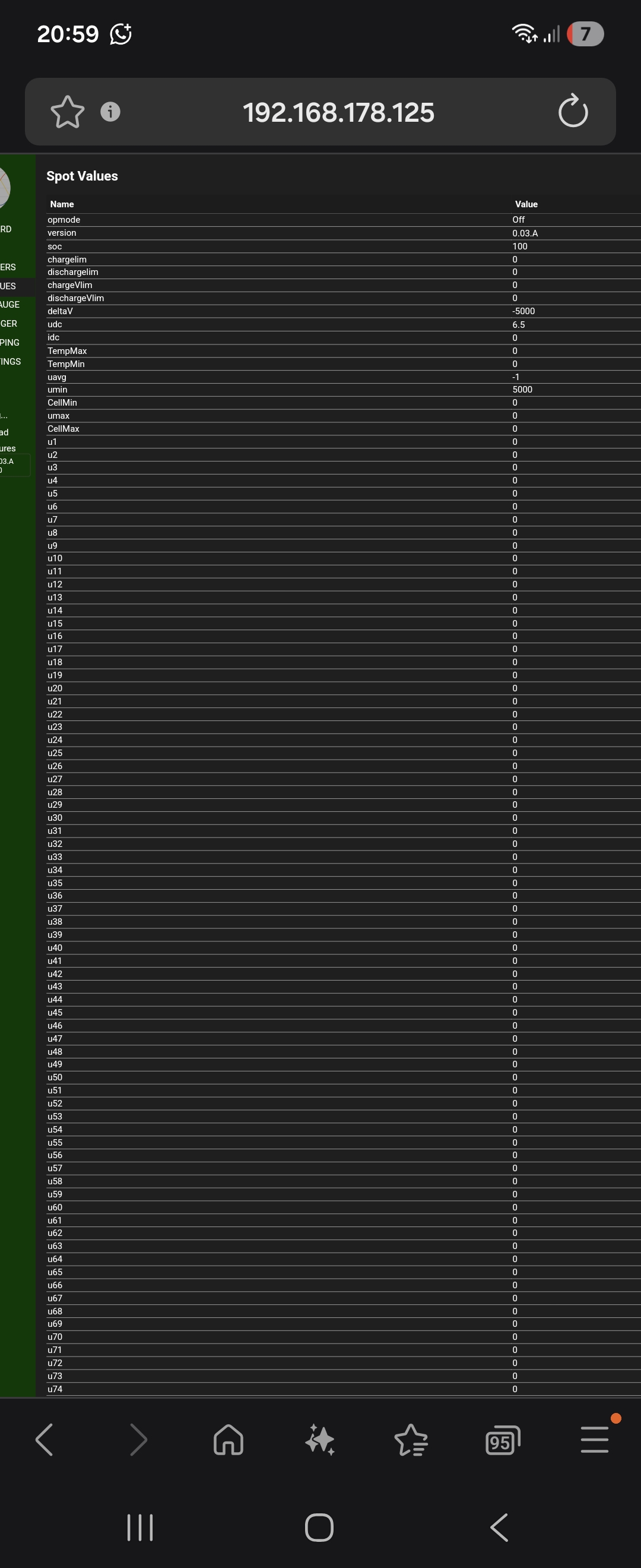

Data is very unstable...
Now its not displaying voltages anymore... somethimes some temperatures

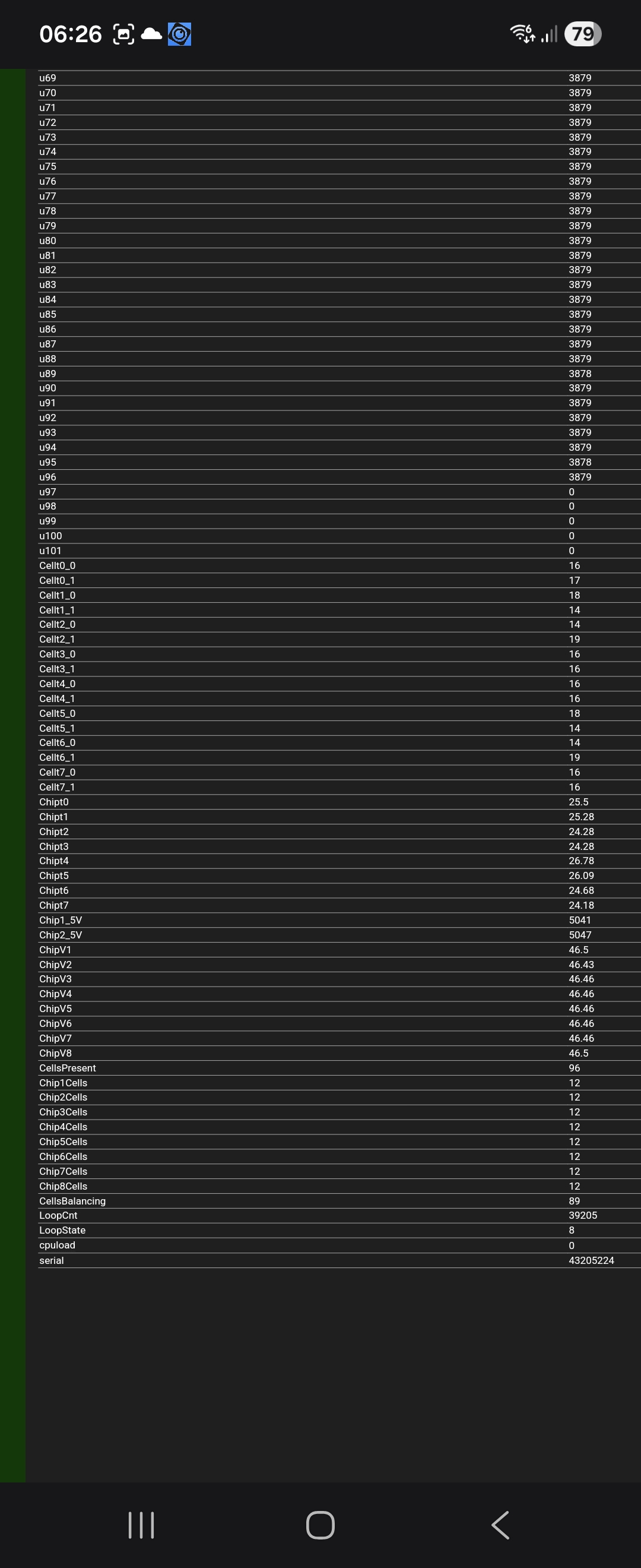

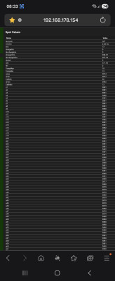

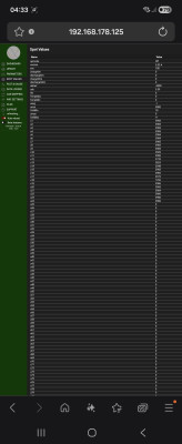

After a night, cell voltages are back ...
Sometimes temps comes and then go...
I select balancing on, first time showing 23 balancing, now none...
What could be the problem?

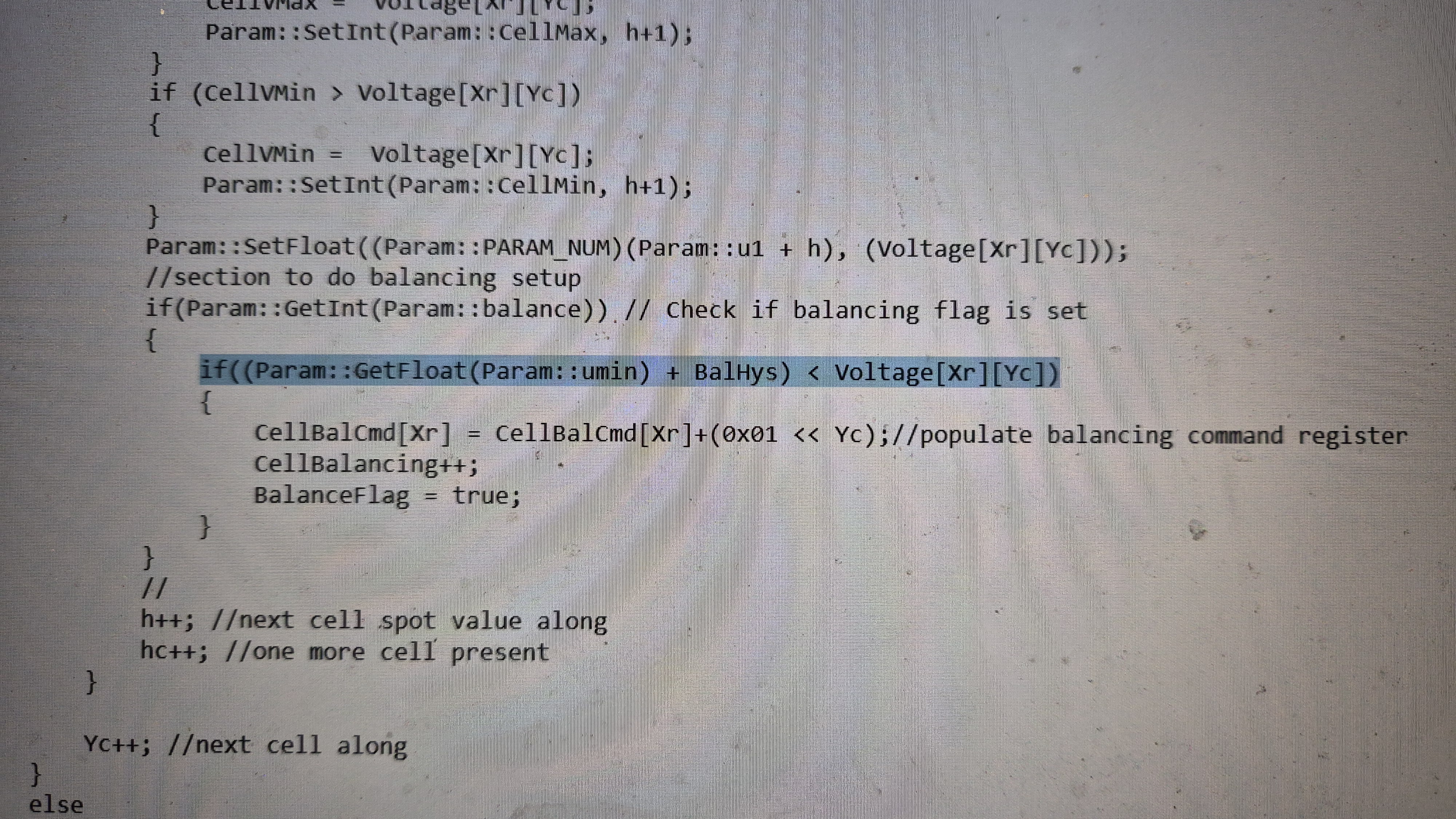

So next for me to do is a small modification on balancing.
I want to change this line:
umin to umax
+ BalHys to - BalHys
I want to balance from top to bottom. So first bleed the highest...
I can change in code really simplex, but the question is: how to upload :?
No experience with it. I can save file, but normally I work with arduino or teensy.
I think I have to convert all (included) files to a bin file, and then upload it.
Could anybody help?

Did a update to both boards....
With STM programmer. What a hell of a job... Without Tom, never succeed...

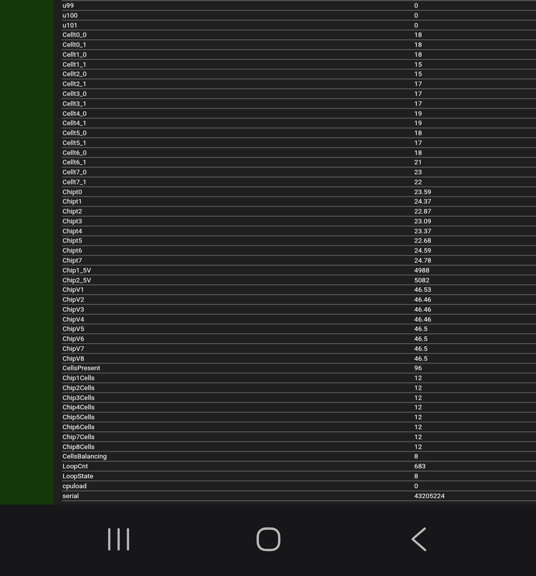

I replace very little:
Balance voltage is highest cell voltage - balhyst (0.002v)
Hopefully it will balance nice....

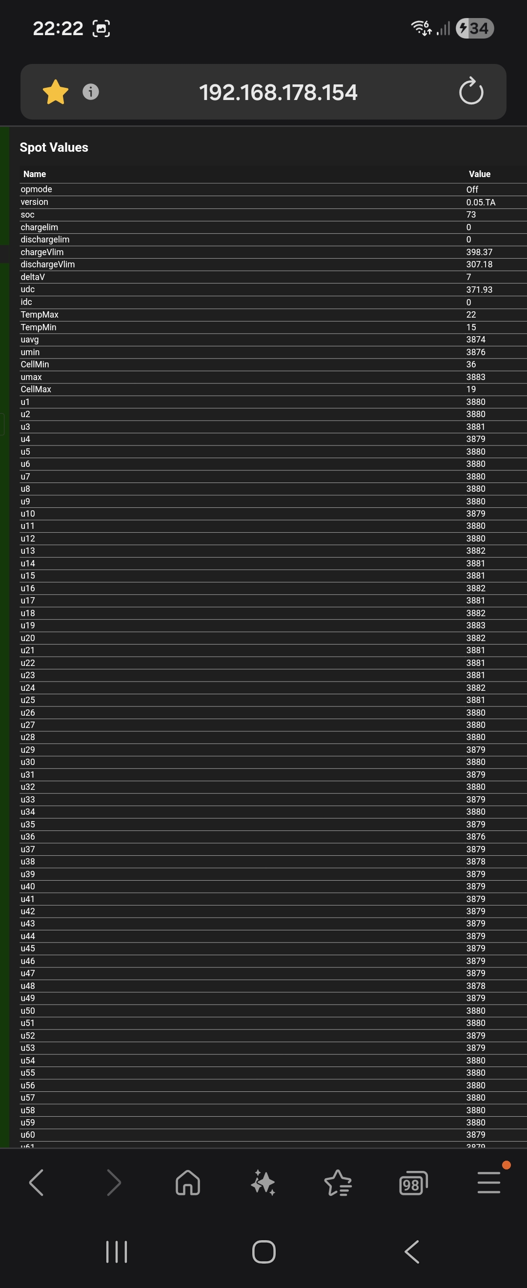

7 mv imbalance
8 cells balancing

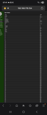

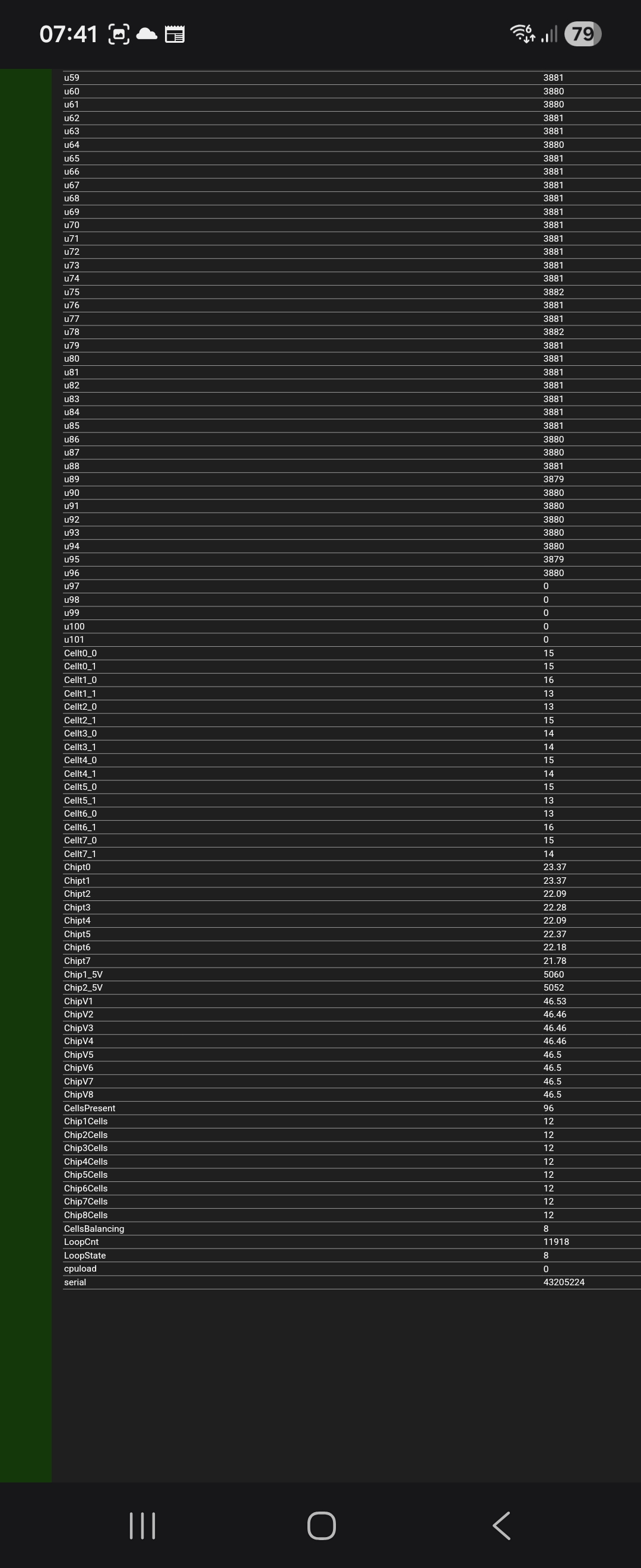

After a night, seems cell balancing does not do anything (spectacular) (Can be my fault)
Question for makers: cell balancing M3 module is done by resistance wire, right?
1: How did you imitate this on a bench?
2: When balancing, cell voltage is not available (shorting wires), how is voltage measurement performed when balancing? Balancing stops for a few ms?
3. Why is uavg not matching, also before I do modulifications

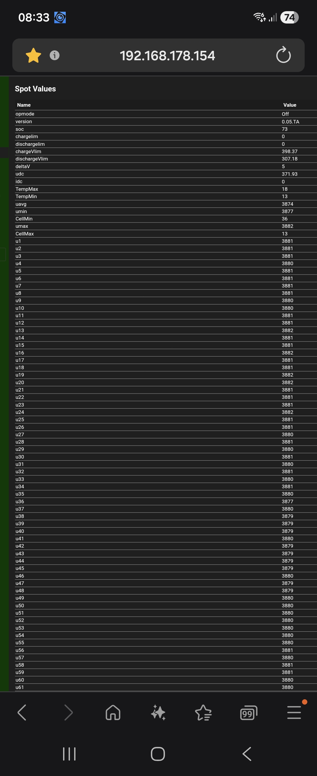

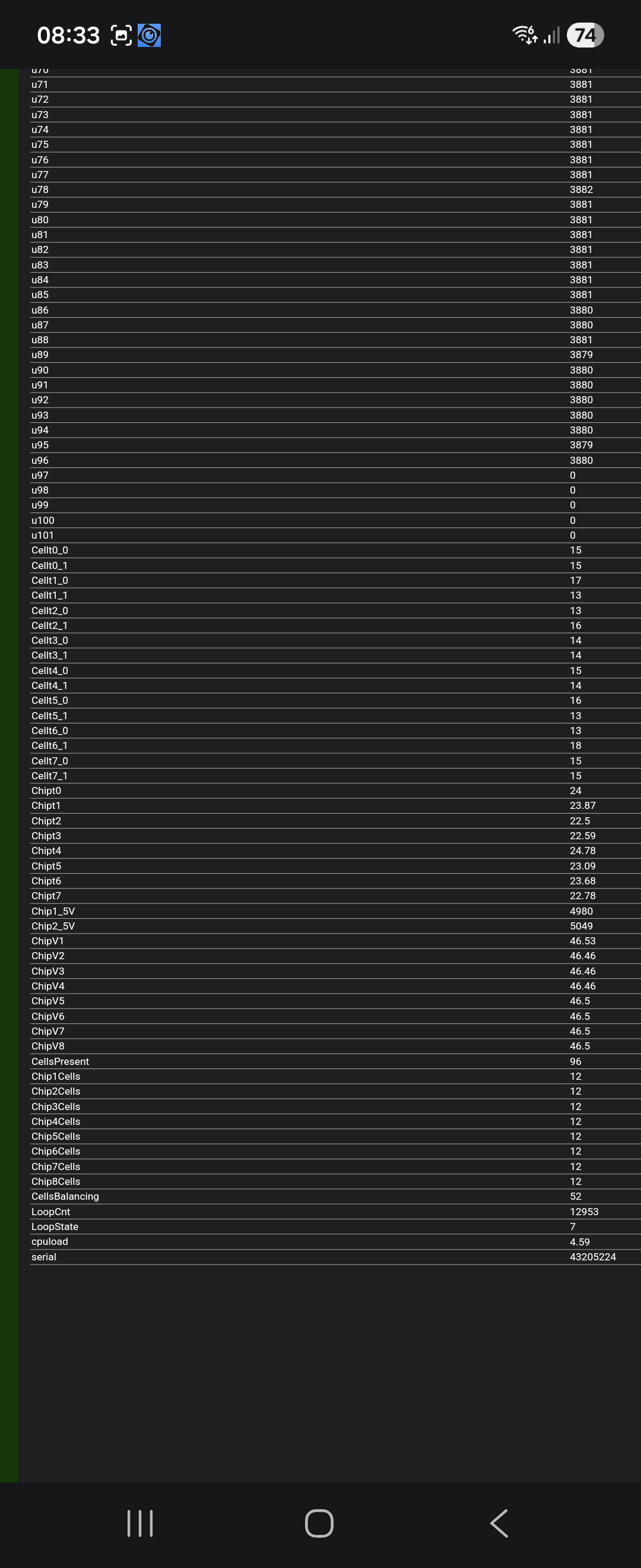

I think he is doing something. But what?
5mv imbalance
52 cells balancing
It seems the lowest is more rising in state of the highest are decreasing...

hanskraayeveld wrote: Tue Oct 14, 2025 5:47 am Question for makers: cell balancing M3 module is done by resistance wire, right?
1. request balancing and check feedback from the BMBs, as I said I will look to find some time soon to revisit this.
2. Before requesting a measurement balancing is paused. This maybe the reason balancing is not happening porpperly.
3. No idea can take a look when having everything set up again.

Post by hanskraayeveld »
I measured the amps (with a very percisely meter) and I measure its balancing.
I measured parallel the brick wire. The last and first brick wire current is flowing one way.
The middlest brick wires, current is flowing forward, a sec, and back a sec.
So it is bleeding, for sure...
So it seems it cannot bleed all bricks the same time.
Am I right?
I hear also something clicking on bmb every 2/3 sec

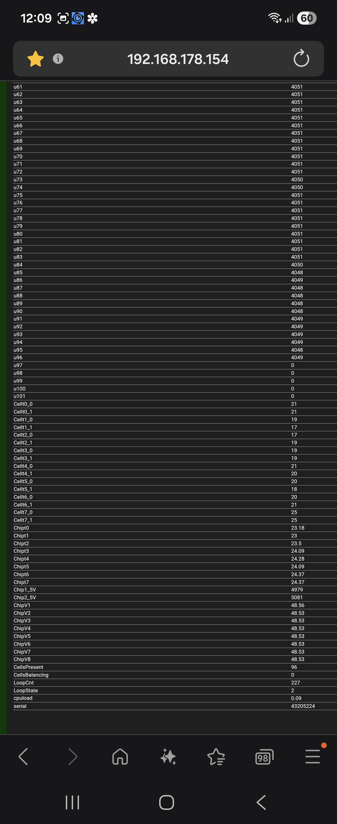

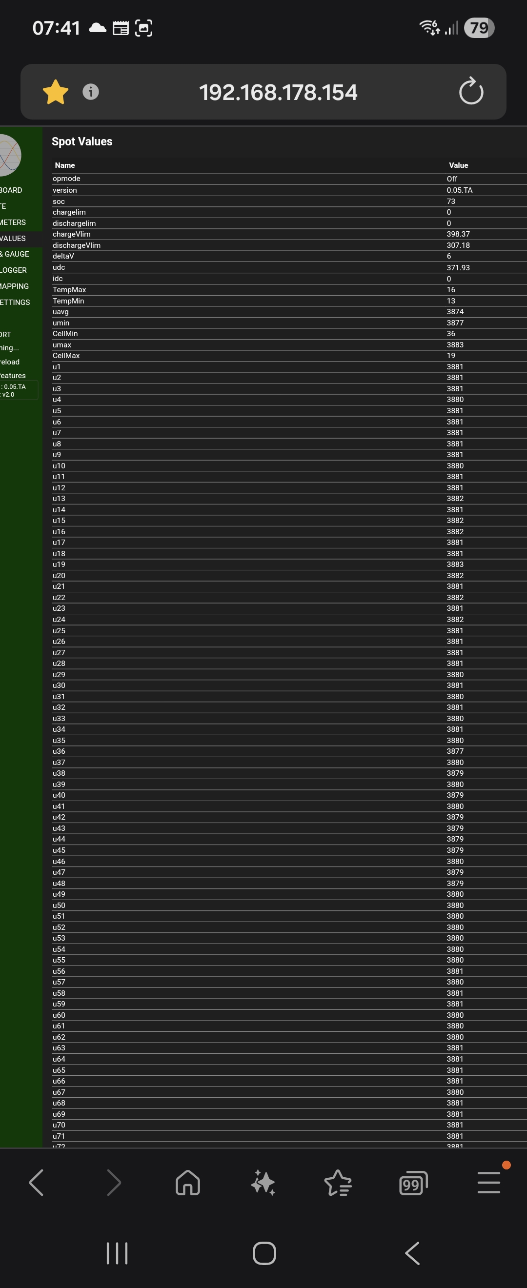

4mv imbalance
89 balancing
After 29 hours working time
Works nice for me, as expected, only little speed up ;)
I measured balancing/bleeding time is approx. 25%
Hopefully Tom can speed it up to 95%. 5% for measuring voltage.
He also did that for model S.
Tom is working on it... So fingers crossed

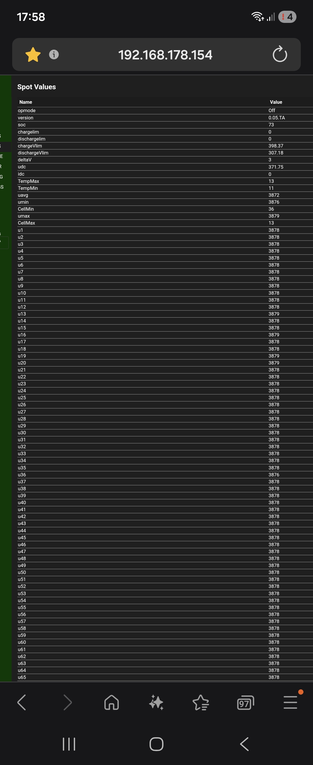

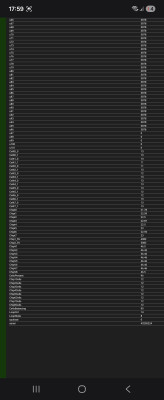

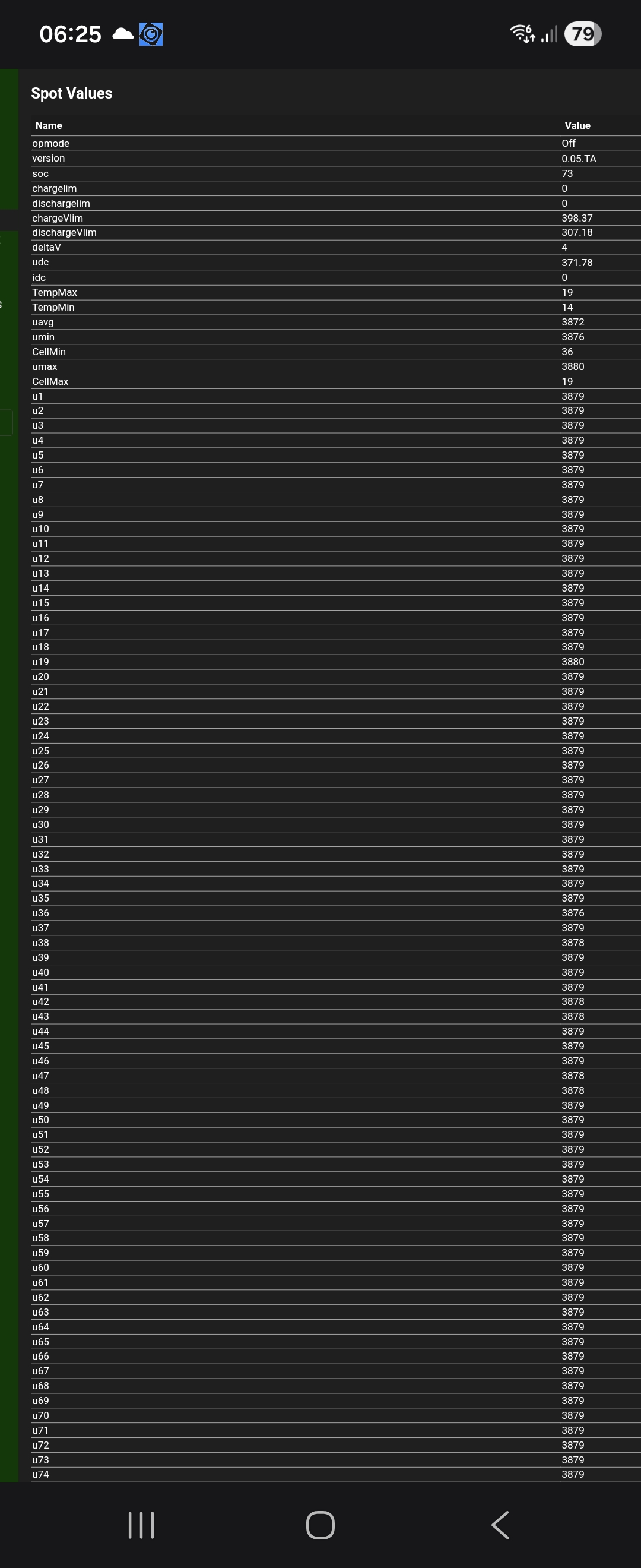

Cells balancing 95
I stopped balancing today, this is can readout.
If I had more time balancing would be perfect balanced within 1mv
