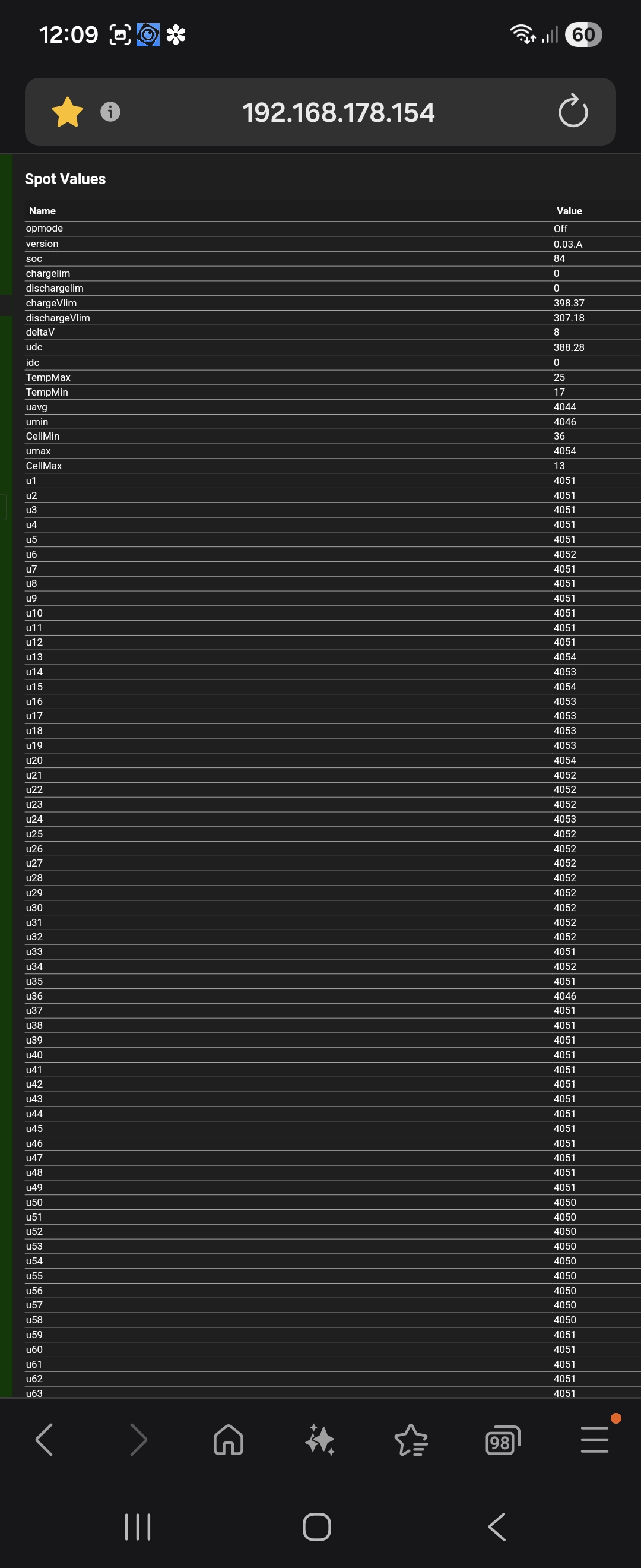

I also connect 4 modules, changed parameters to 4 modules, plugged two wires in one connector on hvc, other connected to hvc, but little data?
After it, I plugged out other connector from bmb4 to hvc, but same data.
After it connect to one module again, same... little data.
Is it unstable?

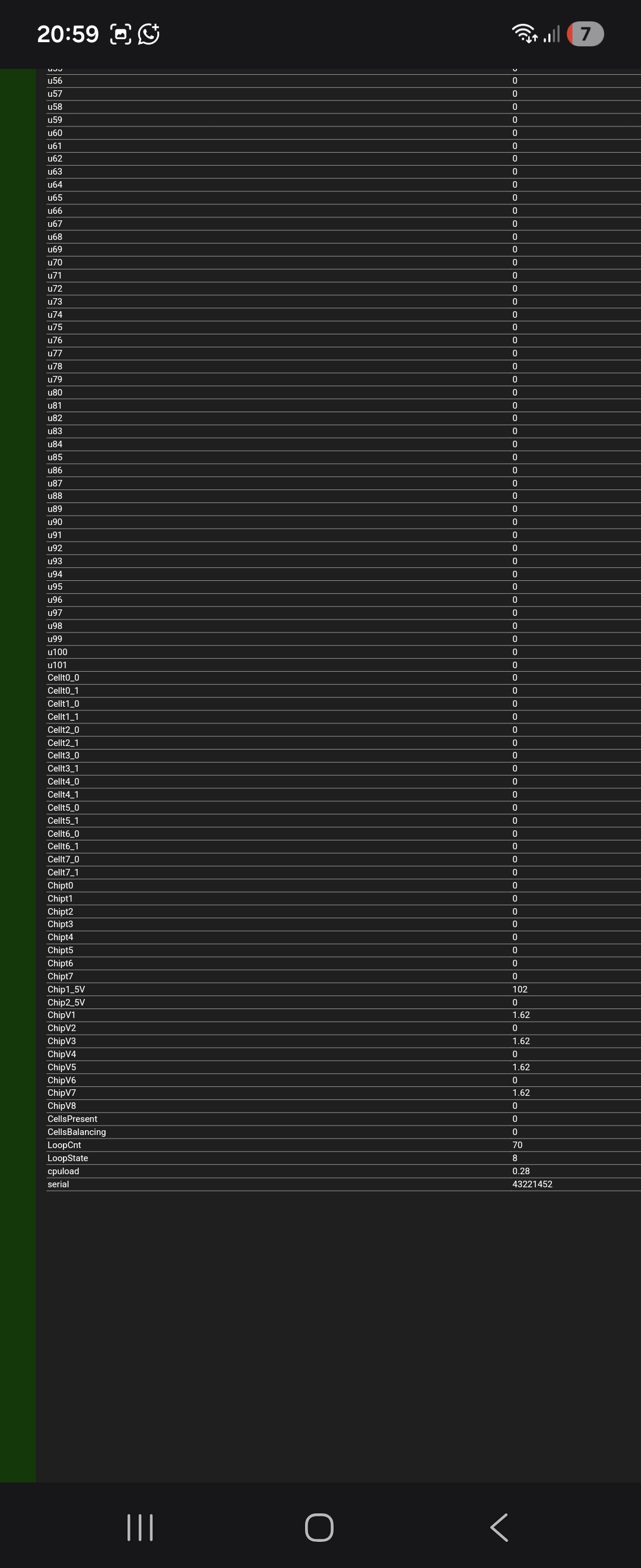

Data is very unstable...
Now its not displaying voltages anymore... somethimes some temperatures

After a night, cell voltages are back ...
Sometimes temps comes and then go...
I select balancing on, first time showing 23 balancing, now none...
What could be the problem?

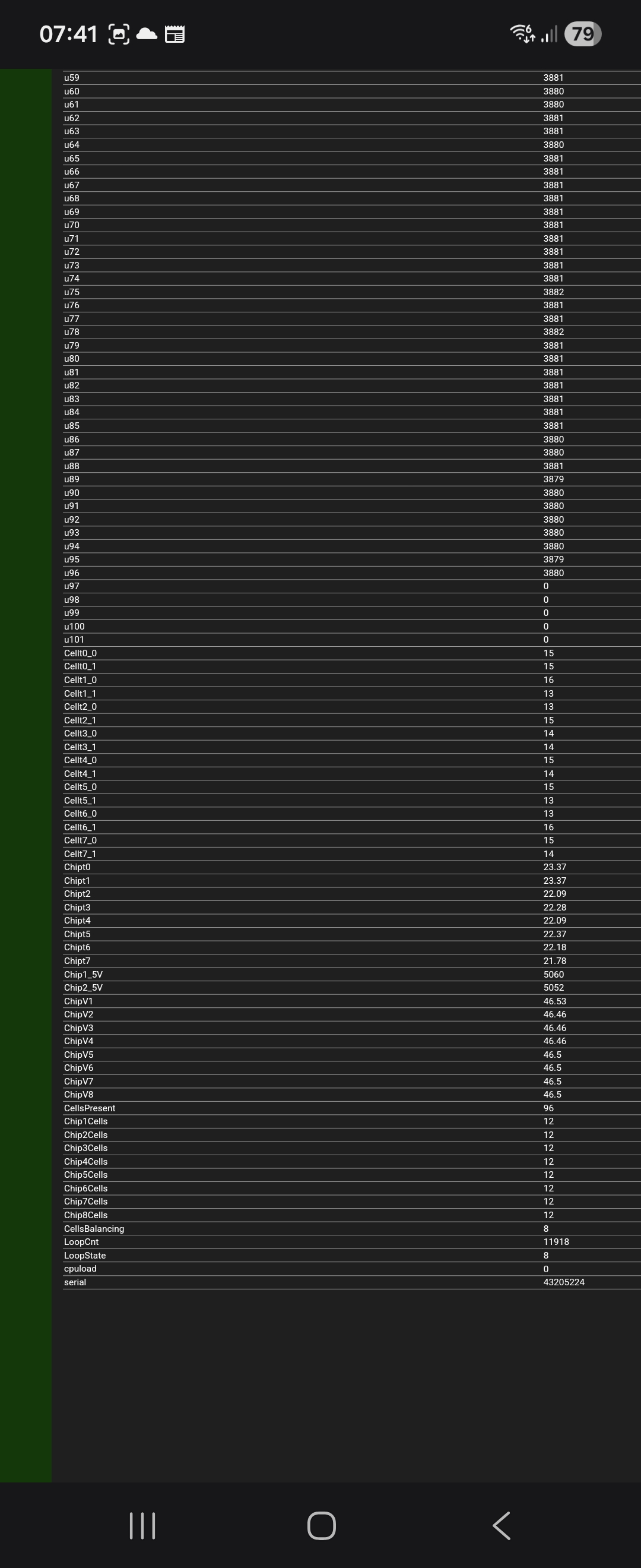

I think he is doing something. But what?
5mv imbalance
52 cells balancing
It seems the lowest is more rising in state of the highest are decreasing...

by tom91
hanskraayeveld wrote: Tue Oct 14, 2025 5:47 am Question for makers: cell balancing M3 module is done by resistance wire, right?
1: How did you imitate this on a bench?
2: When balancing, cell voltage is not available (shorting wires), how is voltage measurement performed when balancing? Balancing stops for a few ms?
3. Why is uavg not matching, also before I do modulifications
1. request balancing and check feedback from the BMBs, as I said I will look to find some time soon to revisit this.
2. Before requesting a measurement balancing is paused. This maybe the reason balancing is not happening porpperly.
3. No idea can take a look when having everything set up again.

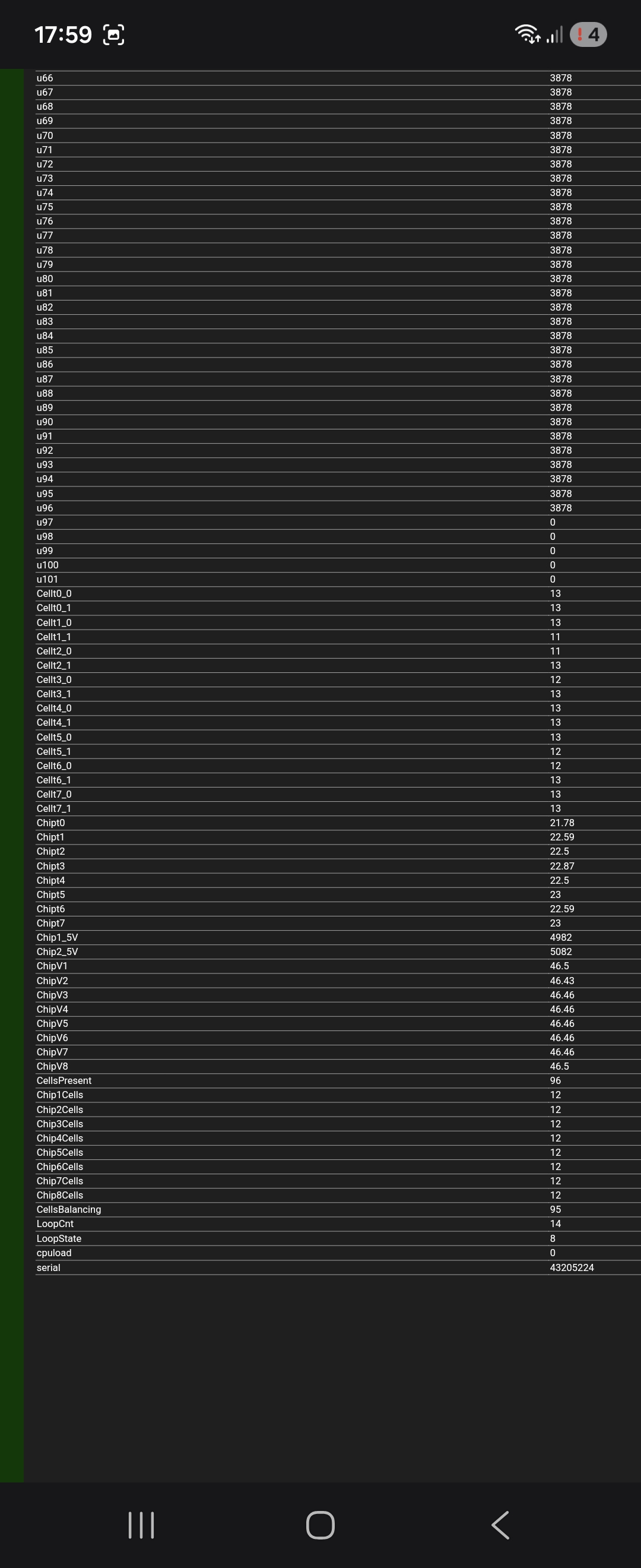

Cells balancing 95
I stopped balancing today, this is can readout.
If I had more time balancing would be perfect balanced within 1mv
