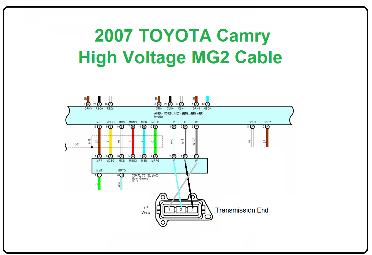

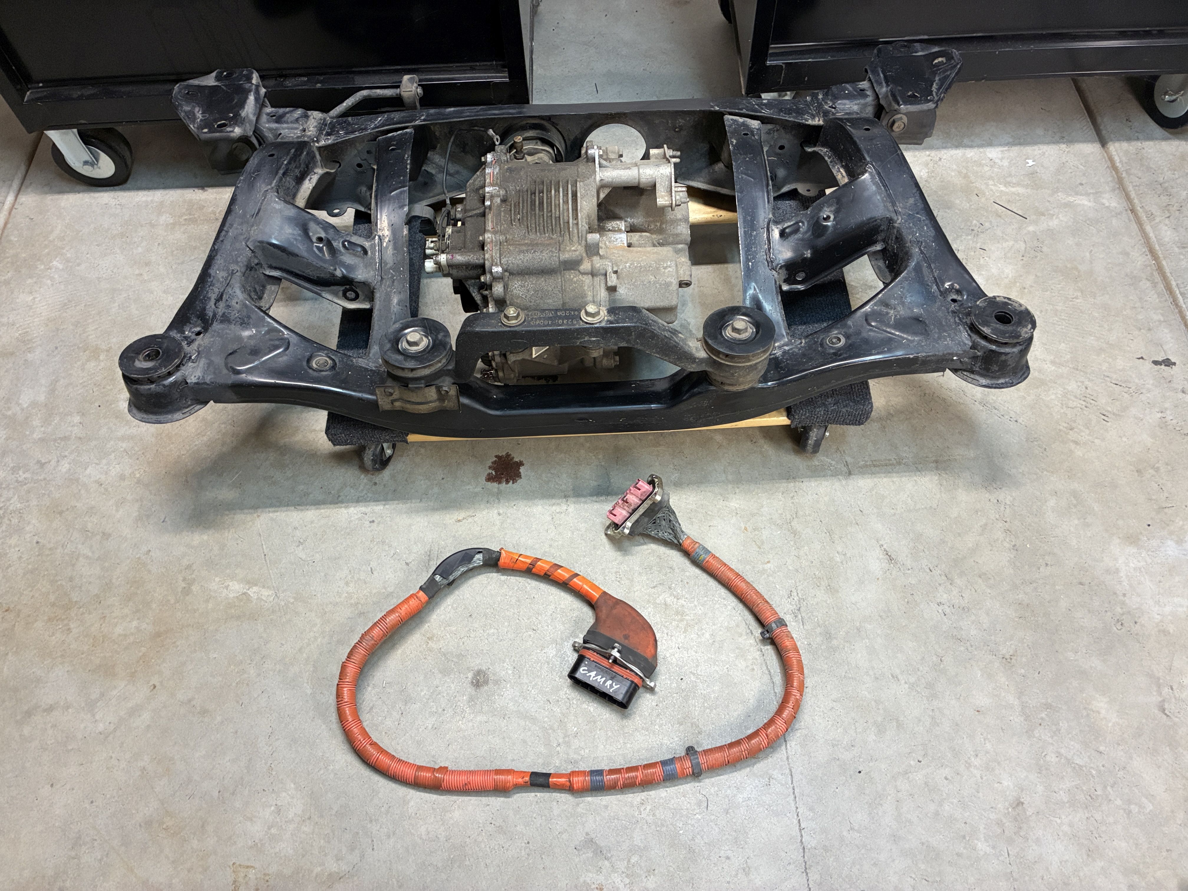

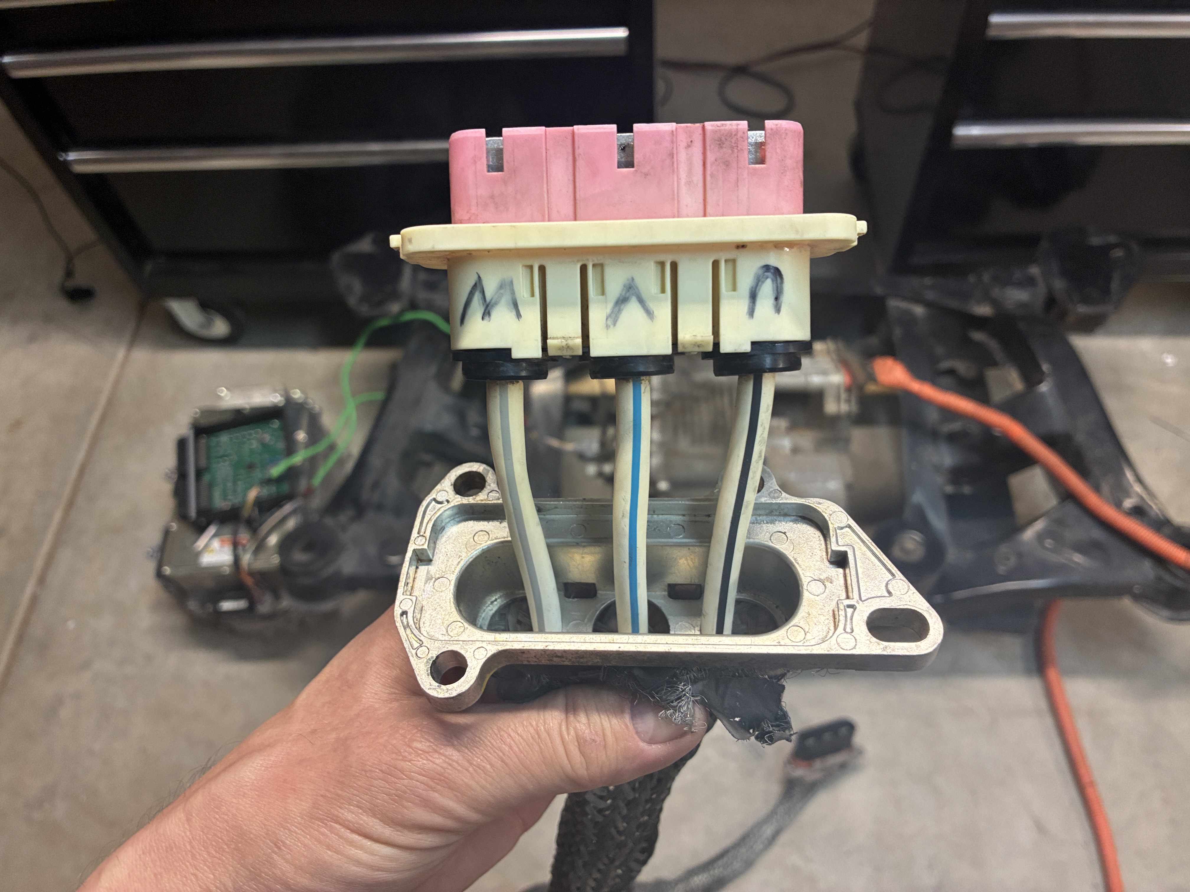

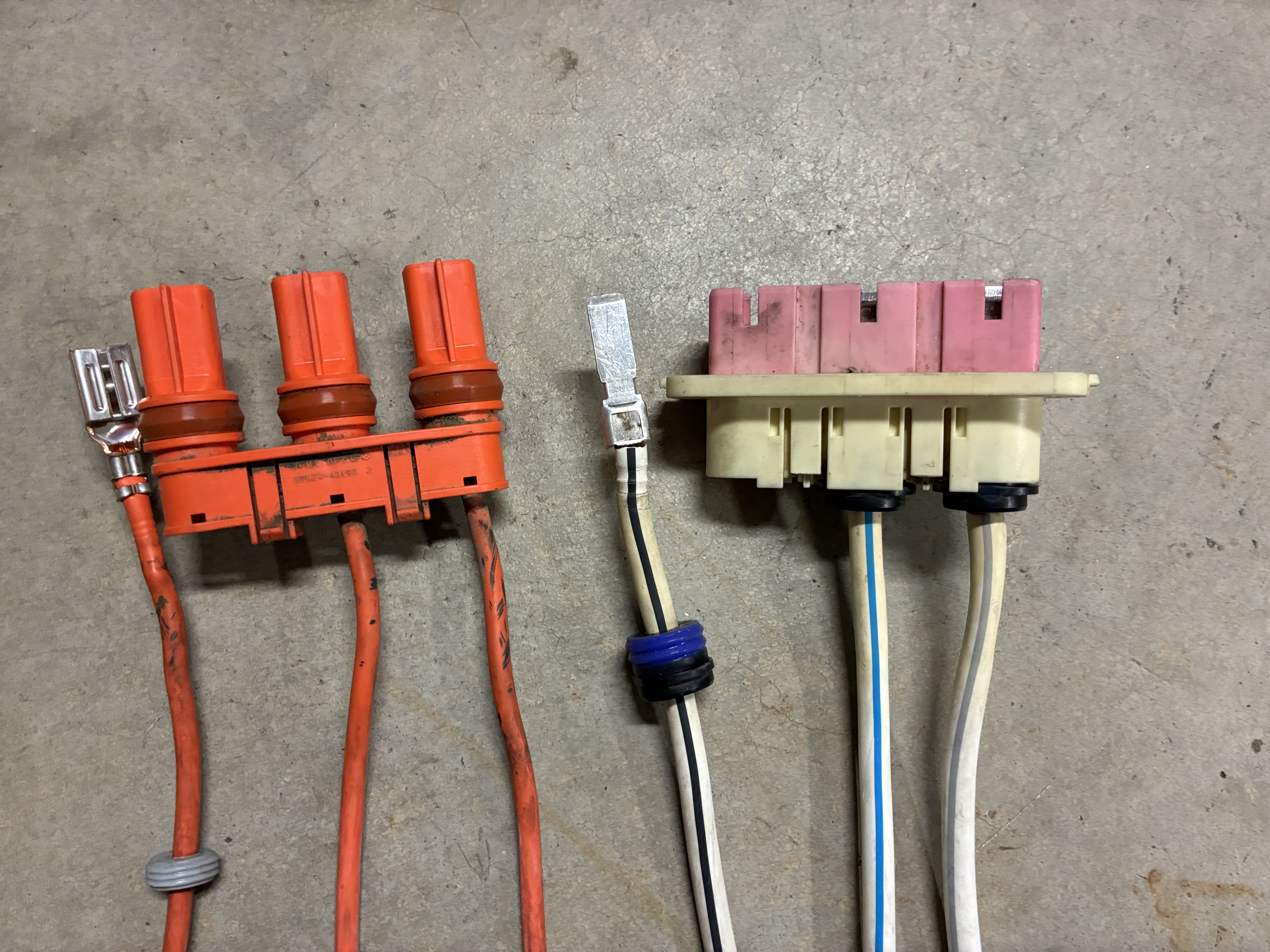

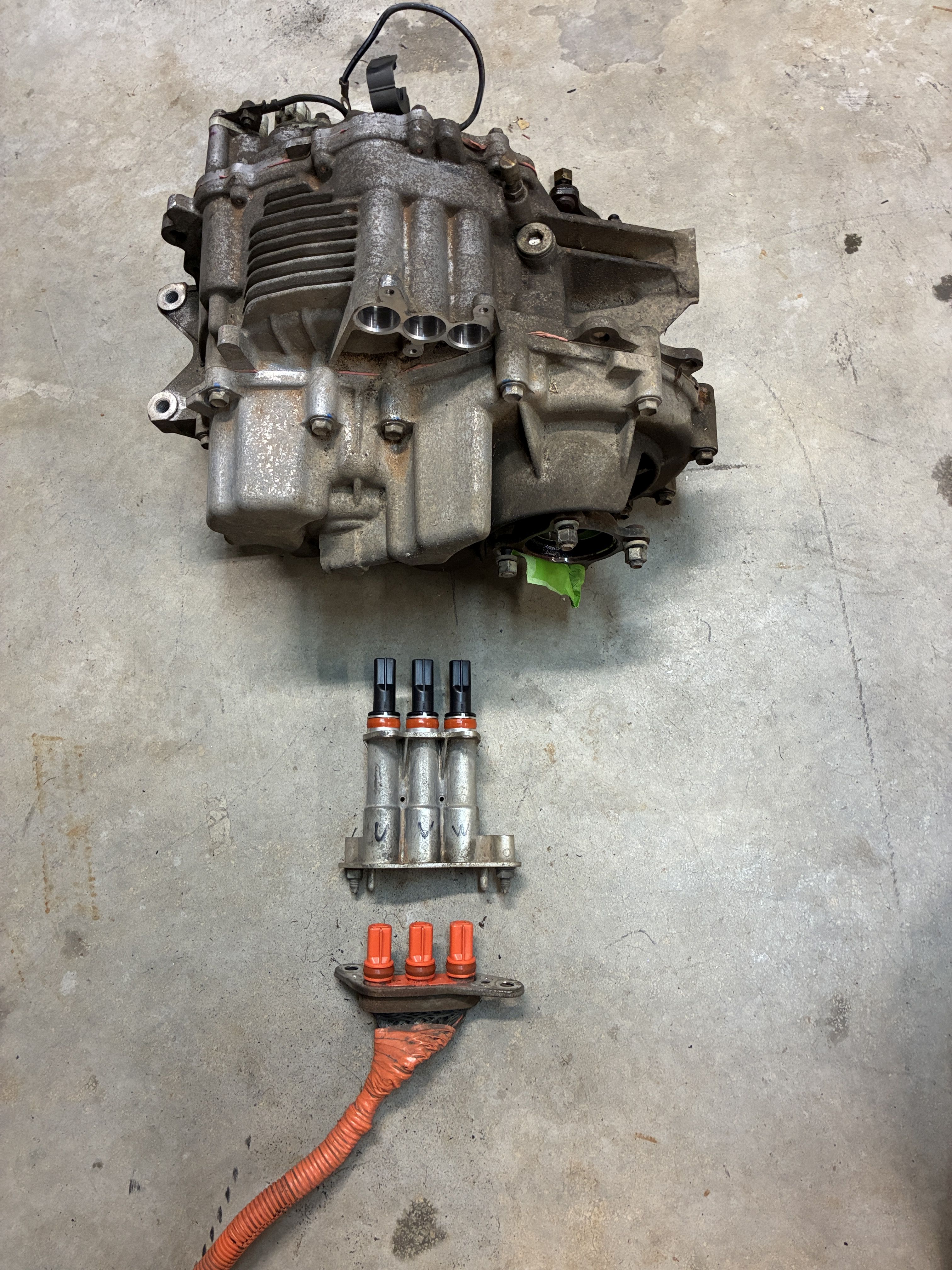

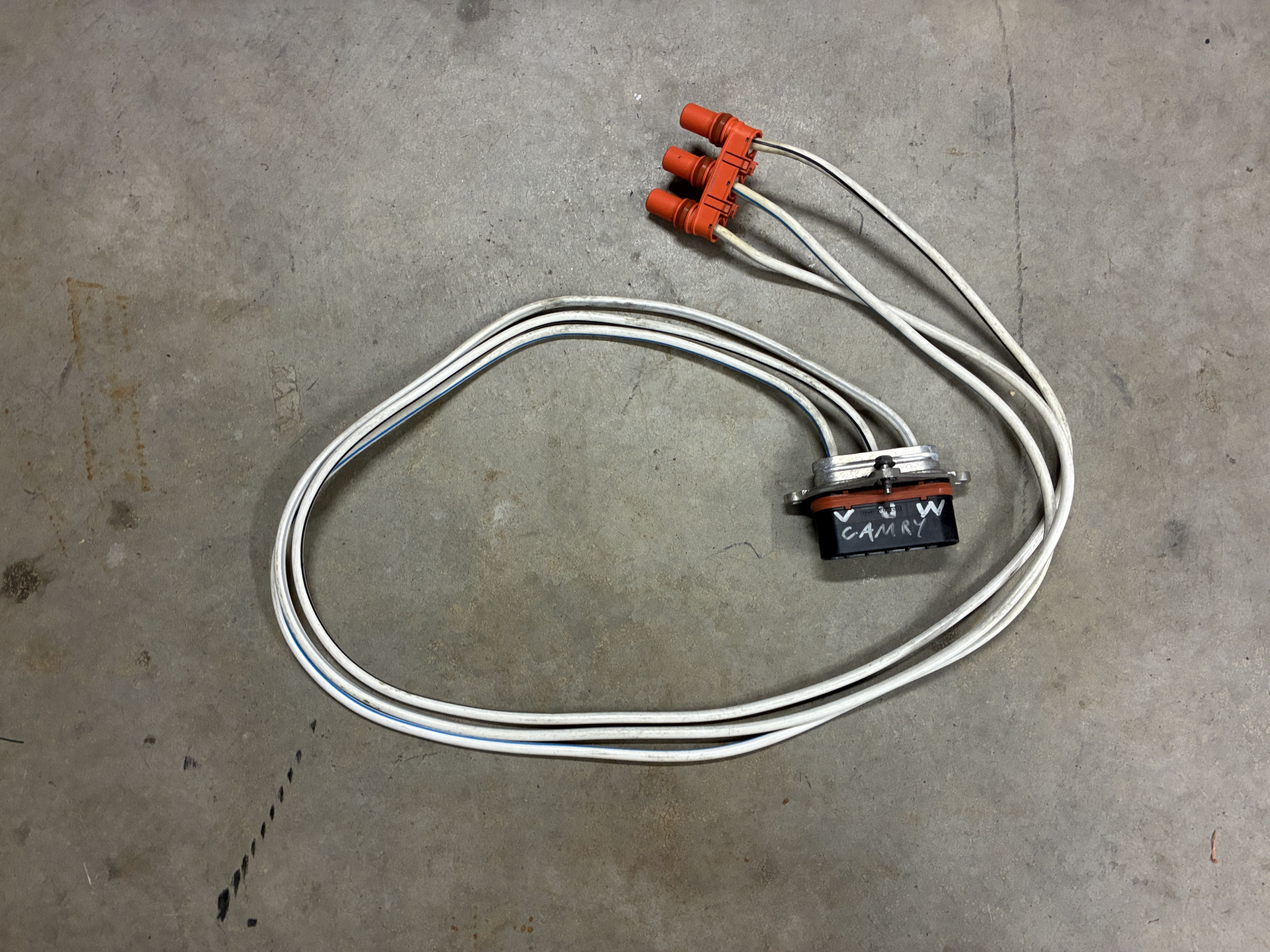

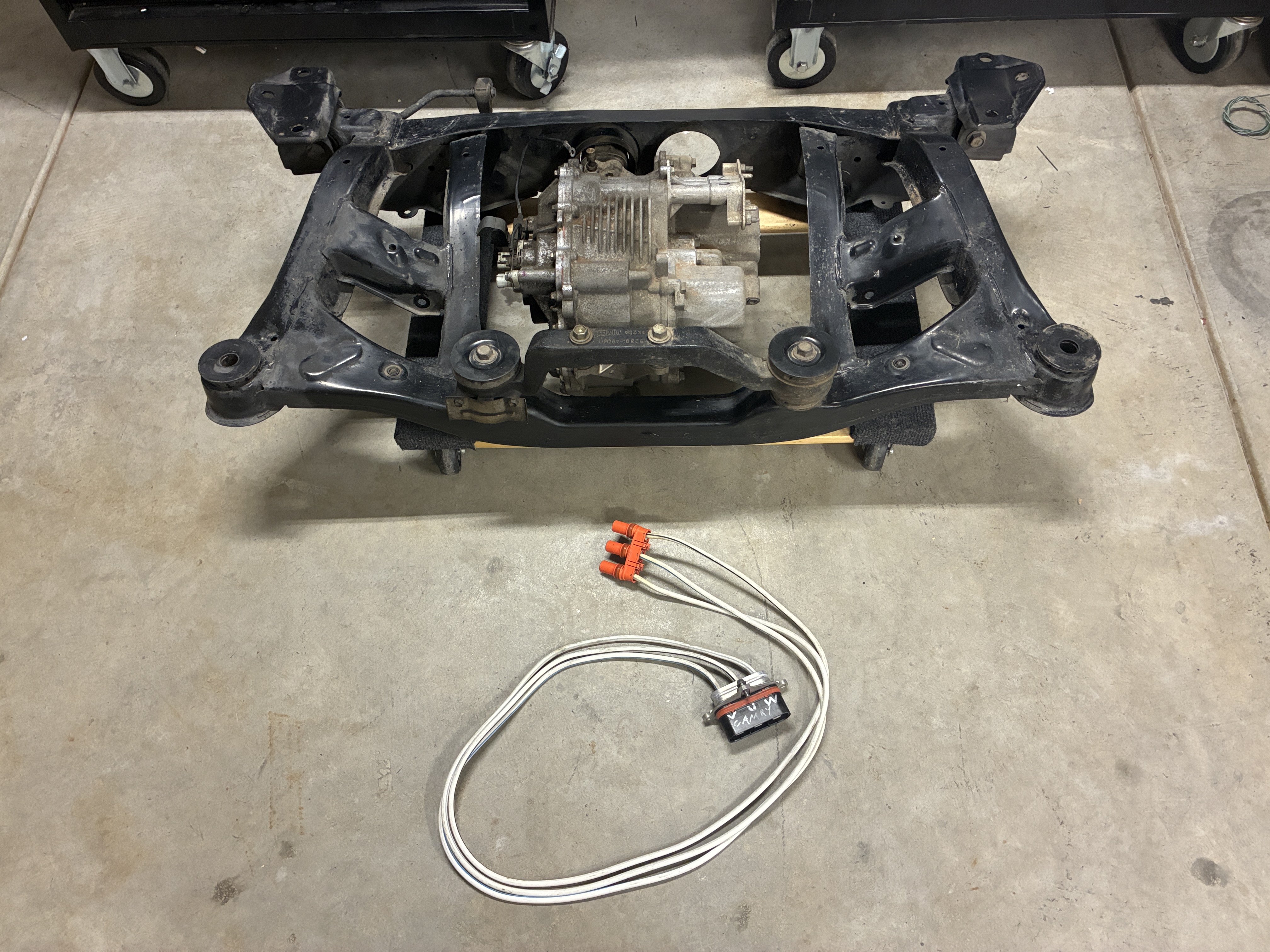

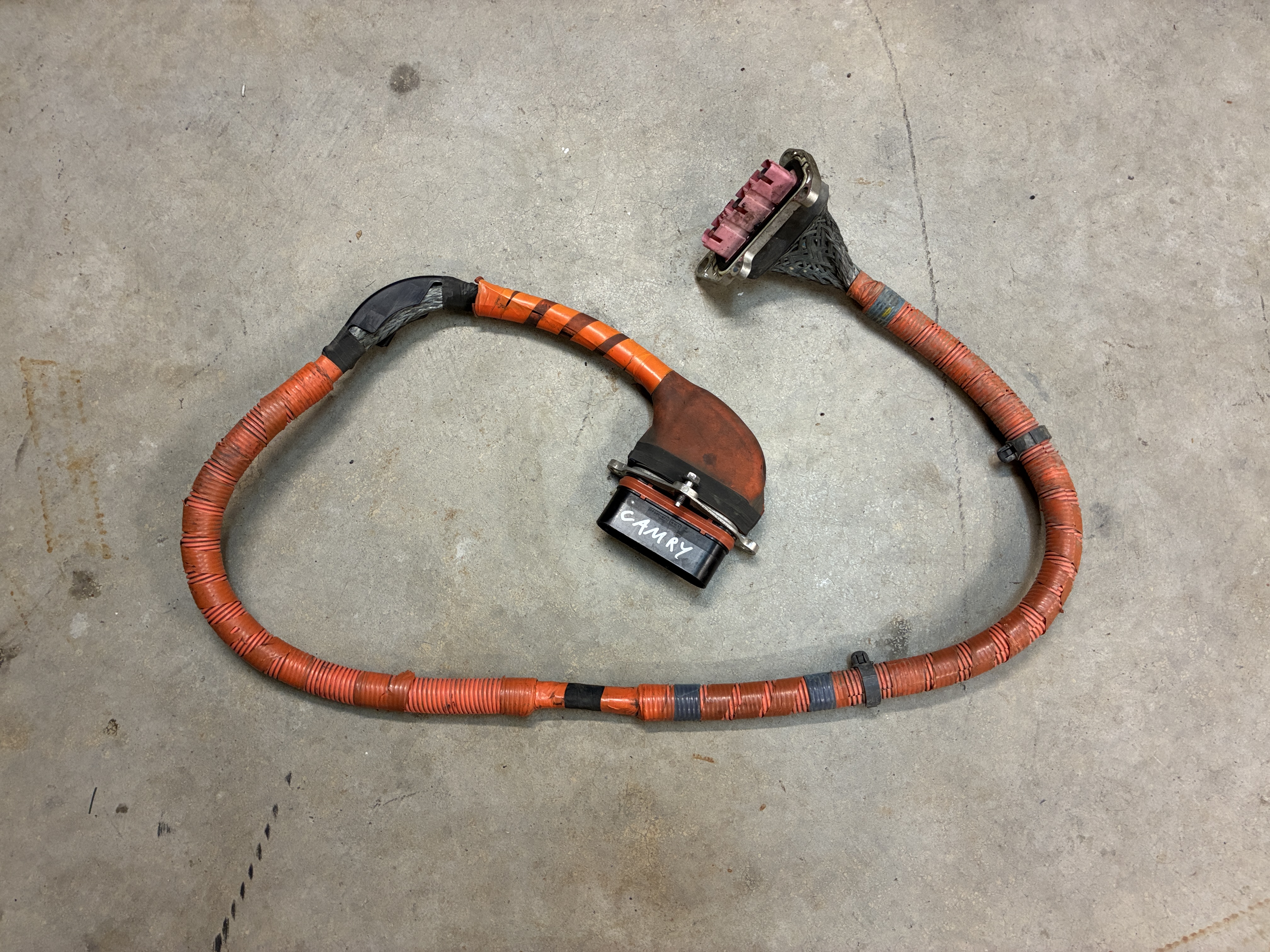

let's see if we can make the beefier Camry MG2 motor cable work as well
decided to skin it as well to make sure we get the Three Phases of the Moon aka U, V, W correct
nearly impossible to tell but these do have identifiable colored stripes, and notice how they aint orange

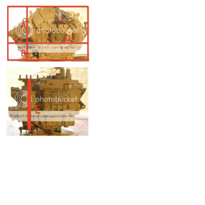

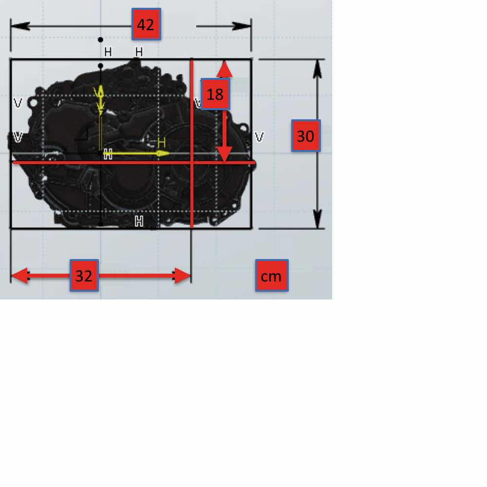

Hello Greg,
I follow your work with great interest!

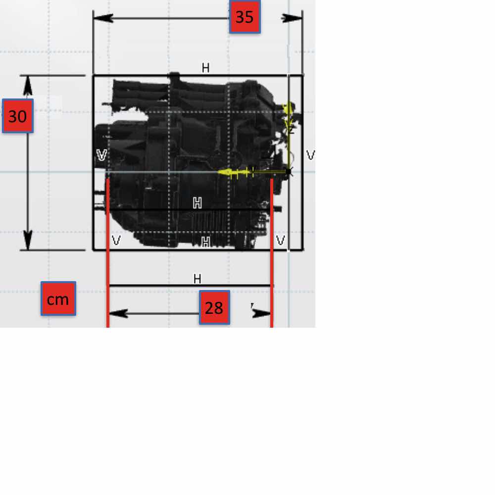

Could you provide us with more dimensions (external dimensions) for the motor?
And another question: Do you have any expectations regarding the top speed for a given wheel diameter and battery voltage? Or are you just waiting to see how things turn out? Other pioneers were ultimately dissatisfied with the MGR and then converted to Outlander.

TRWIKI wrote: Tue Feb 17, 2026 7:19 am Hello Greg,
thanks for the kind words, hope to have these dimensions for you today
measurements approximate at best, I would not send anything to Send Cut Send based on these, lol
A -
B -
C - 4"
D - 12-1/2"
E - 10-7/8"

Re: Junkyard Report: 2009 Toyota Highlander AWD
https://grabcad.com/library/lexus-rx400 ... ic-motor-1
I did a 3D scan of one a while back

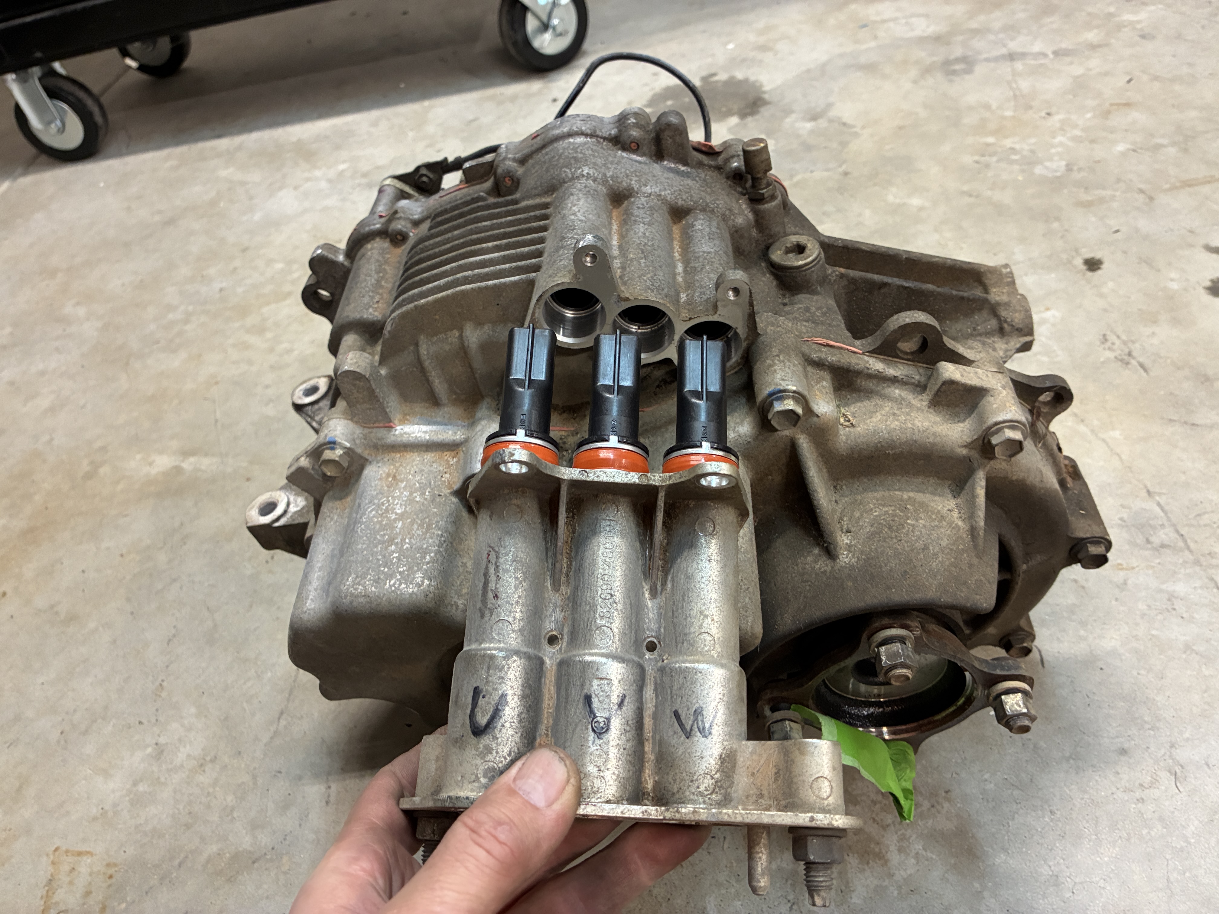

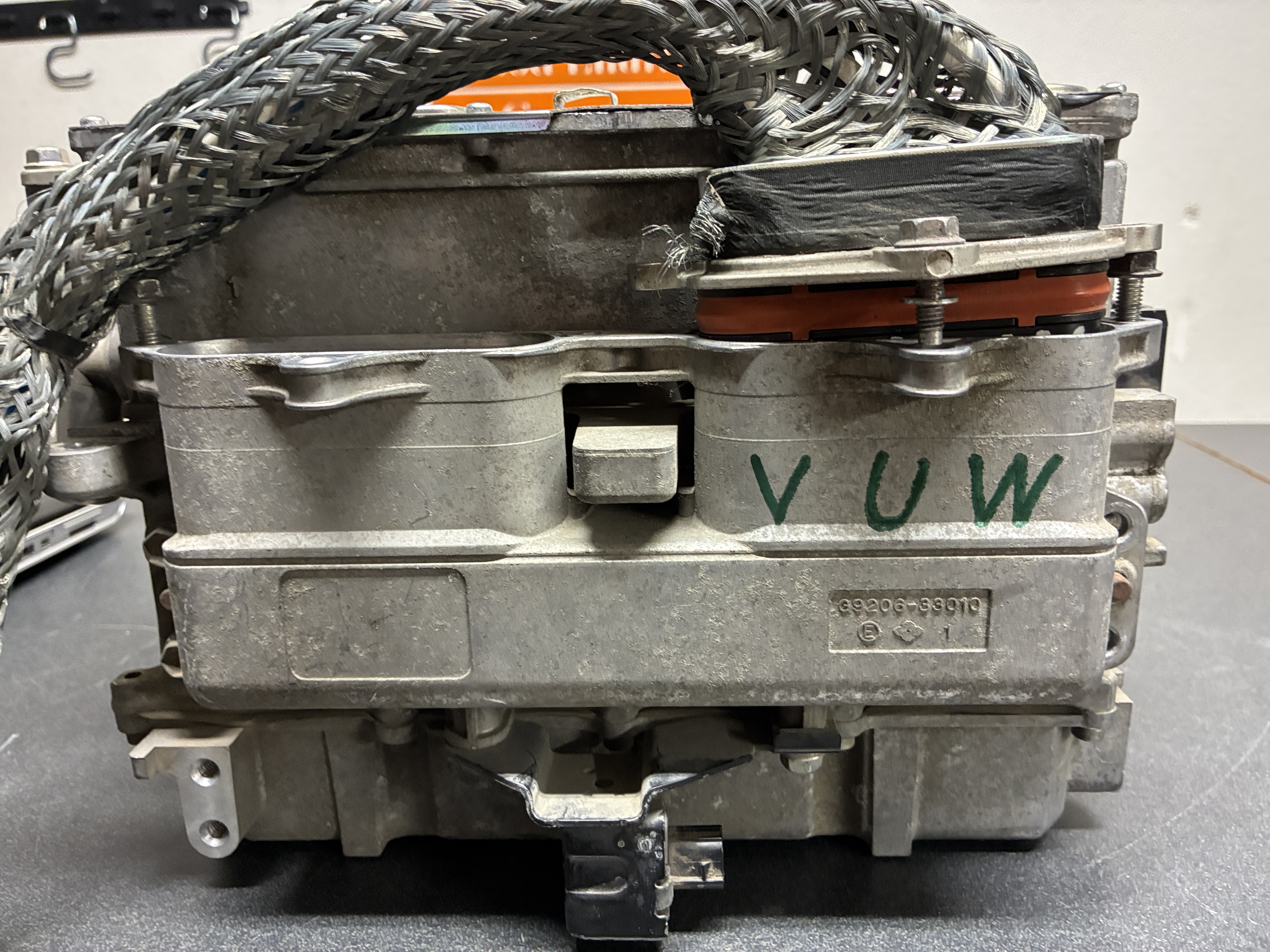

and this is what the three AC phases look like on the Camry inverter side
Gregski
Posts: 3157
Has thanked: 628 times
Been thanked: 1607 times
Post by Gregski »

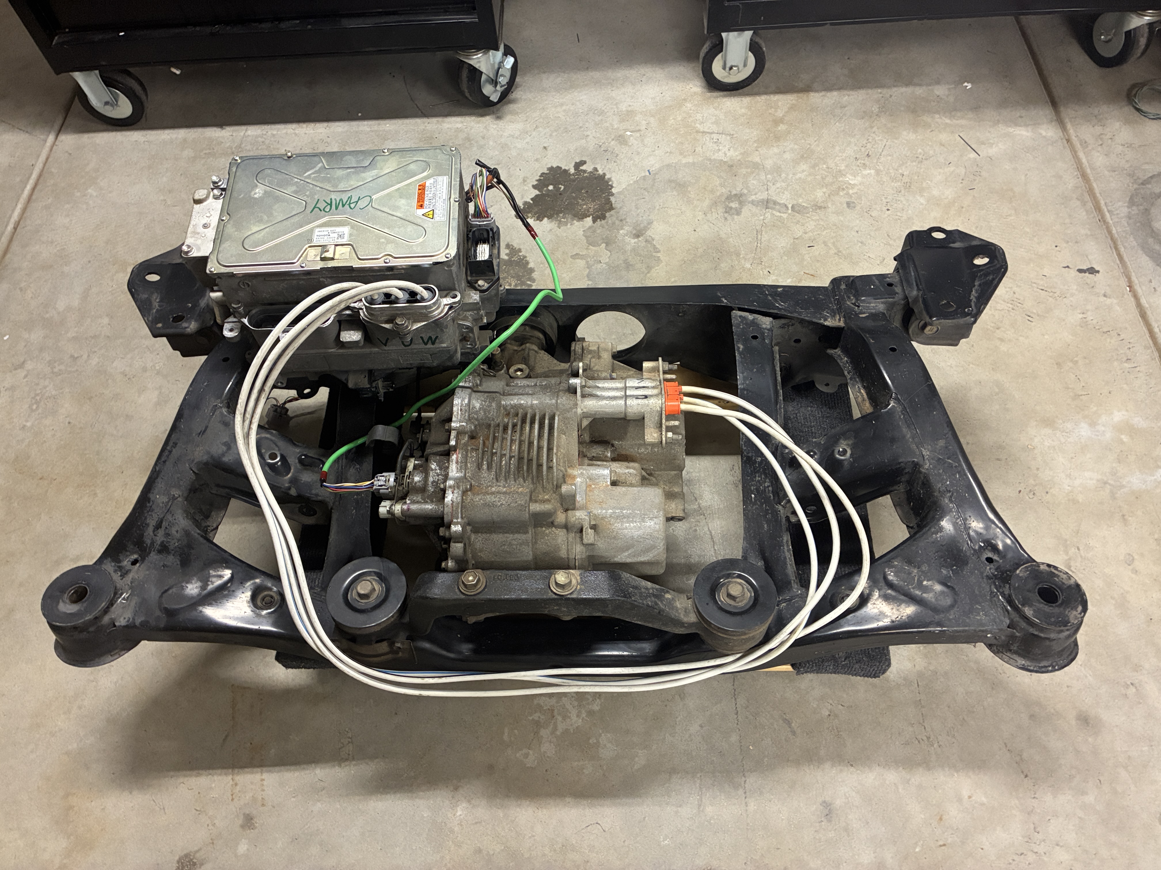

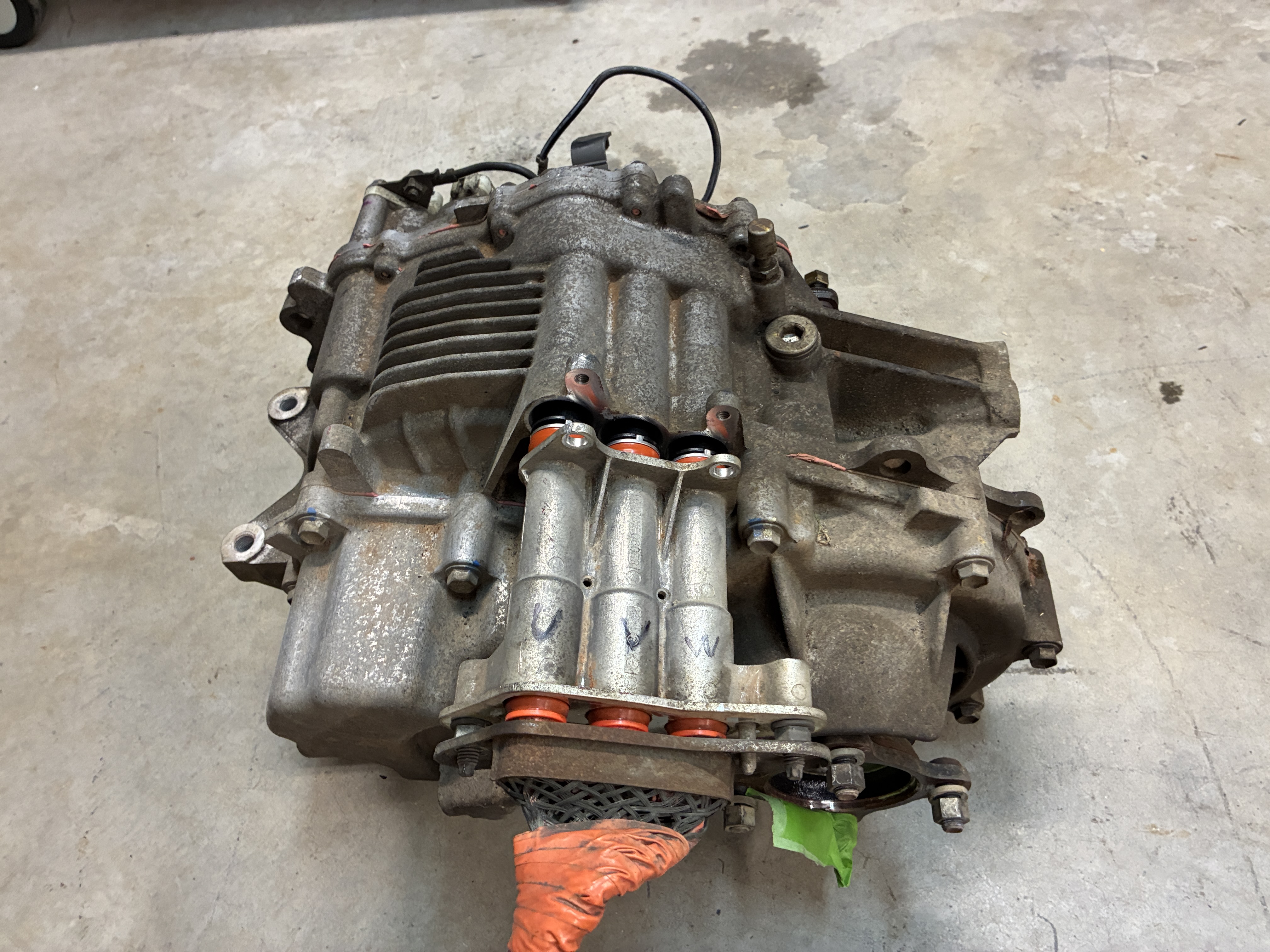

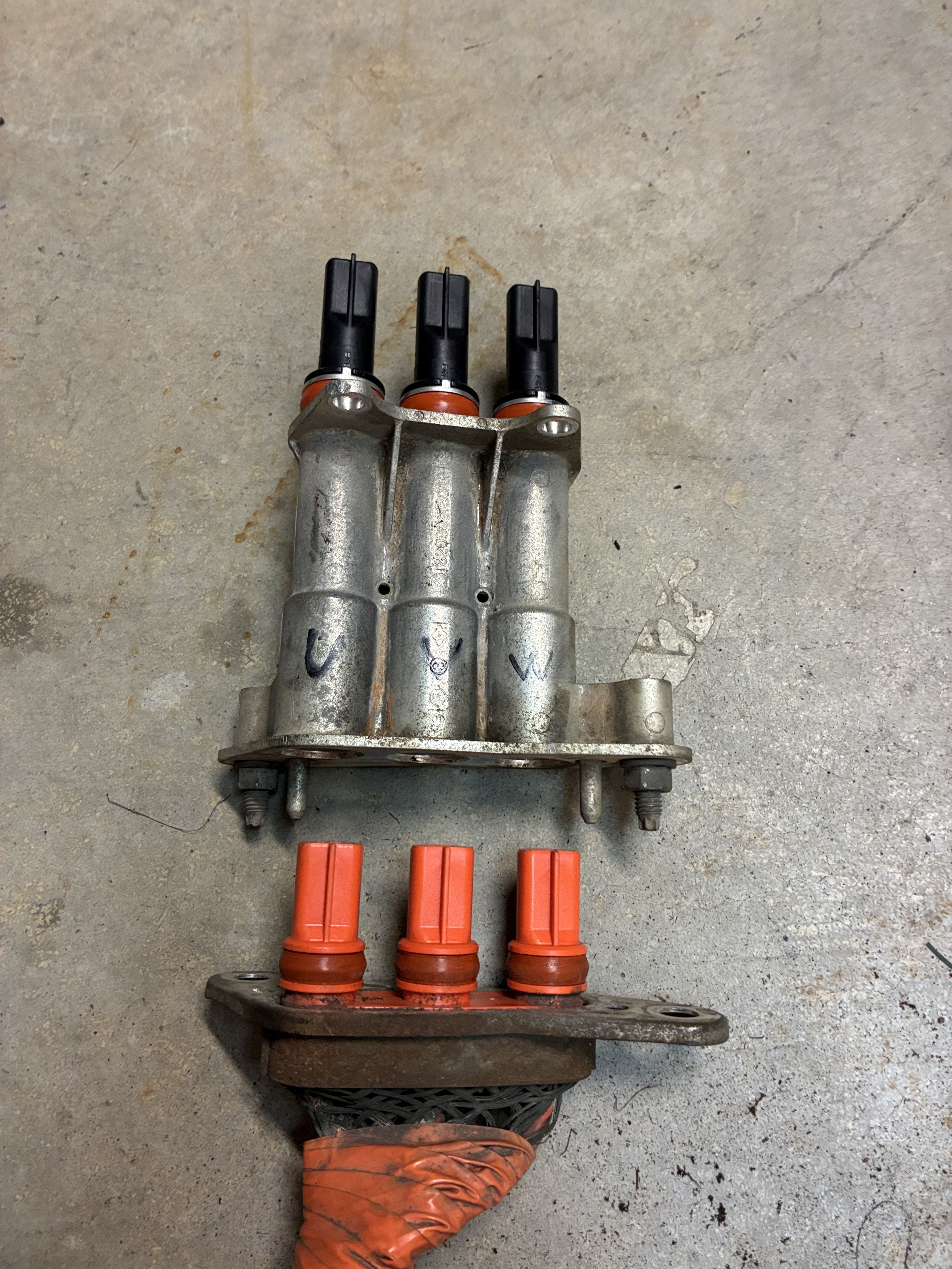

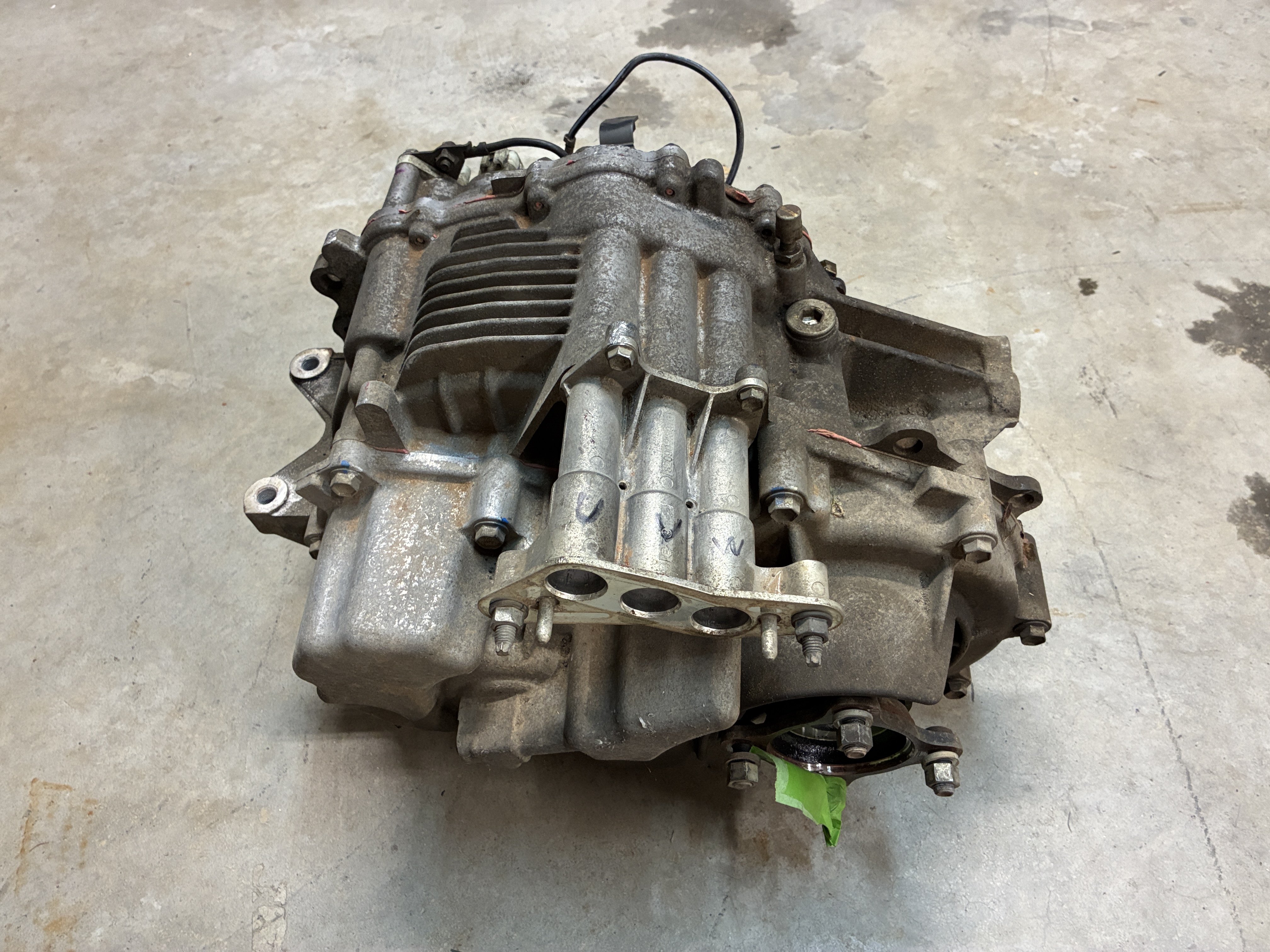

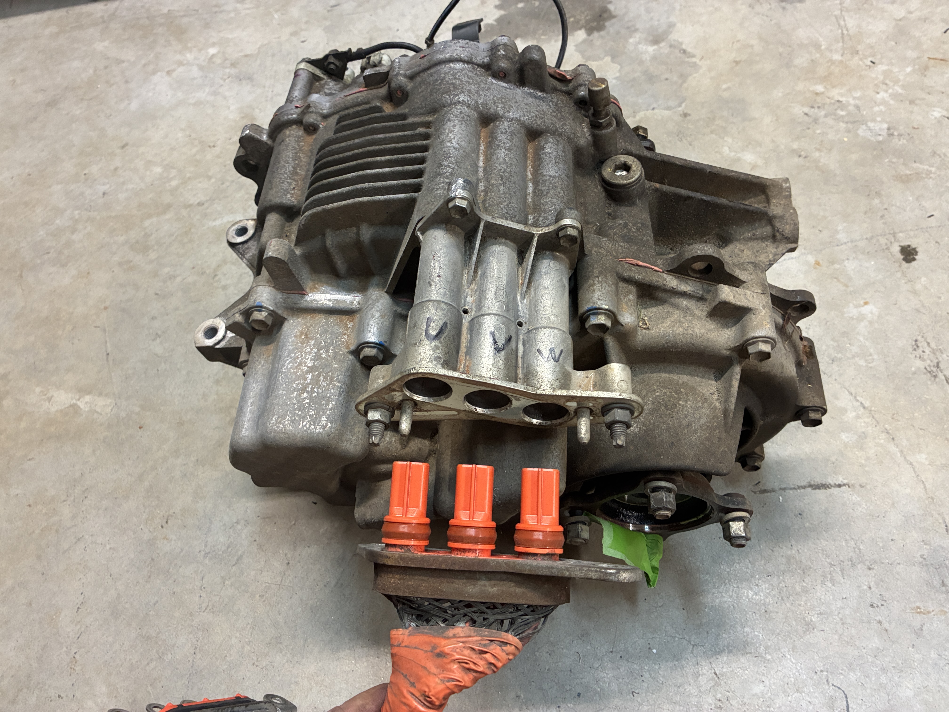

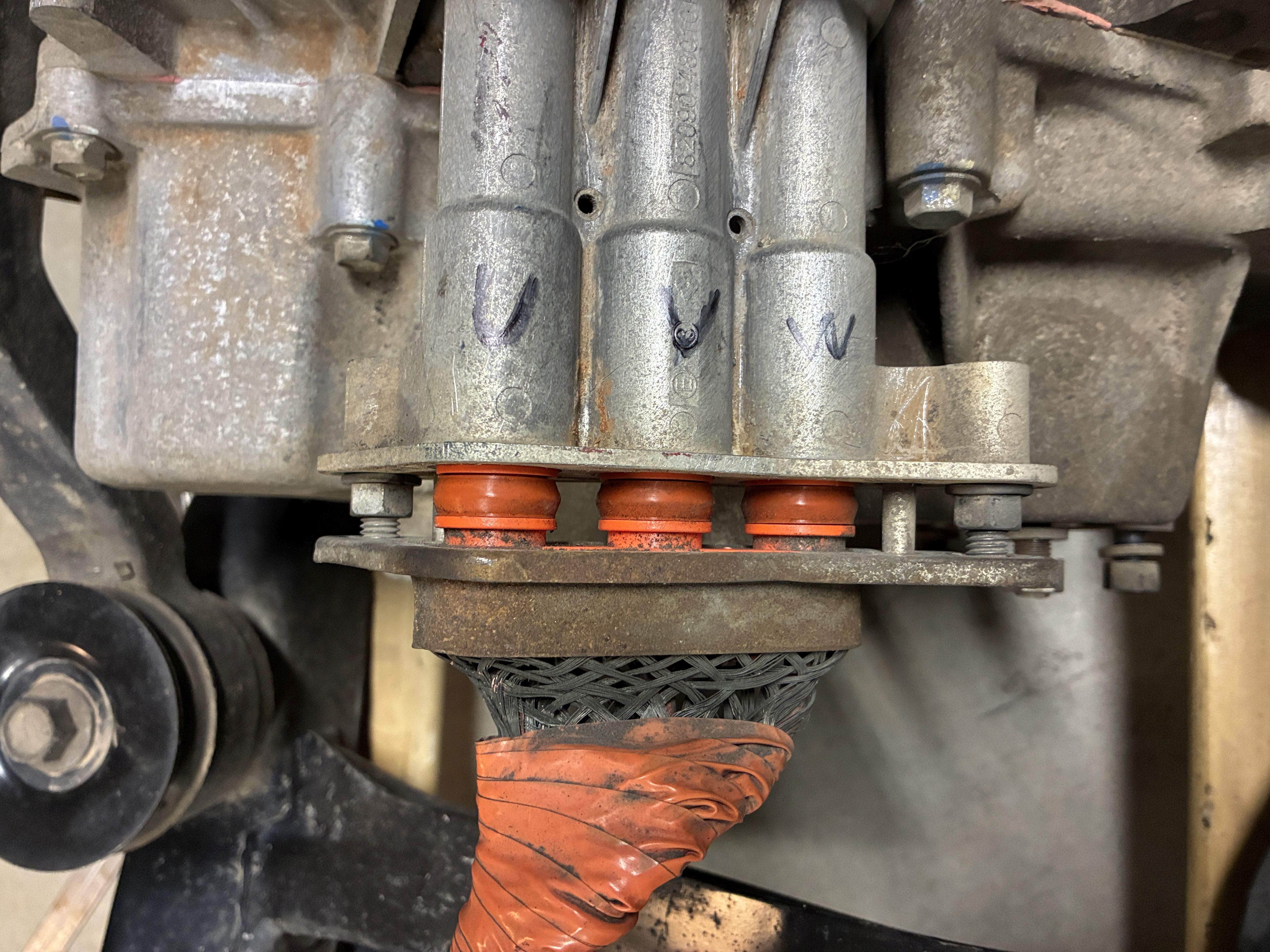

and I also identified and labeled the three AC phases on the Highlander MGR (Motor Generator Rear)
hard to tell: U V W so the same as the Camry transmission end, assuming the plug is flipped the right way

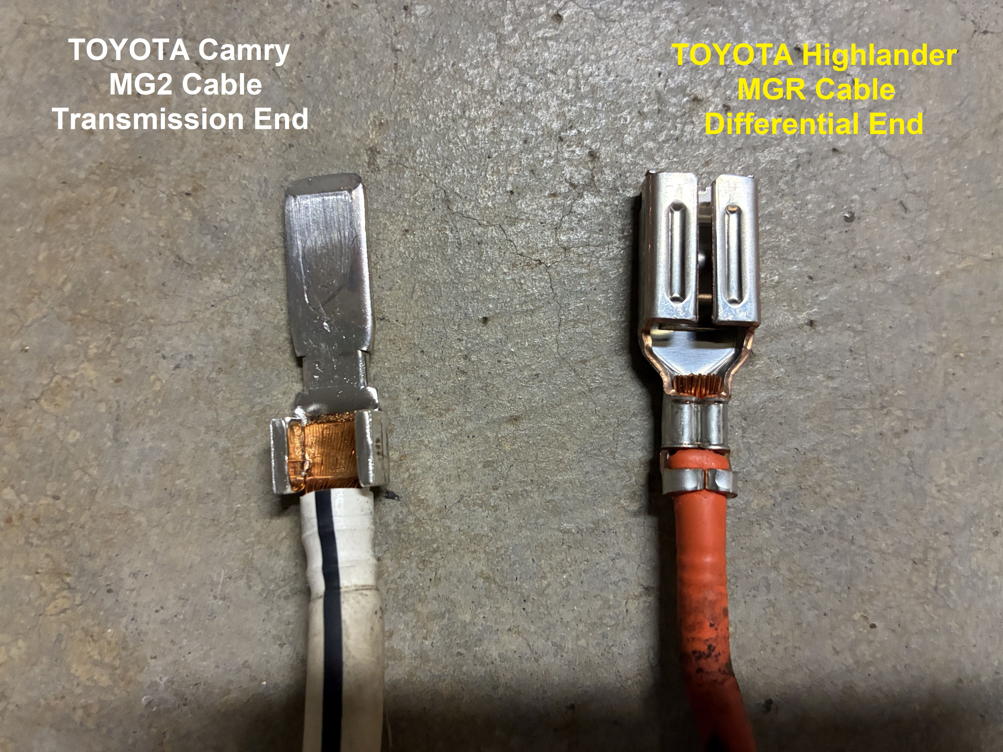

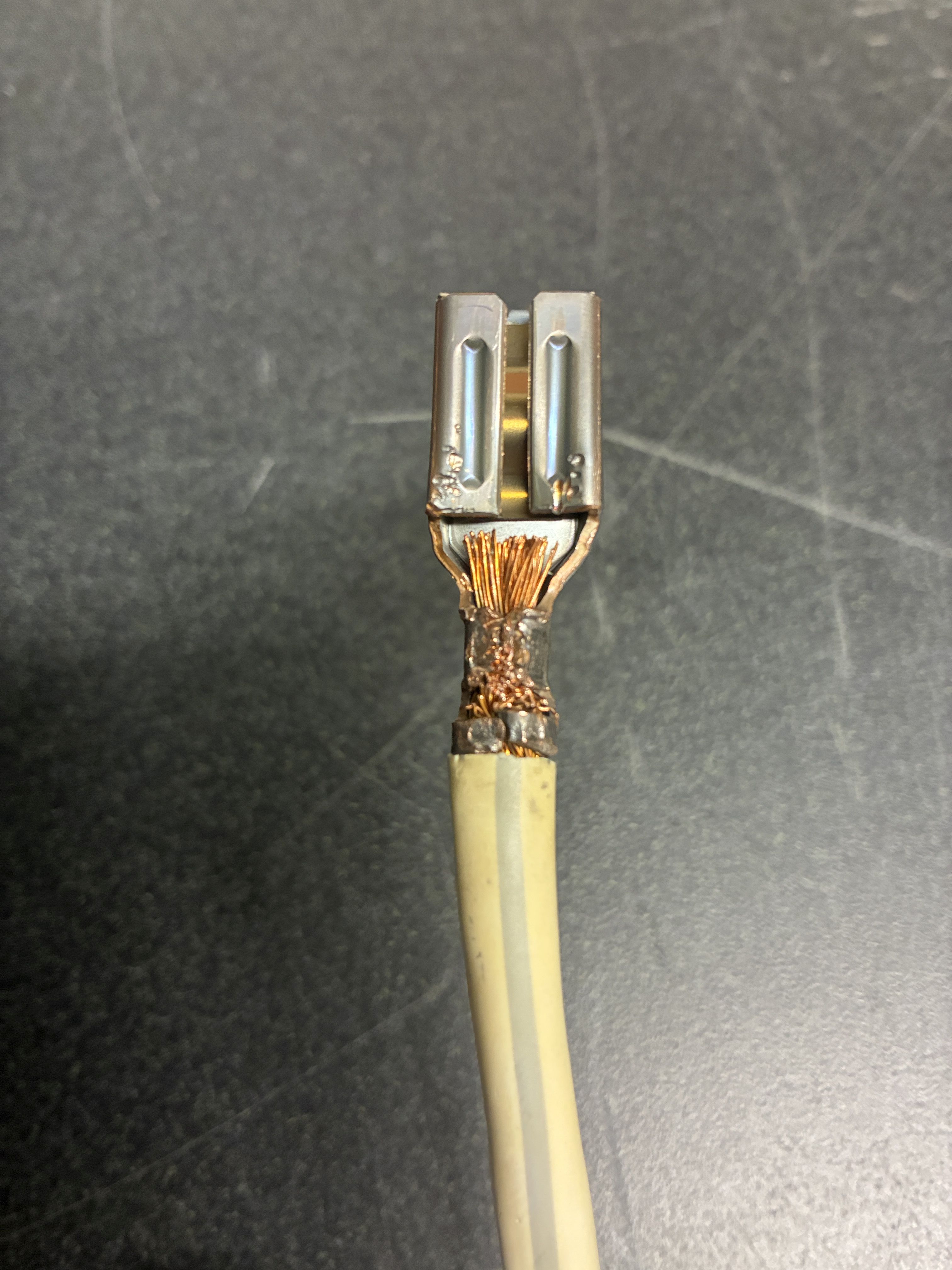

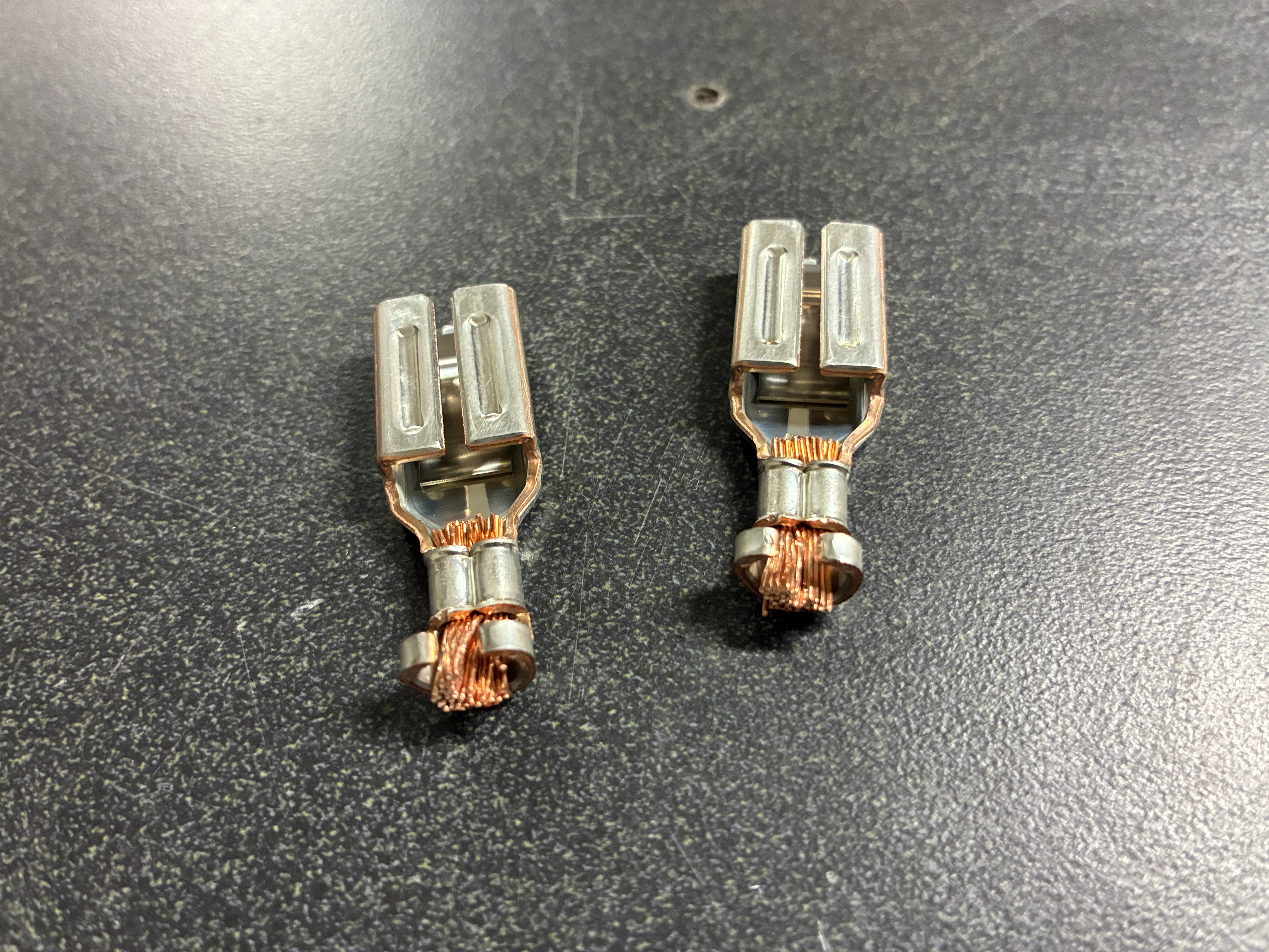

and now for the fun part, now WE have to transfer the crimped on connector off of the orange Highlander MGR cable and affix it to the white Camry one, and do that 3 times
good enuff for government work

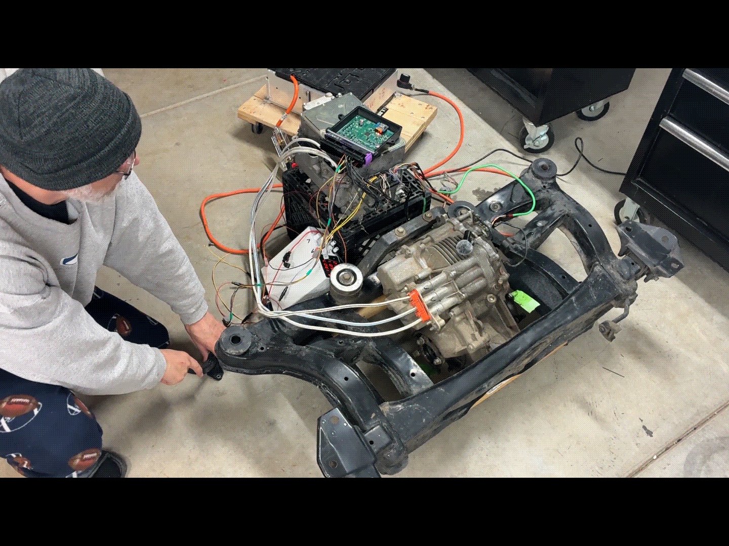

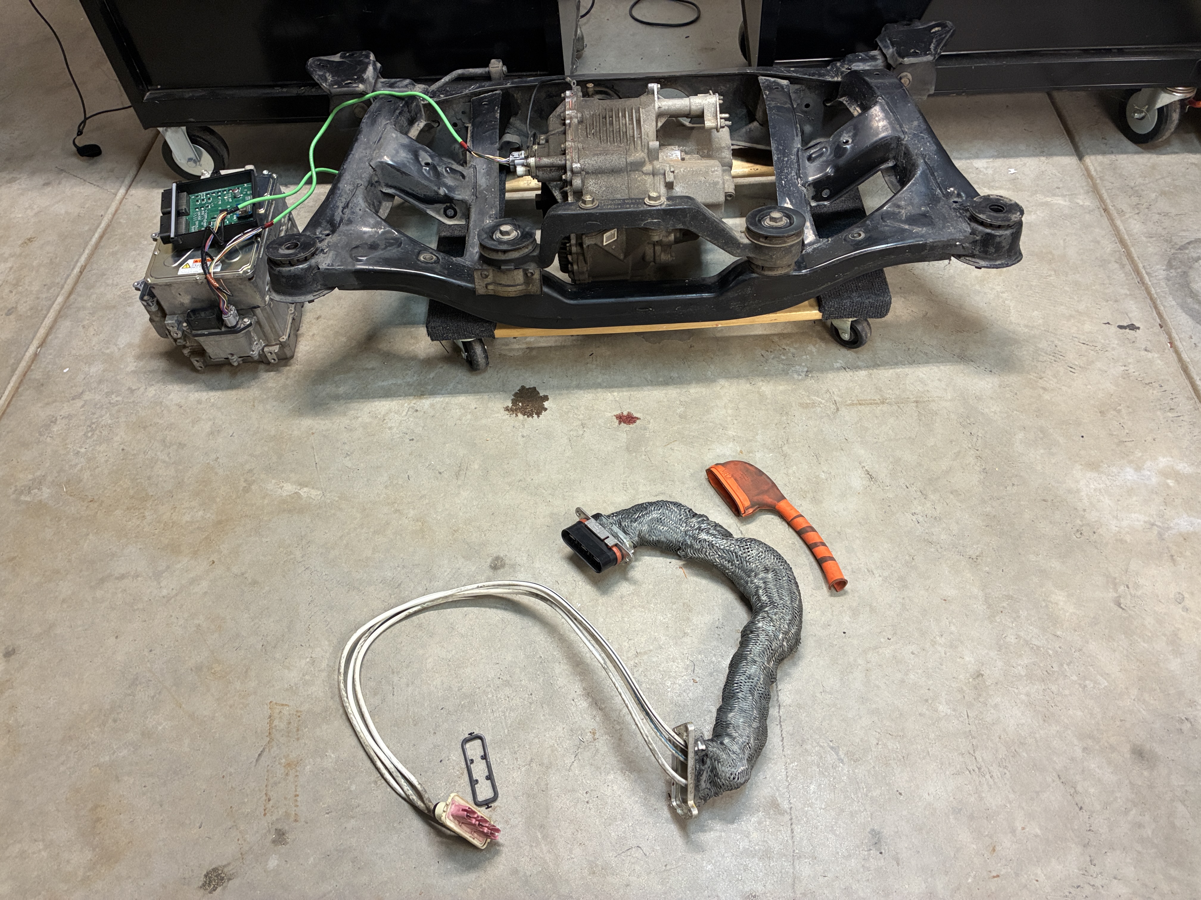

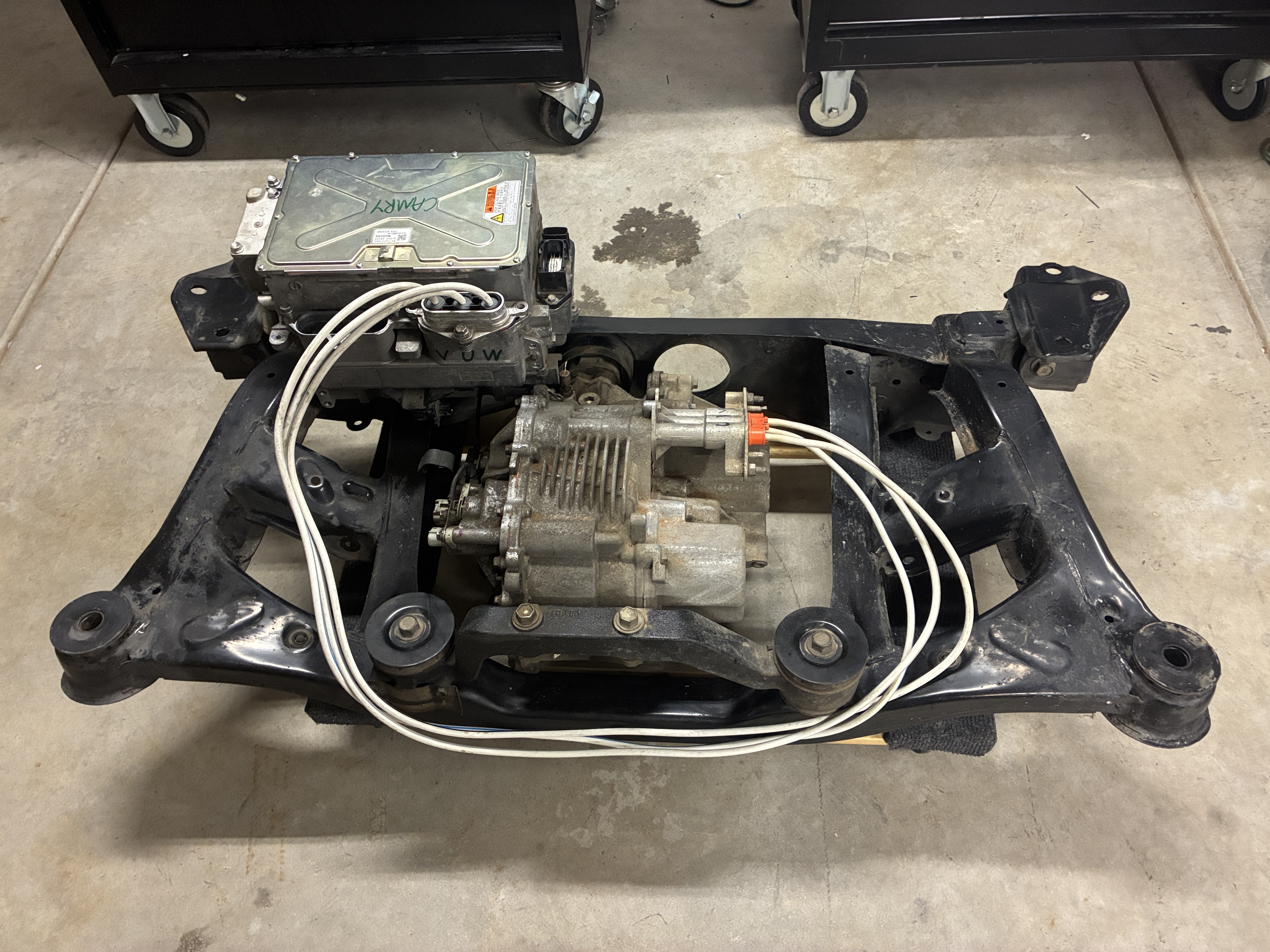

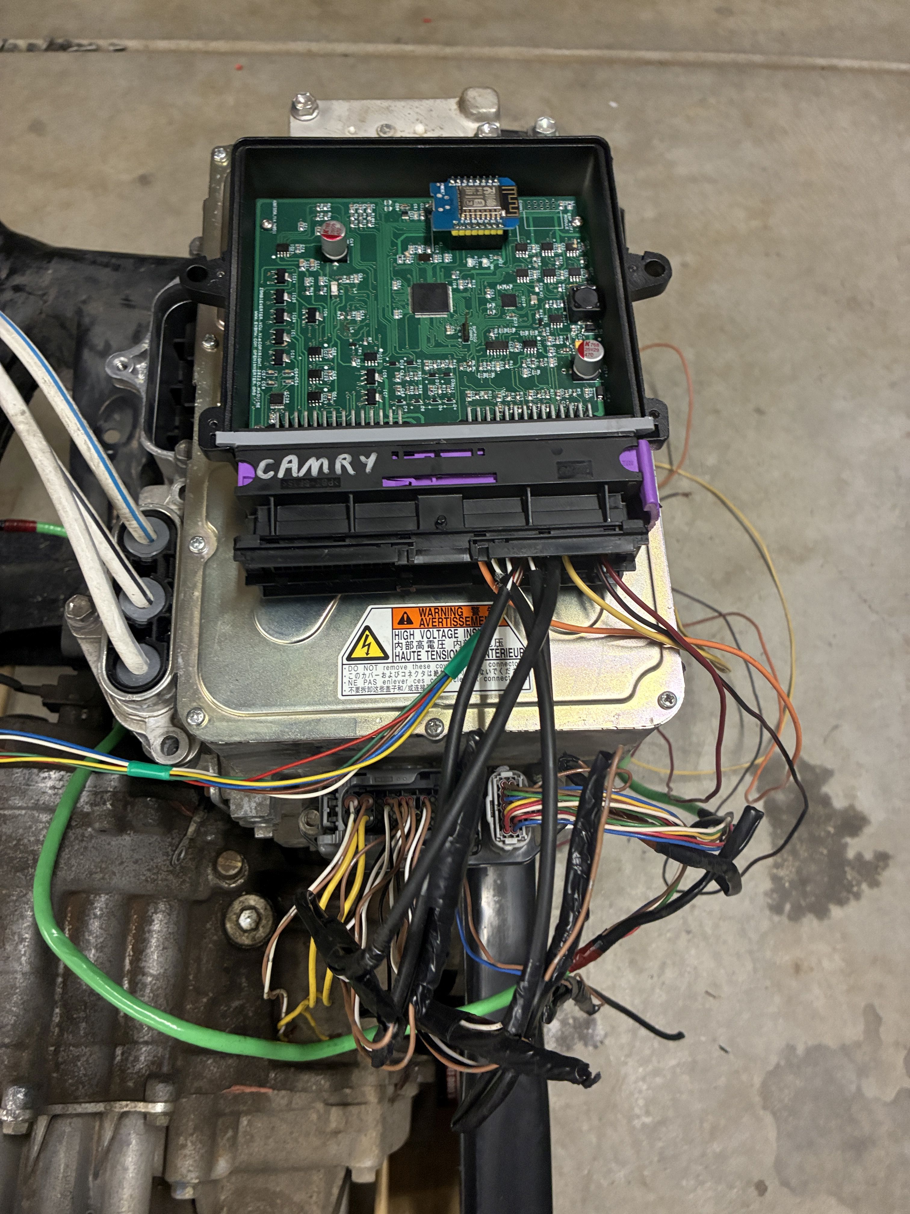

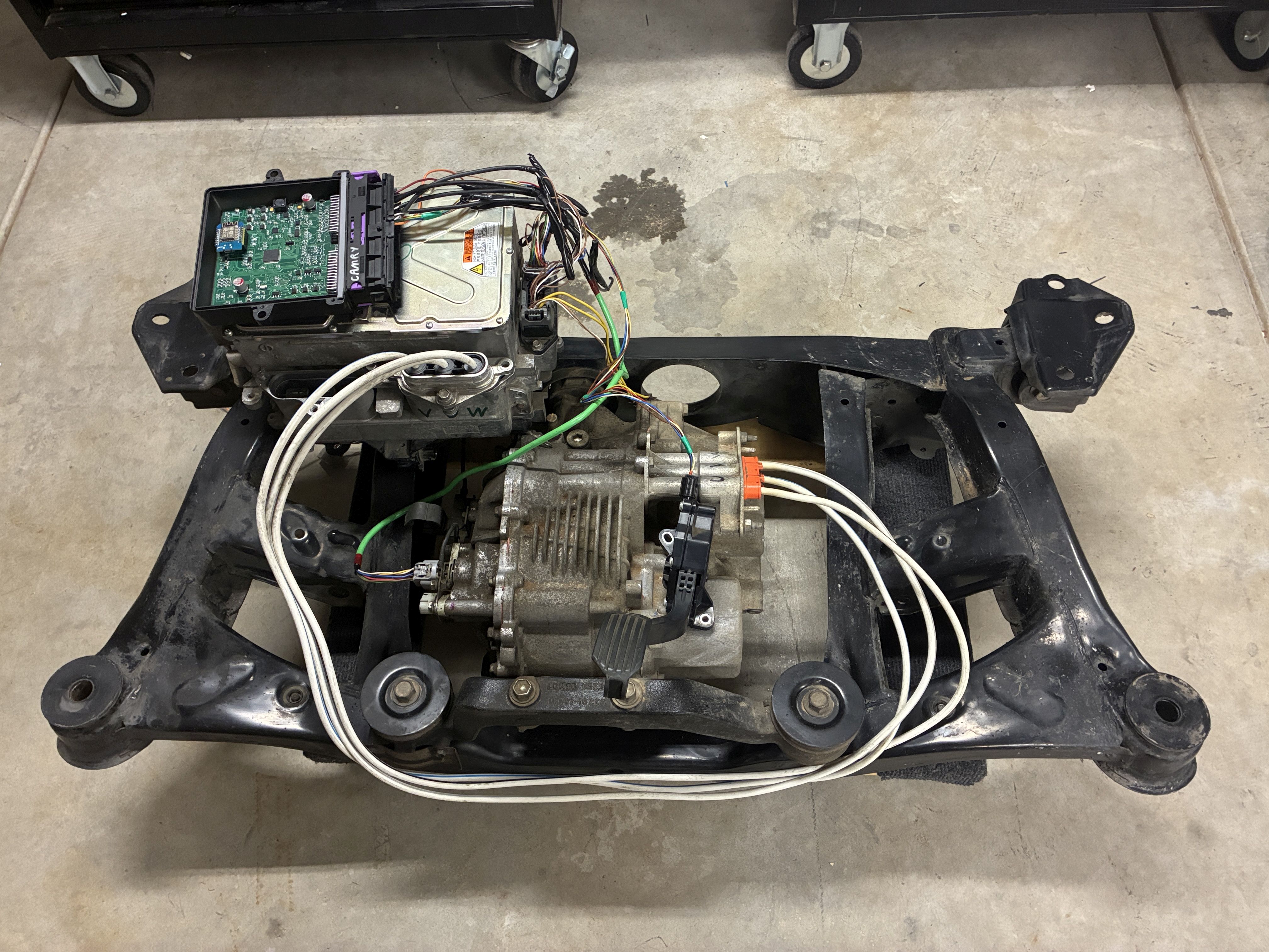

alright, time to hook it all up

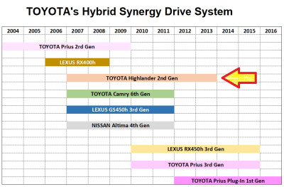

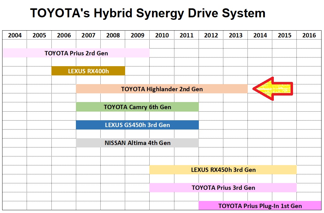

Wait what, Tom91 has thanked me for a post, Today Is Gonna Be A Good Day!
just wanted to show where the Toyota Highlander lands on the TOYOTA's Hybrid Synergy Drive System timeline, and why it's inverter overlaps and borrows from the Gen 2 Prius design, look and feel, I hope to dedicate an episode to it in my DIY EV Will It Spin 1 TOYOTA's Hybrid Synergy Drive System YouTube video series

and she scootches

Post by TRWIKI »
These are a few measurements that interested me.
I got them from TOMS STL file.
Unfortunately, I couldn't measure them directly in GrabCAD.
The measurements are slightly rounded up to full centimetres.
I do not guarantee their accuracy :-)
Anyone interested can check this for themselves.

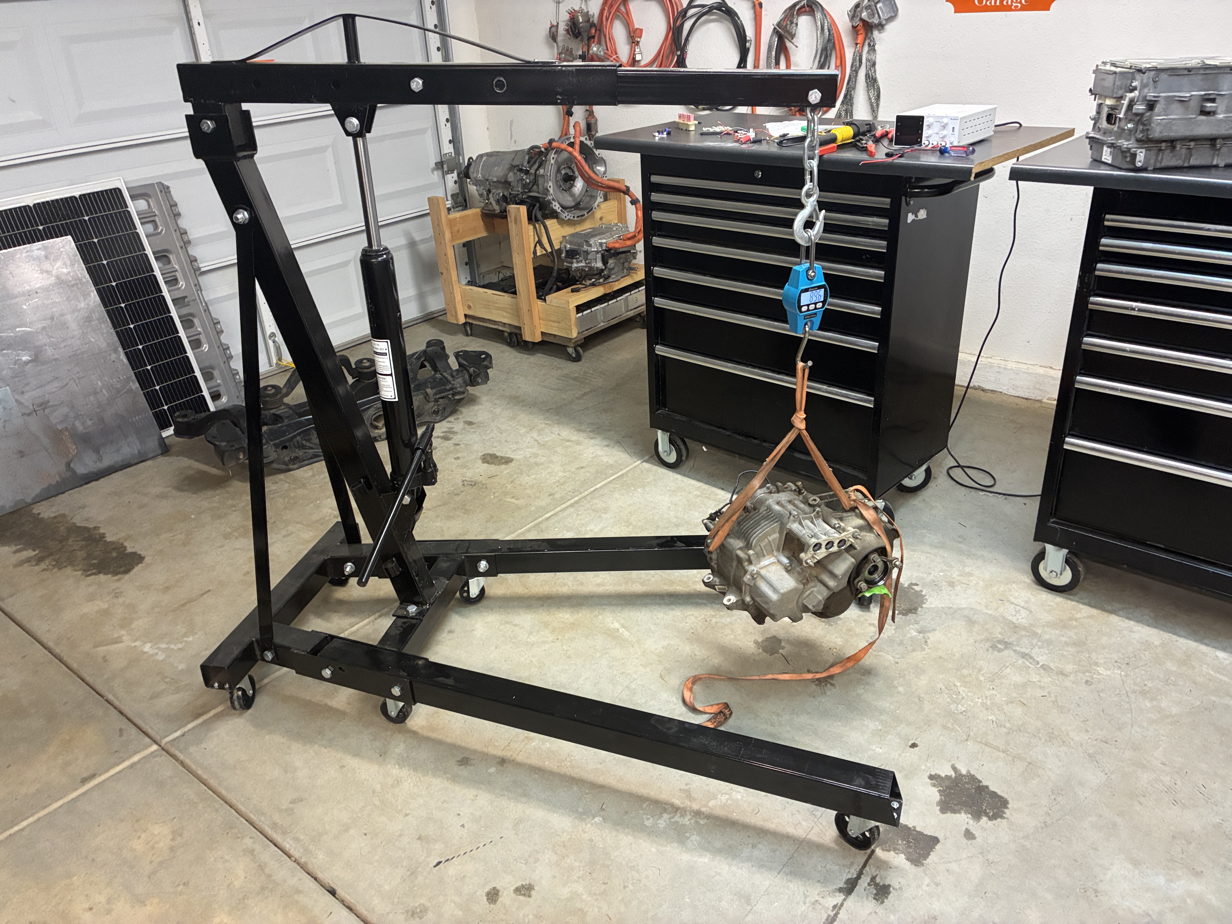

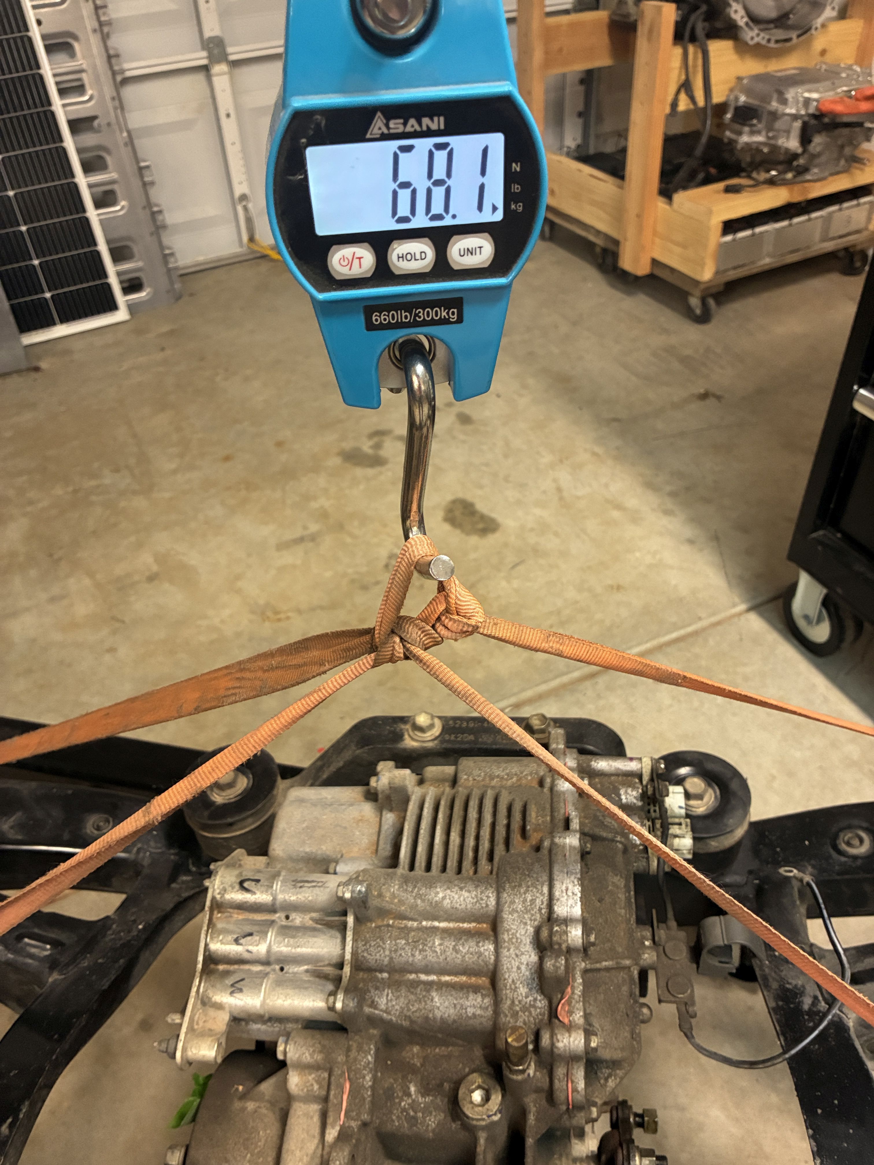

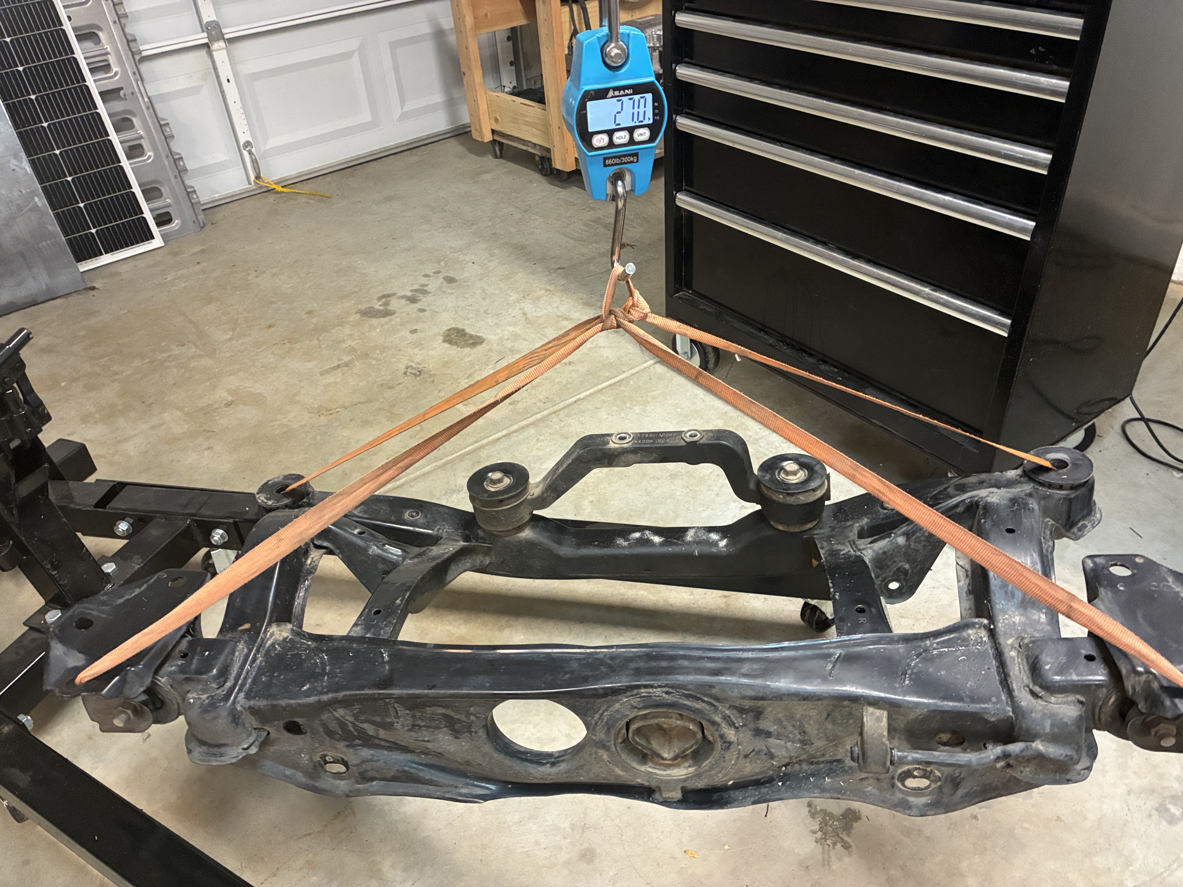

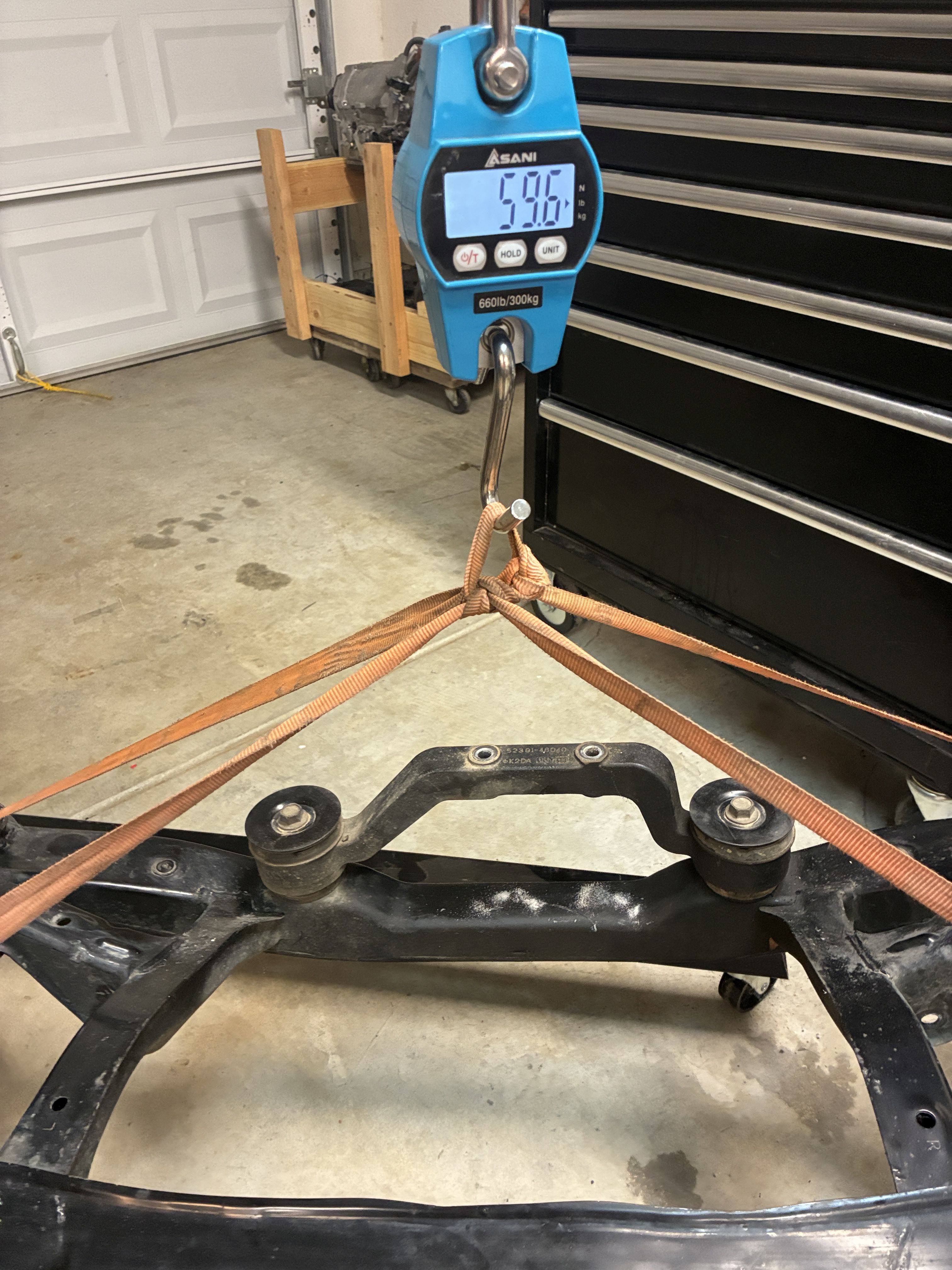

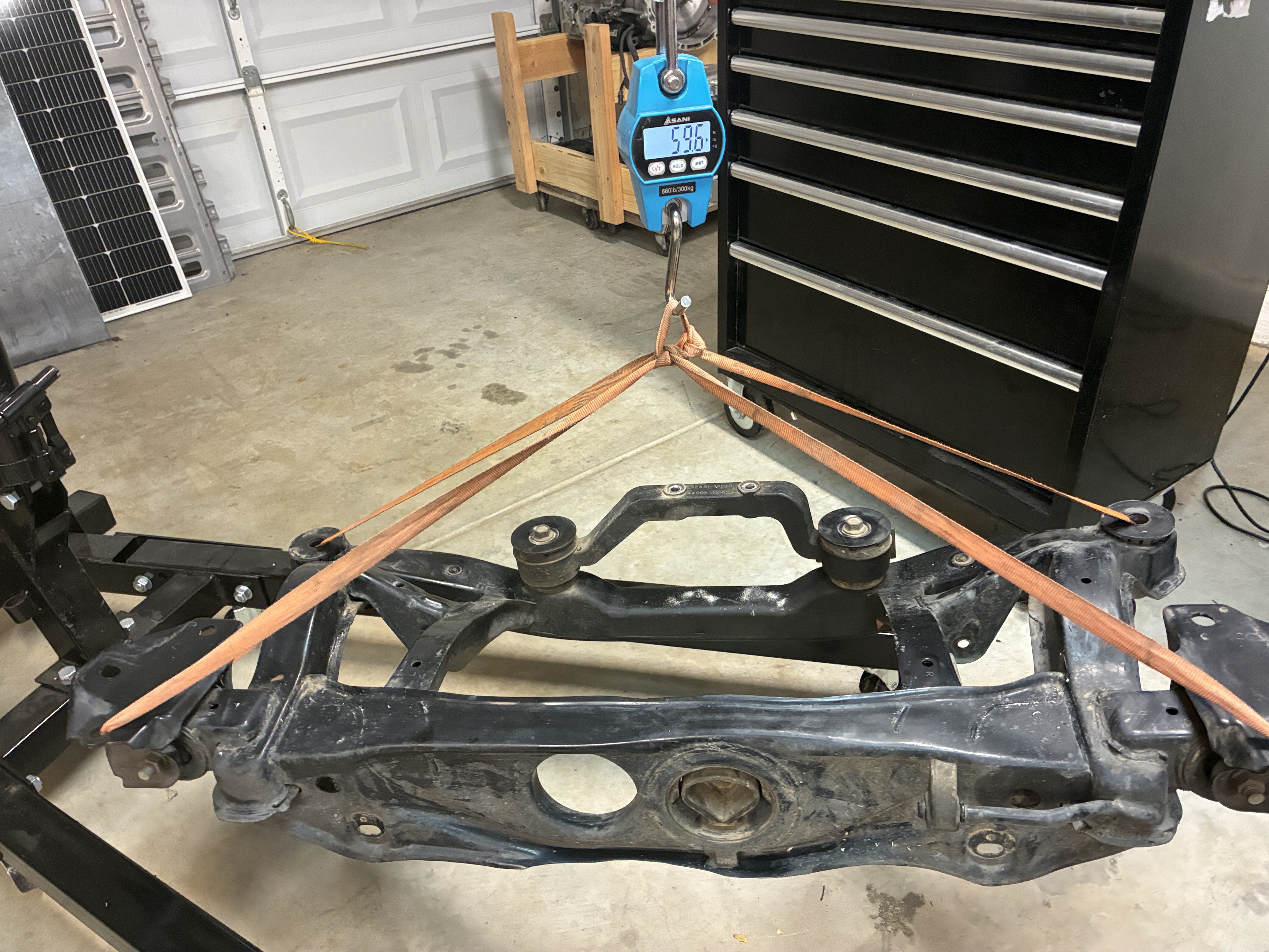

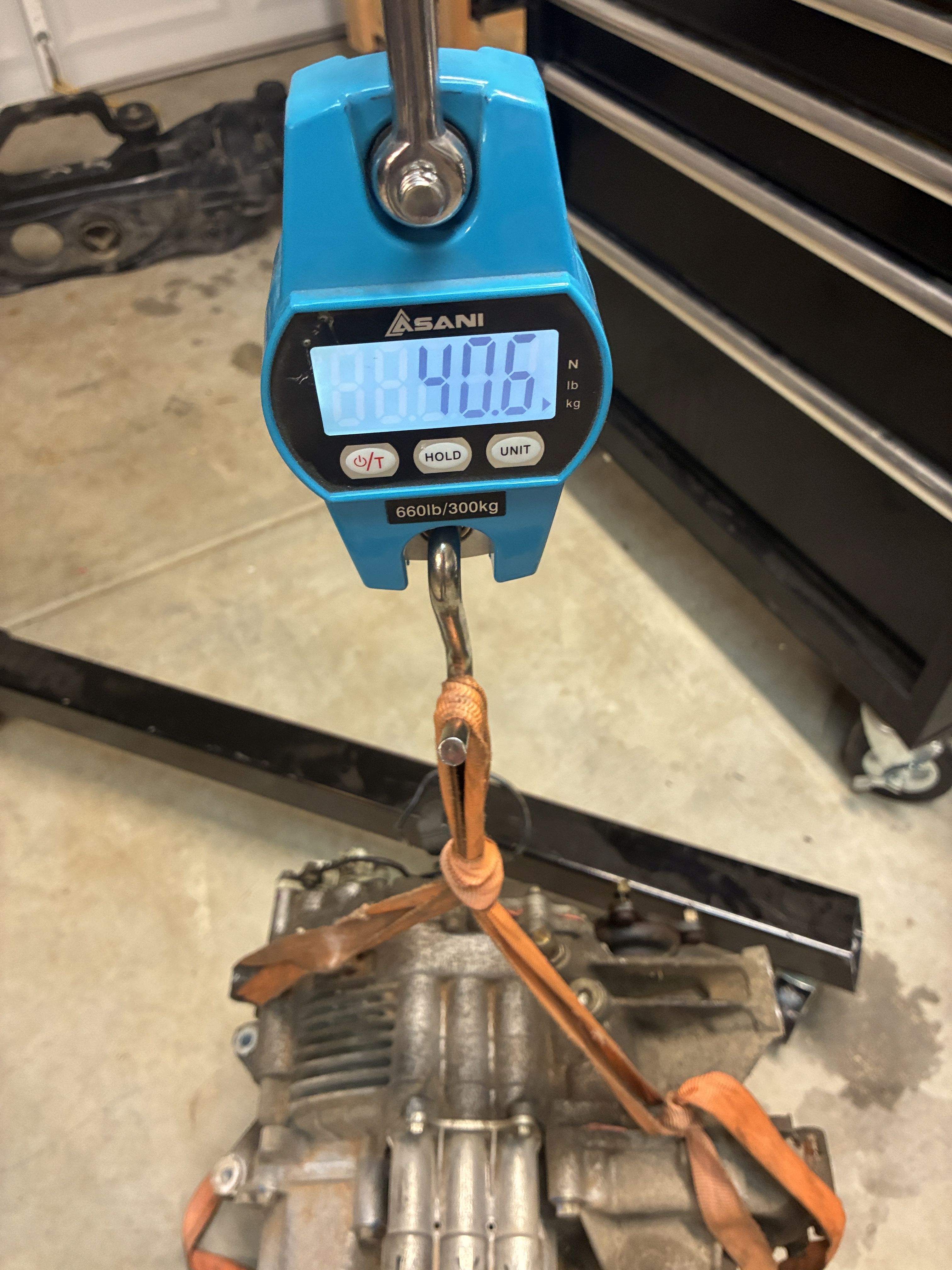

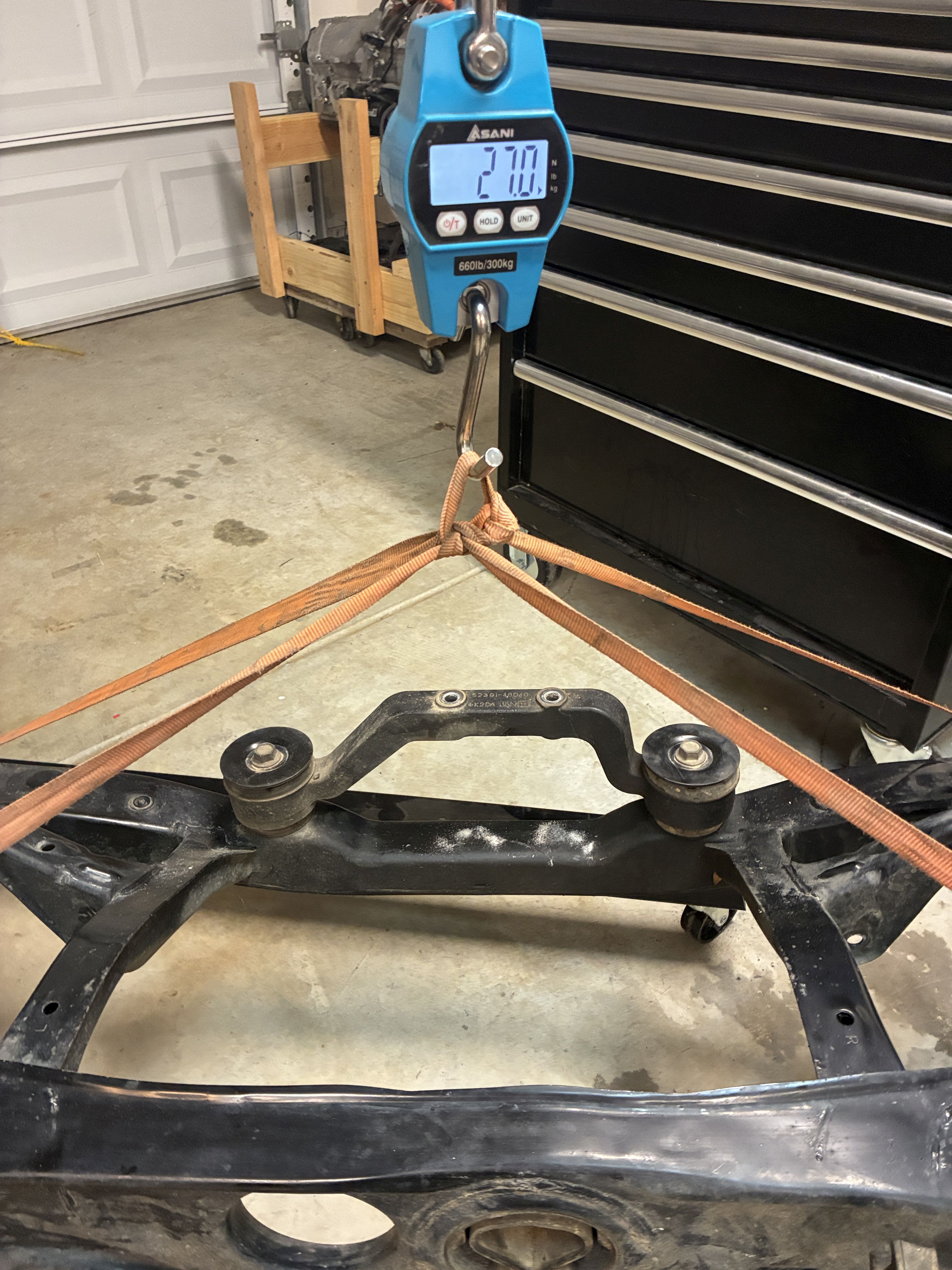

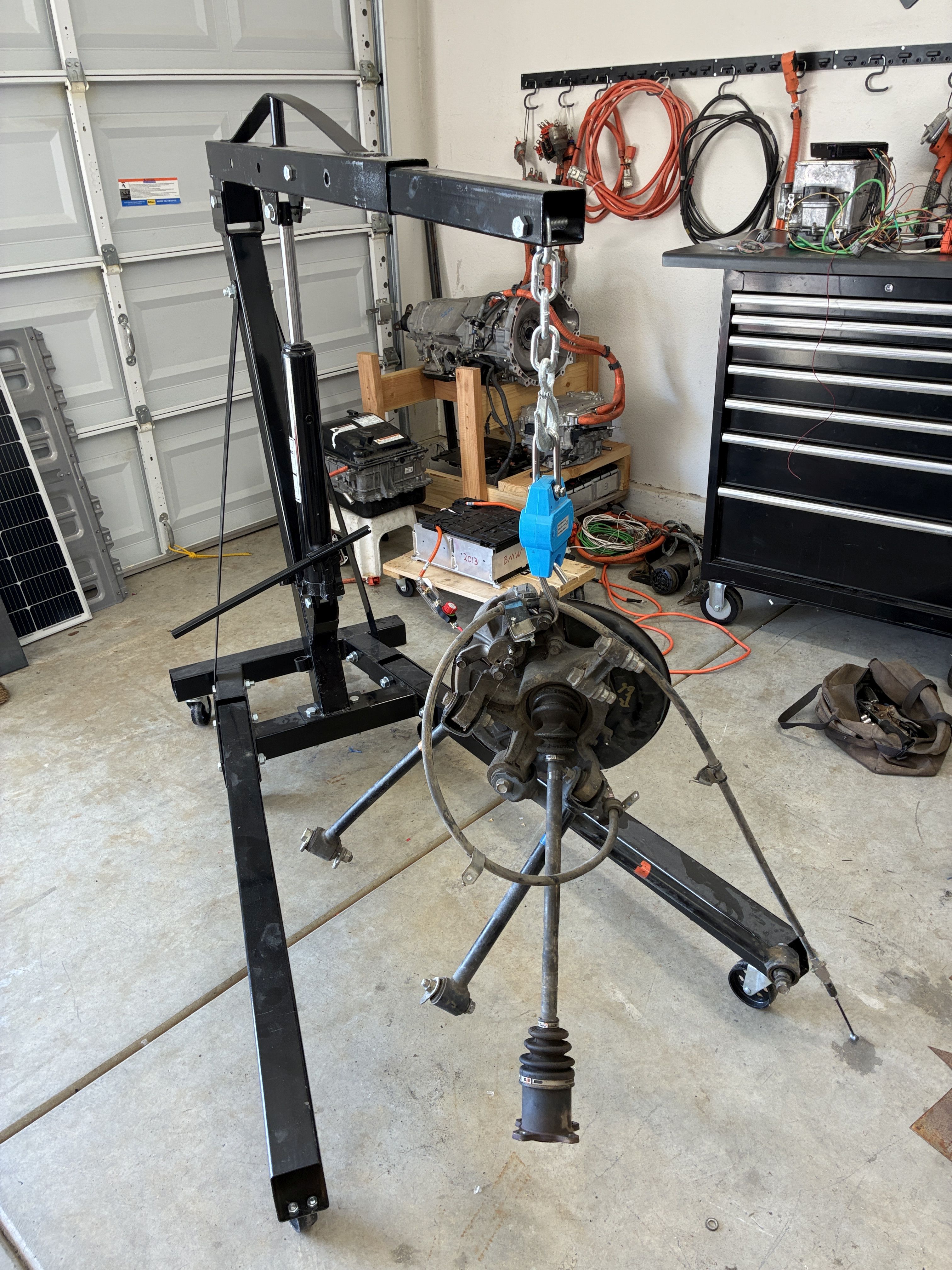

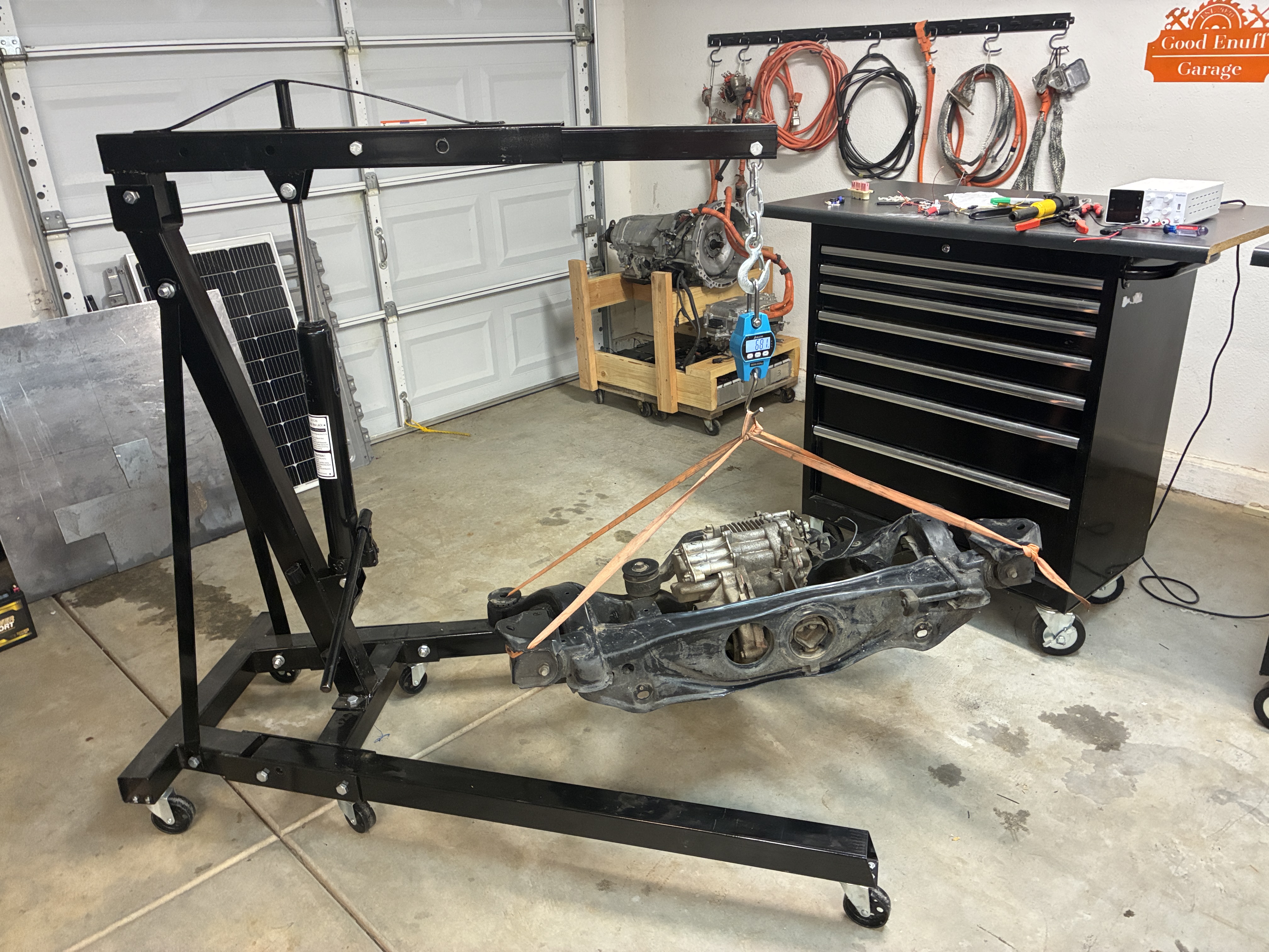

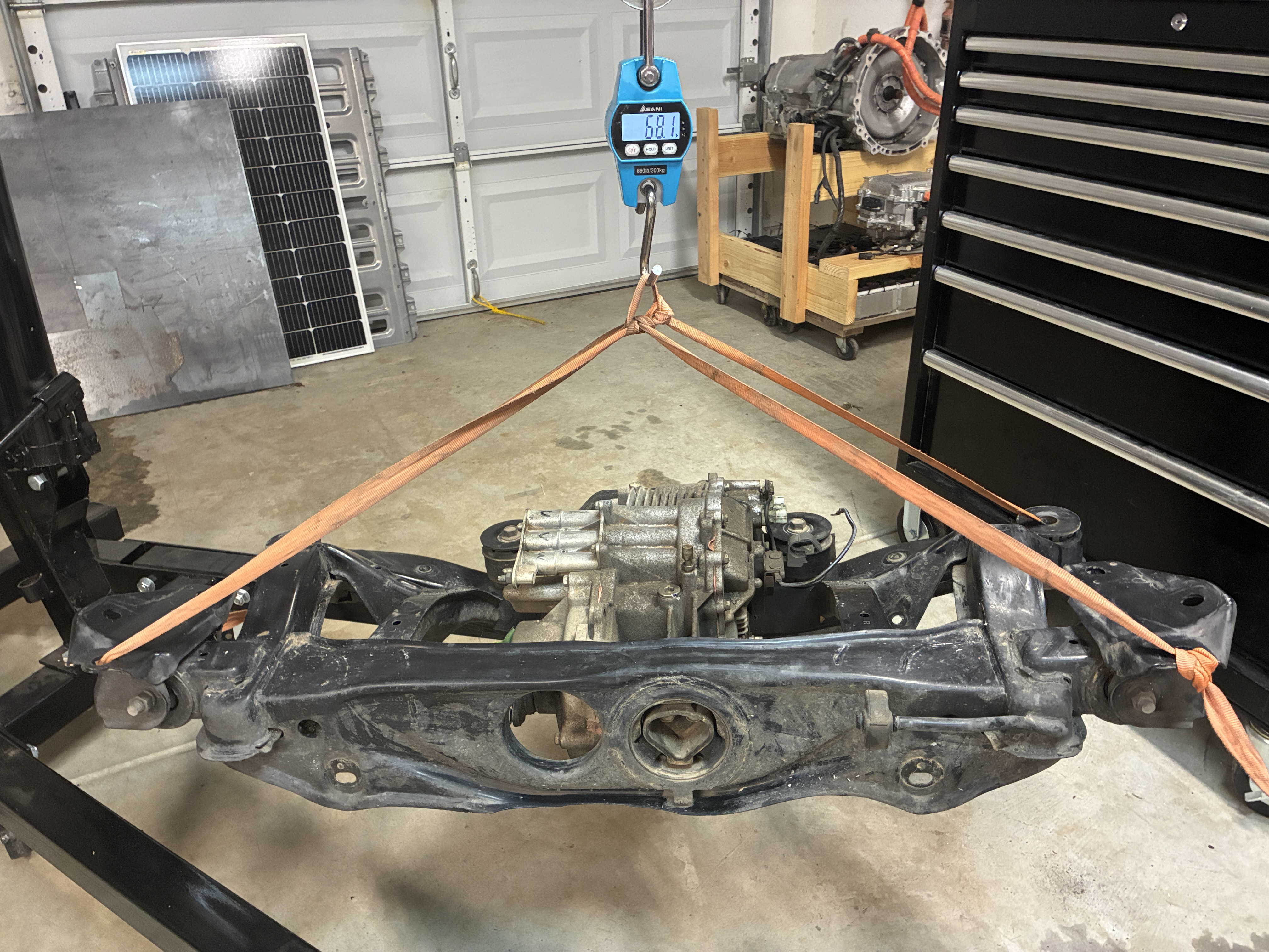

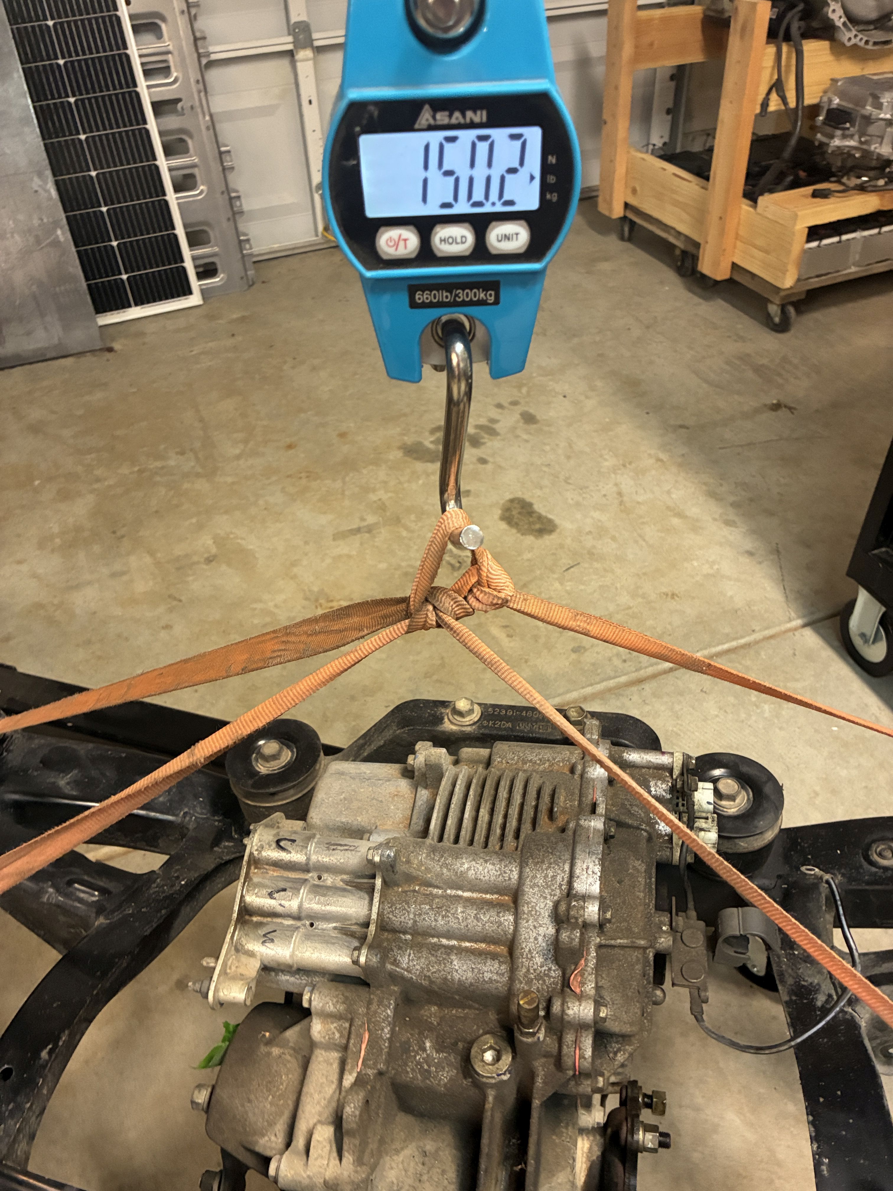

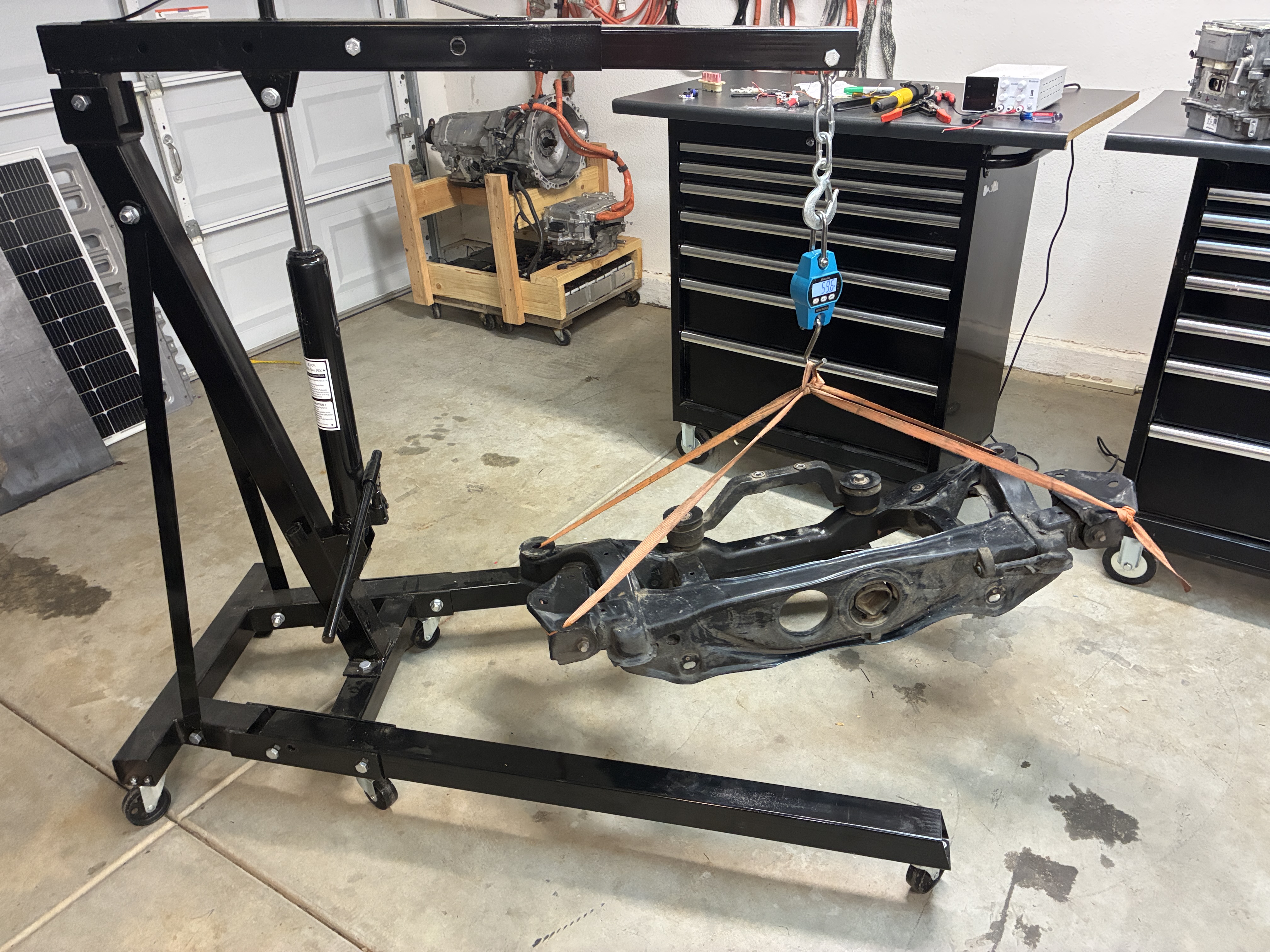

and here's what the Toyota Highlander rear subframe weighs by itself
Gregski
Posts: 3157
Post by Gregski »

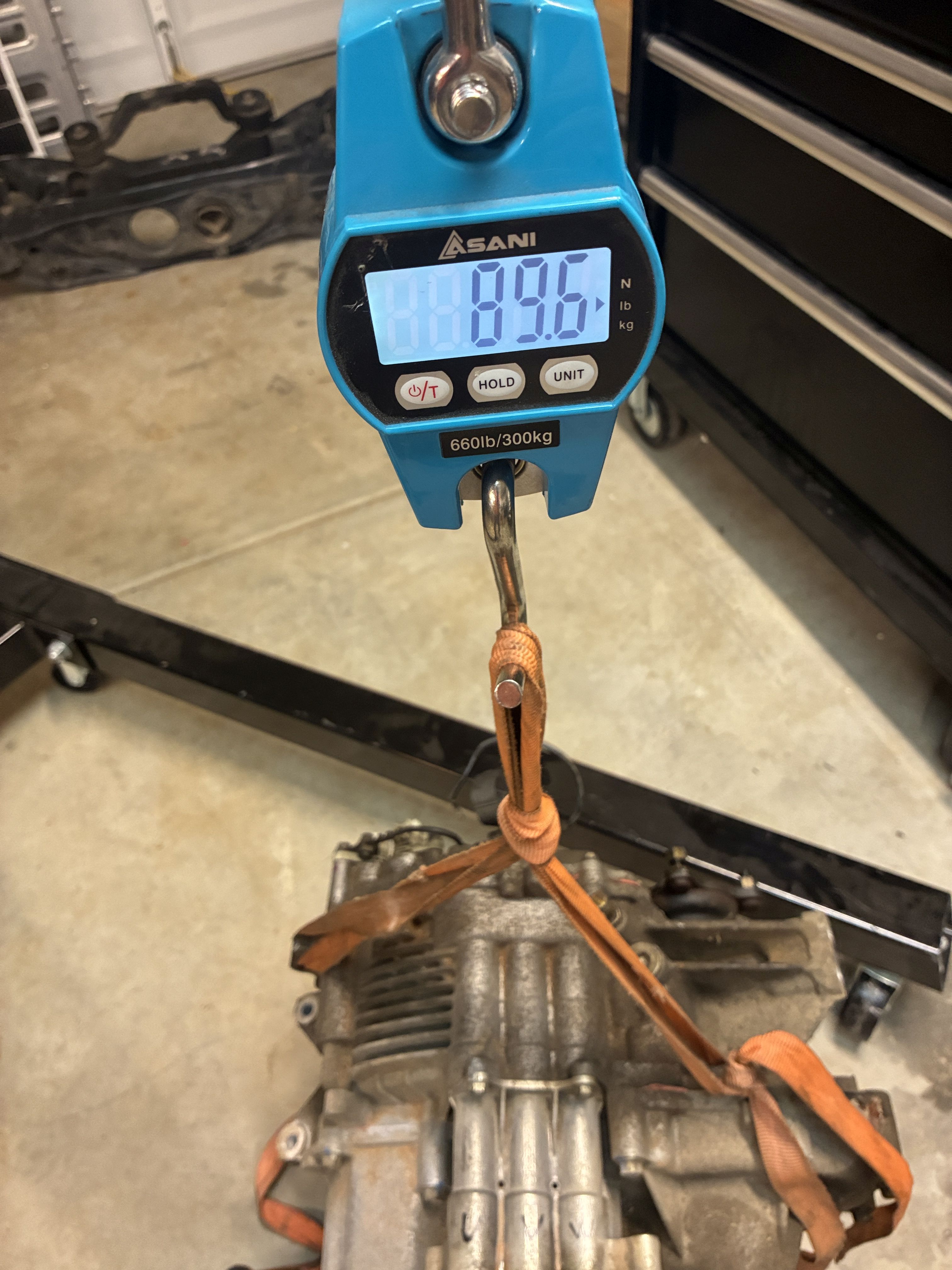

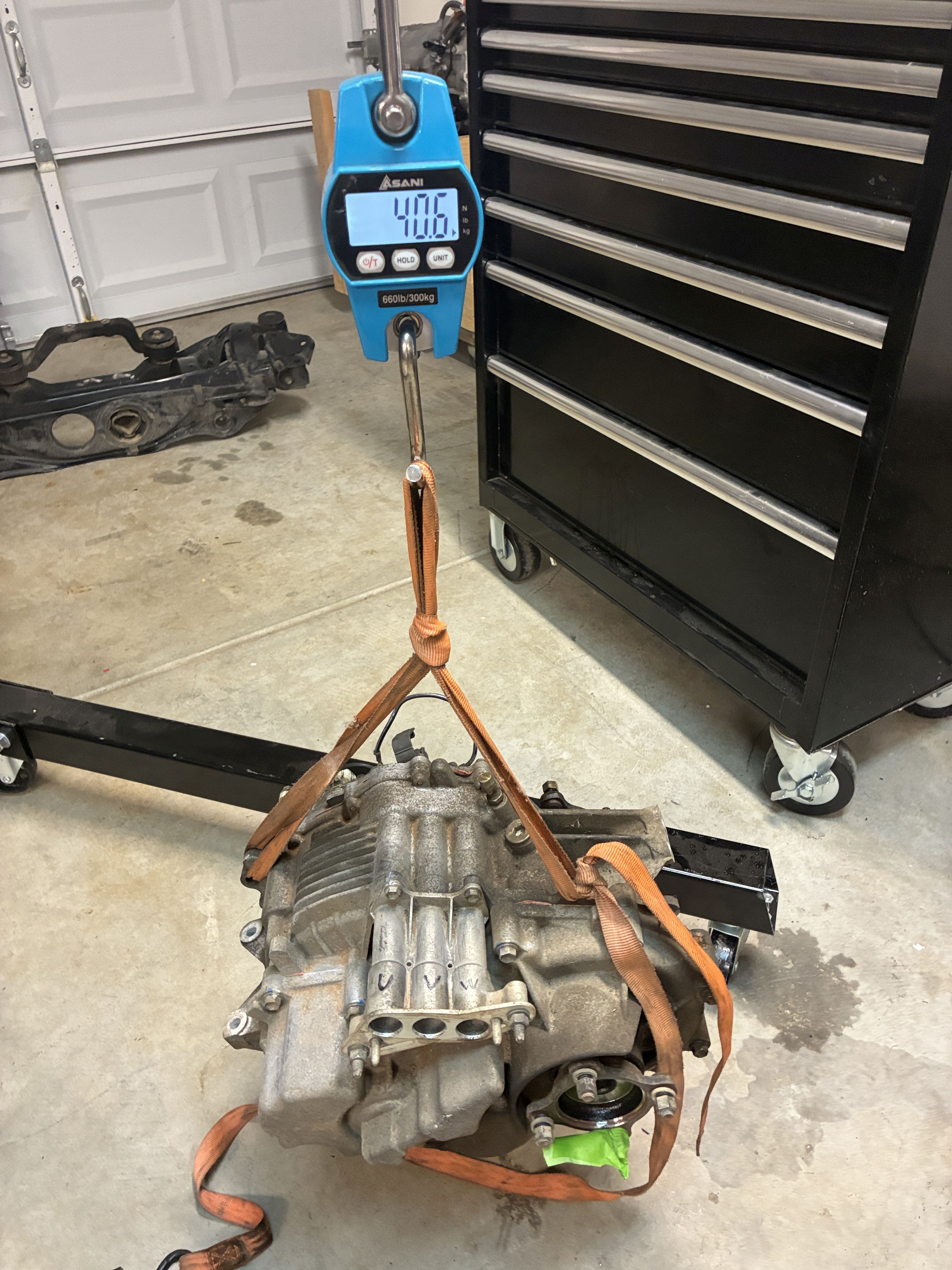

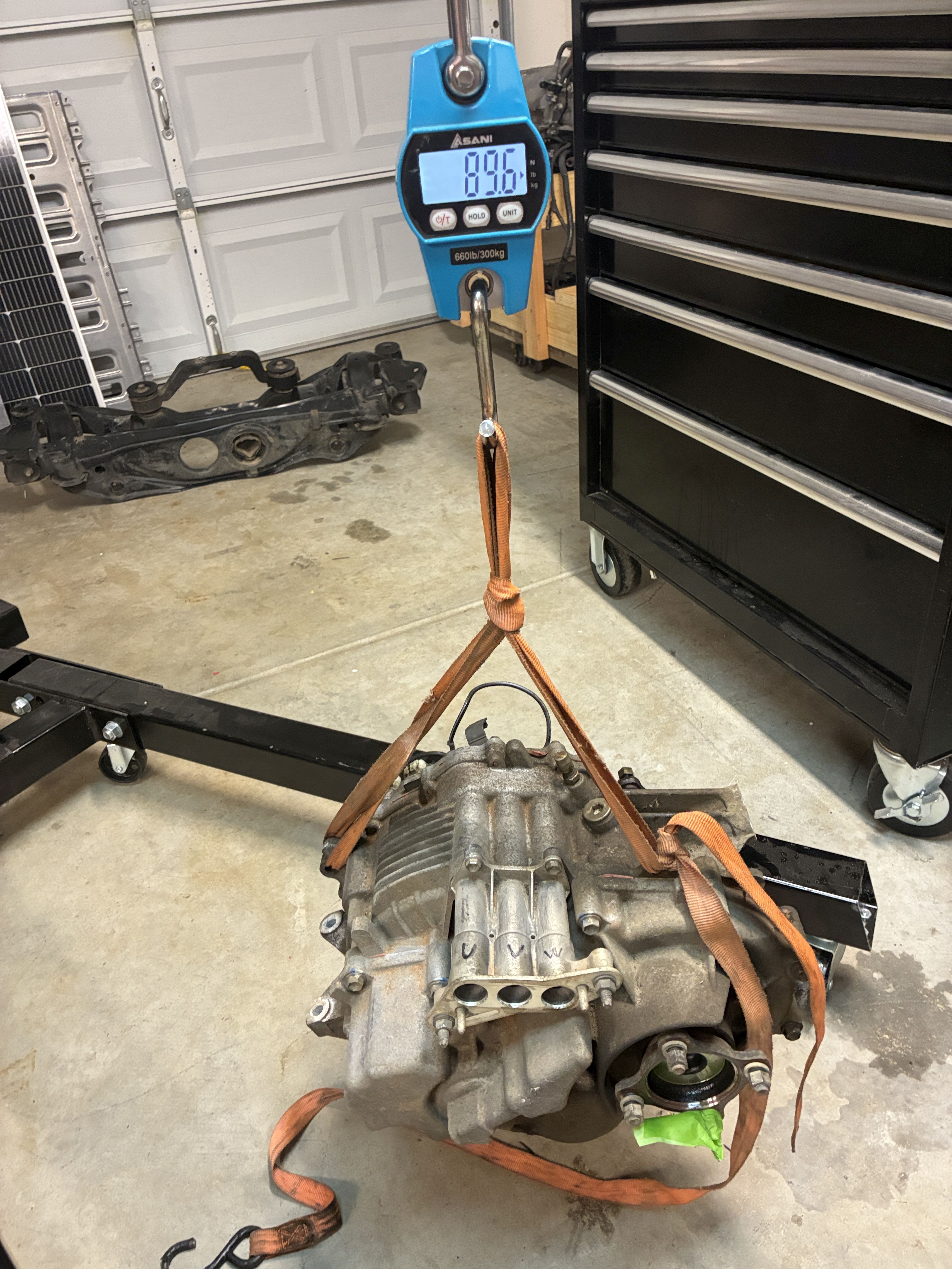

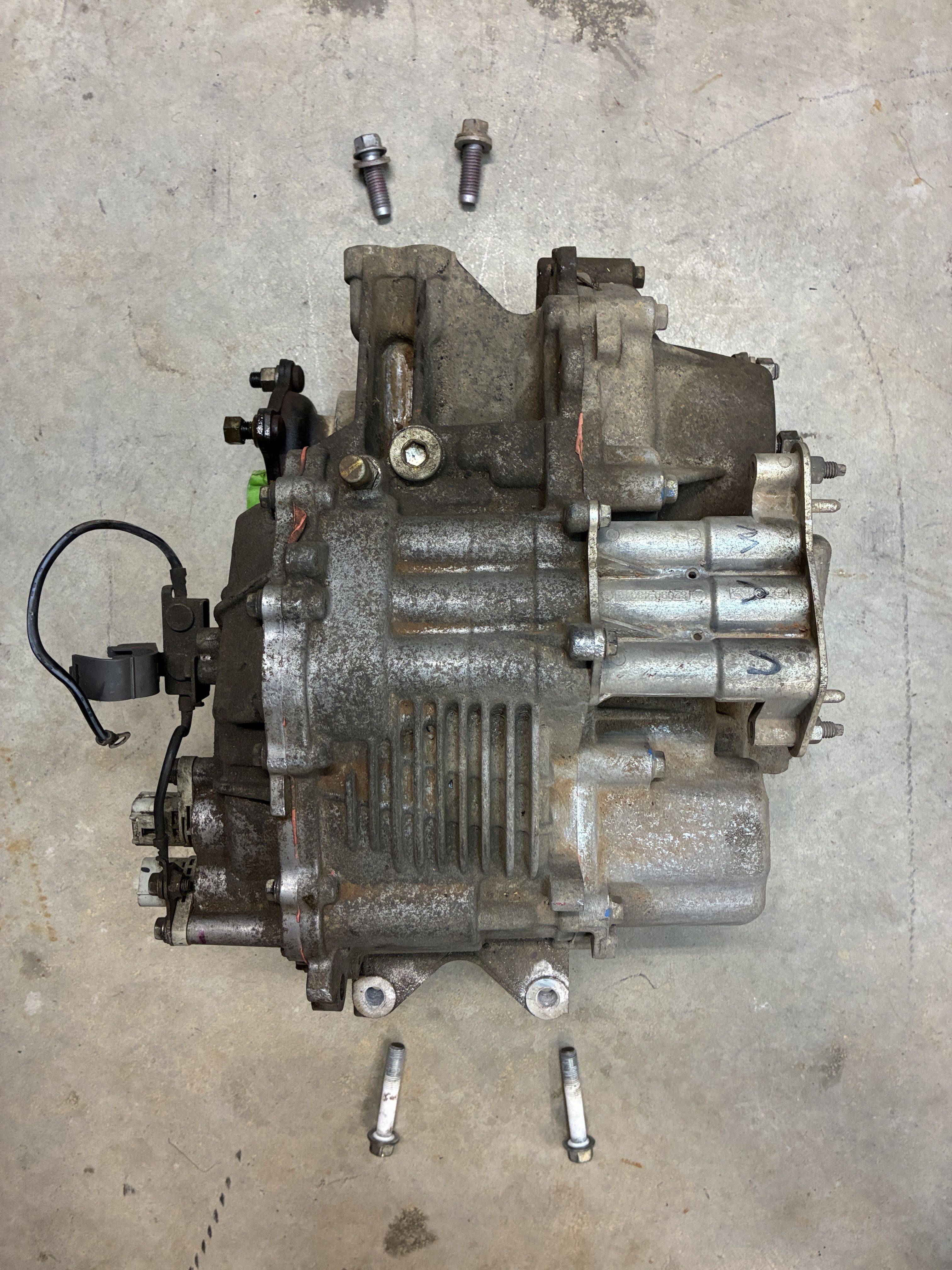

and here's what the Toyota Highlander MGR weighs by itself

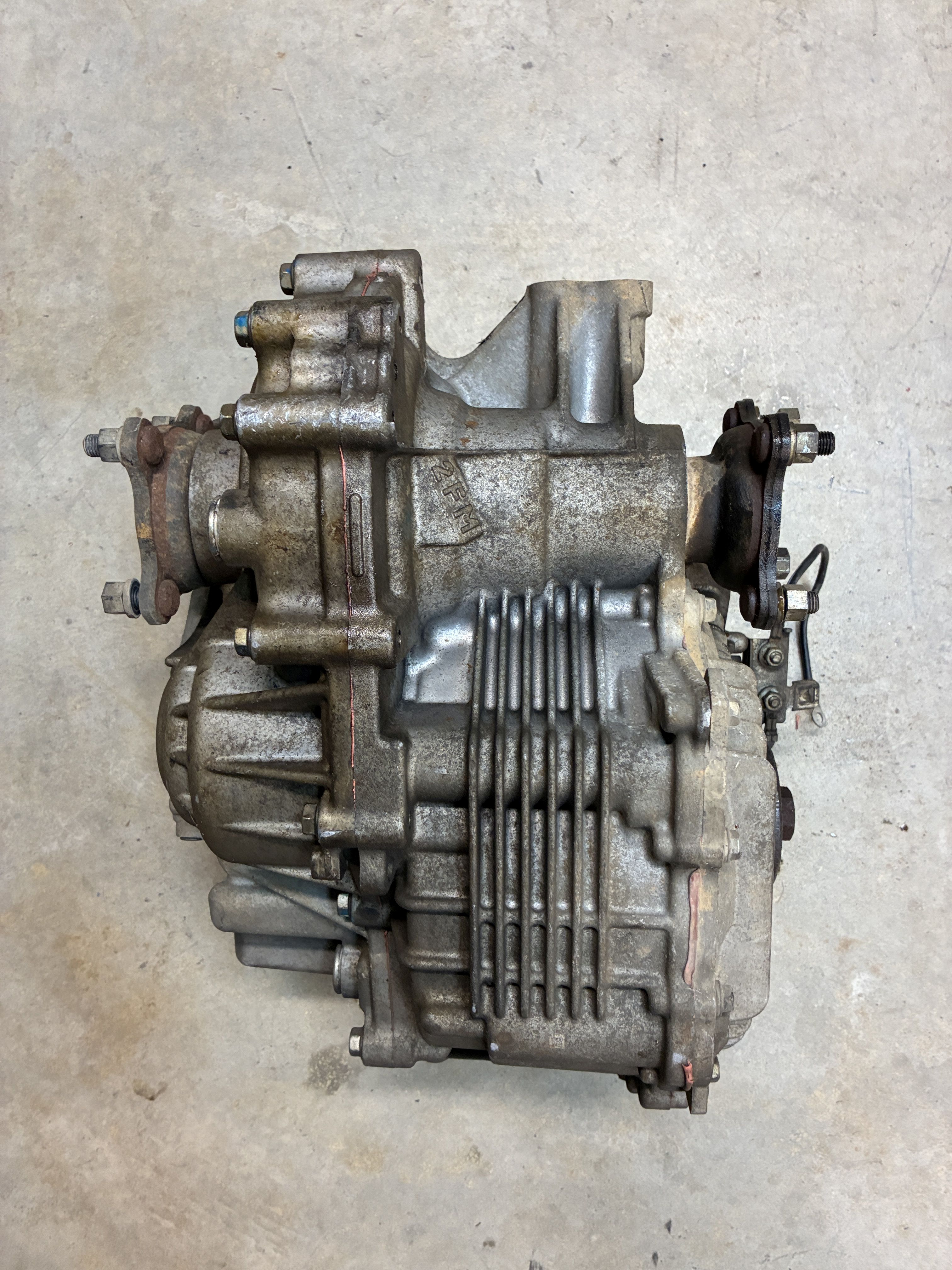

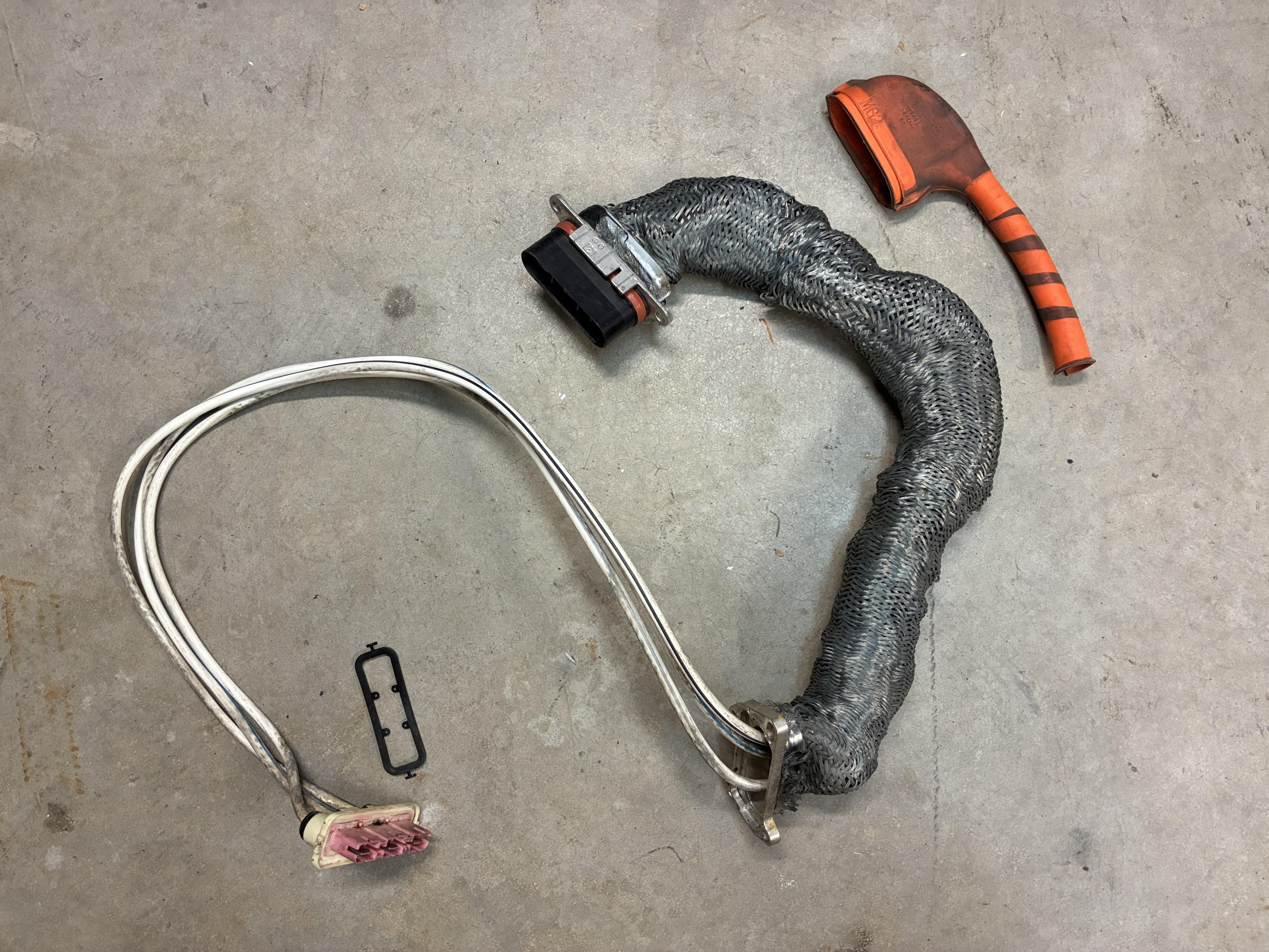

then I just had take off the silly willy extension where the three U, V, W fingers plug in to, and you won't believe what we saw
You have got to be kidding !!!
Gregski
Posts: 3157
Post by Gregski »
and here are the four bolts that attach the MGR to it's subframe, it is rubber mounted
and here it is belly up

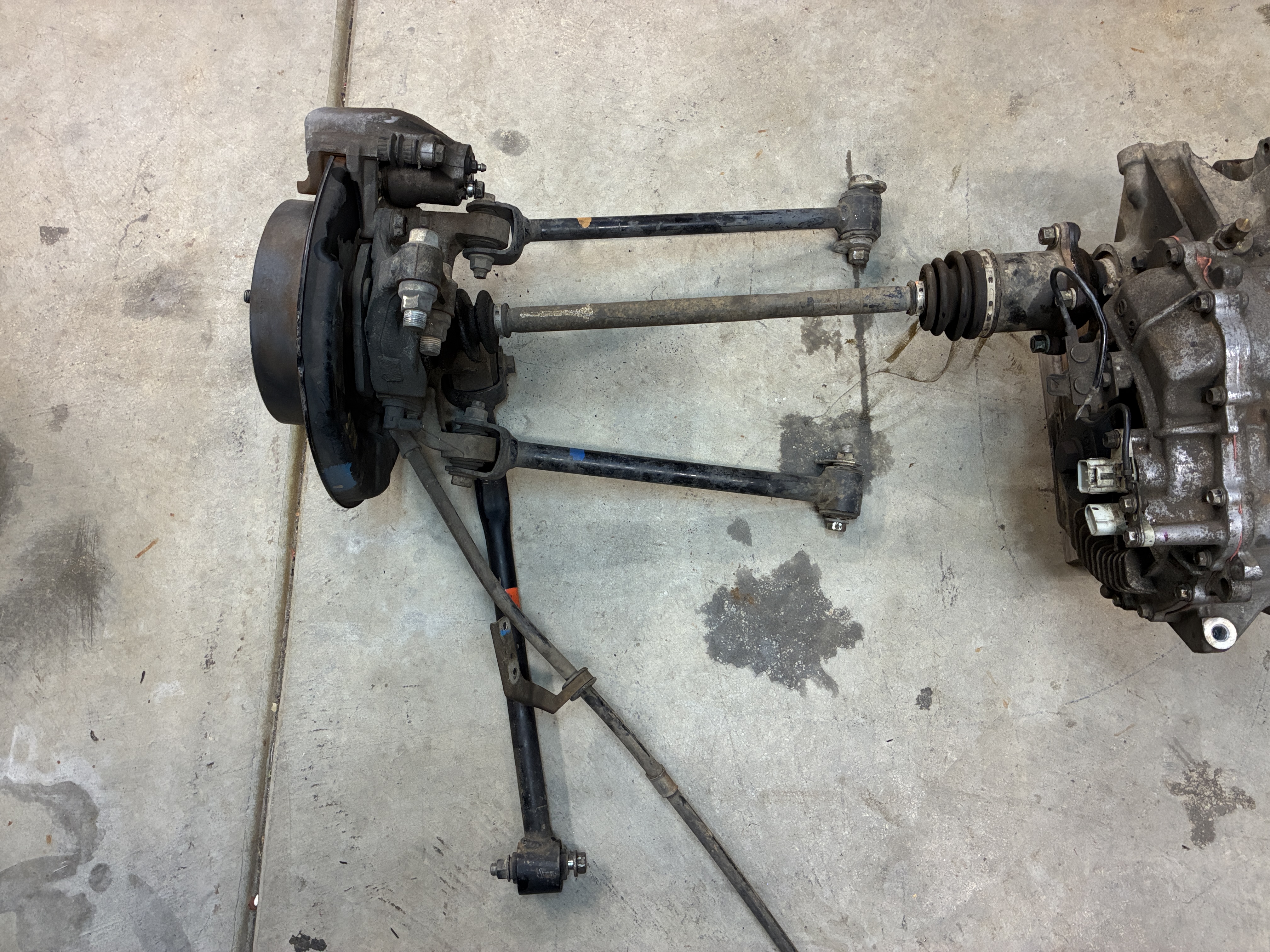

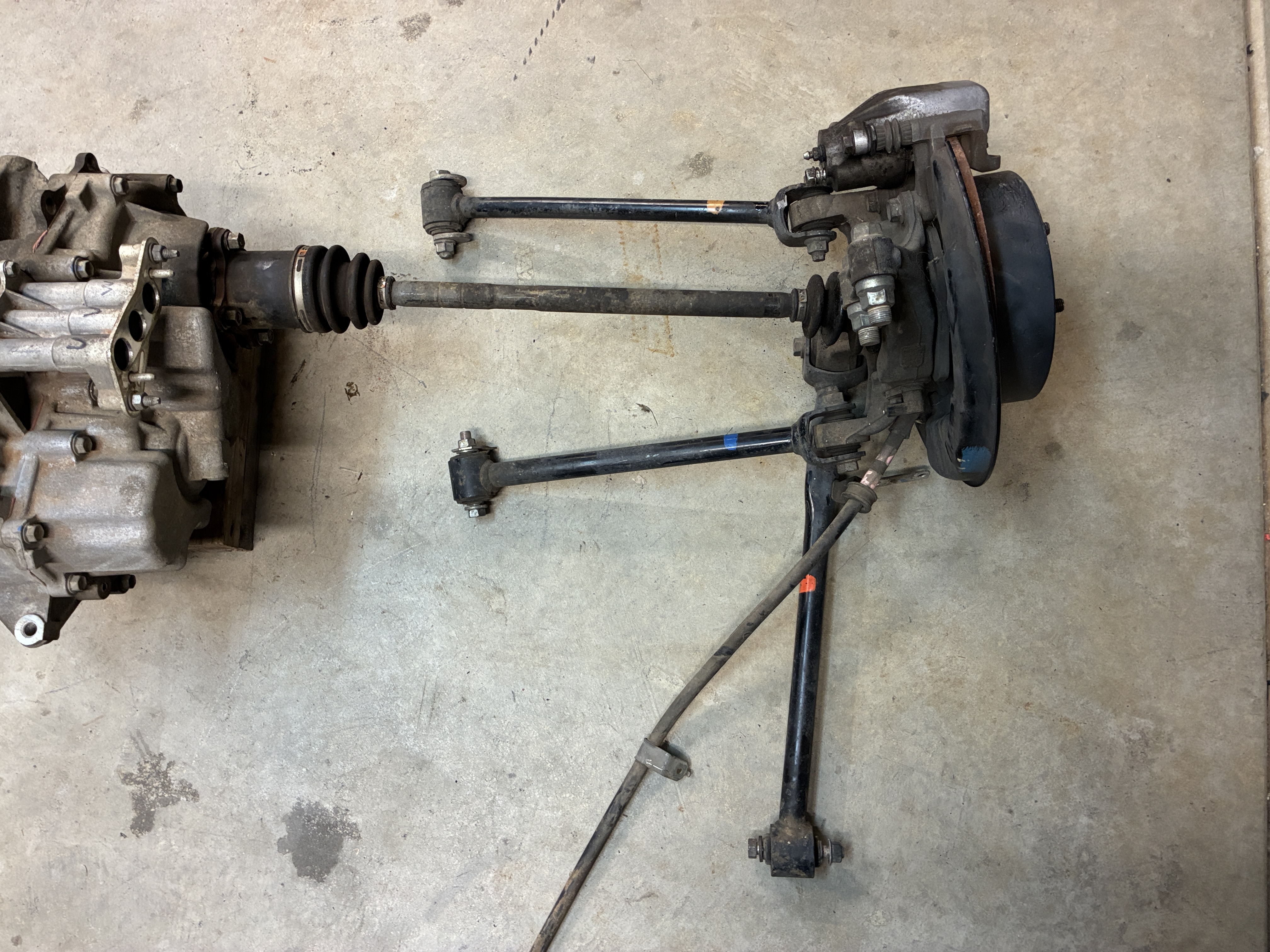

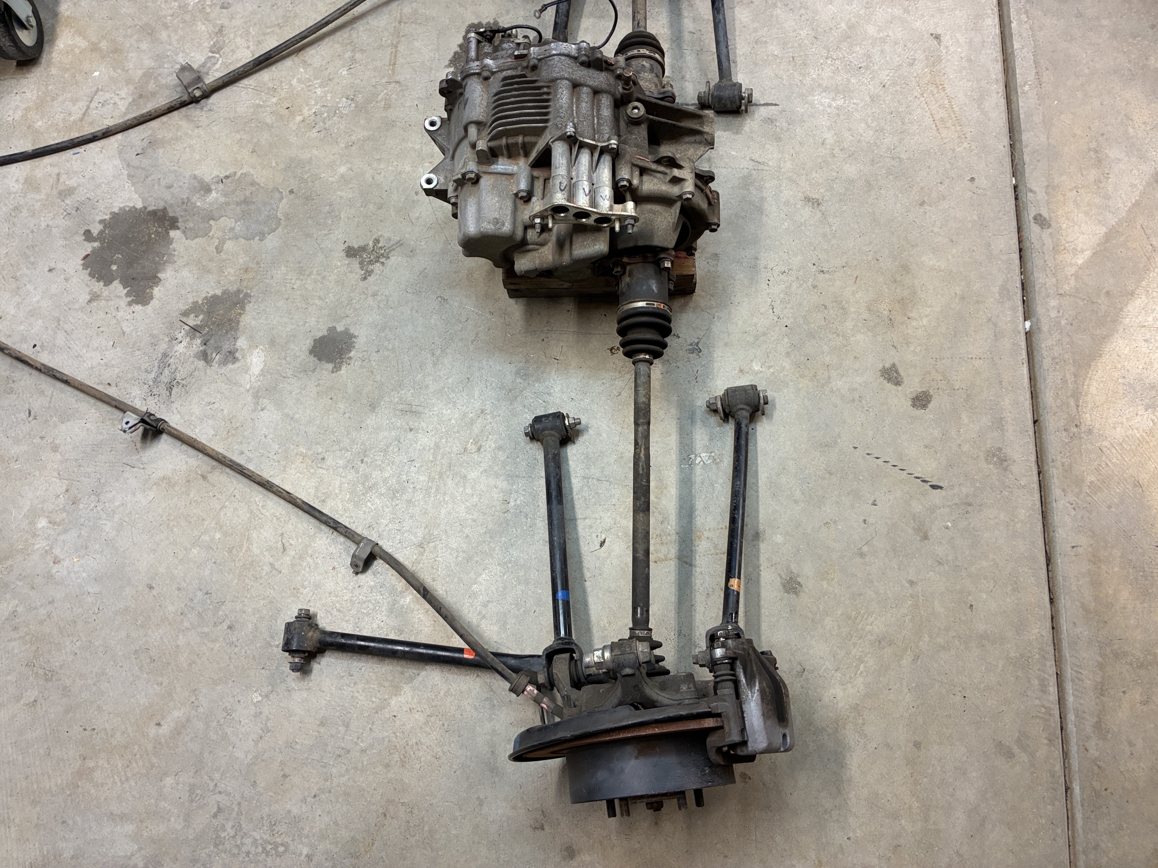

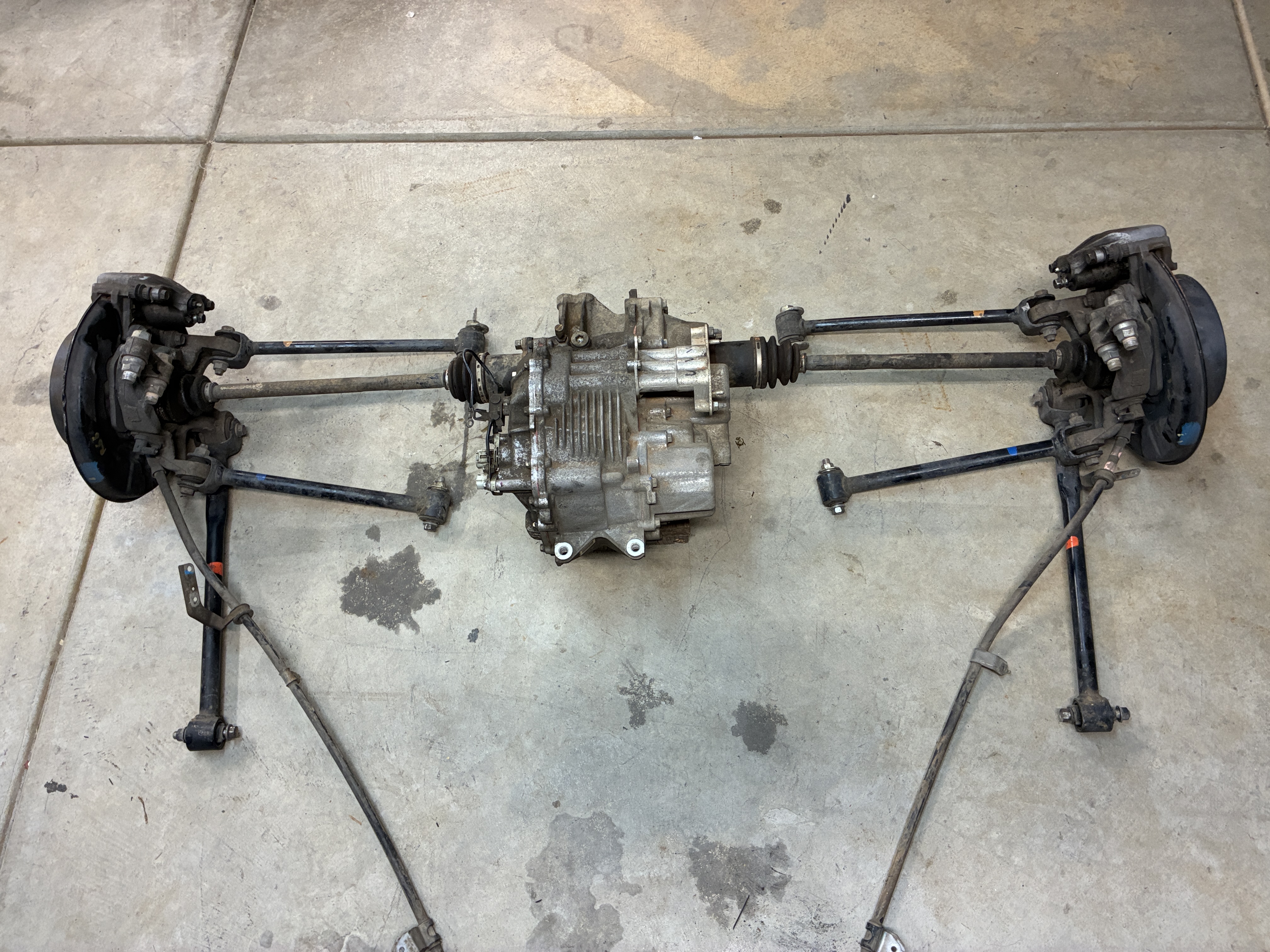

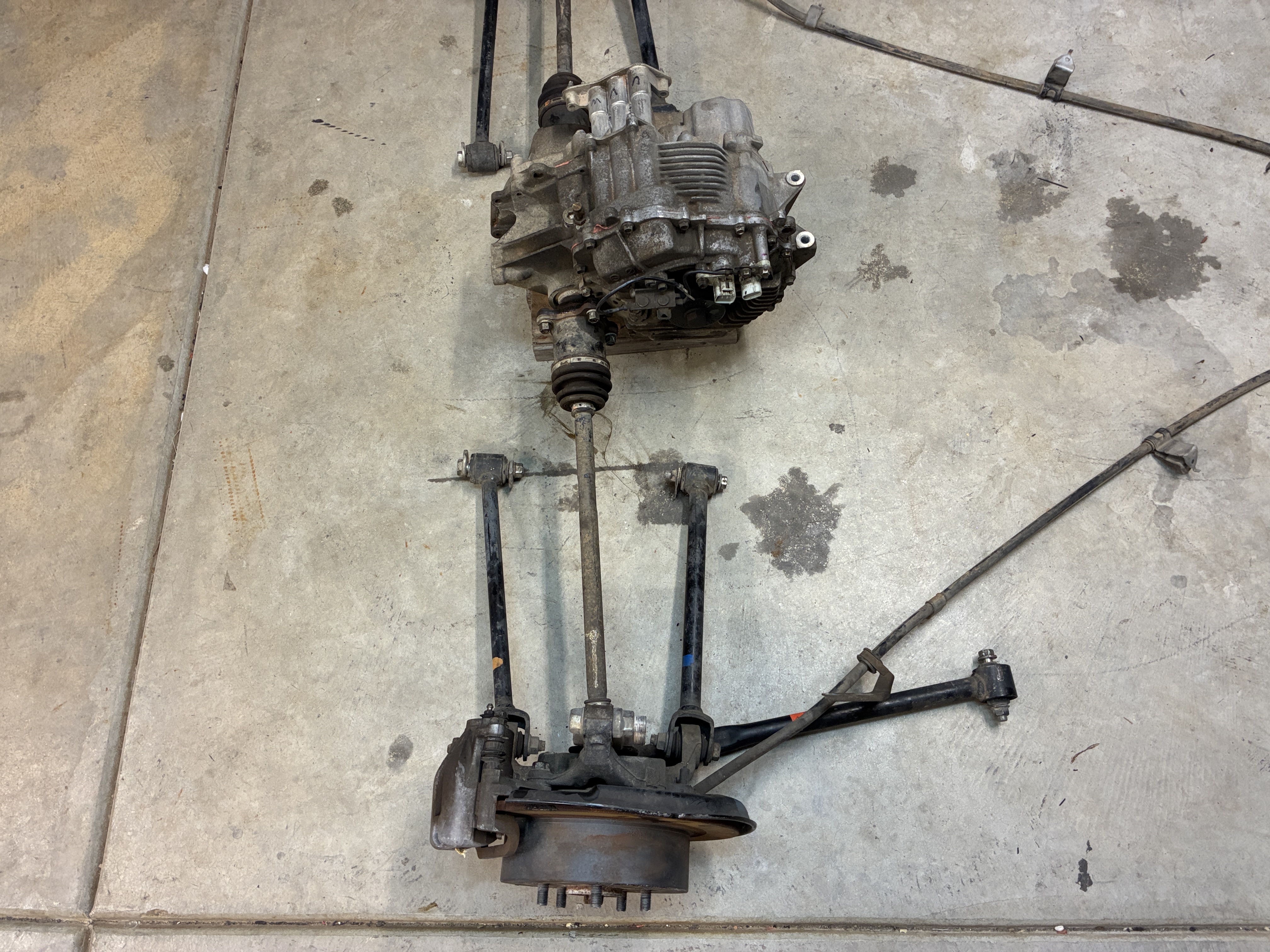

so let's take a look at it's original wing span sort of speak, I did not weigh the spindle/brake ends but let me tell you they are heavy
first, we are standing right behind the vehicle here, the cables running forward are for the stock emergency brake
Gregski
Posts: 3157
Post by Gregski »

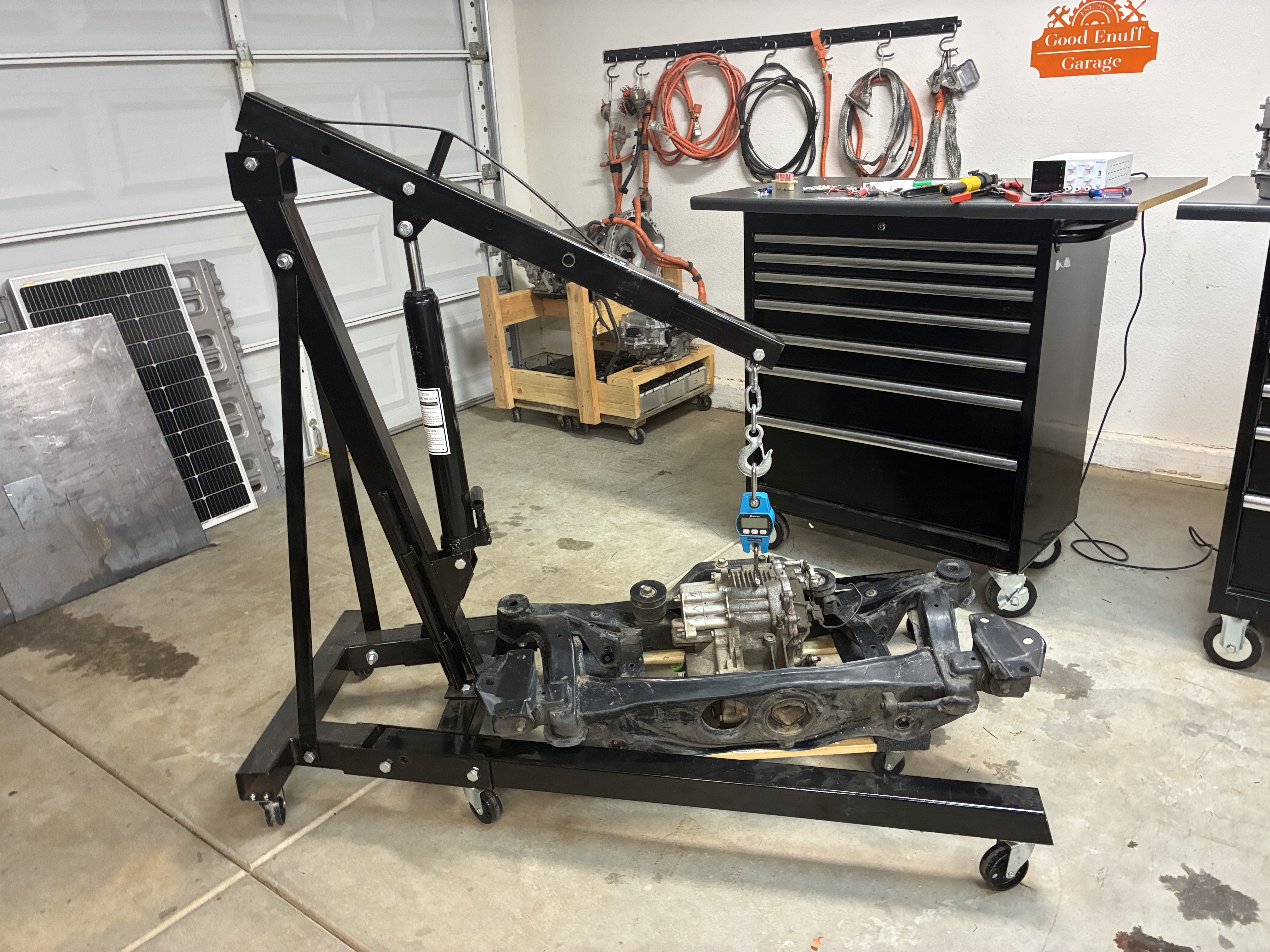

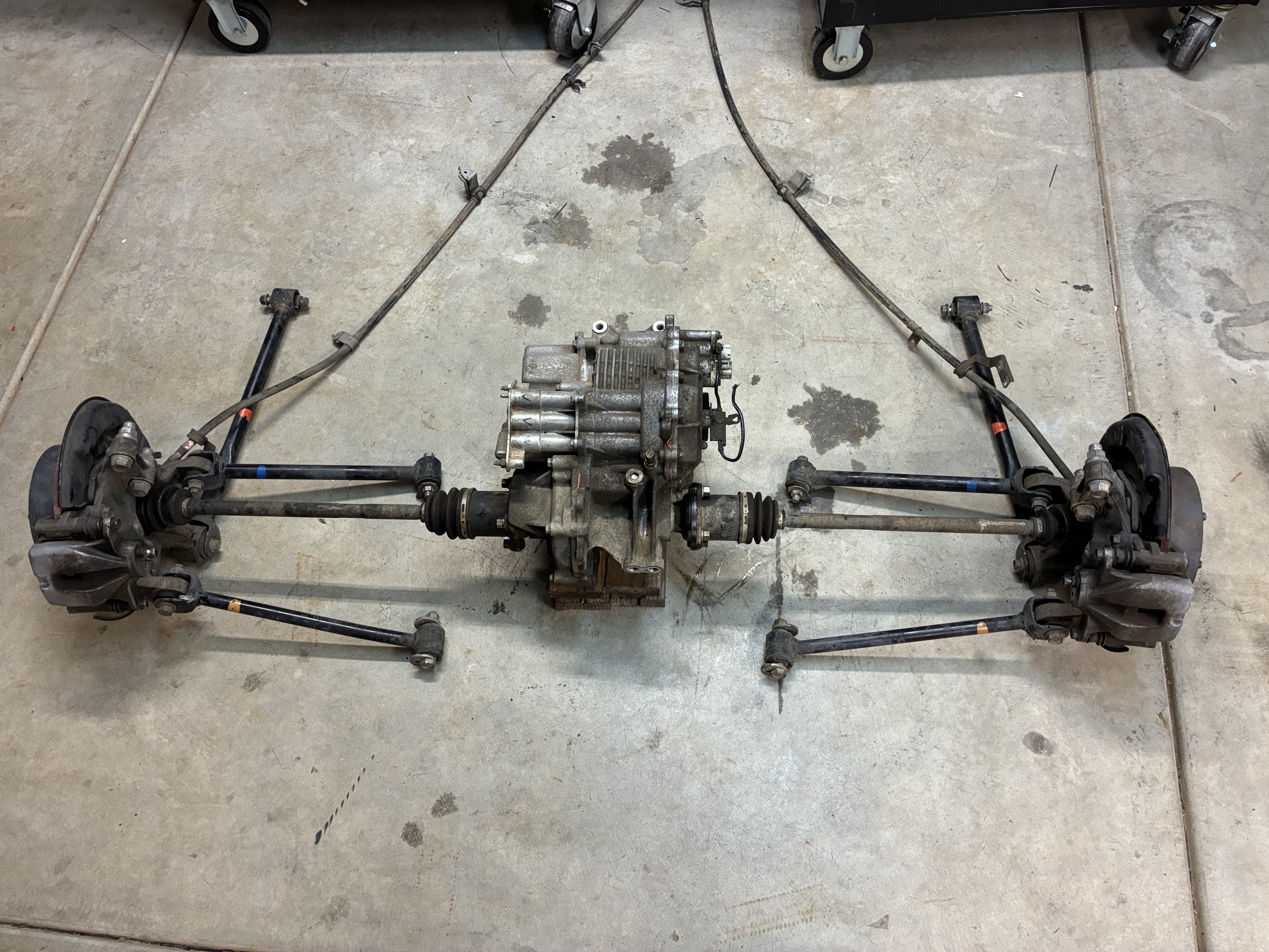

and here we are standing in front of the vehicle looking back at the rear motor

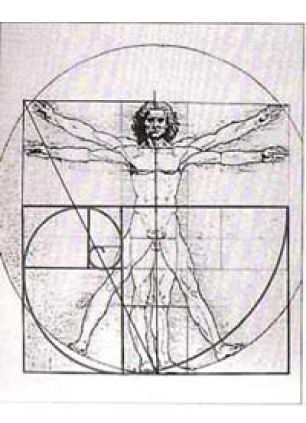

and I don't mean to get all scientific on you, but I'm almost 6 feet tall and I have a really big wing span myeslf, and when I stretched my long arms from end to end of this monstrosity it was just shy of my wingspan

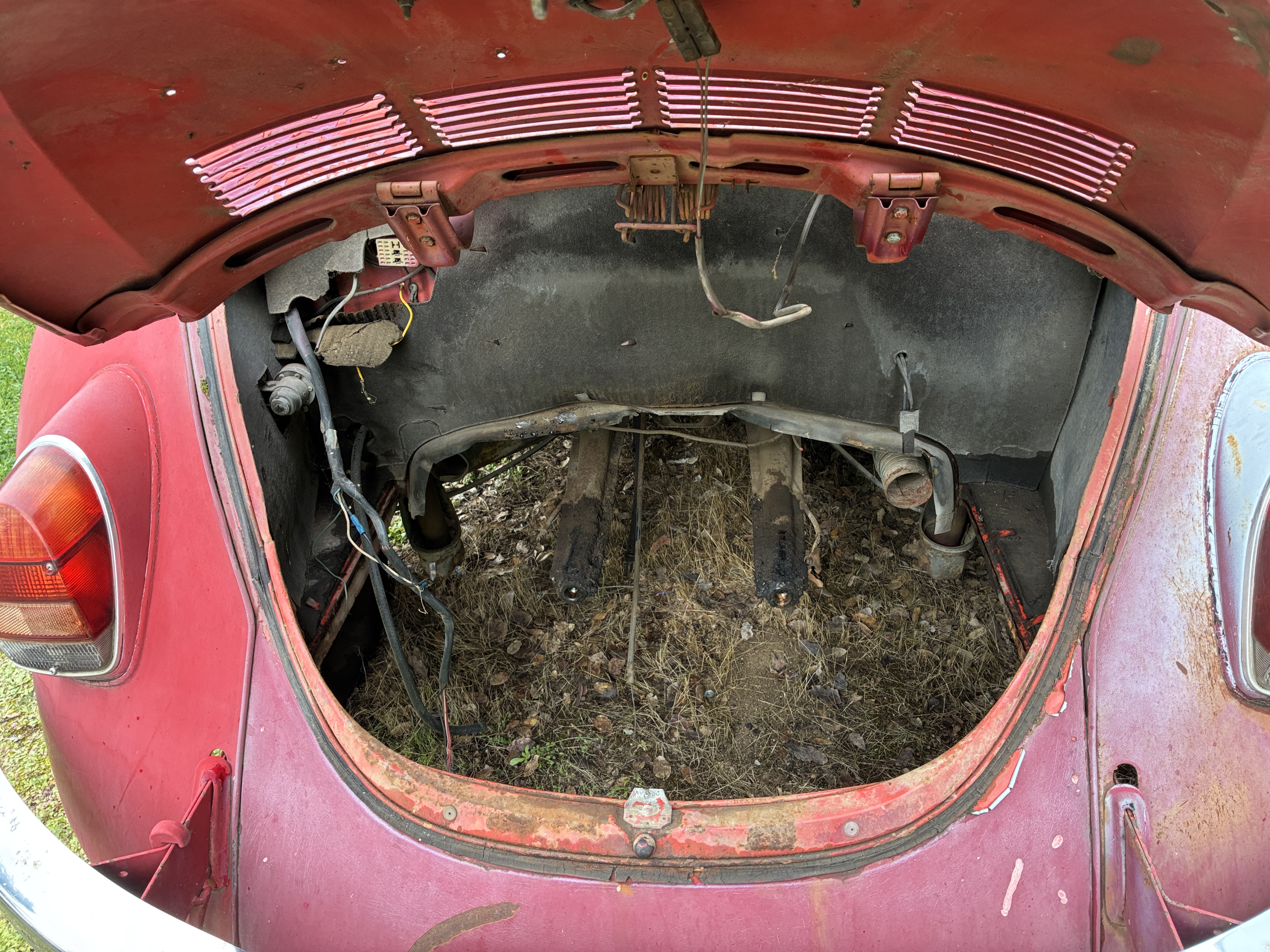

alright, talk is cheap, let's parlay this into a real build
let's see how well you know your cars, can you tell what year Ford Escort is this?

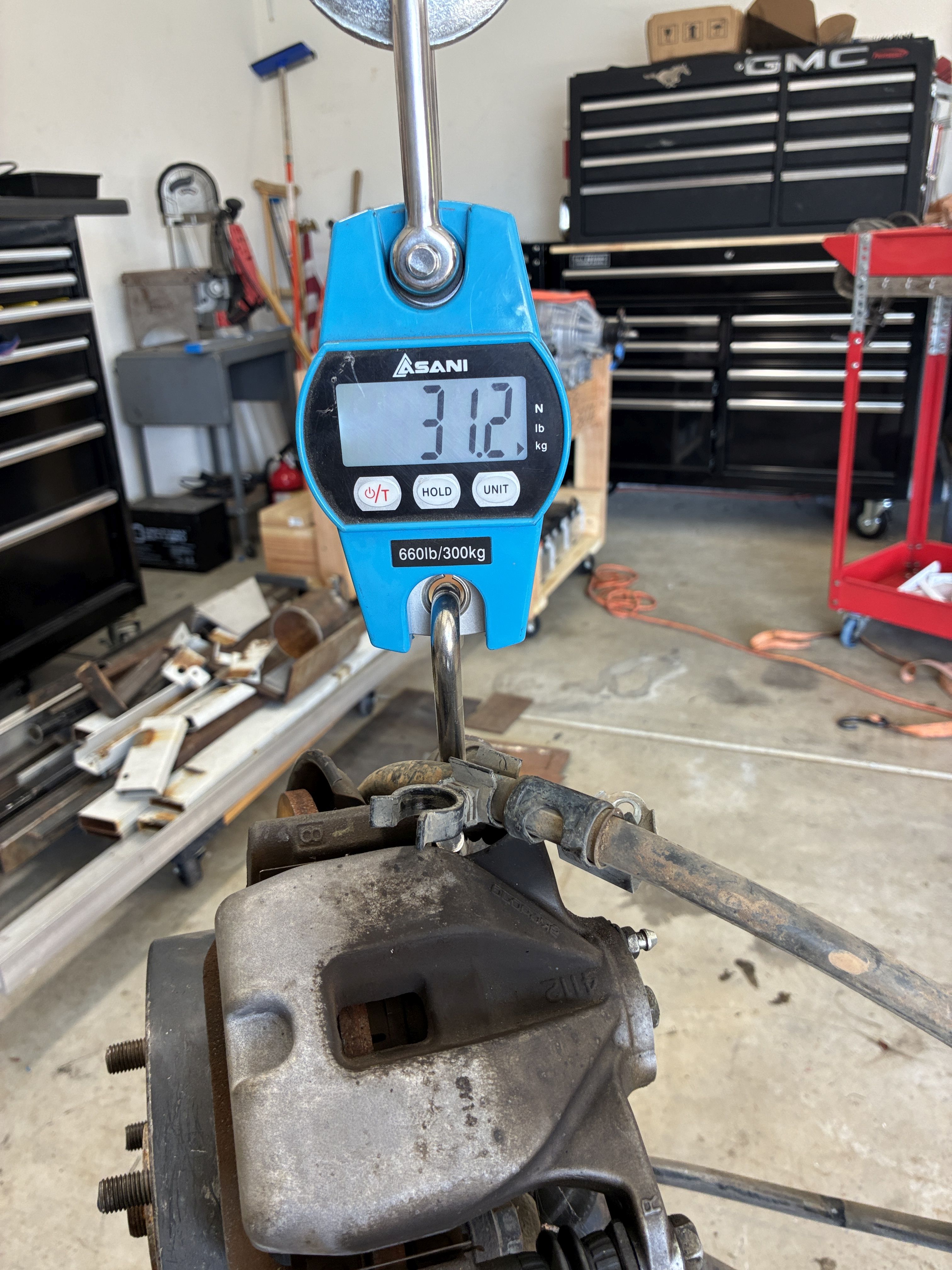

Post by Gregski »

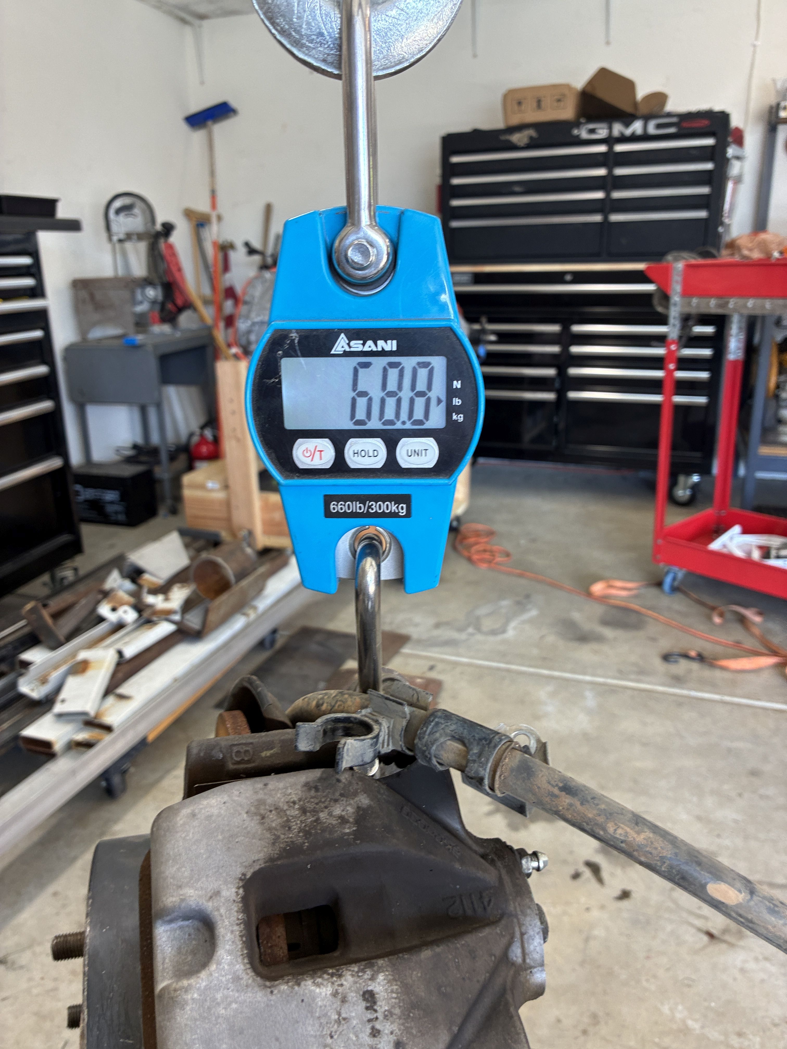

I also weighed the Highlander rear spindle/caliper/suspension sticks
so here are the totals
60 pounds for the rear subframe
90 pounds for the motor
70 pounds for the driver side spindle
70 pounds for the passenger side spindle
290 pounds (132 kilos) TOTAL
69 pounds (times two mind you as this is per side)
31 kilograms
