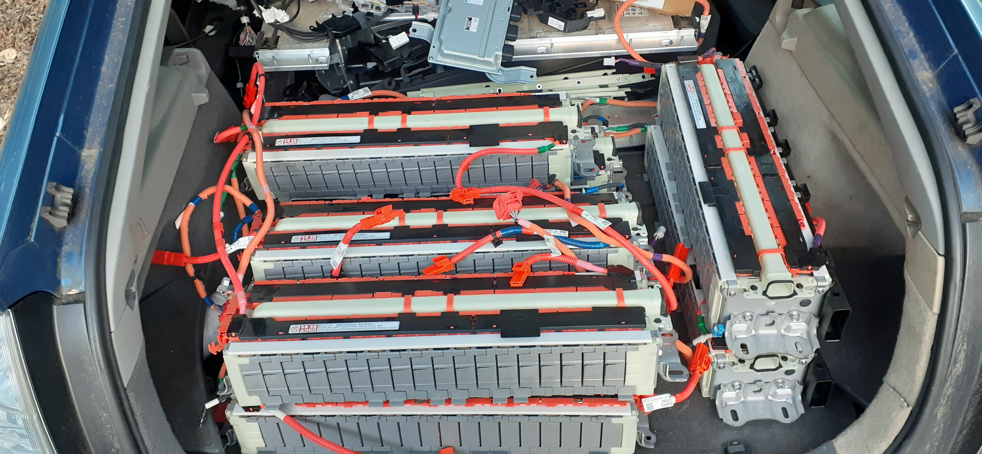

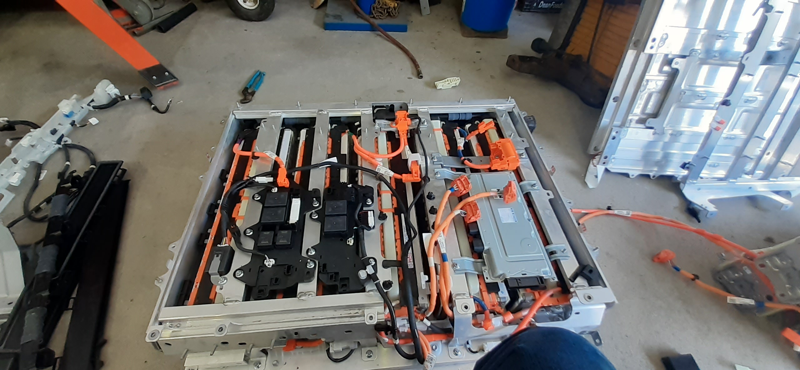

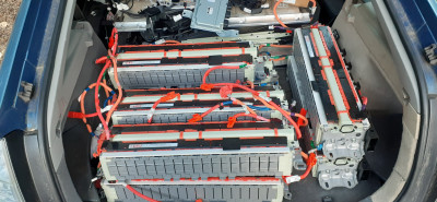

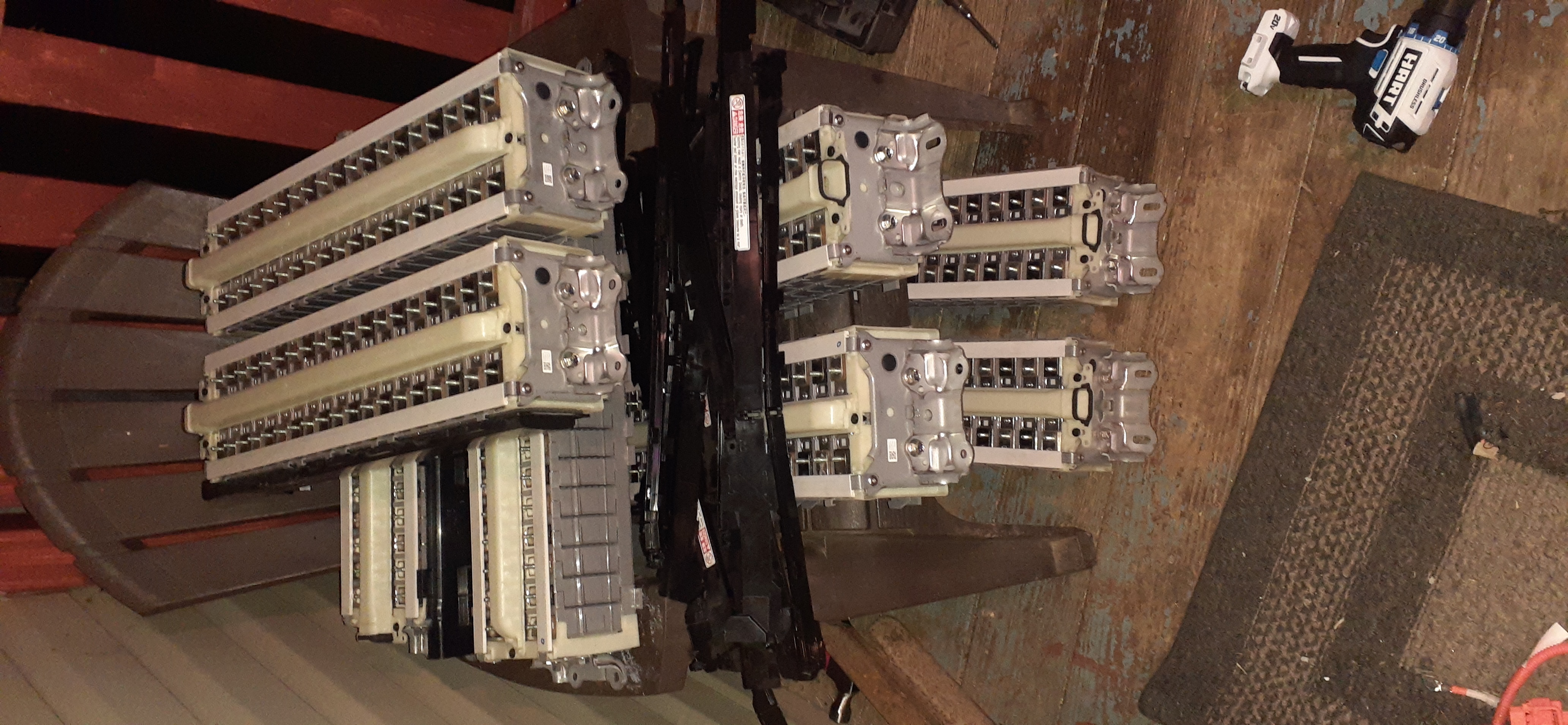

well, i have the battery's for the Electric RX-8 conversion. will be reconfiguring these to a 100ah only 47s at the moment until i can buy another prius prime plug in hybrid battery, rough voltage until i can get the other battery will be 192 full charge and nearing 164 volts at almost 30 % charge.

Will be adding the dual motor board to the mazda soon. Along side the batterys. This car should be good for 100 miles with some other features.
