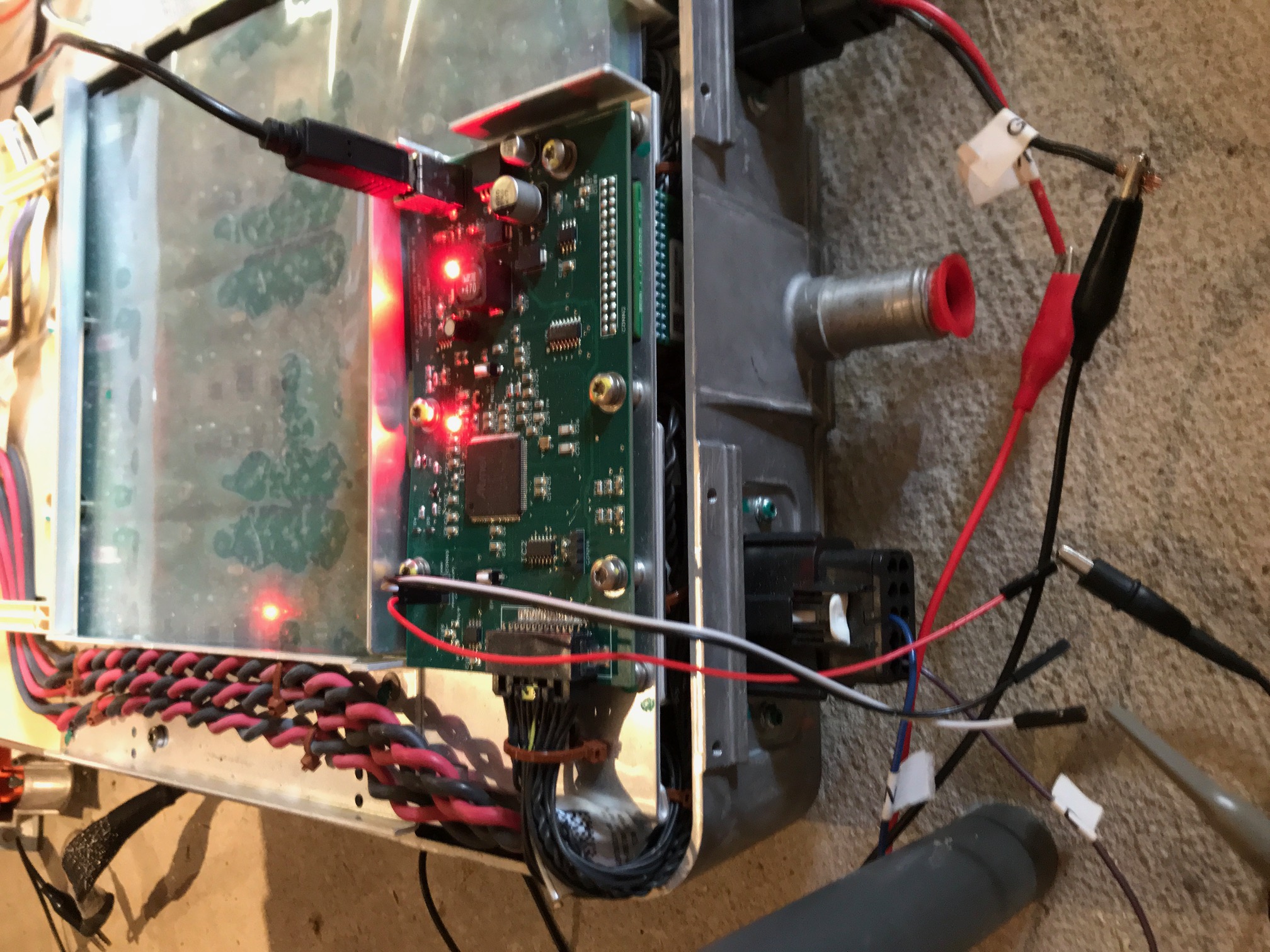

A capture and a new symptom in the process...
I attached a CAN receiver to the pins on Damien's charger controller. I was able to capture some CAN frames while activating 1 module for charging. The new symptom is that the 1 module does not start charging (???). It exhibits the symptoms that I saw when attempting to initiation 2 modules charging. Disconnecting the CAN receiver from Damien's controller and module 1 begins charging as normal.
Observation : Somehow connecting the CAN received to the internal CAN network is "disturbing" the internal can and preventing the 1 module from initiating charging. I've attached the CAN frames observed by the attached CAN receiver. (Note: I had 0, 1 and 2 120 Ohm on the CAN lines - made no difference to the observation).
Additional testing. 1) Hook up oscilloscope to the internal CAN to observe the waveform 2) hook up a different CAN receiver (different model altogether) and catch some frames.

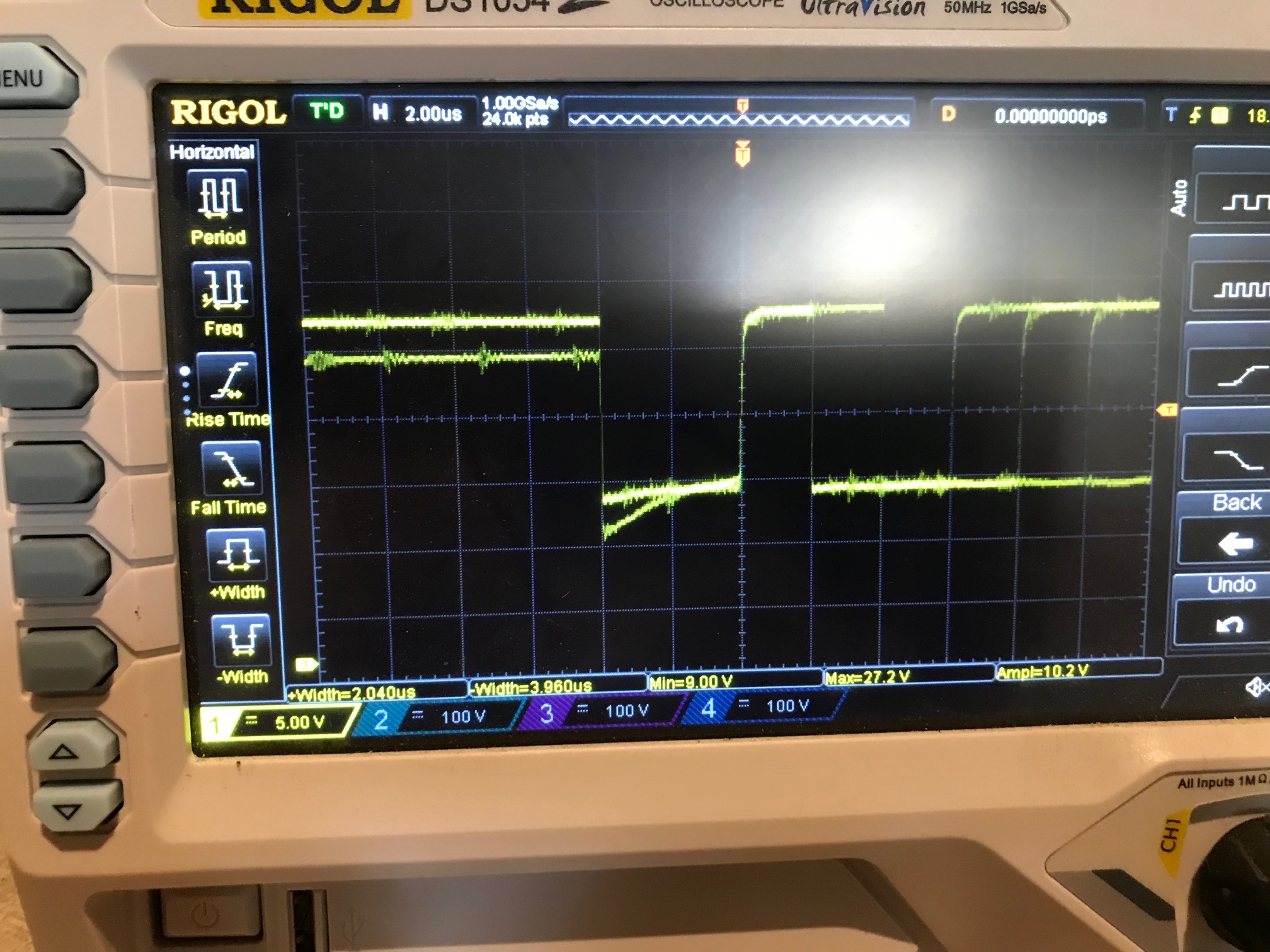

More data...
The oscilloscope confirmed the CAN on the internal charger network, but I was unable to read any CAN (possibly some odd incompatibility between my CAN reader and the internal network - it reads other CAN sources fine, just not this one). I read frames yesterday - but now I suspect that the CAN receiver was toast - when I disconnected it 'charging on one module worked', when connected 'charging on one module didn't work'. I tried getting ESP32CanDue running from EVTV today, but can't yet get all of the source libraries to reference correctly.
Also attached is a log of some tests (Output from the Gen2TeslaCharger software).
One possible line of inquiry might be to do with temperature limited current. It was 30C in the garage today. I checked all prior logs and they report "Temp Cur Lim 15 X Y" where X and Y are Celsius temp readings. "Temp Cur Lim" (the 15) is reported by the modules - value reported is multiplied by 0.234375 (to get 15). I'm guessing that 15 means that the modules are NOT curtailed by the temperature - even at 30C ambient.

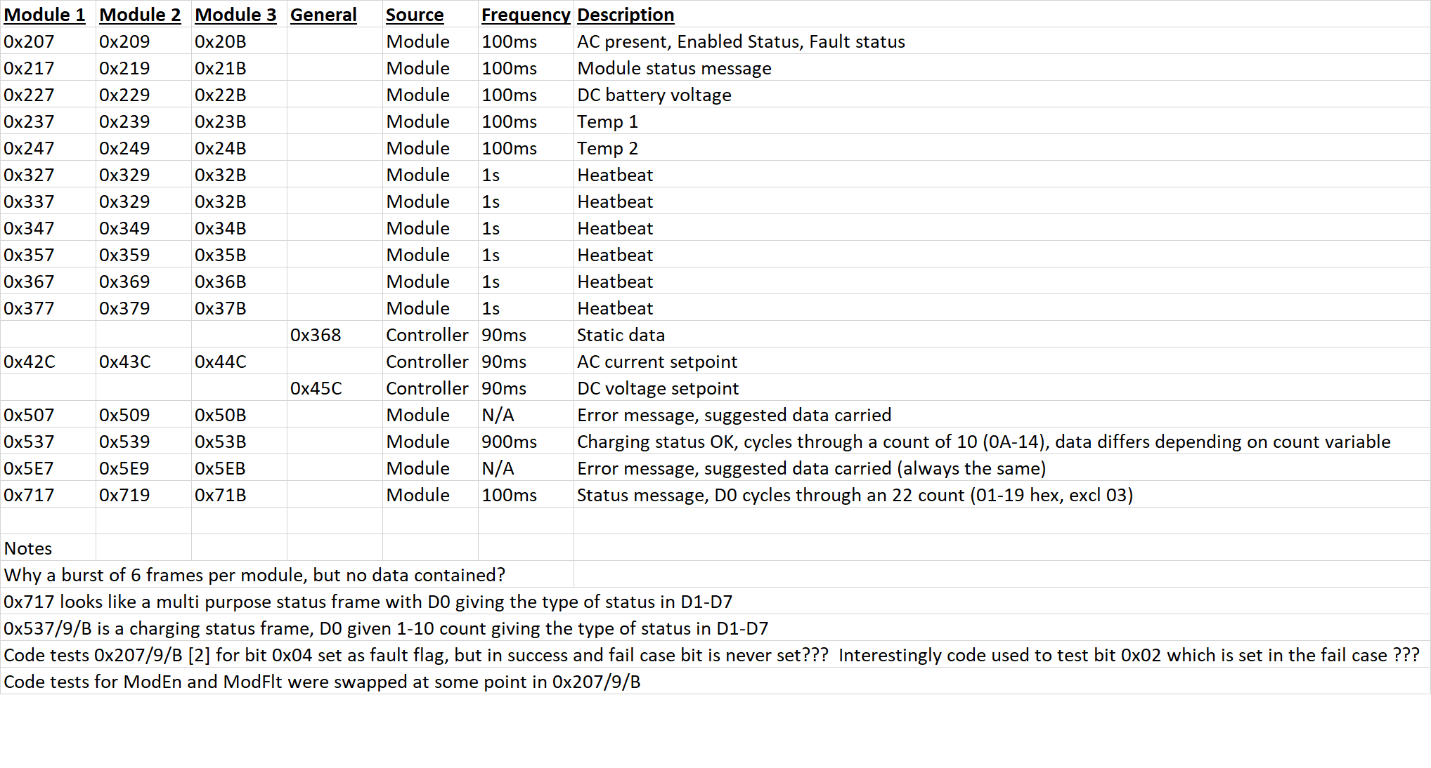

I have done some analysis of the CAN frames from the 1 module good charge and 2 modules failed charge, just to see how they might be different and how the frames from the software look like.
Analysis : Shows the frame IDs from the successful 1 module run, and the frame IDs from the failed 2 module run
Current : Some calculations looking at the current request data set to the modules (US and UK differ here in that current request is divided across 3 modules whether they are active or not - in the US code)
Mod1 successful log : Module 1 activated and charging successfully
Mod12 failed charge log : Modules 1 and 2 activated, but never get to charging successfully
I don't see anything obvious from the logs, but I think I've spotted the period during which the charger tries or prepares to start and then fails. I highlighted the start and end of a charge start period, and also highlighted with red text some messages that look a little odd.
There's no obvious "the module checked something and is not going to fail message". Interestingly some frames that are specific to the fail log are produced all through the test, even before the 'start charging' command is issued. This seems odd because how would the charger know that it is going to be requested to enable two modules? Some more detailed logging also capturing the logs on the controller serial might be in order to understand exactly what's happening when the two module startup is requested.
Jeff
Charger CAN Log Analysis.xlsx- (533.86 KiB) Downloaded 399 times

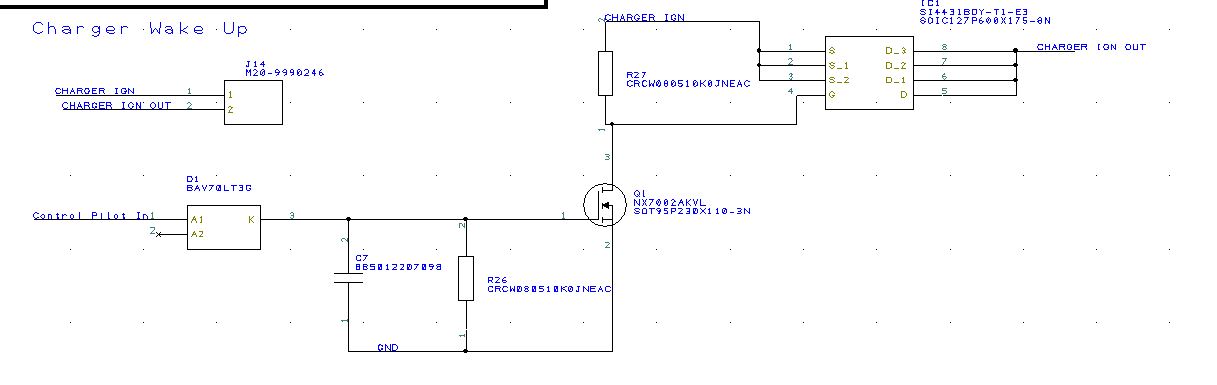

Wire the charger to be constant live or ignition live. This unfortunate draws quite some current.
I made a botch fix for this, create a circuit that takes the CP line and then switches a N mosfet to switch an P channel mosfet to power up the charger. It works a treat.
