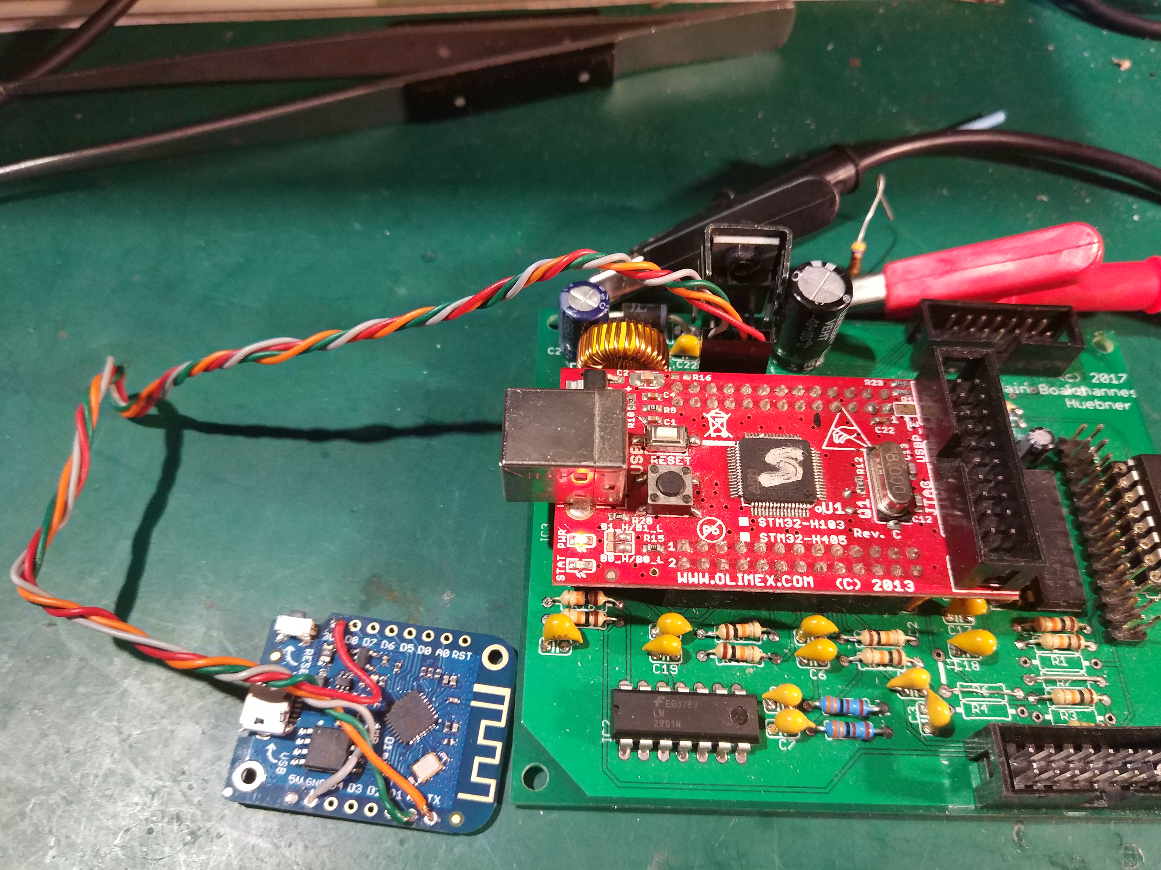

OK again i went and made some photos
This is my setup. Note wire colours. TX goes to RX and vice versa. Be sure you program D1 module with those settings you see on pic AFTER you program STM32 chip with STLINK you connect Wifi module to setial pins.

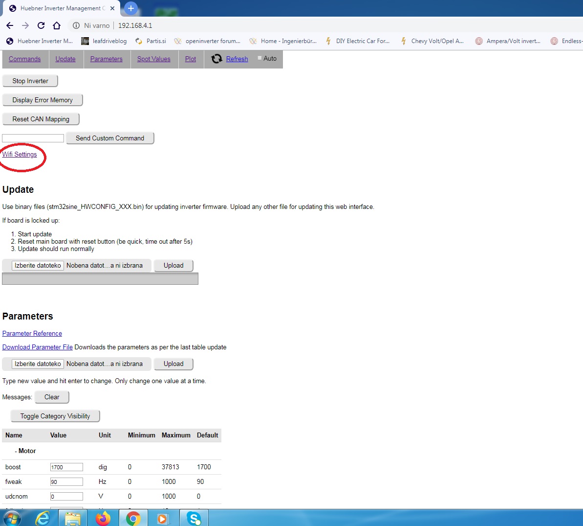

Next you apply 12V power to the board and search for wifi module with your phone.
Connect to wifi whitout password for now
Go to phone browser and type http://192.168.4.1/ and enter
If you do not get settings the first time reset STM32 by the button
Then restart the address in blowser again. After you get parameters field you search for "wifi settings" and change them.
Reset or reconnect again.... do not forget SSID and password

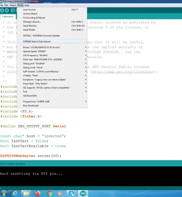

WeMOS D1 Mini is programmed via Arduino IDE.

Webpage hosts fine, but doesn't seem to want to connect to my wifi ever. (When I tell the webpage to look up Parameter Reference, it's supposed to go to Johannes' website but it times out trying to load). Not sure if that's essential, I can connect to the WeMos over wifi and those settings save fine, so, good enough?
When I scroll down I don't see (and never have seen) any actual parameters loaded. Just the header that says Parameters. I've refreshed, reloaded, reset... nadda.

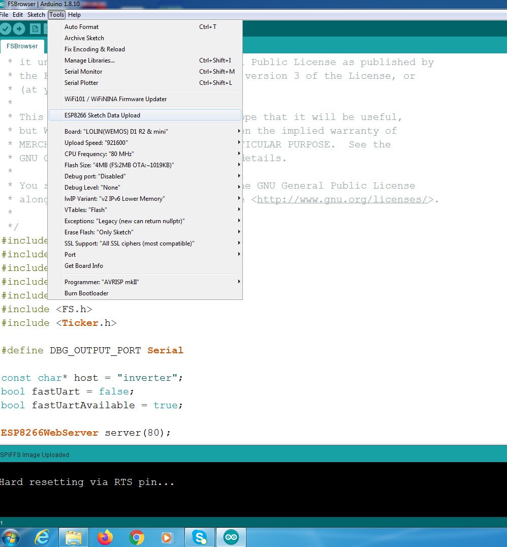

The only things different in my Arduino IDE settings from your most recent screenshot are:
My "Flash Size" is still set to 4MB (FS-1MB) (from your earlier instructions) instead of 4MB (FS-2MB) (as shown in your most recent screenshot). Which is correct?
iWIP Variant: "V2 Lower Memory" instead of "V2 IPv6 Lower Memory". Does this matter?
When I download the parameters file, it's just blank curly braces { }.

Like I said EXACTLY as in the picture. Those are settings that work. I don't vouch for others.
Sometimes you have to reset STM32 so D1 can get in sync with serial.

No, i mean that when you set out to program ESP in Arduino you have to set every parameter like in the pic! If you have a memory set differenty or some IP config you may get different results.MattsAwesomeStuff wrote: ↑Sat Jan 11, 2020 9:47 am Reflashed the Wemos with exactly the same settings.

I think we're saying the same thing.No, i mean that when you set out to program ESP in Arduino you have to set every parameter like in the pic! If you have a memory set differenty or some IP config you may get different results.
I disconnected the WeMos, changed the settings in the tools menu to match your settings in the image, plugged the WeMos back into the computer's USB, uploaded the sketch from the Sketch menu, uploaded the sketch data from the Tools menu, plugged the WeMos back into the Blue Pill on the Control Board, powered up the Blue Pill, reset the Blue Pill via the reset switch, logged into the inverter's wifi... still no parameters visible.

Darn!MattsAwesomeStuff wrote: ↑Sat Jan 11, 2020 11:14 amI think we're saying the same thing.No, i mean that when you set out to program ESP in Arduino you have to set every parameter like in the pic! If you have a memory set differenty or some IP config you may get different results.
I must confess i didnt try serial with Bluepill exactly. I just use my Olimex H103.
I tried with Bluepill. I cant seem to get parameters.
So schematic is the same that Damien uses on his github? Because i dont have his board i connected to STM32 pins directly.
I reloaded my D1 with the correct firmware so that is not the issue here.
I even tried with H103. I can get parameters from my Olimex board.
Johannes, any thoughts? Maybe you adressed TX RX differently? To program my Bluepill i used the last code from this thread.
viewtopic.php?f=3&t=220&start=60#p3121
EDIT: I even tried to supply bluepill from different 5V source so USB connector wouldnt interfere with serial, still no joy.

- We know the WeMos D1 Mini boards work, some of you have got them working.
- We know the Blue Pill works, Damien got his working the first time on his board, in multiple videos.
- I seem to have gotten both boards to at least accept their bootloaders without error.
Any reason I'm not seeing them talking to each other? Or a way to test them?

I will try and test Bluepill connection with original Olimex ESP8266 MOD tomorrow. I think it should.MattsAwesomeStuff wrote: ↑Sun Jan 12, 2020 9:29 pm Any reason I'm not seeing them talking to each other? Or a way to test them?
I am having problems connecting to another D1 which i programmed the same as the first one. Very strange, keeps refusing connection from my phone, but it connects to PC fine.

Hm... see here this problem...
viewtopic.php?f=7&t=234
Would it be possible that bluepill does not have the TTL capability on the side outputs and needs additional interface like FTDI to communicate on that pins?
I will see with scope where i see any traffic and how i can use the pins available with D1.
Also i can use my Linux interface with Bluepill to connect. I see by the flashing led serial is working.

Damien definitely got it working with the Olimex MOD 8266 and his Blue Pill board. He has videos of it in the Prius Gen 2 thread. But I think you said you can't get it working with either the D1 or the Olimex?

Re: HOWTO: Flashing ESP8266
Blue-pill has x3 different TTL UART pins... I believe you need USART#3
USART3 TX PB10
USART3 RX PB11
USART2 TX PA2
USART2 RX PA3
USART1 TX PA9
USART1 RX PA10
USART3 TX PB10
USART3 RX PB11
USART2 TX PA2
USART2 RX PA3
USART1 TX PA9
USART1 RX PA10

Yes i tried to get Wifi Working through serial 3.
Now i only used D1 mini. I need to make a new cable to hook up Olimex wifi gizmo, but i will try this also.

Yep, that's where Damien put it in the circuit.
You can see it on the circuitboard: https://github.com/damienmaguire/Prius- ... %20PCB.pdf
And you can see here that those pins are labelled as USART RX/TX: https://github.com/damienmaguire/Prius- ... ematic.pdf
Damien definitely got it working, presumably using the same code and components.
Part of this is that I don't know what a sign of life looks like from the Blue Pill or the D1 with respect to talking. Like, is the web interface interfacing poorly and just not sending or receiving? Is the Blue PIll not listening? Are they both trying to but something in between is stopping them? Is it getting part way through the process and stopping before the point where I'd see a result?
My only measure of "Yes they're talking" I guess is if the parameters start to show up.

No the board is definitely talking. Steady blinking green LED is proof of that. I just dont know what is the port that this thing is sending data to.MattsAwesomeStuff wrote: ↑Thu Jan 16, 2020 7:48 amYep, that's where Damien put it in the circuit.

D1 is not the problem, it works on other stuff. I think all Bluepills are not created the same. That is a pun, sorry.doobedoobedo wrote: ↑Thu Jan 16, 2020 11:34 am Can you get an oscilloscope on to the UART pins of the D1 mini?
Yup i dont find any traffic on TX and RX if i dont connect Wifi module. D1 by itself is sending signal.
However i did see clear PWM on B3 pin at 17khz.
Hm...
I tried installing the first firmware and i got different config. I am not sure what to do with this one...

I'm semi-sure mine aren't corner-cutting crap.I think all Bluepills are not created the same.
I ordered locally-ish, the guy runs a small shop supplying stuff to people in Canada. A business built on reputation and word-of-mouth. I ordered from his Amazon store, but still. Not some Chinese popup clearance company that'll be gone before the boards arrive.
Still, could be the case.
So, looks like the problem is on the blue-pill side?
