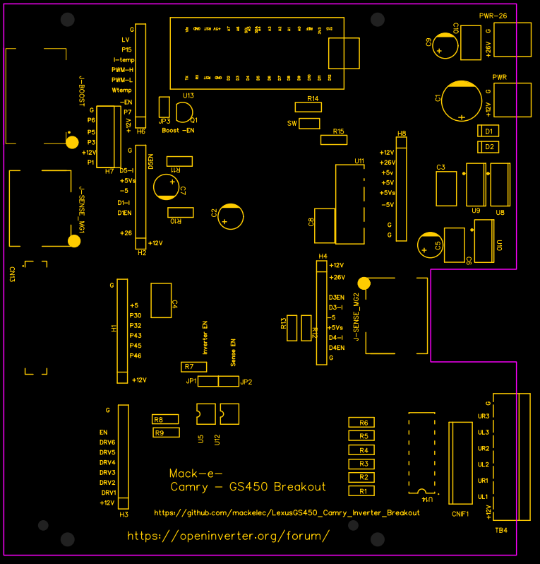

I'm ready to get a PCB made.
Everything is on this Github
If I have described something wrong or have missed something please let me know.
(The outline of the Toyota PCB and holes in on github as DXF)

by Jack Bauer
That is simply excellent. Thank you.

mackoffgrid wrote: Fri Nov 27, 2020 8:35 pm I have received my PCBs and was going to test it out this week but another job may have pushed that back.
What's the status on this? I'm considering using my GS450H inverter with johannes brain, do you think I wouldn't be too far off if I'd base my board on your latest pinouts?
Re: Camry Hybrid Gen 1 Inverter Hacking
Posted: Tue Jan 19, 2021 5:37 am
by mackoffgrid
I haven't tested the PCB yet - too many projects :D
The thing with the Camry Inverter is that not all the Fault and Temp lines have been identified. This is not a problem for my application.
If you use my gerbers it will cost $10 or so at JLC to try it out :D
The physical dimensions, holes and connector positions are fine.
