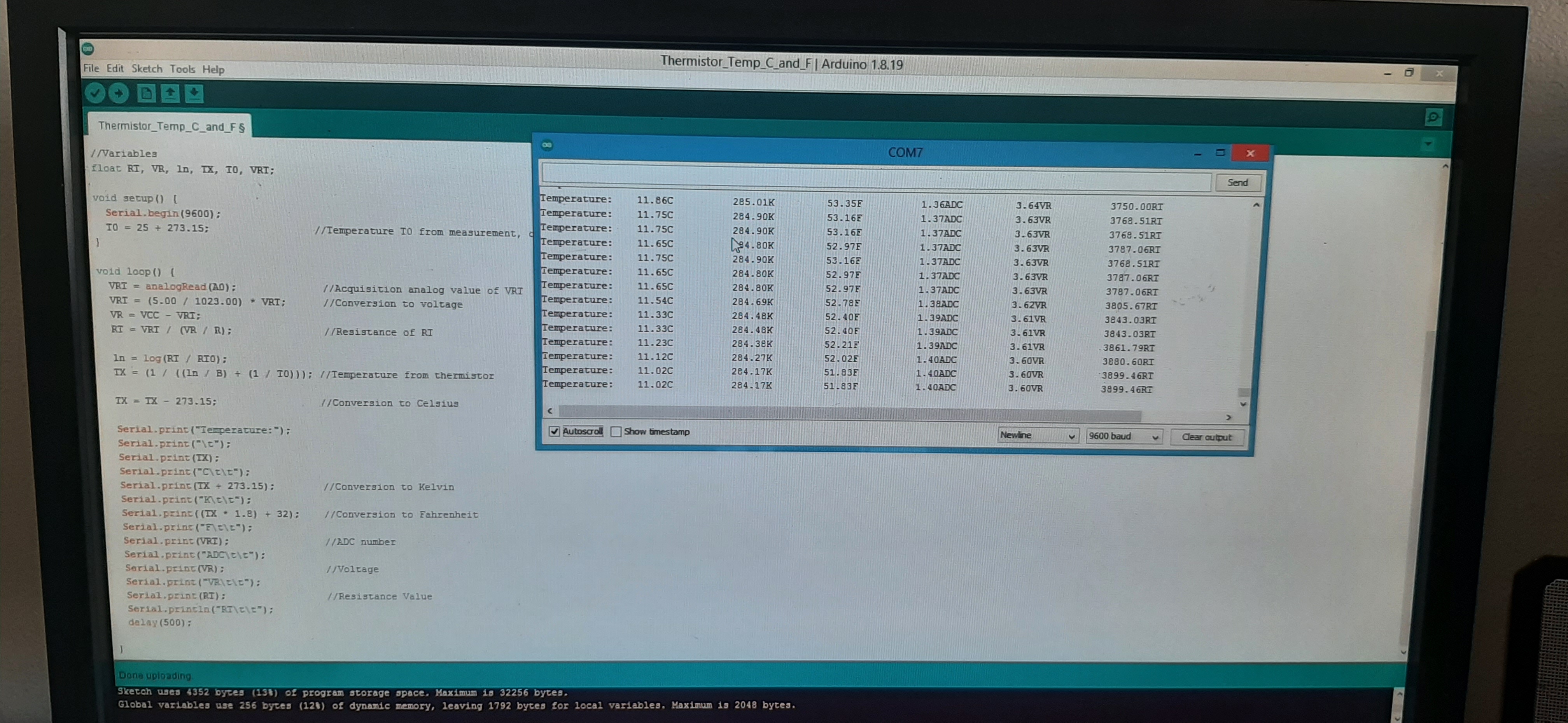

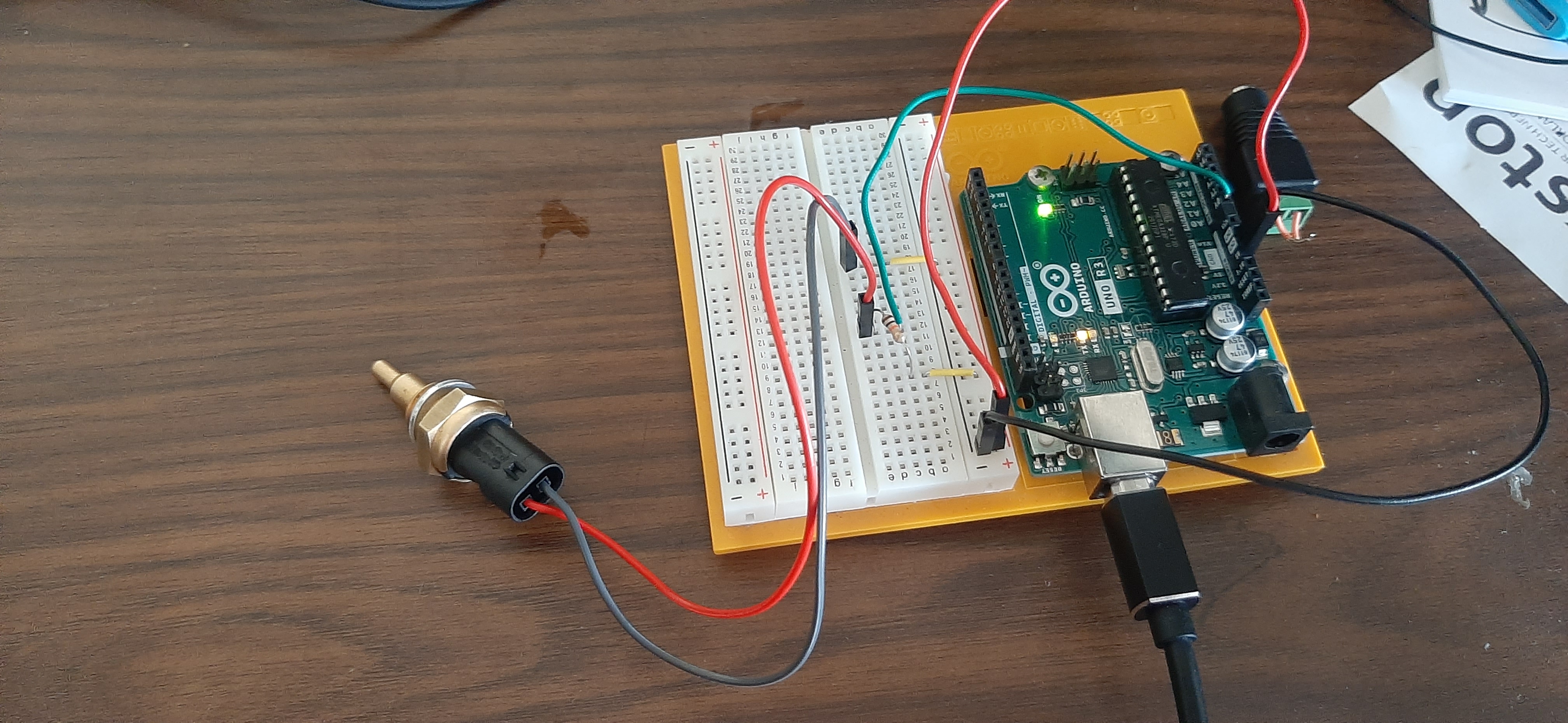

Happy New Year. I have a BMW 13627580635 temp sensor that is used on the hybrid gearbox. I followed the steps outlined as best as I could. I'd like to be able to use this sensor in place of the MG2 temp sensor on the Zombieverter and Prius Gen 3 boards but I'm not sure how to do that.
