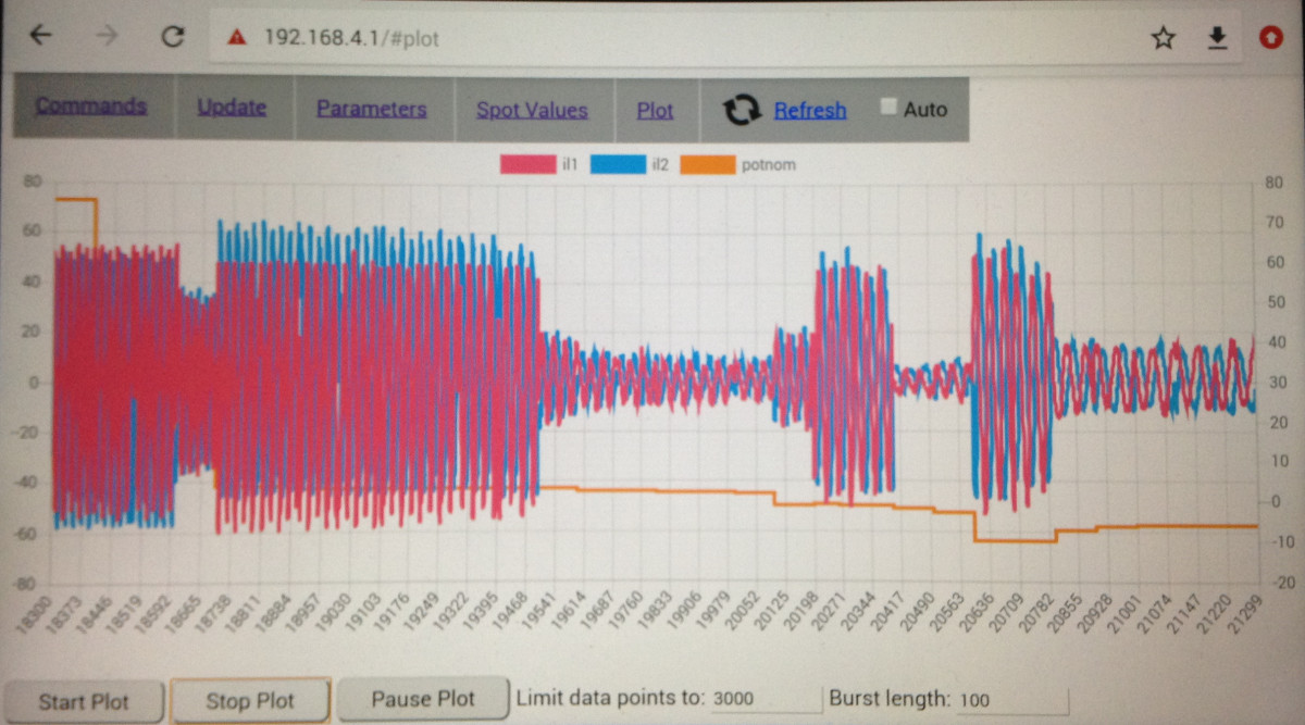

Here is one plot during acceleration. On the left axis is IL1 (red), IL2(cyan), POTNOM(blue) and on the right is motor speed (yellow). Divide motor speed by 65,8 and you get car speed in km/h.
Above 1500rpm there is no change in motor current amplitude? I would expect this current to continue to decrease as speed increases.
Also not shown in this plot but at speed over 30km/h I get the same acceleration with 25% throttle or 100% throttle. Even if the motor is in field weakening region I would expect the acceleration to be linear to throttle input.

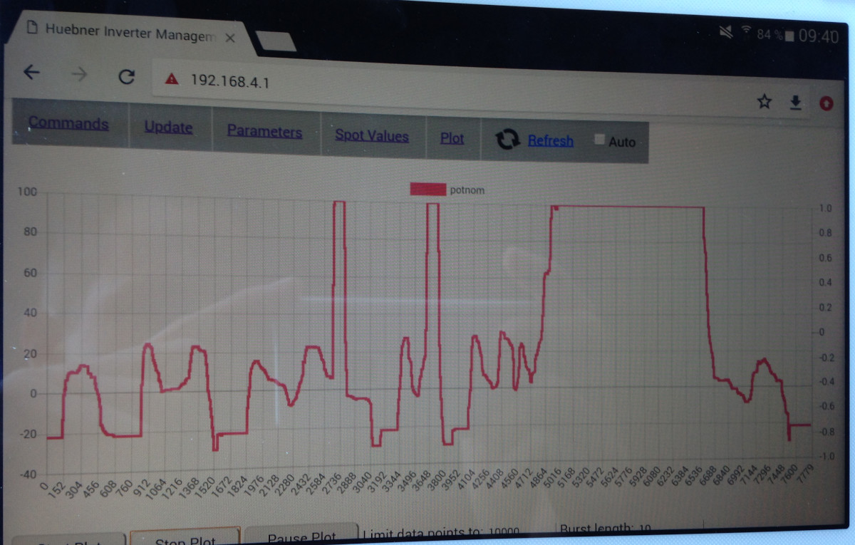

One plot of deacceleration.
Starting at approx 50km/h or 3300rpm and setting throttle pedal close to potnom zero but still positive at around data point 18700 and still get quite hard regen? At 19500 the speed has droped and the regen stops, potnom still above 0. At 20125 I have released pedal enough to get some small regen and then at 20271 I suddenly again get a more powerful regen without change of potnom.
I think I have missed something in the setup? Will try to find whats causing this and try to fix it.
I also have some spikes in the current measurement, jumps to 5A when at standstill. Proably due to CAN-tranceiver disturbances.

Can you plot fstat, uq, ud? Accelerate, regen, stop.
Maybe the controller gains must be tuned for this low voltage setup. I don't know.
Could also have the boost converter step up to 300V or so.

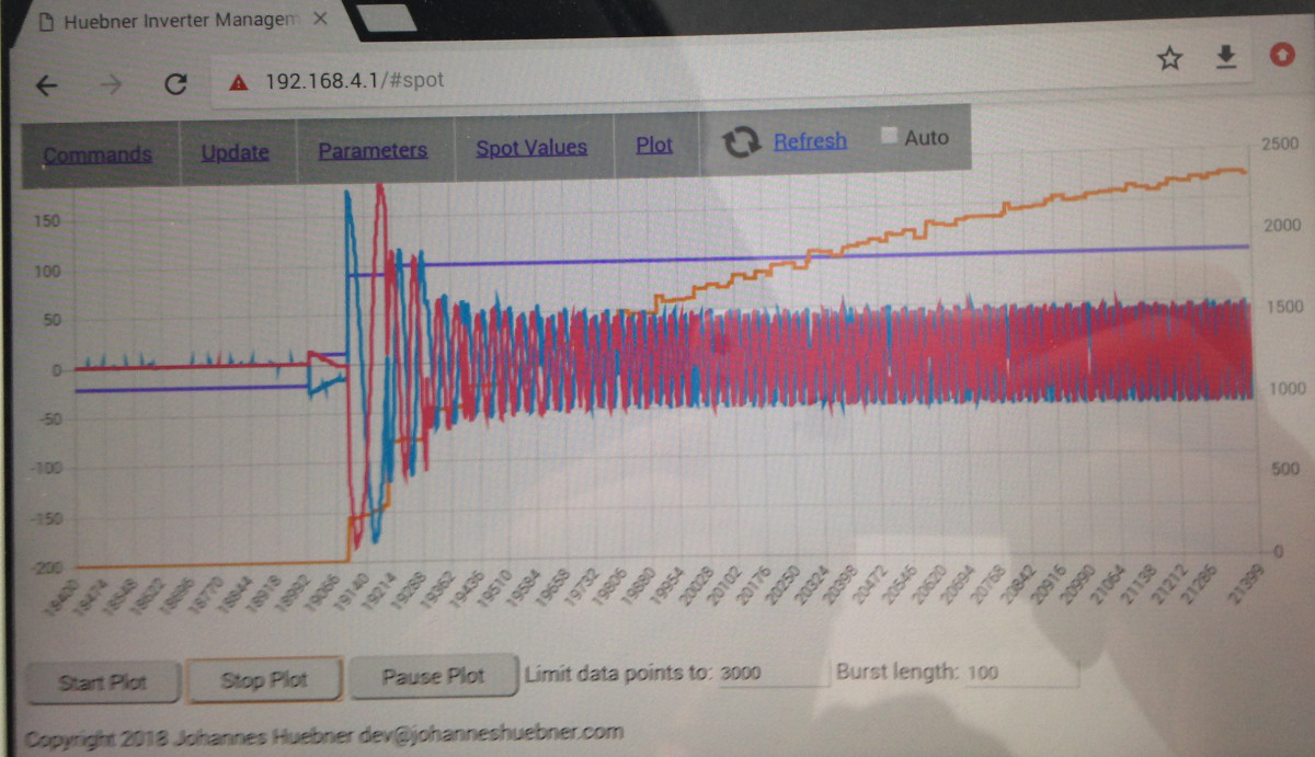

I've tested by setting throtcur to 4 but with no effect on acceleration. It only made the throttle pedal more responsive.
I will however keep this relationship in mind when doing future tests.
I have also found out how to make screenshots on my tablet, so increased image quality. :)
Deacceleration.
Acceleration.
There are some jerkyness going on during deacceleration in the transistion from FW to normal, ~110Hz.
I do have a hard time finding the exact right value for syncofs. I've tried following the video but I get motor standstill between 31300 and 34000 so I have averaged it to 32650 for now. Maybe this also is a sign of to low battery voltage.?
There are also spikes in ud and uq so I think it is a good idea to get rid of them before digging to deep into other problems.

Re: Renault Clio Electrique -97
Posted: Sun Oct 25, 2020 9:49 am
by johu
Yeah you can see inverter goes full amplitude at like 60 Hz or so. From then on it has nothing more to give. You can try working on syncofs more and also see what happens with boosted voltage.
