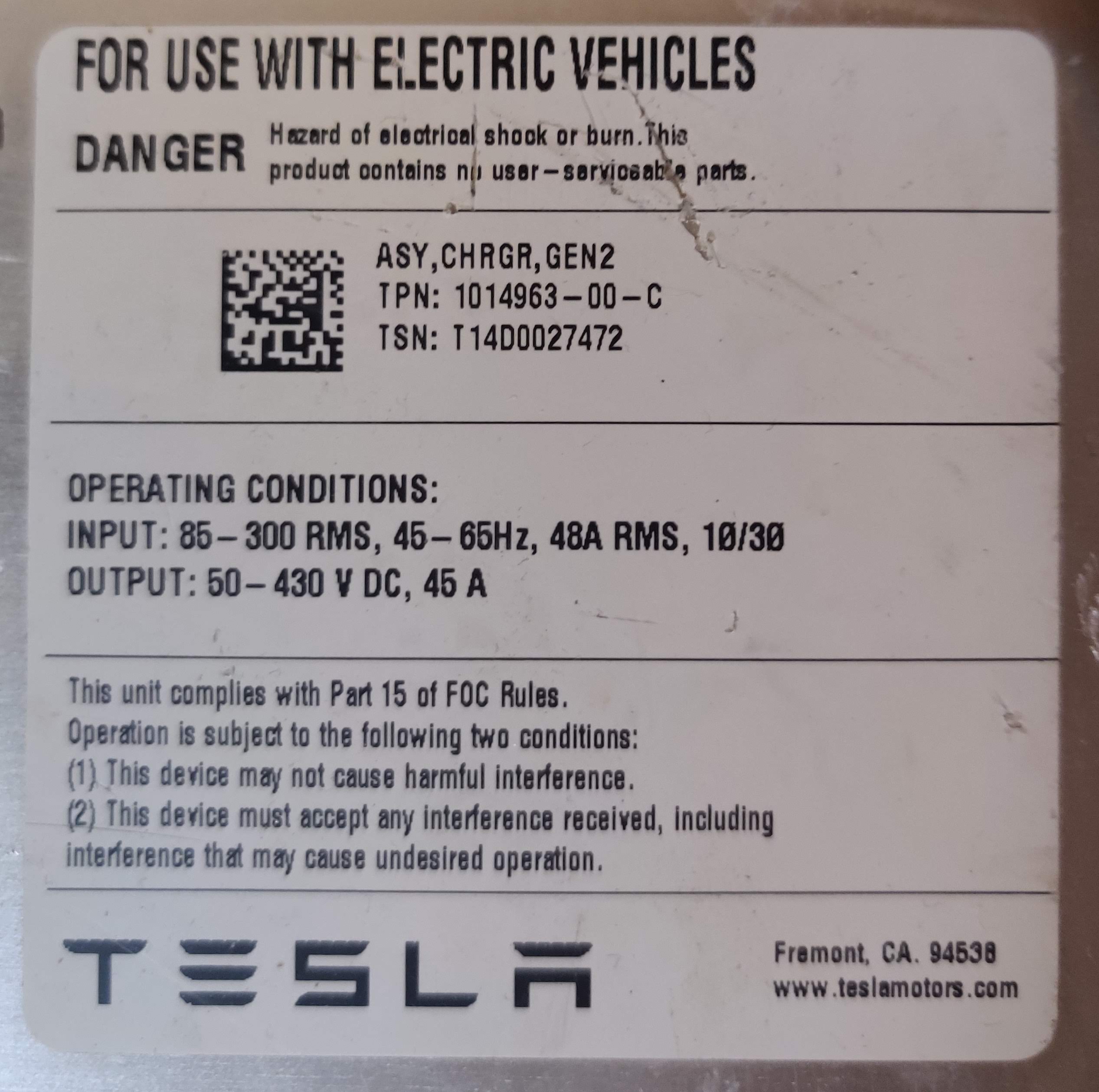

Folks, trying to get GEN2 charger to work but it seems to be broken or perhaps not compatible/supported.
It is model 1014963-00-C from vehicle and not from supercharger.
Description of the issue:
viewtopic.php?p=29667#p29667
Did anyone get this model/revision (1014963-00-C) to work?

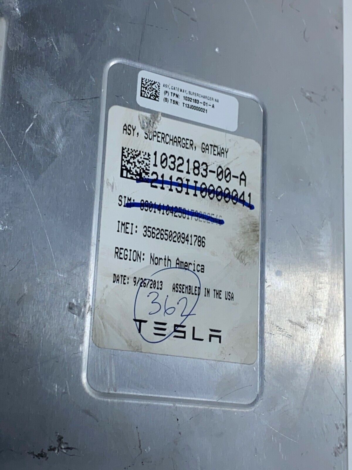

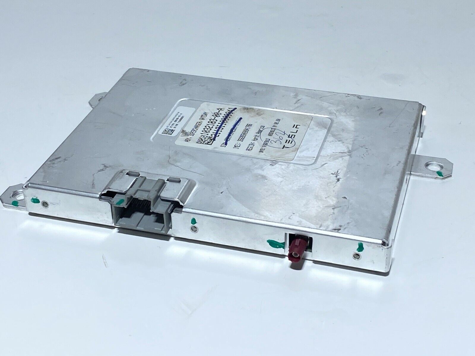

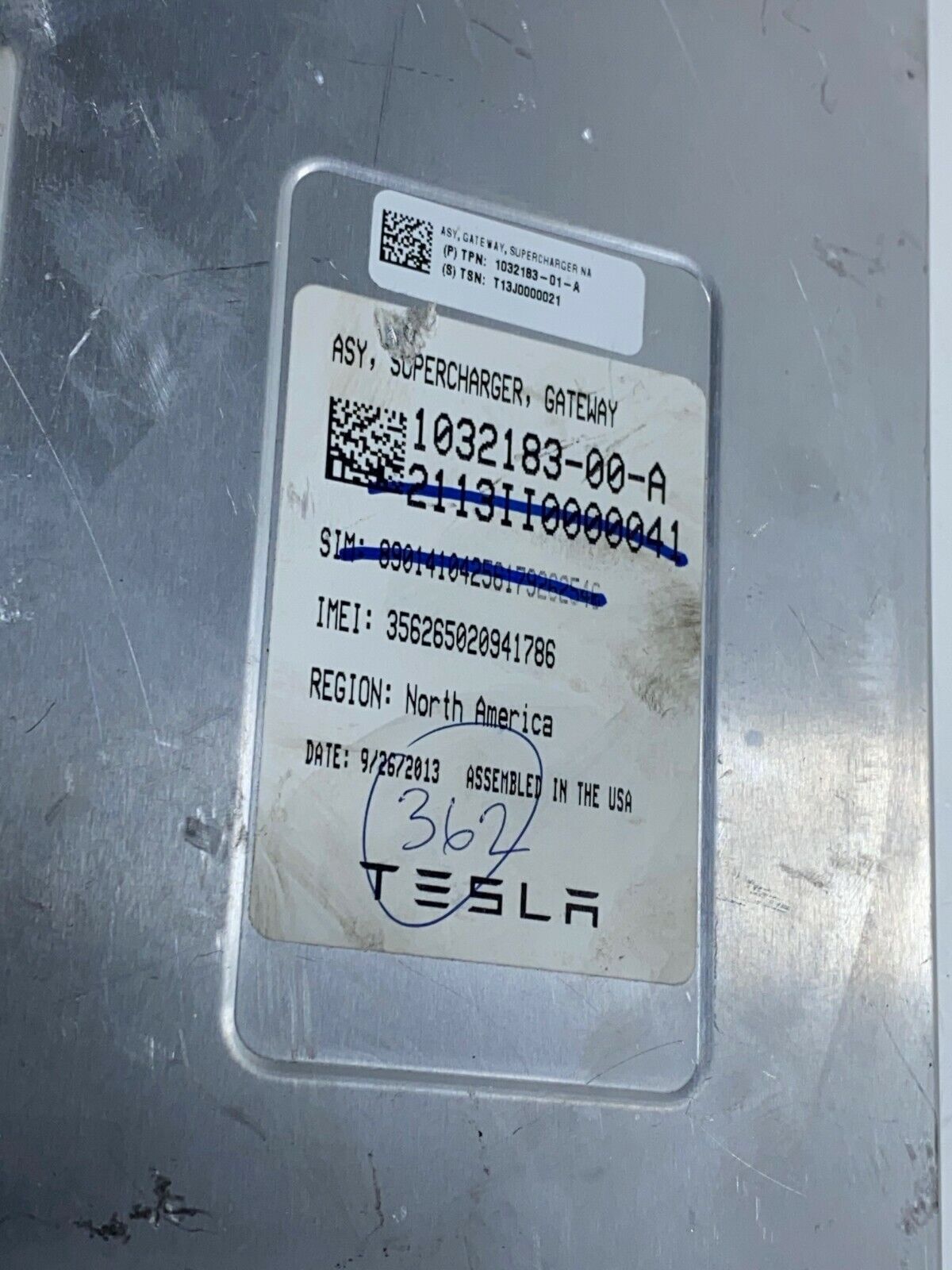

Came upon this : https://www.ebay.de/itm/234267863745
If it is what I think it is it might contain the necessary CAN to control all these supercharger chargers.

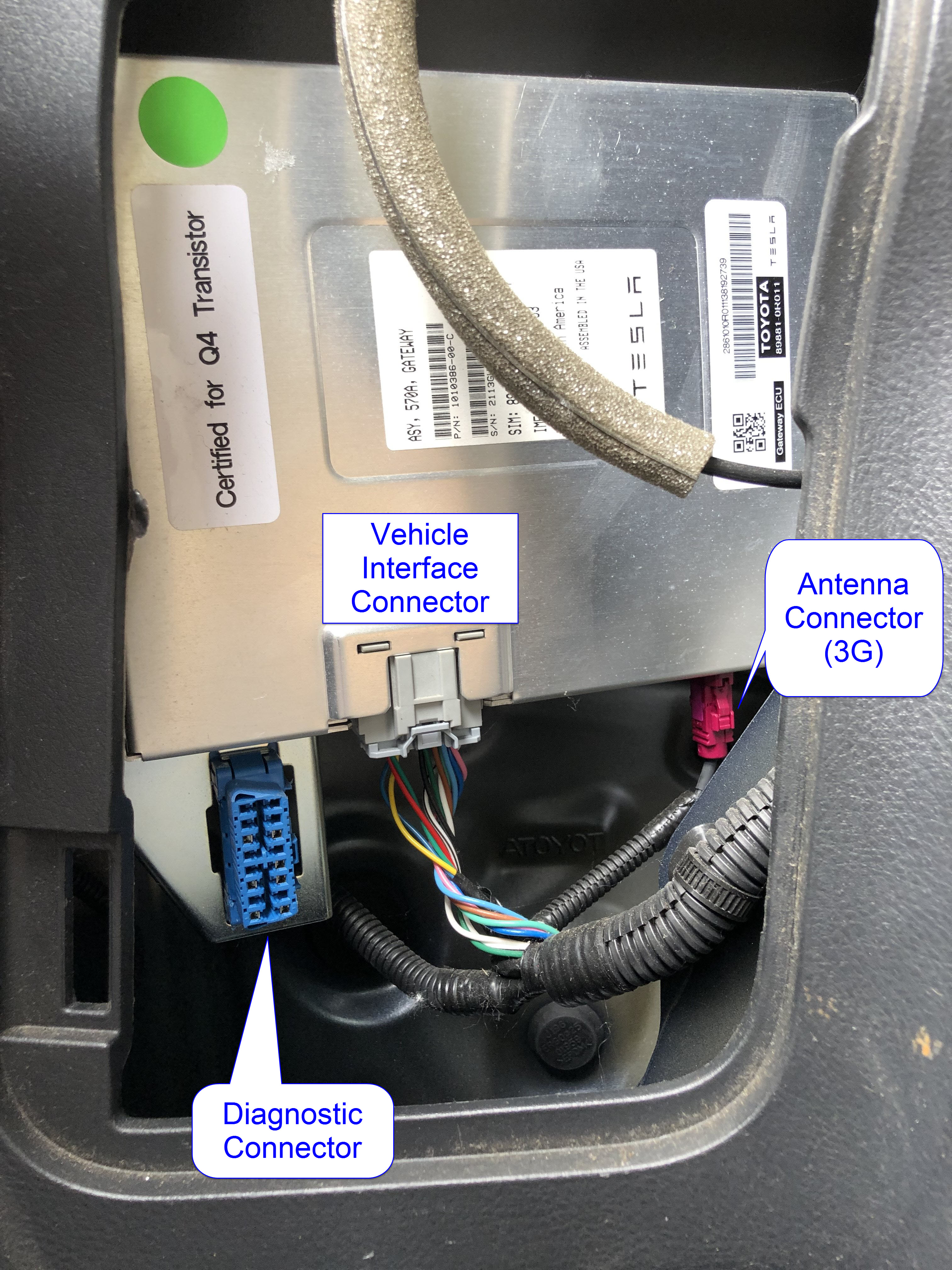

Interesting. It bears a striking resemblance to the Tesla Gateway module used in the Toyota RAV4 EV 2012-14.Jack Bauer wrote: ↑Sun Nov 07, 2021 1:01 pm Came upon this : https://www.ebay.de/itm/234267863745
Pics of the Supercharger Gateway Module from that eBay ad:
Pic of mine in a 2014 RAV4 EV. Even has the antenna connector:
The blue OBDII port is not part of that Gateway Module, it's merely bolted near it, and its harness is part of the Toyota harness.
Vladimir Leshchenko posted a (360p, ugh) video of the internals of the Toyota version on YT last year: https://www.youtube.com/watch?v=J-nOMmLsYOY
