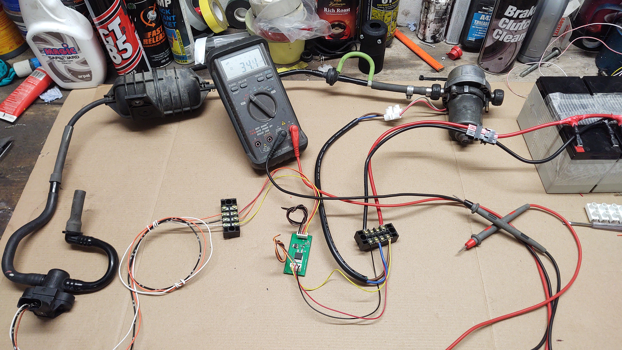

While I'm waiting for the coupler to arrive I'm doing other things that will need done anyway.
I bought a Zafira power steering pump but I think it's faulty as it spools up to full power but won't fall back to normal power.
So as the Zafira pump seems to be faulty I decided to see if I can drive the Freelander PS pump with an alternator adapted to run as a motor.
Also I've just tested the circuit board sent by Johu with the Audi sensor and pump and all working perfectly so far. :)
Thanks Johu :)

Great work! I would be wary of running the power steering that way. My smith Edison van does it that way albeit with a larger motor and it is very inefficient from a power and space perspective. Just a thought would the leaf rack be usable? . Have you a plan for the leaf shell?

paaa wrote: Fri Jan 22, 2021 12:33 pm Great work! I would be wary of running the power steering that way. My smith Edison van does it that way albeit with a larger motor and it is very inefficient from a power and space perspective. Just a thought would the leaf rack be usable? . Have you a plan for the leaf shell?
This car is just a test mule so if it turns out to be a bad option I will rethink it. The Zafira power steering pump draws 25A continously and more when you turn the wheels so it's not particularly efficient . I still have the Leaf power steering so if any one comes up with a way to use it I'll give it a try.

Toyota Prius and Vauxhall Corsa C electric columns are popular solutions.

I know you have a lot of experience with conversions so thought I'd ask, have you any thoughts on the wisdom of spending time on the original power steering pump and motor as I've shown it? I don't want to try and reinvent the wheel if it ends up being square.
I already have the motor and ebike kit and it seems to be working but I don't want to waste time on a lost cause.

I've never actually done anything with power steering, the Lotus will be the first when I get around to it. I have a Zafira pump waiting to go into that and from what I've seen, a correctly functioning pump should idle at around 8 amps. The behavior I've been seeing didn't quite seem to match up with the description of power steering function with a pressure limiting valve, but having done some more research, it's a combination flow regulation valve with a pressure limiting valve too.
Power steering pump, function.pdf
(401.59 KiB) Downloaded 723 times
You haven't as yet tested your pump setup under full load, so I don't know if your setup will be adequate.

I agree 100% Paul, testing with no engine or gearbox is not really going to give a true result but it kinda proves the concept. I suspect a more powerful motor and almost certainly a more powerful controller will be required to run this long term but as I've said before this is just a test mule for the real thing so I don't mind trying stuff to see how it goes.
