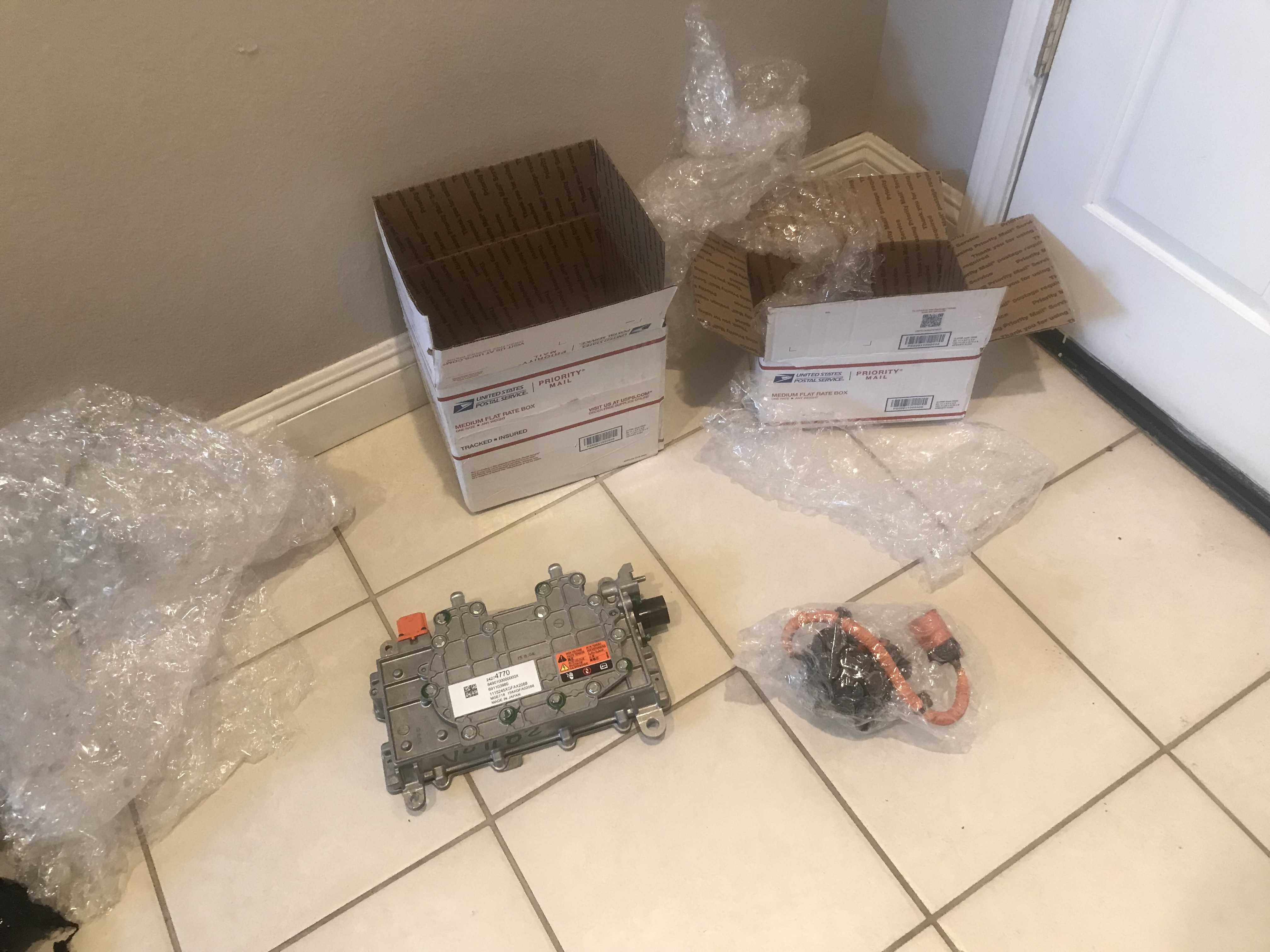

Did we get an answer on this? I'll be using this unit in my project and would make things simpler.

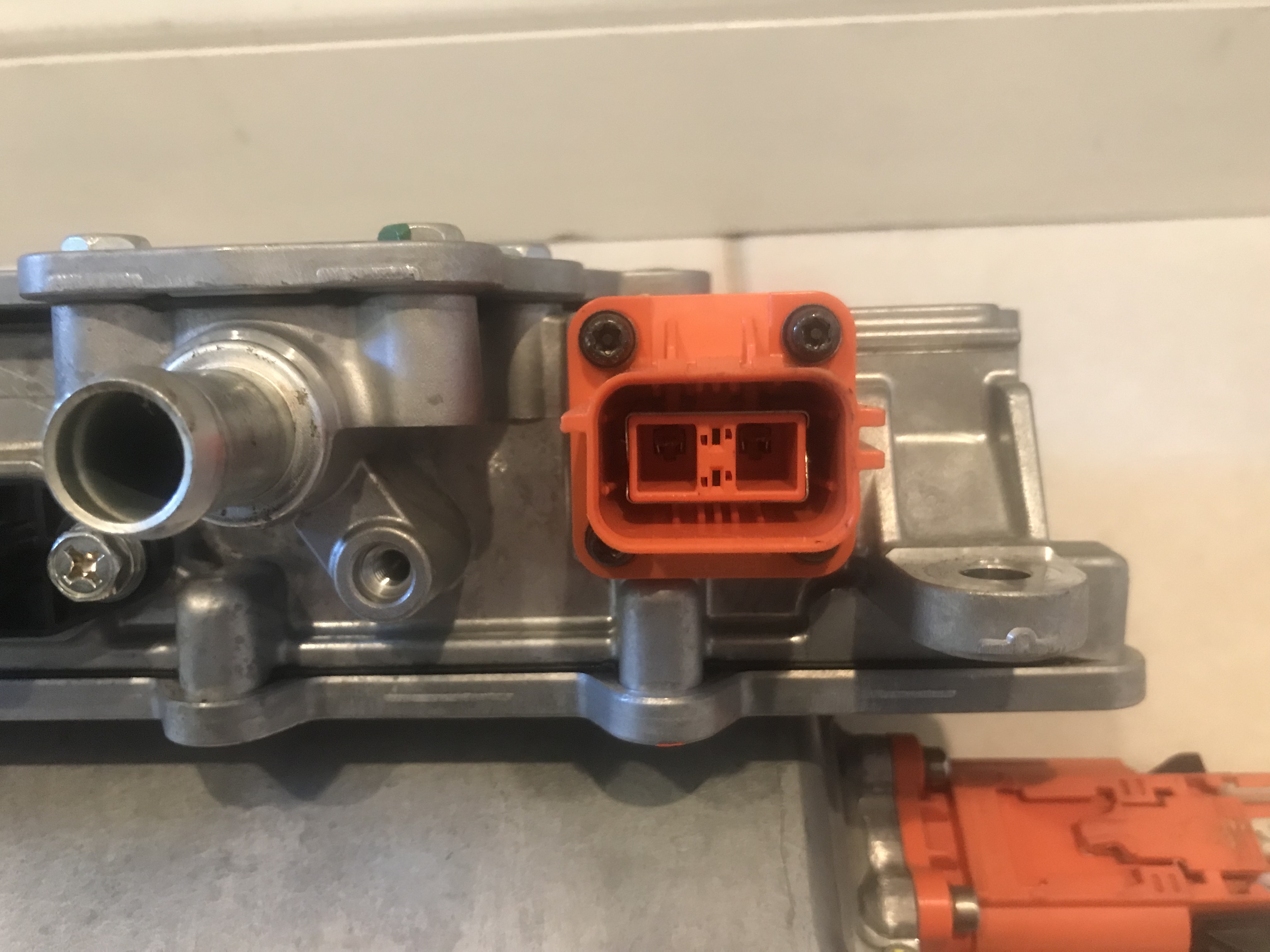

Did not check that (yet). But it's easy to check; look at the PCB and see if there is a current-limiting device between the HV-connector and the HV-capacitors.

Do you see indication of any current-limiting functionality in these pics?

There is no current limiting resistor there. How do i know? Because i burned one of them when i accidentaly reversed polarity
There is plenty of film caps to absorb the spike at connection though.

And I see 2 inductors which are if I'm right prime examples of current change limiters.

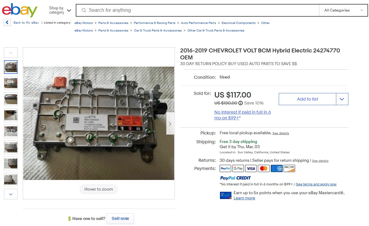

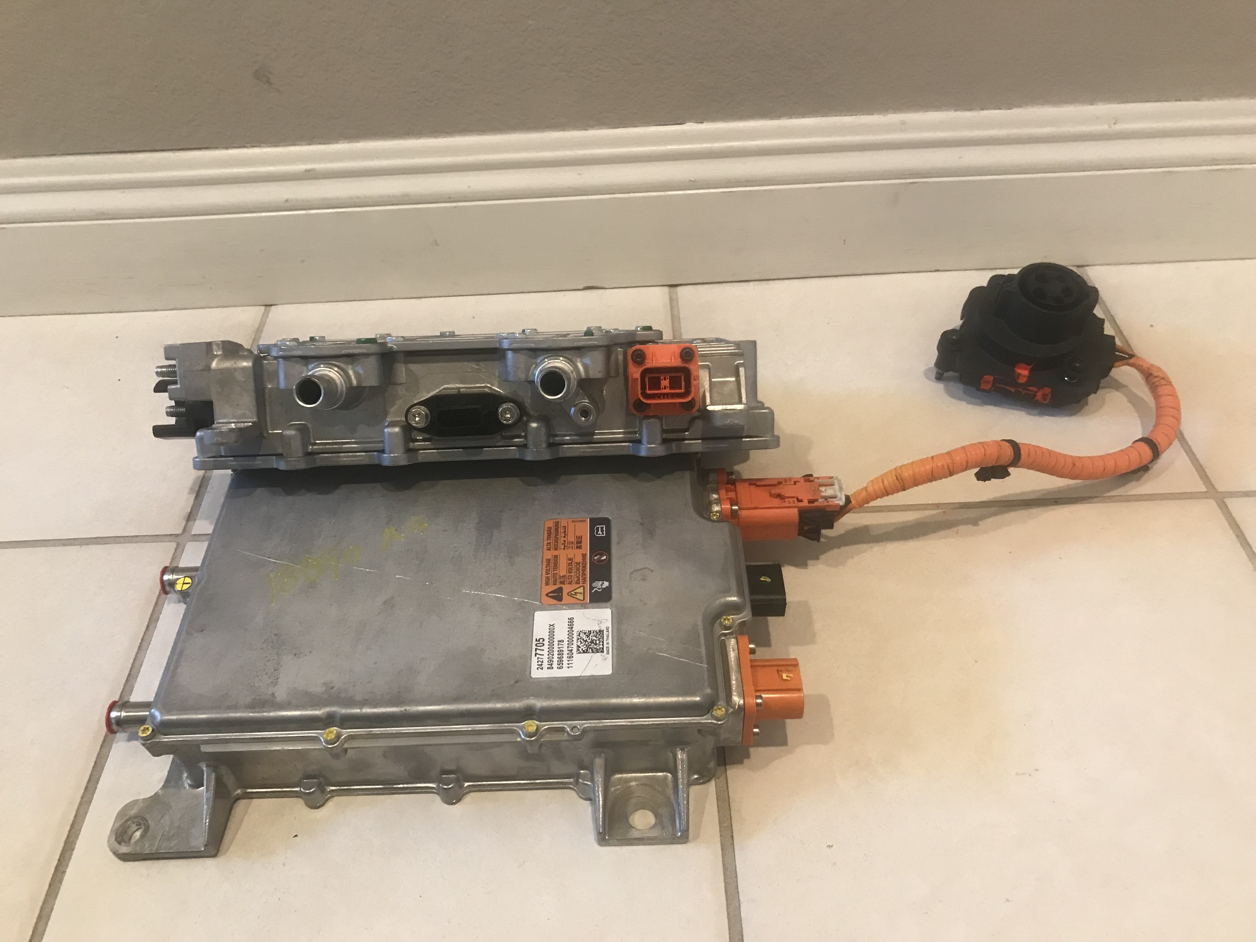

just got my second gen Charger/Converter set on eBay, sharing the Converter listing (items were purchased separately) to show folks what they go for as of the current date, brace yourselves for death by a 1,000 questions, ha ha, I know nothing about these things, and I'm prepared to share all I know
Part Number: 24284603
Supersession(s): 24274770; 24280796; 24290992
https://www.gmpartsmog.com/p/70072595/24284603.html
unlike it's charger counter part, the converter sports a single orange unicorn

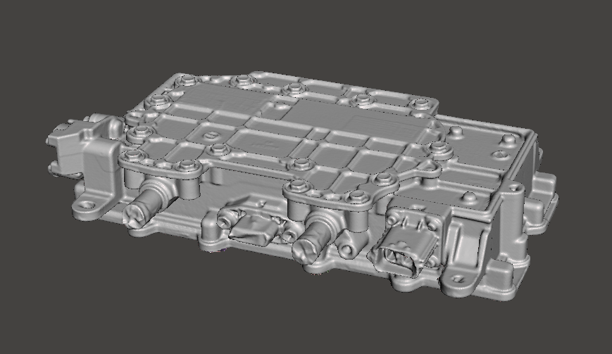

Had time to scan this unit in 3D
Uploaded to GrabCAD:
https://grabcad.com/library/chevy-volt- ... c-module-1
