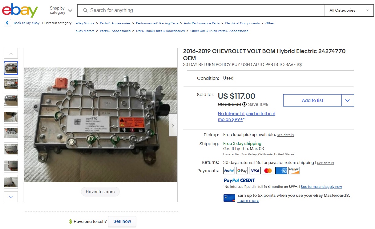

Posted: Sun Feb 27, 2022 3:50 pm
by Gregski
just got my second gen Charger/Converter set on eBay, sharing the Converter listing (items were purchased separately) to show folks what they go for as of the current date, brace yourselves for death by a 1,000 questions, ha ha, I know nothing about these things, and I'm prepared to share all I know
Part Number: 24284603
Supersession(s):
24274770; 24280796; 24290992
https://www.gmpartsmog.com/p/70072595/24284603.html
unlike it's charger counter part, the converter sports a single orange unicorn
