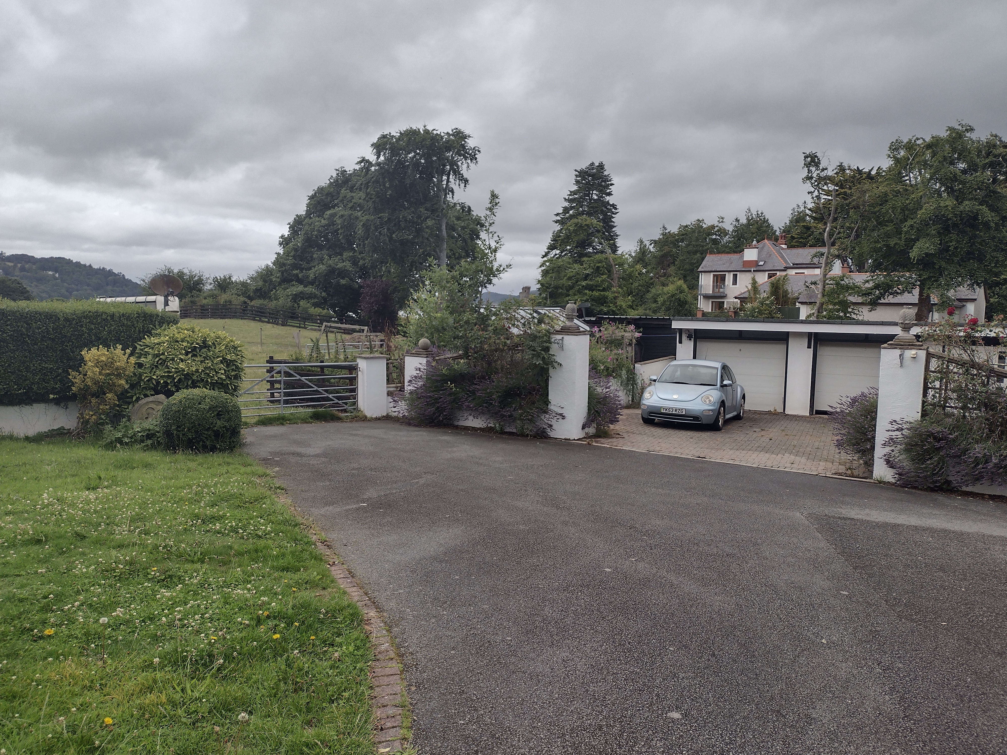

We're on a trip to Wales
Took 2 charge stops to get here, probably could've done just 1, but went with 2 to play it safe.

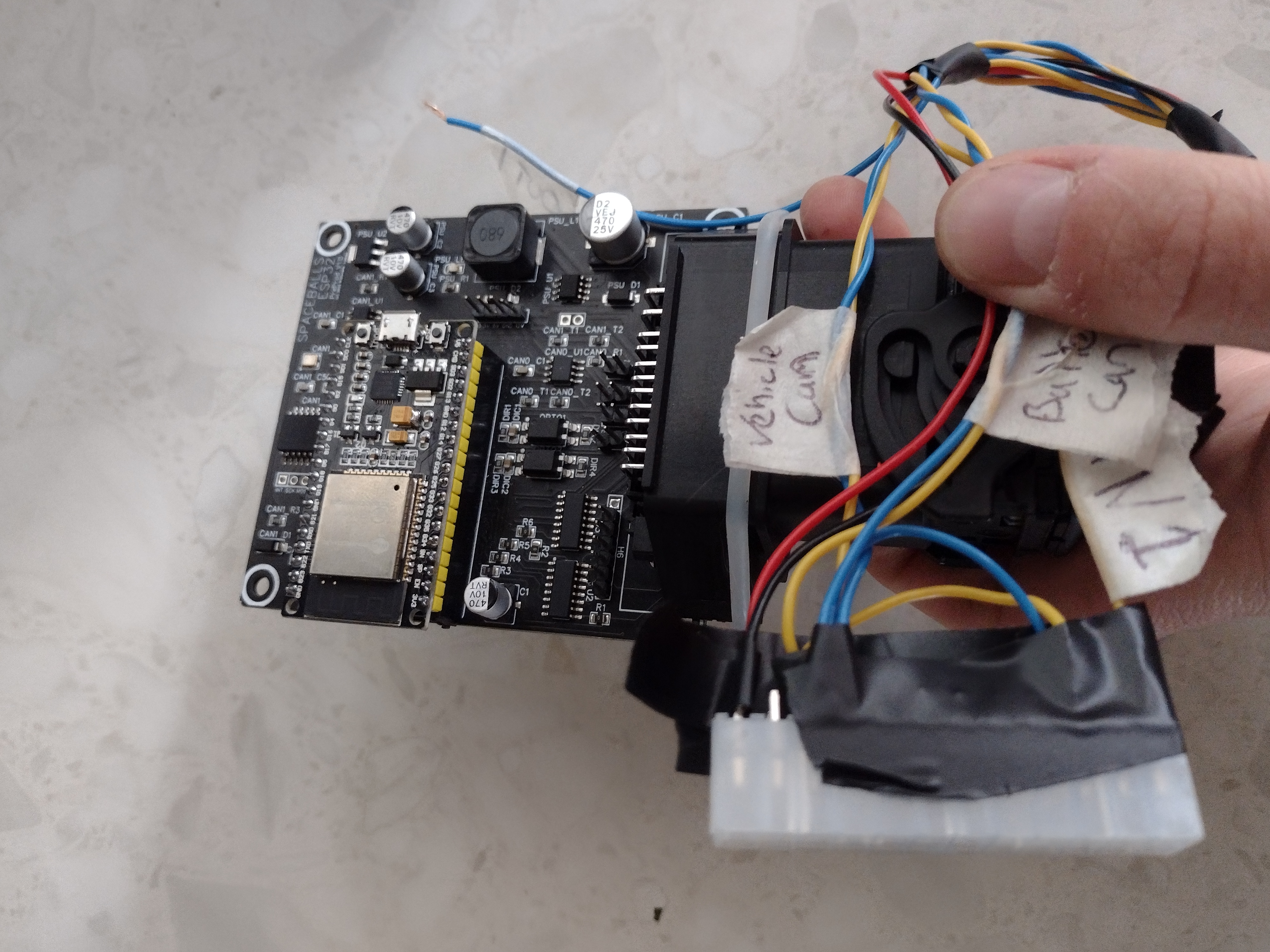

Recently replaced the Teensy based BMS with ESP32 and that seems to be working great.
I made an intermediary connection so I could swap between Teensy and ESP32, but now happy enough to commit and remove the white Molex connector
Car also passed MOT today, 1 advisory that a numberplate bulb is out.

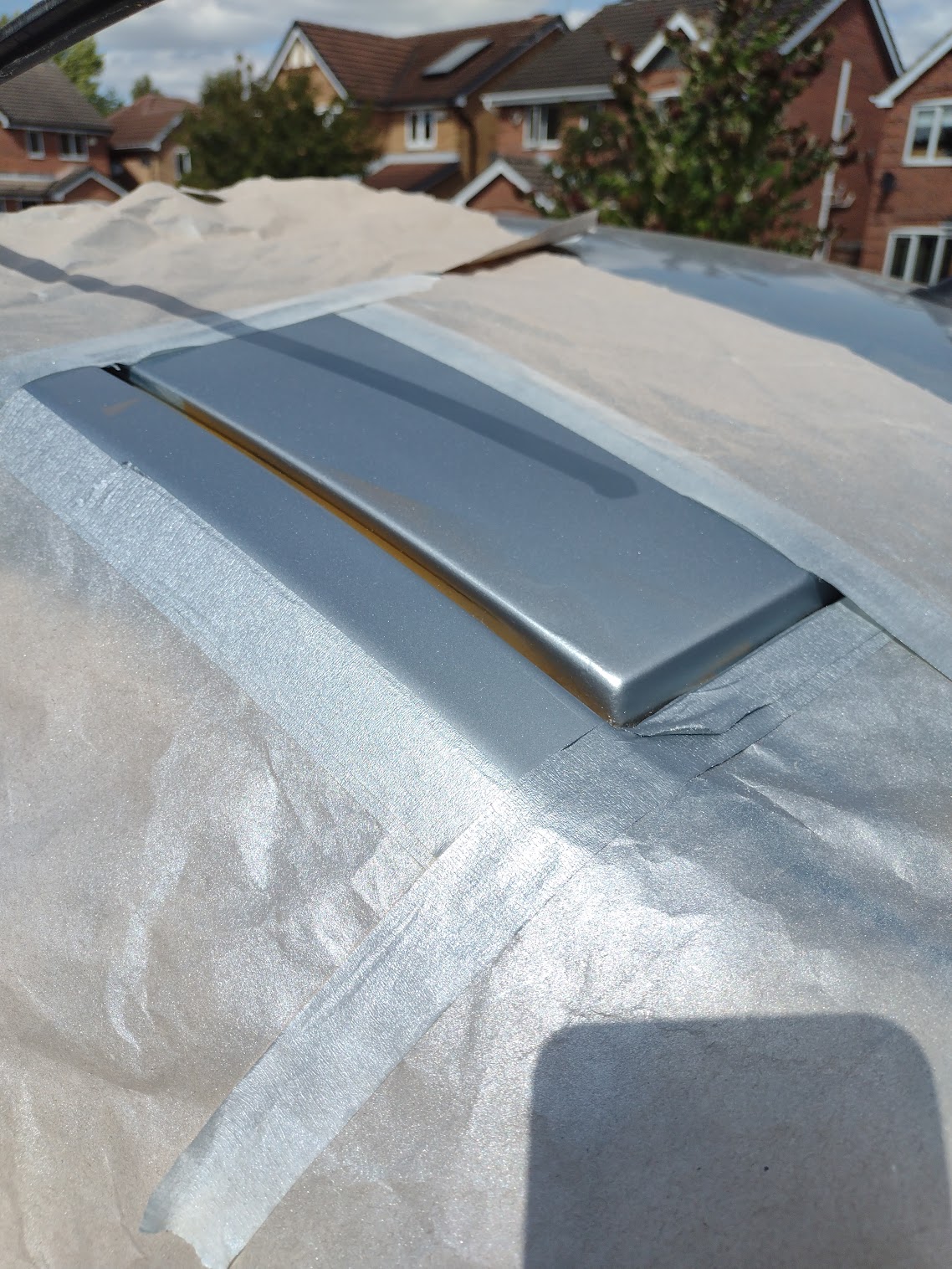

Also started working on trying to address this rust patch Not perfect, but I guess it'll do. Hopefully wont look too bad with a bit more faffing and some clear coat.

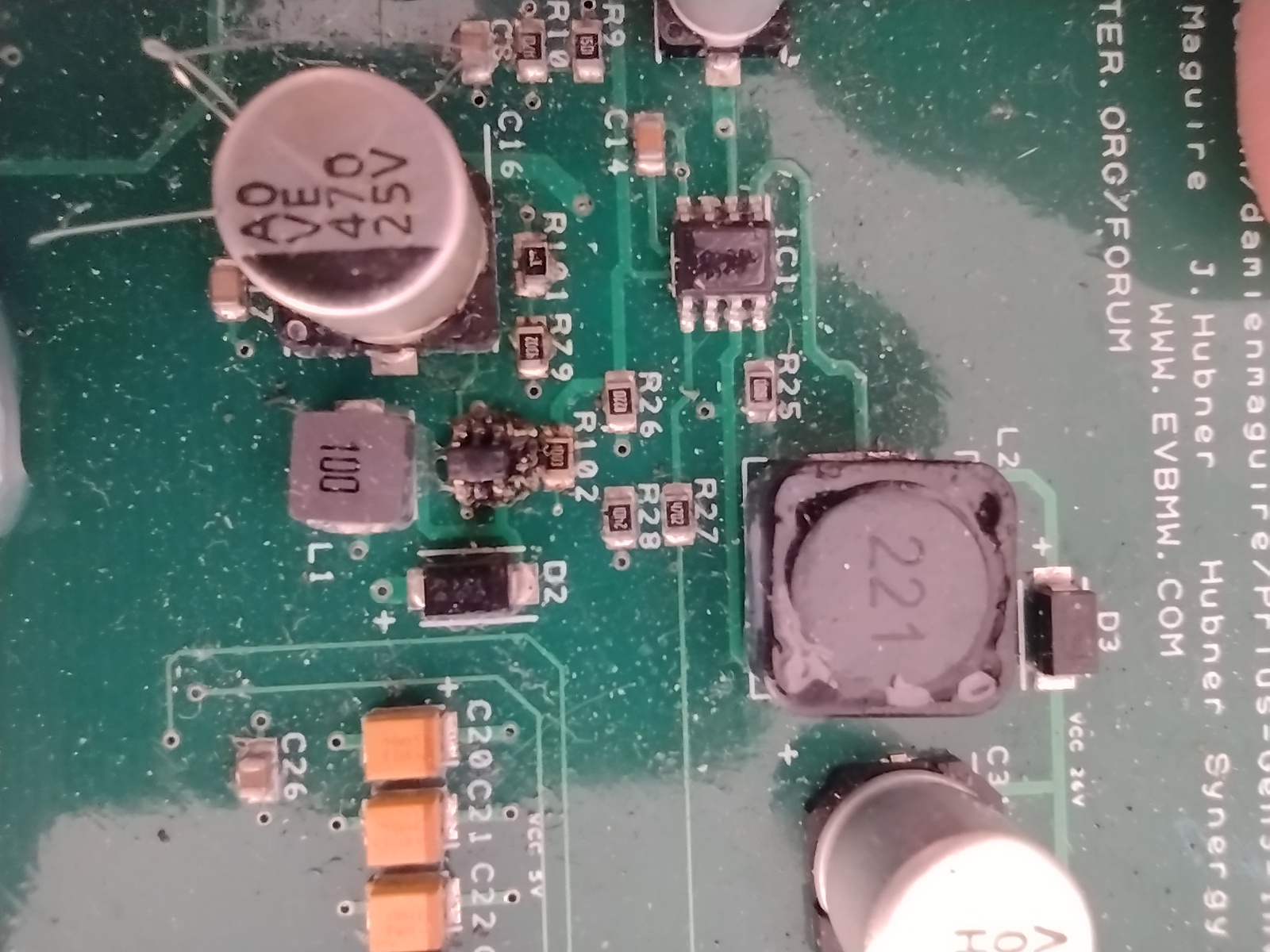

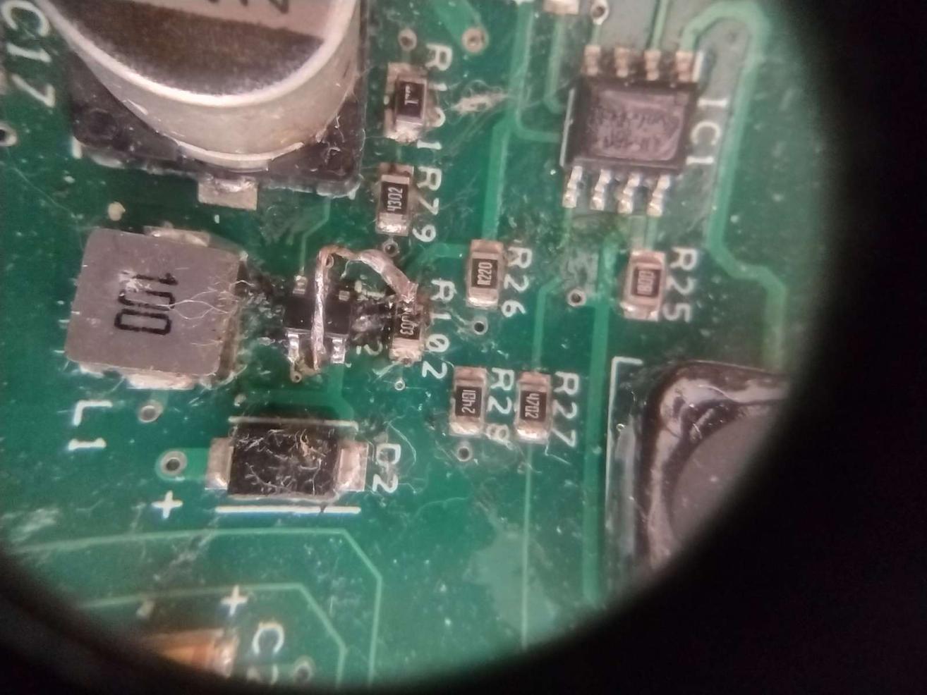

And I'm out of action. I've killed the 5v supply on my board. I've got a little buck module on the 5v rail for the wifi module that's external. Connecting a new esp8266 in reverse polarity was a little stupid.
Hopefully that's all that's dead on the board.

Re: [DRIVING] VW Beetle 2003
Hoping all it needs is that chip replacing, though it's left a little hole in the top layer so might cheat a little and place it elsewhere an run jumpers

OOOPS!Bigpie wrote: ↑Thu Sep 07, 2023 4:32 pm And I'm out of action. I've killed the 5v supply on my board. I've got a little buck module on the 5v rail for the wifi module that's external. Connecting a new esp8266 in reverse polarity was a little stupid.
Hopefully an easy fix, can you test the other components in situ?
- Posts: 1884
- Has thanked: 91 times
- Been thanked: 517 times
That sounds like a lot of work
I've applied 5v and the 3.3v rail powers up, the STM32 is working fine. The -5v comes to life too.Alibro wrote: Hopefully an easy fix, can you test the other components in situ?
Ive applied 12v and the 26v comes to life. So as much as I can at the moment, it seems ok.
New IC on and a jumper wire to replace the blown away trace and everything appears to be ok. Now to reassemble after a couple of coats of conformal coating.
It wasn't that easy. All day faffing and swearing but now replaced the -5v ic twice and now we're rolling again. Thankfully Rob has posted me some junk Prius boards

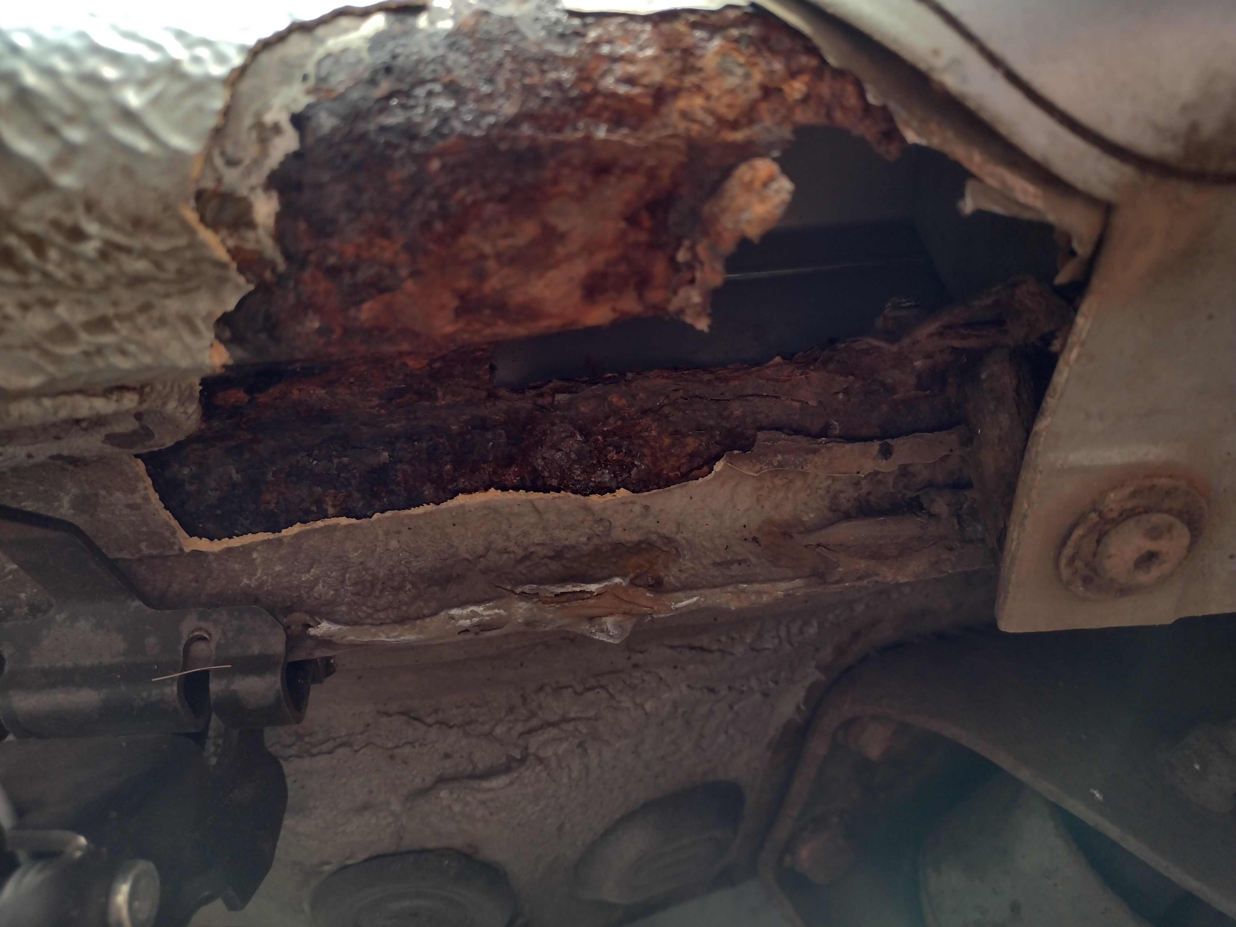

Erm, new problem. Some of my car has gone.
I've got a date with a welder.

I really dislike welding sills but oh well, I'll get some practice for if I decide the electric convert the rust bucket RAV4.

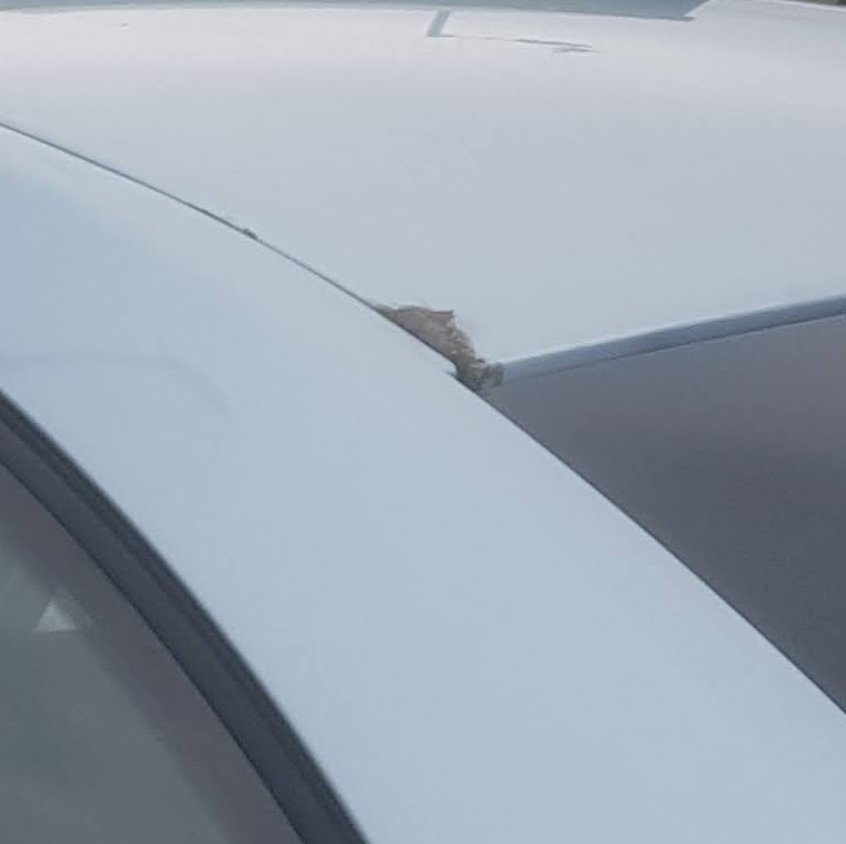

Same goes for my Mazda. I managed to just weld sheet metal under the rear wheel well. And i covered it with paint and construction hydro sealant paint Ibitol.
But now i see something rotting at the seams where you lift the car at front wheel wells. I will have to find a real metal former to get this sorted.
