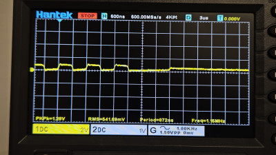

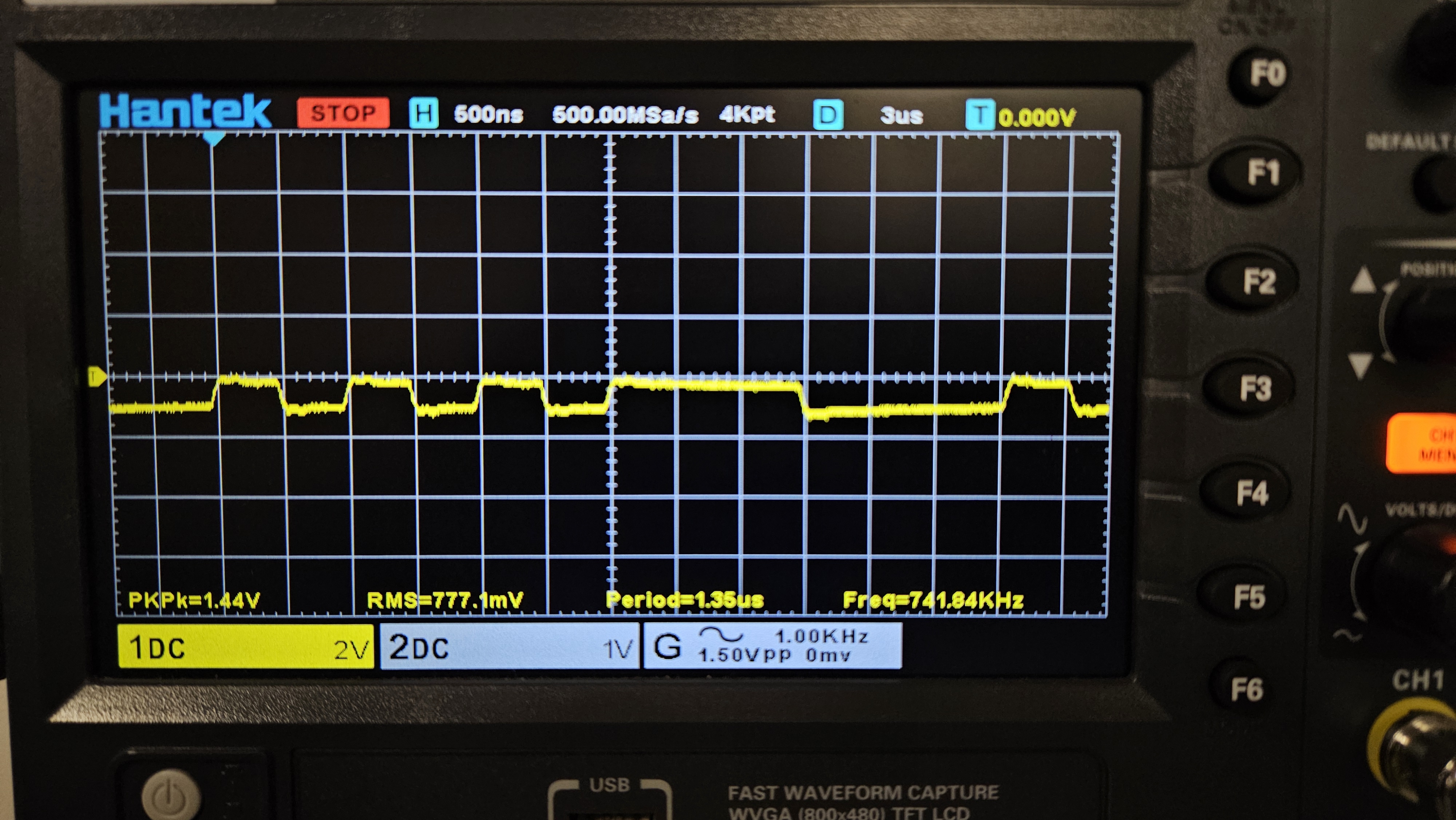

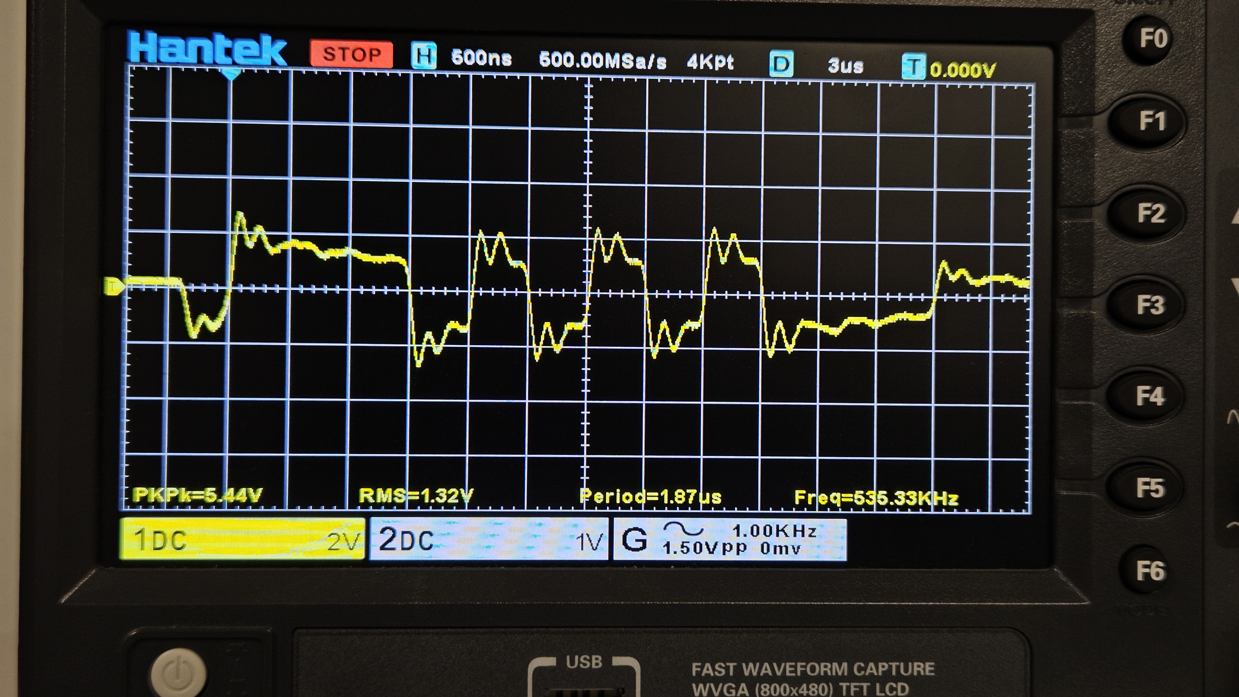

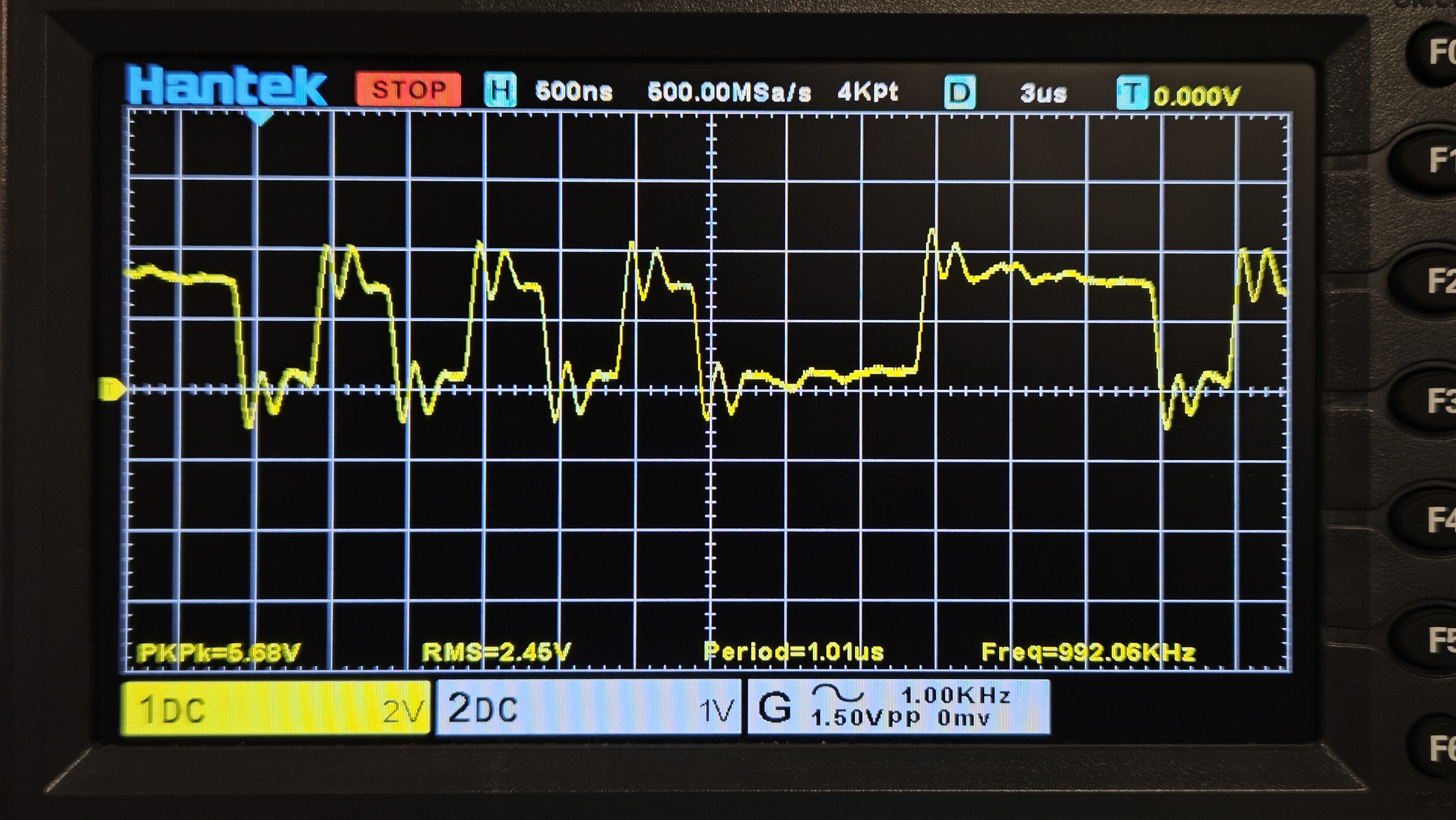

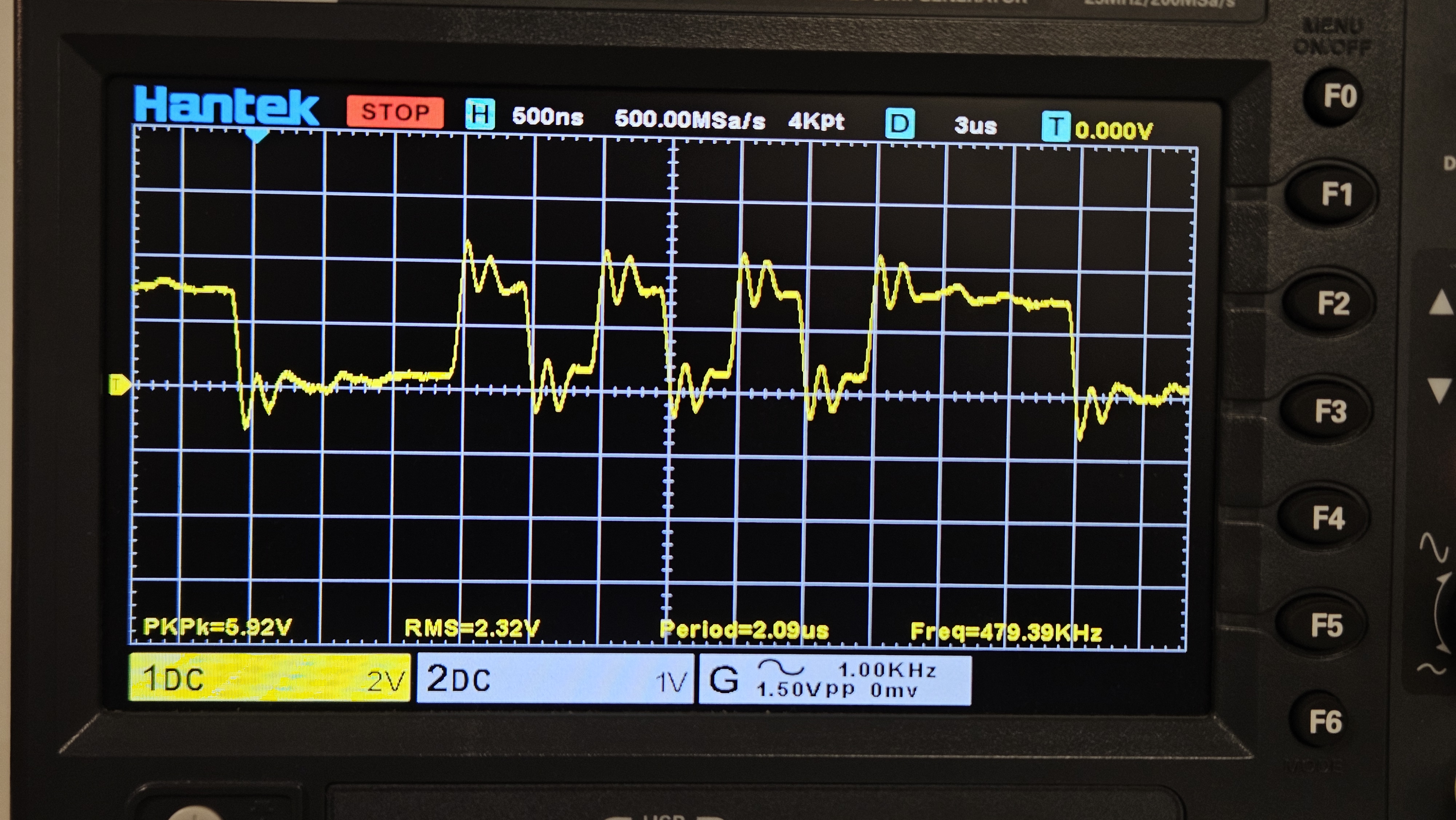

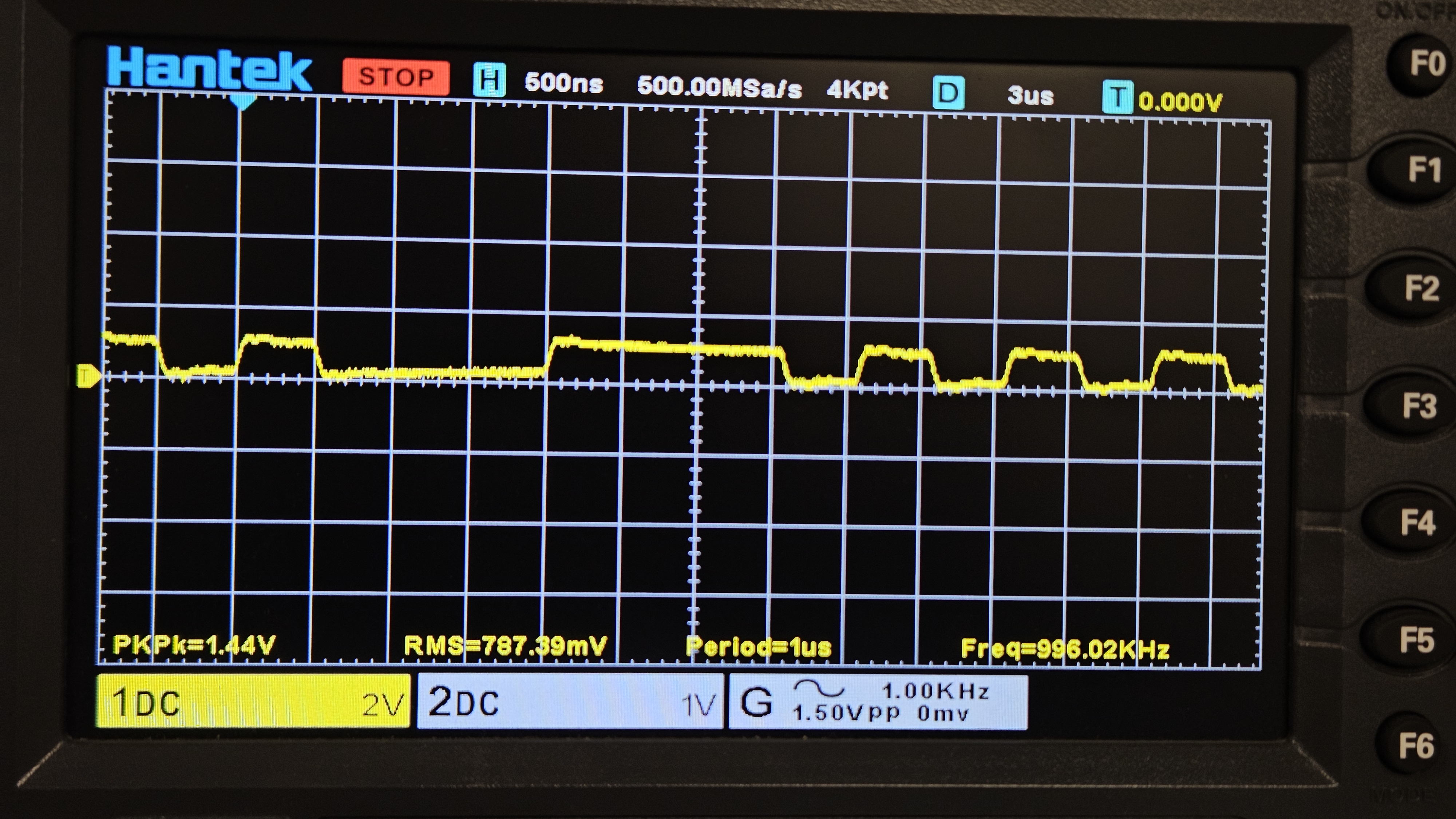

Do these signals look right?
TXP before transformer
TXP after transformer
TXN before transformer
TXN after transformer
bexander
Posts: 897
Location: Gothenburg, Sweden
Has thanked: 78 times
Been thanked: 102 times
Re: Kia Niro BMS
Post by bexander »
They don't look bad to me.
How does the RX singals look before and after the transformer?

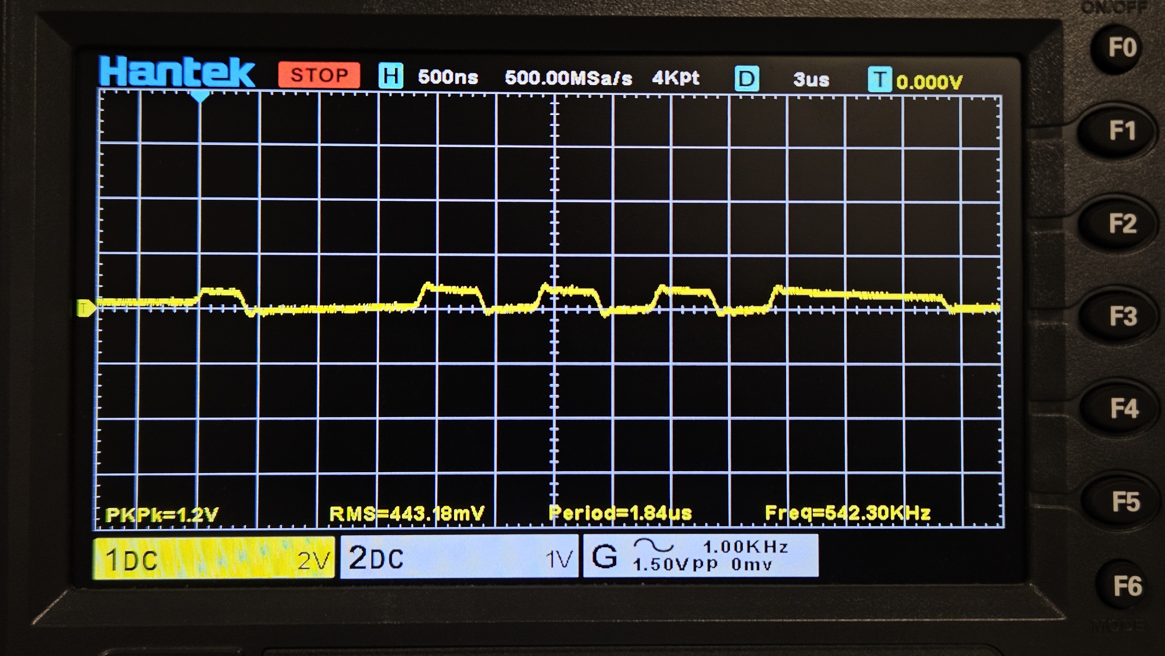

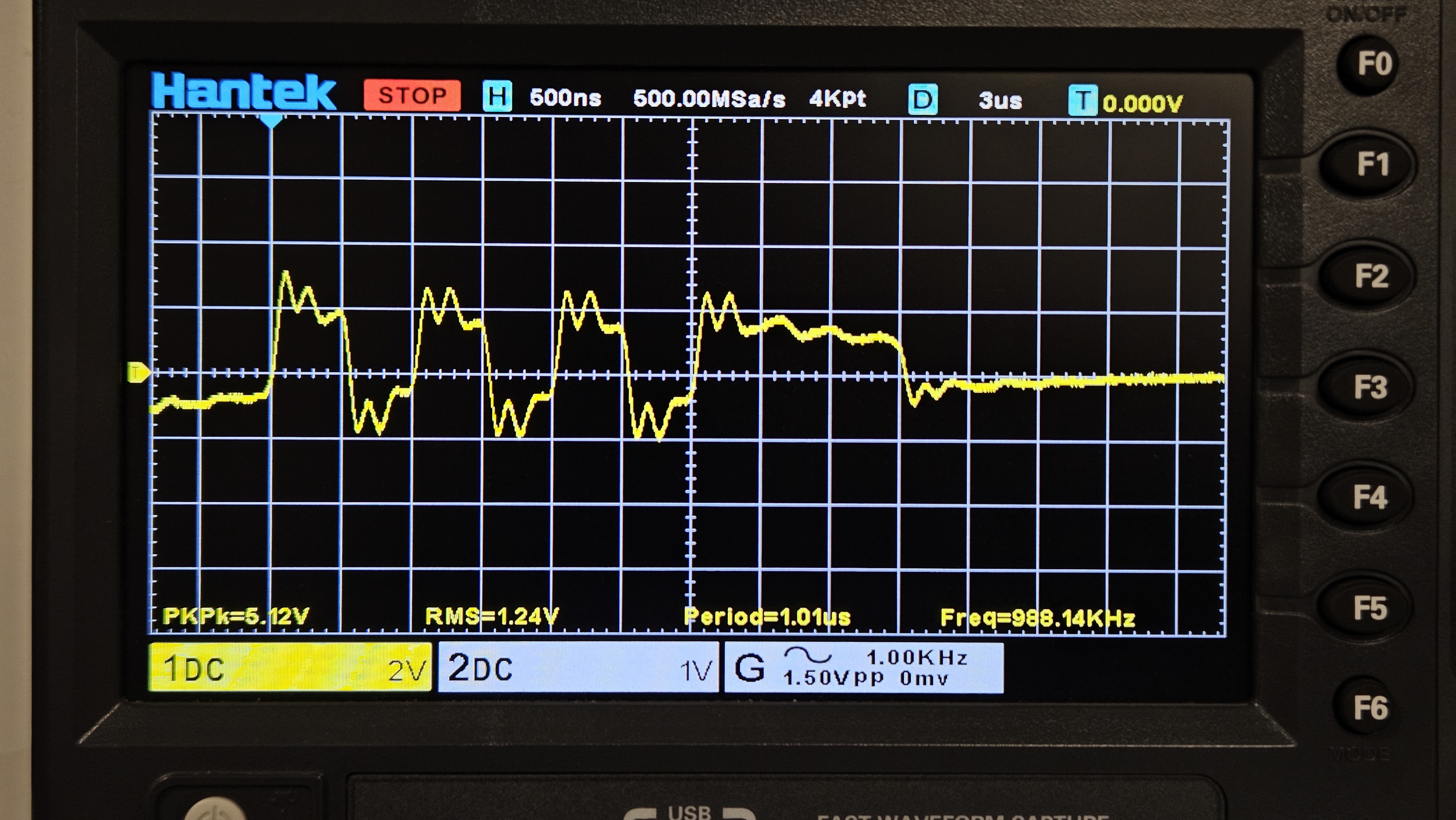

RXP before transformer
RXP after transformer
RXN before transformer
RXN after transformer
With the BMS_test_OI_modified2.ino code from bexander
EDIT: Could someone scope their signals? Then I know what the signals have to look like. Did grab another module, but still no data coming out of them

bexander
Posts: 897
Re: Kia Niro BMS
Post by bexander »
The RX signals look very similar in amplitude to the TX signals, and that is a very good thing. Your signals seem ok at this stage.
In the last serial print out the last byte is 0xD3 which is very odd as it start at 0x00 and in incremented one step for each slave it passes on its way up the daisy-chain with no increments on its way down the chain. This should in your case end up with 0x01. 0xD3 equals 211 and that seem impossible to me? What happends if you connect all slave modules to thw wiring? If you can do this what is the serial output?
