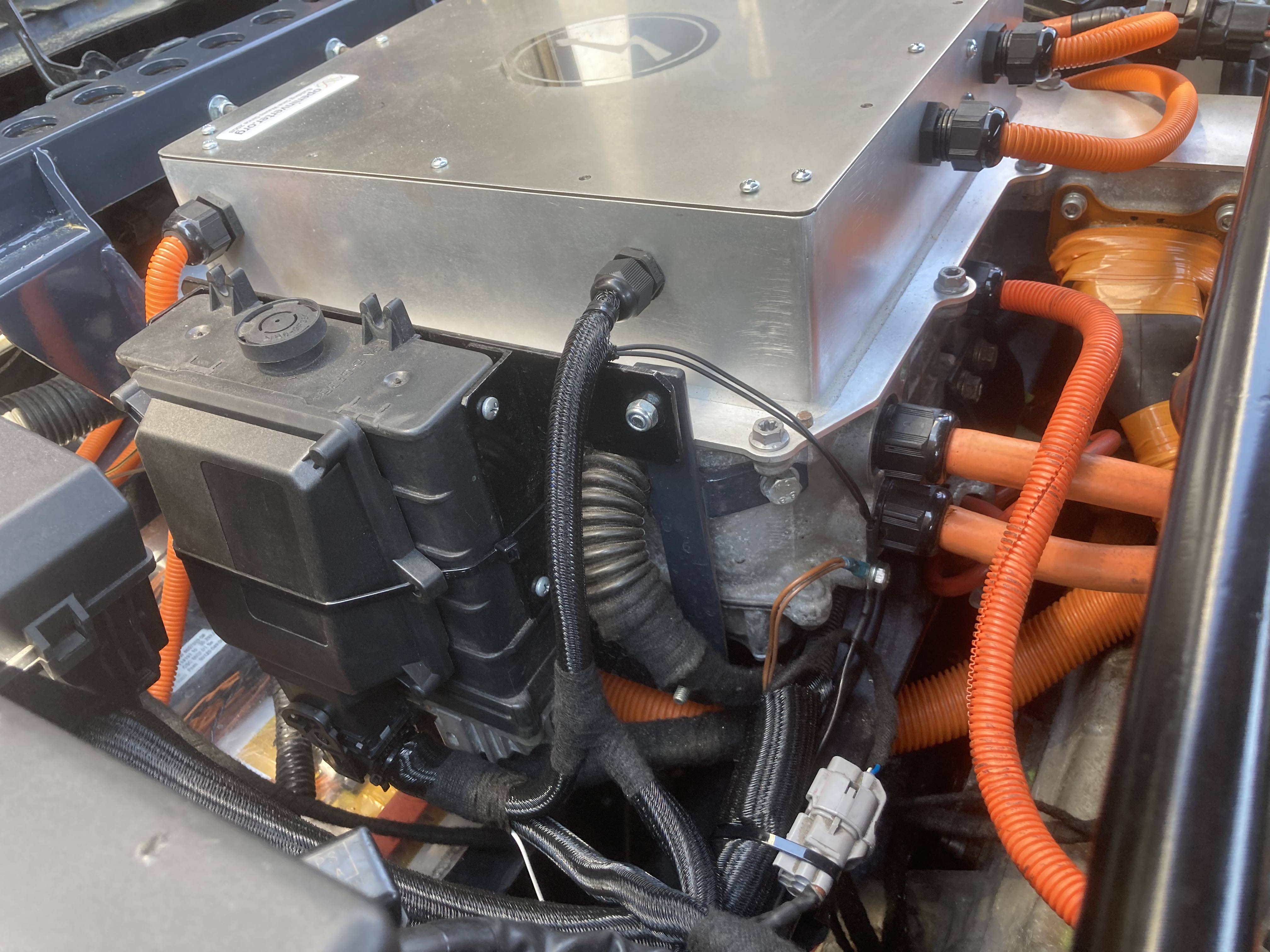

Well today I found time to wash the car and button up Jamie’s esp32 chademo, soc is now taken care of by the bms, it required a bit of a re arrangement of the bms can wiring to make the bms one end of the network and the chademo the other, with cab500, Outland charger and battery modules in between, my prototype board simp bms now being one of the oldest parts of my conversion it’s been “adjusted” so many times it’s now a right mess and amazing it still works! I forgot to take a photo, I will replace it one day with something more permanent!
The esp chademo board itself is in a nice housing and zip tied to the inverter controllers, I will get out one evening this week and do a quick vid of it charging

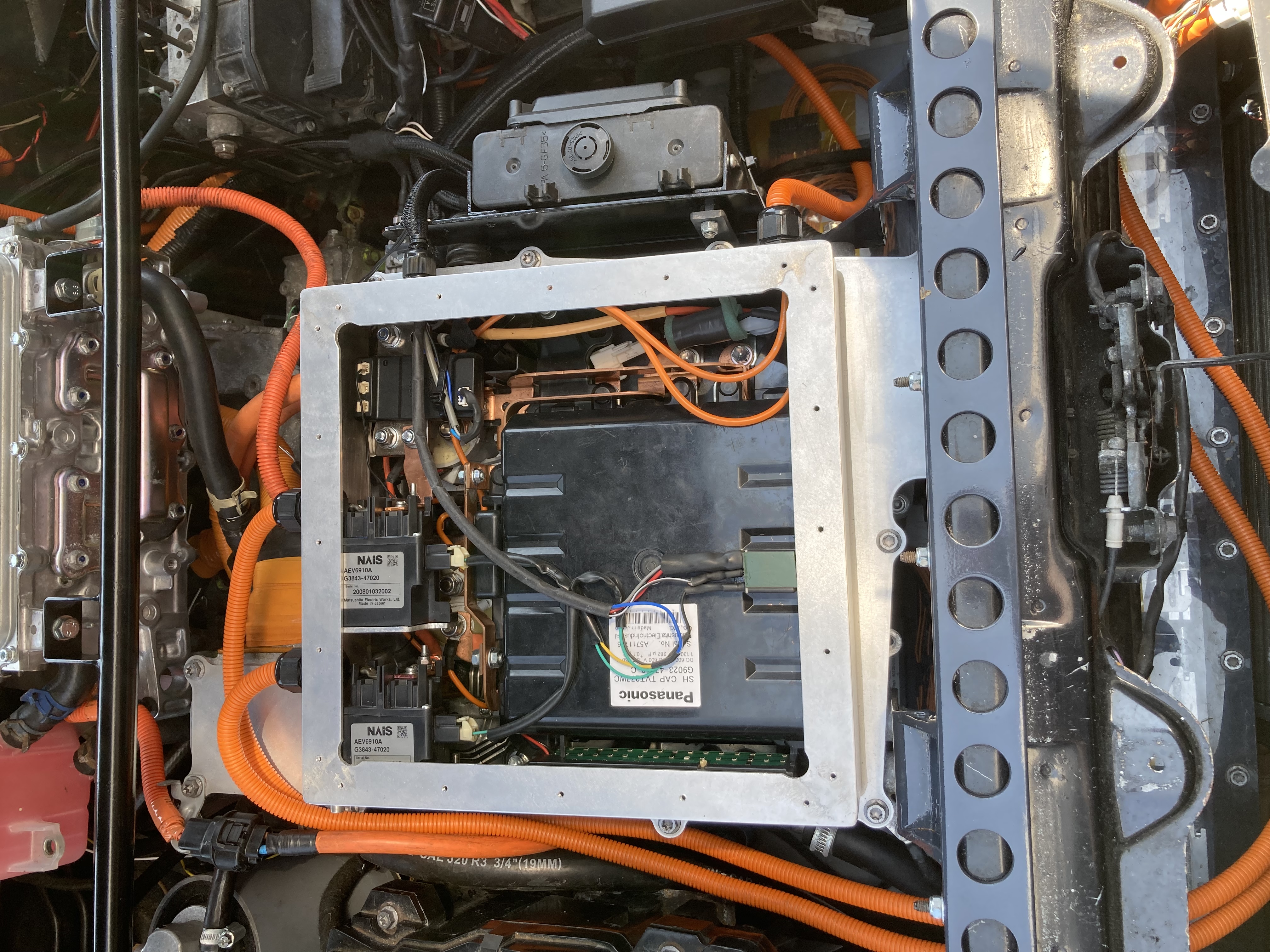

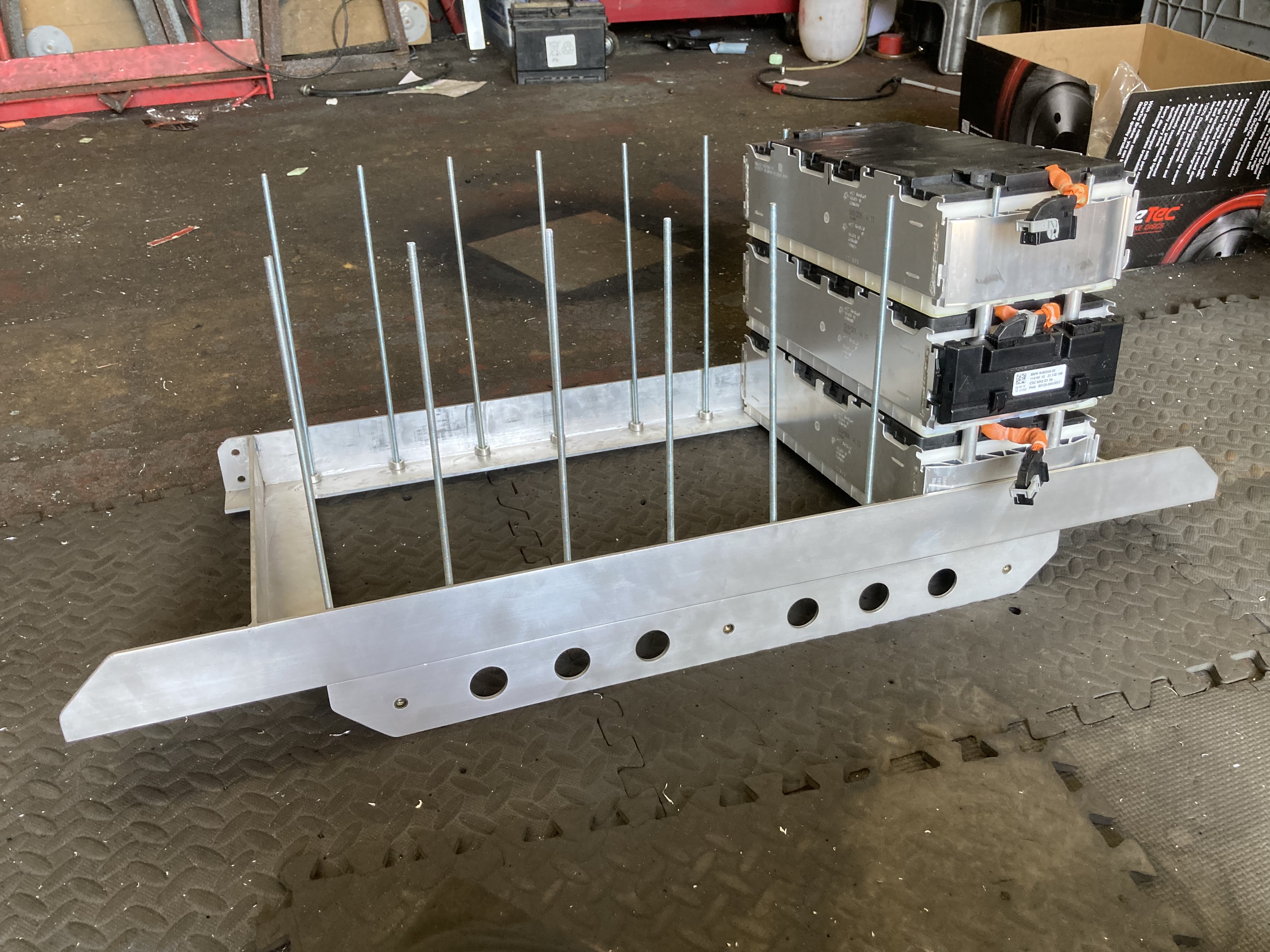

Mk2 rear battery frame and additional 3 modules ready to fit in the next few weeks. I made this one from aluminium angle and have doubled up where it spans the well in the boot floor

That's fancy :D
Ev8
Posts: 818
Has thanked: 43 times
Been thanked: 163 times
Re: Project RX8 , Prius gen2, Lexus transaxle to rwd
Post by Ev8 »
Should do the trick!

I'm amazed how much you can fit in the boot. Really nice design. Cutting the boot floor out of mine seems like something of a mistake now!

Yeah 12 modules is the limit of what I can fit in there! Would love to have used the space where the fuel tank was but it didn’t look doable with these bmw modules, maybe with leaf modules

Ev8 wrote: Wed Jun 07, 2023 12:58 pm Mk2 rear battery frame and additional 3 modules ready to fit in the next few weeks. I made this one from aluminium angle and have doubled up where it spans the well in the boot floor
wow, did you make that or have it made? looks very sleek :)
Ev8
Posts: 818
Post by Ev8 »
I made it, it’s just angle aluminium stuck together with my spool gun on the mig welder and the welds ground smooth so you can’t see how ugly they were!

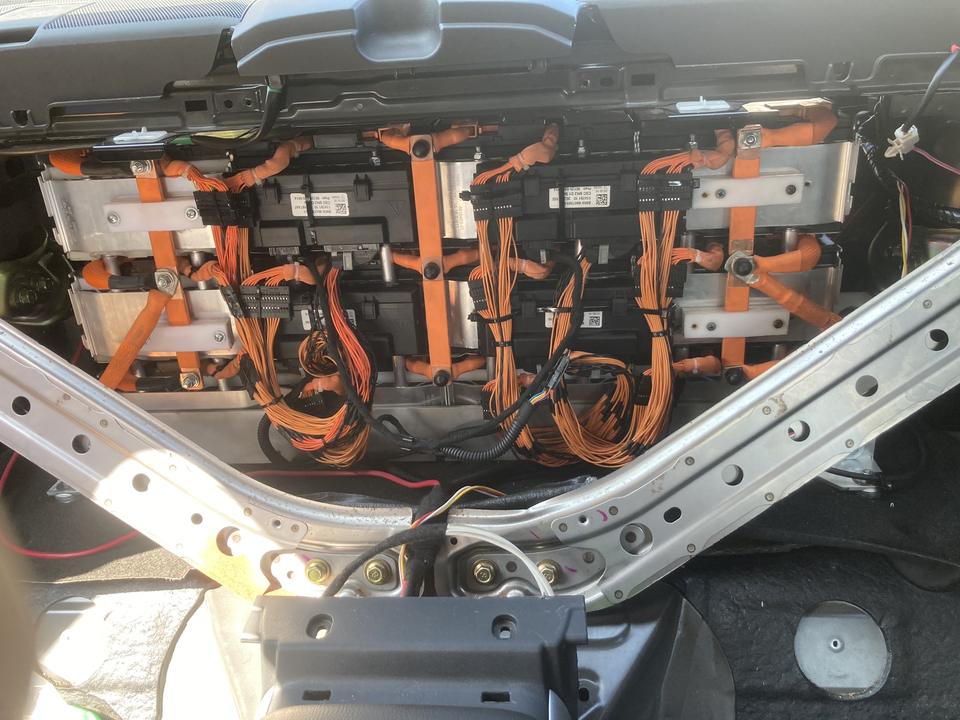

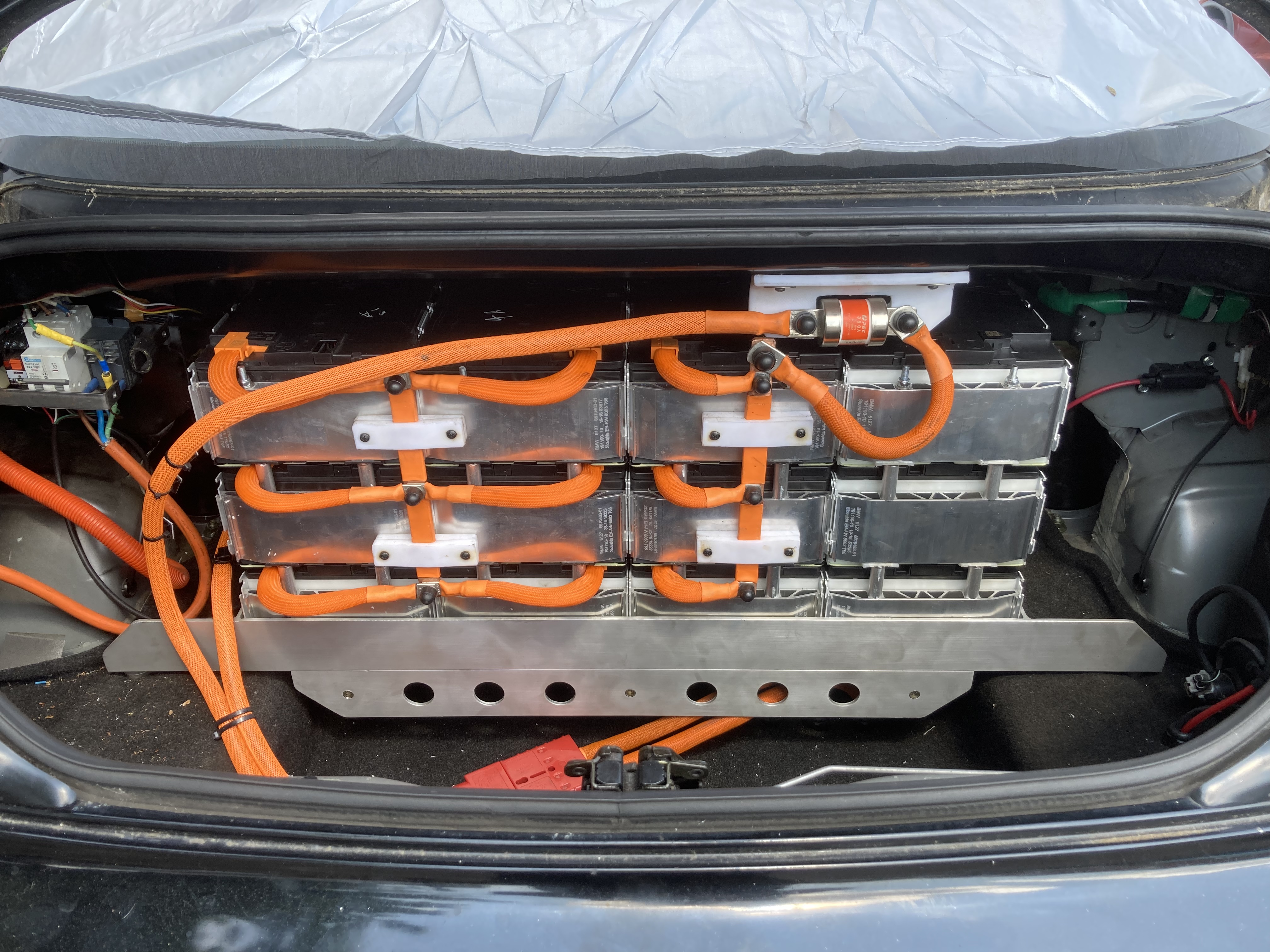

Well I have some hours free after work yesterday so I pulled all the rear battery modules out, swapped the mounting frames and loaded all the modules back in, currently only the original 9 are hooked up as I needed to drive home and I still haven’t fabricated and bus bars or cables to include the extra 3. I ache today as loading the battery frame has to be done with it pulled as far backwards into the boot opening as possible and then once loaded the whole 12 modules have to be shifted forwards as one!
Please excuse the wiring it’s not the final version!
Ev8
Posts: 818
Post by Ev8 »
Hooked up the extra modules over the weekend, having previously changed the 5s modules up to the same voltage as the new ones, once hooked up I charged everything as one and there was a 23mv delta at 4.1v so I let the car sit and balance for the rest of weekend got into work this morning and was greates by 4mv delta.
I also uploaded 5.27 and had a little test drive, it’s made a nice little improvement, not huge but I can now draw 120kw
Picture of the business side of the rear pack, I’m currently designing some pcb’s with fuse links and a connector each end to go between the cell tap wiring and the module cell taps as currently there is no failure protection and 342 cell tap wires!

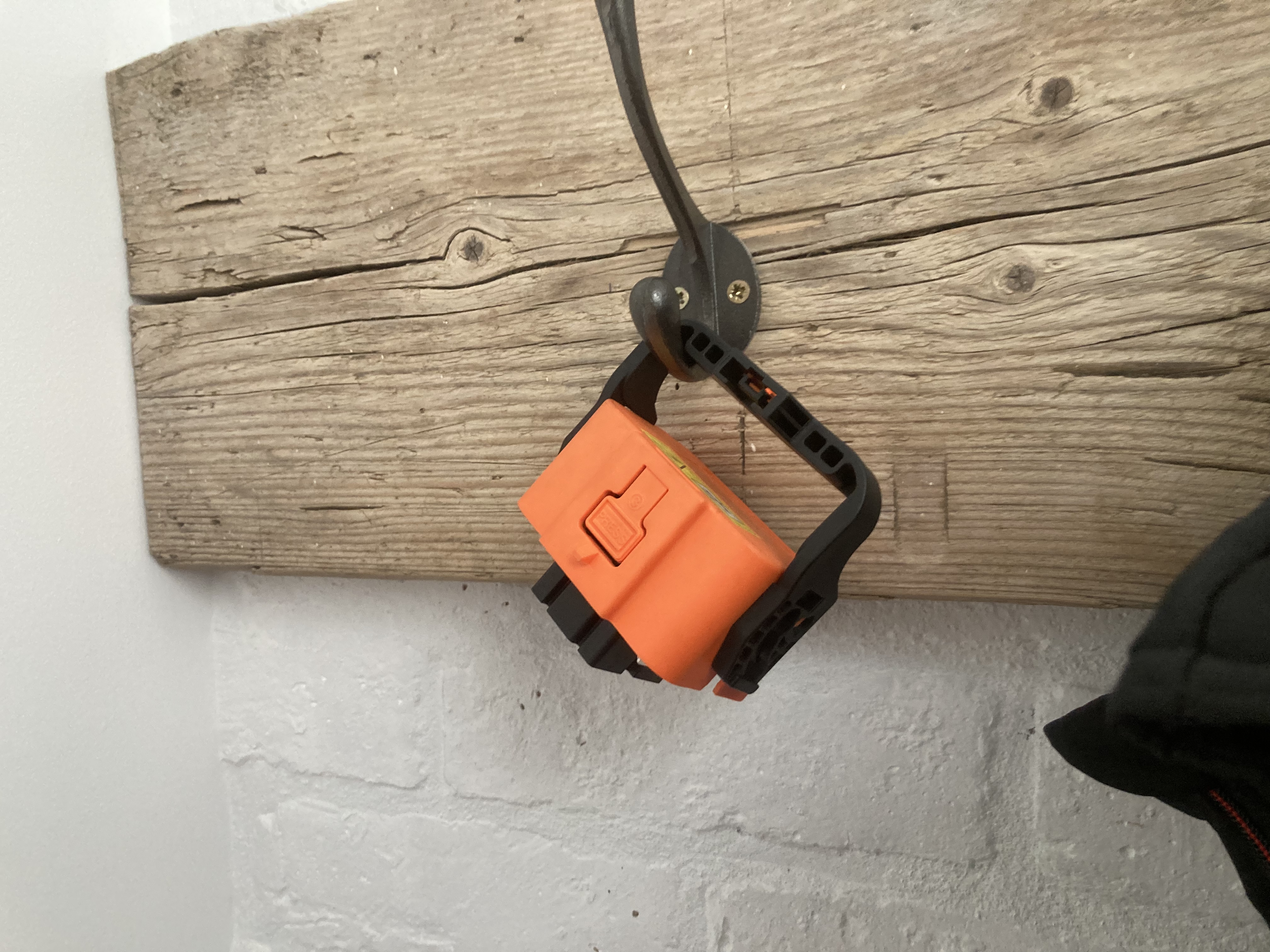

Gone away for a long weekend, car is at home, hv disconnect hung up inside! #ultimate immobiliser

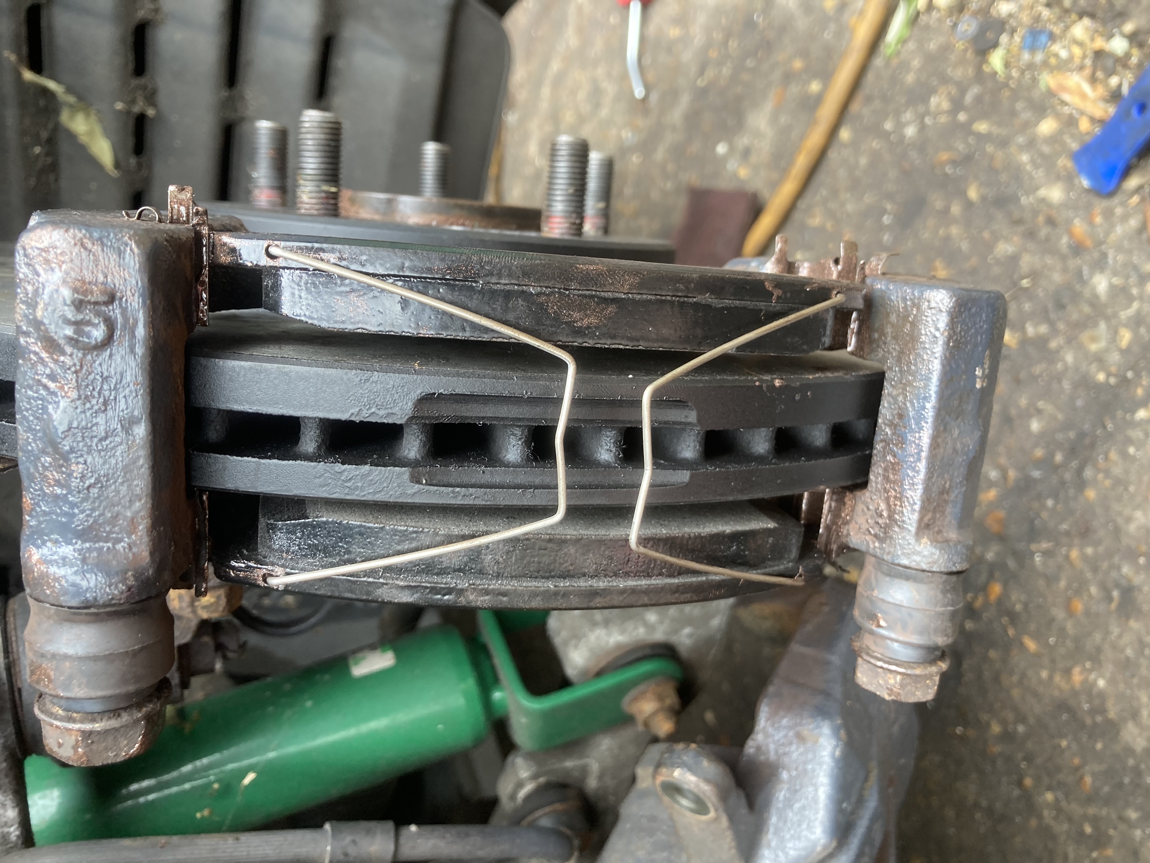

I can’t imagine it’ll help with efficiency any but I changed disc and pads today and added these springs that seem to be appearing on lots of modern cars
Ev8
Posts: 818
Post by Ev8 »
Report on the springs… I no longer hear the pads dragging at low speeds which is nice

Ev8 wrote: Tue Jun 27, 2023 8:41 pm Report on the springs… I no longer hear the pads dragging at low speeds which is nice
Are the springs for an RX-8 or are them from another car or home made?
Ev8
Posts: 818
Post by Ev8 »
The springs come as part of delphi fitting kit LX0712 intended for the Hyundai i30 and Kia Ceed, I just drilled some appropriate holes into the pad back plate to slot them into
