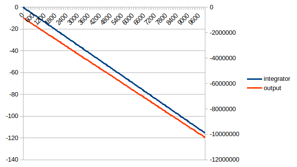

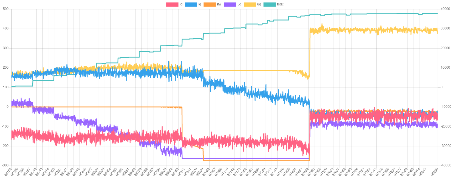

Now, I did some "simulation" of the FW controller myself
int main()
	PiController c;
	c.SetGains(10,100);
	c.SetCallingFrequency(8800);
	c.SetMinMaxY(-FP_FROMINT(200), 0);
	c.SetRef(33000);
	printf("Cycles,integrator,output\n");
	for (int i = 0; i < 10000; i++)
		float y = FP_TOFLOAT(c.Run(34000));
		if (i % 100 == 0)
			printf("%d,%d,%f\n", i, c.GetIntegrator(), y);
	return 0;
And the astonishing result: after 10000 cycles or more than 1s only -120A FW current has built up and it's just about 160 mA per 100 cycles at a 1000 amplitude error. Must have missed some scaling in my previous calculation. Executing code never lies.
ki=1000 reaches -200A after 1800 cycles or like 0.2s
Been thanked: 1918 times
I have also modified anti windup once again:
void PiController::SetIntegralGain(int ki)
   this->ki = ki;
   if (ki != 0)
      minSum = FP_FROMINT((minY * frequency) / ABS(ki));
      maxSum = FP_FROMINT((maxY * frequency) / ABS(ki));
The function is also called when modifying calling frequency and output saturation values.
The actual controller then does
int32_t PiController::Run(s32fp curVal)
   s32fp err = refVal - curVal;
   esum += err;
   //anti windup
   esum = MIN(esum, maxSum);
   esum = MAX(esum, minSum);
   int32_t y = FP_TOINT(err * kp + (esum / frequency) * ki);
   int32_t ylim = MAX(y, minY);
   ylim = MIN(ylim, maxY);
   return ylim;
Objections?

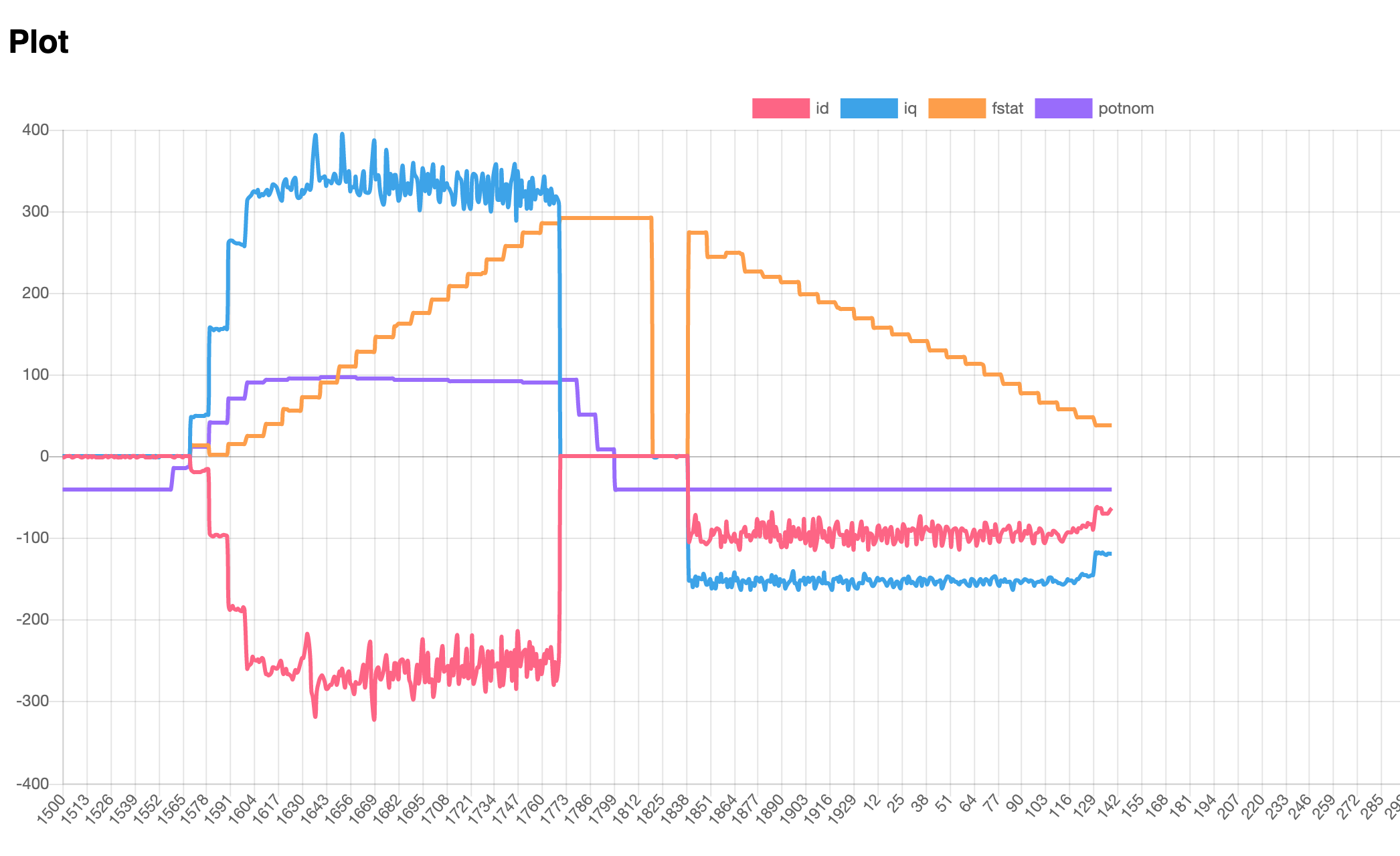

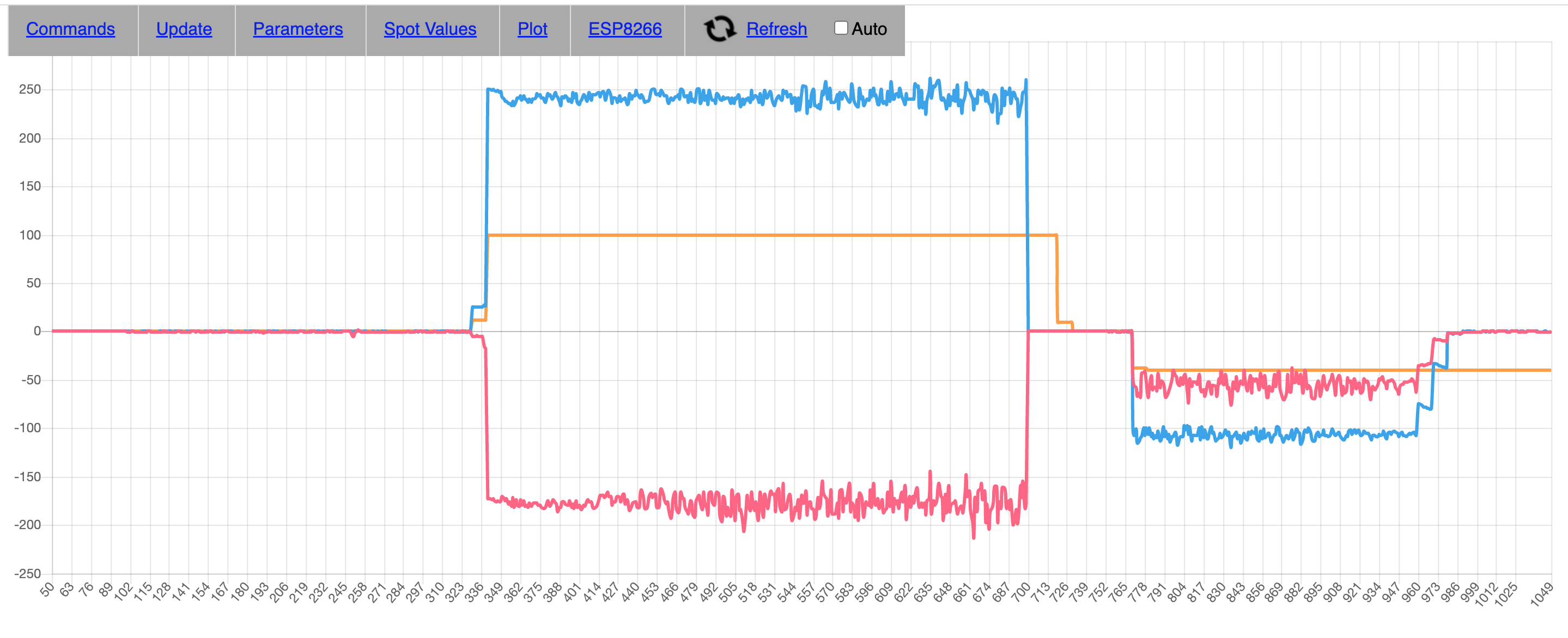

Been out testing more. Lots of cutouts :D
Changed throtramp to 5 and throcur to 3 (cuts out)
Throtcur at 2.5 (cuts out)
Throtcur at 2 (cuts out)
Throtcur 4.5 accelerated really well but also cuts out.
I think the low throtcur values didn't really apply as total current is way higher than 200 or 250A, respectively.

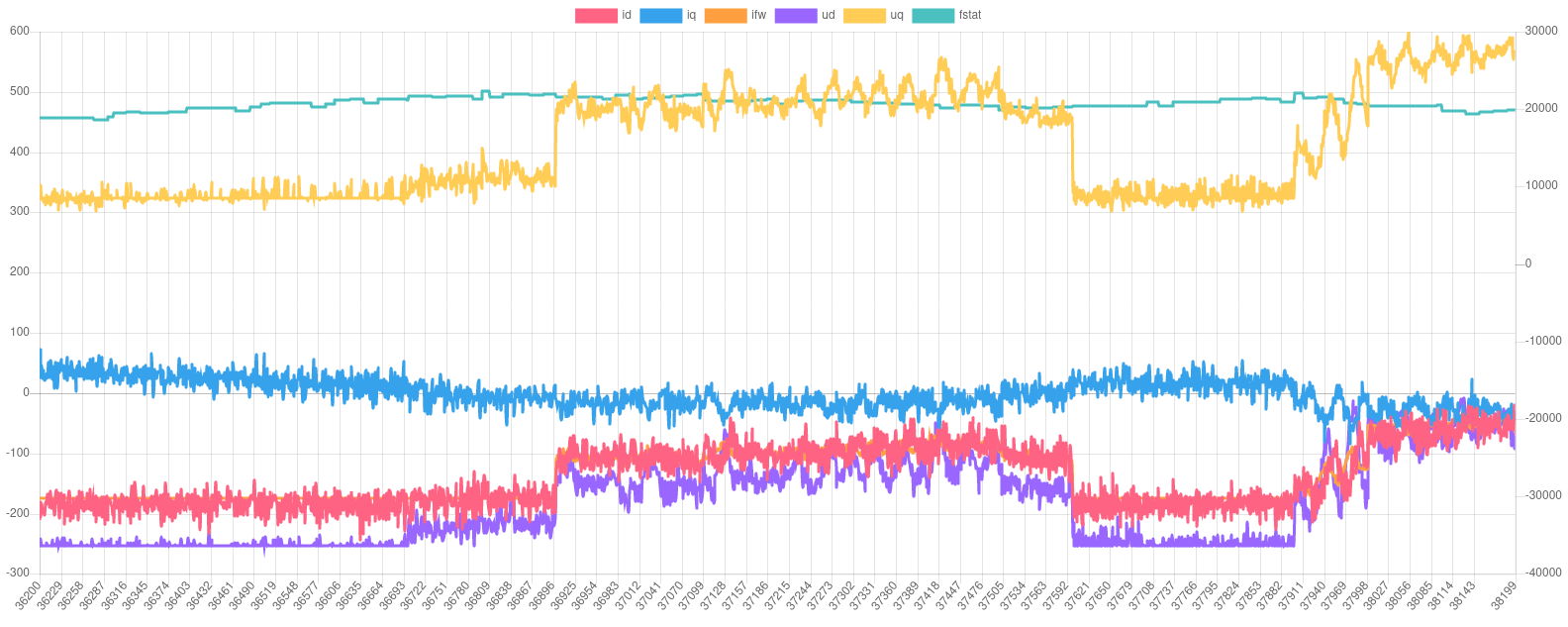

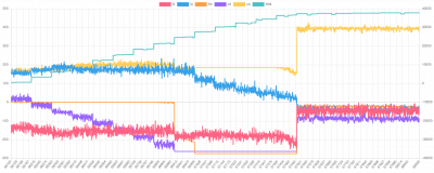

I've also been out for a run and I think I've pretty much nailed it.
Only software change as been the anti-windup scheme from above, everything else untouched.

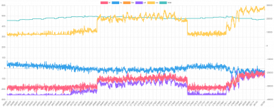

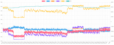

I increased fwki to 500 and started with fwmargin 4000. It never saturates, no weirdness when coming off throttle and regen works as expected. Remaining weirdness was non-linear throttle response, so as soon as FW starts, the car accelerates more.
This next one was downhill. fwmargin 2700. I came off throttle but the car was merely coasting, no regen. Thus sped up past fmax, but by gravity, not electricity. Touched the brake pedal which increases regen and then regen came in nicely. What exactly limited it I'm not sure.
Final run, fwki=300 and fwmargin=2500. We see saturation again but throttle response is now linear. Regen comes in without issues at 7000 rpm.
EDIT: plots look a little different today as I took 100 sample bursts. All the jumps you see are artifacts
EDIT2: just realized I've been running without any syncadv all the time:
FP_MUL(frqFiltered, Param::GetInt(Param::syncadv))
will evaluate as 0 when it is set to 0.5. Alright, I'll just remove it, one mistake less to be make
EDIT3: liking this so much that I drafted a new release viewtopic.php?t=2650

Are your graphs with 100% throttle @johu? Your currents are much lower than mine
I've been forgetting to plot the q and d voltages
Bigpie wrote: Sat Sep 10, 2022 6:33 pm Are your graphs with 100% throttle @johu? Your currents are much lower than mine
No, I will take some when driving in 3rd gear

One word of warning: since we are now successfully putting throttle-independent current into the motor it is possible that the rev limiter no longer works in a no-load scenario. The slightest misalignment will create some small amount of torque which is not noticeable when attached to the weight of a car but could become very destructive on an unloaded rotor.
So do not rev up the motor beyond base speed when it is not loaded!

johu wrote: Sat Sep 10, 2022 4:42 pm EDIT3: liking this so much that I drafted a new release viewtopic.php?t=2650
Got to say I feel a bit awkward about this! I post saying I think there is a stability issue with the controller, you post saying it's all good and here is a new release. It's your code and your descision but it's not a way of working that I'm particularly comfortable with :?
At the risk of sounding like a broken record, please be careful. In your final plot both Iq and Id controllers look like they are maxed out for a lot of the run meaning that they are running open loop and not fully controlling the motor. It doesn't look like it caused any issues but it's not a good place to be above base frequency.

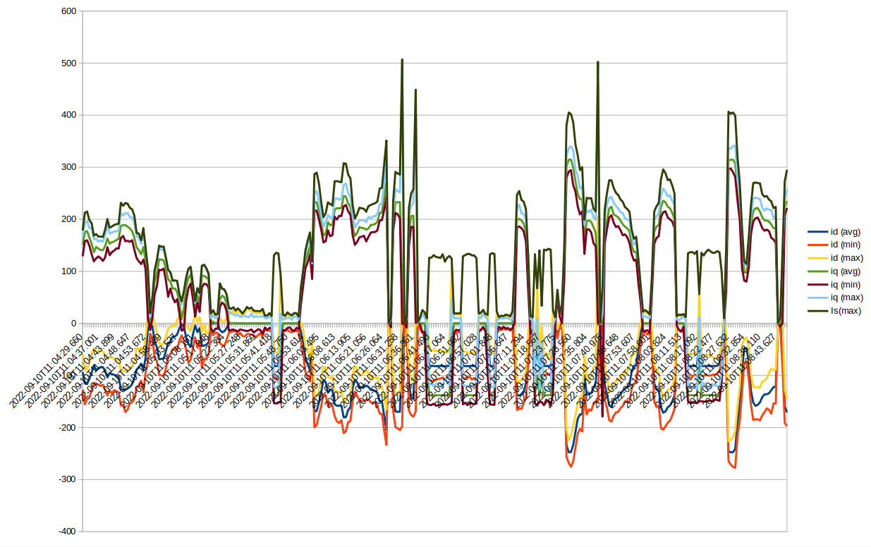

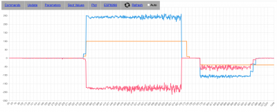

At 435 on the bottom axis looks to be where I had 3 coutouts in a row. The brown plot in the temperature from the inverter.
Had a look at this, pretty sure it's the desat. Although the individual currents aren't that high each point covers around 0.6sec, or around 5000 loops through the control loop so it's not telling the whole story. I've plotted it again including the min and max currents:
There is quite a big difference between the min and the max and it is pretty constant which suggest that there is a bit of oscillation in the controllers. Also plotted is the max combined current (Is) which is getting up to 500A at times (roughly the times where you have the trips) and I seem to remember Damien commenting that 500A is around the limit for the Gen3?. I realise that not all this current will be going through a single IGBT but a fair chunk will and the above is enough to convince me that desat is the issue.
It would be worth tweaking the ki and kp's a bit to see if you can reduce the difference between Imin and Imax.
Edit - Thinking about it a bit more it could also be noise in the system rather than stability issues?

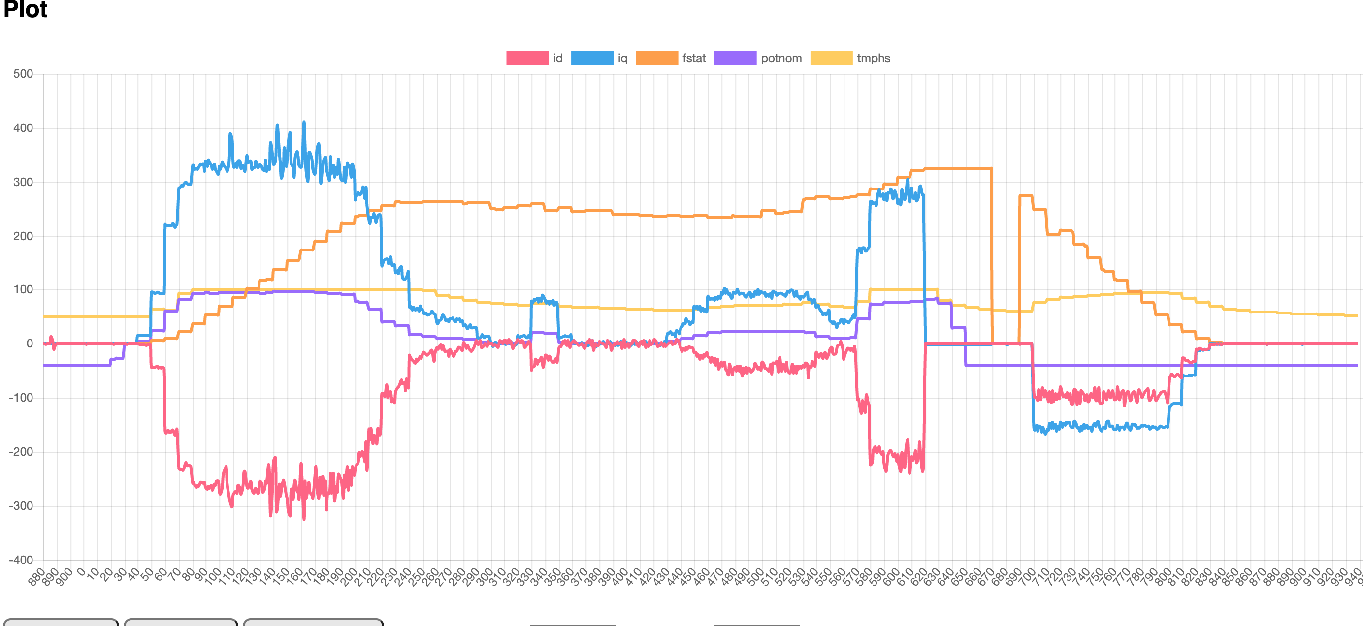

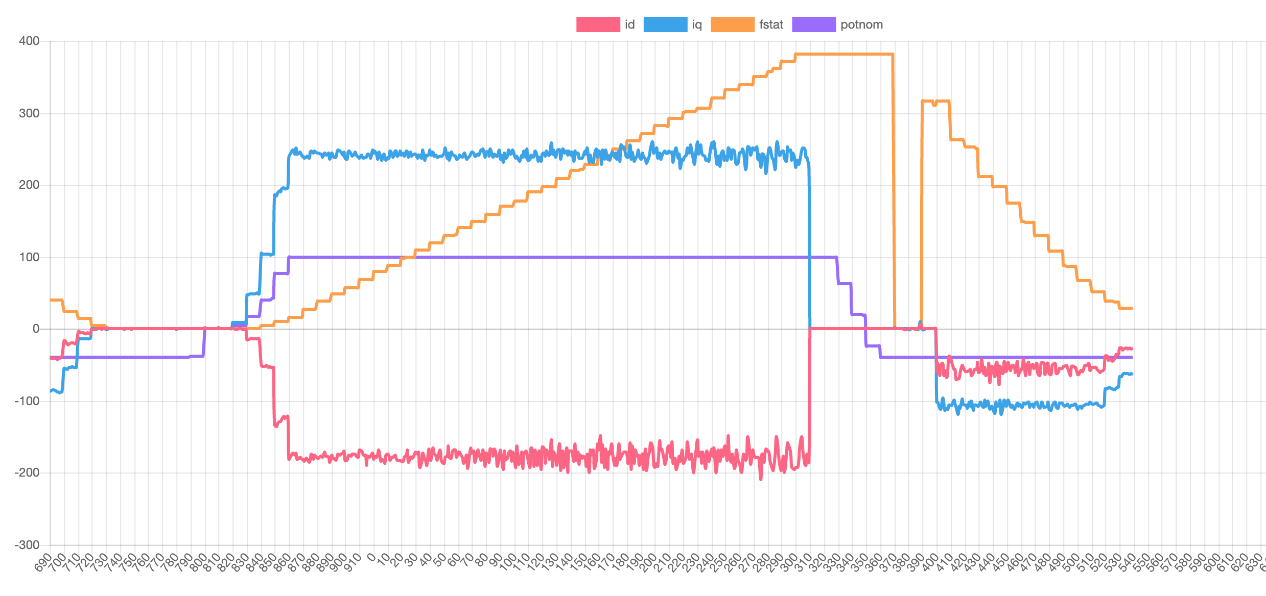

So apparently the prius will only cut for desat. My cutouts are always happening at around 380Hz so I've set fmax to 350 for now, limits me to around 6500 rpm vs 14k if I gently take it past that speed
This is with the 5.20 release. Drives pretty well with fmax set to 350

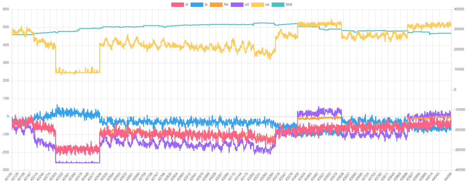

Pete9008 wrote: Sun Sep 11, 2022 11:16 am Got to say I feel a bit awkward about this! I post saying I think there is a stability issue with the controller, you post saying it's all good and here is a new release. It's your code and your descision but it's not a way of working that I'm particularly comfortable with :?
Yes, I hear you, but: it is an improvement over the version before that (5.14.R) that certainly developed unwanted regen even at relatively low speeds.
Pete9008 wrote: Sun Sep 11, 2022 11:16 am At the risk of sounding like a broken record, please be careful. In your final plot both Iq and Id controllers look like they are maxed out for a lot of the run meaning that they are running open loop and not fully controlling the motor. It doesn't look like it caused any issues but it's not a good place to be above base frequency.
yes, agreed. Essentially that limits FW current but the cleaner solution would be to have an extra parameter for maximum FW current rather than just setting it to throtcur*50.
EDIT: in the first plot it looks much nicer but it felt much worse. Field weakening current also creates reactance torque creating large torque ripple as it comes and goes.

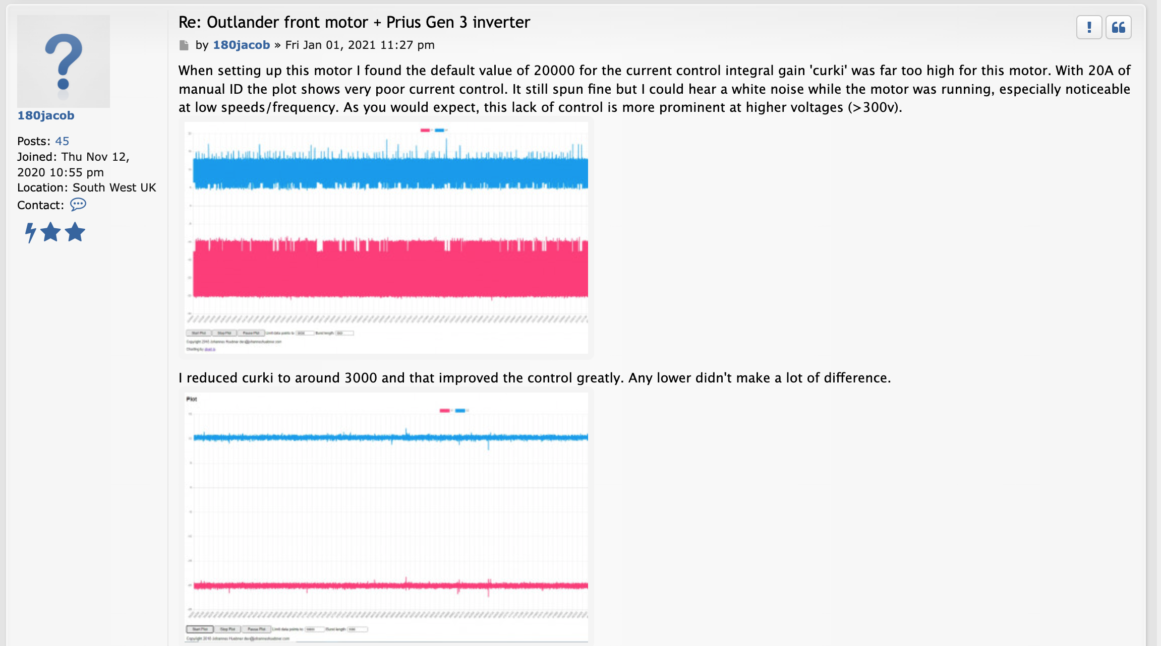

The integral gains seem a bit low, I wouldn't expect them to differ that much from the Leaf ones (curki=35000, fwki=300) but I don't know for sure.
Posts: 1884
Has thanked: 91 times
Been thanked: 517 times

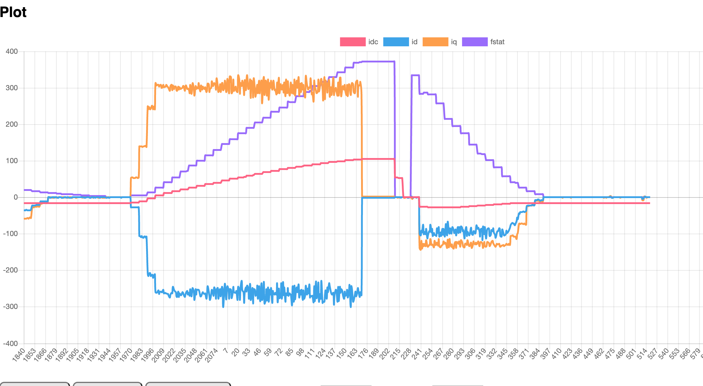

Saw this post ages ago and just went with it :D
viewtopic.php?f=19&t=902&p=21451#p21451
Will have a play around though.
hmm, ok. My motor is slightly noisy as well. I'll try lowering it back down but that's after holiday ;)
Also I forgot to take out curkifrqgain. I had it set to 0 for all tests.
