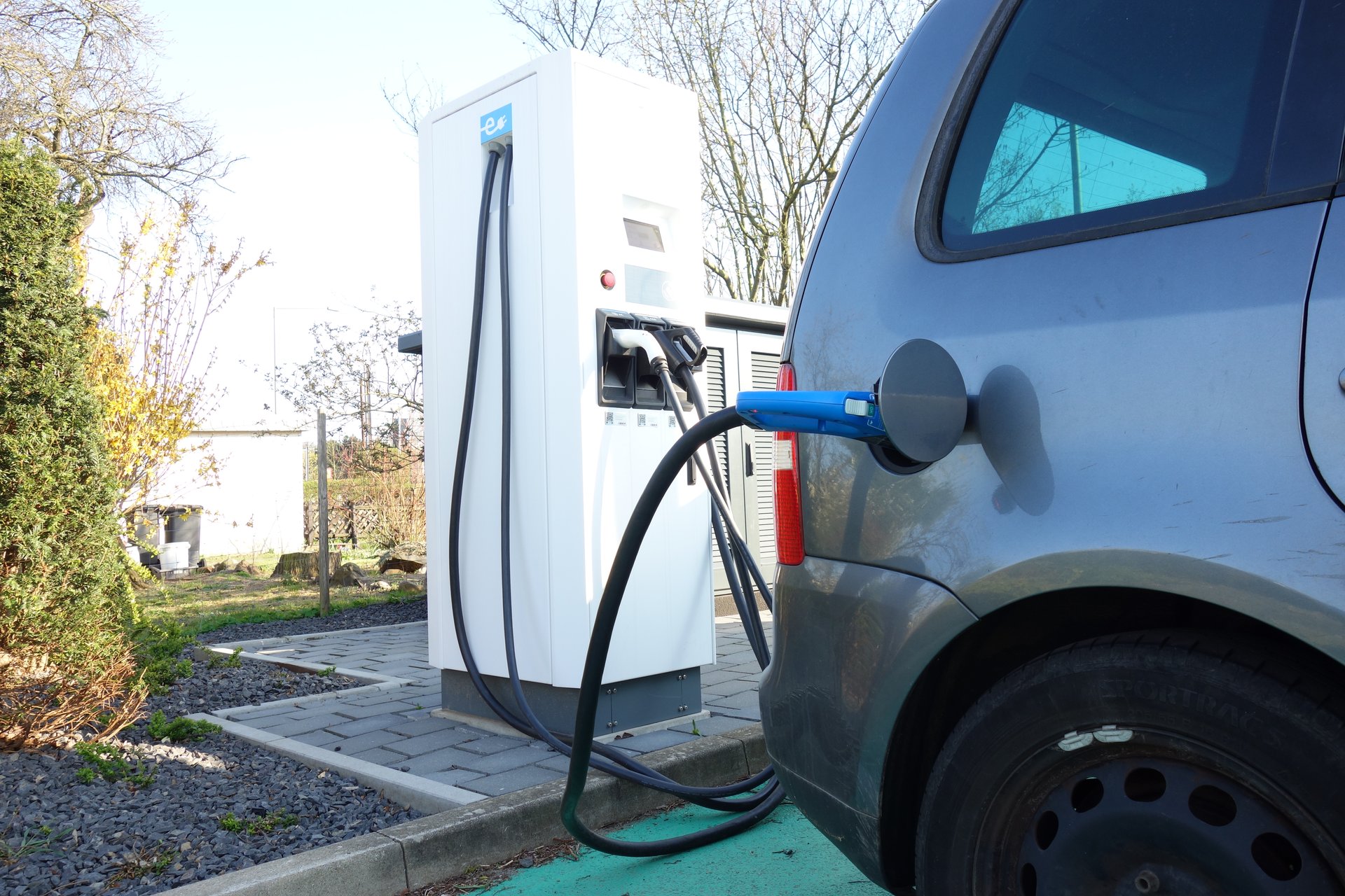

Its been ages since I played with this but I have a fleeting memory of needing to set the limit voltage way higher to avoid the evse shutting down on overvoltage. In fact I think the jld505 software handles the current taper once target is reached.
Been thanked: 1918 times

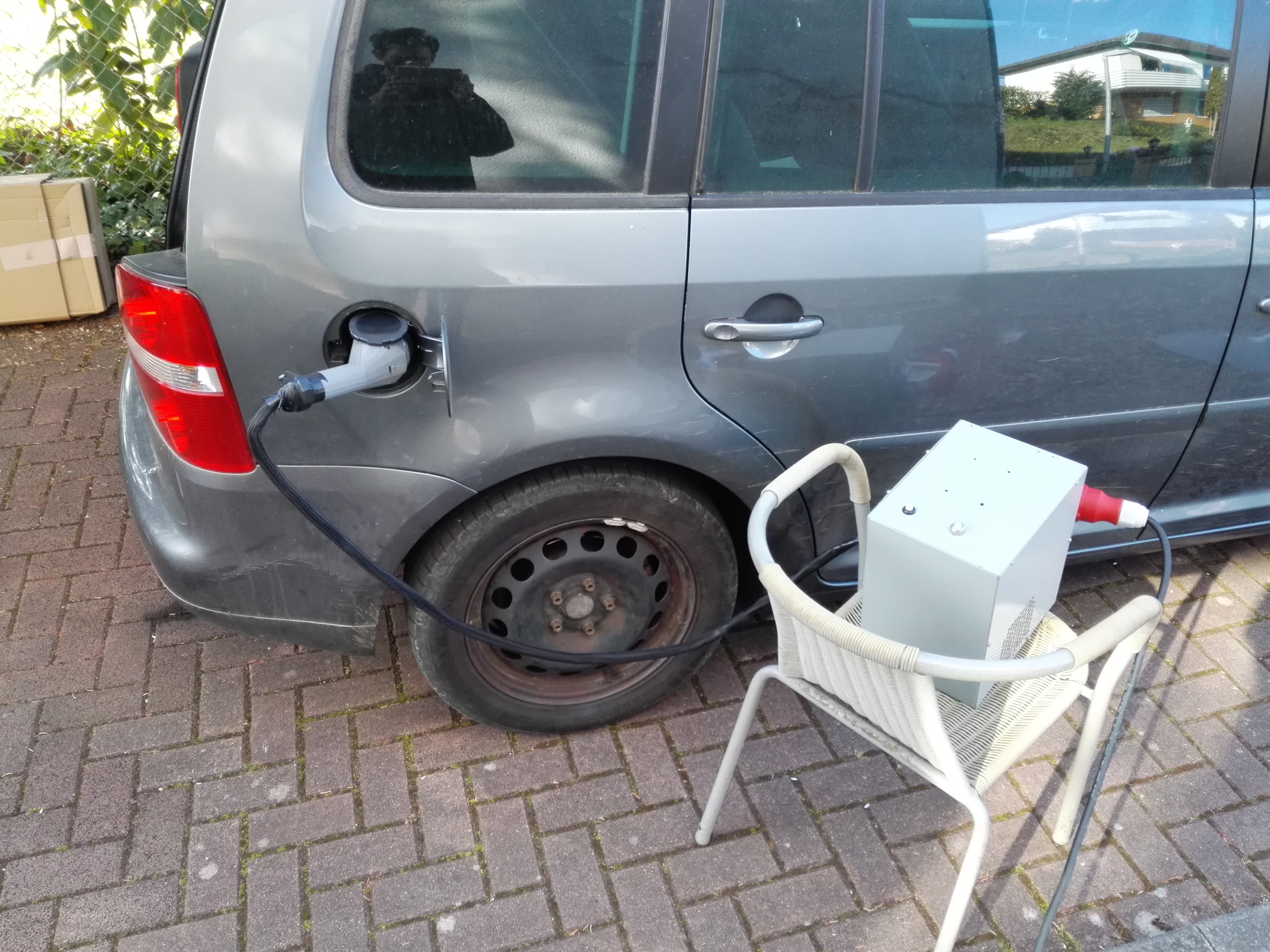

Another attempt today. Good news: I can finally charge without ignition on :)
BMS current limits are relayed to the EVSE so I also don't need a sane target voltage. I set it to 450V and 460V limit only to discover that I still had the 410V constant in the CAN code :?
The longest stint was 2.5 kWh. After some random time it simply quits charging "as commanded by the vehicle". I couldn't see a state transition to ChargeEnd which would happen if the BMS signals a full battery. Also the commanded charge current was non-zero. Will retry later with the elevated voltage limit, maybe that was it.
Anyway the conclusion is that you do not need a dedicated CAN bus for ChaDeMo and also the EVSE doesn't care about the extra CAN messages.

Nice work. What brand was the fast charger? I remember some of them had terrible current regulation and would cause a kick in voltage that would trip the overvoltage limit. The higher the soc the more likely it was to occur.
It's the one on the picture. ABB if I remember correctly

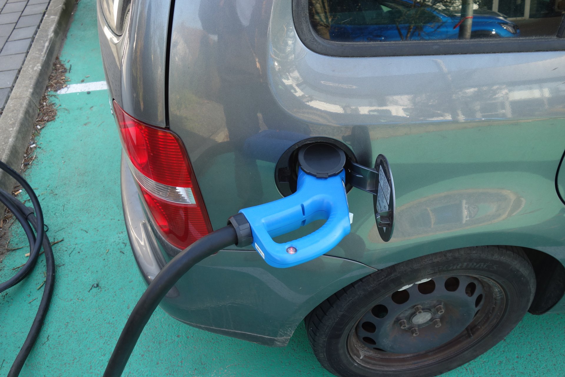

Got mail from celeron55 today :) 3D-printed ChaDeMo plug complete with pins and cable - thanks very much!
Not using the CAN line yet as the charger still uses a Gen1 mainboard w/o CAN.
Apart from that it works fine and prevents the car from driving off while plugged in.

More importantly I fast charged from 20-80% without interruption and with 35kW 8-)
