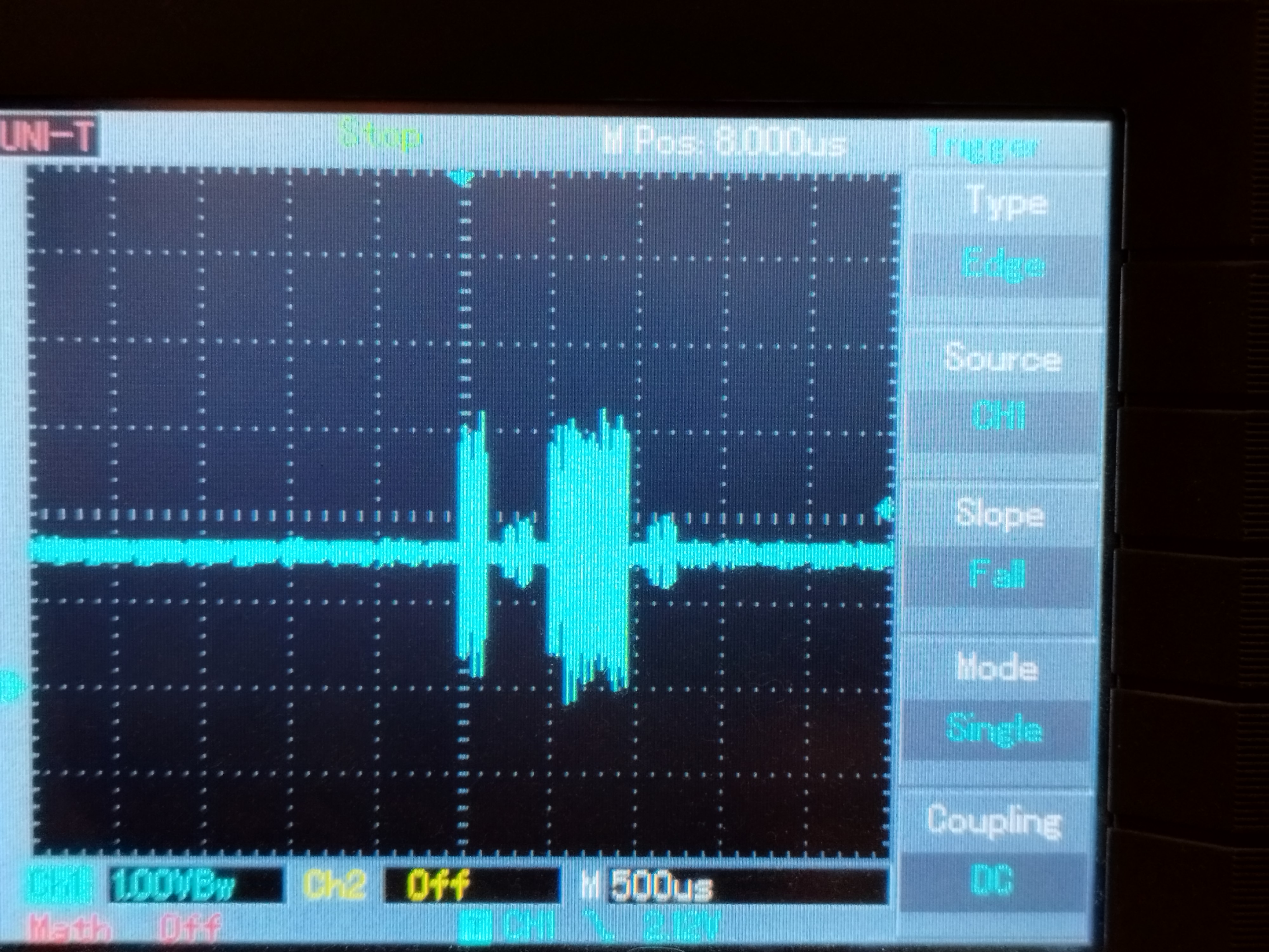

And I'm stuck.
There's no communication going on and when I scope TX it looks completely silent. Terminal says various promising messages

This is normal. As long as the pev does not see central coordinator packets, it does not transmit anything. On my board I see static 1.6V on the tx lines in this case. When connecting to the evse modem, the tx lines looks like this
Qca7005 tx line
Qca7005 tx line
The packets with the low amplitude are the ones from the evse, the strong ones come from the QCA.

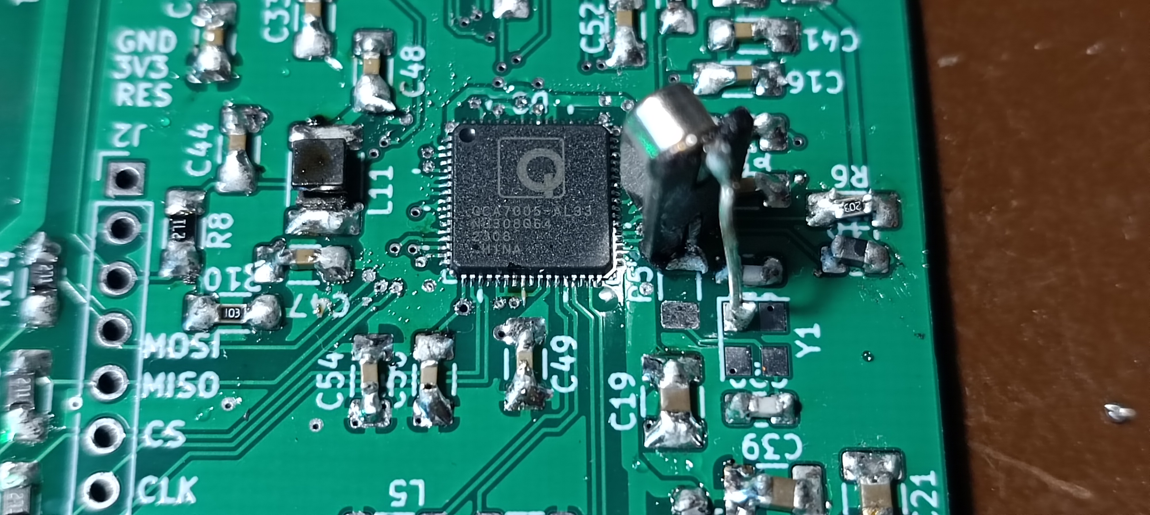

Re: Develop a QCA7000 board?
We have liftoff :)
All your checks went ok. When I took this picture
I realized my mistake. One end of my funky crystal wasn't connected to its cap. With that fixed I reached the charging loop with pyPLC.

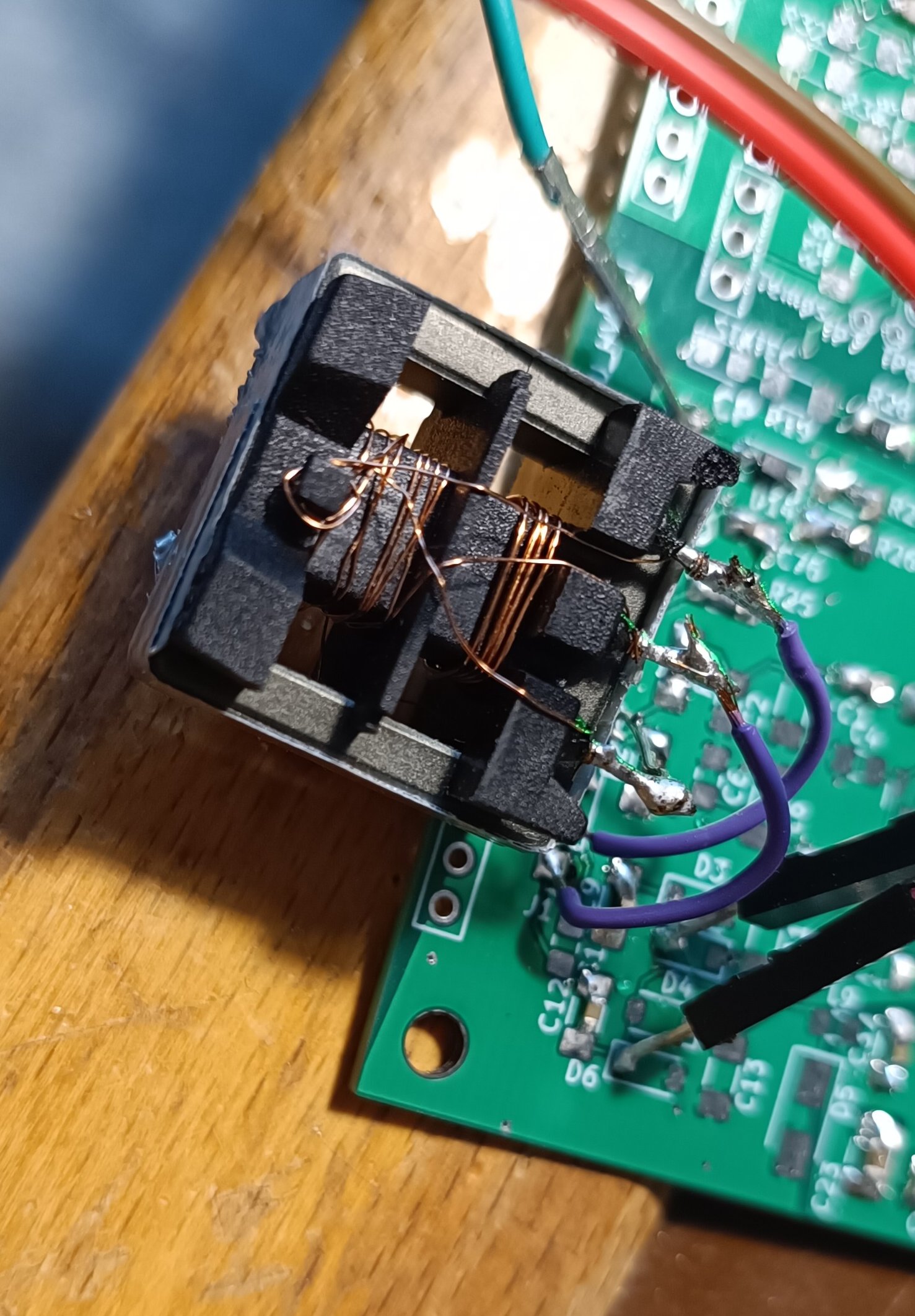

Apparently not much can go wrong with the transformer, check it out
Is it beneficial to have a winding ratio other than 1:1?

Really nice pictures of the crystal and the transformer :-)
johu wrote: Wed Dec 06, 2023 9:00 am Is it beneficial to have a winding ratio other than 1:1?
No, 1:1 is fine. Regarding the number of turns, just measure the levels on one side and the other with scope. If there are too less turns, the transformer will damp, this should be avoided. The signals on both sides should look the same. If there are too many turns, this increases the risk that powerful pulses from outside (due to EMI, switching contactors and so on) could reach the QCA and kill it. So the goal with the transformer is: As less turns as possible, but as much as necessary.

I also looked around at JLCPCB for SMD transformers. I don't know what sort of uH we're looking for. Most are 1:1 or 1:1 with middle tap.
https://jlcpcb.com/partdetail/Sumida-ES ... 0C/C596483
Here's one with 2 separate secondary coils:
https://jlcpcb.com/partdetail/Rlt-SMD09H1971R/C5358224

Roughly estimated, we need at least 20µH to get 120 ohms at 1MHz. A little bit higher is better. The RIK10 with 5 turns has approx 44µH. This means, the https://jlcpcb.com/partdetail/Sumida-ES ... 0C/C596483 with 120µH looks good. Contra: It is not cheap (~1 EURO). Pro: It is automotive-qualified.
I would avoid the three-winding-version, and simply connect the TX and RX together on the QCA side of the transformer. This leads to not ideal in-phase-rejection between the TX and RX, but this does not matter, because we are not fighting with microvolt sensitivity requirements in this application. I used this simple approach in serveral try-out boards without issues.
Other alternatives welcome.
Edit: https://jlcpcb.com/partdetail/3170710-C ... 1/C2904734 costs 0.10 EURO and looks technically fine.

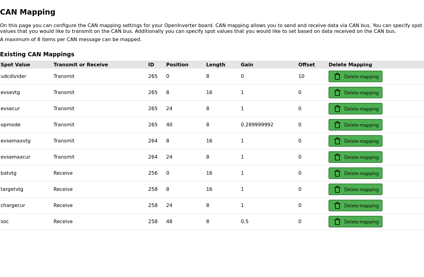

Just to be sure: Is it normal, that it sends just two messages on CAN at startup:
I guess all other CAN traffic needs to be configured in the CAN-mapping, right?

Yes, these are the boot loader messages.
All else needs to be configured. Here is my CHAdeMO config
udcdivider is just a dummy. It is the CHAdeMO version 10 special for Touran (in offset)
