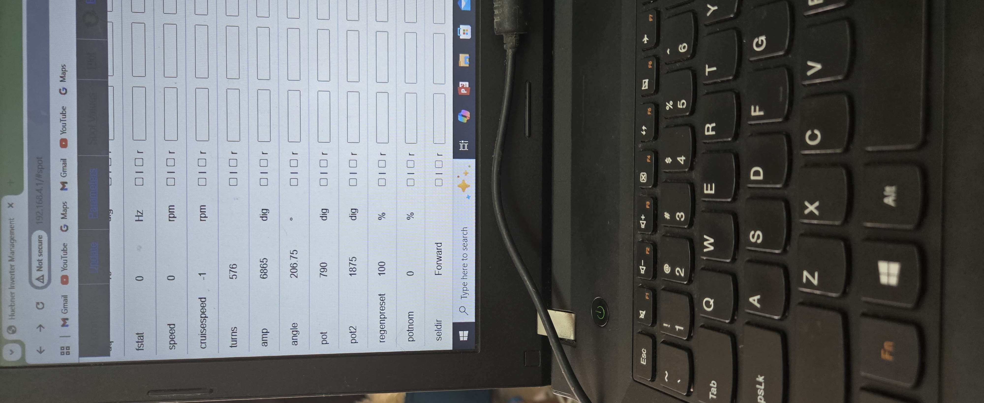

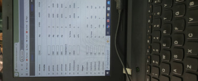

Based on Retros response quoted above, I've attached two screenshots of potnom values before and after the throttle was pressed and not pressed.
Do I need to get json files or the screenshot will do.
Ok so basically when the throttle was not pressed pot1 790 and pot2 was 1875, And when pressed both gave values of 4095.
So now as Retro said that I should set NOT pressed value to a larger value, I added 50 to the 790 and got a value of 840. When throttle is pressed I subtracted 300 from 4095 and got 3795 like Retro explained.
Moving on to pot2. As mentioned that with pot2 things are vice versa now. When NOT pressed i got 1875 so I added 50 to that value and got 1925 and from 4095 of fully pressed i subtracted 300 and got 3795 again.
Now coming to adding the values in parameters,
On potmin I put our larger value of 790+50=840
On potmax I put our less value of 4095-300= 3795. This value was above potmax limit which is 3500 so I kept it at that 3500 value.
Then pot2min i added the values vice versa like instructed to, meaning for pot2min i added less value 4095-300=3795 and pot2max 1875+50=1925.
What is noted is that in parameters both pot2min and pot2max had values of 4095. While pot had potmin 0 amd potmax 3500. "Pleaser see attached screenshot.

RESULTS
The motor didn't spin.
I tried changing the values in parameters for pot and pot2, tried adding and reducing them to try and see if I get any different results but still the motor didn't spin.
Is there smelting im doing wrong. Did I miss Retros instructions, am I adding in the right values ??

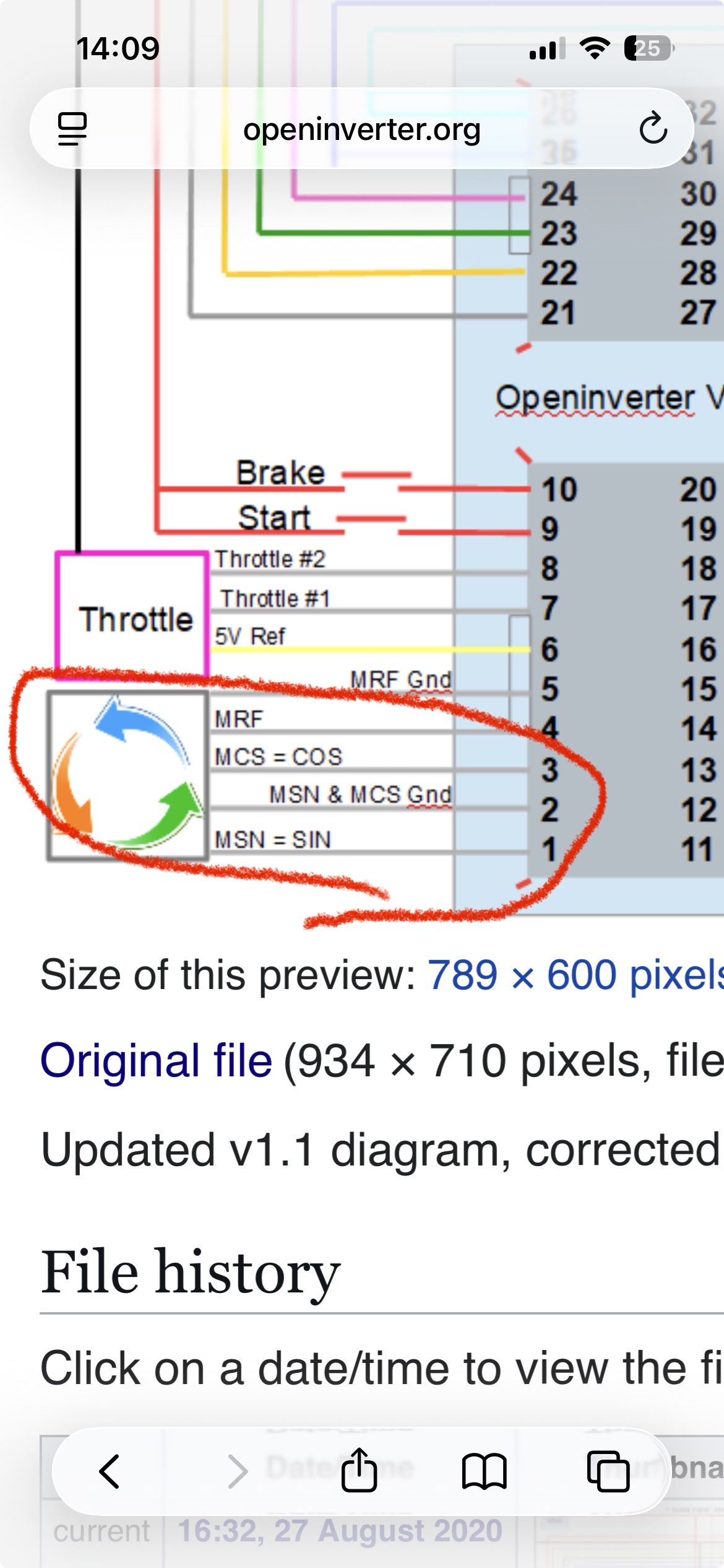

Can someone tell a newbie what 1-5 pin is on vcu (resolver?)
Is there wiring diagram for Connector?

blasaab wrote: Sat Jan 24, 2026 1:12 pmCan someone tell a newbie what 1-5 pin is on vcu (resolver?) Is there wiring diagram for Connector?
I've never dealt with this because I've never used the Prius transaxle. But, I did dig this up:
https://share.qclt.com/%E4%B8%B0%E7%94% ... recu40.pdf
And it indicates a couple wiring colors Red with Green stripe, and Yellow with Brown stripe for GSN and GCS. It doesn't help much other than just say those two are resolver signal wires.
I couldn't find anywhere on our wiki anyone who's documented the Prius Gen 2 transaxle, (there must be some, @Gregski has documented almost everything about his Gen 2 build, I just can't see if it's in the wiki anywhere) but this whole 5 pin connector seems to be a plug on the transaxle that connects to Johannes' board.
Presumably it's the resolver that you've been using this whole time? If not, what have you been connecting to Johannes' board in terms of resolver wires?

blasaab wrote: Sat Jan 24, 2026 1:12 pm Can someone tell a newbie what 1-5 pin is on vcu (resolver?)
Have you seen the collab video of Damien and Johannes where they teach us how to go about connecting the VCU to the transaxle and putting in the "TEST SETTINGS" ?
