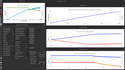

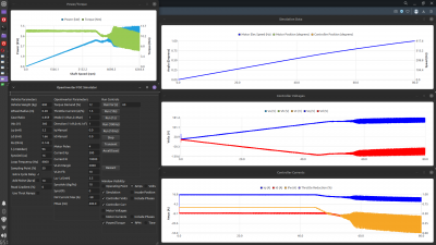

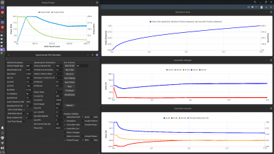

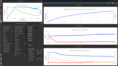

Was out driving yesterday and noticed that there are quite some oscillation when at 65-70km/h (280-310Hz) cruise or slightly lower torque request.
Tries to tune it by increase kp which helps reduce the phenomena but it also gives unwanted regen with kp at 800.
Adjusted other parameters as well but without desired effect.
Started the simulator and tested with less than 100% tourqe demand and I can see a oscialltion here as well for 25% and 12% torque demand.
Torque demand 100%
Torque demand 100%
Torque demand 50%
Torque demand 50%
Torque demand 25%
Torque demand 25%
Torque demand 12%
Torque demand 12%
Torque demand 6%
Torque demand 6%
Torque demand 3%
Torque demand 3%
The conclusion I can find is that when |Vd| is close to |Vq| the control loop start oscillating?
I will continue testing in the sim. Any suggestions on what to do is very welcome.

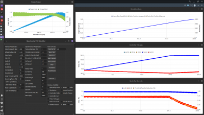

Re: Renault Clio Electrique -97
Posted: Fri Jan 13, 2023 7:31 am
by bexander

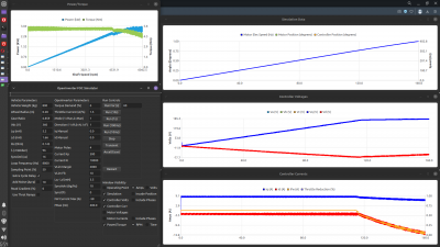

Reducing VLimMargin seem to reduce the problem but I'm not to keen on reducing the IRL, might cause other problems.
All plots with 12% Torque demand, VLimMargin is normaly set to 2000.
VLimMargin_2000
VLimMargin_2000
VLimMargin_1000
VLimMargin_1000
VLimMargin_100
VLimMargin_100
VLimMargin_0
VLimMargin_0
VLimMargin_4000
VLimMargin_4000

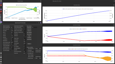

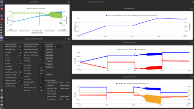

Posted: Fri Jan 13, 2023 7:40 am
by bexander

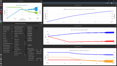

Reducing Ki also seem to reduce the issue.
All plots with 12% Torque demand.
Kp 500, Ki 10000
Kp 500, Ki 10000
Kp 500, Ki 5000
Kp 500, Ki 5000
Kp 500, Ki 2500
Kp 500, Ki 2500
Kp 500, Ki 20000
Kp 500, Ki 20000

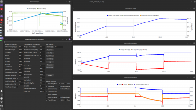

Then decrease Ki and slightly increase Kp
Kp 600, Ki 5000
Kp 600, Ki 5000
Looks promising, needs testing in car.
Did som Accel/Coast as well to see how it will respond to step changes. There is a slower respons with lower Ki, as expected.
Kp 500, Ki 10000
Kp 500, Ki 10000
Kp 500, Ki 2500
Kp 500, Ki 2500
Kp 600, Ki 5000
Kp 600, Ki 5000
