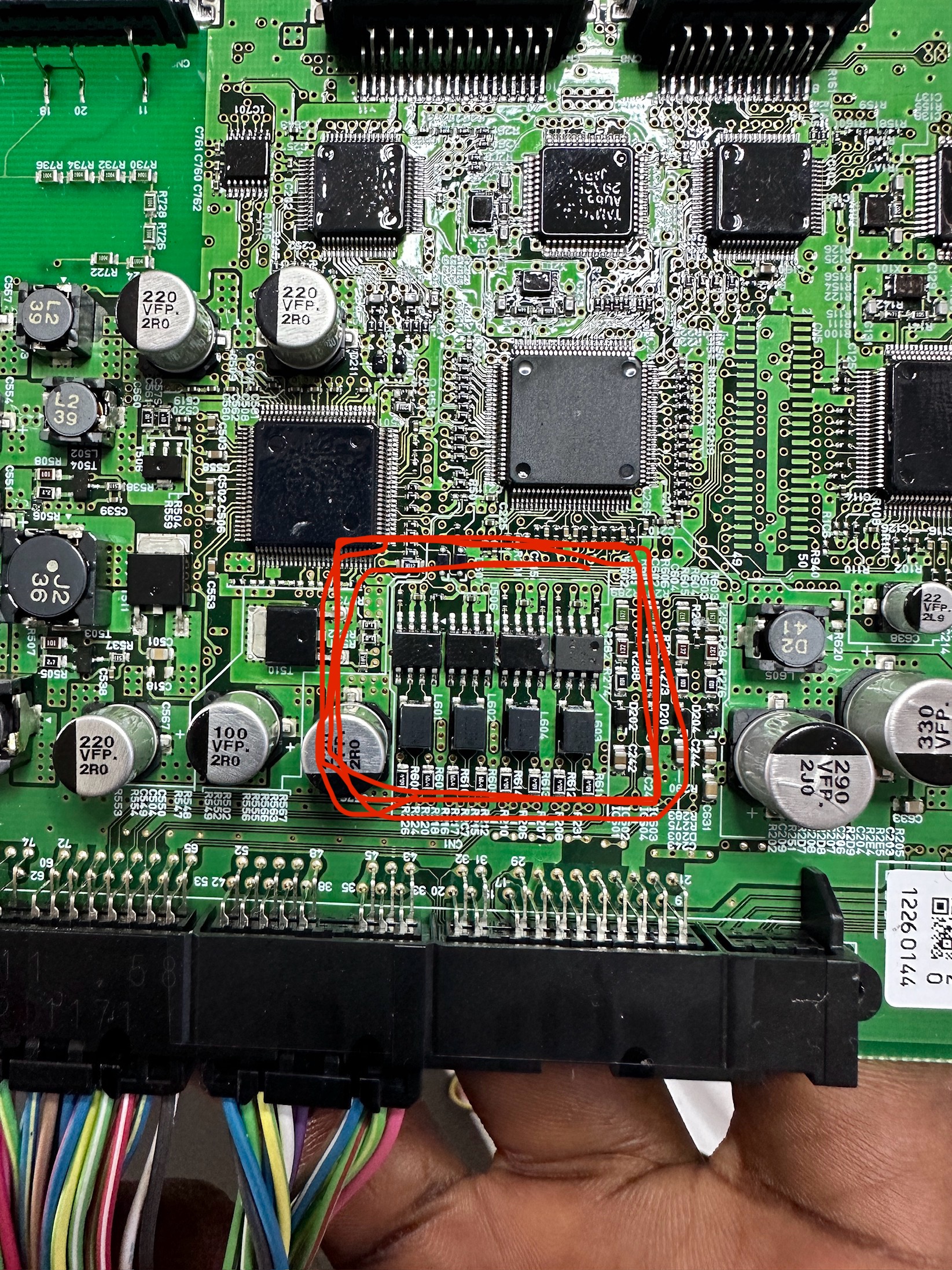

Hi there, @toxakartoxa
i have an inverter board from a toyota camry 2012-2017 with the number G9200-33171 similar to the crown one
do you know which IC is for REQ CLK HTM MTH ?
thanks in advance
thanks in advance

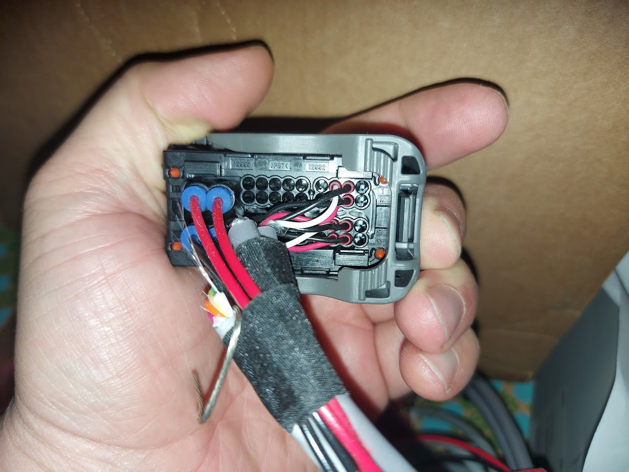

The back of my wired connector. Note I have left out one of the resolvers as this was for a test setup for Zombie testing.
Connector pinouts usually correspond to backs (wire sides) of connectors and so does most numbering.

Thanks Tom for the fast reply. Yes will certainly extend the diagram. But happy you agree so far.
Your wiring looks like mine so it must be something outside of the plug. Alright will try more ideas. Thanks for the support.
