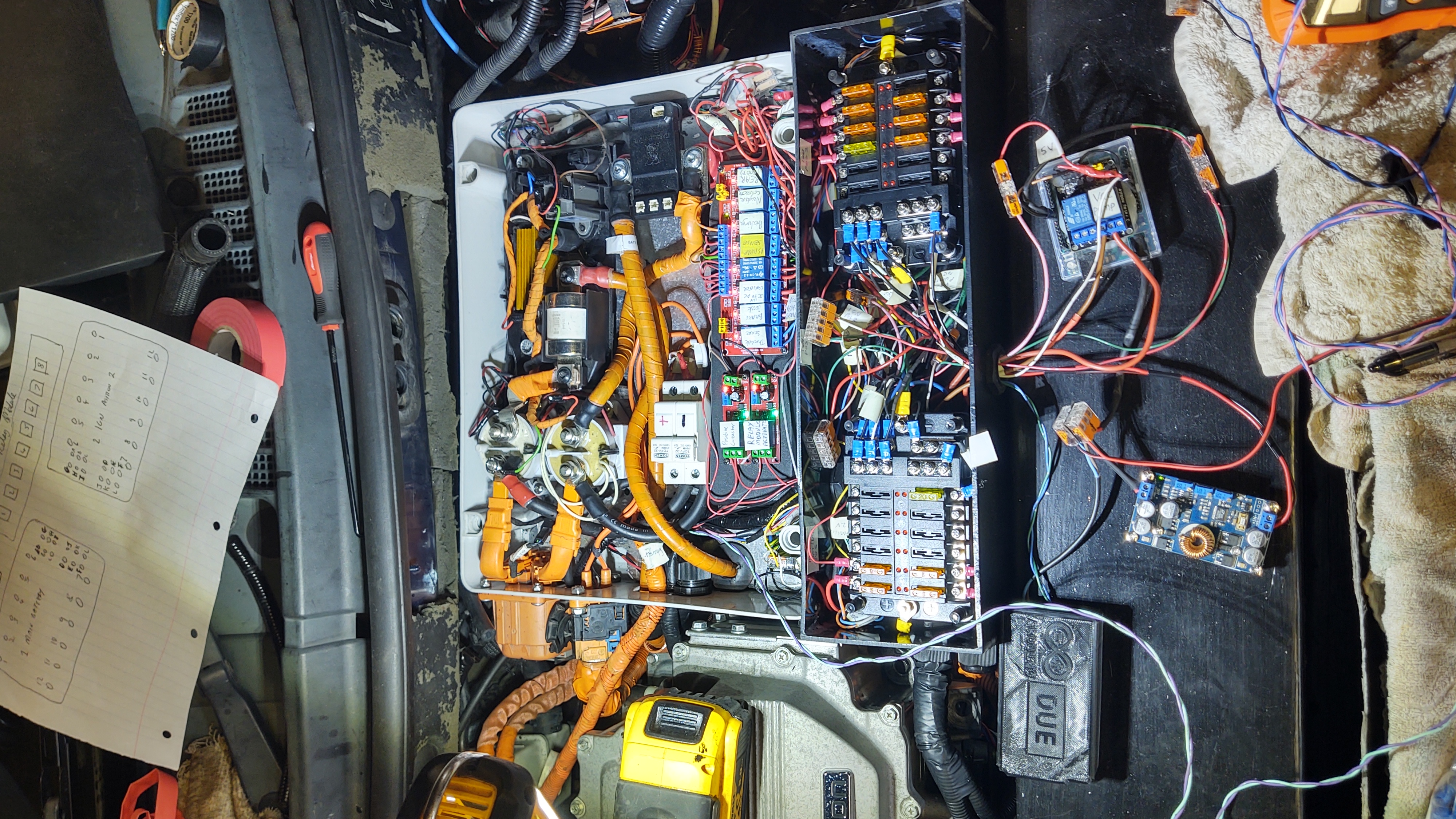

So today I managed to pretty much complete the LV junction box and get the car working again (spinning the motor while in neutral and charging). I made a couple of minor errors with the location of some wires but they were easily sorted and no harm done. Before connecting the battery properly I hooked it up through a 12V bulb to confirm there were no shorts.
In the photo below you can see how I've tried to tidy things up a bit with the fuse holders. As it turned out I'd have been better off with 3 smaller 6 or 8 way fuse boxes than two 12 way as I had to resort to Wagos for wires going to ignition position 1 but it is still much neater than before.
I have been documenting every wire as they were connected so hopefully when I go back to add stuff or make changes it will be a lot easier.
Then to see what would happen I connected the heater up and Woo Hoo, we have heat! Nice warm air coming through the vents with the heater on. Now I need to route the controller through the bulkhead and mount it in the cabin.

While testing I managed to drop some solder on the board while it was running. This caused the operation to be somewhat sub-optimal so after first replacing the MCP2515 I then had to replace the Arduino and of course it was no longer soldered to the vero board.
Originally I had planned to mount the board under the bonnet and feed wires through to the dash but while staring at the new pile of wires I had an idea.
OK so neat it isn't but this was more a proof of concept than a final installation. In order to tweak the code I will need to remove the Arduino as I didn't give myself enough room to plug in a cable but that can wait a bit. I have plenty of other things to work at in the meantime.
Jamie/TurboPete's code works great however in my application I might need to adjust the temperature difference before the heater switches to half power. It looks like it switches to half power while around 10°C below requested temp. This means if I request 55°C it only gets to around 50°C which is not quite enough. I find myself turning it up to 61 or 62°C to get the desired 55°C.
I assume this will change as we get into late Spring so for now I am keeping the adjustment and code as is. I have a second ash tray that I can use if I decide to use Arber333's code without a POT.
