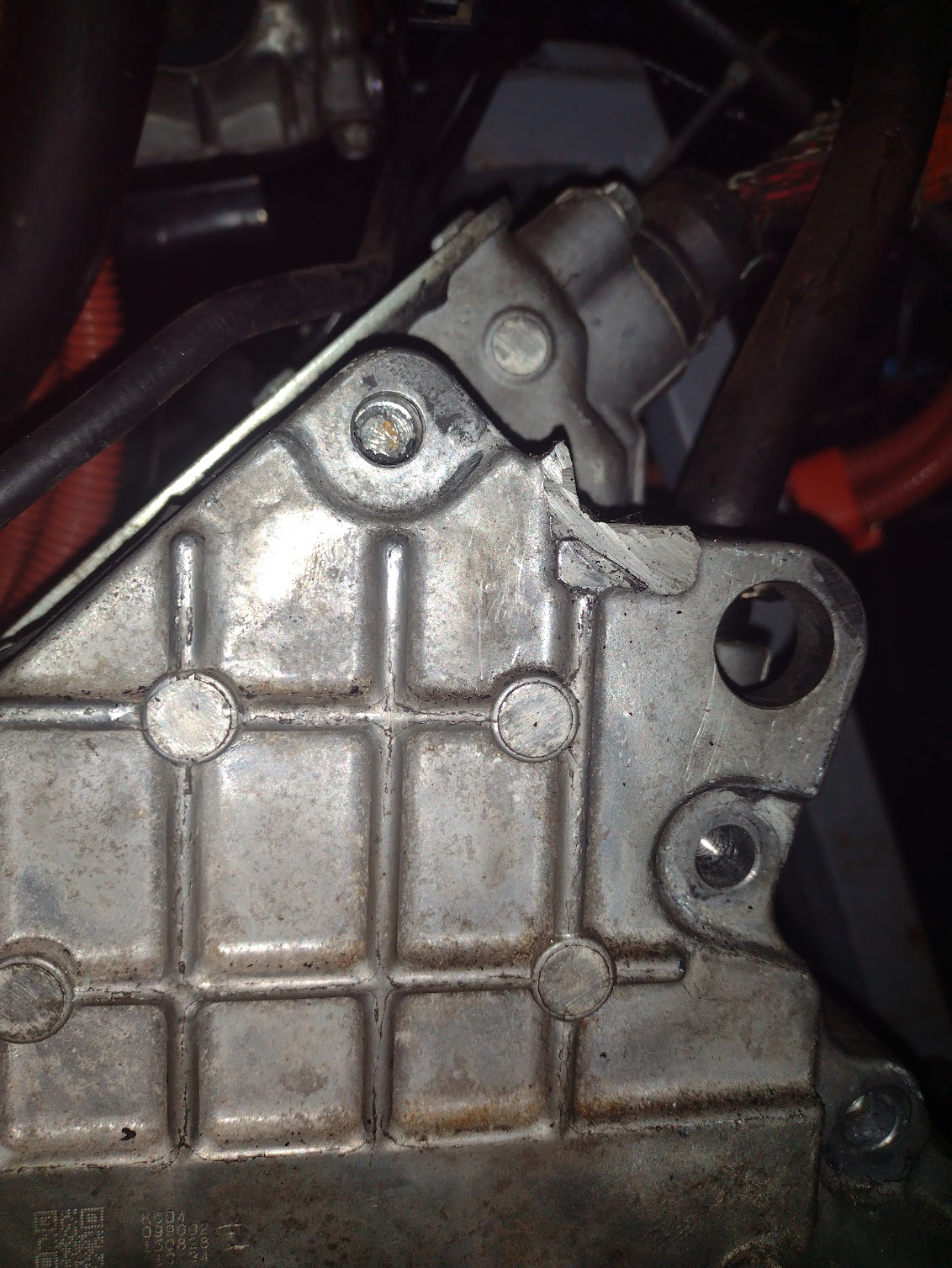

A couple motor mounting bolts have snapped. Theory is, I'd not use thread lock and they've loosened and then the final impact snapped them. So motor is twisting entire engine/gearbox etc. It explains why slow turning by hand, or coasting was ok. It was immediately obvious when I had a helper to observe.

Posts: 1774
Has thanked: 82 times
Been thanked: 424 times
Re: [DRIVING] VW Beetle 2003
Got some left hand drill bits and extractors coming tomorrow to hopefully do the trick.

Well the left hand drill bits were great. Got the bolts out. Bad news the probably remains
