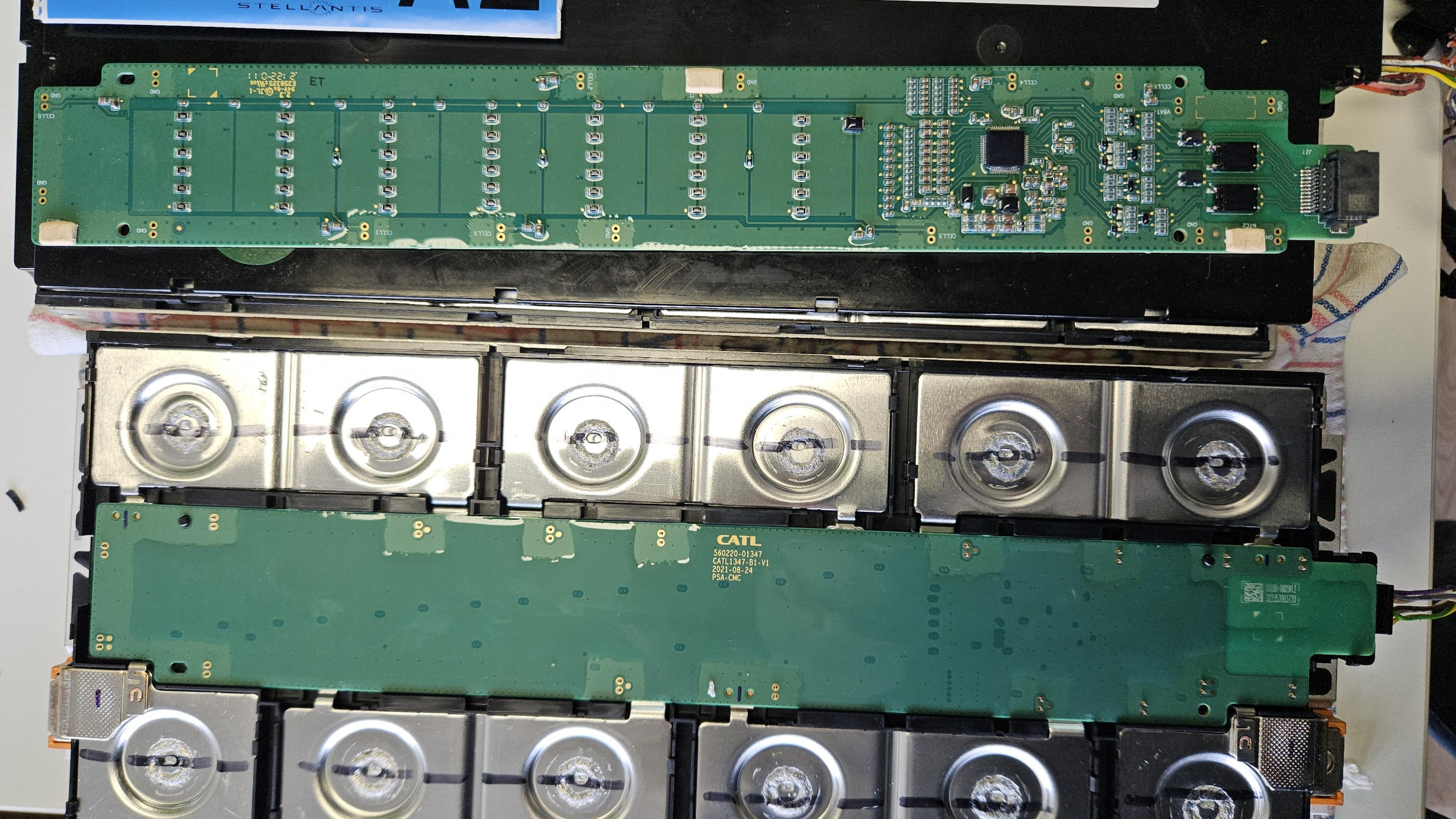

I updated the code so it works correctly with more modules in the daisy chain. I'm now testing the balancing part but I can't seem to get it working.
My question is what are these big pads on the PCB for with the 6 1k resistors in parallel? Filtering of measurements?
Any idea how the balancing works?
PS. Comes from a Peugeot E-208 pack
EDIT: I think the big pads are for the cell balancing with bleed off resistors.

As you mention, most likely are the resistors for cell balancing bleed off and the large pads are to aid cooling of the resistors. Is there more stacks of resistors on the other side of the PCB?

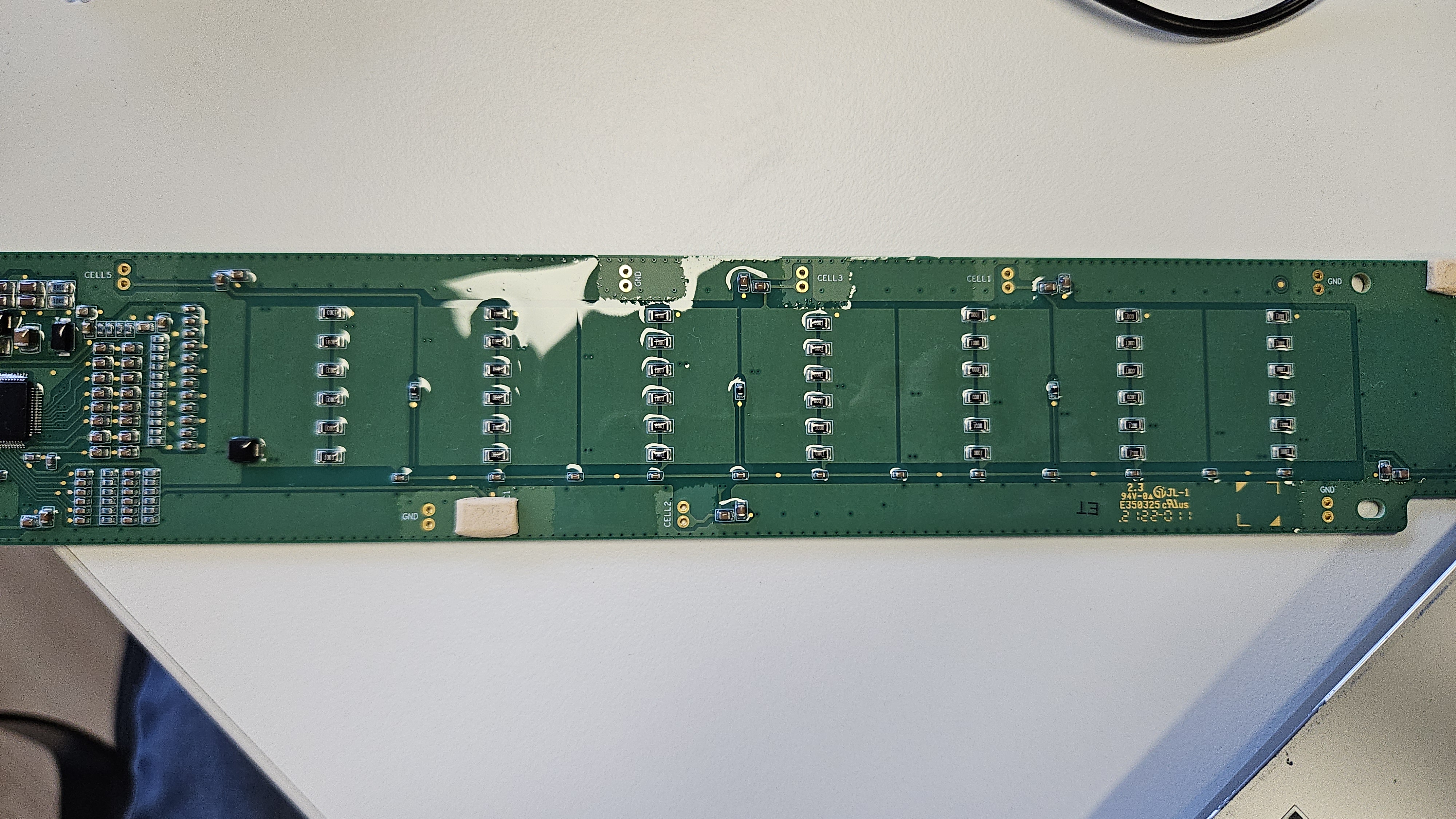

No resistors on other side of pcb
Thankyou woleg for the suggestions, I will try to do these changes.
Update photo of the PCB on the modules (No modification, all stock)
