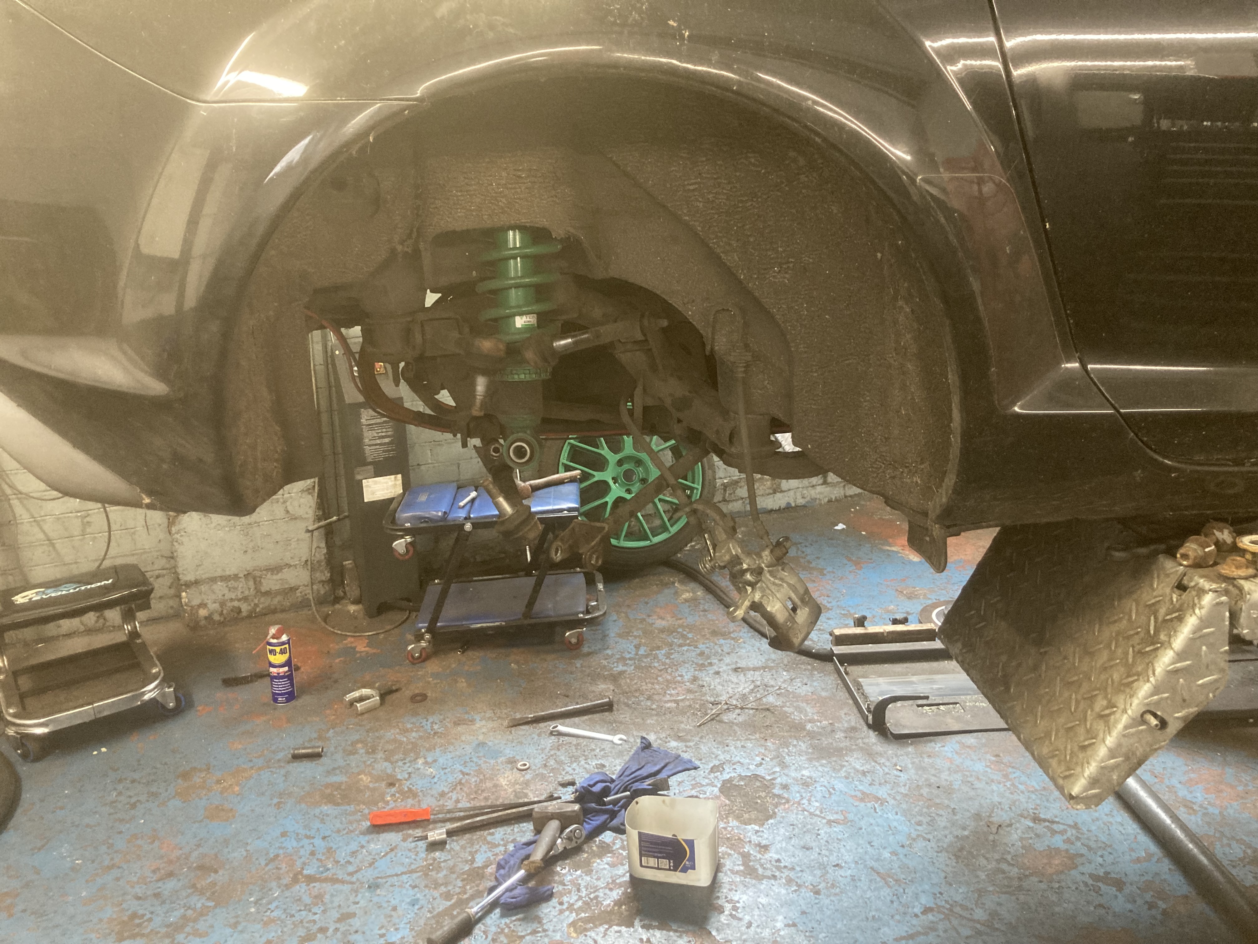

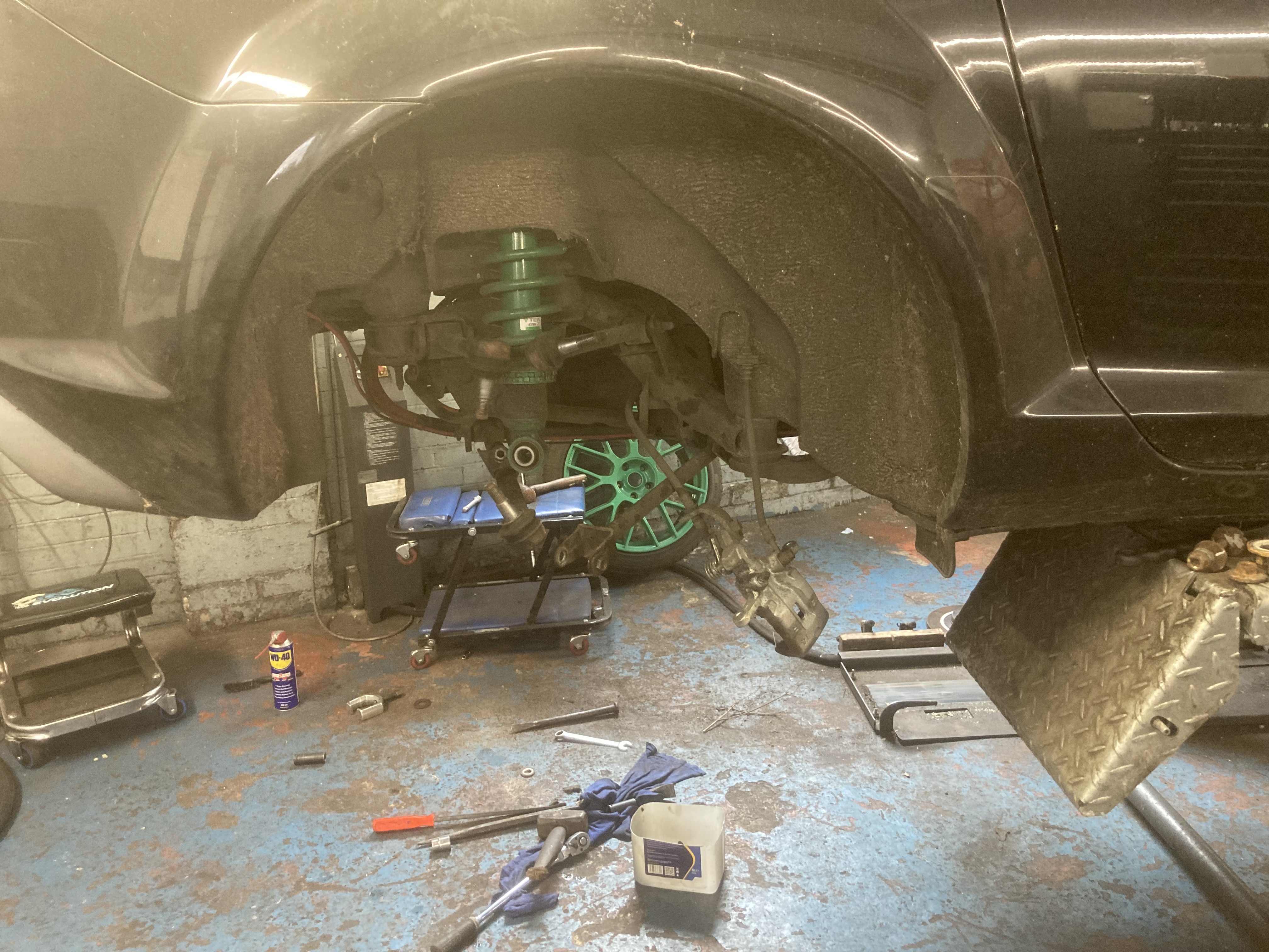

Finally found a weekend to pull out and replace the diff that’s been complaining louder and louder over the last 3000 miles, new wheel bearings too while I’m at it
Ev8
Posts: 818
Has thanked: 43 times
Been thanked: 163 times
Re: [DRIVING] Project RX8 , Prius gen2, Lexus transaxle to rwd
Post by Ev8 »
So good news bad news…..
Good news is I can no longer hear how many teeth the diff crown wheel has under regen.
Bad news is the diff can’t have been the only thing making a noise so I suspect the gearbox isn’t the healthiest.
So that leads to the question find another gearbox or ditch the whole motor setup and go gs450?
