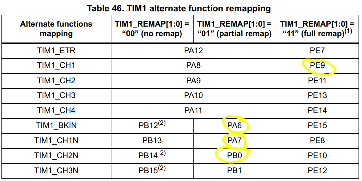

et0 wrote: Tue Dec 14, 2021 11:22 am Just a quick one - has anyone seen the OIL PUMP output working for the GS450 yet?
I get no PWM at pin 30 of the VCU or pin 40 of the STM32, when it's on and running. (Oil Pump is set to 50% in the menu)
Trying to narrow down if it's another bad STM chip problem or something else.
Thanks!
Did you figure this out?
I'm having the same issue. I think it is a software bug in hwinit.cpp: where it is using the wrong pin to setup the timer for the Oil PWM signal and putting it on the INV_POWER pin. I tried the obvious thing of fixing the pin in the code, but that didn't help.
streber

streber wrote: Thu Jan 06, 2022 3:11 am
Thanks!
Figured it out. It also needed to remap the TIM1 pins. I'll send a pull request to get it fixed on the main branch.
https://github.com/damienmaguire/Stm32-vcu/pull/23

streber wrote: Thu Jan 06, 2022 4:25 am Figured it out. It also needed to remap the TIM1 pins. I'll send a pull request to get it fixed on the main branch.
Damien and Streber;
Do you guys now if the other PWM outputs work at all?
Because if you use that remap command.
All other timer IO's will also be remapped away from the used one for PWM1,2 and 3.
Does somebody know if the N channels are usefull for normal PWM signals?

Yeah we try to contribute but its not easy missing information.
Would be awesome if you can answer my questions too...
I think they are easy: Should the PWM outputs work? are they tested?
Because i think they weren't and are connected to the wrong pins...

I have not tested the pwm as yet. The pinout design was done using STM CubeMX to try and avoid assigning wrong pins / conflicts etc but its me so anything is possible. I have attached the CubeMX ioc file so it can be reviewed.
CubeMX is available here : https://www.st.com/en/development-tools ... t-software
ZOM_CubeMX.zip
(3.66 KiB) Downloaded 321 times

Thank u for explaining that. I re-checked and think i know it.
The pin assignment works a bit different then expected. For the other PWM pins we do need timer 14 and 15 from memory oh and more AFIO assignments...
Johu; Can you elaborate on your LIN driver? and can you tell me if N channel PWM outputs are useful for normal PWM modes?
Or should we look for assignment of CHx pins only?

@EV_Builder I also haven't tested the PWM yet since those ICs were missing in my kit and I don't have a use for them yet.
@johu I found that the master branch is pulling a version of libopeninv that isn't remapping the CAN2 pins. I see remap support is in the newer versions of libopeninv. Do you have a preference on how to resolve this? I see a branch for updating libopeninv but not sure the state of it.
