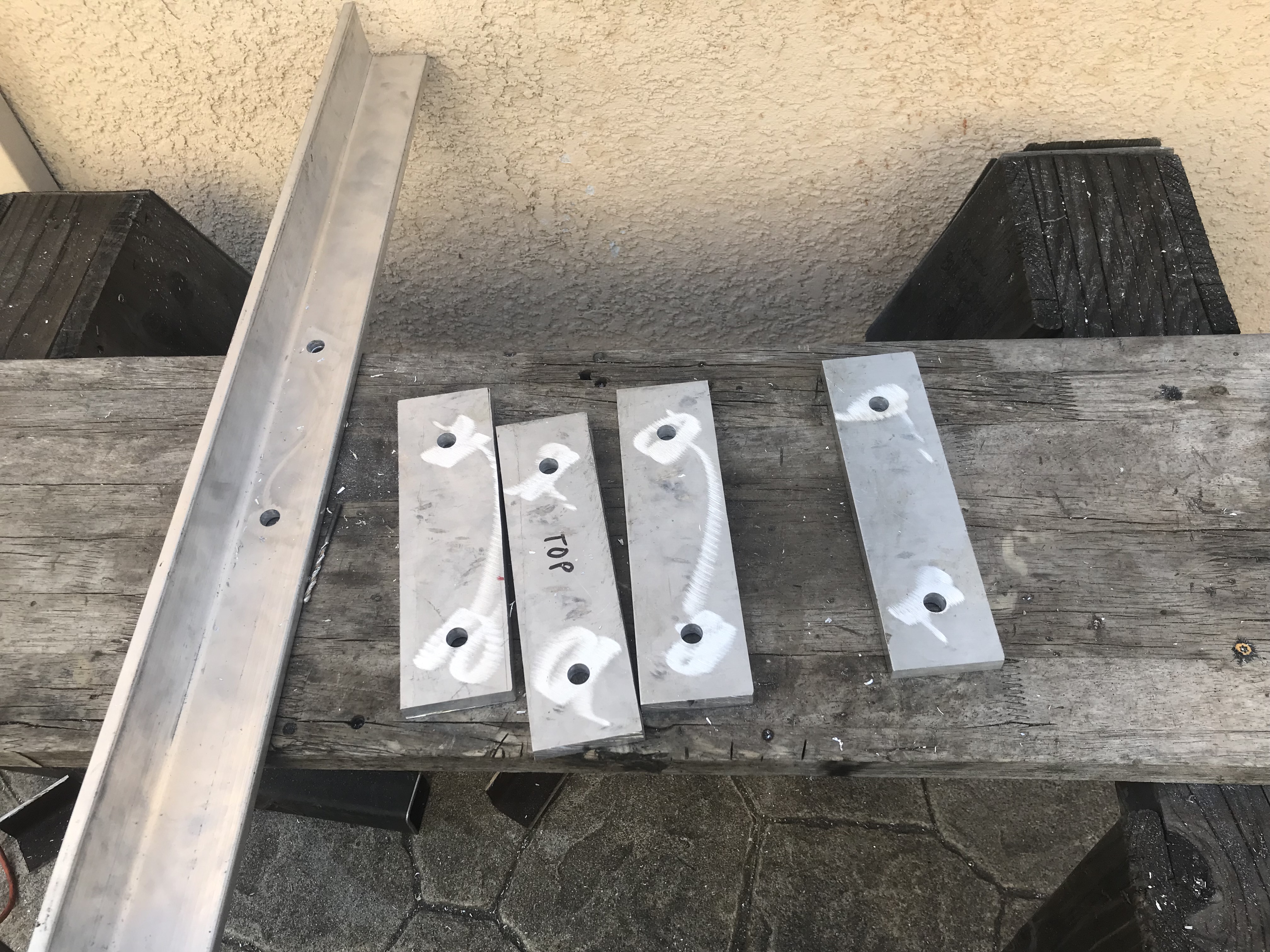

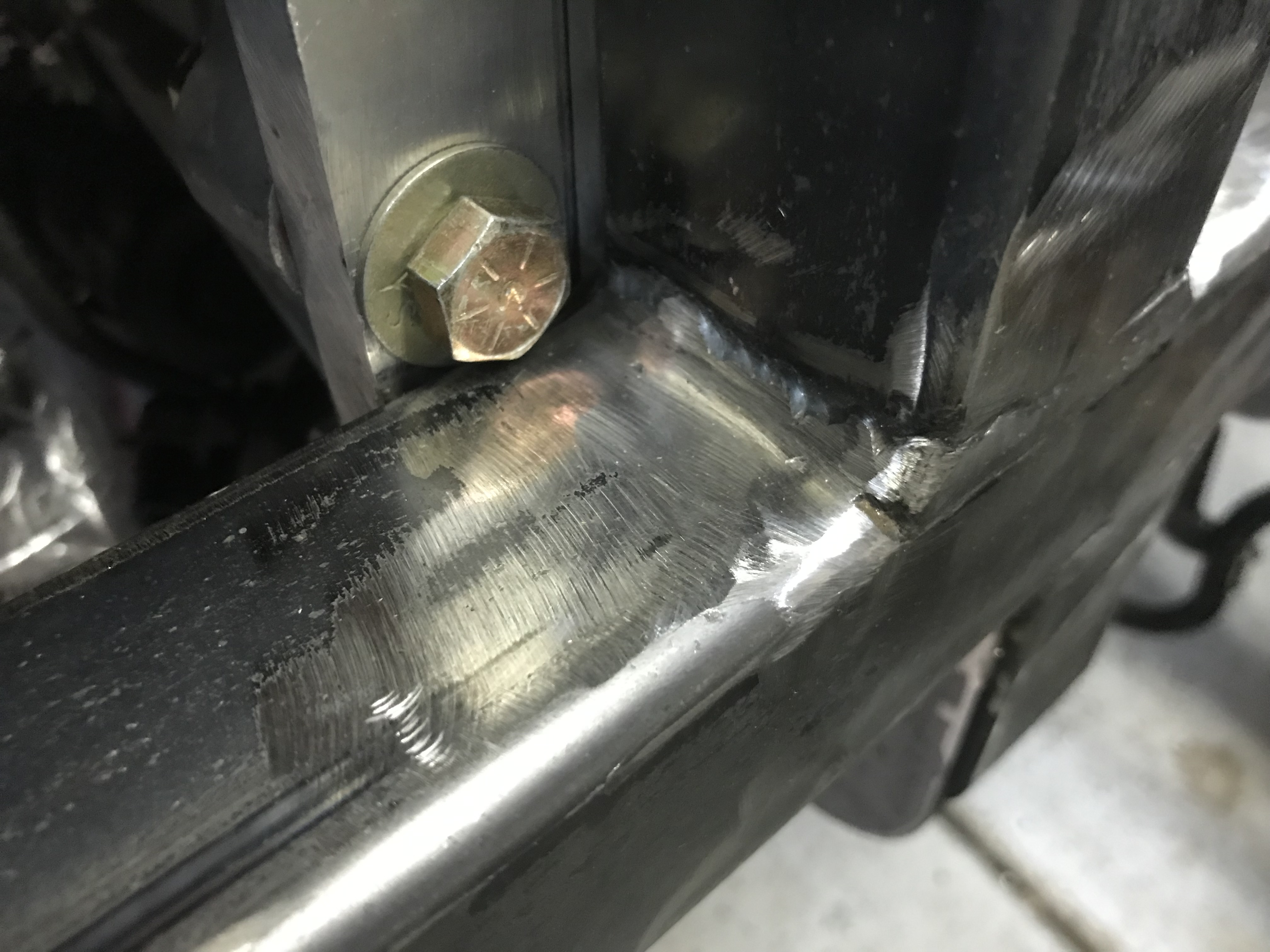

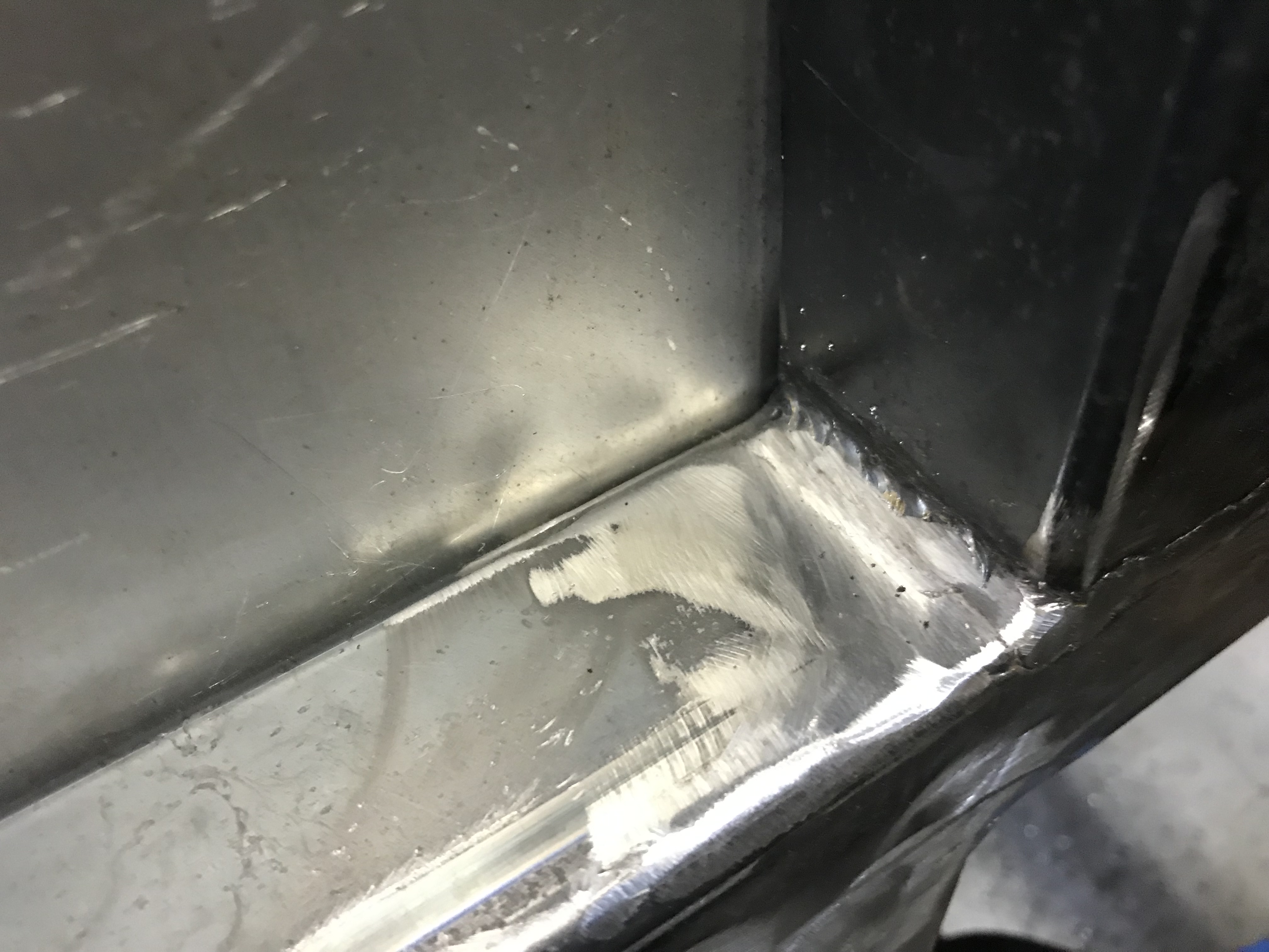

what's that Johannes? you want to see sum close ups of them joints/welds, why of course...
I think they pass the 50 foot test, flying colors!
mjc506
Posts: 343
Has thanked: 30 times
Been thanked: 29 times
Post by mjc506 »
That looks better than a lot of OEM efforts. Great work!

That front mount looks well up to the job, see how you go with the rear one but I think you may need something a little stiffer than those radiator bushes. Thanks again for posting in such detail, I for one really appreciate the thought and effort you put in.👍

mjc506 wrote: Thu Mar 31, 2022 2:35 pmThat looks better than a lot of OEM efforts. Great work!
can you read the bottom row mate, no seriously thank you I appreciate the kind words

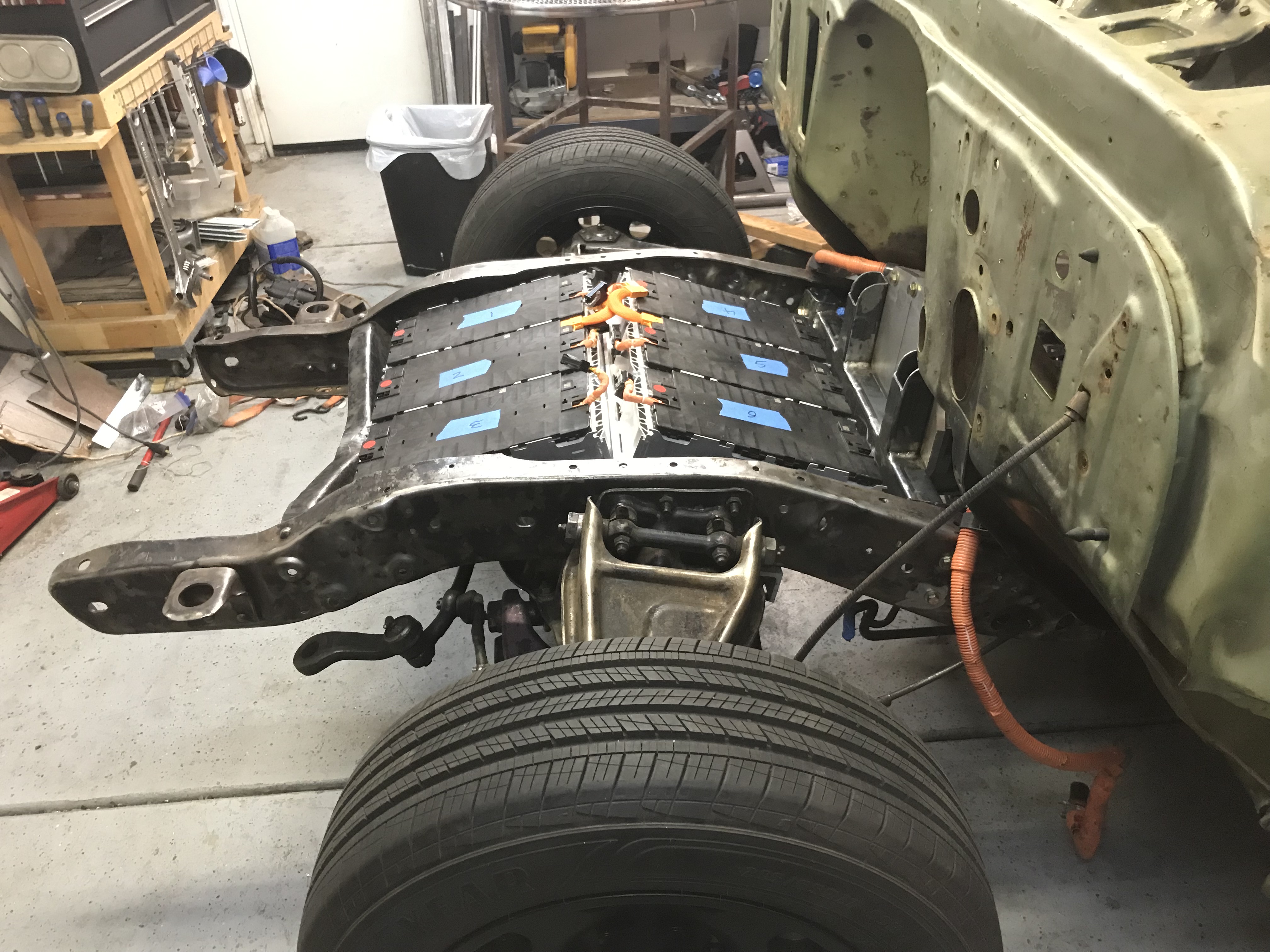

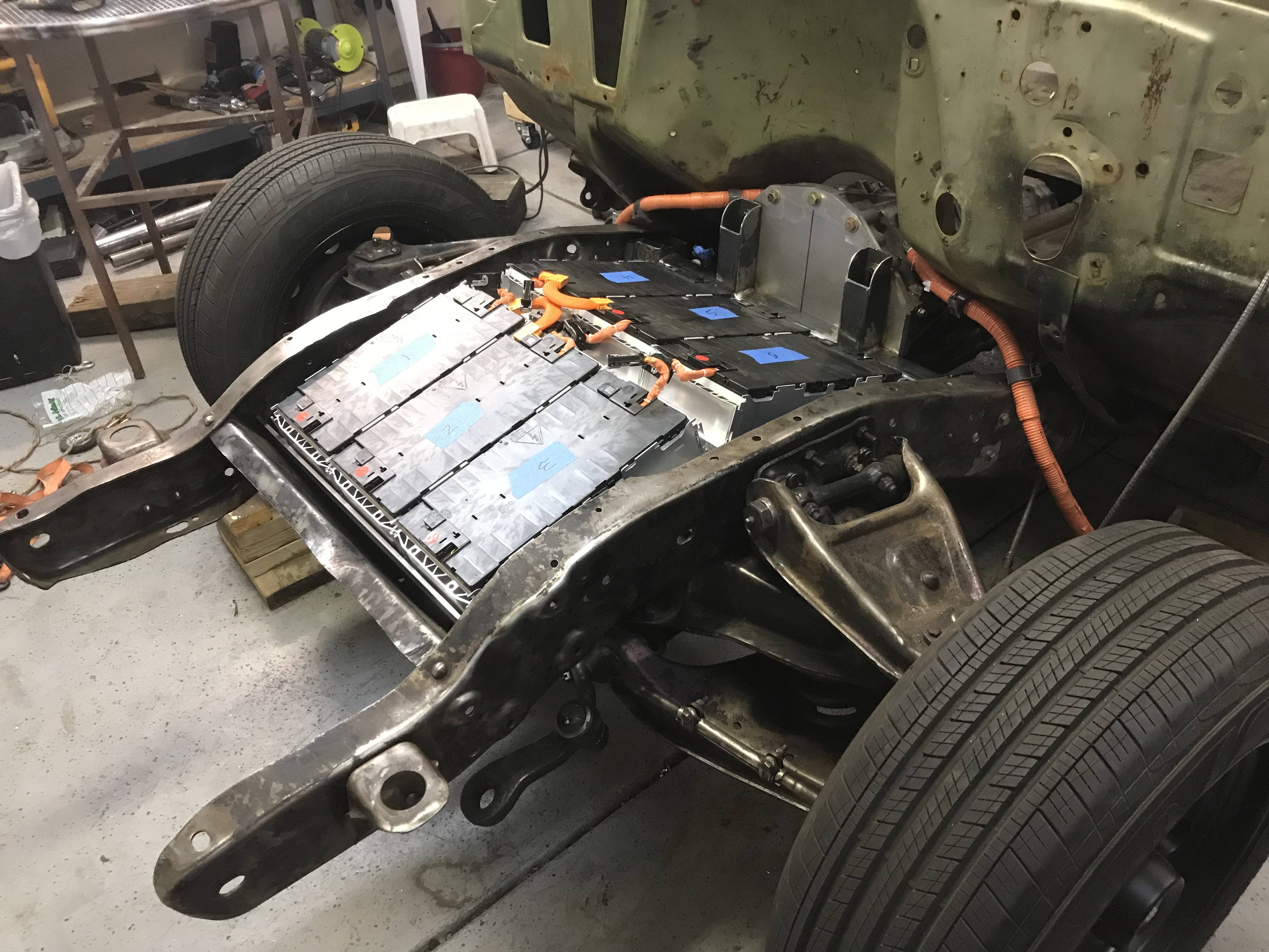

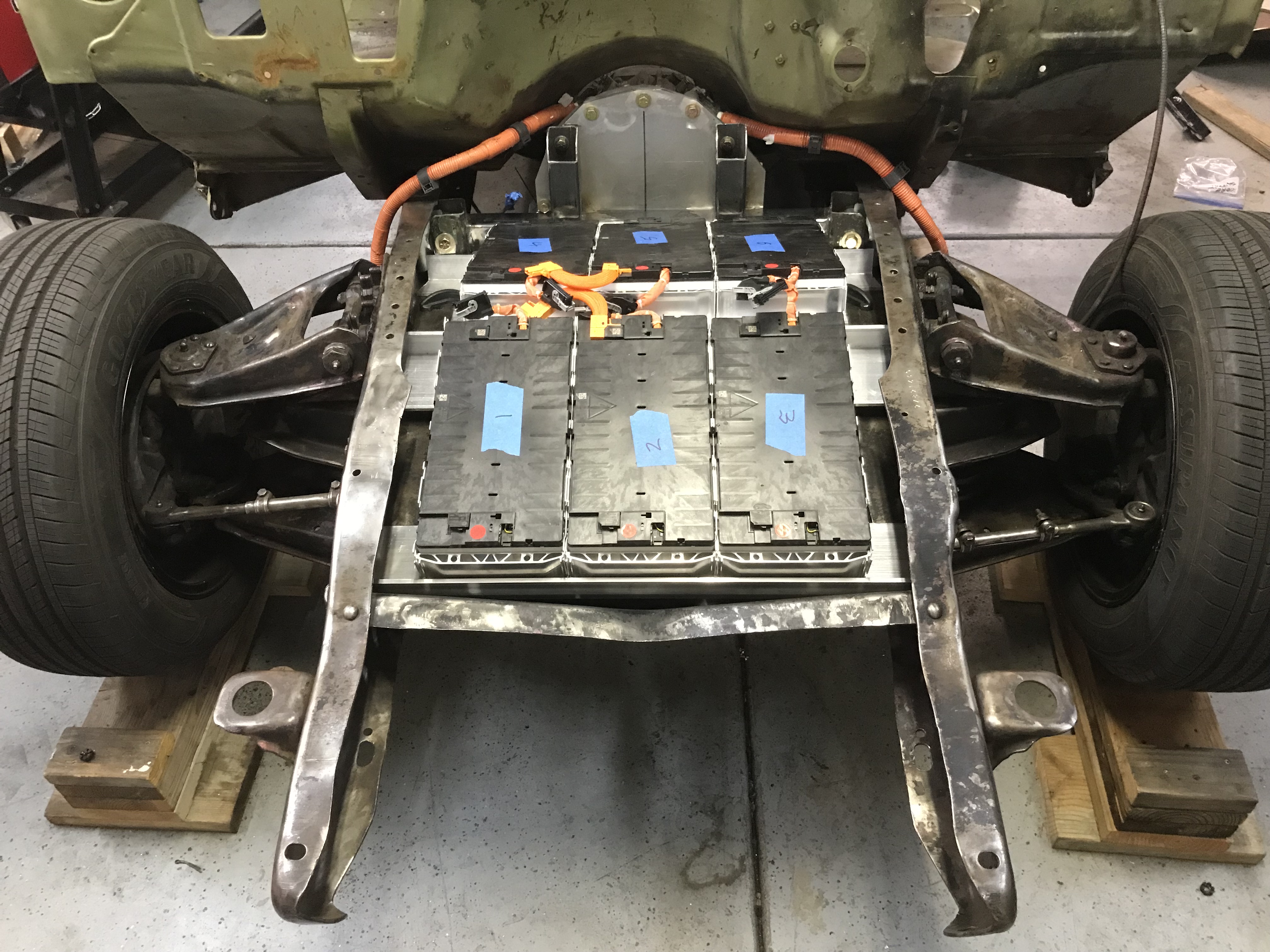

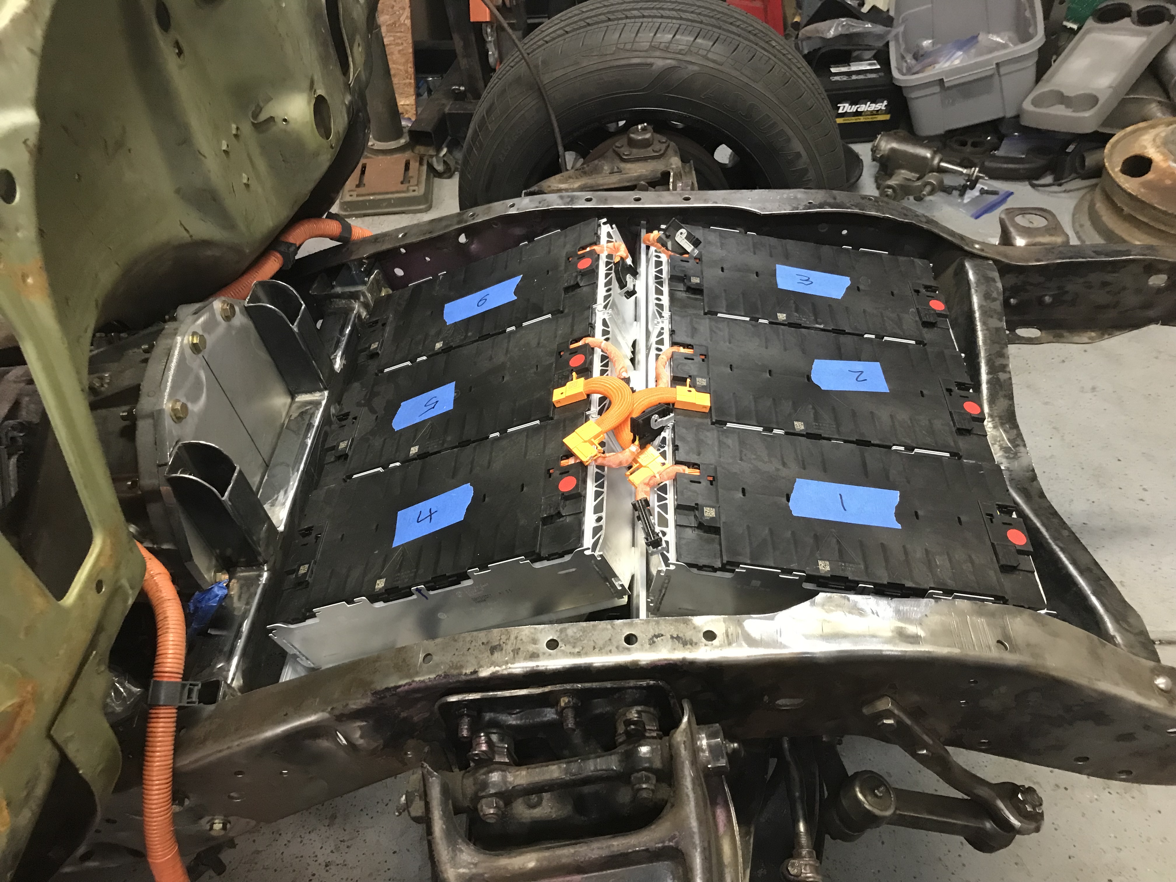

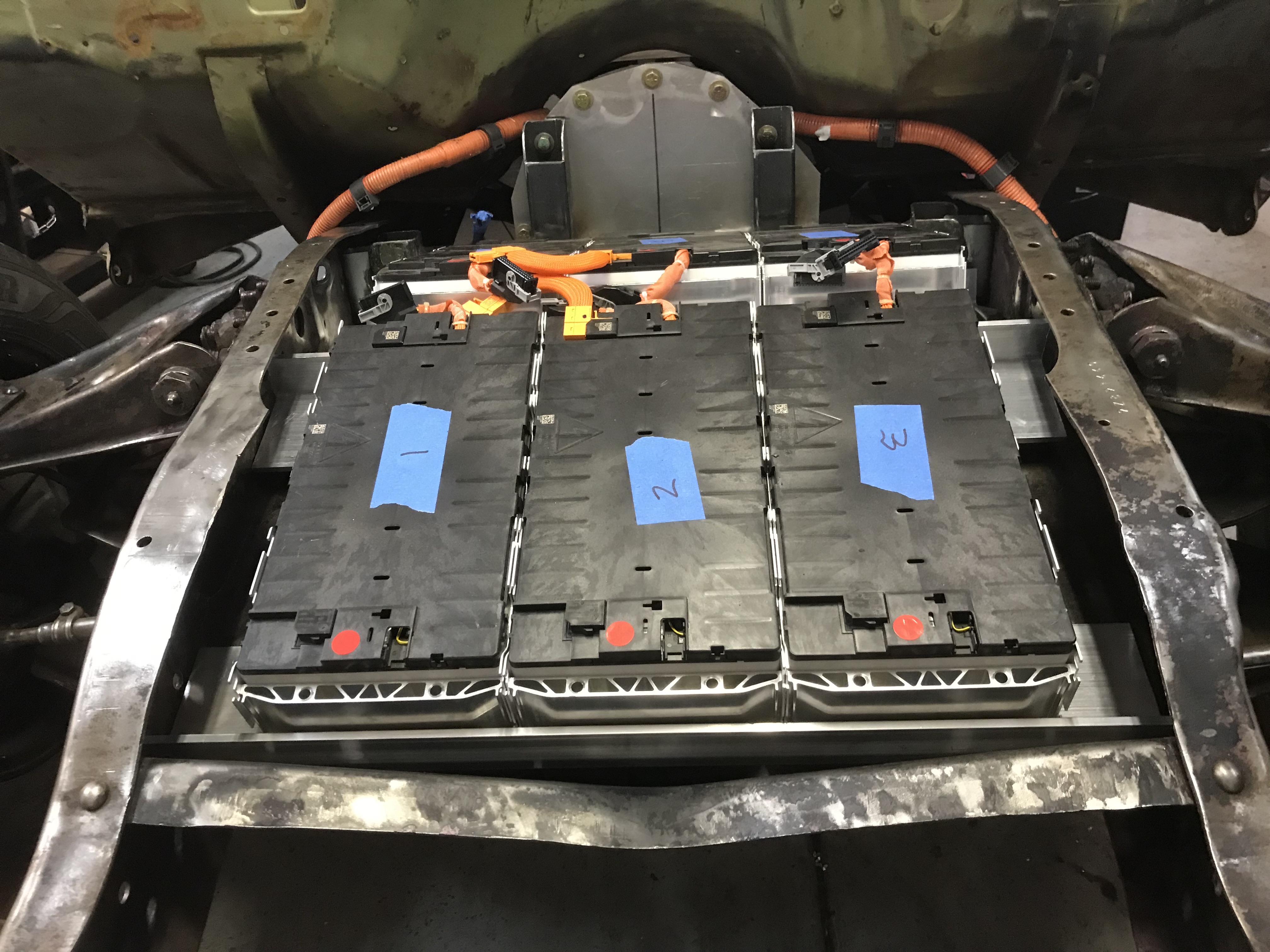

with the trans mount installed I was dying to try and fit the batteries back in there
Note: the sharp peak in the middle of the first battery pack is there because I have yet to cut holes for the engine crossmember bolts in the aluminum brackets, once I do that they will go down about 1 1/2"

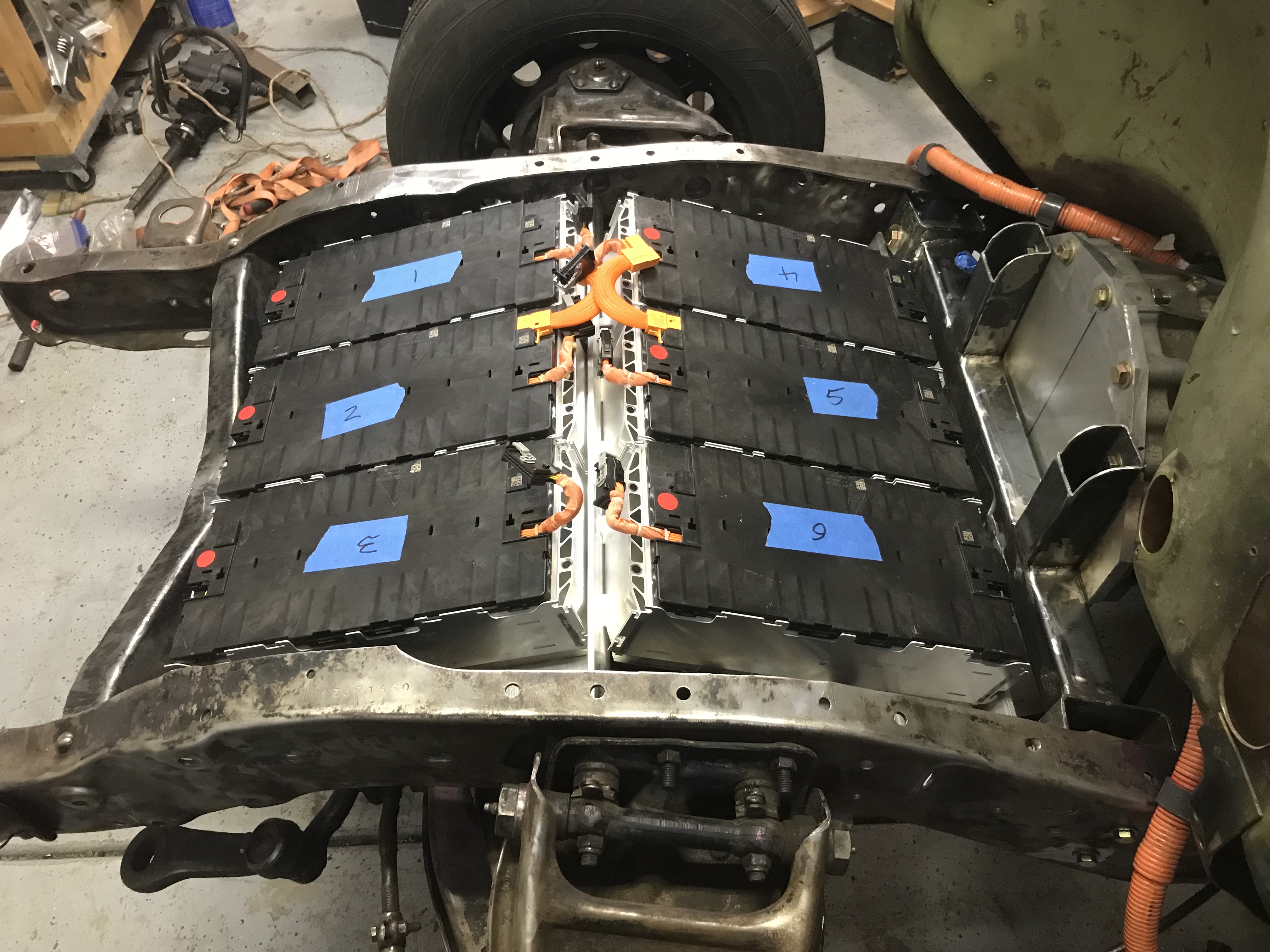

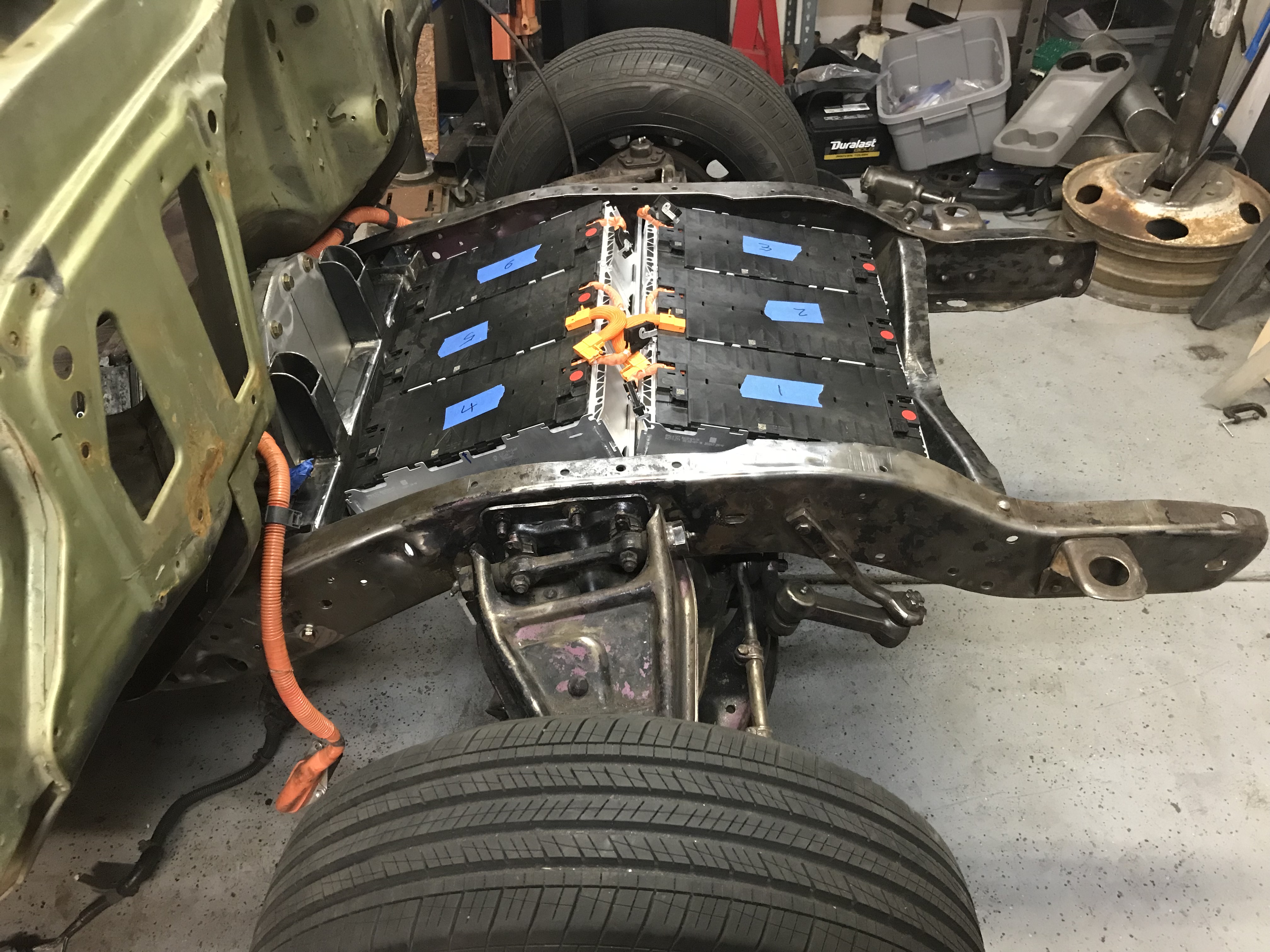

Gregski
Posts: 3164
Has thanked: 633 times
Been thanked: 1610 times
Post by Gregski »

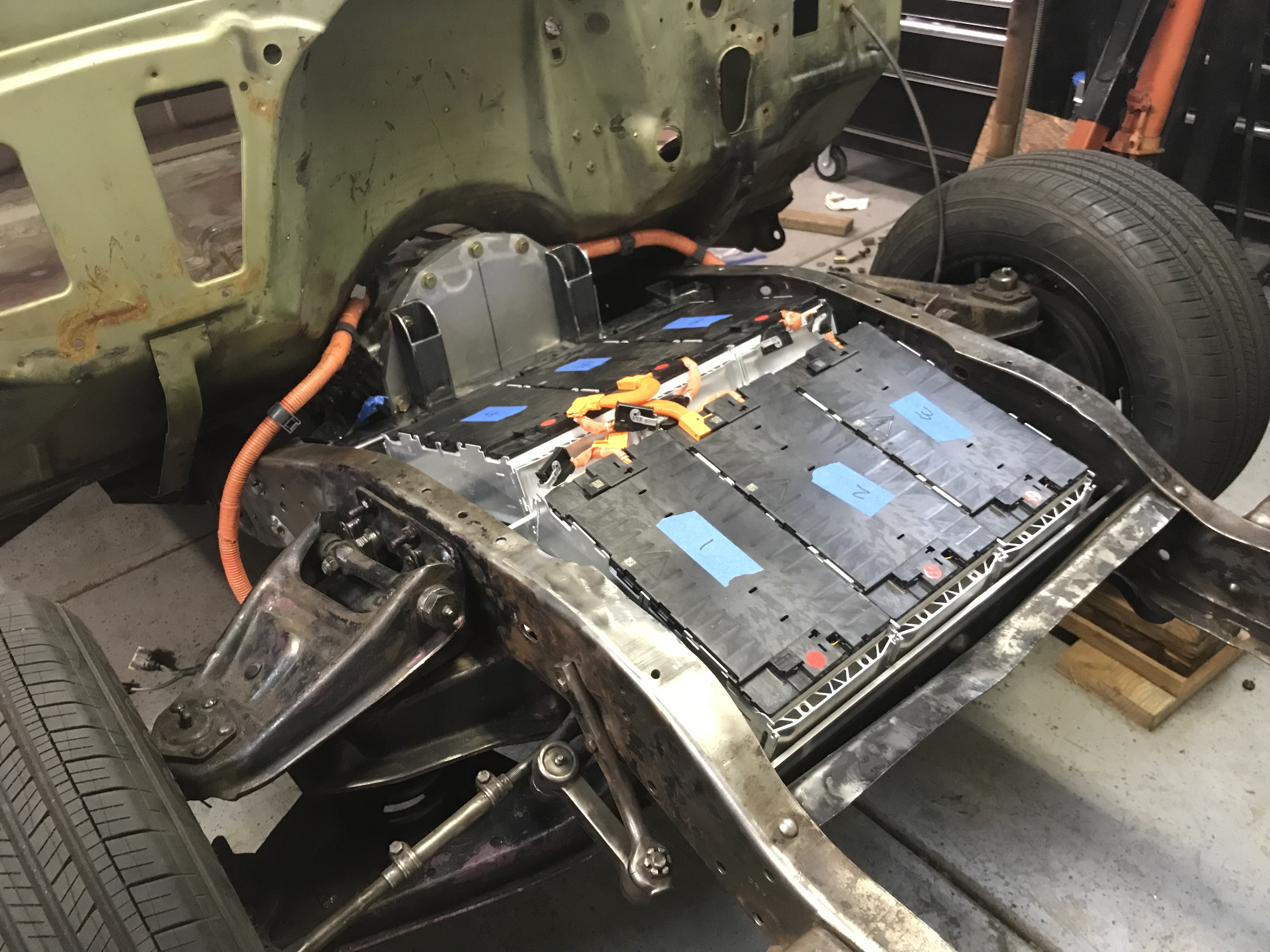

it's gonna be s!ck
same pics from a little bit of a step backness, just to try and take all that perspectus in

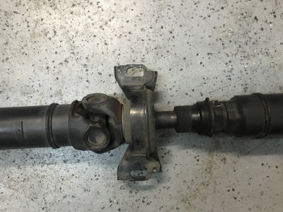

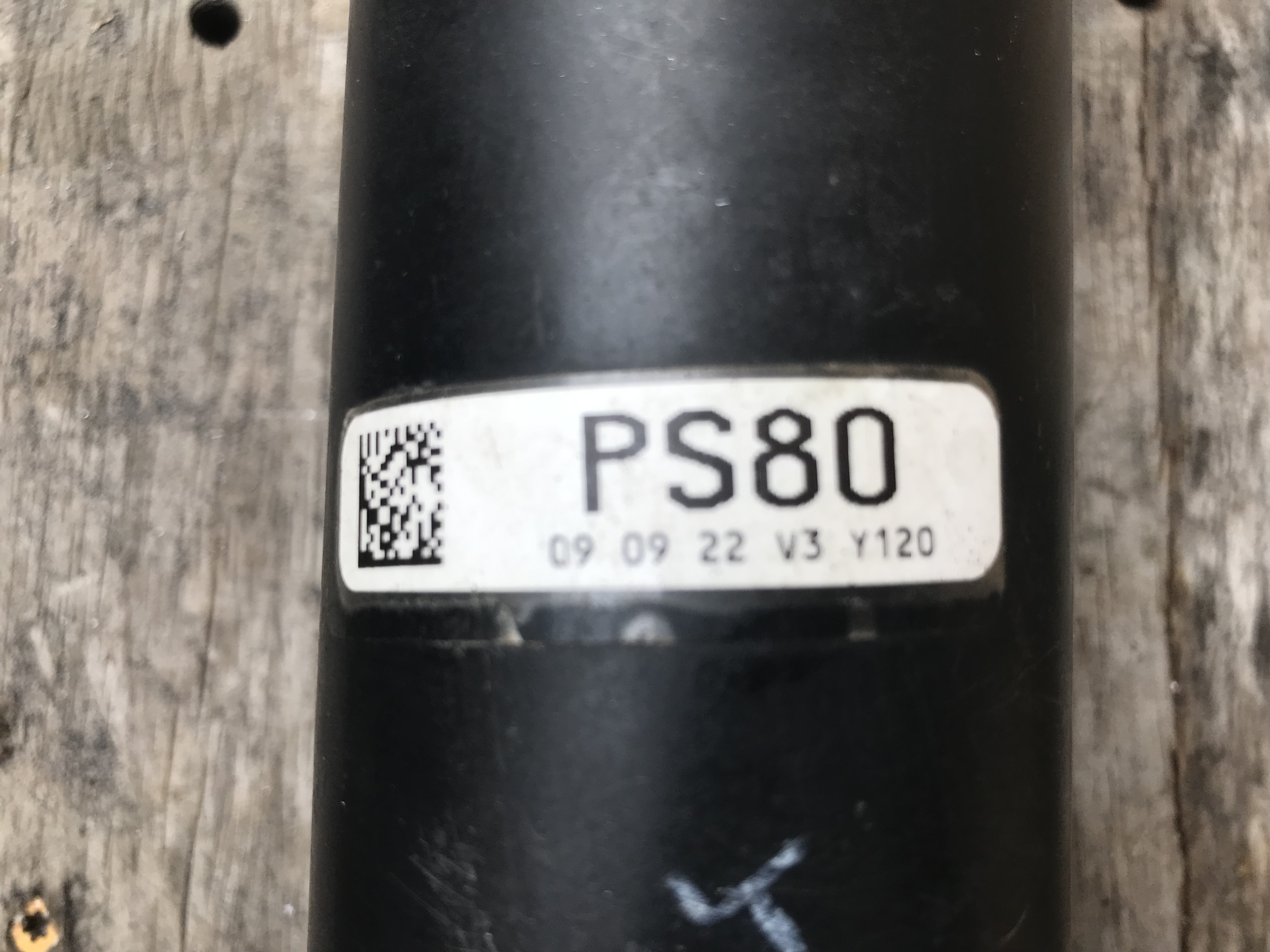

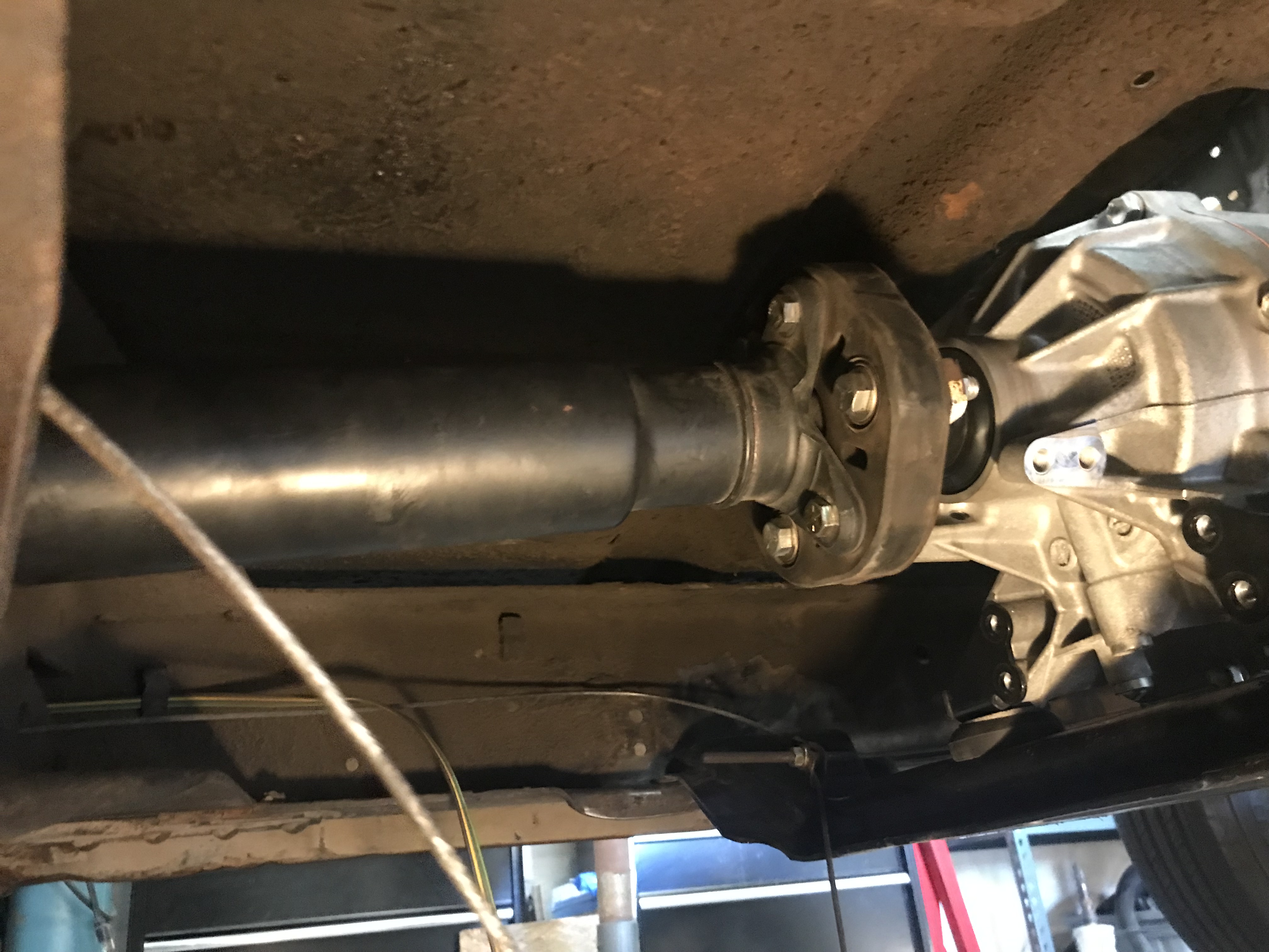

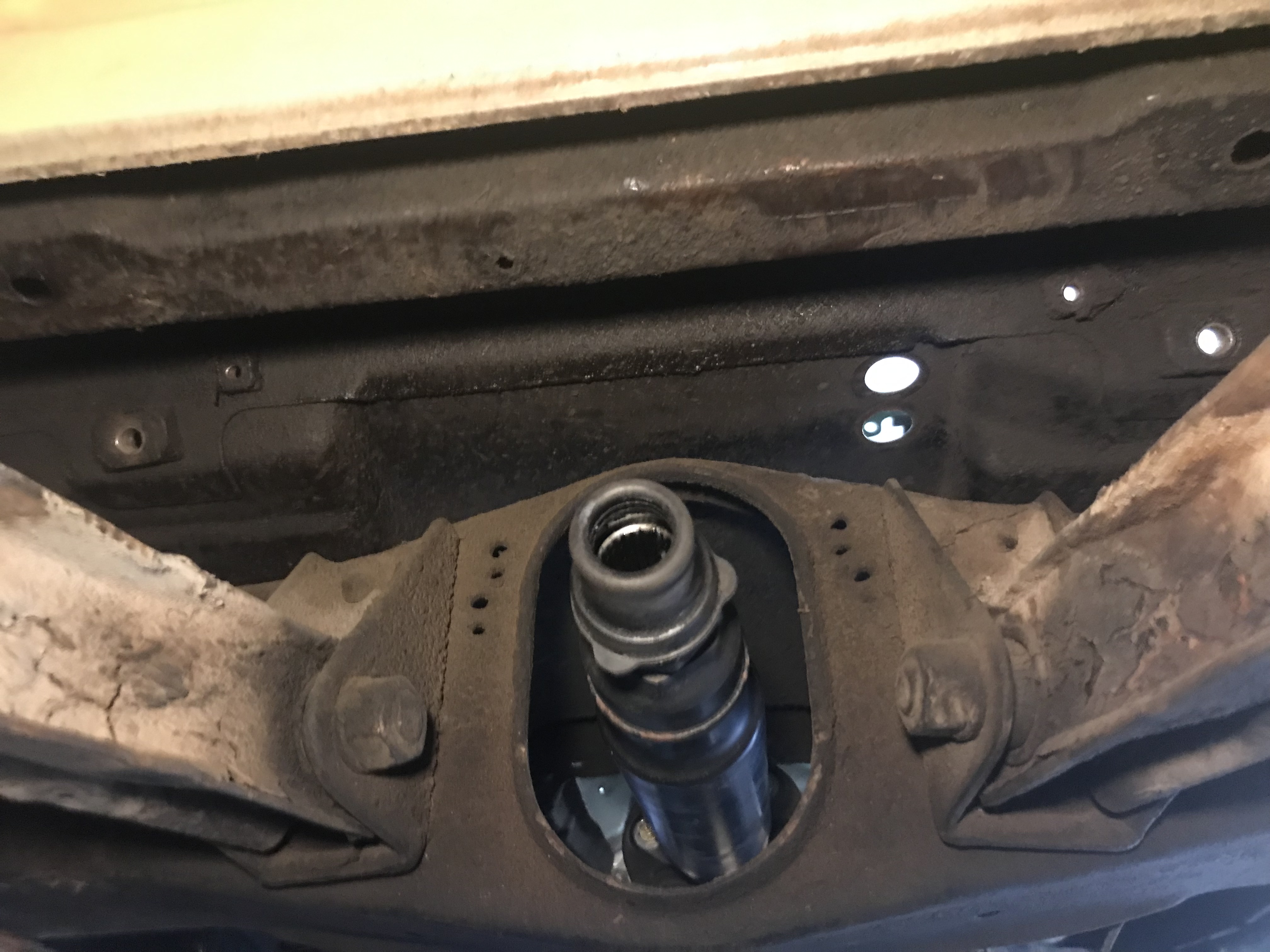

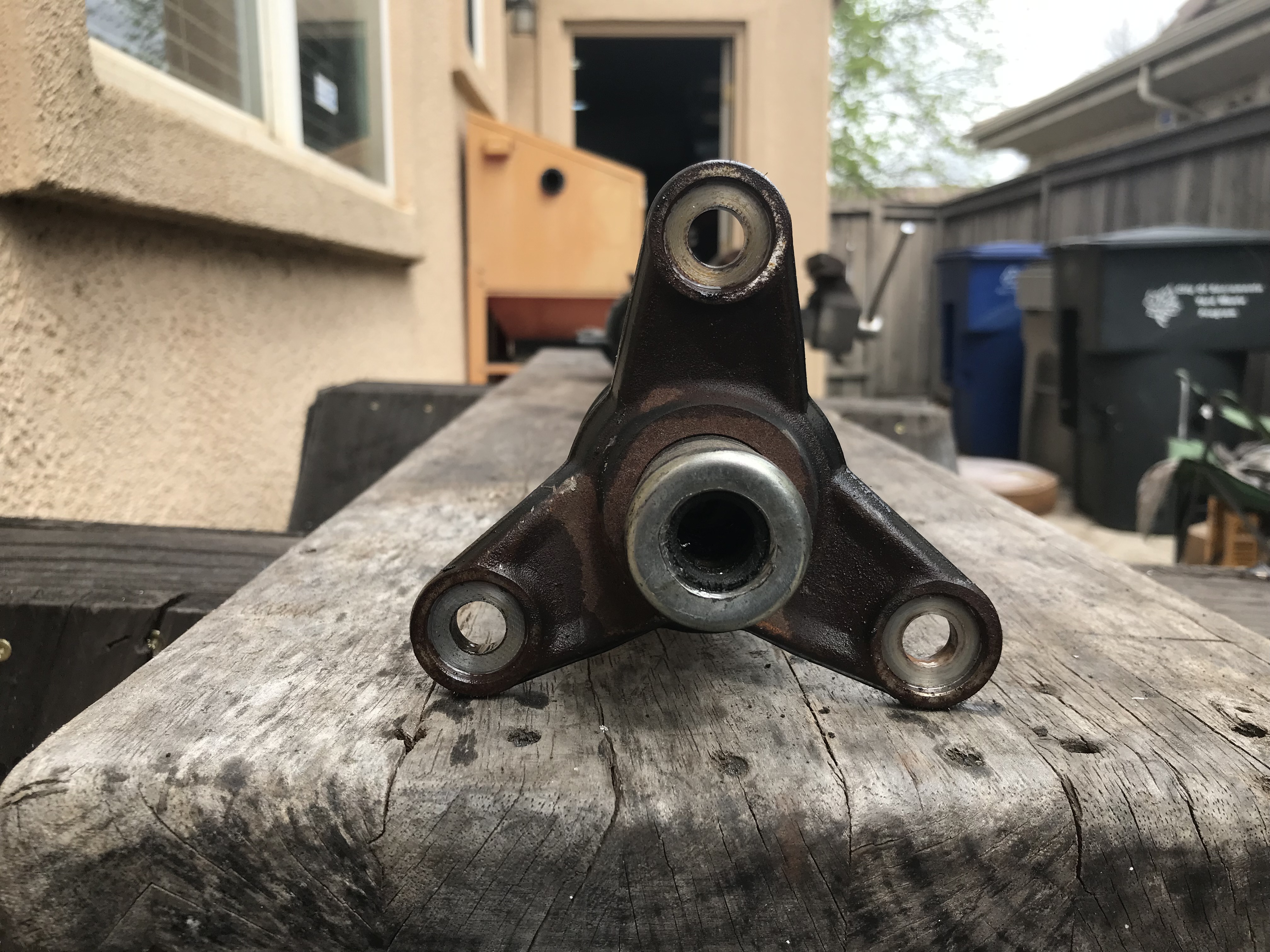

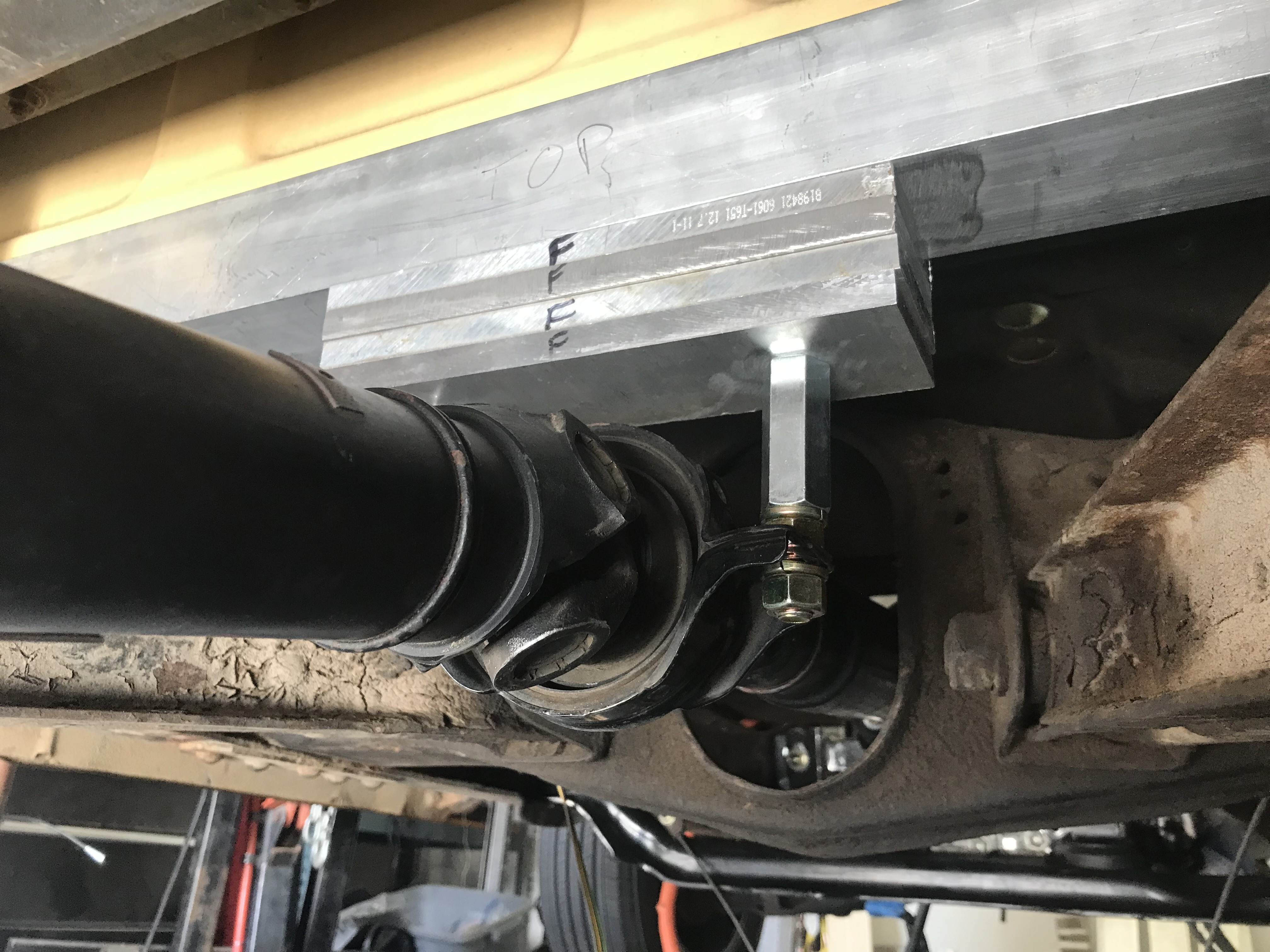

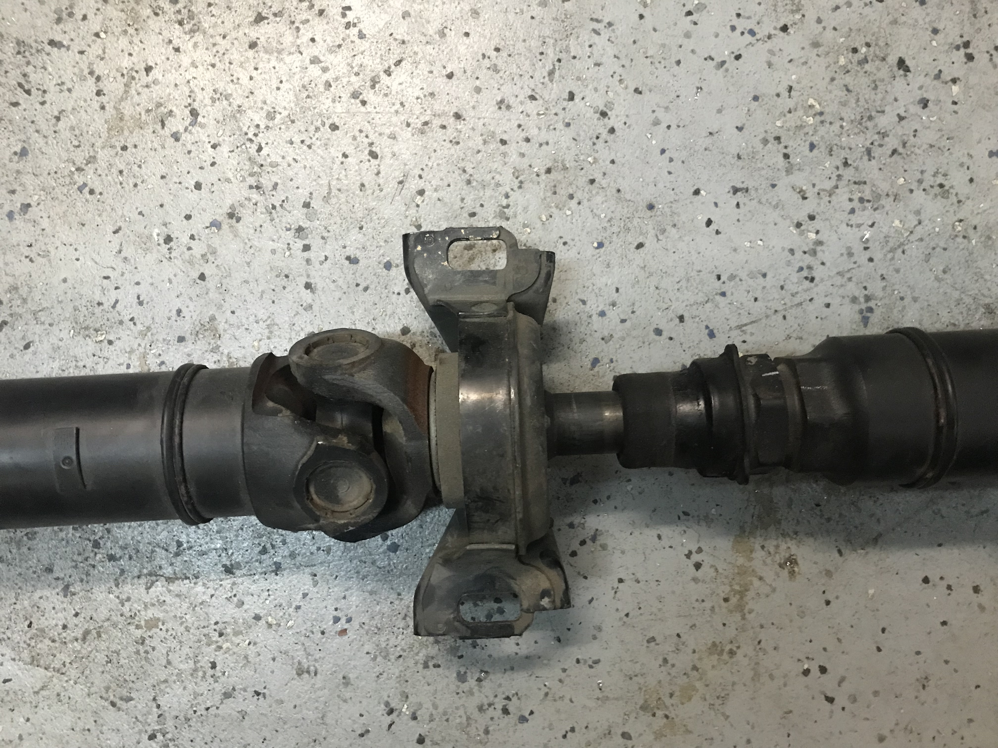

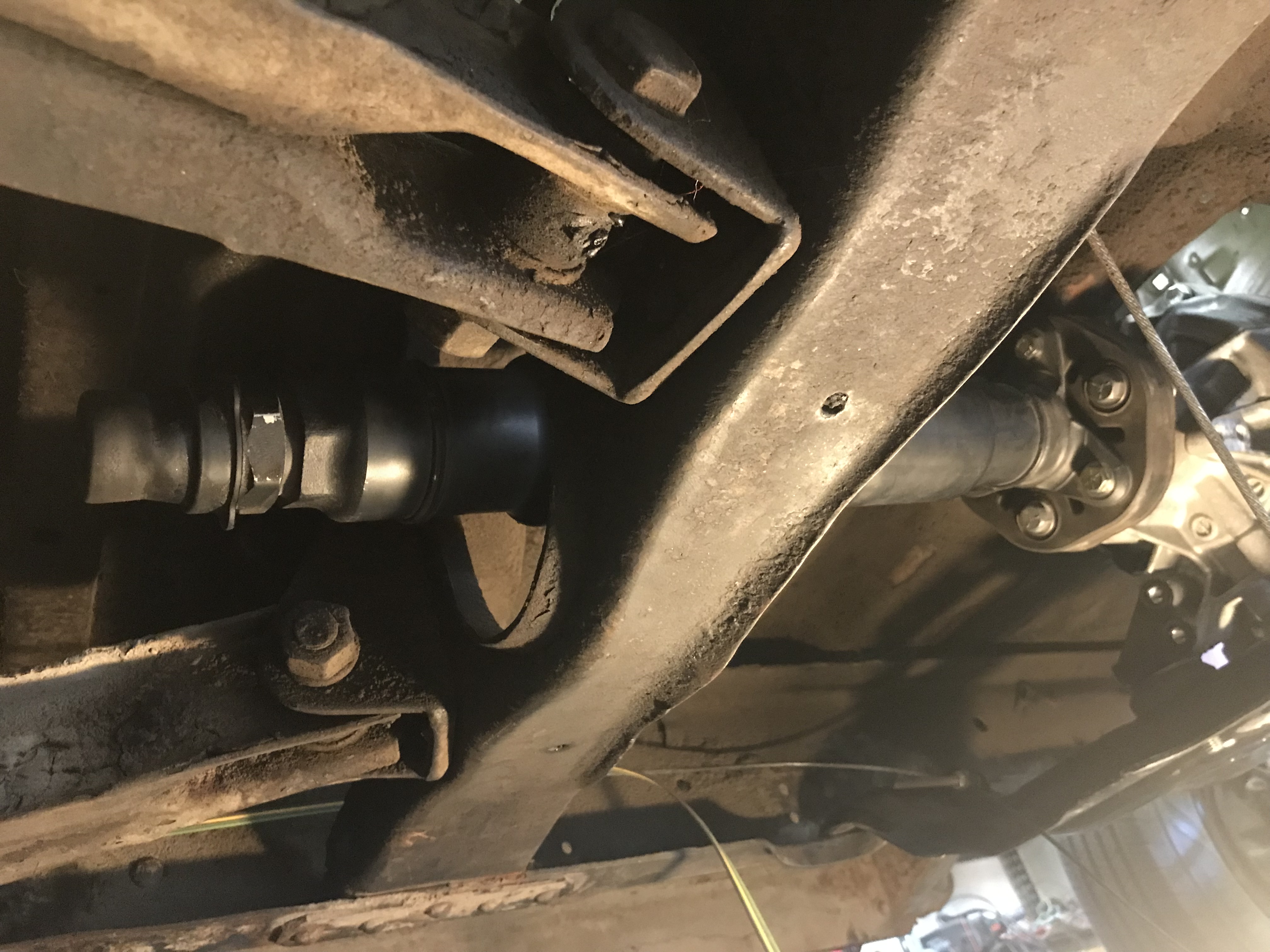

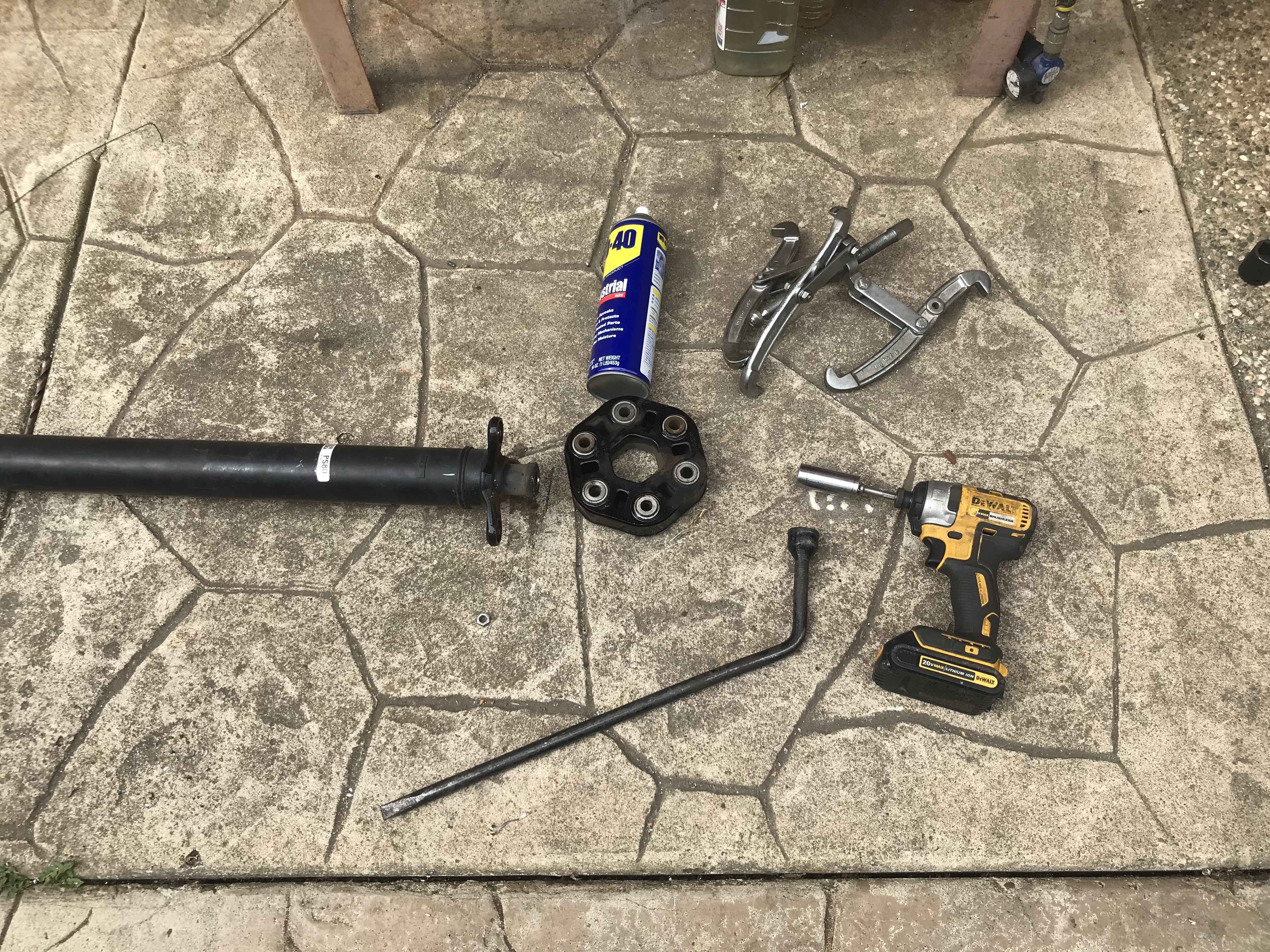

I got the stock OEM Lexus GS450h two piece drive shaft so I started to work on the middle donut support mount, I believe it's crucialistic that the short shaft is perfectly in line with the transmission
I started out by divorcing the two pieces just to make the short stick lighter and easier to work with, plus mounting it by itself gave me a line of sight to test with my eyecrometer

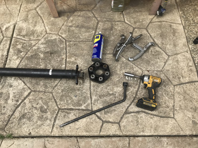

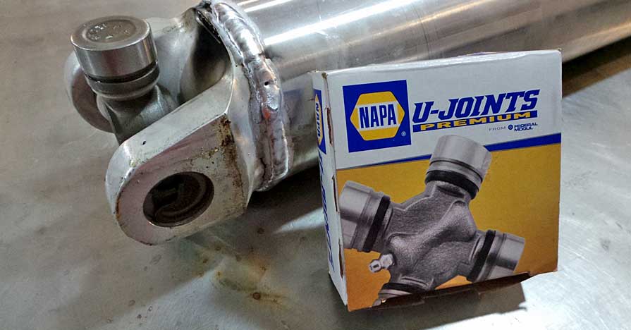

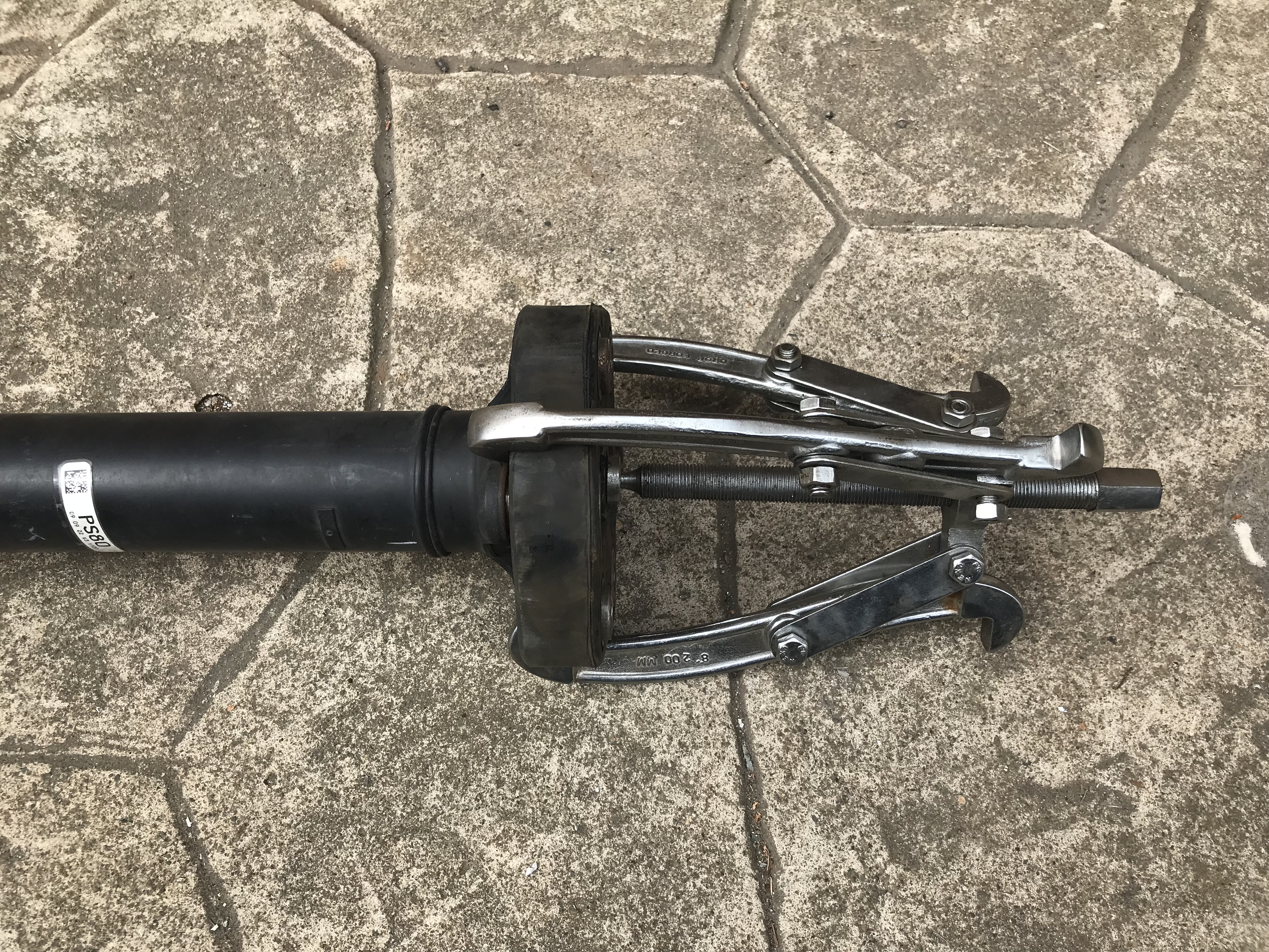

I also chose to remove the bulky rubber doo dad off the long shaft, at the end that would mate with a Lexus differential
this is where we will welder up an "American" [pronounced: Universal] joint

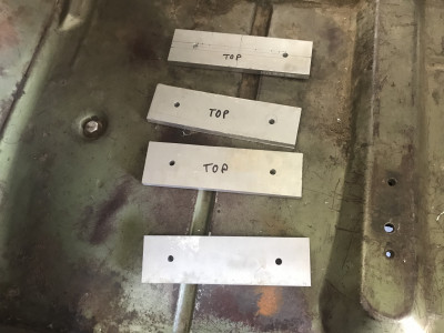

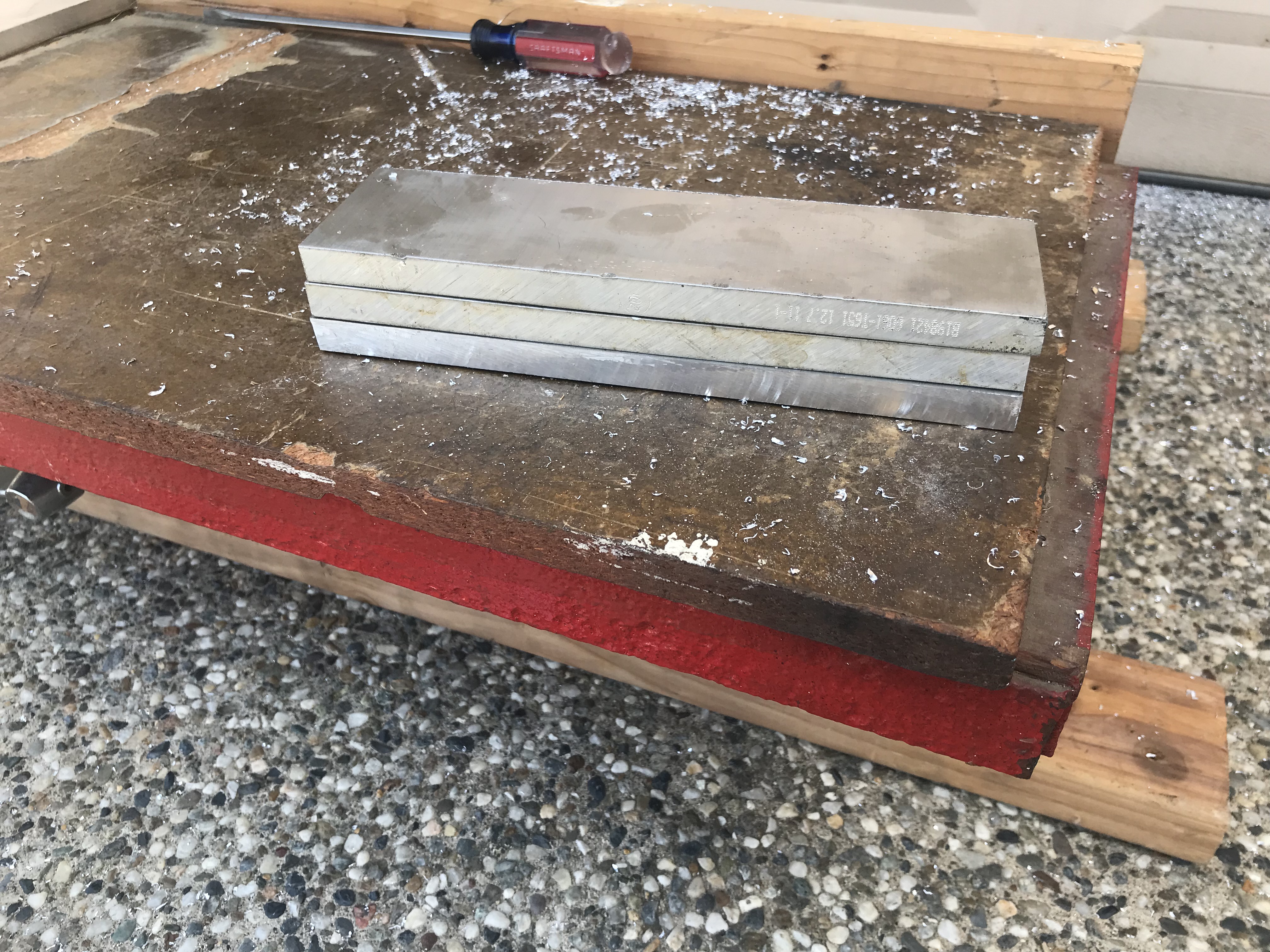

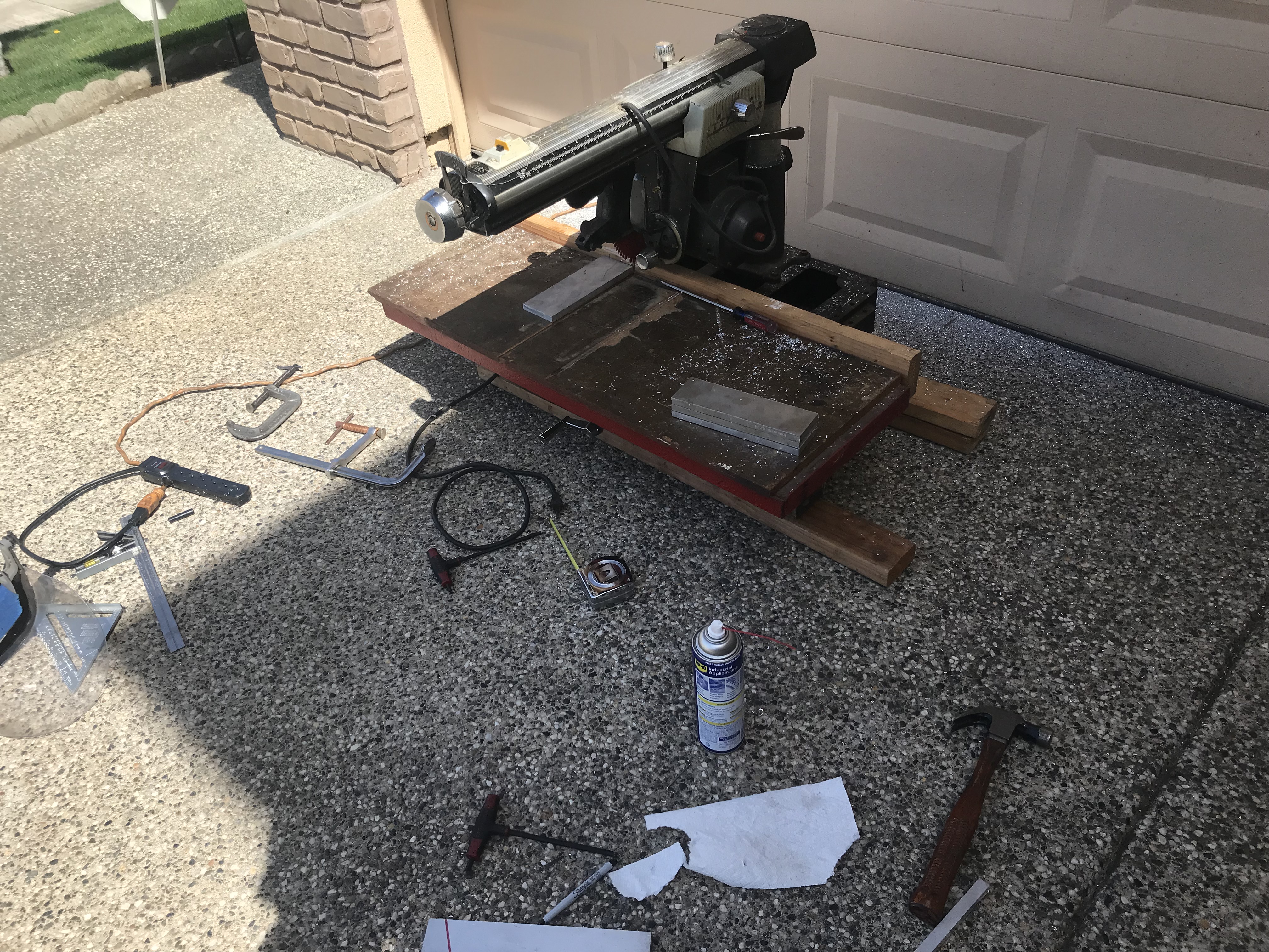

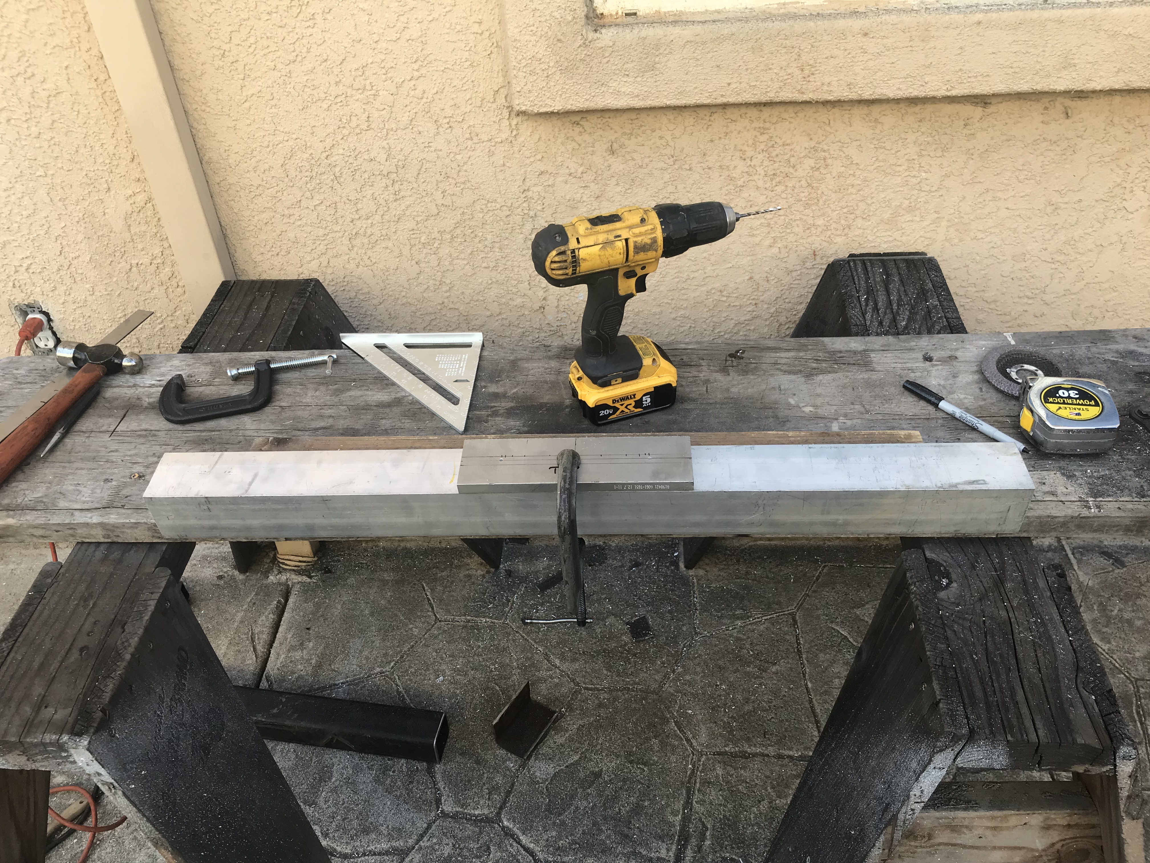

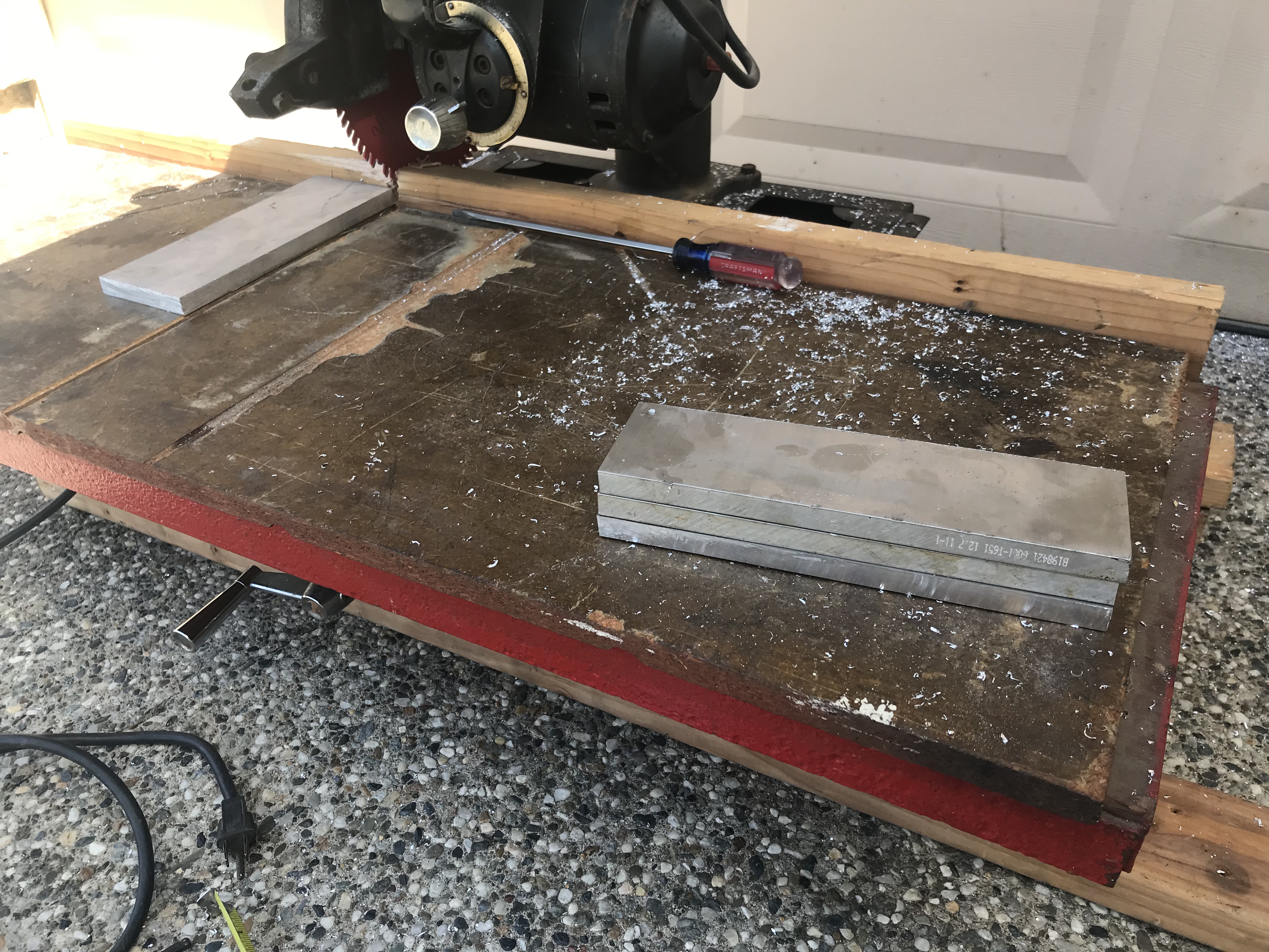

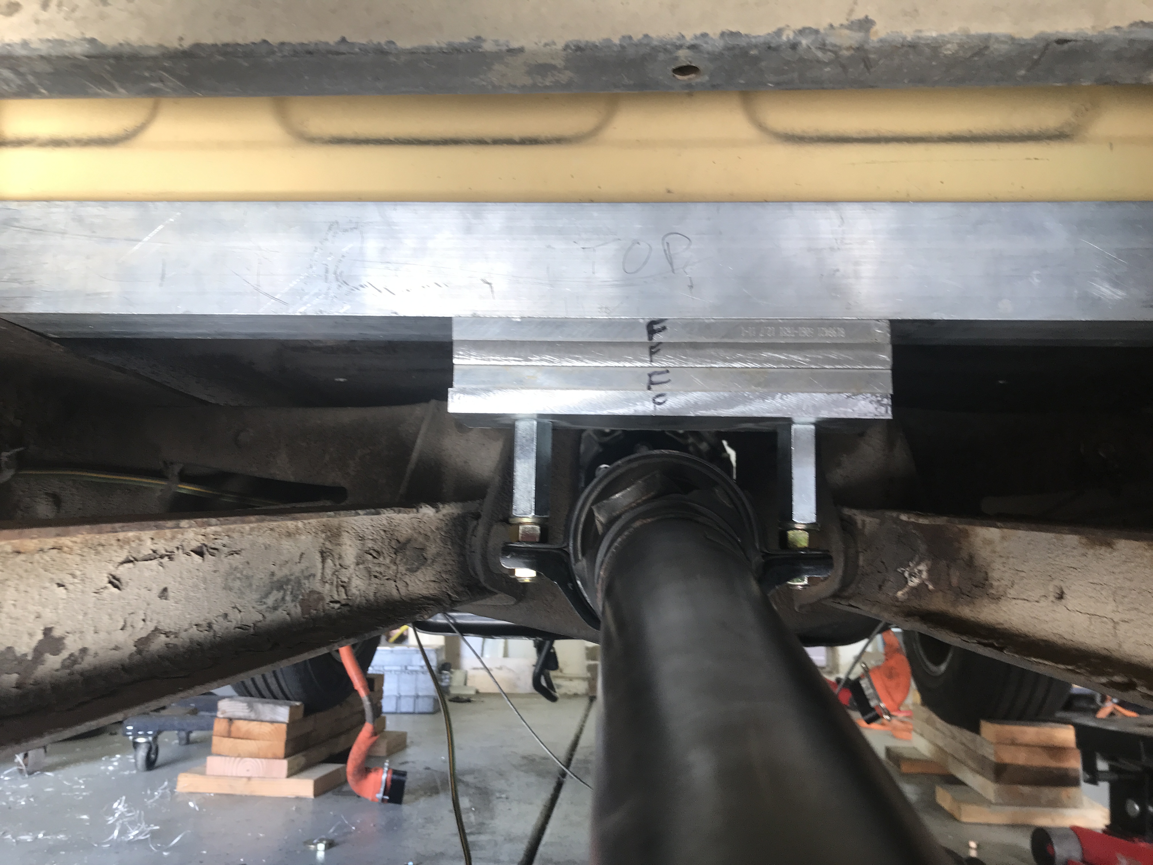

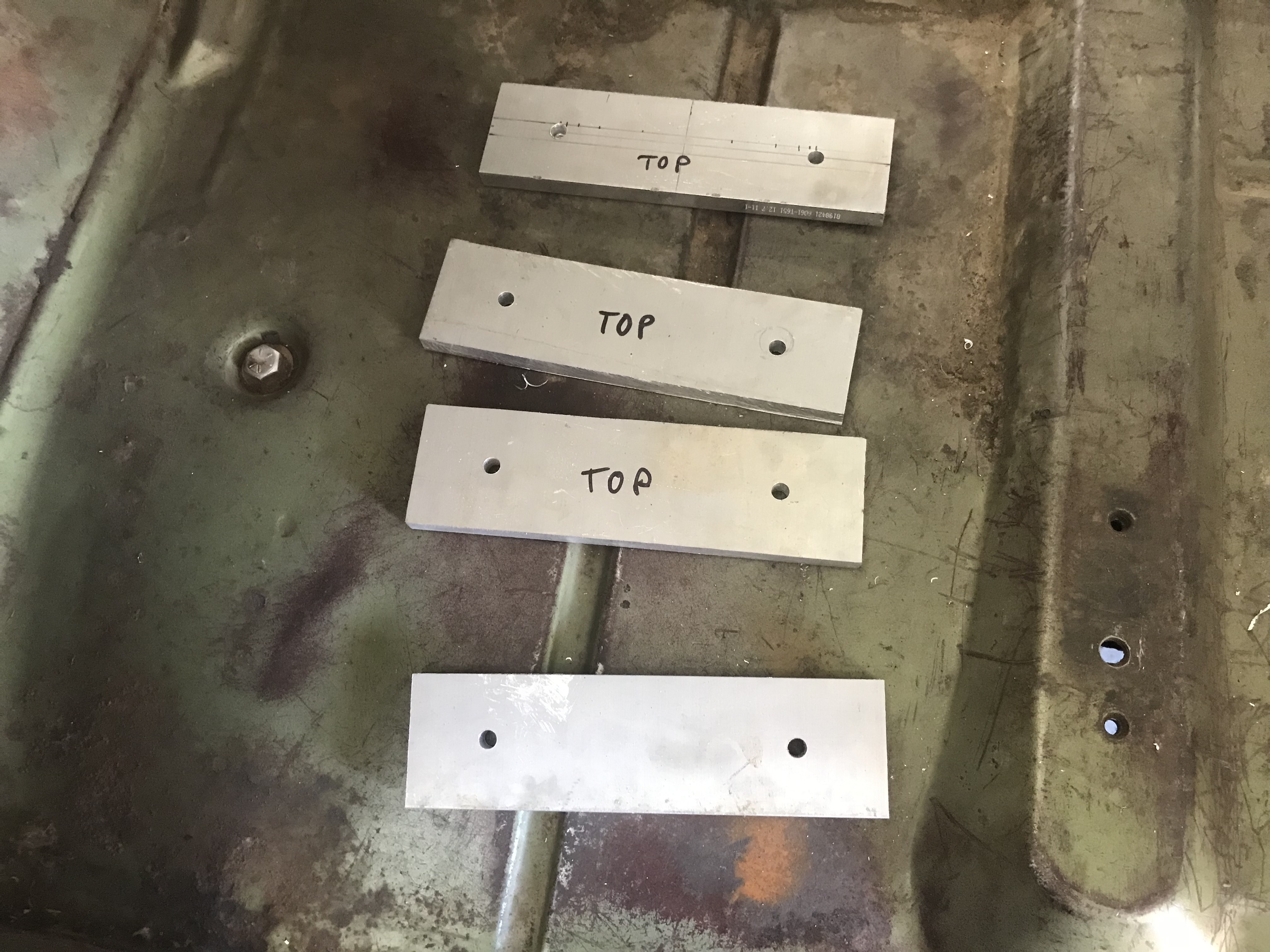

next it was time to stack sum plates
for this I decided to work out front in my driveway, figuring it's been days since my last HOA complaint!
Gregski
Posts: 3164
Post by Gregski »

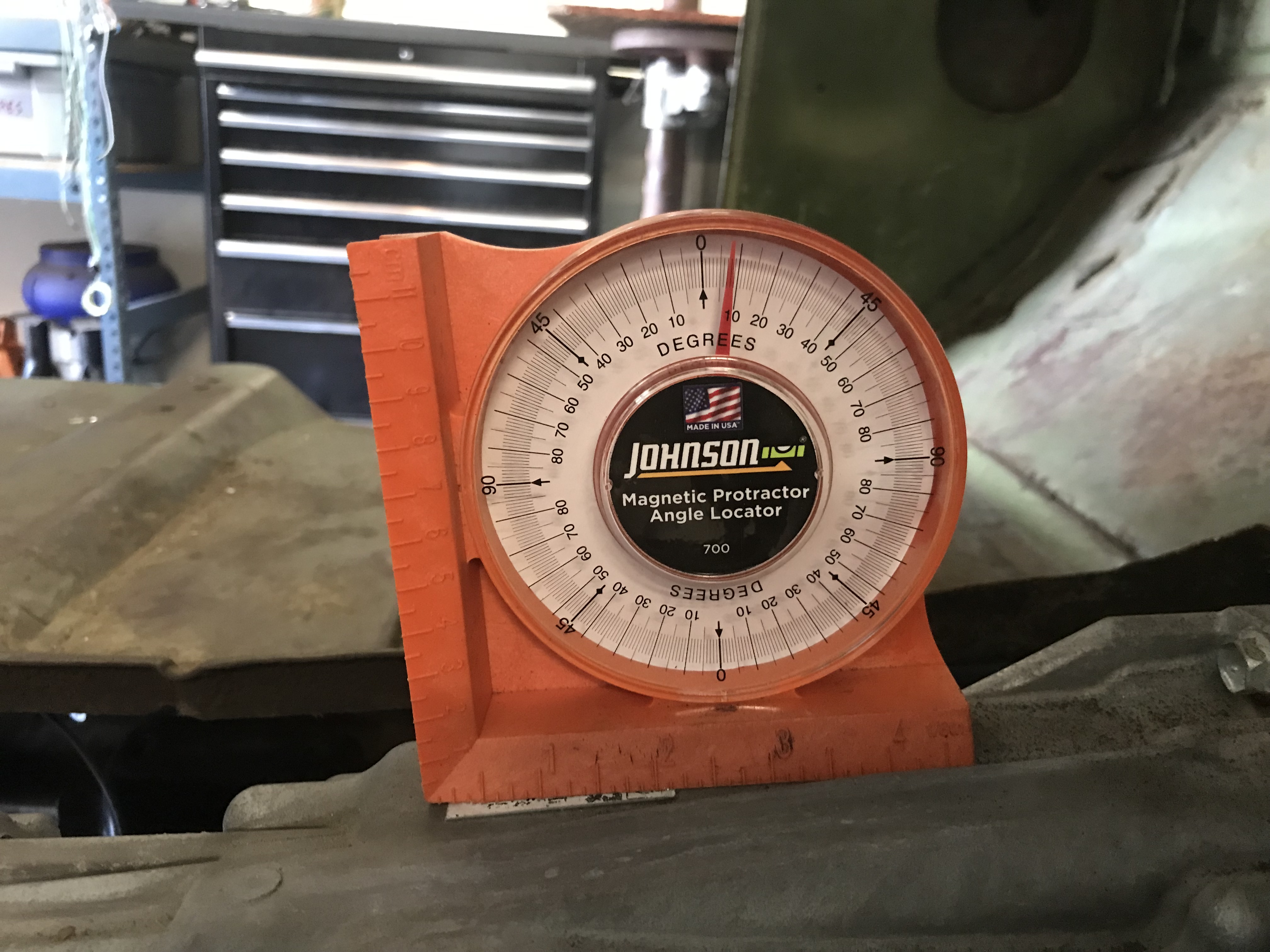

here I'm just showing off my protractor and sliding ruler skillz

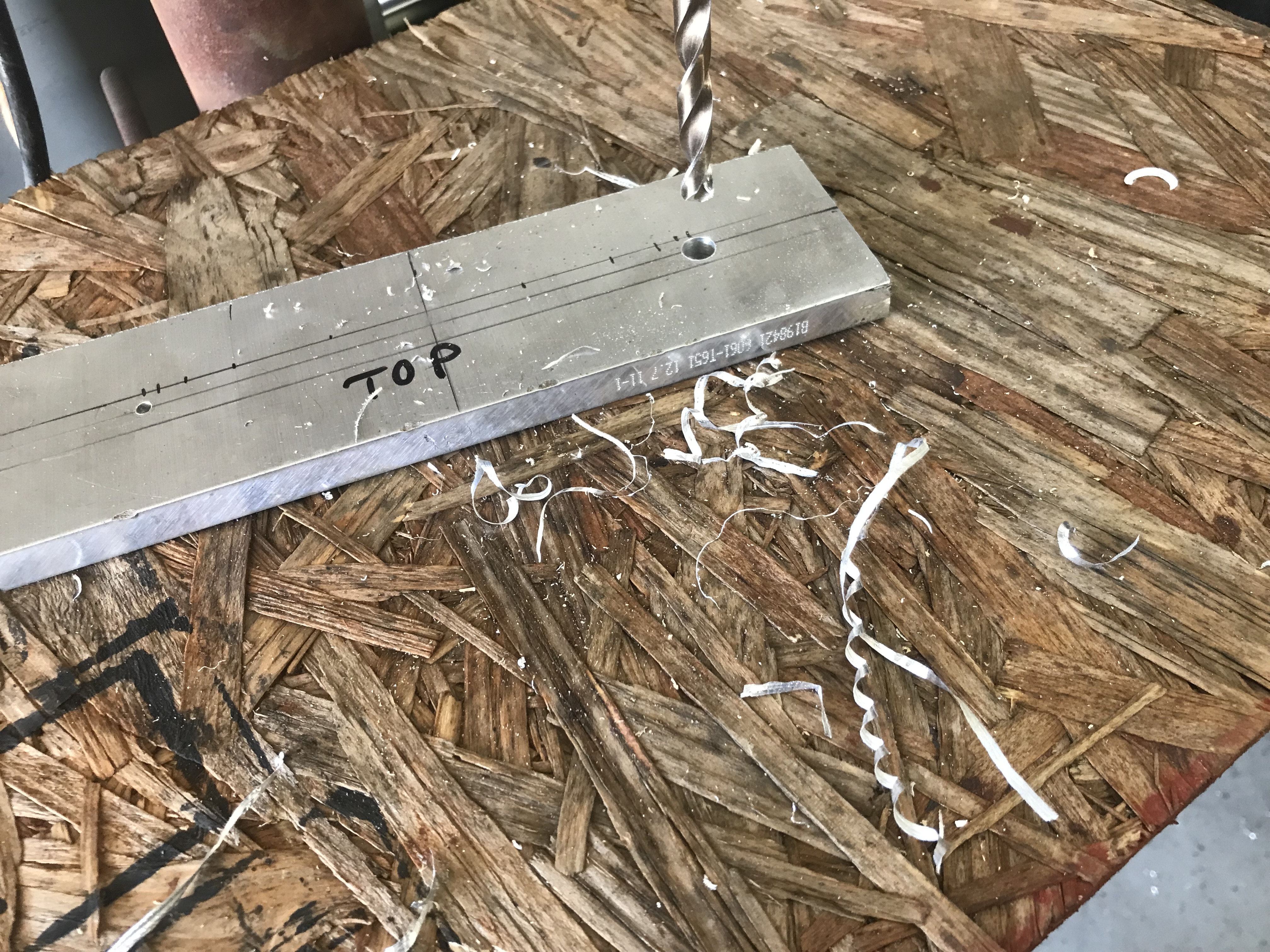

Post by Gregski »

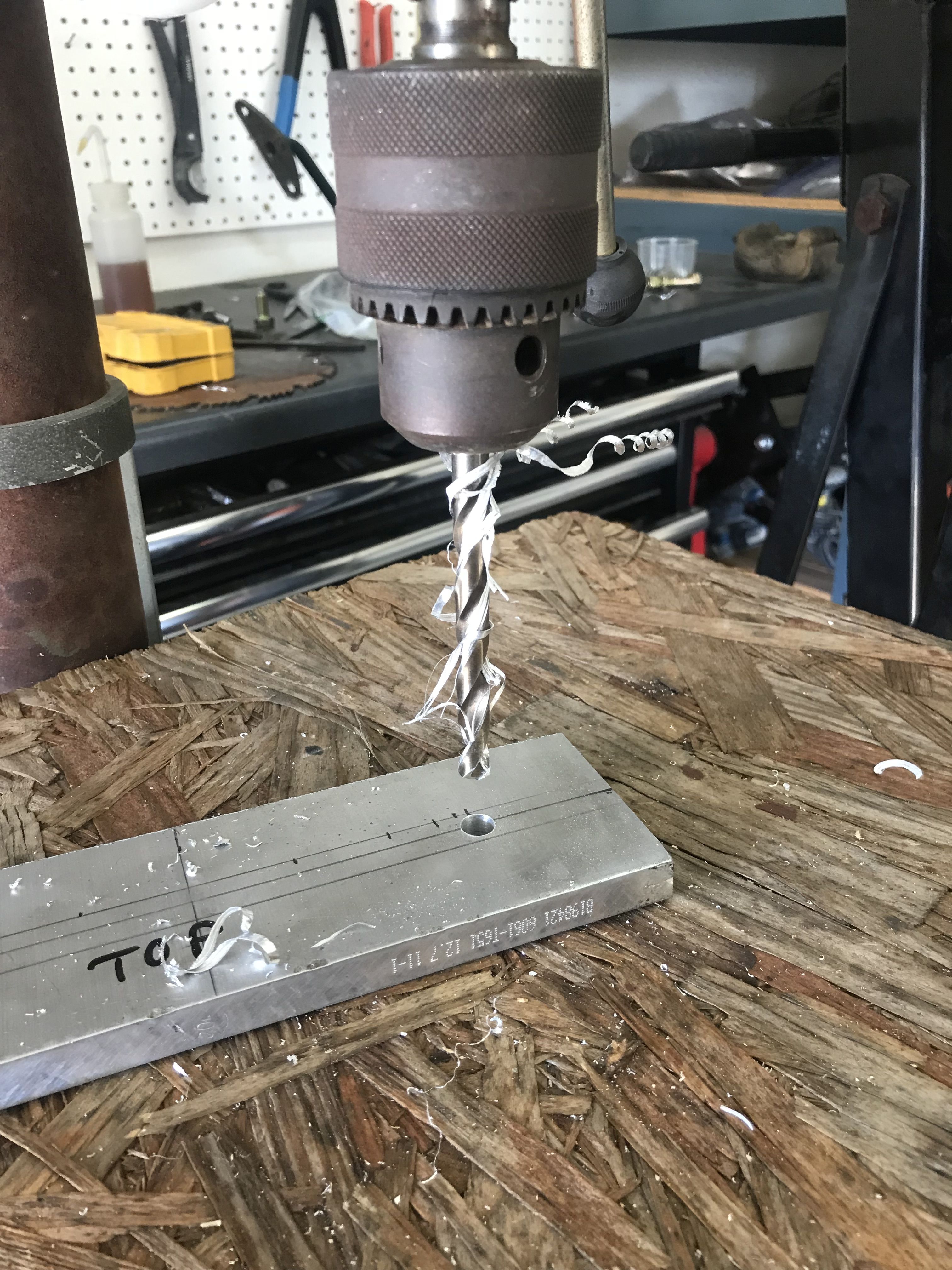

Public Service Announcement
If your drill remnants look like this, this means you have a good sharp drill bit. This is Goodness!
If they look like sparkle glitter that means you have a bad dull drill bit. This is not good.

I like the "folding" battery pack, should offer a bit of useful passive safety in the event of a front end collision.

poking holes
Gregski
Posts: 3164
Post by Gregski »
yes, but what is he making ???
Gregski
Posts: 3164
Post by Gregski »

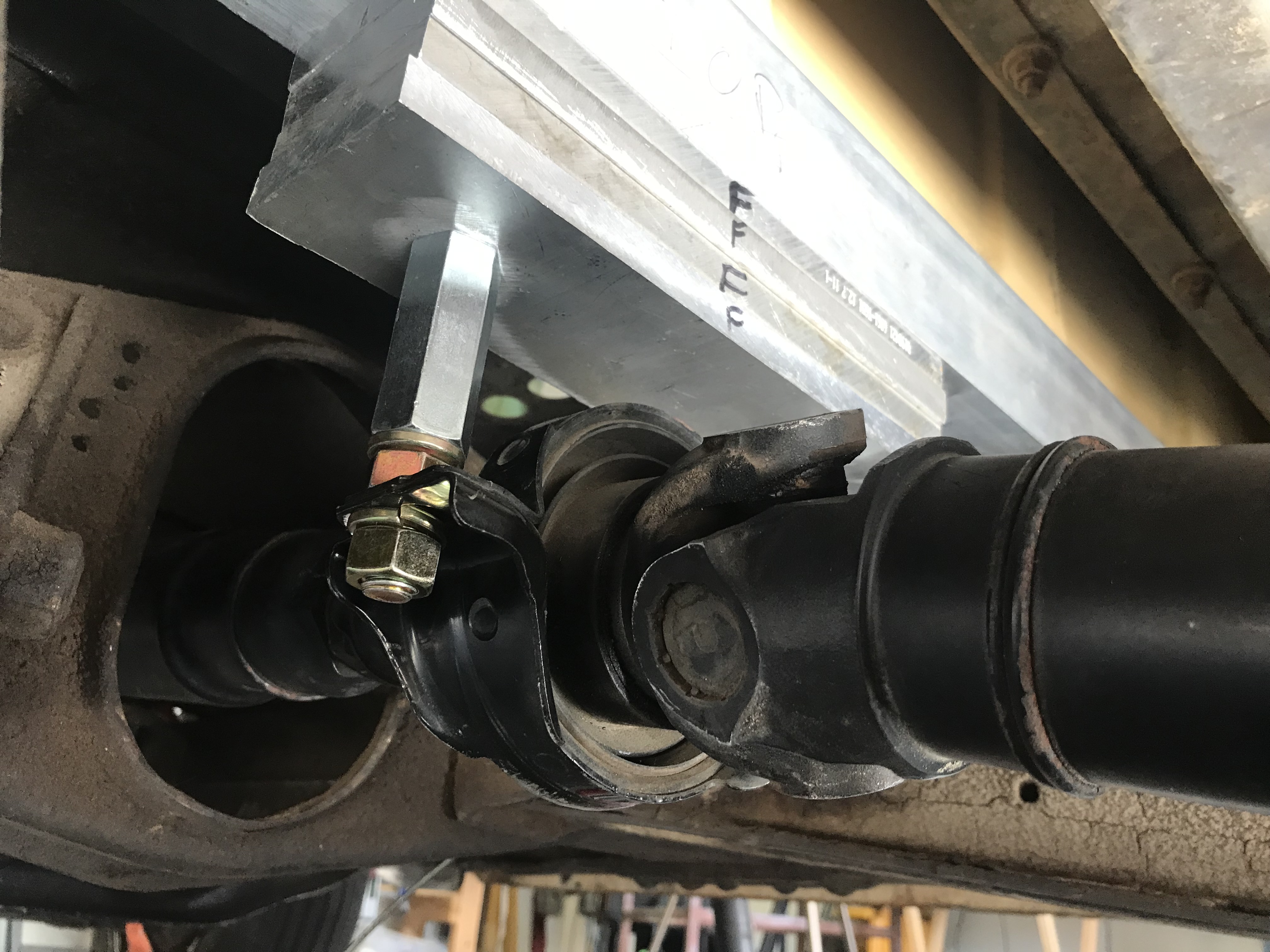

why the Mountulator 3000
... and please don't go all Anglesuxon on me, this is just a mockup

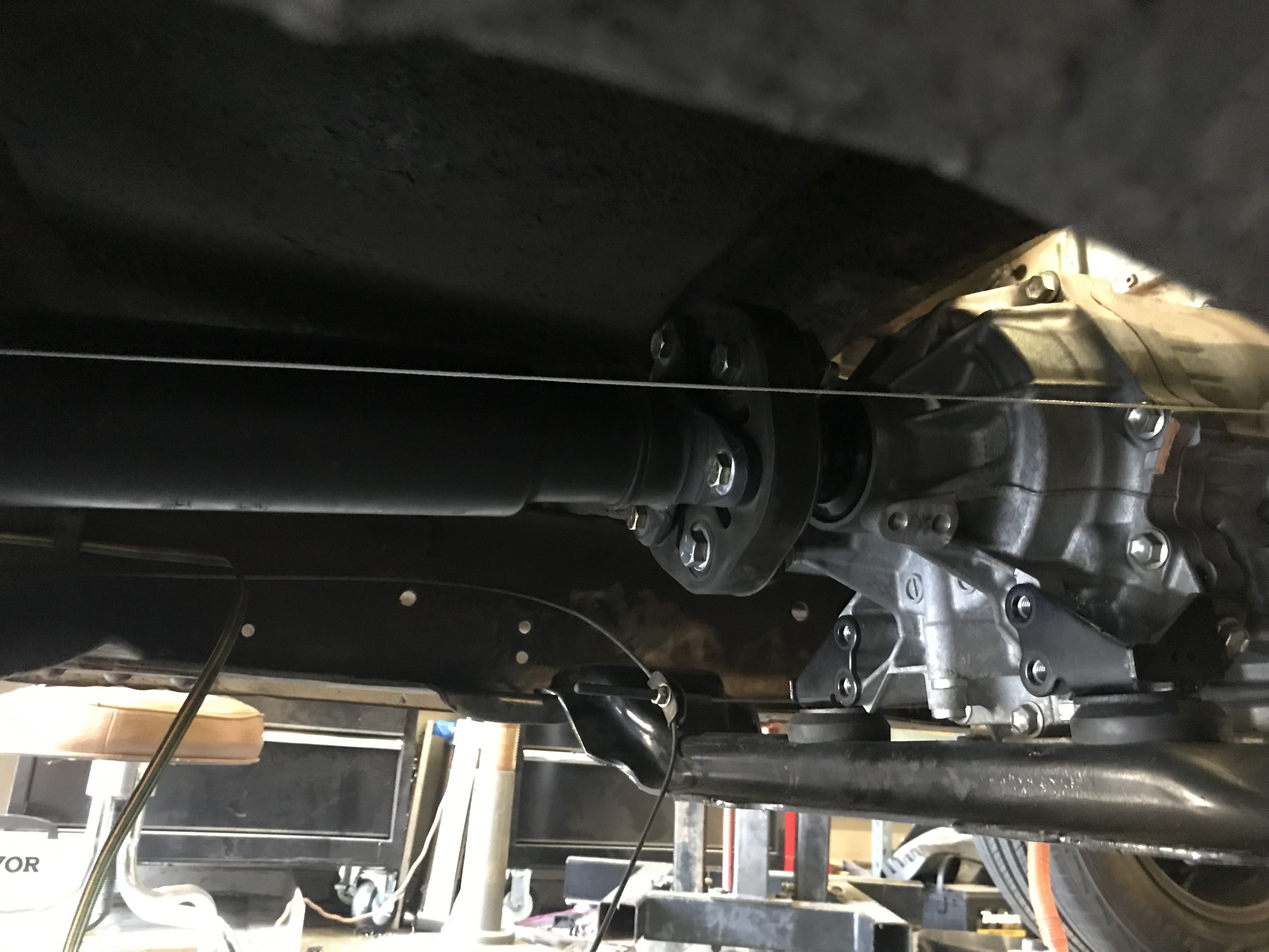

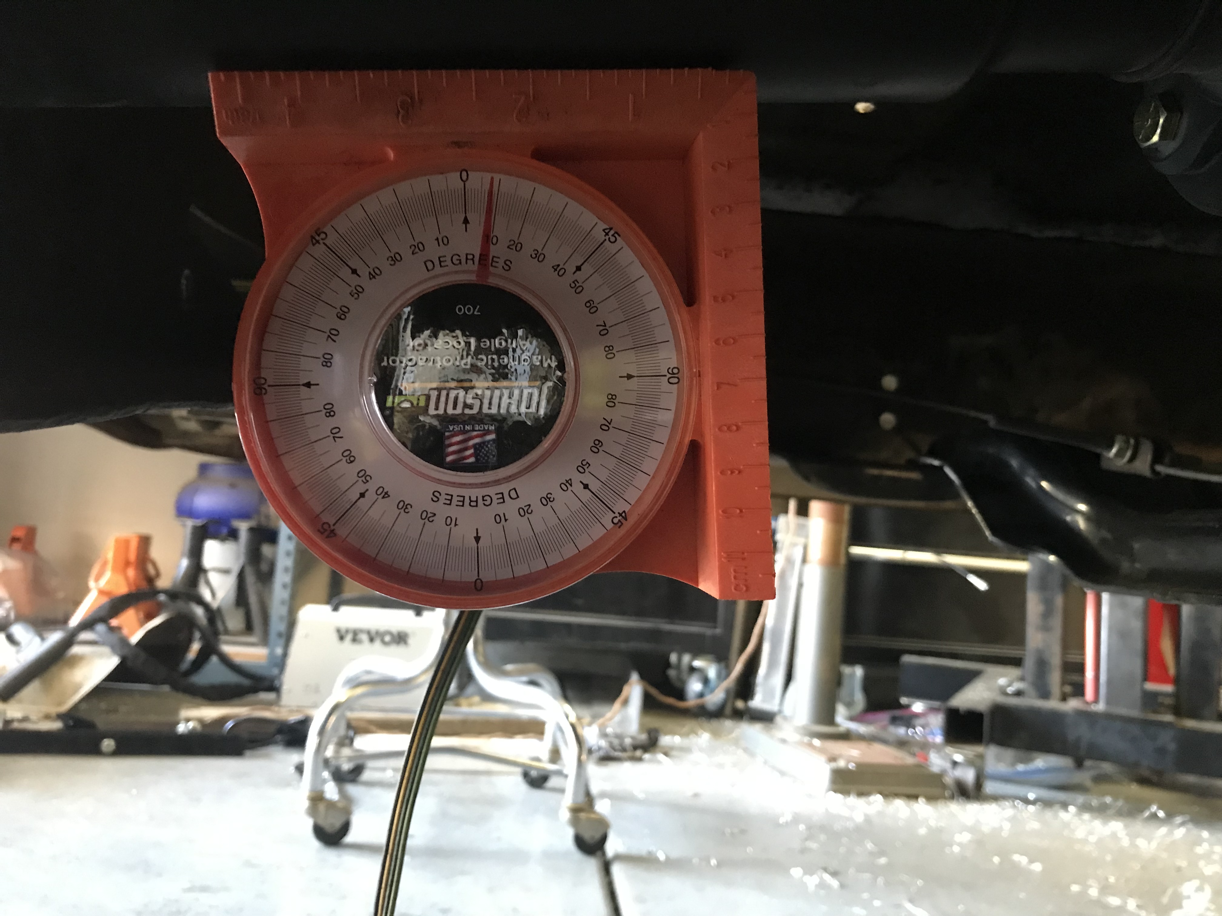

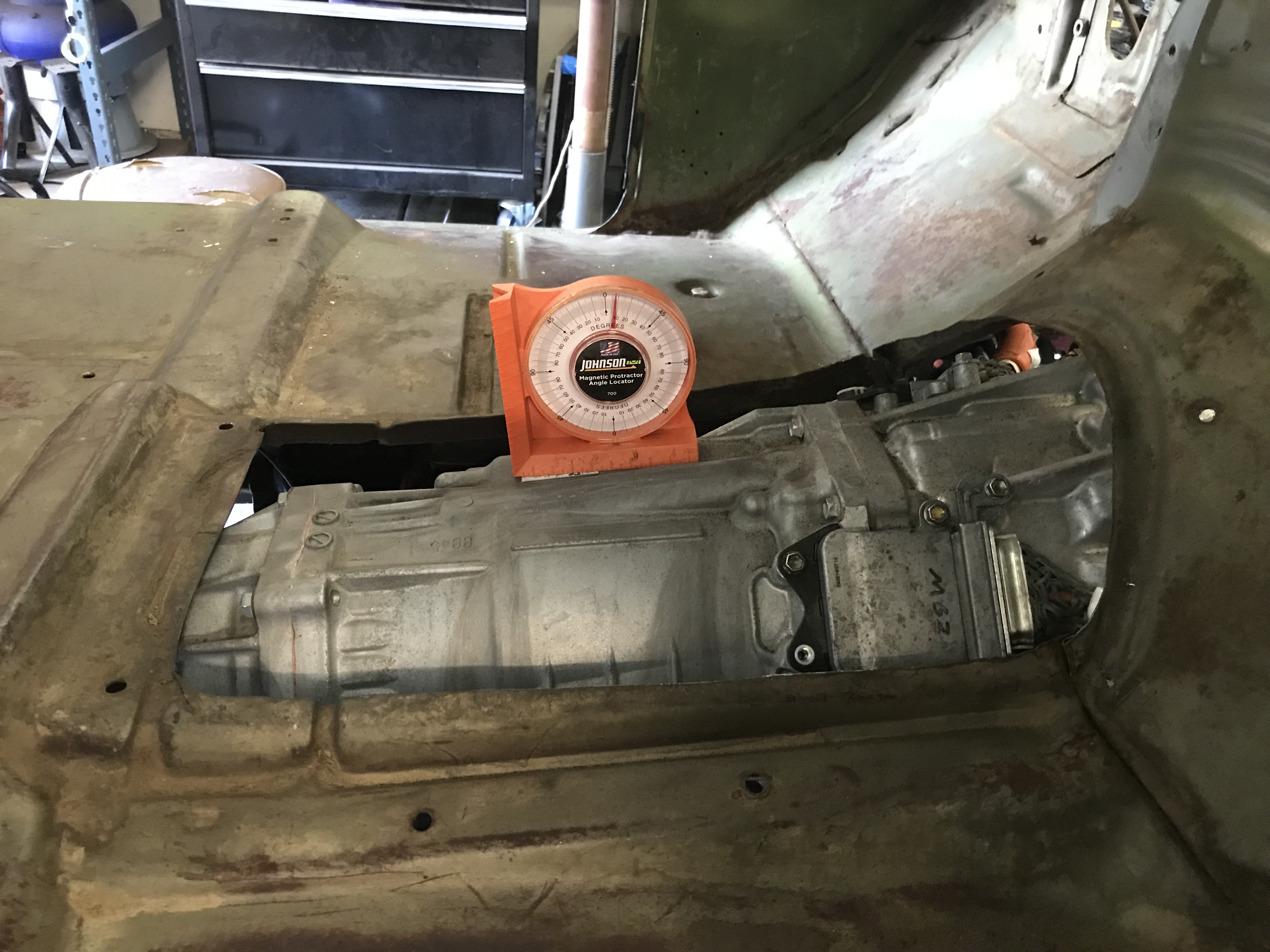

looks like both my Transmission and the short drive shaft sit at the same angle of 7.5°
Gregski
Posts: 3164
Post by Gregski »
I confirmed that using the latest technology, a white lazer level
