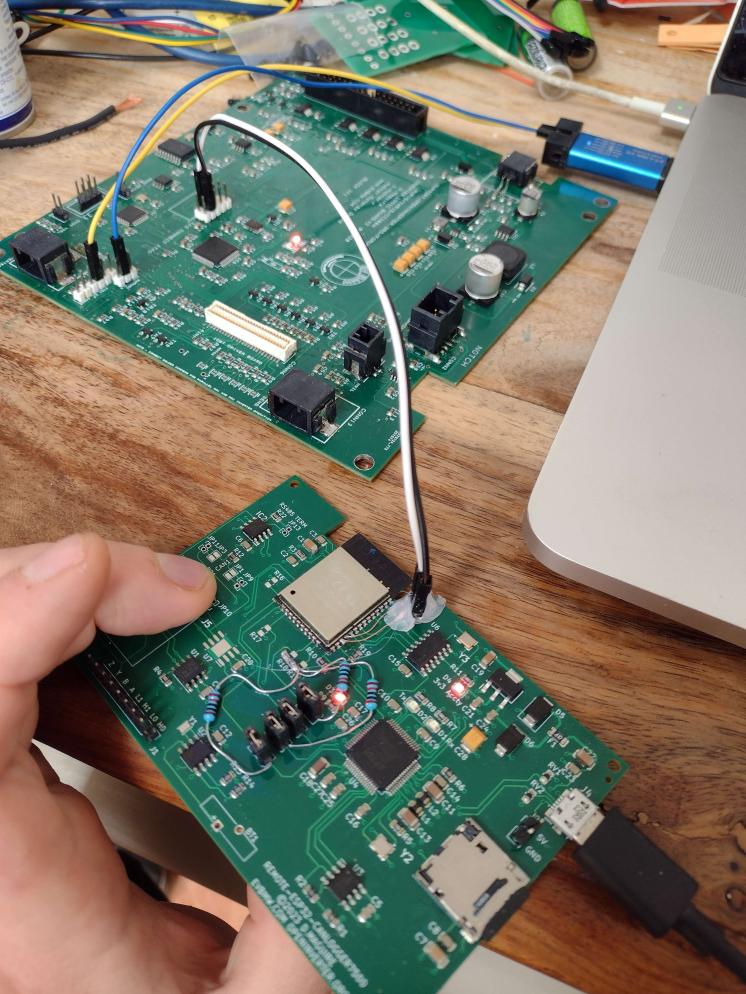

So, to carry this on. I've not got one of Damiens WIP Remote-ESP32-CANLOGGER7500 boards.
I've put https://github.com/Pete9008/esp32-web-interface on there, after burning the efuse
Tested working:
SDCARD
RTC
Unfortunately, it doesn't have the RX TX pins from the ESP32 broken out for easy use, but does have 2 can interfaces and some serial interfaces (RS-485/RS-422) which my OI boards don't have. So next need to bodge these on there.
espefuse.py --port /dev/tty.usbserial-14200 set_flash_voltage 3.3V
SDCARD
RTC

- Posts: 1757
- Has thanked: 80 times
- Been thanked: 410 times
Re: ESP32 Based Web Interface & Data Logger
Done this for now
Going to put your auto tune branch on this board now and test if it gets logging. Still not figured out the current sensors so can't run it on a spinning motor yet.
Looks like he has done that though. When he's back online I'll see if he'll put on github to so I can make some tweaks and send off to JLCPCB for one with fixes on.Going to put your auto tune branch on this board now and test if it gets logging. Still not figured out the current sensors so can't run it on a spinning motor yet.

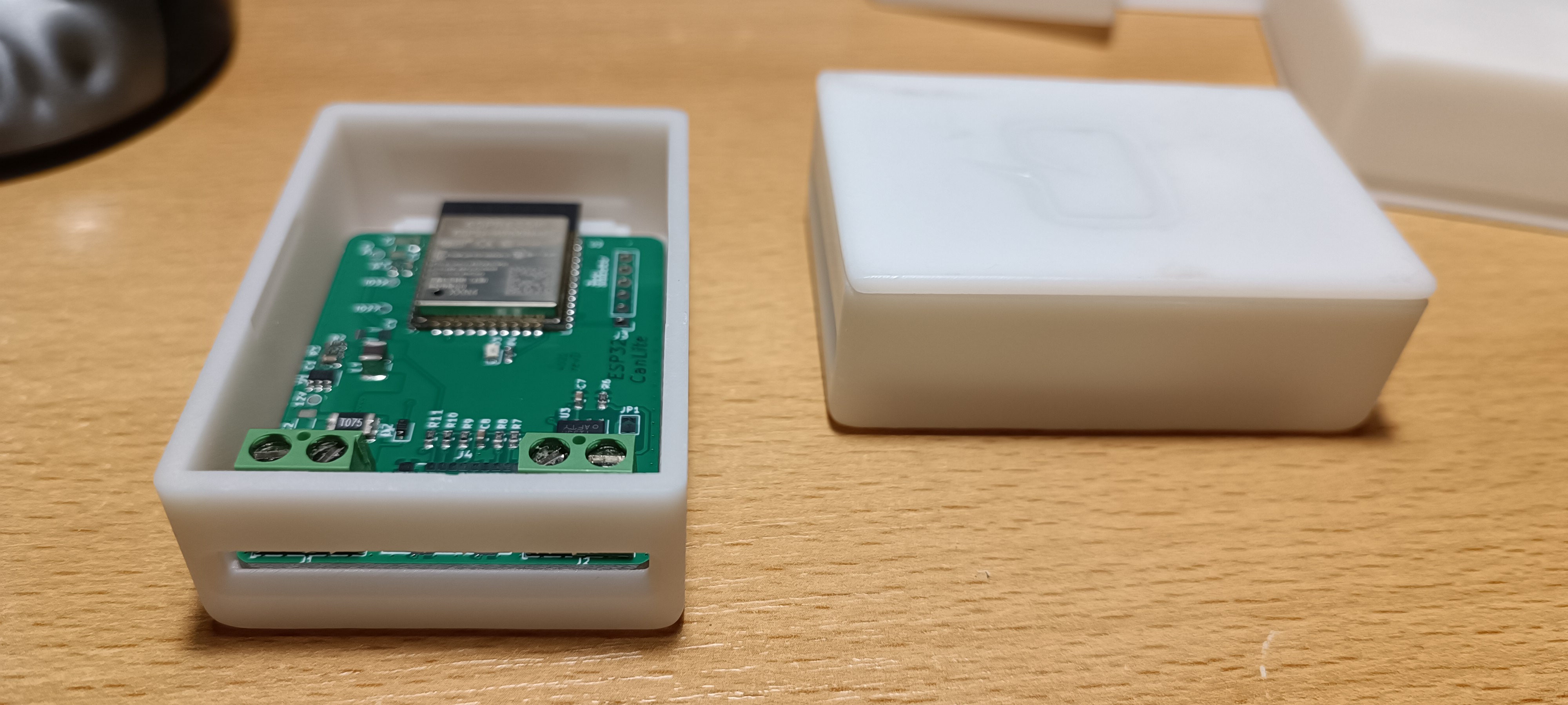

This is the modified ESP32 CanLite from which I removed the 12V high side drivers and replaced them with an SD-card slot. Also rerouted the pins to be compatible with Petes and Damiens design. As you see it also comes with a nice printed enclosure.
It only communicates via CAN so won't be able to do any real time logging but therefor will be able to talk to all openinverter devices on your bus, provided you took care of your node ids. Node ID is selectable in the web GUI. I have finally merged chrskly's better looking web interface. Only downside it's a bit wide for phones.
https://github.com/jsphuebner/esp32-web-interface
Will put it in the shop soon.

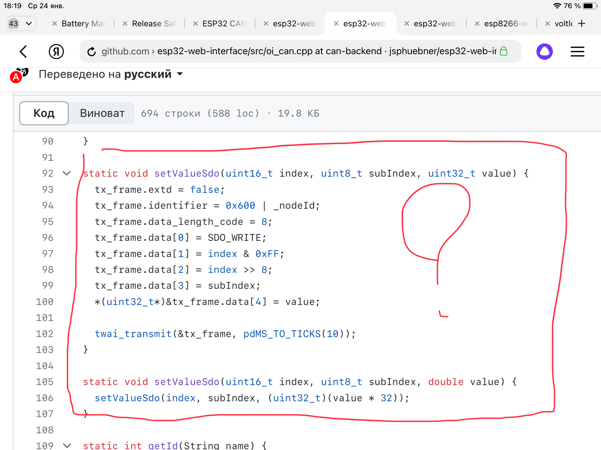

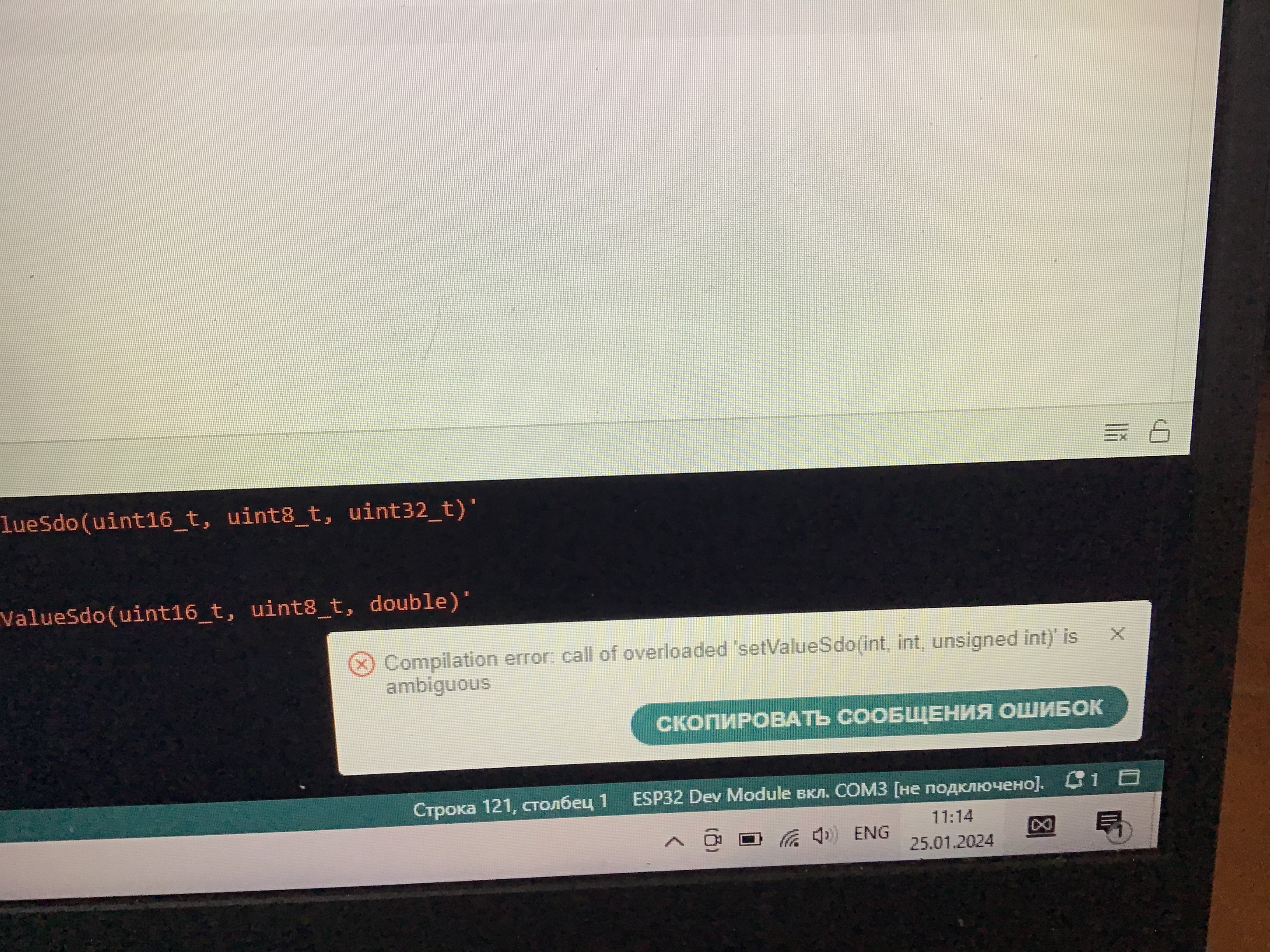

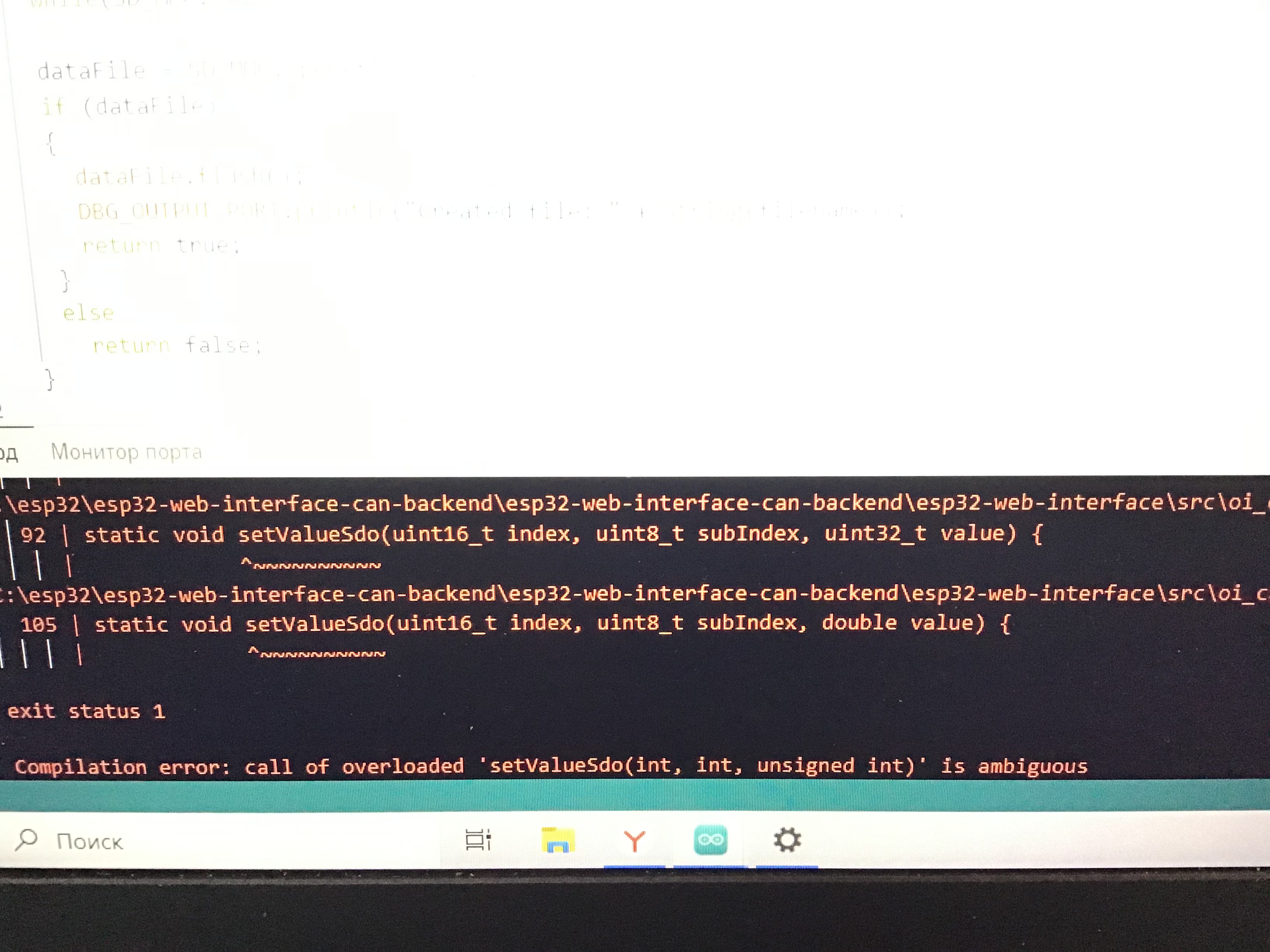

When composing a sketch, it returns an error. Maybe I don't understand something. Please enlighten me)))
- Posts: 6618
- Has thanked: 341 times
- Been thanked: 1484 times
It must be something with the compiler version, it doesn't seem to understand the overloading.
Can you try to compile with platformio? Arduino I haven't tried.
In the description on the git hub, you posted instructions for arduino) I'll try it on the Platformio…
