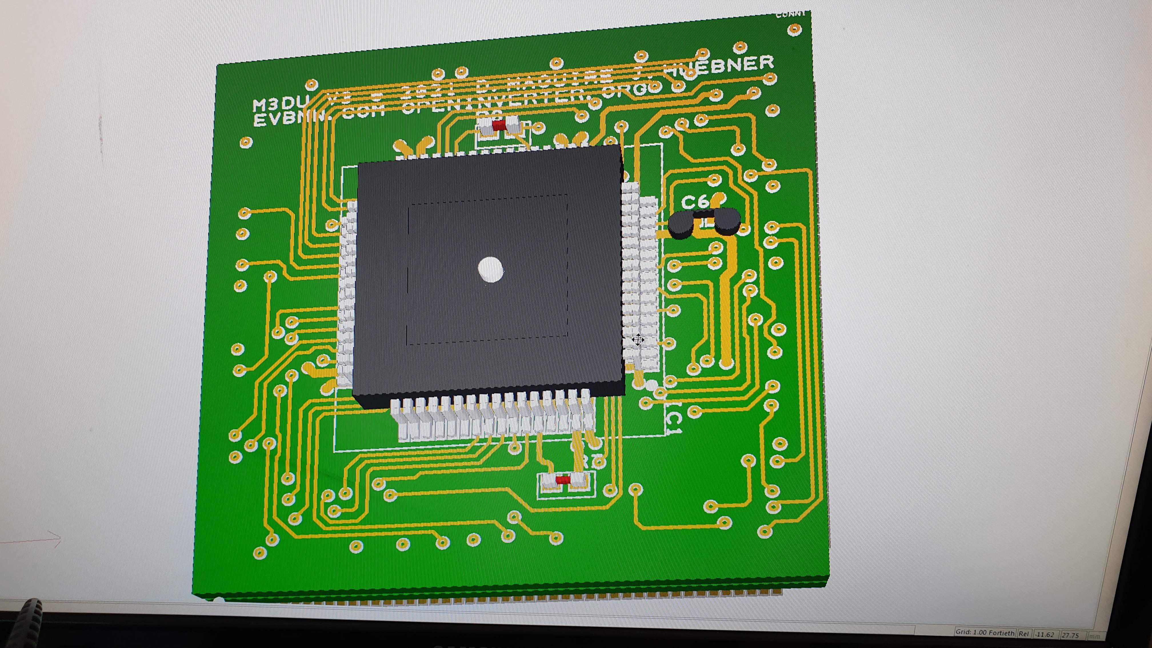

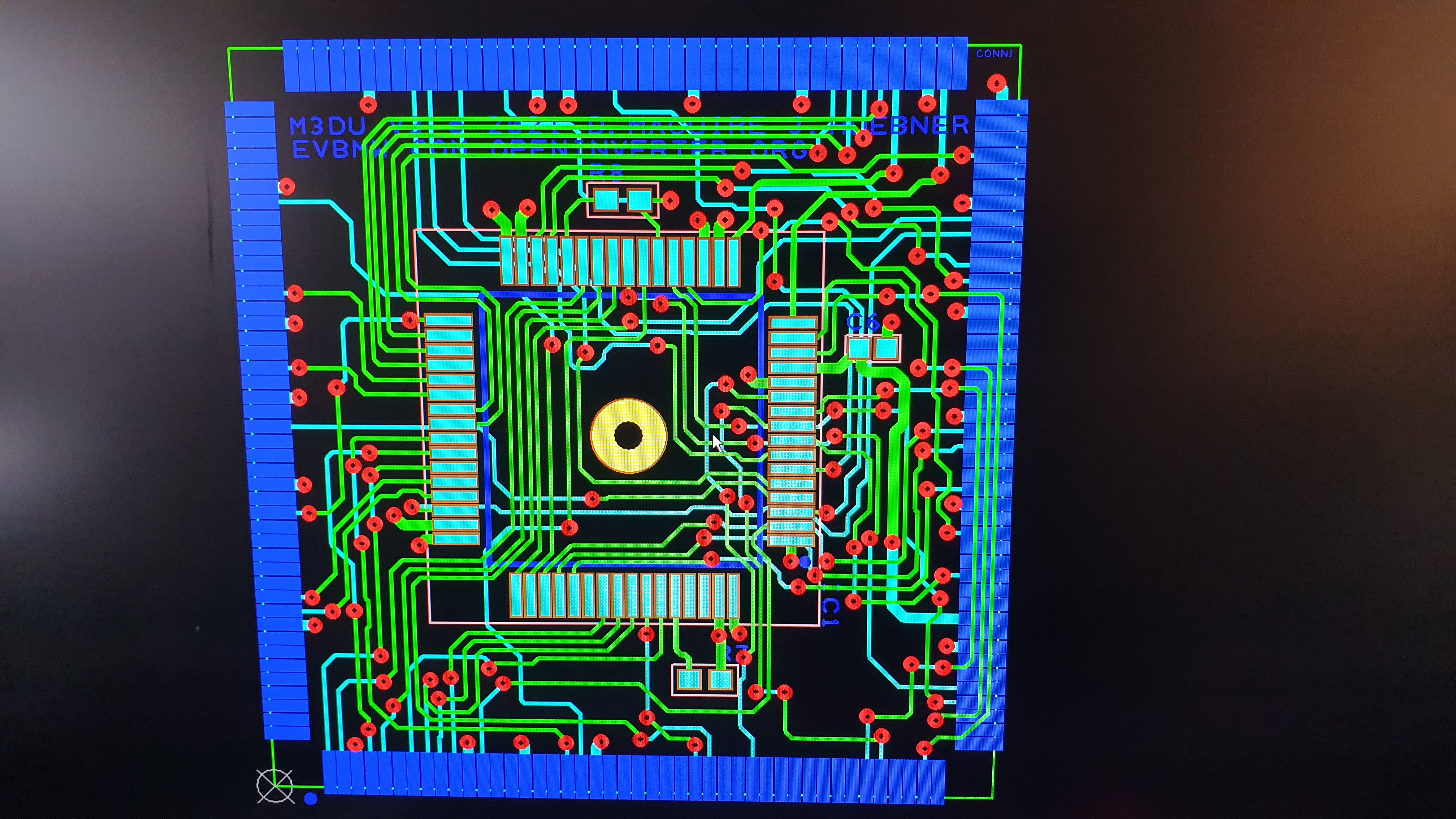

New version using the RD part and onboard DAC. Also changed the mounting pads to bottom only so no need for expensive edge plating. I'll run some checks and then get a few made from PCBWAY. With luck this is the final version:)
Posts: 4006
Been thanked: 1136 times
Schematic and board layout for those interested. Just need to verify the resolver exciter pin before pushing the button with pcbway.

JaniK
Posts: 404
Has thanked: 101 times
Been thanked: 15 times
Post by JaniK »
It looks clean. Like a computer processor without heat shield.
Well done 👍
