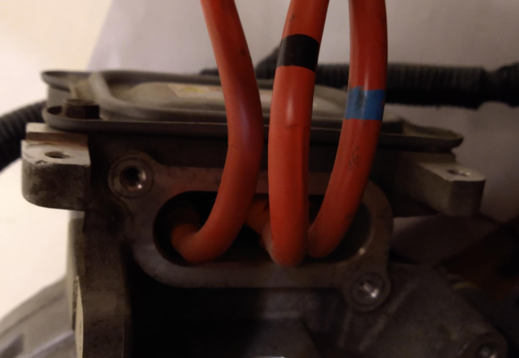

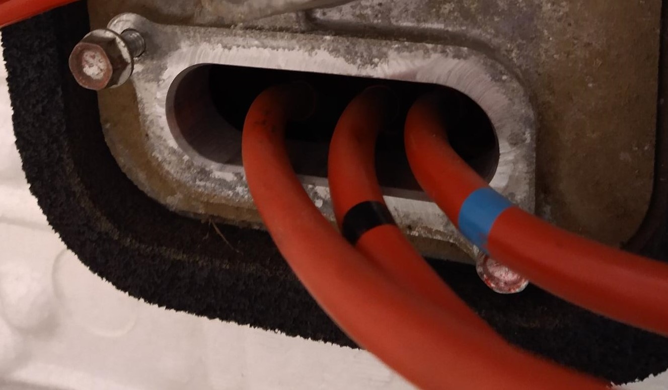

royhen99
Posts: 261
Location: N. Wiltshire. UK
Has thanked: 22 times
Been thanked: 133 times
Post by royhen99 »
Forward and reverse should behave the same. Phase cables are straight through as in photos below.
FFMan
Posts: 331
Joined: Mon Jul 25, 2022 7:59 pm
Has thanked: 8 times
Been thanked: 47 times
Post by FFMan »
thanks for those lovely pictures, that is how mine is wired
