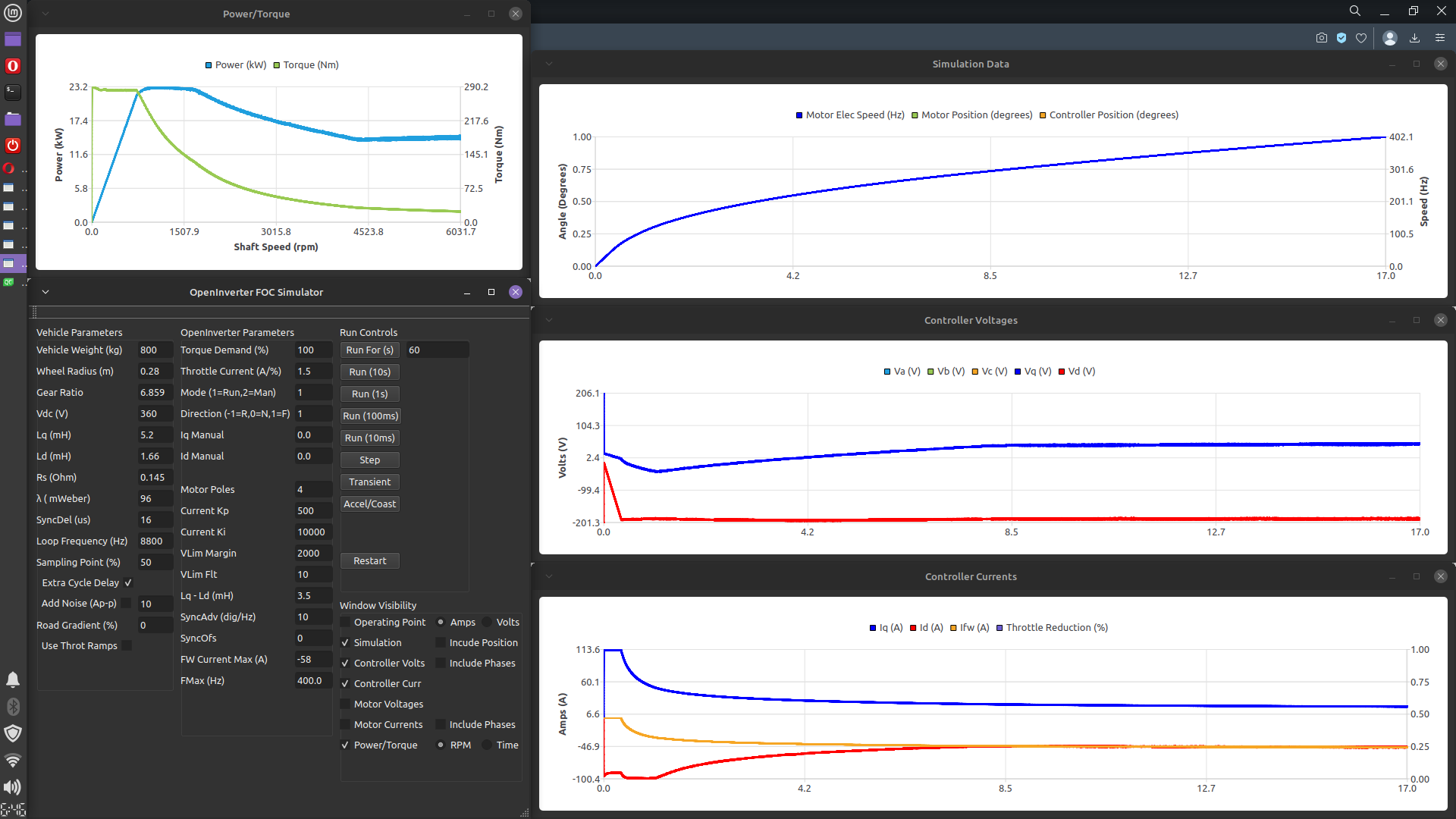

bexander wrote: Fri Jan 13, 2023 11:29 am Have been out test driving and tuning.
First I tuned Ki down and also Kp up to end up at Kp 700 and Ki 1200. Feels much better but the oscillation is still there.
Decided to try the Ki/Kp tuning procedure, viewtopic.php?p=45512#p45512.
The result I ended up with was Kp 700 and Ki 1000-2000. So the procedure seem to work well.
Set Kp 700 and Ki 1000 and made another test drive. Drives ok, the oscillation is still there but much less pronounced. A large log from the entire test drive adn also latest parameters.
log 11.csv
Yaris_MGR_FW5_24_2023-01-13.json
Had a quick look at this, the numbers seem slightly lower than last time.
Over the whole run it comes out at Lq=5.25mH, Ld=1.54mH and flux link - 89mWb
Over a shorter section it comes out at Lq=4.95mH, Ld=1.44mH and flux link - 88mWb
Not really a big enough difference to worry about but would like to understand it. The battery voltage is a little lower but not that much. It's possible the changed parameters could have had an effect? Is there anything else that changed?

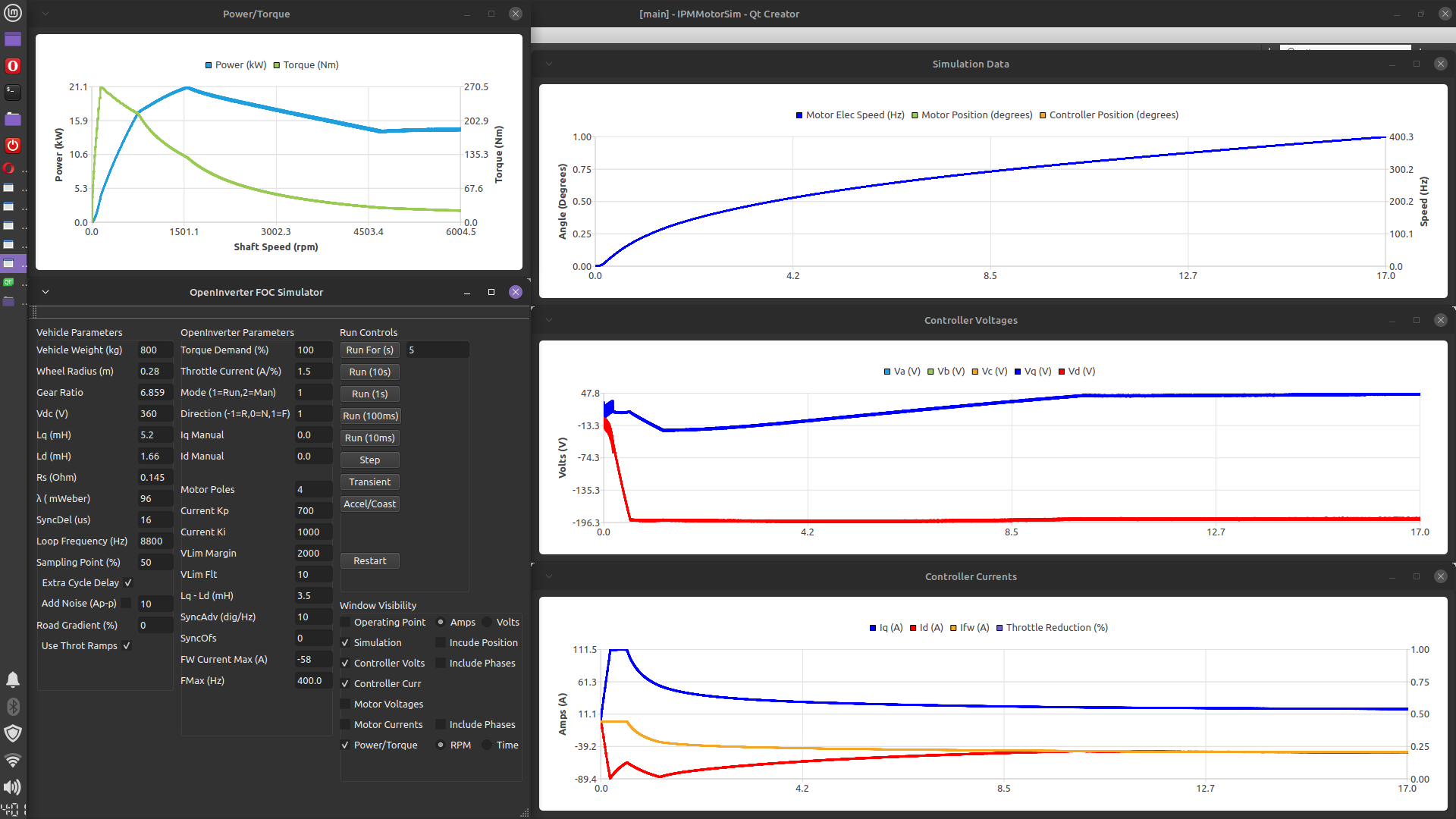

Pete9008 wrote: Fri Jan 13, 2023 9:29 pm Had a quick look at this, the numbers seem slightly lower than last time.
No, only kp and ki changed. In this log a start from home and return home so elevation gradients are included.
When running the sim and comparing the different settings, they give some different motor performance.
Kp 500, Ki 10000
Kp 500, Ki 10000
Kp 700, Ki 1000
Kp 700, Ki 1000

I think that is the trade-off at the moment, low ki helps with stability but high ki helps with control. My feeling is you have tuned it pretty much as well as is possible at the moment, it's just a case of choosing which compromise you prefer.
Hopefully the MTPV stuff might help and once that's done I'd like to revisit an old idea on the control side to see if the ki compromise can be improved.

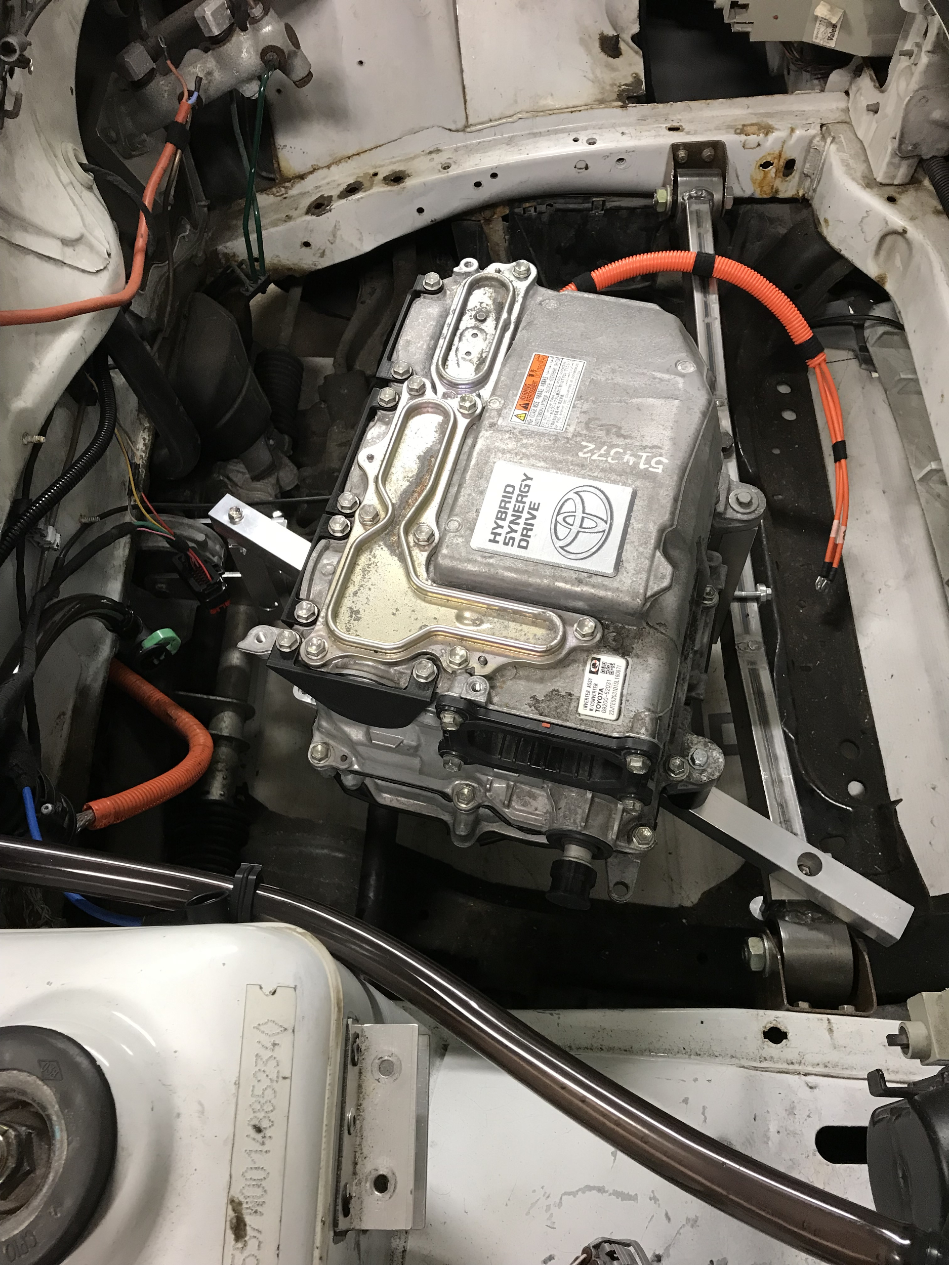

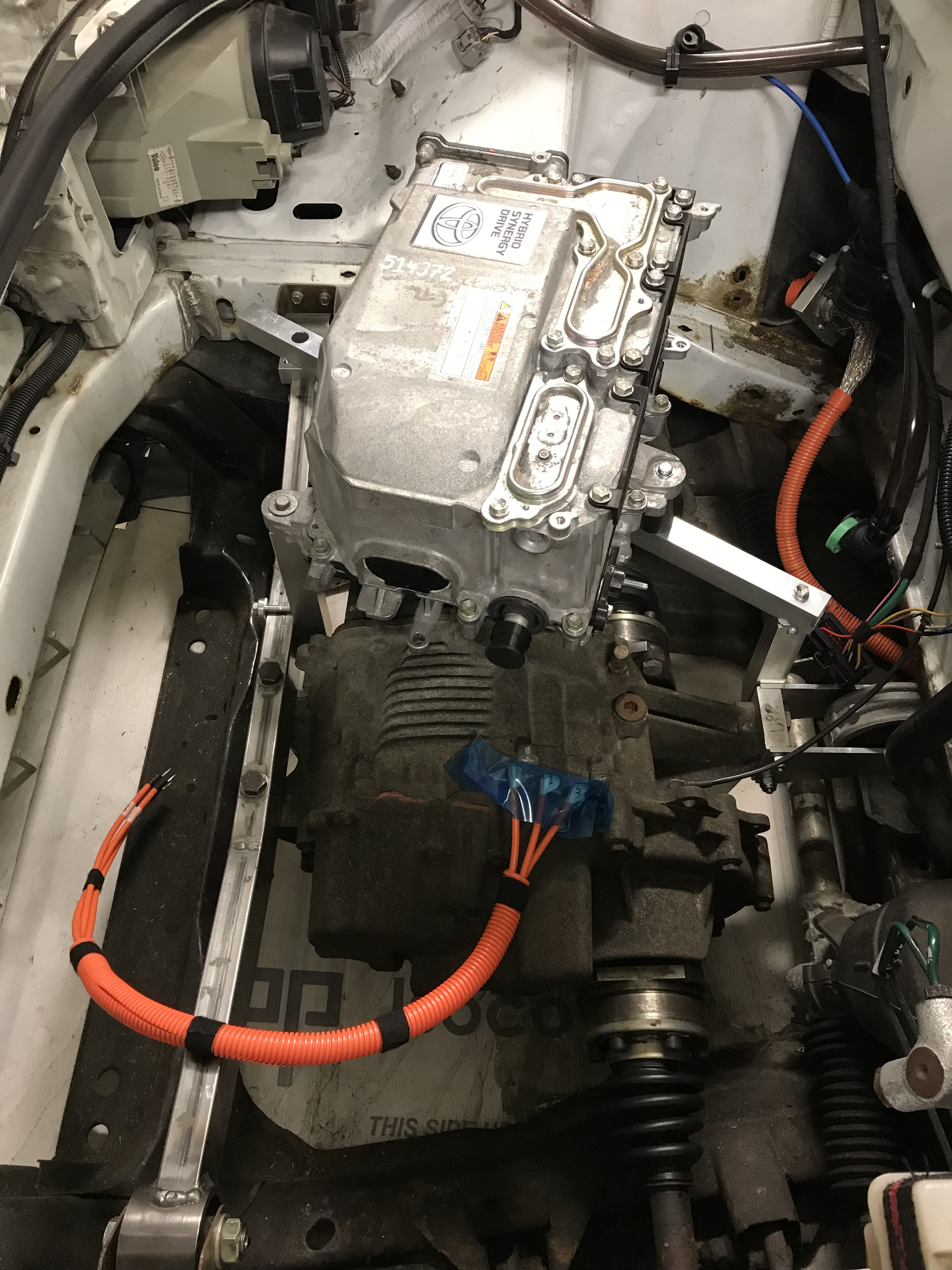

I have modified the inverter so I can feed battery power in it's intended place, i.e. bypassing the input capacitor (rated 300V) and modified the DC/DC to accept 400V by replacing 8 resistors and 3 capacitors (rated 350V, now 400V).
Have also made a more permanent mount for the inverter with the inverter facing the other way compared to the test setup.
The mount feels very solid.
Next is to adapt cable harness and sort out inverter cooling.
